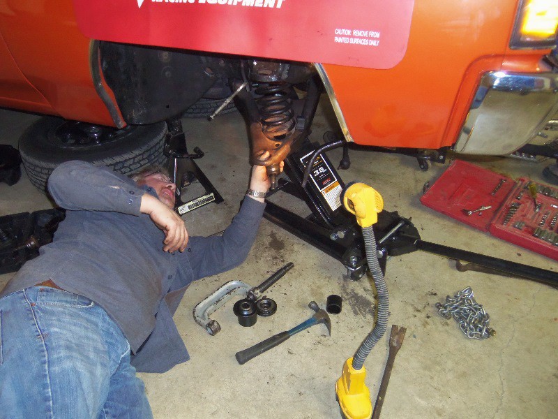

Major thrash session in the southern 'burbs yesterday... installation of a front disc brake kit, ball joints, new tie-rod ends, and lowering the front-end about an inch.
(BTW, to not disappoint y'all, picture #1 is there on purpose. It was the 1st picture to be taken. And it was about 9am - so no extra "shmutz" from you guys!! )
There were a few stumbling blocks. One spindle needed a little "clearancing" for the caliper mount to fit, and the mfg. left a burr on the shoulder where the spindle nut threads end - preventing the outer bearings from sliding on.
(This nearly caused a total work stoppage - without a mic or vernier available we couldn't determine if the shaft was mis-machined (diameter) or what. Dashboard saved the day with a gentle tap on the bearing with a socket. This sheared off the burr and the bearing went on! )
Nothing that some "shadetree ingenuity" couldn't solve.
