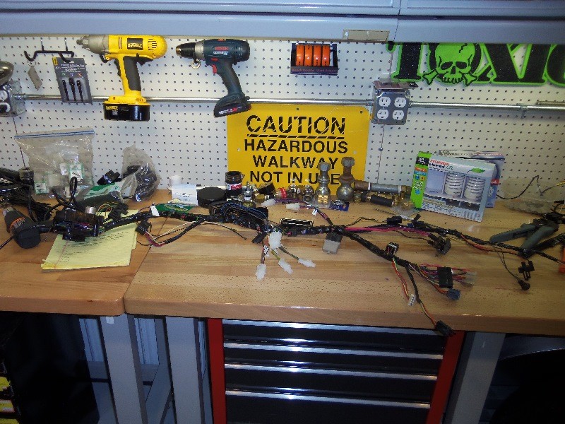

John D came over and reworked my dash harness. We "repurposed" the idiot light feeds to new plugs that will feed my new instrument cluster insert, and integrated the cruise control into the harness. Also installed plugs to feed & connect to the floor shift for NSS, backup, and speedo pulse generator.

Pushrod's going with an "insert" that replaces the sweep speedo cluster - and allows aftermarket round gauges. Instead of running new wires out through the firewall, we decided to rearrange the factory harness a bit.
- Unwrapped it, and ID'd the wires to each idiot light (OP, Temp, R turn, L turn, Hi Beam, Brake, etc.) - Clipped these off at the backs of the idiot light housings, and pulled them back through the "spaghetti" to a central point above the cluster. - Clipped off/abandoned the un-needed (multiple) ignition & dash light feeds at the factory cluster splice. Saved 1 each to feed the new instruments. - Added a new wire all the way to an un-used port on the bulkhead connector for a tachometer feed. Installed the correct "Packard" connectors, and created a factory clean pass-through out to the engine compartment. Did basically the same for an electric choke feed. - Added the (previously underdash/add-on) wiring for the cruise control into the factory harness loom. Made the necessary "taps" into the wiring (soldering & shrink tube) inside the harness on the wires, instead of tapping in at the device connectors with crimp terminals. - Incorporated the necessary feeds for the Vintage Air ECU in the harness. - Re-wrapped the harness.
Now he can just install the gauge-specific sending units, and re-use the factory feed wires through the bulkhead connector... basically converted a sweep-dash harness into a custom SS-dash harness.
Now I'm just waiting for the car to get somewhat re-assembled so we can do a "poof test" before it's buttoned down tight.

John, looks like you are getting your schematic reading and electron fix this way since your Elky is in cold storage!
True... but the way that the summer is booking up with tire-abuse events I should really think about some jobs on Blackie that are pending...
