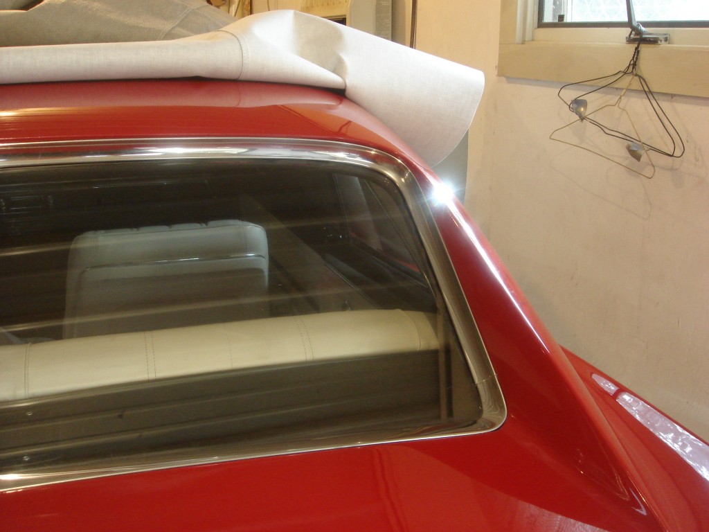

Now problem on removing the upper moldings on the front windshield. But no idea of how to remove the rear window molding. Maybe I even need a different tool? Anyone done this before on a 66 that could give me a little advice?

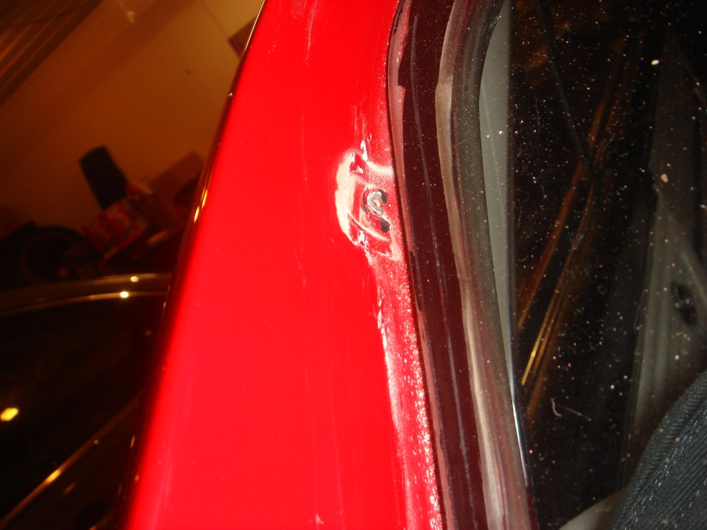

Looks like the front clips cannot be replace unless you remove the windshield. Looks like they were all replace at some time with clips held in by a screw as the top clips are suppose to be held in by studs.

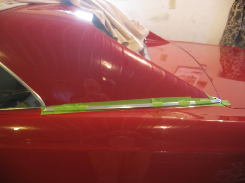

Though I should do the windshield moldings before I start drilling holes for attaching the sail panel area moldings.

I use the same tool for the rear as the front. The rear is much harder to get ahold of the clip and release it. I start at the top and work my way around the sides leaving the bottom for last.
The screws on the roof of yours must have been installed when the top was removed. My '66 has studs up there BUT mine is a late build and yours is early and some things changed during the model year production on the Chevelles.

Petty sure clips have been replaced with screw instead studs when top was removed and car painted in 94.. Original stapels are still there along with a liitle hole where there was a screw through the seam of the vinyl. I would like to replace all the clips with new, if thats an option. Looks like maybe possible if I can cut out enough of the material holding the windshield in place. Will probably have to clean prime and paint the area.

The rear molding is the same as the front. There is a lip along the paint edge that the clip grabs. When you slide the release tool along the window frame, it will stop when it gets to a clip. You then roll the tool so the tip prys the clip away from the frame enough to let the molding come loose.

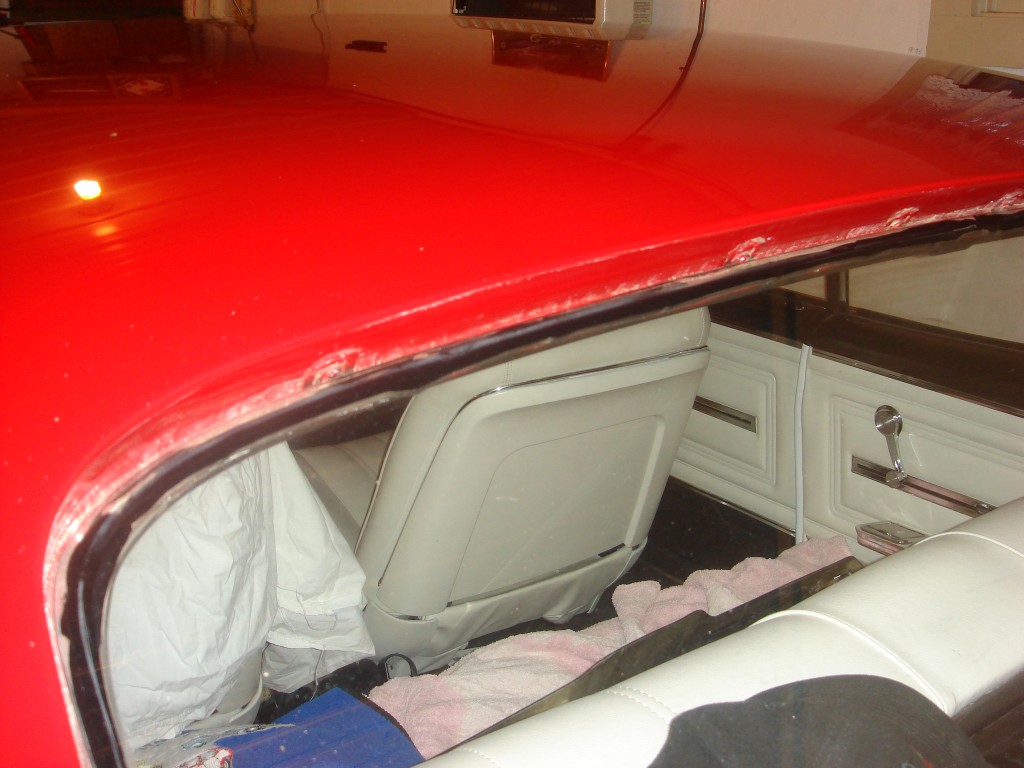

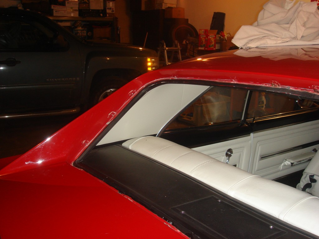

Well I got 3 of the 5 pieces off. That tool is a pain; because of the design, it does not reach up high enough on the clip. I broke one clip off. I think I will be able to re-attach the clip with a 3/8" screw, looks like enough room. You need a more specialized tool to remove the moldings for a 66 chevelle with the sail panels.
On the rear the top clips are held on by a stud as done at the factory. They replace the left quarter panel with a full sail. When they attached the clips, they just used pop rivets. They also replaced the clips on the right side and installed with pop rivets. Don't know about the bottom, as I have not removed the ss molding there. From inside the trunk, it looks like that's the original panel between the sail area. I guess I will see if any work or repair when I get that piece off.
The pop rivets are what make the tool difficult to use. The clips aren't supposed to be trapped that tight against the body.

Had to remove the back glass. All clips are now off including those with pop rivets. I have removed all the excess urethane from the front pinch weld channel and about to clean that area and clean and prime the rear pinch weld area. After cleaning I will try some of that new epoxy primer in a spray can to seal the area from any scratches. Have to order that from Eastwood and some stainless screws and special clips for installing the rear sail panel molding. Just ordered some clips and screw in studs for the clips from Ashleys today. After all the prep work is done, I will have to decide if I will install the vinyl top or have someone that Karl recommended install the top. Then put the rear window back in with the butyl sealer or a urethane application similar to what is in the 66 fisher body manual.
