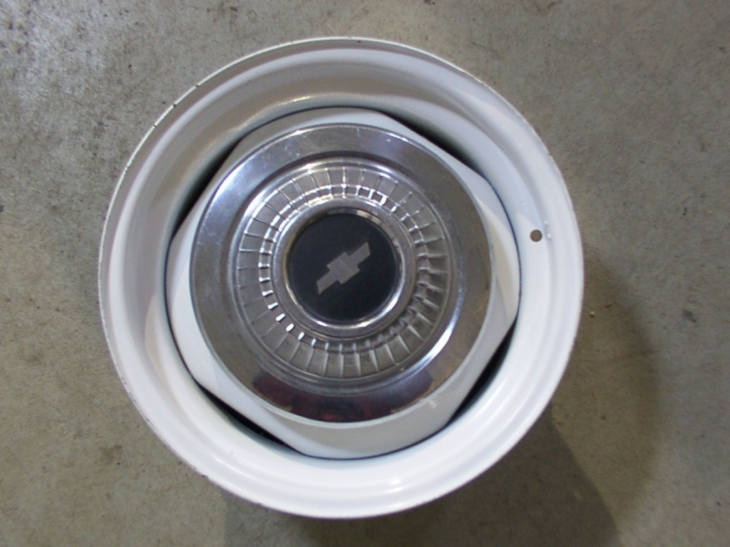

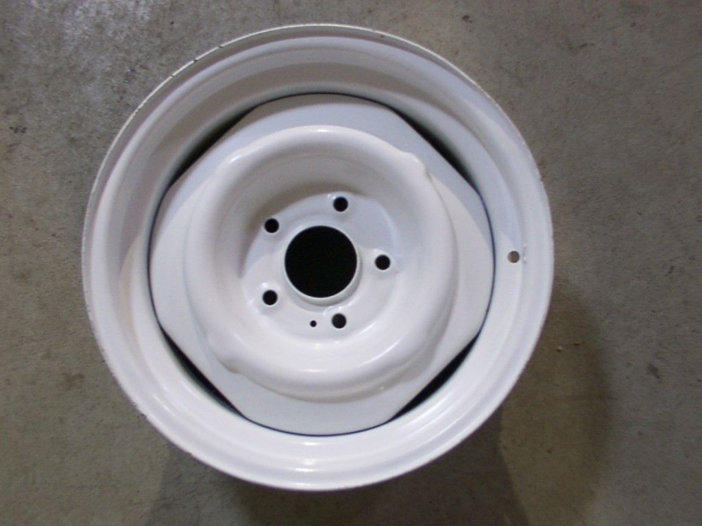

This past weekend I checked the rims I have. 15x7 have a 4 5/8 backspacing and have four "nubs" for holding on the hubcap. The stock 64-67 caps fit on without problems (see pics). I got a pair at a swap meet then spent about a year and a half finding 3 more one by one (ones for a spare). Of course after that I found a set of four at a swap and bought those too. I have no idea what vehicle they are from. Possibly midsize 70s station wagon?
I also have a set of 14x6 which will work with disc brakes and 11" rotors. They also have four nubs and the stock caps fit them as well. I got them off of a 75 Nova.
