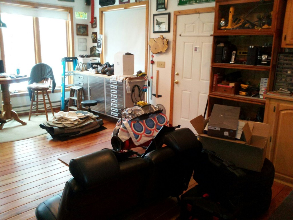

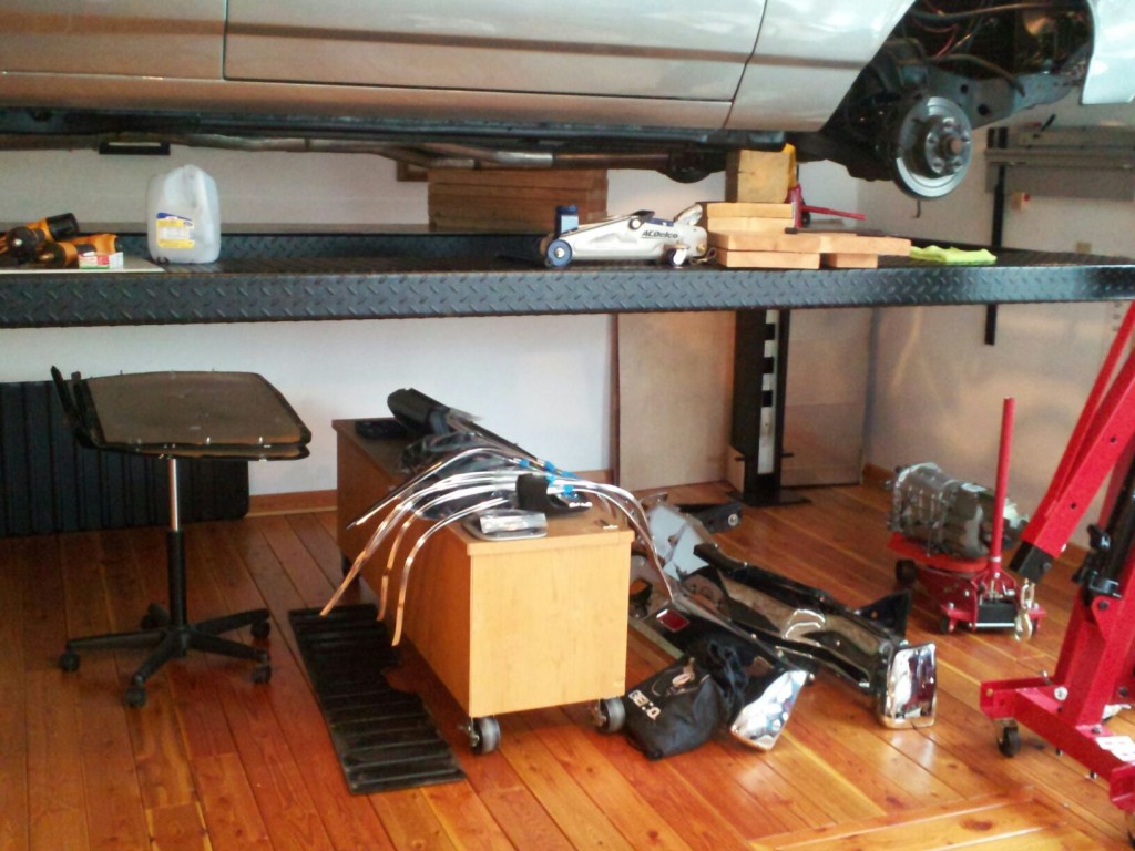

It’s out, thanks to Jon H, I could not have done it with out him. The Keisler RS 500 five-speed trany was longer then I thought and required quit a bit of tilt but it came out through the top. Trany went in from below in October and came out through the top in December.
We now know you can remove a big block through the center of a four post lift, took patience to work in cramped quarters. Now it’s pull the heads, check the valves replace all the seals, install the new cam clean things up, and then off to the dyno.
Once again, thanks Jon.

A guy doesn't mind helping a friend, but when you have to take your shoes off in the shop because it is cleaner than the typical house I think that is asking a bit much. Actually it was enjoyable as Kevin has all of the right tools and the prep work completed.
Dec 1, 2011
Isn't that crazy ??? It's like working in a gourmet chefs kitchen... That was really nice of you to run all the way down from Lino. Wish I could've volunteered but this week has been very busy.

Kevin I thought you could use the 4 post lift to pull the engine straight up if the trans had already been dropped out through the bottom? Something to think about for reassembly.
You still amaze me how you keep all the fluids from dripping out all over like what happens to me when I pull engines/transmissions... I'll bet you had the shop vac out sucking it up as it dripped out of the engine. Right?

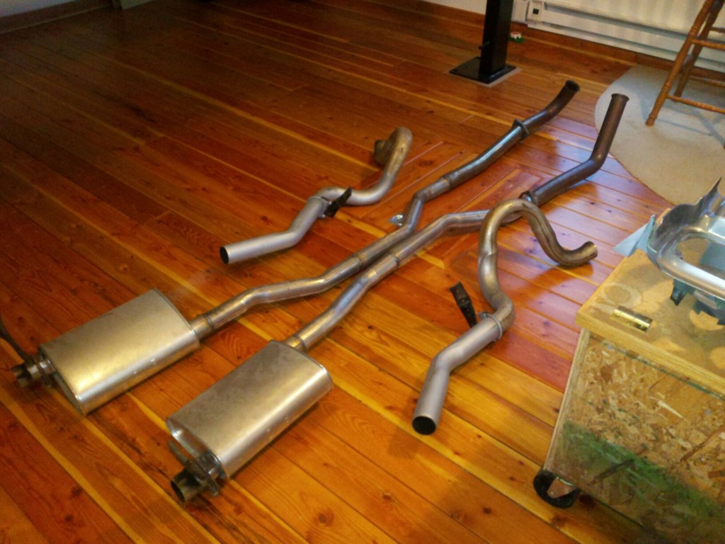

Starting 2012 with the snow a nice fall and a project that is snowballing.
Did you really think you could contain it to just the engine ....
I gave the '66 a good wash after I drove it to the party and parked it on the storage side. With the new job, it's not looking likely that I will do anything with it in the near future. I moved the Camaro into the shop to replace the trunk floor that I have been threatening to do for 3 YEARS.... It will also be nice to get the fuel gauge working. I still haven't pulled the LS5 off the shelf to open it up either. This working during my winter "break" is getting in the way of fun.

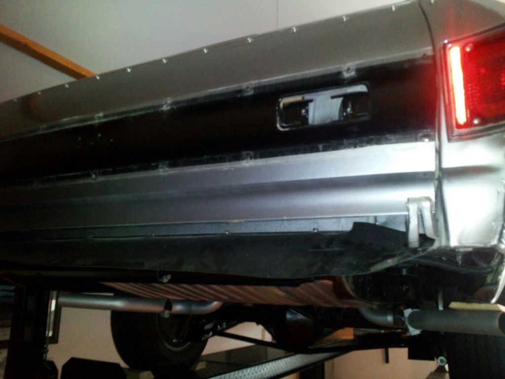

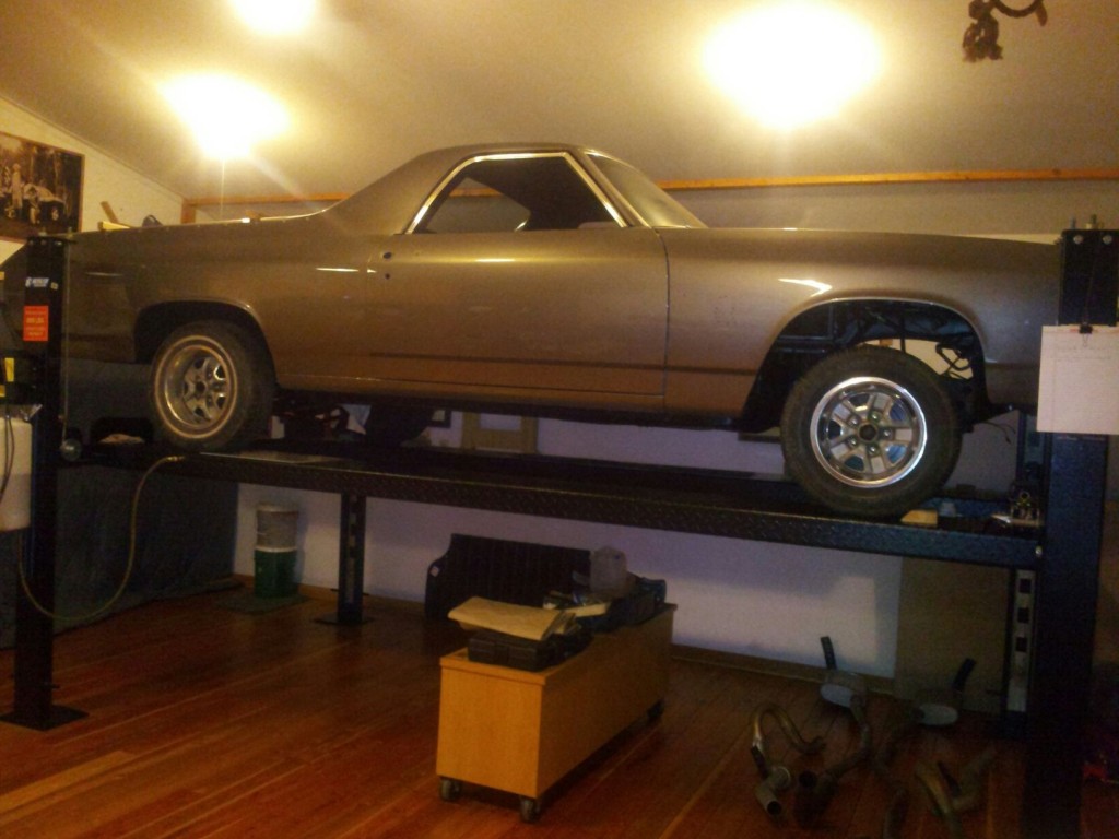

Moving right along with ‘taking it apart’ and getting the Elky ready for paint. Stan, you where right, I tried every way to get the exhaust out without cutting, but in the end it was Sawsall time.
Almost done with soundproofing inside the cab, next come the smugglers box, doors and aft bulkhead.
It is down to being a shell; I think I’ve removed almost 2000 pounds of components and parts so far. Hope to have it in the paint shop before the week is out. Then it’s back to getting the engine work done.

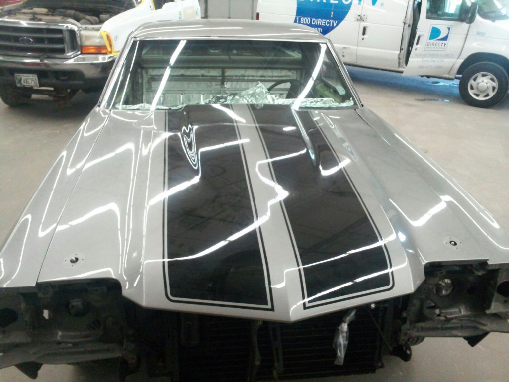

Phase two has started, today the Elky left for its new temporary winter home, Maaco of Burnsville. Jon H goes to Texas, and the best I can do is send my truck to Burnsville.
Stopped by this afternoon to go over some details with Jeff and Jason, both great guys to work with. Jason was showing me his GTO vert project and mentioned they had an Elky like mine in for some work. He took me out to the shop floor and there sat a 1972 El Camino SS. I walked over looked at the VIN and see it’s a W code. Figure the odds less than 600, 72 W code Elky’s where made and here sit two within 20 feet of each other forty years latter.
Getting pumped up now, today took the bla out of winter for me; now for the engine work then phase three and four.
