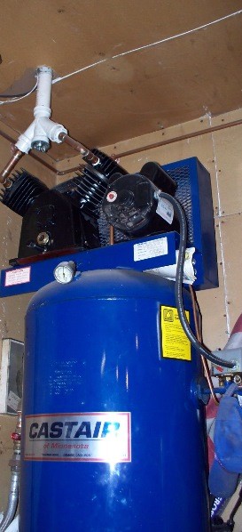

I built my own using a cast air pump. Like John said the lower the pump rpm the quieter. I have a large compressor and its nice to beable to have a conversation with someone and not have the compressor droned you out. Or make the kids jump when the compressor kicks in. The people at cast aire are very helpful. they helped me size the motor pulley to work with my setup.
Oct 26, 2011
One thing to consider doing as well (for everyone). If you go with a "fixed position" unit (no wheels), spend a few bucks in the plumbing aisle at Home Depot. Get the fittings/elbows/pipe necessary to run the intake up into the garage attic. Just doing this will cut the noise in half!
I made a manifold out of a combination of copper & pvc. The inlets to the cylinders are 1", So the "main" pipe is 2". There's a similar manifold in the attic where the air filters are re-attached to.
(How the unit got up ON the workbench in the corner is another story)
I still havent ran mine yet.. have to plumb and get an electrical pigtail.. anyone interested in a plumbing party at my garage this spring?

Geez, it's been "amortized" over so long... but I'm guessing about a grand... about $800 for the unit, with install accessories (flex pipe, cork biscuits, hoses), then another $200 for piping, fittings, regulators, etc.

I have ~$200 in plumbing. It's all black iron pipe with one flex hose to the wall. You're welcome to come see it for ideas.
When I built the workbench I had the compressor location in mind. There are 4) 4 x 4 pressure treated "posts" under the benchtop (in the location of the legs) that go to the cement floor. The mounting bolts go through the benchtop into the posts. The load is transferred to the floor, not the benchtop. I also extended the tank drain through the benchtop, and elbow'd it over & out to the front of the bench with a petcock. I can drain the tank from the face of the bench.
I used a little mini chainfall hoist rig on a roof rafter to get it up there (I've got 10' ceilings). A little scary, but I got it up there myself.
It sits on 1" thick cork & rubber biscuits, using 6" lag bolts through the benchtop into the posts below. When it's running you can barely see ripples in a water glass 15' down the bench.

I've owned a Cast-Air unit for 10+ years now, built in Chaska. (6hp, 220V, 2-stage/V-twin, 60gal)
http://www.castair.net/about-us.html
