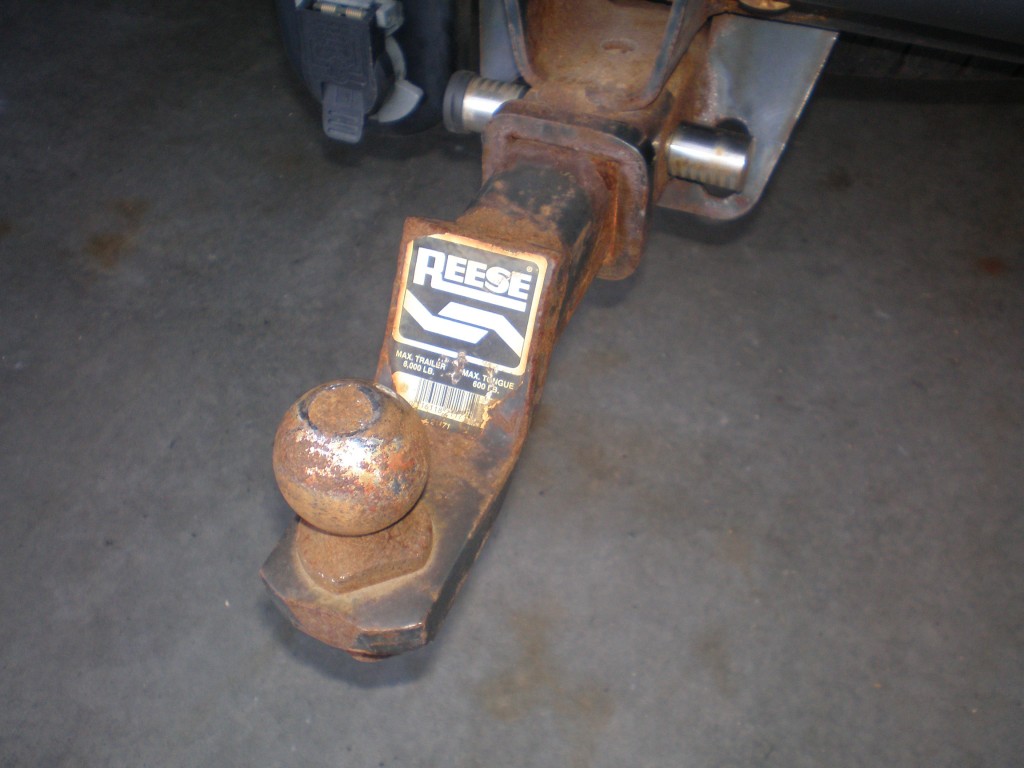

I'd like to take out the trailer hitch receiver from the attachment on my truck, but... it's rusted in. Any ideas on how to get it out other than a BFH or a welding torch?
See attached pic.
Oh, and no jokes about taking out the locking pin first. I do know that needs to come out. Doh!

With the pin out, hook a chain around a large stationary object, loop it around the ball, and let the truck do the work. :)

Hit it with some PB Blaster over a few days (put cardboard down on the driveway), then do Derek's trick.

Remove the lock and spray in between the reciever and the tongue as well.

In between PB blaster applications, a solid tap on it from each angle too so it helps break free and gives more area for the spray to work.

I have been here before and here is what I ran into. Once I got it out the inside of the hitch is so rusty you cannot get a new receiver to go back in the hole again. Maybe yours won't be this way hopefully.

I have the exact same problem with my Suburban. I sprayed it with PB Blaster and hooked one end of my tow strap to the ball and the other end to my other Suburban. After a few "yanks" (each one with more gas) my 3 inch tow strap broke in half. The ball is still in there.

Blow the crap out from around it first and behind if possible. Use PB, Deep Creep, Liquid Wrench, whatever your flavor is and let it soak in. Hit it with a torch on the outside of the receiver after a few days of soaking, then another shot of penetrant. Repeat a few times and then give a tug or two, I have seen it done with candle wax to seep in as well.

hey Stan, i worked at the hopkins hitching post installing hitches for a couple years in the early 90s that insert may never come out guys would come in and pay us to remove the insert and usally we ended up gas axing the old hitch off to install a new reciever hitch. good luck, the guys have the right idea but sometimes good old rust might as well be a weld. if you end up buying a new reciever frame call Rigid Hitch in Burnsville Mn the are a wholesaler but will sell to you if you order ahead and pick -up at the will call desk. it helps if you go on-line first to find part #. i believe youre truck uses the R3-0860, should be about 220 bucks. good luck

Thanks everyone for the creative ideas.
Sounds like the receiver is in to stay.

Though it is a lot of work I have never not been able to get one out. Good old lube in a can, heat and a hammer .. as well as many attempts quite often on different days and it will come out.
