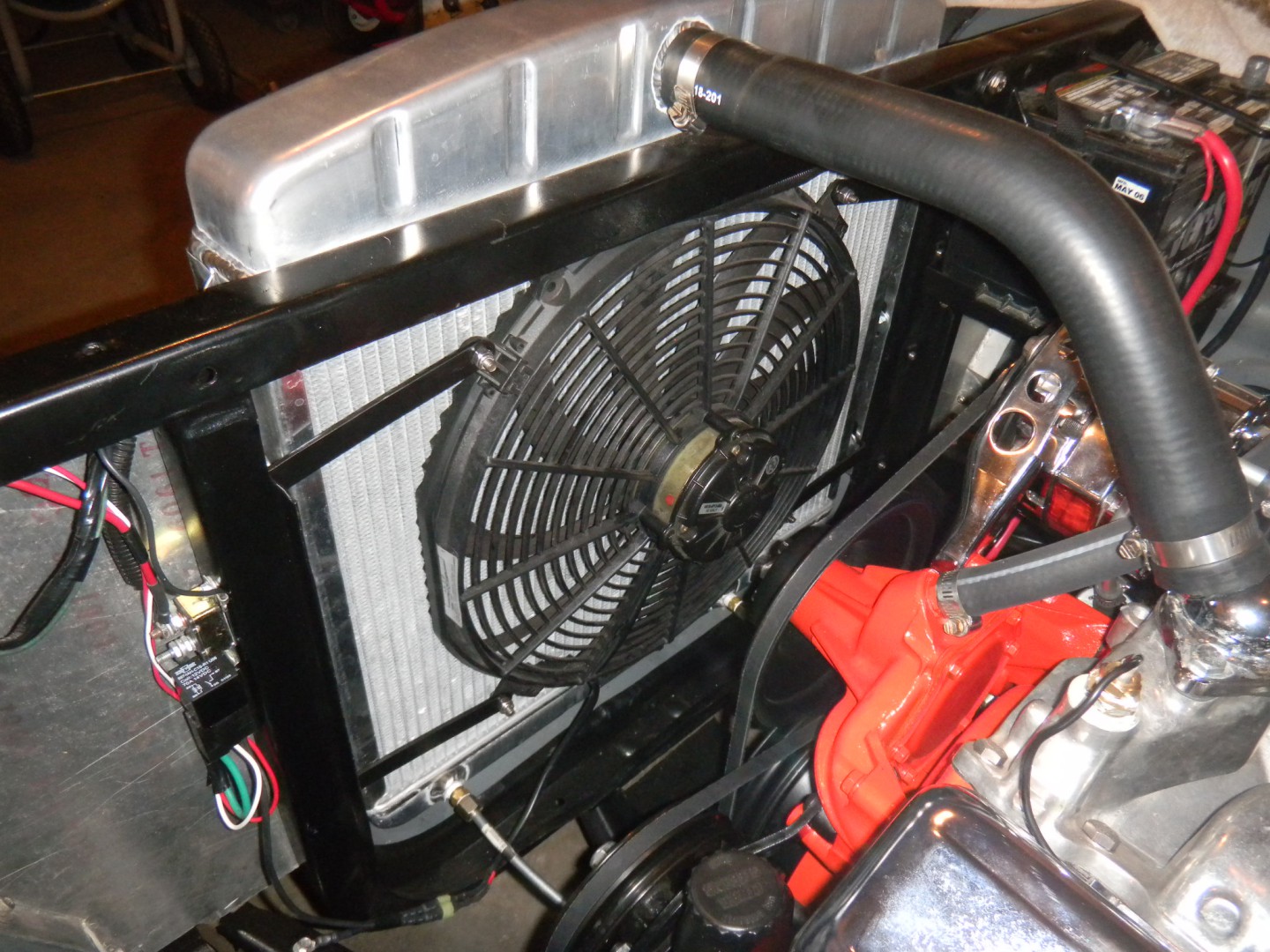

Ok so I fiqured it was about time I took some pictures of what I have been working on instead of my darn cars. What started as just a rear end swap turned into change to an auto transmission, weld in side motor mounts, install transmission cross member and rebuild a stock steering column to shift the automatic.
So I put in the side motor mounts with the manual transmission still in so the motor was sitting correctly. Then removed the manual and here is the 700r4 bolted up so I could get the crossmember position and welded in brackets on the frame.
-- Edited by 67ss on Sunday 4th of September 2011 02:10:36 PM
This is the 74 nova 8.5 10 bolt that is the exact same width as the stock rear end. It will have 3.42 gears and a factory auburn posi when it is all done. Had it blasted and painted to make it look pretty. Had the driveshaft shortened by proven force in arden hills.
And last how many steering columns does it take to make one, the answer is three. Here is all the pieces that will make one good one eventually. We also got a wider brake pedal from a 56 to go with the automatic transmission, not technically correct but I think it will look better.
So why am I doing all this? The muncie that came out of this car is going into my chevelle over the winter. Running the casting number on the muncie it is a 65-66 so how perfect is that.

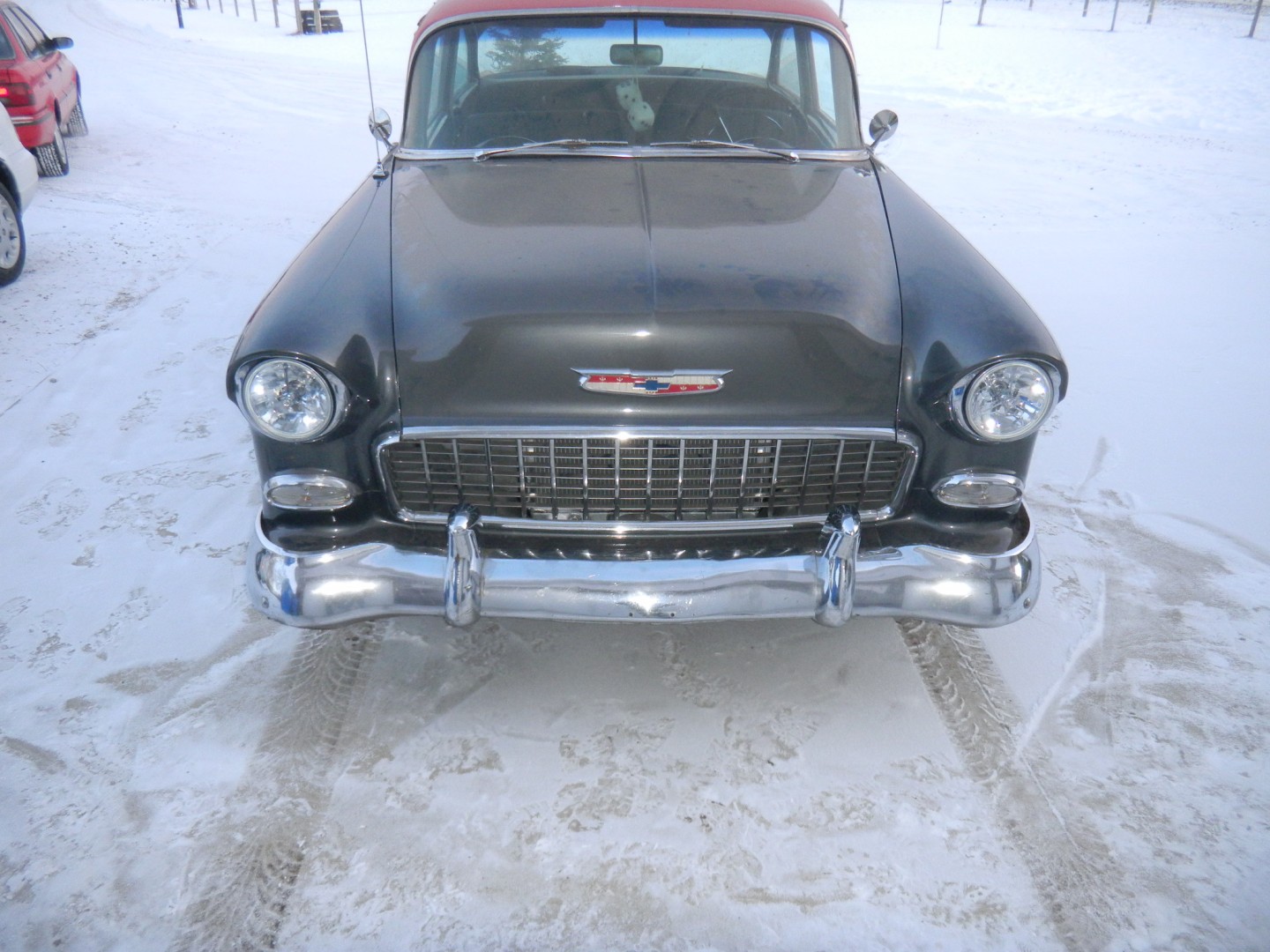

Made some progress this week. Got the front suspension back in with the disc brake kit. Power steering box rag joint and steering column all fitted. Last version 2.0 on motor break in again. Went much better no vacuum leaks and no oil leaks so far. Took out the break in valve springs and rocker arms and installed the final ones. Fired it up again to make sure all quite and still running ok.
Few more pictures of some progress. Motor and transmission are all bolted in. Now just working on getting everything hooked back up on the motor. Had to order a flexible dipstick tube as there is no room behind the engine for it to come up, should be here by end of the week.
Quite the ordeal for starting out to just repair the rear axle so he could get it home...

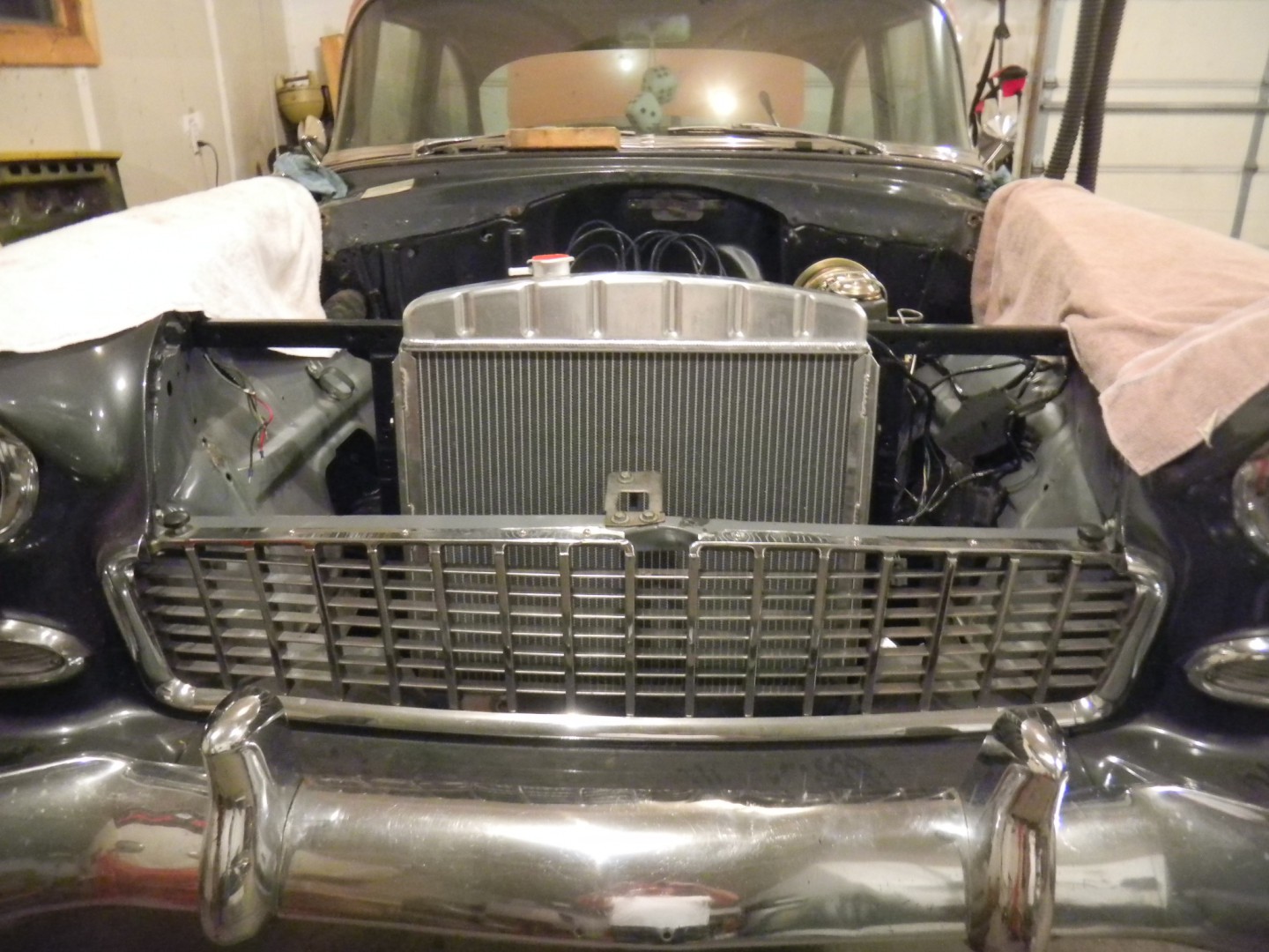

May 14, 2013
Dug it out of moth balls this weekend. Installed a front sway bar on it and is headed to the alignment shop Wednesday. Hope to put some miles on it this weekend and work out any last bugs it might have.
May 14, 2013

Got it fired up and everything is good with the motor, cooling system, and all the rewiring I did. Now its time to go back to the brakes and figure out why the pedal feels like crap. First I need to warranty the proportioning valve as it is leaking. Hopeing that is the main cause but will have to see. Camera battery is dead still working on new pics.
Finally got the pic's. Dash now has a radio and the factory trim across the middle. Mounted the Electric coolant fan controller in the glove box. Picture of the cooling fan mounted to the radiator and an over all engine shot. Relocated the battery up against the radiator support. Makes the firewall look much cleaner.
Looks great, Chris. He should be very happy...
It moved under it's own power today from the garage to the shed.
Chris, does that mean your Chevelle is moving into the heated garage for some work?
I would have found it difficult to not go for a quick spin down the street. So, did ya!
Stan, I have some other things I need to catch up on before the chevelle makes it's way up to the garage. Wife has some honey do list things I have been putting off.
Kevin, it was very tempting to go drive it but we had a light snow dusting yesterday so the roads were not dry. Plus the alignment is way off now because of the new spindles. First thing come spring load it on the trailer and take it to the alignment shop.
