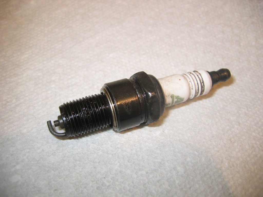

Here are some photo's.
Guess I misspoke a little, the tip of the plug looks like it is not burning clean. Would you suspect a oil seal or oil ring. It hard to see the oil leaking down the edge of the inside of the inspection cover; but it is there.

I agree with Mitch, oil on the outside of the plug is coming from outside the engine. If it was coming from inside the cylinder, it would never make it past the threads to get to the outside (hex portion) of the sparkplug.
The black tip on the plug could also indicate that cylinder is running a little rich.
Usually a bad or worn valve seal will blow blue smoke out the tailpipe upon startup. Bad rings will blow blue smoke out the tailpipe all the time or on hard excelleration. Then again, if it's only one bad seal, you might not notice any blue smoke.
I guess we will have to wait and see, I am usually wrong. I installed a new plug and washer and now there does not seem to be anything coming out of the plug area. I have driven the car twice,about 10 miles each. Can't see any oil anywhere on the engine. I have the valve that diverts the pass side exhaust under the carb to heat it up and send the exhaust out the drivers side. Haven't noticed any smoke.
Oil had pooled in the pocket of the spark plug and after I took the plug out, all the threads were wet. And oil/gas had weep-ed onto the bottom 1/3 of the hex part of the plug, the top 1/3 was dry. Don't see how oil could get there. No evidence of any oil coming from the rear of the intake where it mates to the head.
