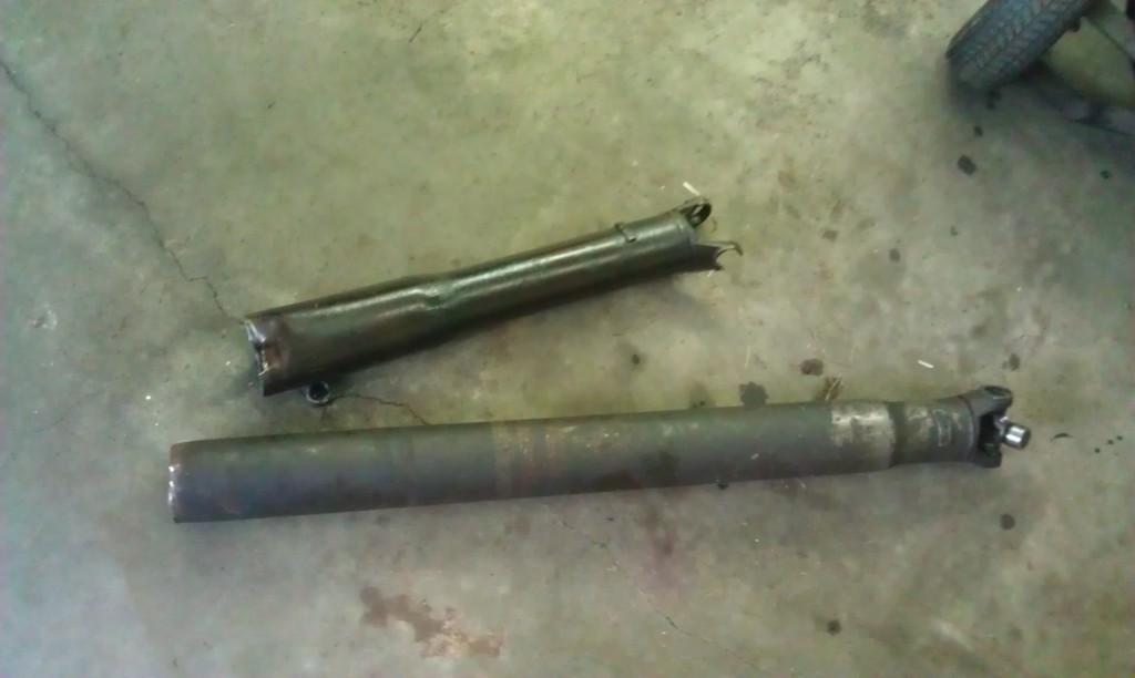

I have a loop on mine it is a cheap jegs one that I had to modify for the GVOD. I placed it 1/3 of TD back from GVOD output. Not sure of Seagrams72 power levels but if you are making a ton of torque and HP IMPO not sure if Catco is the place to go. May also want to consider upgrading your joints also. Not sure what size you are running. Looks like it broke at the tranny yoke.

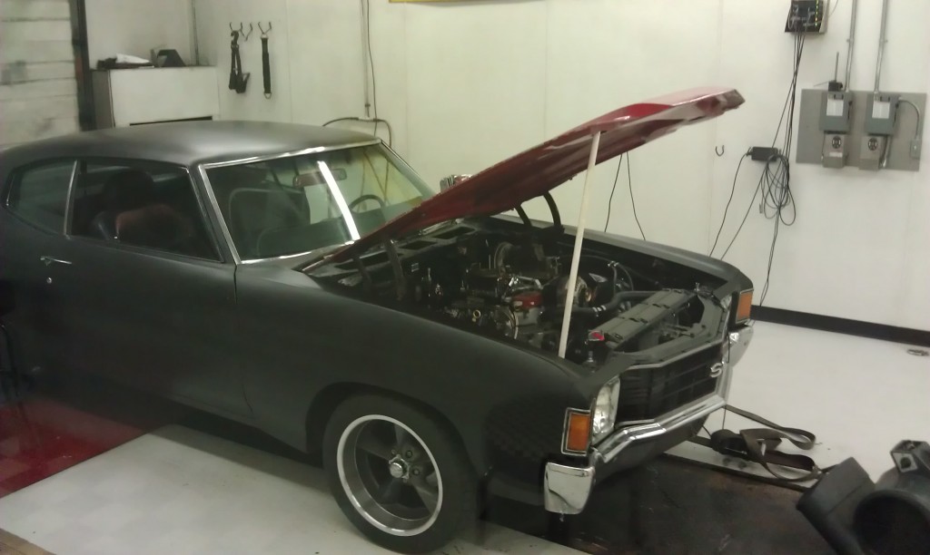

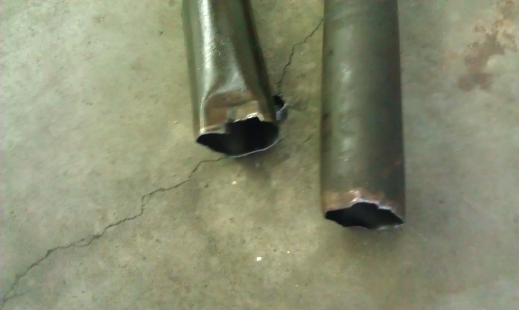

Tranny yoke is great, sheared part of the way through the shaft. We think the little tab broke on the driveshaft after the fact because the u-joint is fine. Yoke in the tranny is 100% A-OK, also the Carquest U-Joints look un harmed and useable (won't be thought!).
On the second run it got 380 tq and 373 hp @ 5200 at the tires and still had more tuning in to go. Shaft broke @ 5700-5800
