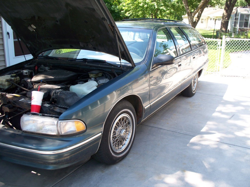

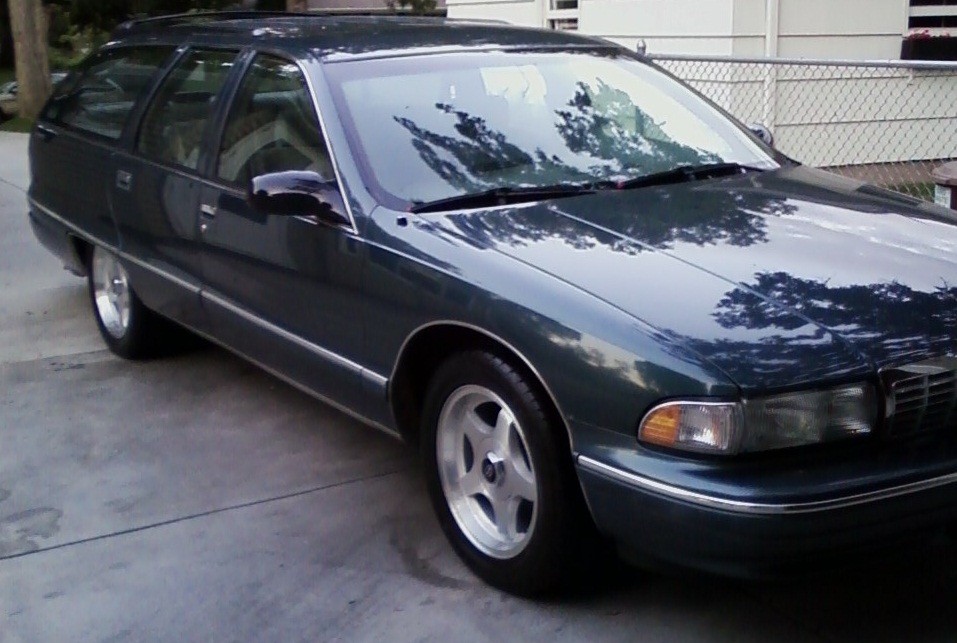

Picked up a new project/daily driver yesterday - the replacement for my F-150.
I really need something that'll carry 4 full-size people, the doggie, a lake-load of crap, and occasionally tow the boat... the truck would do all of this, but NOT the 4 adults.
I'm going to have to tease y'all for awhile, until I get some "after" pictures... but I'll go as far as saying it was an "Estate Sale" one-owner car, with 71,403 on the clock.
It's been sitting basically un-used for 2+ years, wasn't cosmetically maintained for long before that, so it really needs a TOTAL detailing job. I've got the hard surfaces of the interior done, and will be doing the carpets, seats, and soft stuff over the next few days. Then I'll attack the exterior and engine compartment.
Thanks again to Pushrod for helping me get it home, and doing his wizardry on the A/C system.

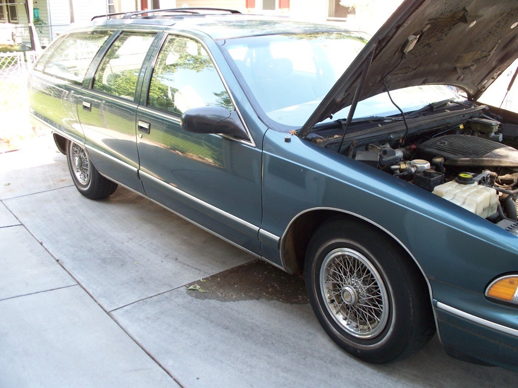

Derek gets a cookie, and Stan some crumbs... It's a '95 Caprice Wagon, LT1-4L60e, wood delete, gray/green metallic with gray cloth guts. No nasty body rot or rust, a few rock chips that'll need some work. The surprising thing is the rust damage on the front wheelhouses & core support... no where else! Not under the back end, floors, nothing - just under the hood.

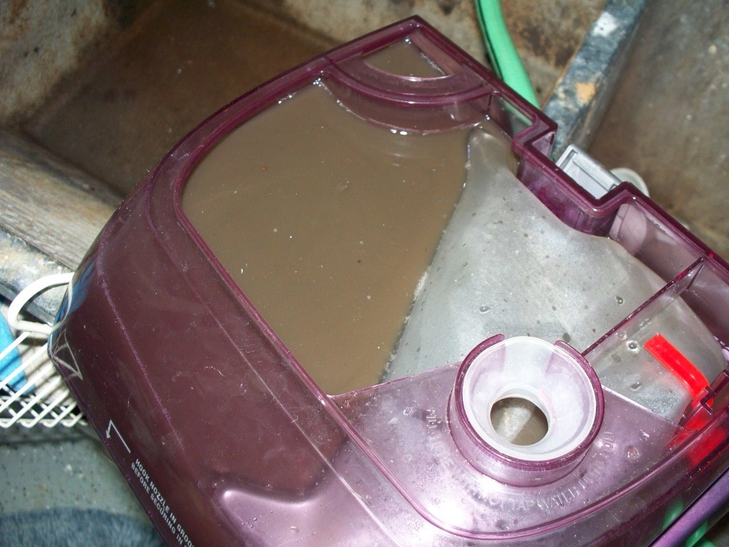

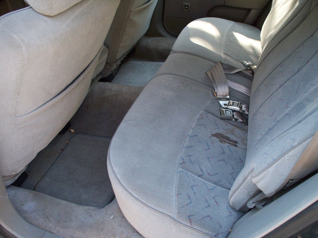

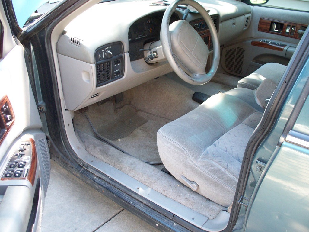

Spent the bulk of this and yesterday afternoon CLEANING... the dash, door panels, cargo area, seat upholstery, and carpets... We've got a Bissell carpet machine with the side-saddle hose & wand gizmo - it got a workout today. I used 4 or 5 tank fills of water & "juice". The stuff I dumped out of it beared no resemblance to water, more of a viscous mud/slime/slurry. (I'm seriously thinking this thing was left in a pine forest with the windows down. I sucked up about a pound of needles, and dug them out of every little crack and crevice inside & out.)
I'll get some more pictures up soon with the car CLEAN.

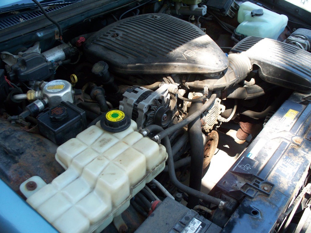

The inner fenders dont supprise me but I havent ever seen a core support rust like that before either.

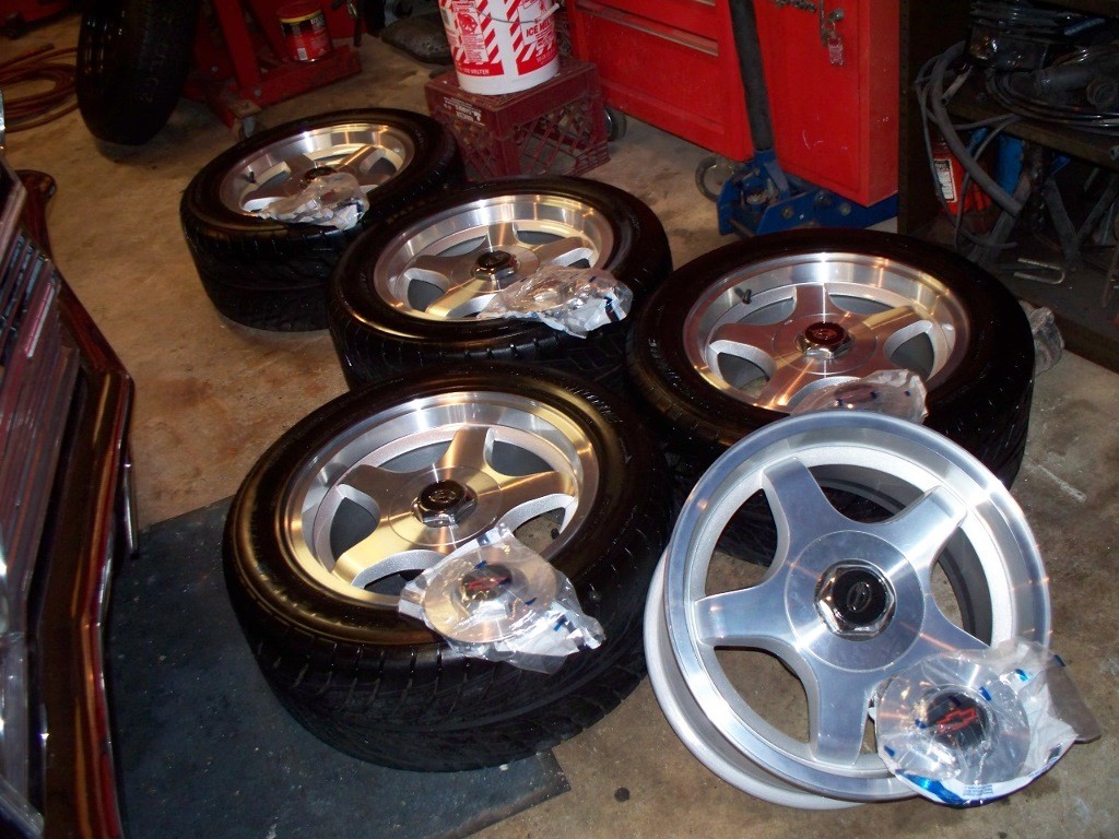

I seem to do well on Craigslist finding wheels & rubber...
5 genuine GM wheels, 5 Impala SS center caps, 5 Bowtie center caps, 20 lugnuts (correct for the alloys - GM), and 4 Bridgestone Potenza's. Plus a "never on the ground/still got nubbers" spare. There isn't a SCUFF on any of these wheels! Less than 1500 miles on them. )
(original owner had them on a Roadie wagon, and didn't want to use a weenie wheel if he got a flat on the rear. He researched and found a 235/70/15 tire & wheel "the same diameter as the alloys & Potenza's, "because I didn't want to burn out the posi...". Then he bought a 5th wheel-only "just in case one of them got curb rash, I could have the tire remounted on the spare rim while the scuffed rim was repaired" )
Now, which caps to run, the Impala's or the Bowties...
-- Edited by John D on Friday 1st of July 2011 09:55:03 PM
I vote Bowties.....they have more contrast...

Couldn't take it anymore, had to bolt on the SS wheels. The dang car was looking too nice to have the granny-wires on it! Glad I did it now, as it took some PB-Blaster and a sledge to knock the steel rear wheels off the axle hubs. (They'll have to come off again when I inspect the rear brakes and paint the drums anyways...)

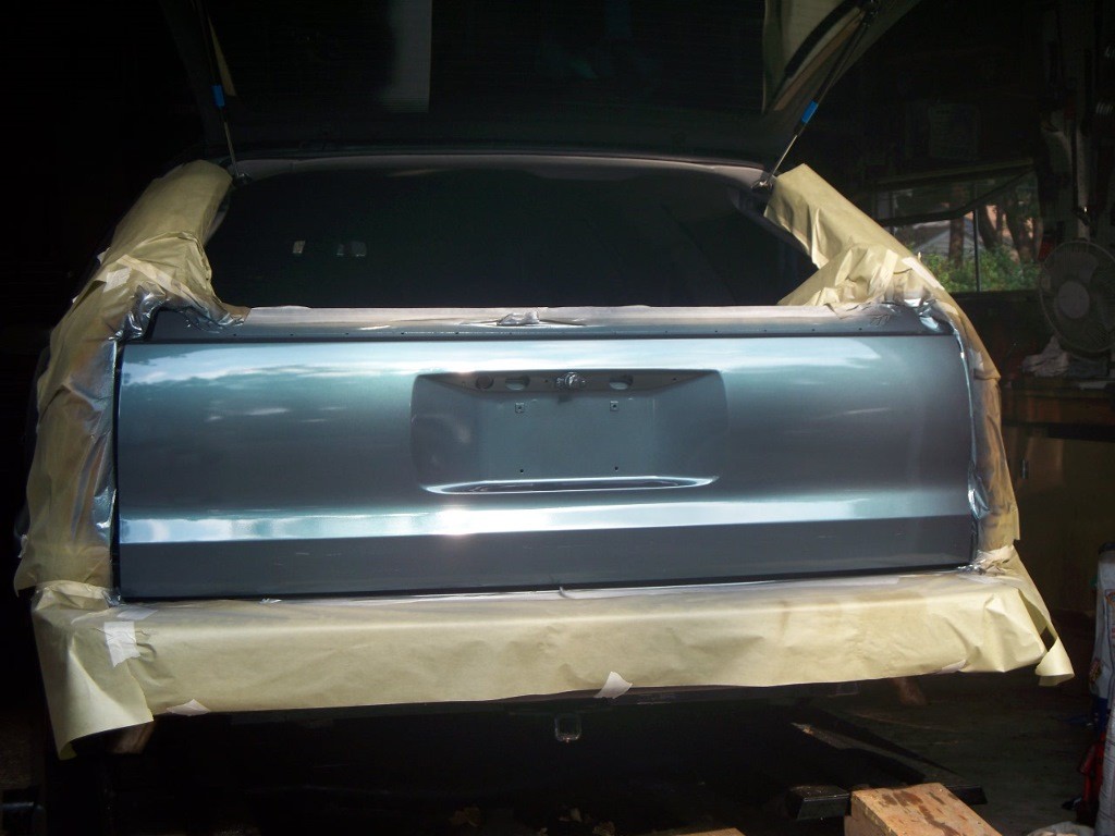

Yesterday's project was the tailgate. The license plate corners had rubbed through the paint causing some rust bubbles, and the emblems and moulding were loose (foam sticky tape had failed). When I pried the emblems all the way off, where the sticky tape didn't fail, it took the paint off. There were also some deep scratches and scuffs all over the gate... so it got re-shot.
Dupli-color no longer offers my color (in dauber or spray), and it would take a case of those little cans to shoot this tailgate. I found these guys on the 'net:
Took about a week to get the paint, clear, and some supplies. I'm very pleased - the spray cans have a great pattern - 4" fan, constant level of paint for the width of the fan, and when they're getting low, they don't sputter!
I watered down the garage floor & work area, then took the scratches out with 220 wet, then feathered those areas into the field with steps of 320, 400, then blocked the whole gate with 600 (wet). Two cans of color later (2 dry/fog coats, 2 slightly wet, and 2 wet final coats) got the new work covered, then 4 coats of clear. I'll give it a few weeks then a buffing.
You can do respectable work at home with spray cans, patience, and good materials!
Obviously, I wouldn't want to paint an entire wagon with rattle cans though!

The new paint should adhere but 600 is a little fine for finish sanding. Generally 320-400 is better.
