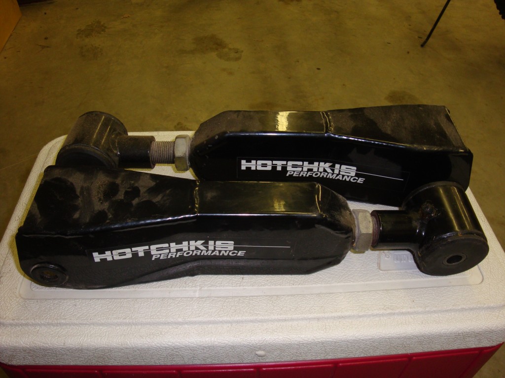

Still motivated I went after the 12bolt, everything went fairly smooth to get the 10 bolt out, then put the 12 bolt into position and started installing the control arms, lower first, then on too the adjustable uppers (Hotchkis, set I bought from Scott P.) and found out that the upper adjustables are too long, even adjusted to their shortest length? No fault but my own, I believe Derrick warned they may not work, but thinking they were adjustable, thought I would be OK. It looks like I will be ordering a set of uppers, so may be later this week before I am able to take it for a spin. I got it all ready for the uppers when they arrive, transferred brakes, etc.

I know the uppers on the 65-67 are longer than the 68 and up, maybe by about 2" . Were the ones you got from Scott for 65-67?
69SSConv said
May 29, 2011
They were in his wagon, so yes. I didn't realize there was that much of a difference? Oh well live and learn?
May 29, 2011
so what do you plan to do with them?

The upper adjustable Hotchkis arms are available if anyone's interested?
May 30, 2011
Do you have a price in mind?
69SSConv said
May 30, 2011
I am not sure, these are hardly used, I know the new ones are $340. I am not looking to make money on these, just come out Ok with the purchase of the new ones? Is $200 reasonable?
Upper arms are sold. Just waiting now for the new ones to arrive so I can get it back on its wheels and take it for a drive
Scott Parkhurst said
May 31, 2011
Sorry about that Loren...!
IOU a beer for the headache. I was sure they could be adjusted to fit.
