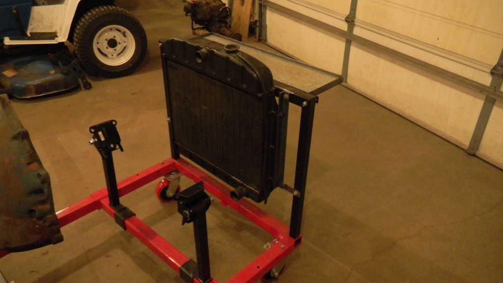

Ok so I finially started working on this thing to make it usable. I first replaced the casters with something that should actually roll with weight on it. Then I mounted the radiator with a little tool tray in front. But I have determined the distance between the bellhousing and the radiator is to short to mount a big block on it without it crashing into the radiator. I have it all in pieces now adding 8 inches to the overall length. But here are some pictures of the changes so far.
Probably too late to stop the buthery, but why not mount the radiator on the other side of the frame ??
I Looked at that thought but it would have required more work for mounting it. Second it is better protected from getting hit or damaged when moving it or other things around the garage.

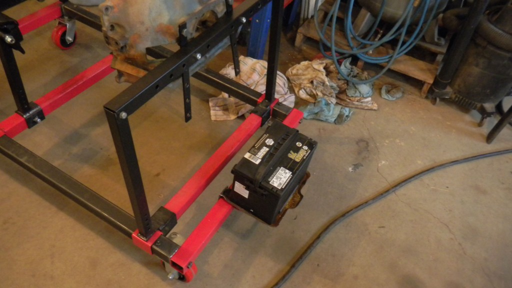

Made some more progress. Here it is with the 8" longer base and battery tray mounted off the back.

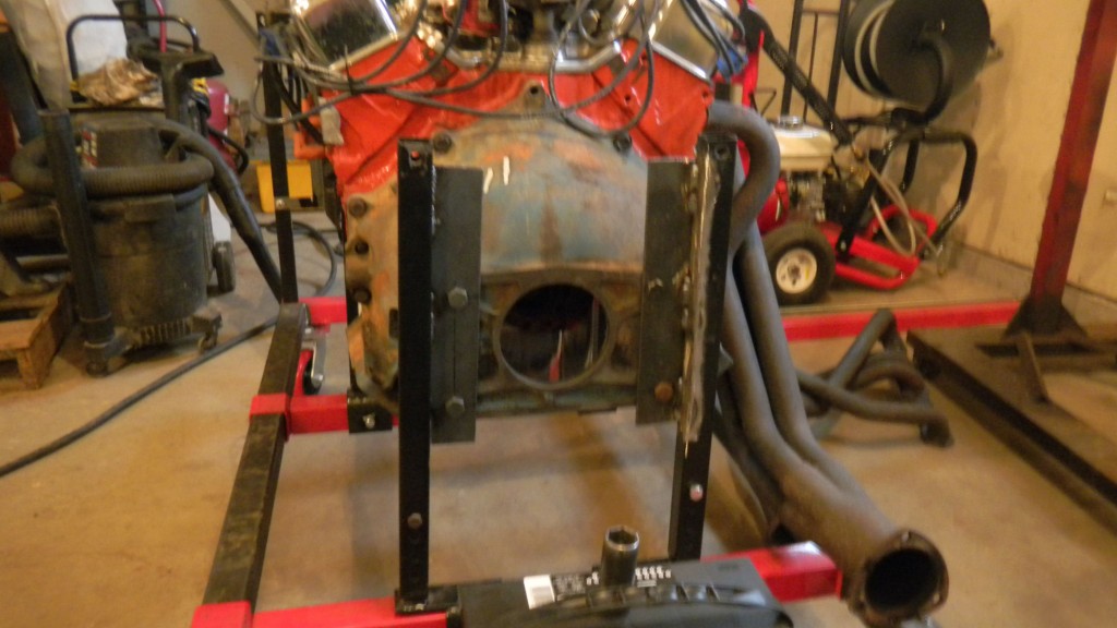

Installed an engine and wanted to see how header clearance would be with the way it came. Headers were close to hitting so I modified the rear mounting area, there should be no problems now with exhaust.

You are having way too much fun!
Looks pretty cool, Chris. It should work nice !!
