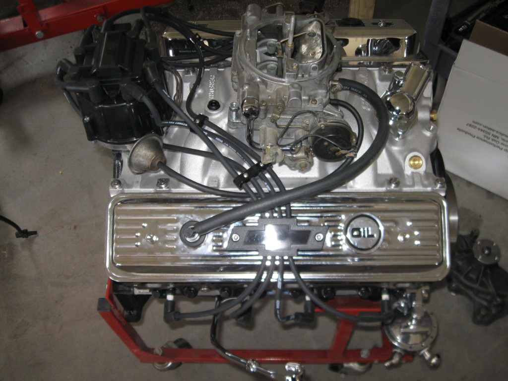

Tomorrow I am taking the engine for my father/son project to Wheeler's to have it dyno'd. Hoping it will put out at least 300hp.
It is 1980 vintage 350 block bored .030, built with:
Speed Pro Hypereutectic Pistons w/.180 Dish (to keep compression down for 87 oct, should be 8.75-9:00:1)
Vortec Heads (thank you Bryan)
Edelbrock Performer Intake
Lunati Cam & Lifter kit - 60101K 213/219, .454/.468
Comp roller tip rockers, & guide plates
Balanced assembly
Edelbrock 600 cfm carb.
Do you think I will get to 300hp?
