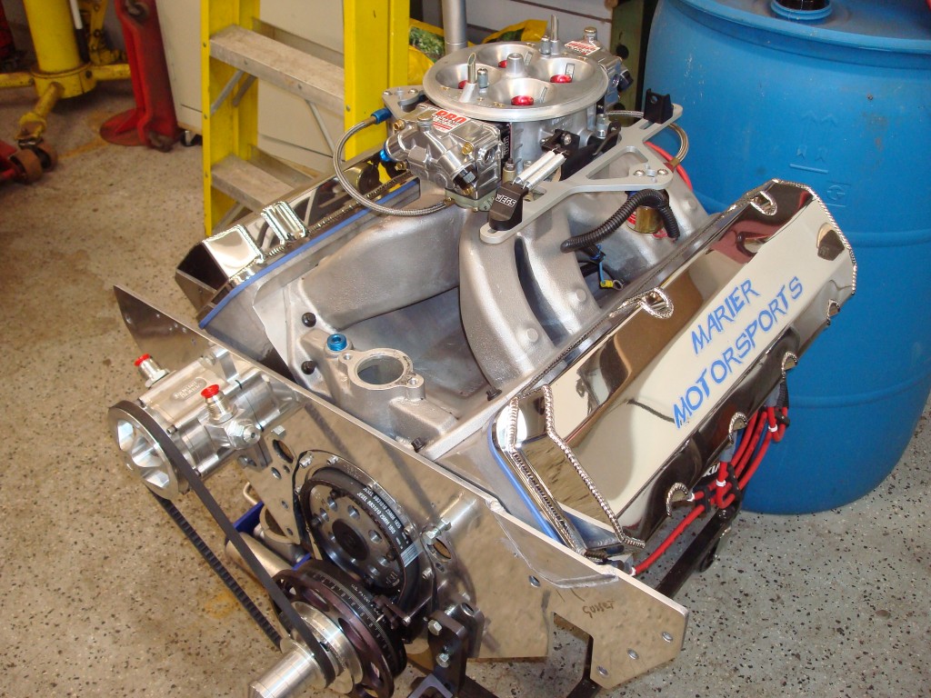

Whoa! How many cubes?
Apr 6, 2011
The valve covers are just stickers he had made and stuck on to them.
The motor is 565 cubic inches,.

That's pretty killer! Gotta be high compression, yes?

Yea it is 14:1 compression.

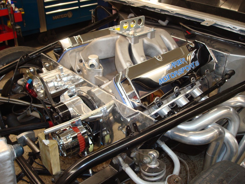

Heres what I did on mothers day, Installed engine and headers to mock up before it go's to fabicator, Putting vac pump on this engine and not much room in there, Had to reverse alternaor to fit, Need to make some brackets. Bought 10 gallons of C16 for $16.00 a gallon, Not cheap.
