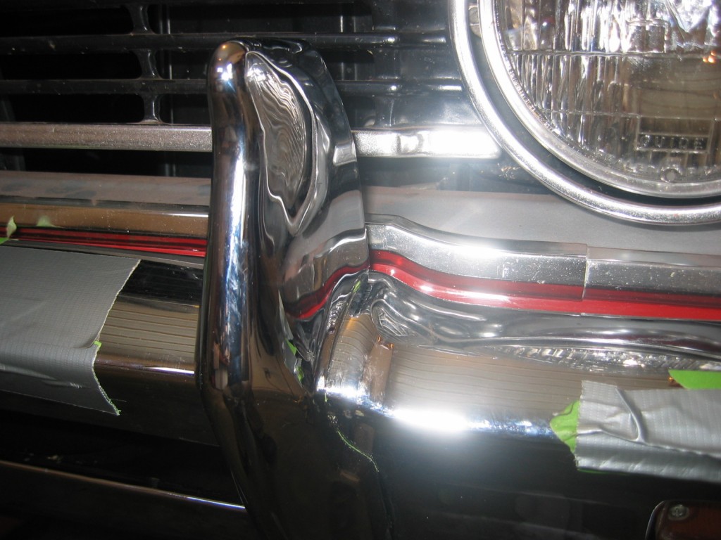

Trying to install bumper guards on my 66. Not sure how these are suppose to fit when done. I have tried to install the lower bolt first and then draw them up using the upper attachment hardware. I have not be able to do it with the 7/16"" lower bolt; but was able to get it in place with a lower 3/8" bolt and hoping over time I might be able to get the original lower bolt hole in. Probably the only way I could get the lower bolt in is to set a bottle jack at an angle and push the lower part of the guard in so the holes line up What do you think?
I could possible get the bottom bolt in and drawn the top into place; but it is so tight I am worried about damage to the bumper.

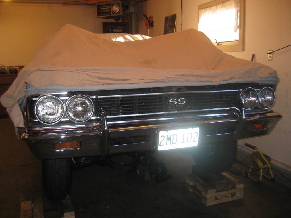

Dan call me last night with a great suggestion as this is what he had to do to squeeze the bumpers to get them on. Thanks Dan Total time to remove yesterdays attempt and get them install and photo was 45 Minn.
Here are some photo's.
