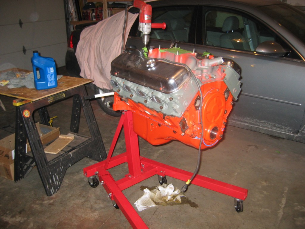

Finally turned the corner. With the help of Mitch, the engine is back together. Didn't have a plug for the oil adapter on the pressure sending fitting, so he left his tool.
New rear seal and oil pan gasket in. New double roller timing chain. Decided to reinstall the old Cam Dynamics cam (found lift was .544 and .544) Heads and intake back on and discovered a broken rocker. Now getting ready for paint.

Jim, it looks like you used the Felpro 1 piece gasket we discussed?
If so, did you use the trick little temporary thread in gasket holders or did you flip the engine over and not need them?
Your garage floor under the engine looks like mine... seems like that darn thing is dripping stuff weeks after it was pulled!
Jan 21, 2011
Flipped the engine since the heads and intake were off. Won't try to do that with those on again.
Yes we, (Mitch and I) used the little guides. The problems we found were 2.
1 The original bolts with the lock washer used to attach the pan to the timing cover were to short and we also had to use longer bolts and also at the very rear of the oil pan where the tabs are. We were able to make the other bolts in the tab areas work.
2. The bottom the the timing cover gasket and the part of the pan gasket that mates to the bottom of the timing cover did not mate up the best in the corners where the two timing cover/oil pan bolts connect.

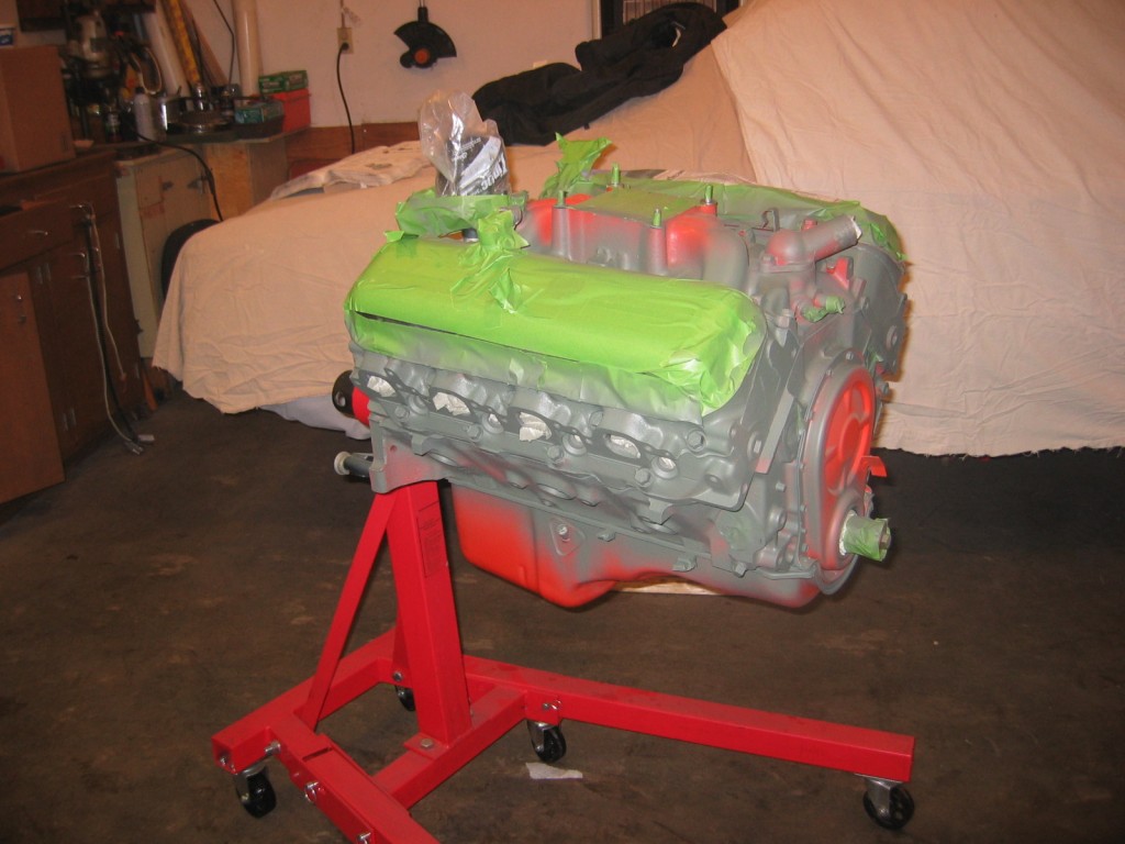

Now another dilemma, after I painted the oil pan, balancer, and timing cover, I discover that I used two different Dupli Color Oranges. One is called Chevy Orange and the other is called Chevy Red/Orange.
Just finish priming, so which is more correct the Chevy Orange or the Chevy Red/Orange? Not like you guys in the metro area, my only option is NAPA.
Thanks.

Though some research of various sites, it looks like Plasti-kote 200, then Duplicolor chevy orange (Not Red/orange), the VHT for correctness.
However VHT get the vote of durability.
