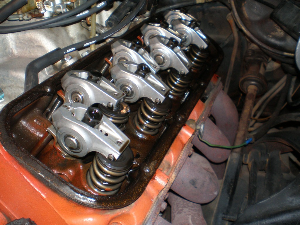

The 402 I'm working on has aluminum roller and roller tip rockers. I read in a How To book that for big blocks, roller rockers aren't really recommended because they don't allow as much oil flow to the pushrod.
I'm considering putting stock stamped rockers in for a few reasons:
1. Reliability and repair-
The stockers worked fine back in the day for 400 HP or more, so why have more complexity? If I do ever break down somewhere away from home, I can go to the corner O'Reilly's and pick up new parts.
2. I could go back to stock height valve covers
There are tall valve covers on it now that barely fit under the brake booster and AC box
3. I believe that the roller rockers only add 5 HP or so and at that on the high rpm end
I'm redoing this motor to be strong on the street but reliable. Not looking for a high rpm strip screamer. It would add about $150 to the budget, but again would be more about insurance/reliability and knowing what is in the engine than anything else.
Any thoughts one way or another?

I think they are more on the 'Proform' end of things. They do look a lot like some Crane rockers, but I'm not sure. Chris R. found a Crane pic that looks a lot like them. I attached the pic.
If they're Crane (or another "reputable" mfg.) they should have a part number or logo on them... If they're a knock-off ???

Those are a nice set of rockers. They looked exactly like the Crane ones. I thought Crane put thier logo on stuff like that but I guess not. If it were me, I would be more inclined to re-use them instead of going with stock, stamped ones. You already have performance parts on your engine. If it were just plain stock, I would then consider the stock arms.
I would be more curious if your engine builder recognizes the rockers and can tell you if they are indeed Crane units or a wanabe look alike from China.

Yes stock ones are probably the better choice for your app. Plus they are stamped steel no fatigue or cracking issue take up less area then Aluminm.
The ones you have pictured look pretty serious (all roller). The ones I have on the Vetter are roller tip only no roller not the fulcrum and are alos steel Fit under stock covers. Given your RPM and Hydrolic cam with a relativly mild ramp, mild lift the stock ones will work reliabley well.

Those rockers you have arent roller tip. Those are full roller rockers. You can always try them both and if you dont like one set. You can switch to the other. I still like the idea of using the full rockers. Although, I forgot about this little detail. If you have short valve covers, the rollers will not fit underneath.
