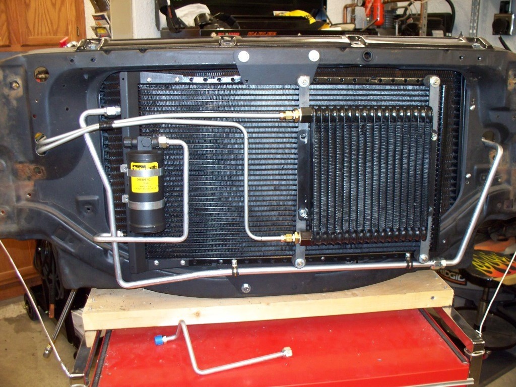

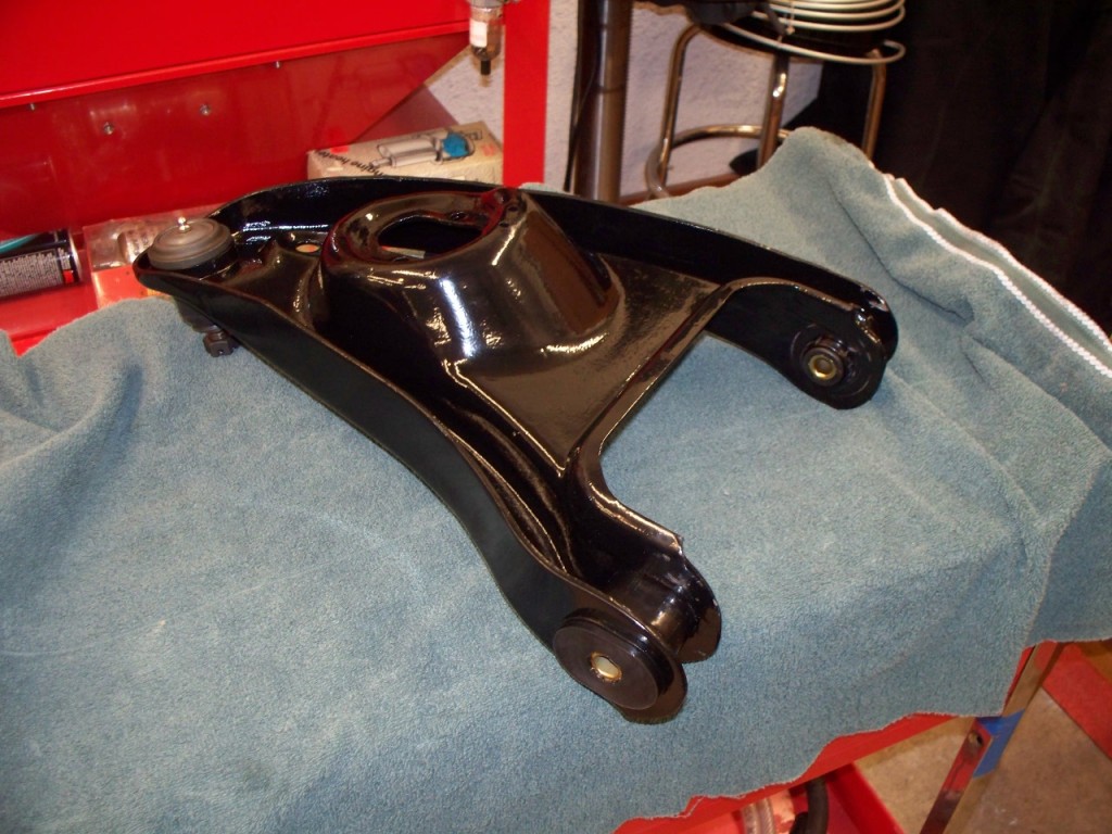

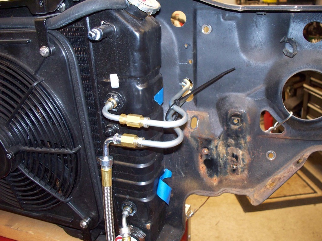

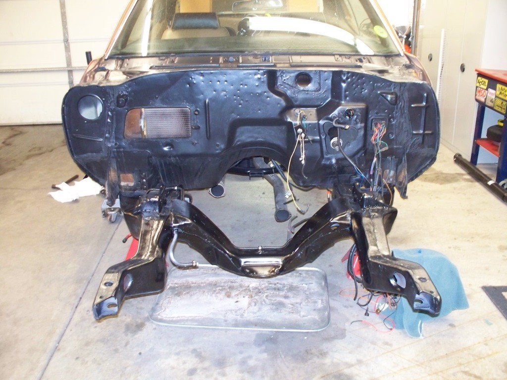

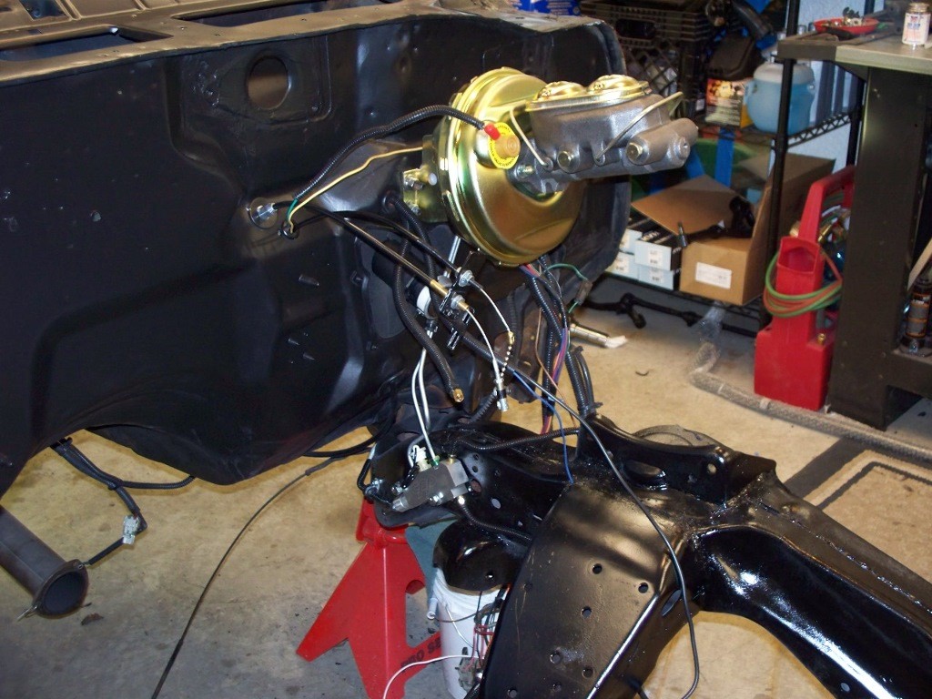

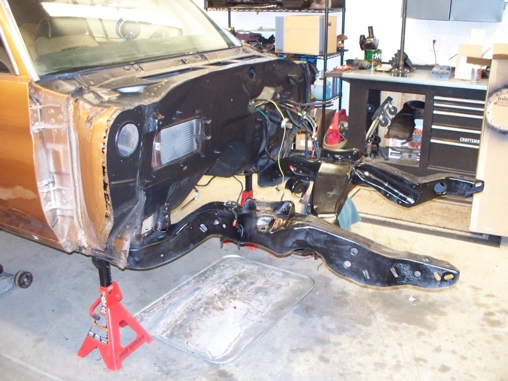

Just thought i would post some pics from from the project on Saturday with John D's help
How much did that worklight from Cornwell cost you Craig. I have been looking for one of those longer worklights for the hutch on my tool box. See them all the time for over 100 bucks, I just dont feel like paying that much.
Nice work on bending those lines. My only concern would be those coolers you have in front of the radiator. That oil cooler and trans cooler may reduce air flow through the radiator itself. Which its possible you may see a rise in temp when sitting in traffic.

Where did the fenders and hood go Batman? No more two feet on the brake peddle, passengers are going to need seat belts now.
When is the ENGINE going back in? Counter is below 100.

NOW you look like part of the hard core club....
I'm somewhat familiar with that bare frame and firewall look.

Chris R wrote:Nice work on bending those lines. My only concern would be those coolers you have in front of the radiator. That oil cooler and trans cooler may reduce air flow through the radiator itself. Which its possible you may see a rise in temp when sitting in traffic.
Those electric fans will take care of that...

That tranny cooler looks suspiciously like an oil cooler that john bought for his car that did not work??
Feb 9, 2011
Good catch. I thought it looked different for a trans cooler but didn't put it together. Looks like it has been repaired and painted.

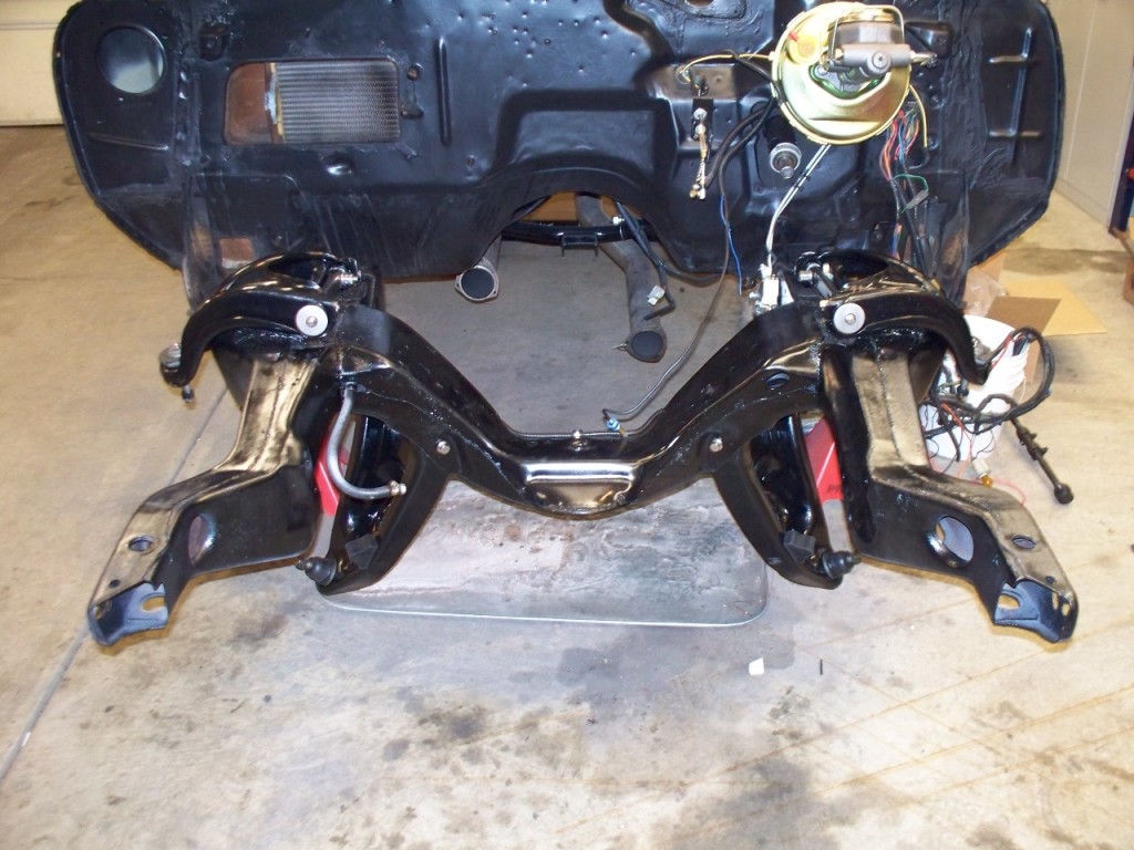

Craig, It is looking very very nice. HOW HARD is it to just take the grill & rad support only off like you have in your 1st and 2nd pic of front clip and leave the rest on. Your motor looks BN already :)
Looks like you put discs in back

Thanks guys, the trans cooler is new I bought it at Car Craft, from universal they call it a "fluid cooler" there is a small fan and shroud that I may use. BTW the trans cooler lines are John Ds workmanship, I wish I could take credit for them they turned out AWESOME!! Thanks again Johnnie. As far as rad support goes, very easy, just be extra careful when leaving the hood on, its possible to fold up fenders with the weight of the hood. bumper comes off first that was the worst part, those bolts dont want to come off But with careful heat and the impact they finally came out or snapped. From that point easy. Also by following the GM assembly manual just in reverse. John and I got alot of work done that day....... hey theres no pics of John with a cold one.....very suspicious, who took all those pics anyway?

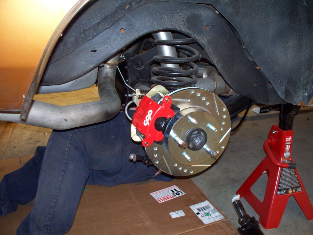

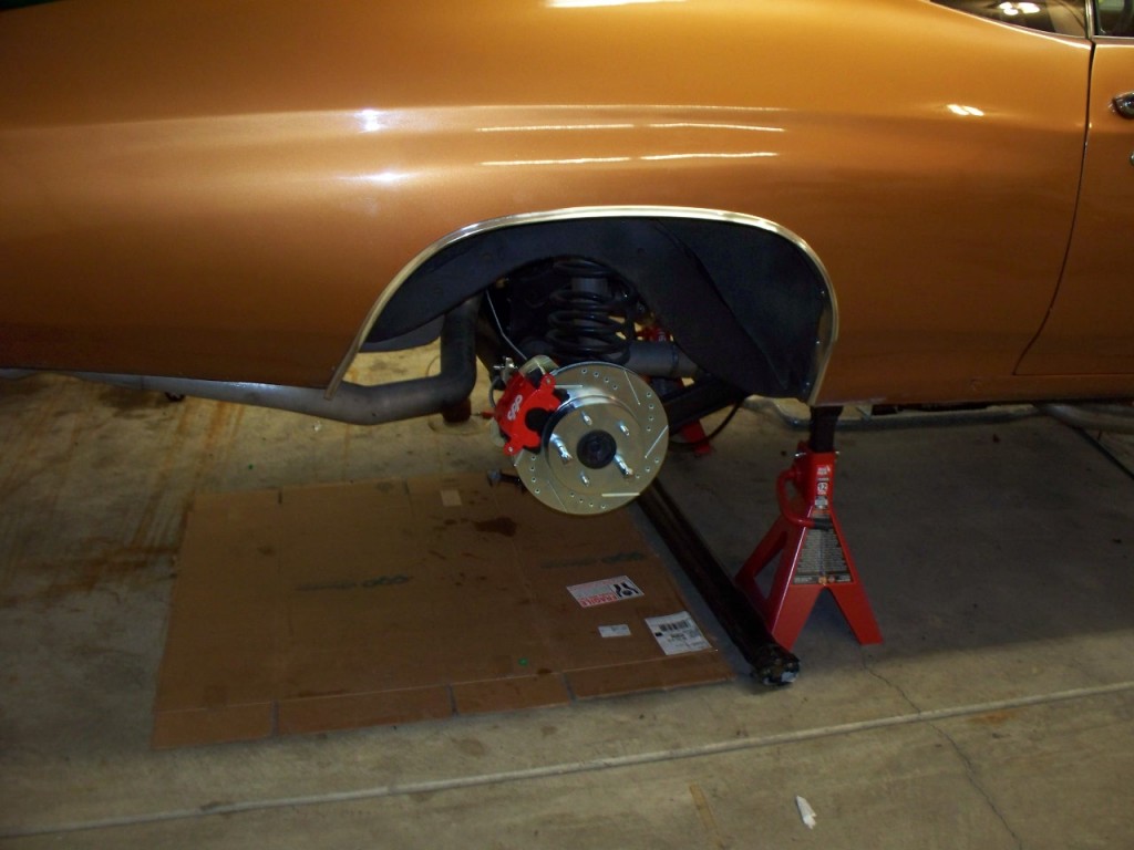

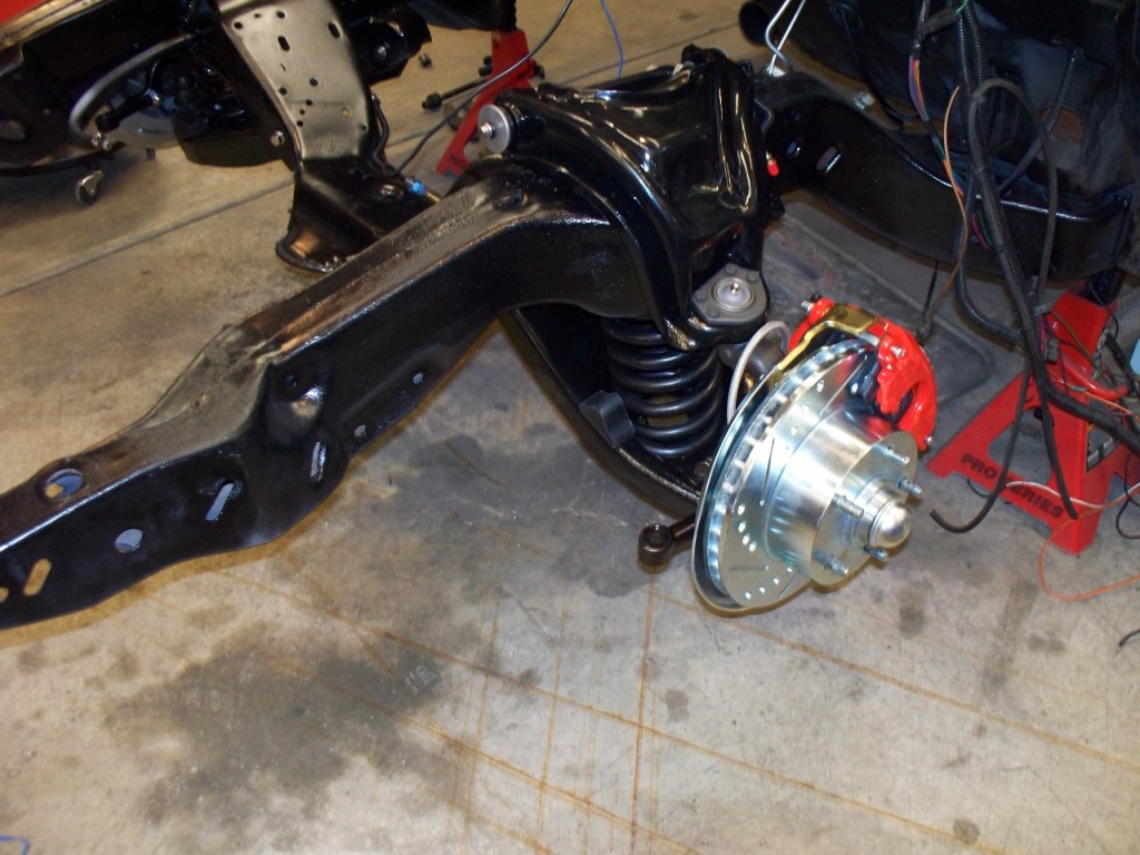

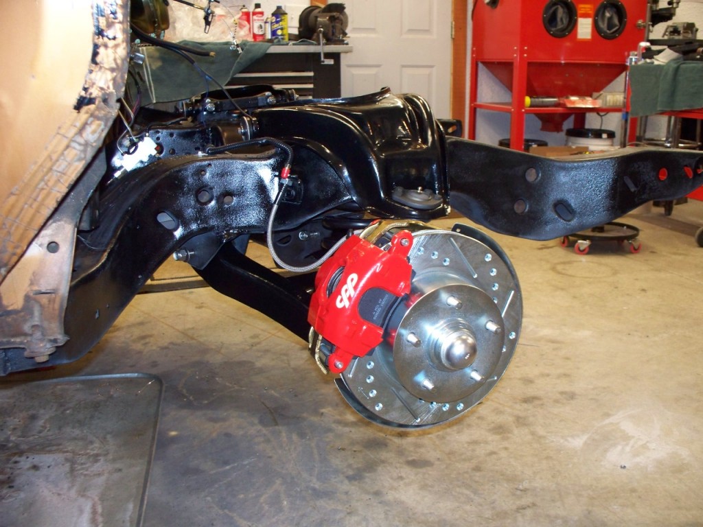

Some more pics after yet another Saturday's thrashing on the car. John D came over again, and after some "creative" engineering with a ball-joint press, the new PST polygraphite bushings were pressed into the freshly blasted & powdercoated A-arms, then the new ball joints, and new stainless fasteners. We'll leave it up to you to figure out how we got the front springs installed without the engine installed... New spindles and disc brakes are DONE , and the system filled and bled. Unfortunately there is ONE *&^$#%$^$# leak ! The connection from the "Tee" on the axle housing to the LR hard line weeps a bit.
I had a real challenge trying to get the springs installed without the motor in as well. What I did is pulled my truck up close and ran a chain from the front of each frame rail to my tow hooks on my Silverado and used the weight of the truck.
Won't find that in any books I am sure, but it worked for me.

Looking really nice !! On the leak, I've found that new double flares sometimes need to be tightened really hard with a line wrench to fully collapse and seat the tube with a line wrench. If you've already done that, then the tube was cracked during the flaring process and needs to be re-flared/replaced. I've had new tubes with cracks in the past. I would also gently bend those axle lines back toward the housing and away from the tail pipes. It appears you may have enough extra tube to re-flare the right side if need be. I hand built and flared 3 lines on mine but haven't installed the master yet to see if they leak...
Feb 13, 2011
I just use springs that are short enough that they don't need to be compressed at all to get them in.

Craig, I like the brakes, was your car an orignal front disc car ? I ask as I was curious what knid of upgrades were availiable for original front disc cars. It is looking real real nice.

Sometimes you have to tighten, loosen, tighten and loosen a fitting a few times to really get it to seal.
Feb 15, 2011
Yup, we tried the loosen/tighten drill a few times... I think Mitch might be on to something with a cracked line/flare. This was late in the day and didn't want to deal with it at the moment.

I've created that problem myself by being overzealous with the second step of the double flaring process. I've tightened the flare tip of the tool too much and crushed the tube to the point of cracking at the tight bend. I've learned to moderate that pressure and let the nut finish the job on the fitting.

The problem Ive had was I was using a cheap Chinese double flair tool, solved that buy purchasing a relatively inexpensive one made in the good old U.S.A. As far as the weeping fitting, I thought Id call CPP they sent out a new one no questions asked I think I will keep practicing with scrap tube. Hey, I finally figured out how to use those emoticons, computers are not my fortePeace out!!!!!!

Yeah, it's funny... Two saturdays ago when I bent & flared the trans cooler lines I was using my Dads inverted double flare kit - Imperial Brass Manufacturing, Chicago IL - that he bought new in about 1947 .

Wait until you try flaring stainless steel.
Feb 16, 2011
I was thinking last night that if the leaking line is stainless, that a crack is very likely. Since they are sending a new one, it should resolve the issue.
