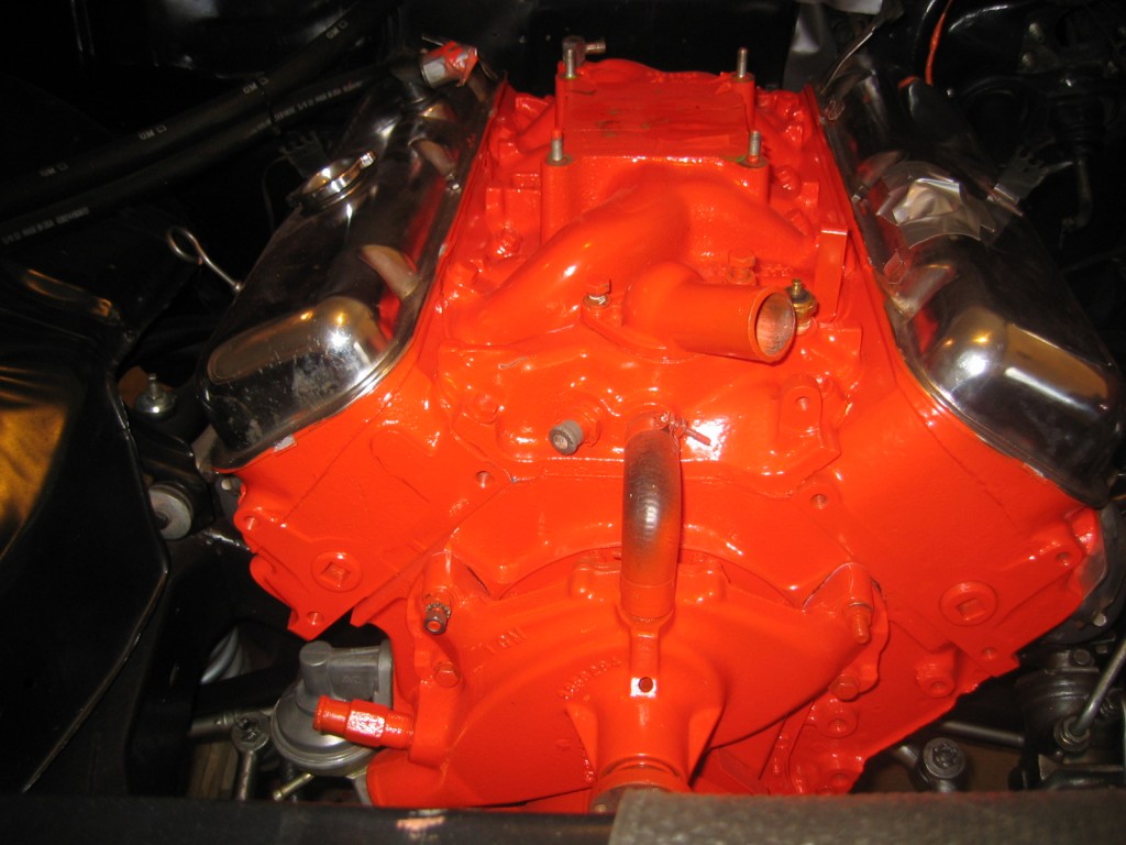

Well, I deceided to go ahead and fix all the leaks and do a general housecleaning. Along with pulling the heads to determine static and dynamic CR. Here are the first photo's

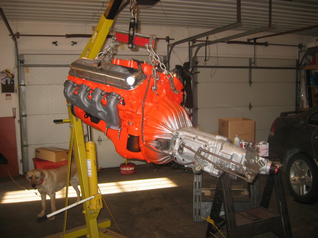

Thanks for the tip Chris. I pull the transmission before I took the engine out. No problem with removing the engine. If I wee to install the transmission on the bellhousing before I put the engine back in, would I have enought room? Or would I half to take the radiator support out?
Dec 27, 2010
If you can rent/buy an equailizer like this, you can tilt the whole assembly to get the trans under the firewall and then start lowering/leveling it off and install as a unit. This is a TH400/396 going in my 70 with room to spare.

Got the engine in Today. You always learn a few things. Would not go in with the shifter linkage, so had to take that off. Then not a steep enough angle, should have adjusted the leveler so that the two front chains were a little shorter than the back two chains, so I could have got it at a steeper angle. Just barely got it in, then the studs for attaching the exhaust manifold to the head pipe, that I had not removed, got in the way. Well with a little patience, engine mounts are torqued, the exhaust system is hooked up, shifter linkage installed, and crossmember installed.
All that is left is to reinstall the radiator, ps pump, alternator, fan & clutch, driveshaft, carb, distributor and hook up the electrical stuff.

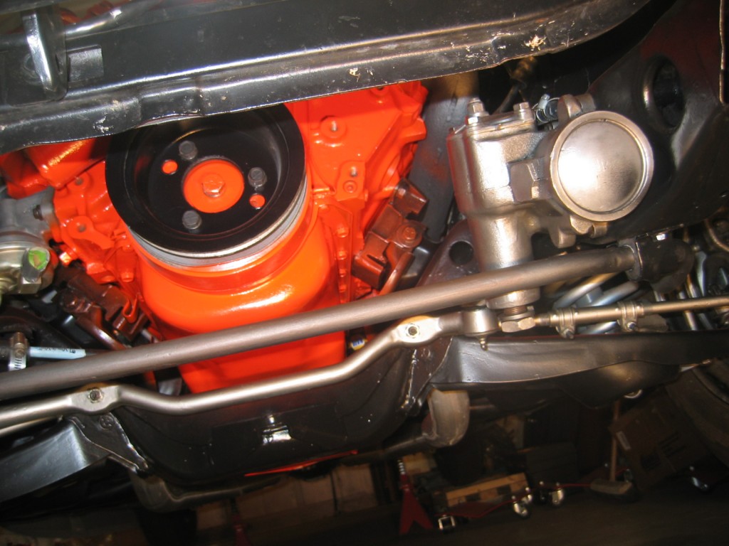

Well today I installed the drive-shaft, put the stabelizer and steering linkage back in that I had taken out to clean and recondition, and did a litle painting of remaining parts to go back in.
Well not much progress today. Messed up a little on trying to do some touch up on the front of the oil pan. So off with the tire rods and center link. Now I have to wait 7 days to touch of the orange on the bottom of the oil pan.
So started to install the speedometer cable. Guess I should have done this before putting in the engine. Had to remove the pass side exhaust and have my wife hole the cable in the correct position in order to get the grommet installed.
Then I attempted to hook up the two wires to the solenoid. Thought I could get the clip that holds the 2 wires in place on the solenoid. No, had to looses up the starter in order to get it to snap over without hitting the block.
Coil went on without and problem. Then I thought I would installed the shifter handle and console. Well where did it put the handle?? An1 1/2 hours later I found it. I had put in a black plastic container the California duster came in. Stopped for the day.
