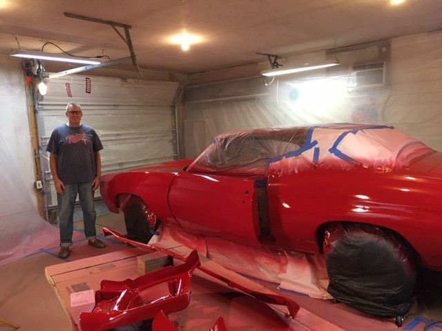

Sorry I missed the meeting and the run to Elmer's closing, but it has been several long days on the Chevelle, coinciding with perhaps the last few days in the 60's. The old yellow car is now red. Yes it is an amateur paint job, but a big improvement and starts my escape from the CAC
Wow! Looks great Bruce, pat yourself on the back you’ve completed a good part of the journey.. Can you identify the color red you used?
Oct 20, 2019
Oct 20, 2019
1971 Chevelle Crandberry Red, had it mixed to match the original color.
Oct 20, 2019
Thanks Mitch
Oct 21, 2019
That is awesome, gotta feel good to see it all in one color.
Oct 21, 2019
All one color, red, glossy, only thing that matters. You made GREAT time on project. Beyond happy for you! Now, every piece you install makes a huge difference.
If too perfect, it becomes a Garage/Trailer Queen, that was never your plan, I believe.
Congrats!!! Karl
Thanks Mitch
Congrats!!!
Awesome! Great to see such a big part of the project behind you now. :)
Nice job Bruce!
It will snowball the other way to completion now when you start putting the parts back on.
Karl's right, there's nothing wrong with a garage paint job and it's no fun driving something that's just super nice. You'll enjoy this more.
Congratulations Bruce! Looks great!
