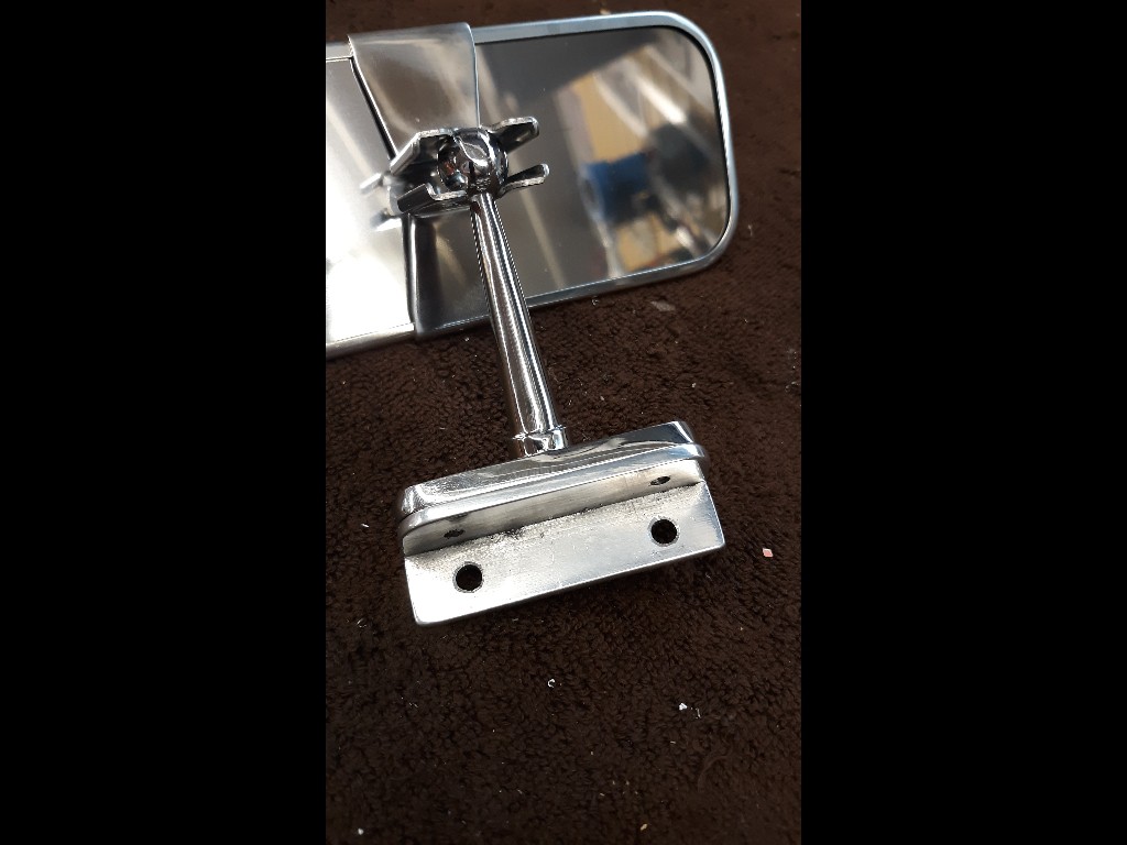

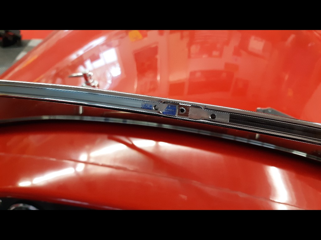

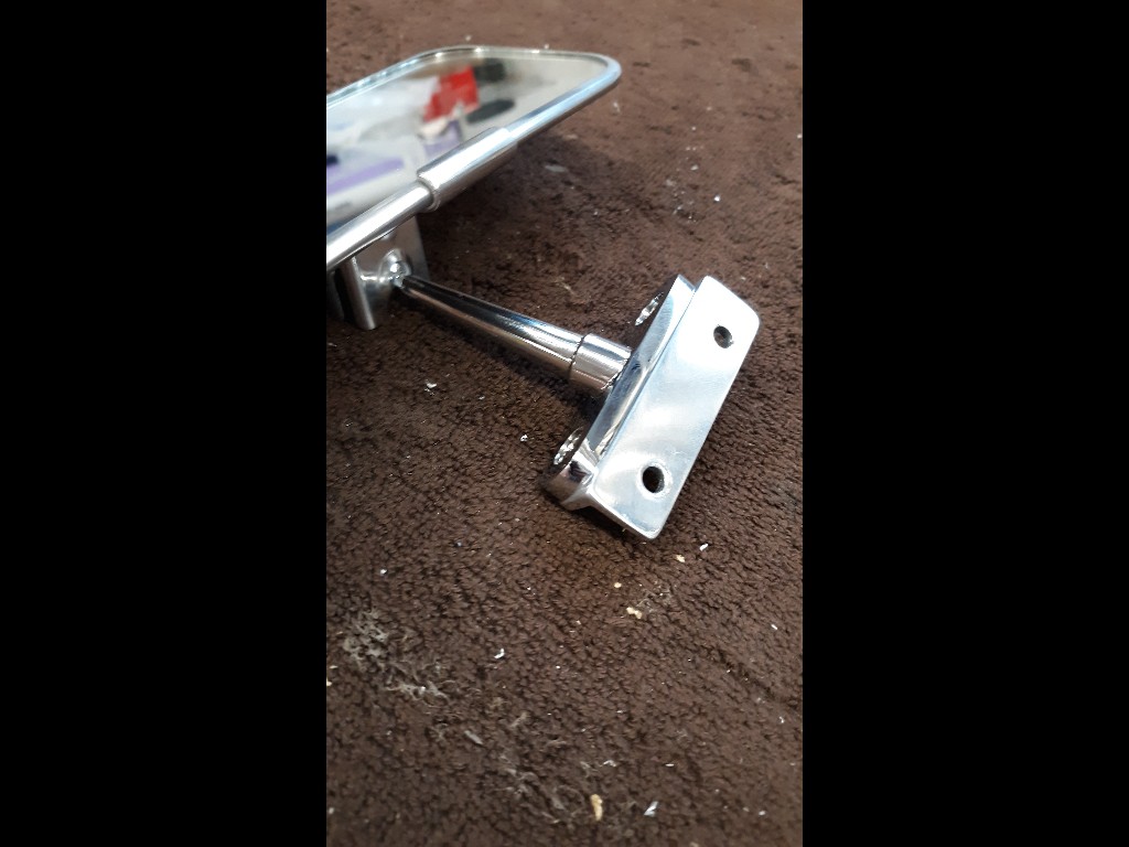

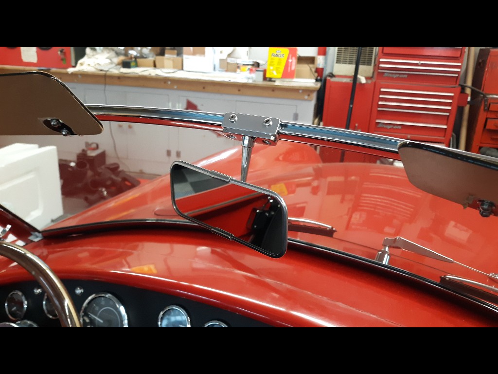

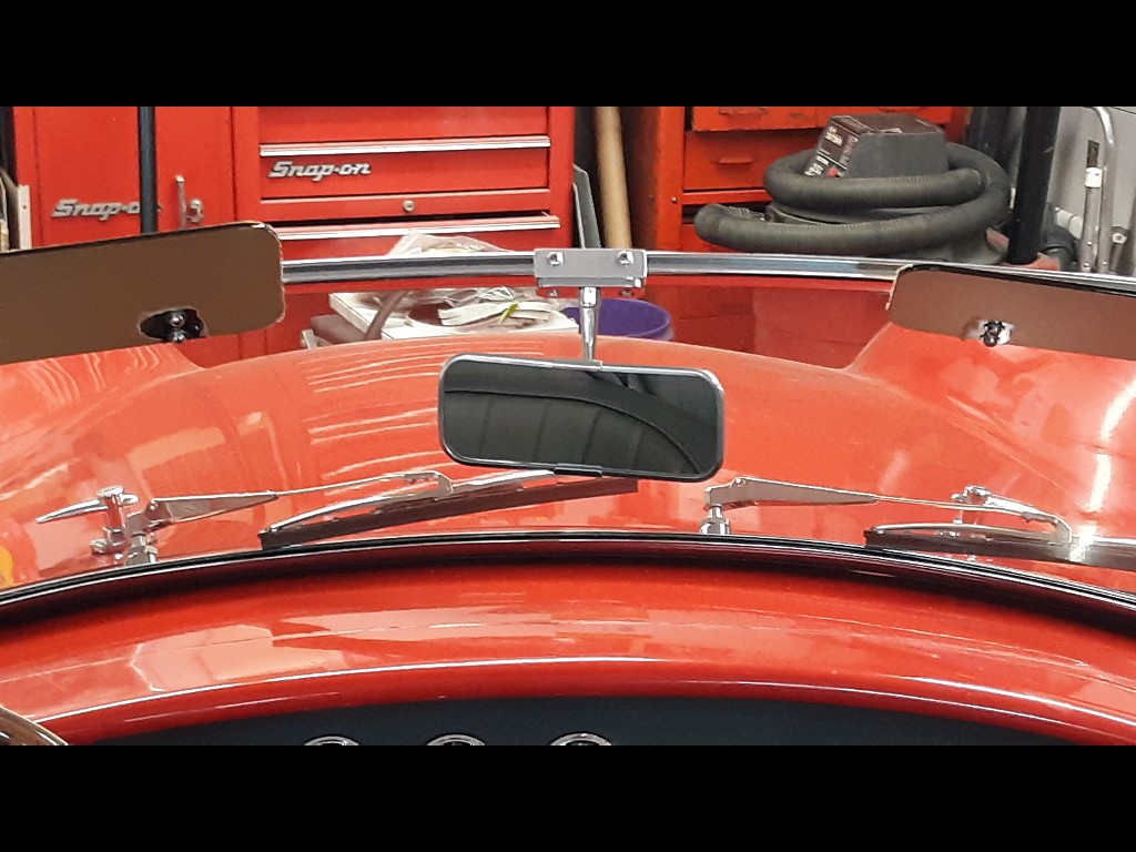

A few little tidbits got accomplished the last few days: Rear View Mirror Center Cap on the Wheel
I'm in a bit of a dilemma, as I've got my DMV inspection coming up, but I don't want to mount my mirror - there's NO WAY I can get it "centered" without the body & paintwork done, and I don't want to drill holes in the cowl that will need to be reworked/filled later. Solution: A piece of 1x1 aluminum angle was cut and trimmed down to fit the base of the mirror and the top of the windshield frame. A few holes drilled, some tapped, and a session on the rag-wheel with some polishing compound. The trimmed off pieces were filed down, and made into thread inserts that slid into the windshield frame
It might just stay on the windshield instead of the "correct" spot, centered on the dash cowling

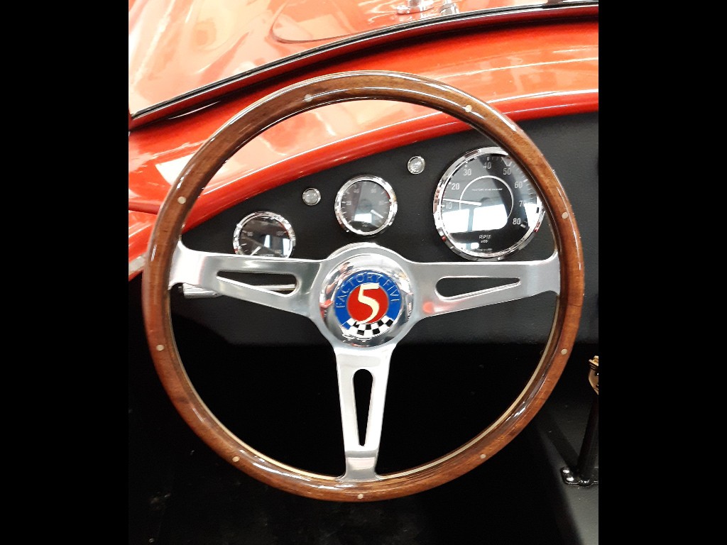

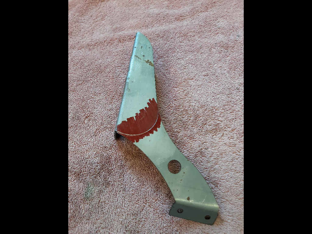

Another item off the list was the center cap for the steering wheel. A dry-fit revealed that the "in-concentricity" of the wheel to the hub wouldn't allow the insert to fit in. Also, the air-tight seal of the o-ring was a pain. I marked the areas of interference and sanded them down a bit, and drilled a 3/32" hole from the o-ring groove into the hub area void. The center cap now presses into place with effort, but can be removed without fighting pressure or vacuum.
I also got the "wind wings" and sunvisors mounted.
-- Edited by John D on Wednesday 29th of May 2019 06:03:41 AM
Mirror looks good up there and I think you will like the increased viewing area better too.

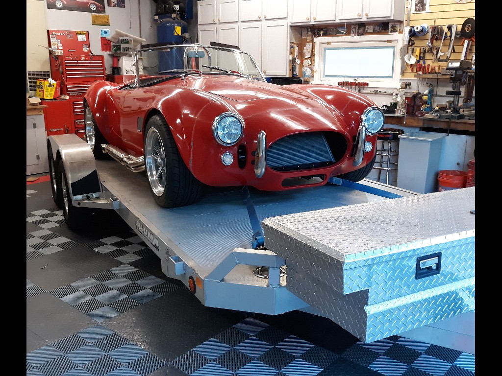

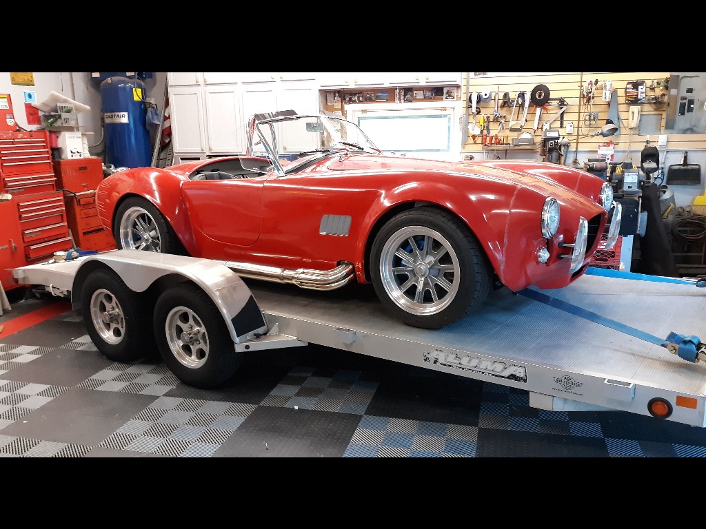

Got back from the cabin, and got #9365 loaded up for its DMV inspection tomorrow afternoon.
Sheryl & I got it on the trailer, strapped down, and backed into the 40 Watt, and we're not filing for divorce! I guess all that time at the boat ramp has paid off!

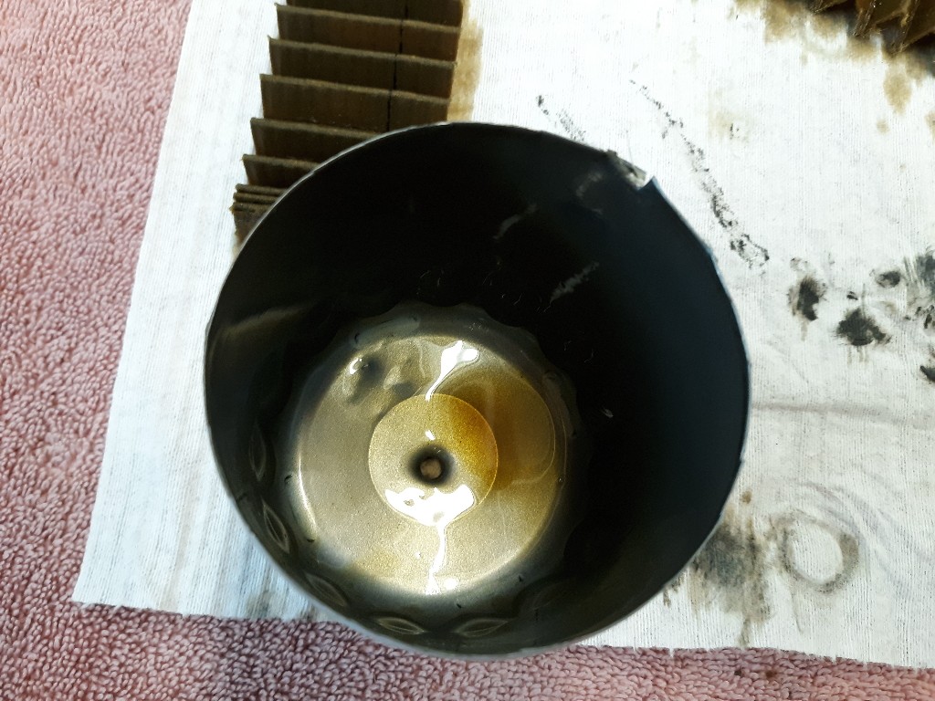

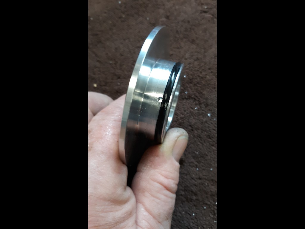

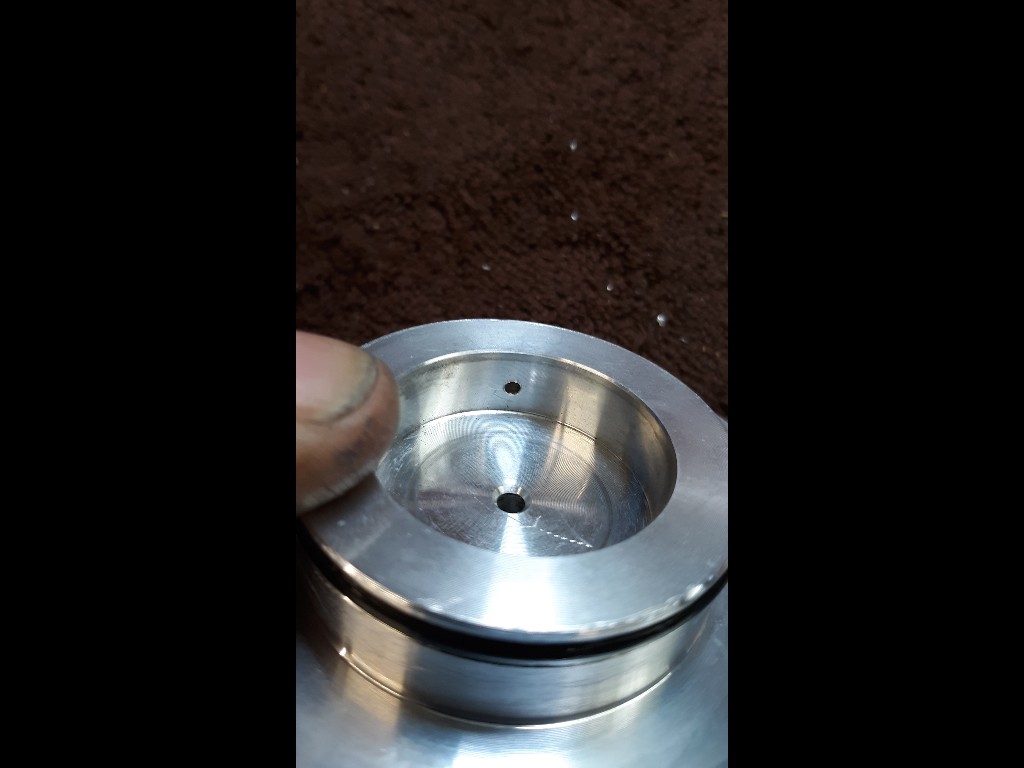

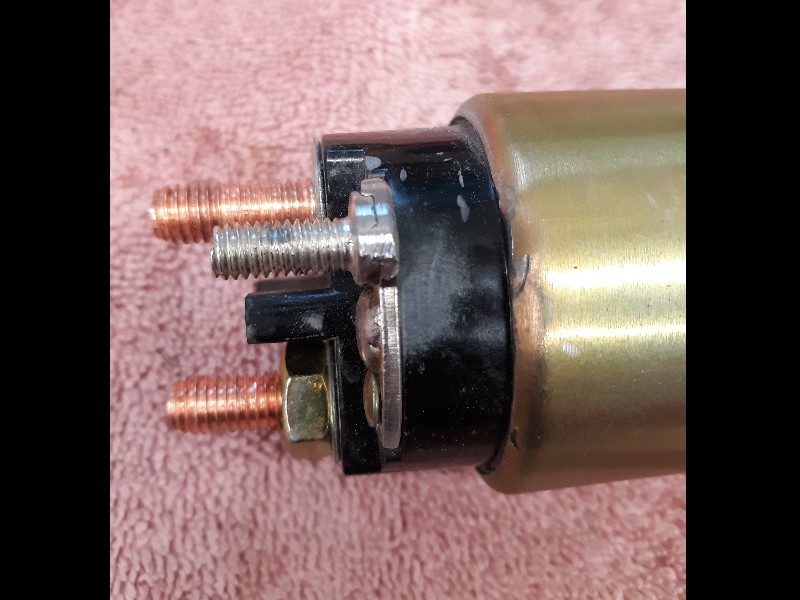

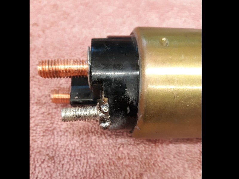

Roadster Update: I had to get under it to adjust the E-brake cables, so I decided to do its 1st oil change as well. It's nearing 1000 miles, and I wanted to get the original oil out with whatever new engine"crud" that may have washed loose. Everything looks great! There was just a tiny bit of black stuff on the magnetic tip of the plug, and zero "sparklies" in the filter. I poured the oil through a screen and over a magnet, and again nothing.

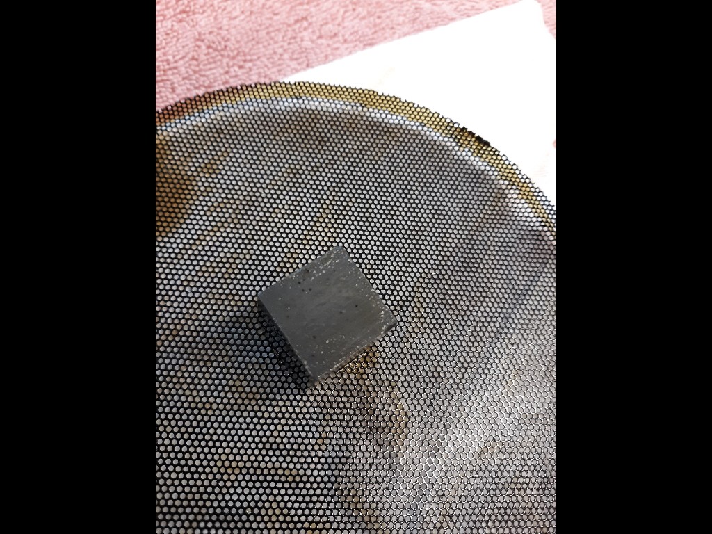

While underneath for the oil change, that little monkey nagging about the start issue kicked in...

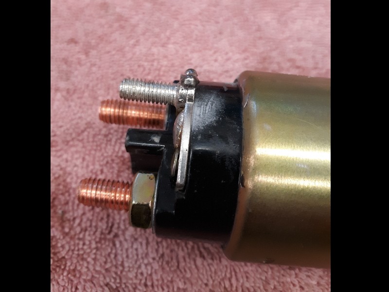

First... Removing the starter from a Roadster with a Coyote & FFR headers is a breeze! Basic tools to remove the electrical connections, and a 14mm on a 12" extension w/ a swivel and it's out in 10 minutes.
Backtrack... I'm guessing I inadvertently "fixed" my problem when I was poking around under the car. I tugged/pulled on the solenoid trigger wire, which "tightened" the post into it's bracket. The terminal was tight on the post, but the dang post wasn't tight in the bracket!
I'll guess again that the terminal post is a "D-shape", or maybe a "star" and its pressed into the bracket and staked in place. Mine wasn't tight, and my tugging on it bound it (by rotational friction) tight enough to maintain enough contact to work. Enter road vibrations & heat/expansion and it worked itself loose again.
Enter the MIG, two quicky zap/tacks, a minute with the Dremel, and I've got a post that'll never work loose again.

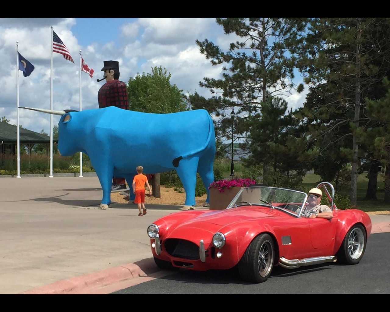

Saturday 7/27 was spent touring north-central MN. From our place in Backus, we hit Walker, Bemidji, Itasca State Park, Emmaville, Park Rapids, Nevis, Akeley, back to Walker for dinner then back home to Backus.

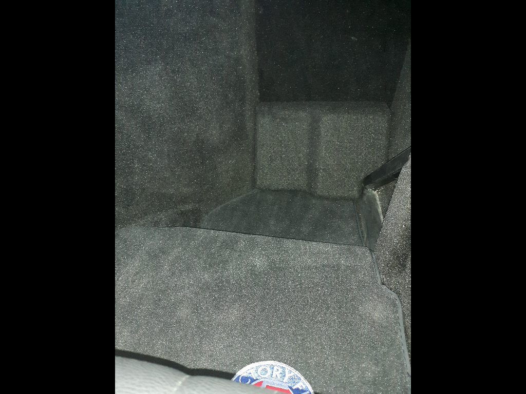

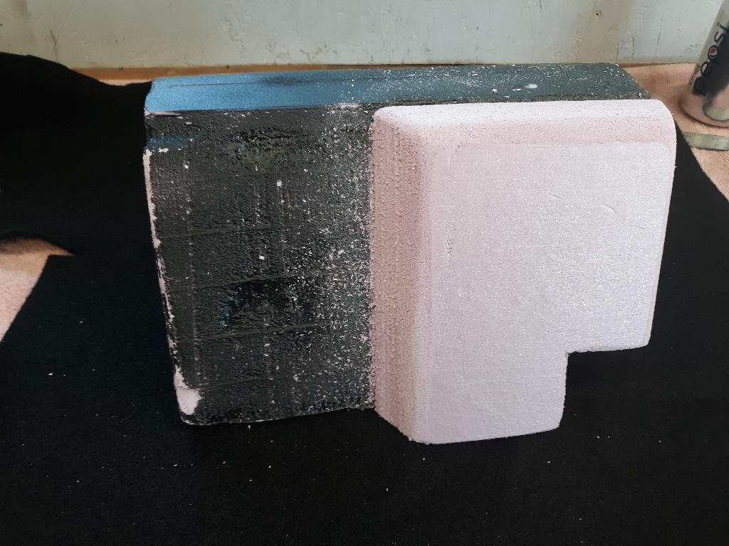

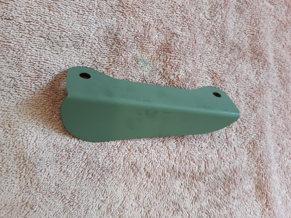

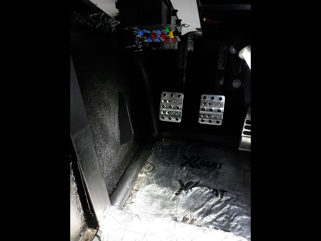

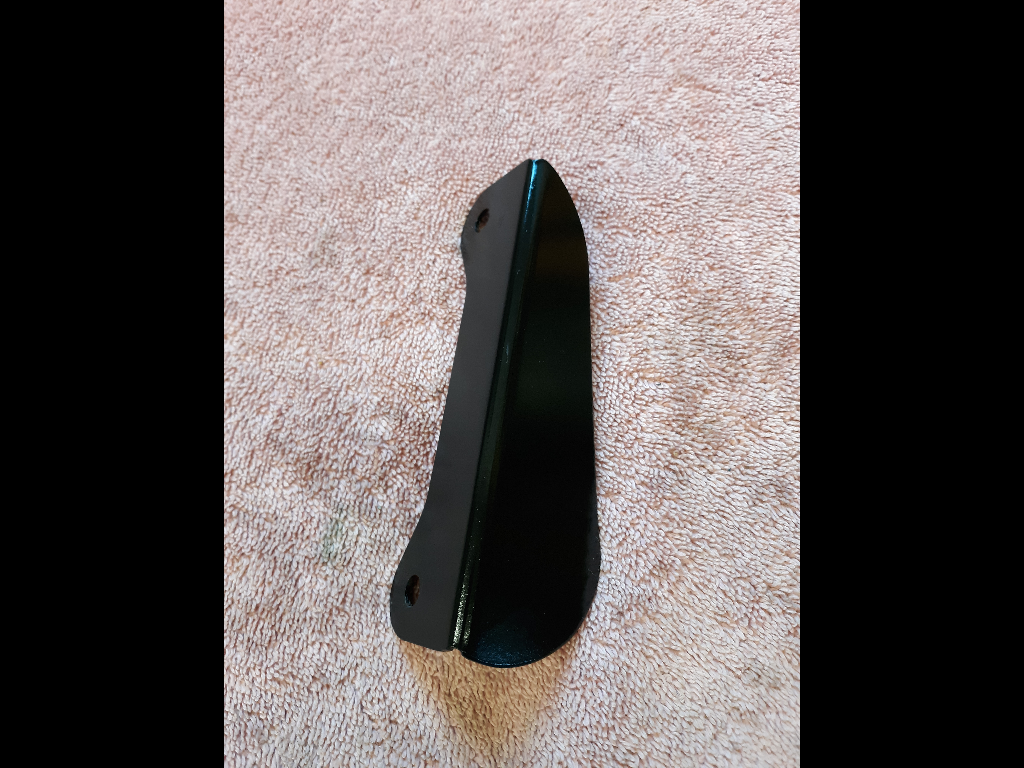

Two projects knocked out on #9365 today... footrests.
One of the things noticed on a longer drive with the Roadster was my left leg was getting sore... and it wasn't "clutch leg". The driver's footbox is pretty cramped, and there's really nowhere to rest your left foot. You don't want to put it under the pedals, and that's not even really comfortable. I realized I was holding my foot kinda "cocked & ready" over the clutch pedal. I needed some sort of dead-pedal/footrest.
I cobbled up one of the unused hood pin brackets, and fashioned a dead-pedal. It's bolted to the outside footbox wall with some nutserts and 1/4-20's.
Sheryl also noticed a need for something. Even at 5'10"+ she had another five inches of room to the back wall on the passenger side. Same thing... nowhere to comfortably rest your feet against, or "bolster" yourself. I had some leftover foam sheet from Glovebox #1. I glue-stacked it together, shaped it, and had her give it a try... Good but not great. The seats in the Roadster aren't straight forward, they parallel the trans tunnel. They're canted outward about an inch. I added another piece to the right side of the bolster and now it's perfect. Some leftover trunk carpet and it's done.

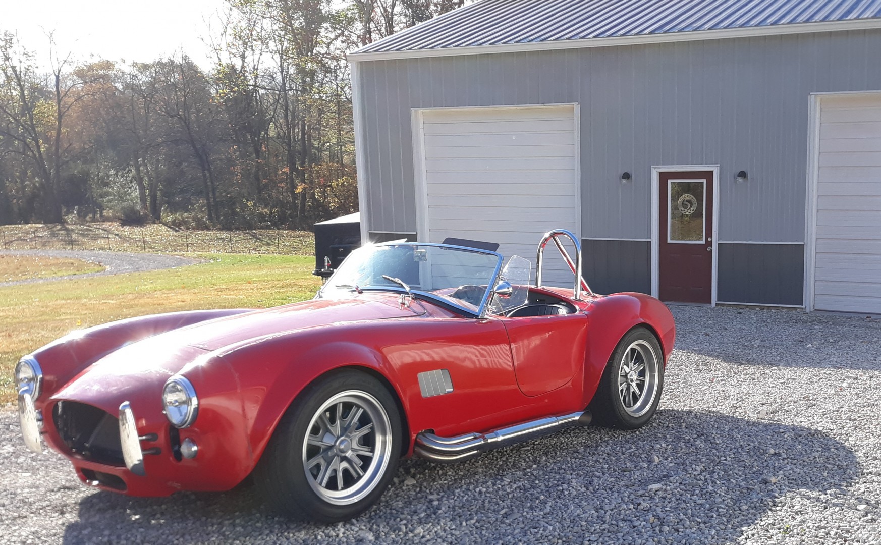

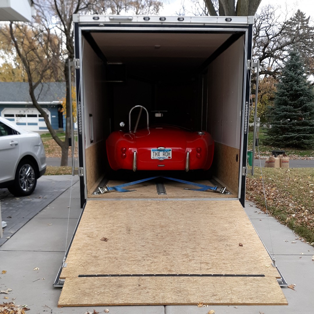

I'm posting this from Bloomington Indiana. I'll be heading home tomorrow, after dropping the car off with Jeff Kleiner for body & paint. There are 3 guys in the country who are really good at and specialize in "doing" the FFR Roadsters. "Da Bat" Miller on the Left beach, Whitby's on the Right beach, and in the middle is Jeff. He's doing cut n buff on one now, with final re-assembly in the next few weeks. Another is in pre-prime bodywork, and then there's #9365. It'll be awhile before he gets to it, but it's in his capable hands (and garage )
I think it was Mitch who suggested Absolute Trailers. I rented their smaller enclosed hauler for this job. It's primarily for sleds & bikes, but the Roadster fits with a few inches to spare, and it's easily within weight capacity.
Rear View Mirror
Solution:

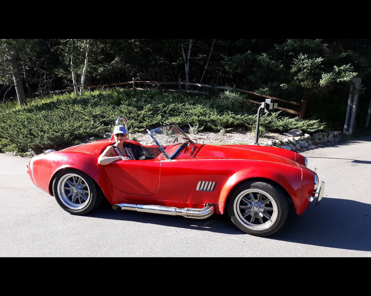

Happy to report #9365 has logged another 180 miles, and only had 1 (somewhat) minor hiccup.
We're spending the 4th week at our lake cabin, and I couldn't resist driving the Roadster. (Mrs. Fixit has to head back to the cities on Tuesday for an appointment, so she drove the F-150 with all the supplies).
Drive Report:
Stopped at the 103-mile mark to top off on fuel. I wanted an easy number to calculate MPG. It clicked off at 5 gallons! 20.6 mpg!!
Decent highway stuff until Rogers, then parked stop-n-go with the weekend warriors, then 60 to 75 mph to the cabin.
2500 rpm in 5th = 70 mph.
2150 rpm in 4th = 60 mph.
Engine temp varied between 80C and 90C depending upon speed.
Oil Pressure was all over the place between 60 & 80 psi depending upon rpm.
The car just likes to cruise at about 72 mph... nice mellow exhaust drone, not lugging, not spinning hard, just putzing along. Lotsa "thumbs-up" from truckers, bikers, and kids. This car is fun to drive... I'll give it a few hundred more "slow time" miles before really romping on it.

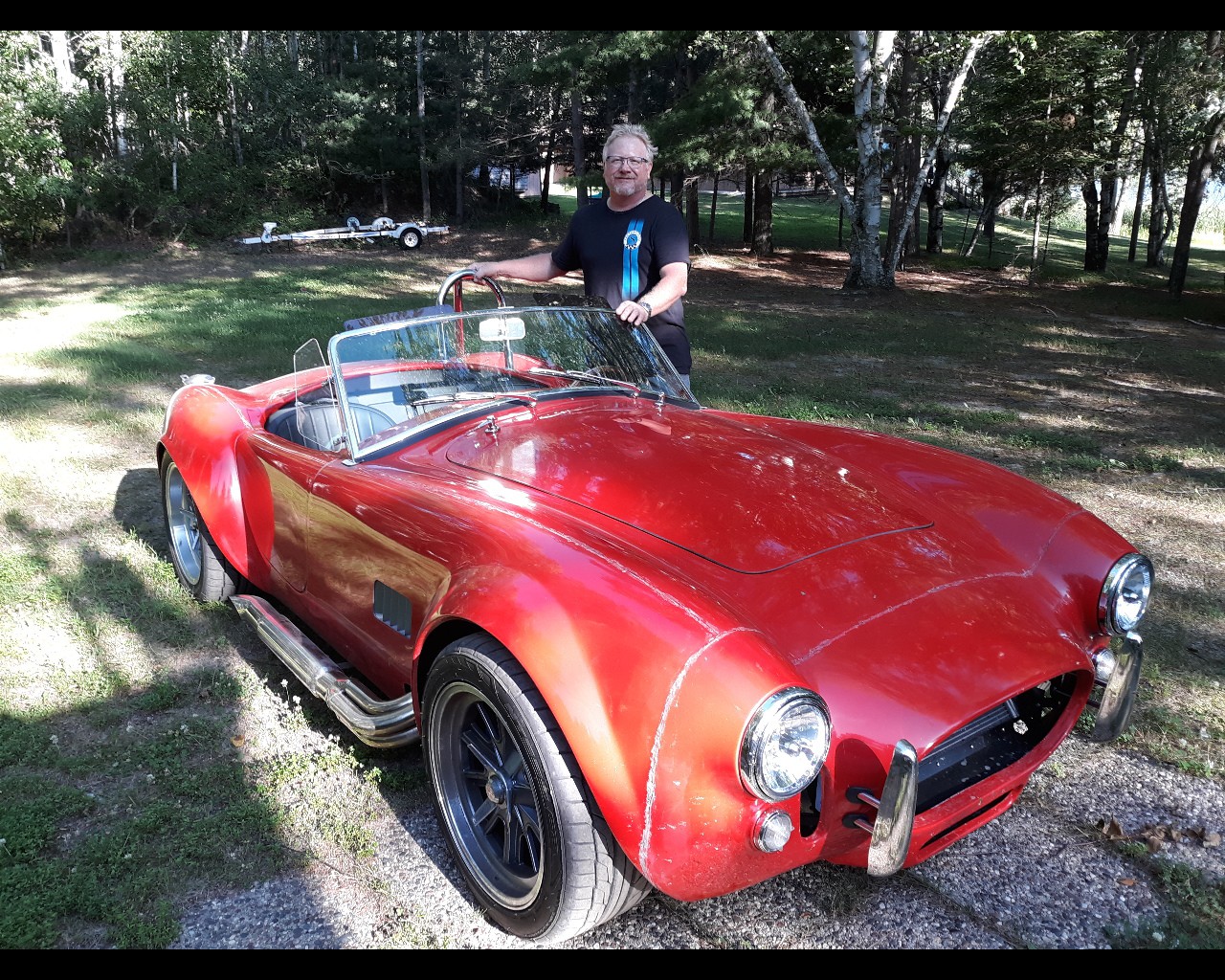

Rolled 500 miles on #9365 over the holiday...
Since I'm getting blasted over on FB for my "driving cap", I figure I'll get the abuse started over here... (It was a gift from Equador. Really didn't have a reason to wear it until I built the Roadster... I think it just works with this car.)
I don't know, the hat is kind of cute.
Reminds me of the helmets roller derby girls wear...
SOOOOO, at 500 miles, you now have a better "feel" for what the car is capable of ??
I don't have the boobs for it... Raquel does!
It's capable of a whole lot more than I'm comfortable giving it!
Just east of us Hwy 87 winds through the woods toward Longville, and it's a great stretch of 2-lane... no cross-streets (but a lot of driveways), several 90* 15mph corners, and a few 35 & 45 mph "twisties", then a 1/2-mile dragway.
I ran through the corners pretty conservatively eastbound (scoping out gravel, etc.), then on the straight got up to 60, 70, 80 several times and did really hard braking (not quite panic stop but on the verge of lockup). I wanted to get the brakes HOT, and verify my Front/Rear balance adjustment. I think my adjustment is spot-on. The rears juuusssttt start to lock a millisecond before the fronts and you're in a full slide. It doesn't want to swap ends, or pull either direction, just slide whatever direction you're pointed... relax the pressure a touch and it slows down like you snagged the #3 wire. Even after 5 or 6 of these crazy stops I couldn't feel any appreciable fade. I'm using the 2018 Mustang brakes, and they're sized for a car weighing TWICE as much. With no power assist they really feel good - great pedal feedback, and easy to modulate.
Cornering is like on rails. This thing just STICKS, but I'm really aware of how unforgiving it COULD be. Coming back westbound I got nowhere near potential on the twisties (no runoff and too many trees!), but cut some apexes and near tripled the DOT recommended speed on the signs. It's common knowledge that these things don't give a lot of warning, they'll snap out from under you, then being such a short wheelbase "overcorrecting" is the death sentence to a save-able goof. It's a totally different feel than a "traditional" car, as you're basically sitting on the rear axle... lots of nose in front of you. I'll wait until BIR or Dakota County to push the envelope. I need to practice my Heel n Toe!
Towing one of these things is like pulling a brick through peanut butter. Best mileage I could muster was averaging 9.4 mpg, and the 3.5 twin turbo was earning it's keep. I'm very impressed with this "little" V6. Tons of torque and I don't think it ever saw north of 3700rpm, even when hammering on it during an onramp. The boost gauge was ticking off in the 10 to 12 psi range however
Anyway, headed for home tomorrow at 0-dark-thirty.

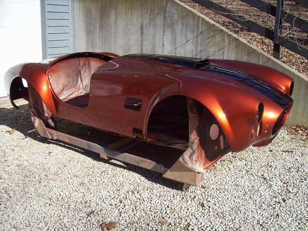

I'm/We're still bending towards a coppery/orange color, with off-white/cream stripes. I've got awhile to look around and submit a few choices to Jeff. Once I do that he'll shoot some samples on little plastic model car blanks and send 'em to me. This is the color family I'm thinking about, but with white instead of black stripes.
That copper/white would look good on your car.
I REALLY like the copper. Maybe look at the pearlescent white of Cadillac/Escalade from a few years ago for the stripe. Might add a little bling to the copper.
