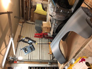

With the nice weather starting to roll in the time for priming is upon me. Also decided to not go with the 1970 Champagne Gold (metal flake), as the degree of difficulty may be too high for a DYI. New color will be a solid Code 75... Cranberry Red, so instead of being gold like our 70 Chevelle 4 door, it will be similar to the Red Fiat 124 Spyder we had at the same time.
Something like this...
-- Edited by BLyke on Thursday 11th of April 2019 04:29:44 PM

Guess it has been a while.... and the car will not likely see the road this summer, but i did actualy start a little bit of the painting. Mainly on a old door that will be scrapped and provided a good test piece. was able to get it to lay down fairly smooth.
If you can get base coat or single stage to lay down smooth, you're already better than me. My Camaro looks like a golden, over ripe, orange...
Jul 19, 2019
My goal was to get the primer smoother than the Nomad blue. Still need to experiment on the settings for flow and pressure, fortunately i have several panels i will not be using to try it on.
Jul 25, 2019
Moved up to priming real parts today and think that it is getting close to dialed in.
Perhaps thre will still be an escape from the CAC yet this year.
My proficentcy seems to be improved from what i had when painting the Nomad. Moved on to some high build sandable primer and it is looking much better than last time, but time will tell.
Worked on gun pressure and settings, results were much smaller droplets for a farly smooth finish on the epoxy and sandable.
Have a little more time in the "workable window" to to get all the loose parts dne and than ont o the main body

Despite the lack of posting of comments and pictures progress has continued.
Focus has been on getting the body parts that were out of wack sorted out and lined up.
Also getting missing parts lined up and starting to track them down.
