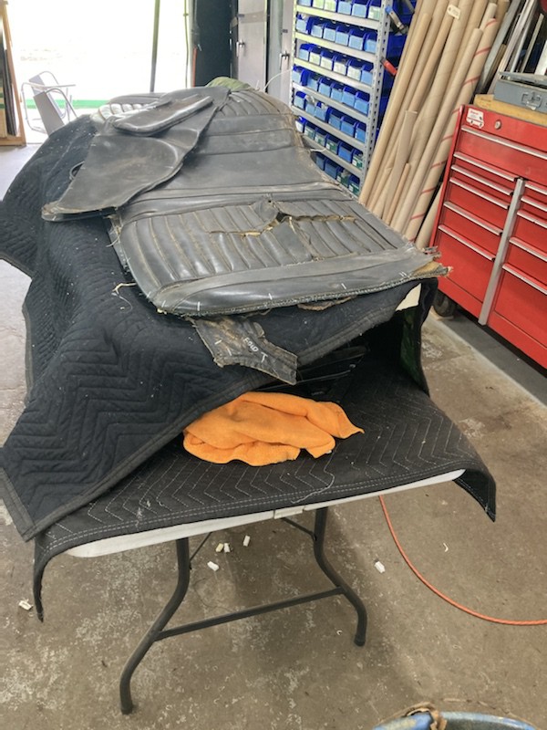

Soooooo, next challenge is to find best Vendor for seat refreshing.
Thinking disassemble, send out for chemical stripping.
When back deal with seat tracks. We have no expectation that we would be able to find correct tracks to fit Chevelle floor. Plan on fabricating brackets on lower seat frame to allow use of standard bench brackets on full size Strato Bench seat.
Chrome piping is available, bucket seat covers, no problem. Challenge will be to recover bench portion to appear compatible.
Could buy a bucket set, that takes care of upper. Upholstery Shop will have to fabricate panels and utilize lower inserts.
Person doing work should take apart, inventory. We will strip, fabricate mounts and send for powdercoat. Return to Upholsterer for custom fabrication and assembly of seat.
Who do we know that is most creative and best qualified? This is not assembling standard covers with standard cushions on a couple of Bucket seats. Not a do-it myself project.
We want a professional job by a professional.

Dropped off assembled seat Friday. Picked up De-Trimmed pieces this morning.

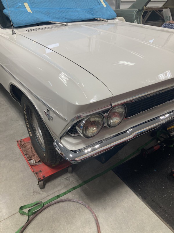

Got "edgimicated" today on current Bumper reconditioning costs at Keystone/LKQ. Called my favorite contact there, for pick up of Elky and Malibu rear bumpers. Also front center and ends for a B-Body ( Biscayne)
OUCH!!! She said they had a price increase. My cost, $1000.00 each. Think I may have to rethink Reconditioning my very nice cores and go with Aftermarket, Goodmark or similar.
Even Biscayne front is over $600.00 for center plus $400.0 each for the ends. Terrified what 56 Chevrolet pieces would be.
Still in SHOCK.

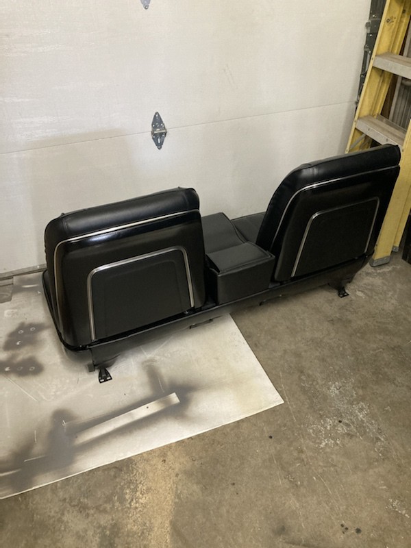

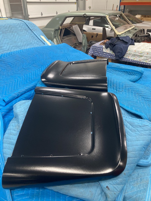

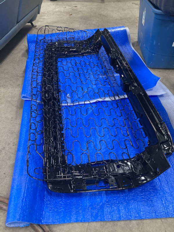

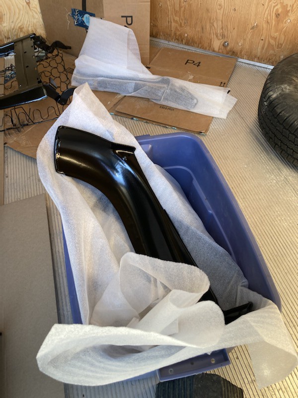

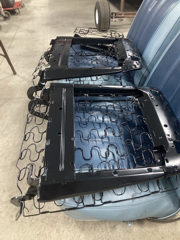

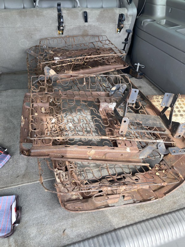

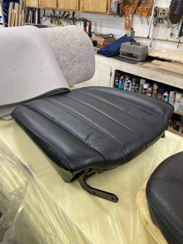

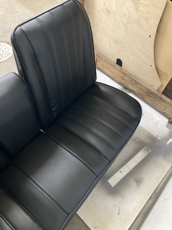

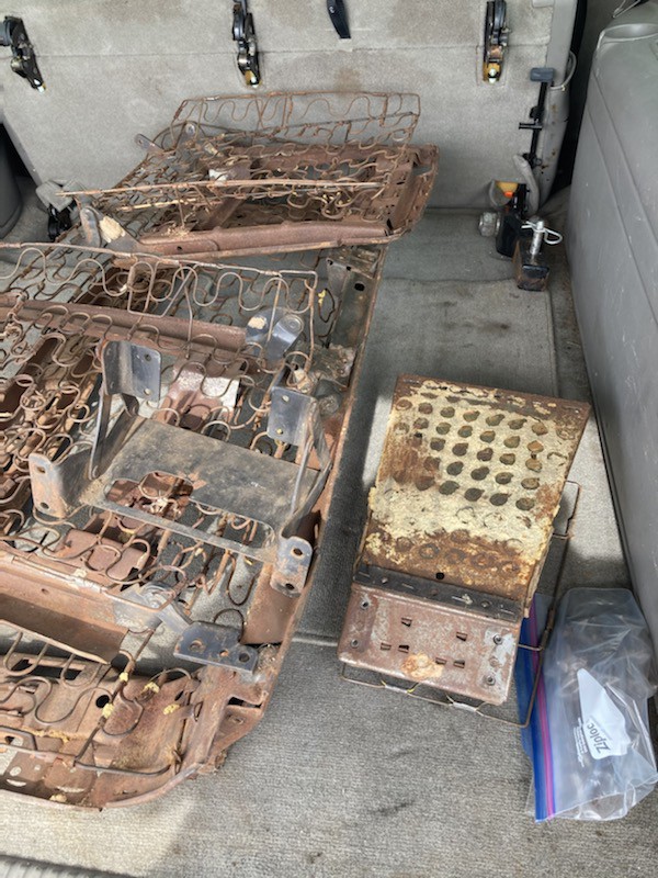

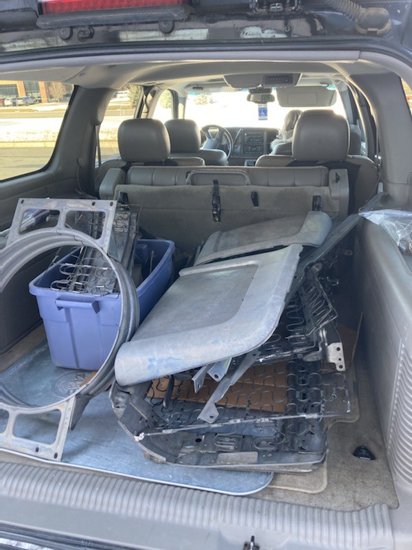

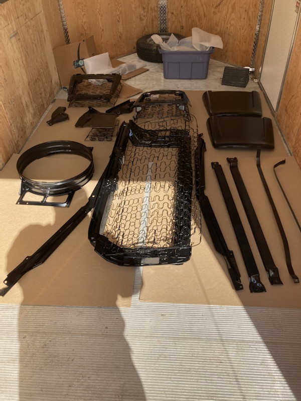

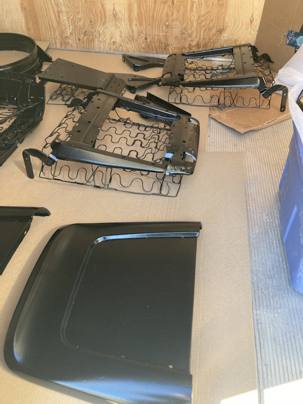

Stripping done, detailing and fabricating rear seat adapter mounts. (Ron)

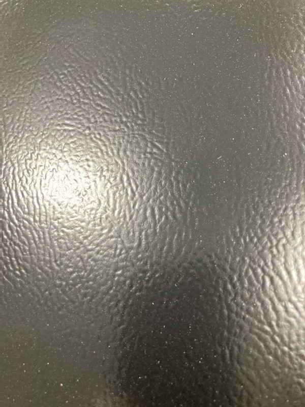

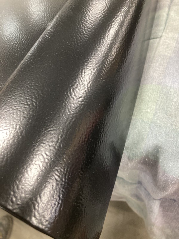

Did you loose any of the texture on the seat backs having them powder coated?
Mar 20, 2021
This particular batch of powder coat seems a little thicker than what I have seen before.
Due to that, the grain is less defined than if we had just shot them with aerosol.
Once again this is not a make it exact resto, so it is not a big deal.
All the other pieces look great with the thicker product, or maybe the powder coat tends to fill the grain no matter what.
Either way, glad they are done, nothing really shows anyhow.
Good eye Chris.
Mar 22, 2021

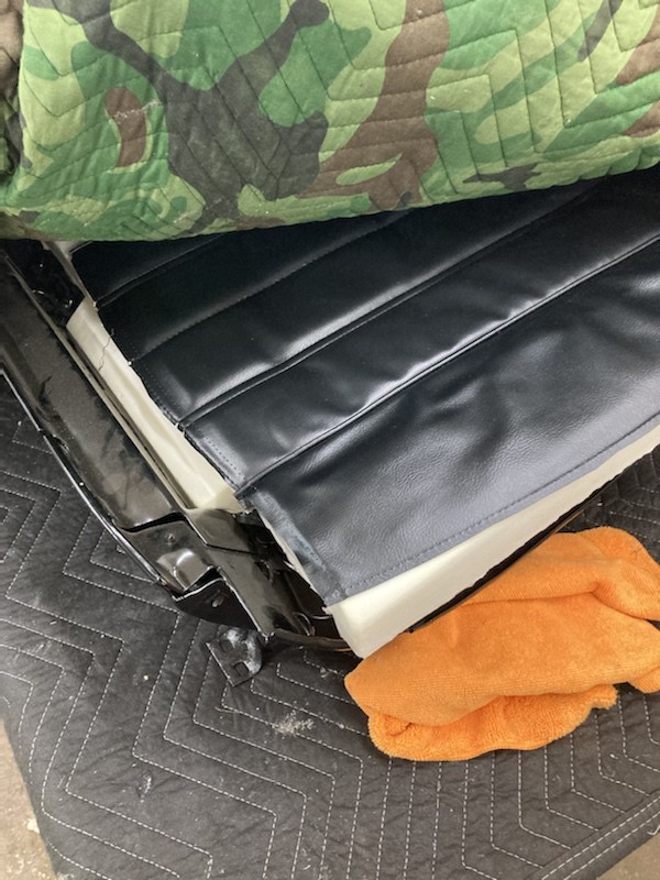

Better shots of stuff. Seats are ready to go back to Metro Upholstery, waiting for a couple of replacement side springs.

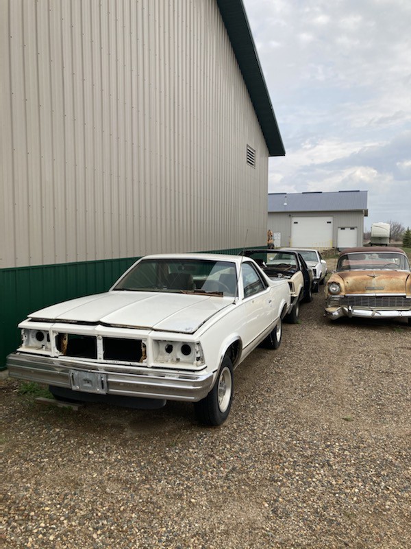

I realize this post started as a "PAIR"

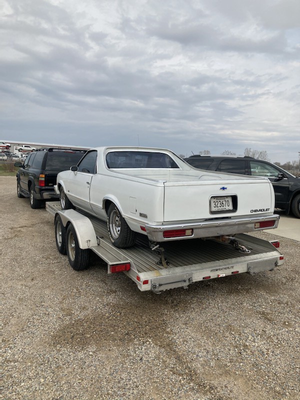

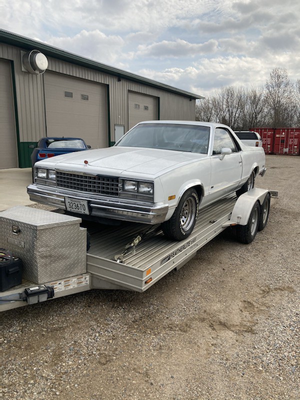

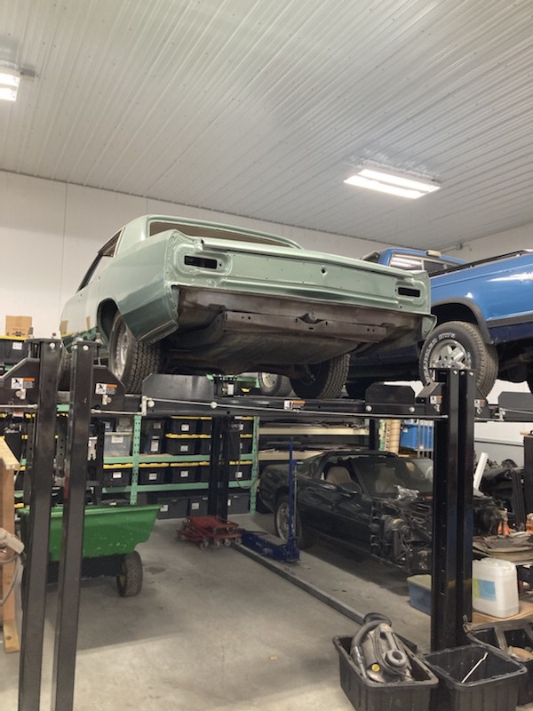

We have several G-Body Elkys' also, three are now parts cars and one got a motor/trans swap.
Son Scot is primary on that vehicle, bought it in 2014. Is a dry 1982 model.
Brought it home from Marshall Mn. It is next in line to go to Exhaust Pros, Northfield.
Loaded today, ready to go when 66 Elky done.
Bought three other G-bodies from a Salvage auction in Mobridge S.D in June of 2017.
One is a dry 4 dr. runs, bad tranny no title.

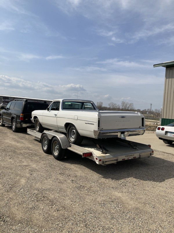

Some Pictures:
Three parts ElCaminos, Have one title in our name on the 78, other two open from the Dakotas.
One very rusty local, other two Dakota cars really solid, including frames.
We put 1/4 panels on the rusty local one 20 years ago, it belonged to an employees' Uncle.
Going to pick a few more pieces of these three and sell, scrap or just leave sit and rust.

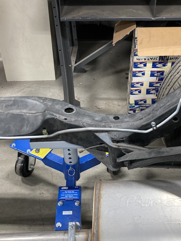

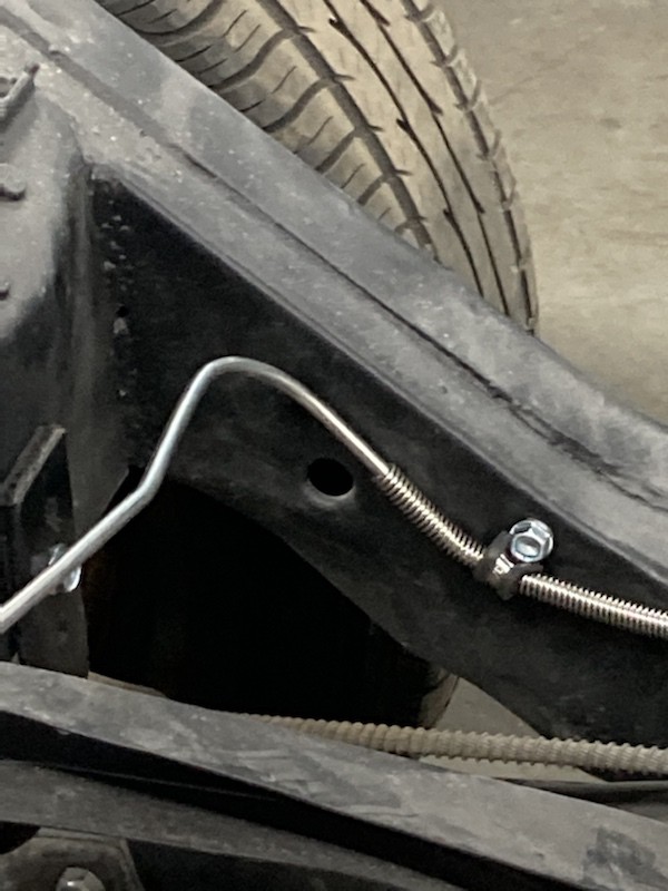

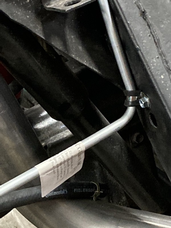

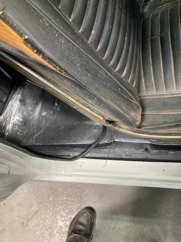

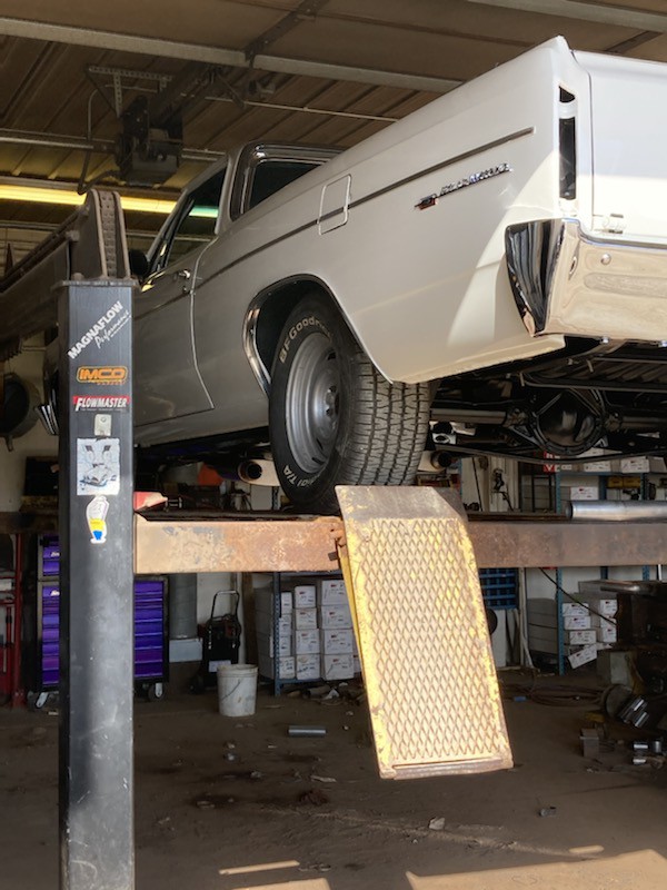

BLUE ELKY----- My good friend Roger played with brake/fuel lines yesterday. Then we went to the RED FOX, Lakeville for beer-30 to celebrate. (we celebrate something every week)
Switched fuel line to steel not stainless, shapes easier. It is a pain getting line through rail and crossmember and then making it fit and not rub too much Ron got the line in, Roger tweaked it to his satisfaction.
Roger used some stainless clamps I ordered through Amazon, did some sizing and hole prep. The stainless clamps were in installed in place of some loose factory clips and added some more for extra integrity.
Pretty sure those lines are not gong anywhere....

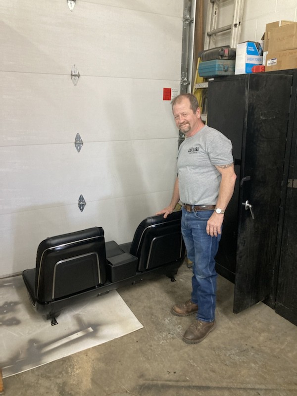

Still, am really pumped about seat outcome. THANK YOU TONY!

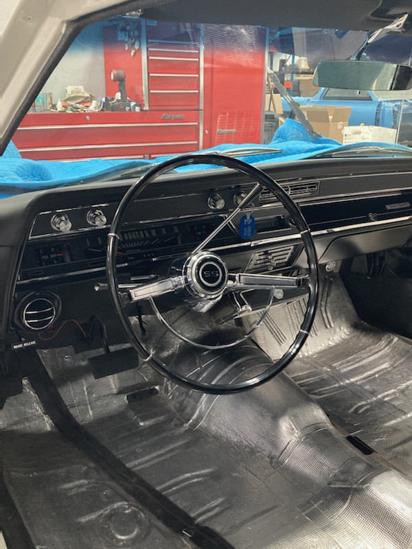

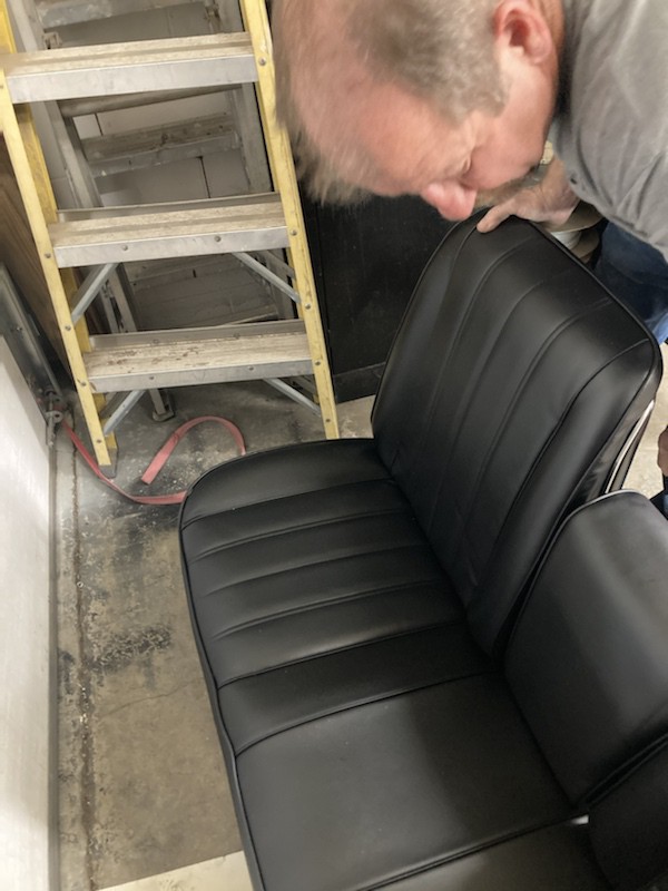

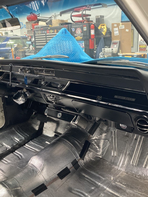

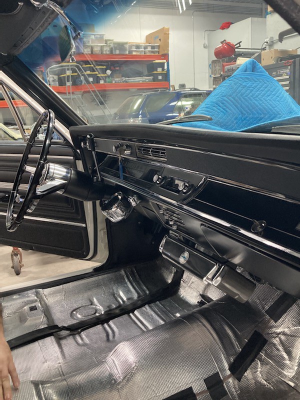

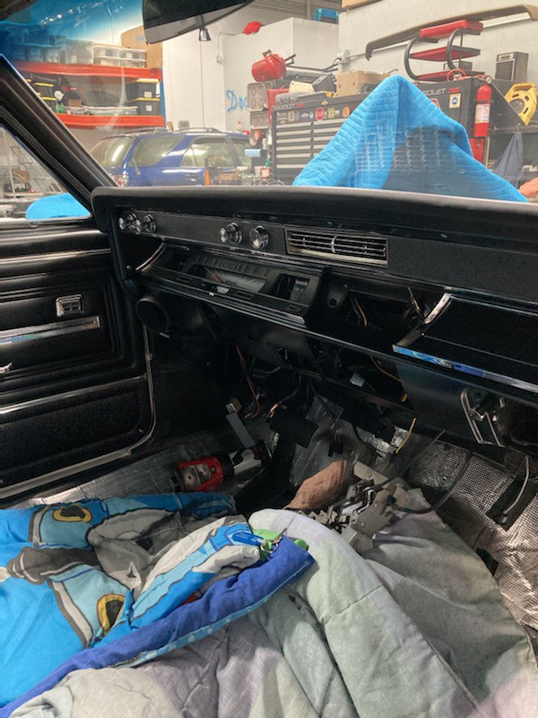

Dash, added two action shots of fire up.
Not sure if they will work on this site.

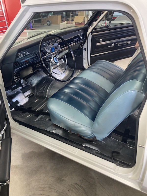

Dash, column are in and operational.

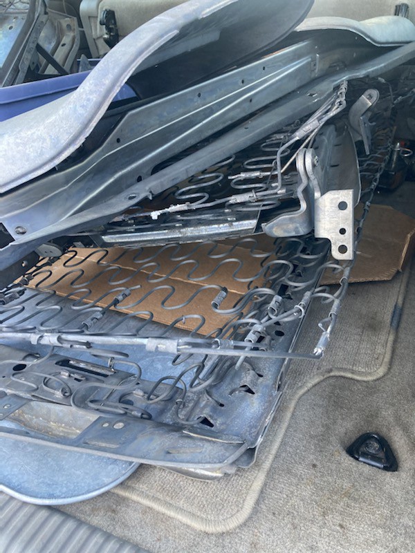

Fitting strato-bench seat.
Tracks will need some playing with.
Seat is out of 66 Pontiac Full Size.
Has the fold down arm rest in the center. Gives the appearance of bucket seats. First gen Camaros could be ordered with them too.
-- Edited by Lost in the 60s on Friday 12th of February 2021 03:05:58 PM
I have seen similar, but the term "Strato" as in buckets was a exotic sort of term back in my teens, and never had bench attached
Came out really well.
Hopefully off to Powder coat this week.

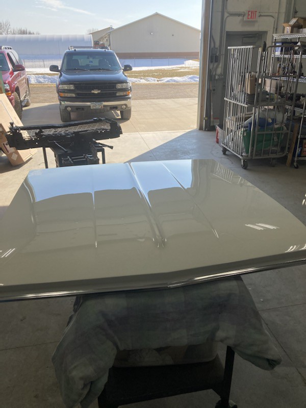

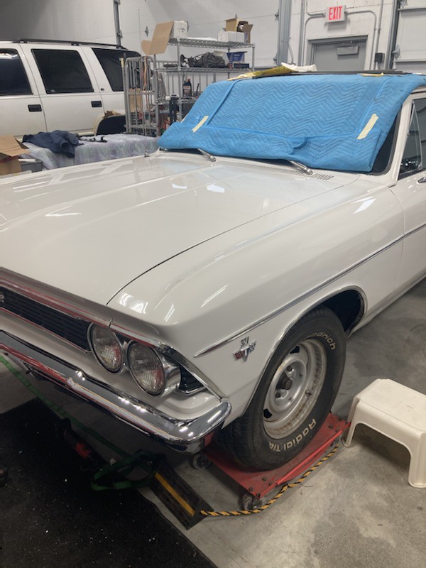

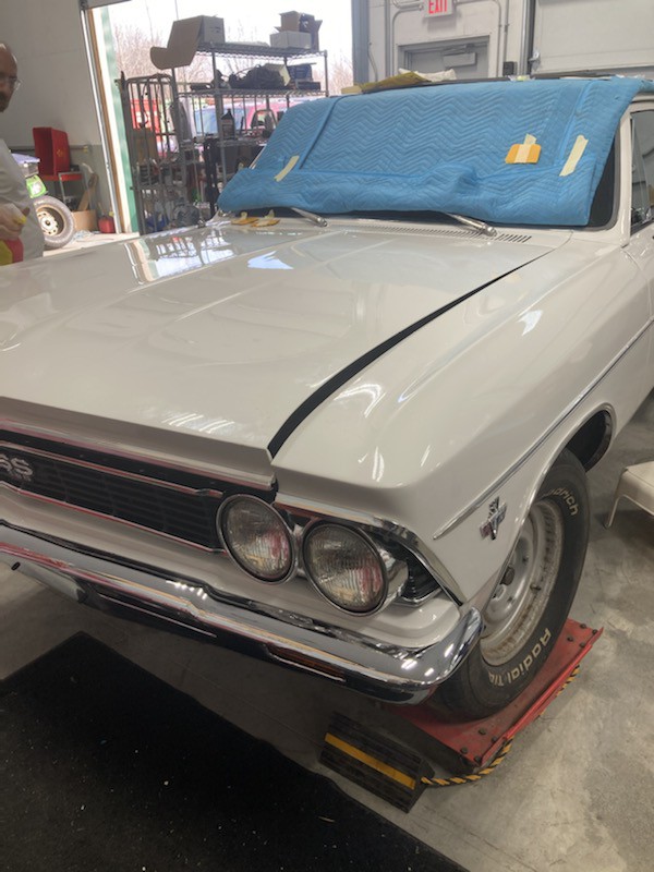

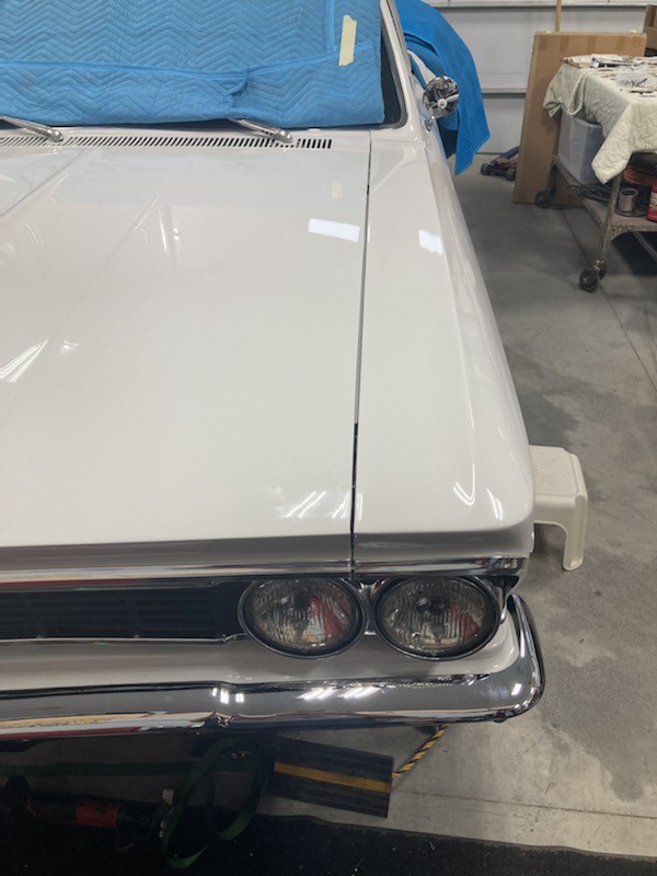

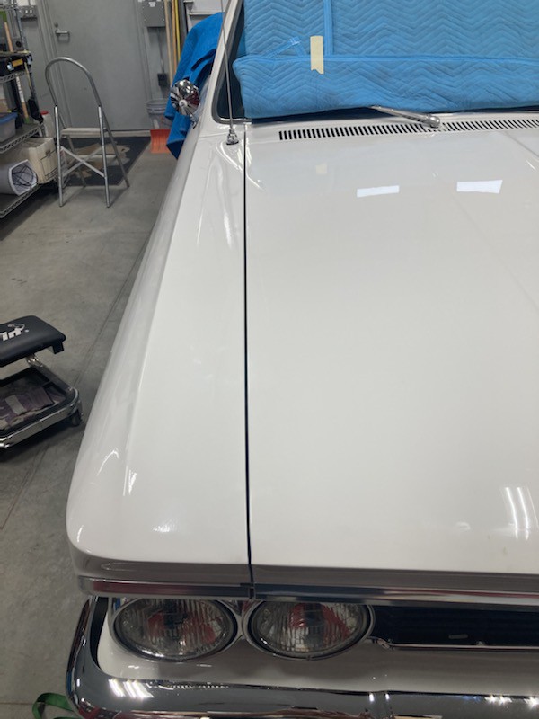

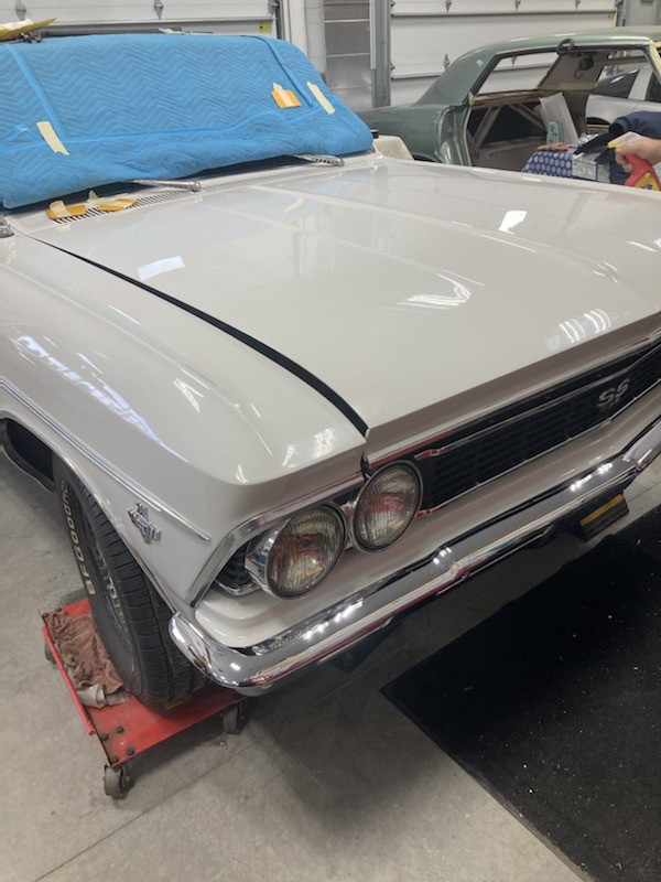

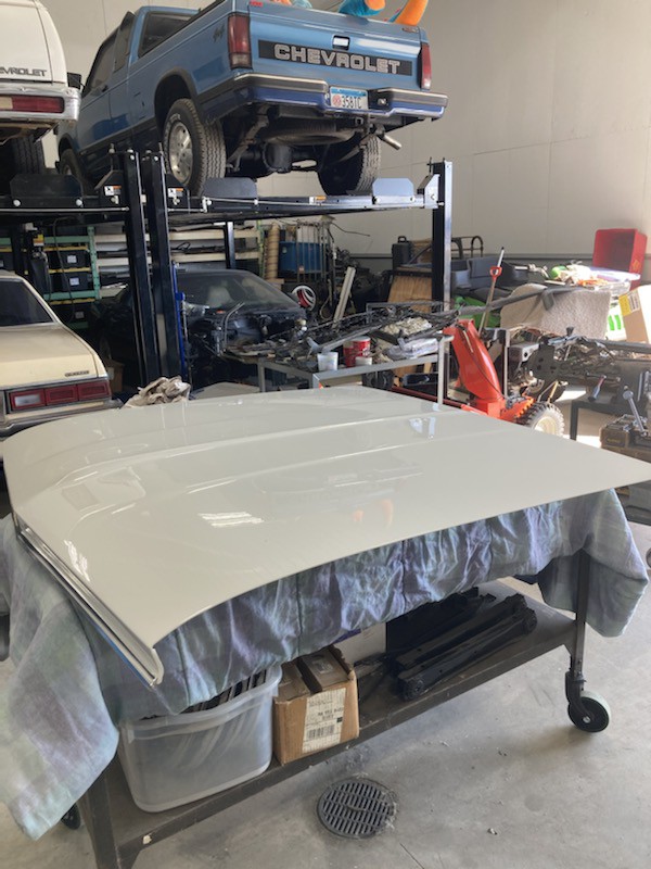

Getting caught up here, Hood buffing and fitting.
Now focus on fender fit at rockers.
This thing is coming along nicely.
Fits are ok, not great, however, it was a mass produced vehicle with very low initial standards.
Also will be a driver, not a Show car.
Next is to take down to Exhaust Pros in Northfield for exhaust fit, fabricate and final install.

Seat and misc parts are done.
24 hour turnaround, incredible.
JIT Powder coating in Farmington does not like these specialty pieces sitting around.
They have always been fair with me.
Highly recommend.

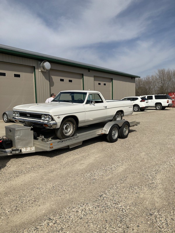

Loading on trailer and taking to Exhaust pros in Northfield to install, fit and modify Pypes system to dump behind wheels.
Pictures later.

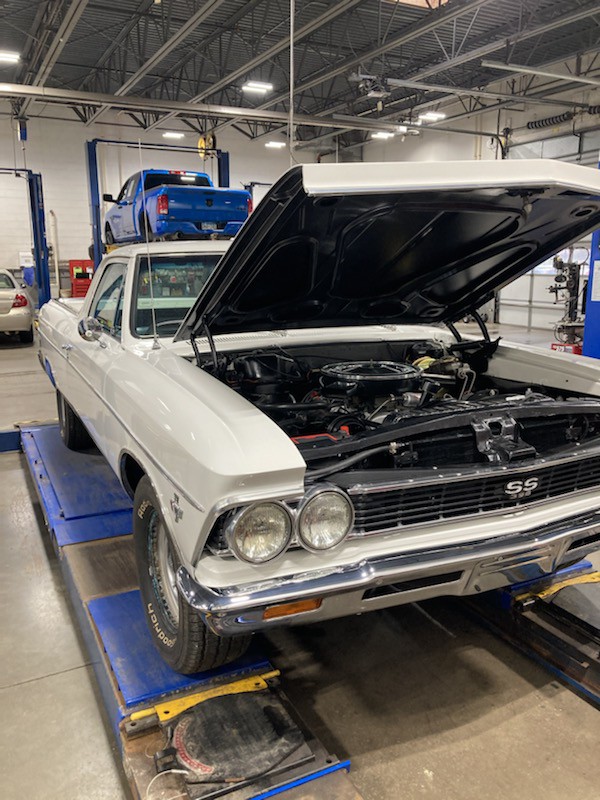

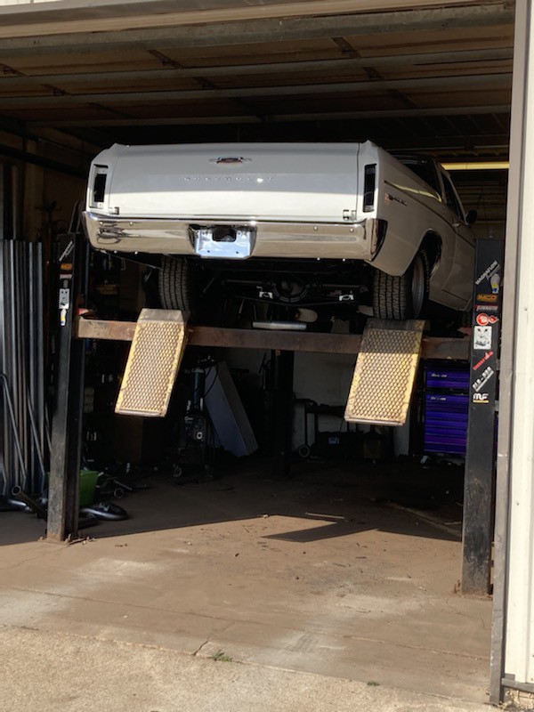

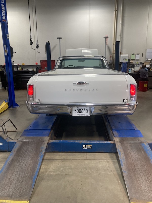

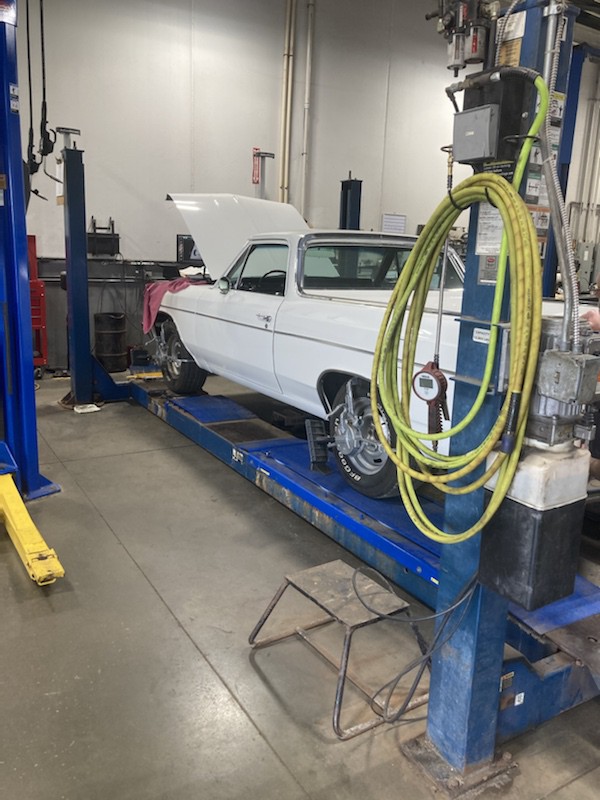

Drove out of shop, on to trailer, off trailer on to hoist.
Took it down Monday afternoon, probably done tomorrow am.
Some Pictures:
Decision for another day.

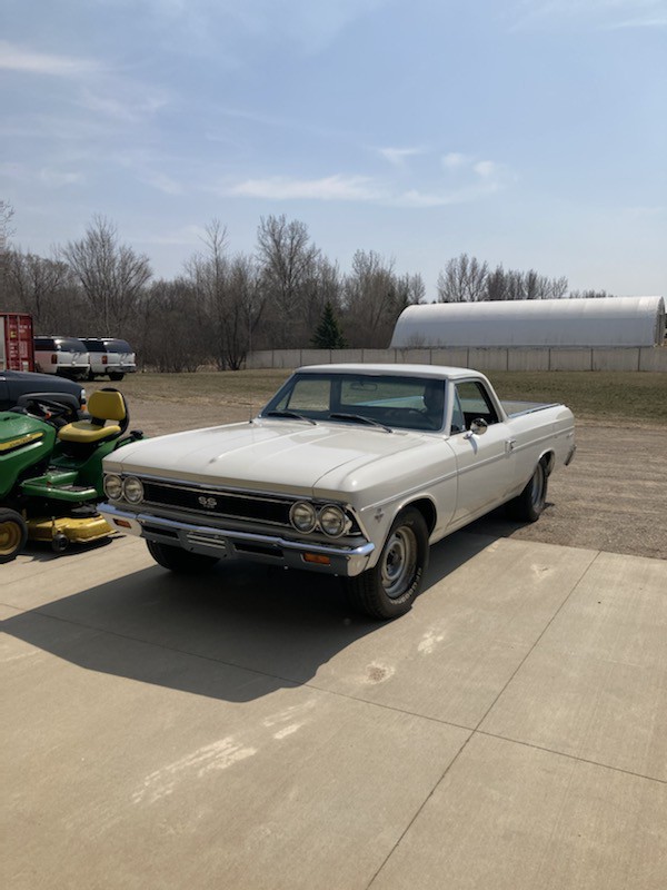

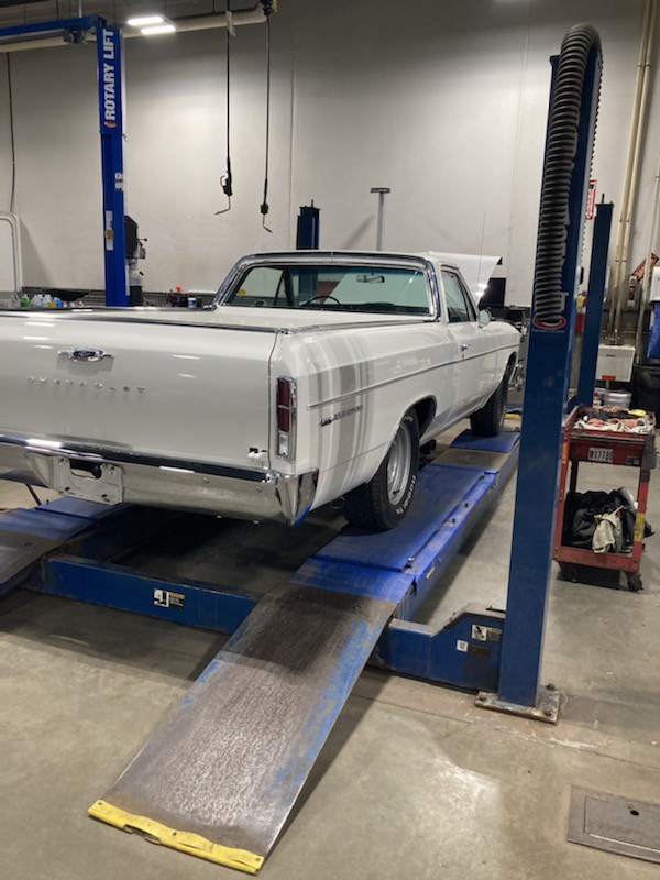

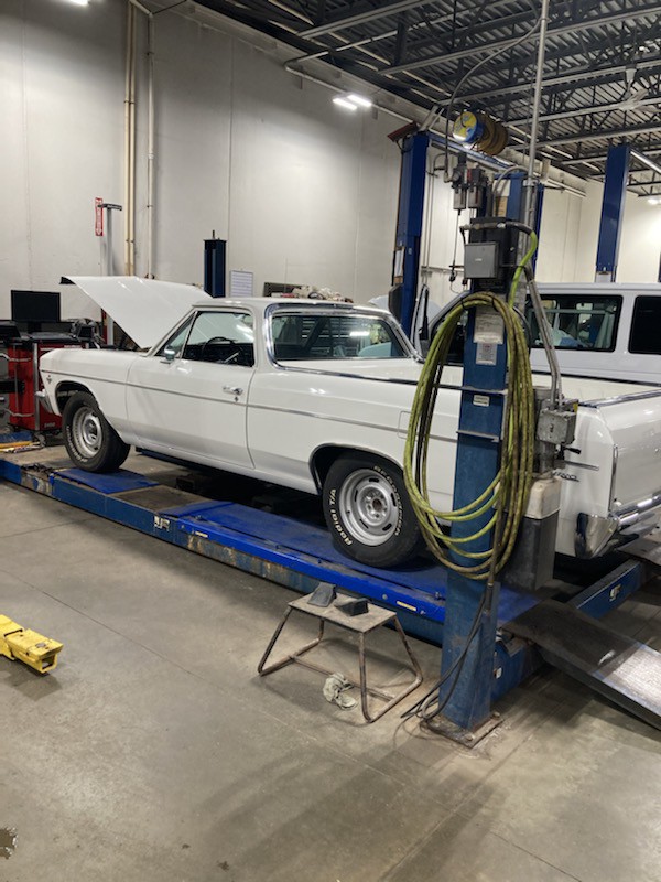

OK, White 66 is BAAAACK.
Now at CLA with a list.
Should be interesting.
Pictures:

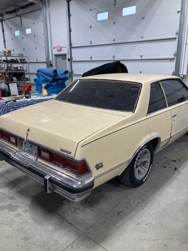

Green Malibu up in air, mothballed.
1978 Malibu in stall some trim removal, body repair and perhaps paint prep.
WHITE ELKY--Seat Update Metro Upholstery.
Covers came in. Splitting up bottom of bucket panels to fabricate additional to make it a bench lower.
Uppers fitted to backs, looking good!

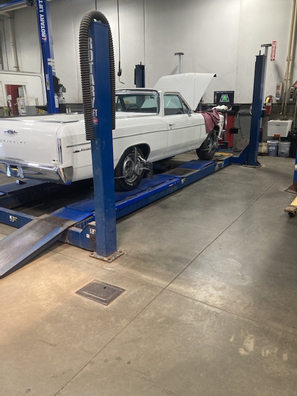

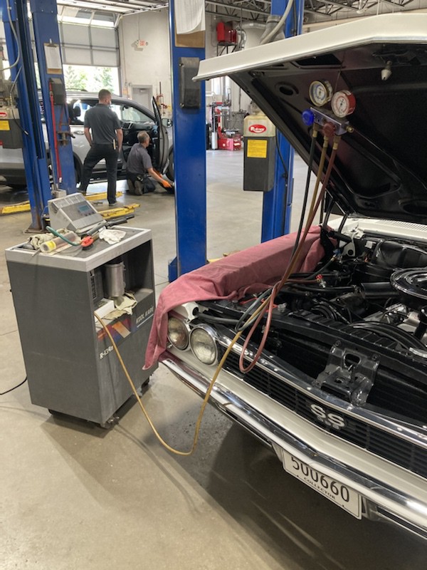

Car is aligned, Dealt with leaky fuel pump, played with supply linne to Carburetor.
Now hopefully charging A/C Need to fill compressor with oil.
Switching to 134, have drier in stock.

Seat Update, White 66 Elky
Tony finished up the seat.
Couldn't be happier.
Came out BEAUTIFUL!!!
That is him showing off his upholstered artwork!
Guessing, probably the only one in existence.
Optioned up a little since you and Jenna dated in it.
Kept your tilt wheel with a rebuild.
Rally gauges, knee knocker tachometer, tinted glass, power windows, tissue dispenser and, "the seat"
OE upper dash pad, factory black.
Ron just had to add a bunch of jewelry to dash, his call.
The Blue elky will probably get a plain 300 Deluxe dash.
It is set up for power 92 Eldorado buckets and console.
More than likely use my black set, I have a nice black dash pad for that.
Always like choices though, have a medium blue set of seats and console out of my wifes' previous 1992 Eldorado, now long gone.
THANK YOU TONY!
