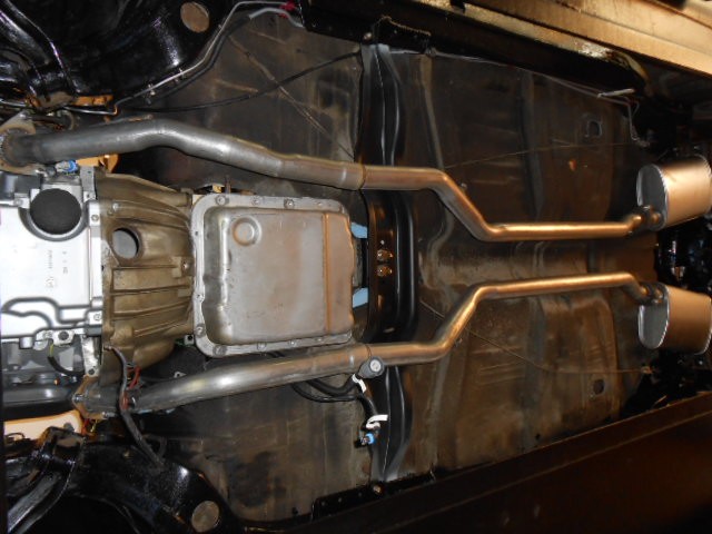

The exhaust is in from the back to forward of the cross member and ready for down pipes.

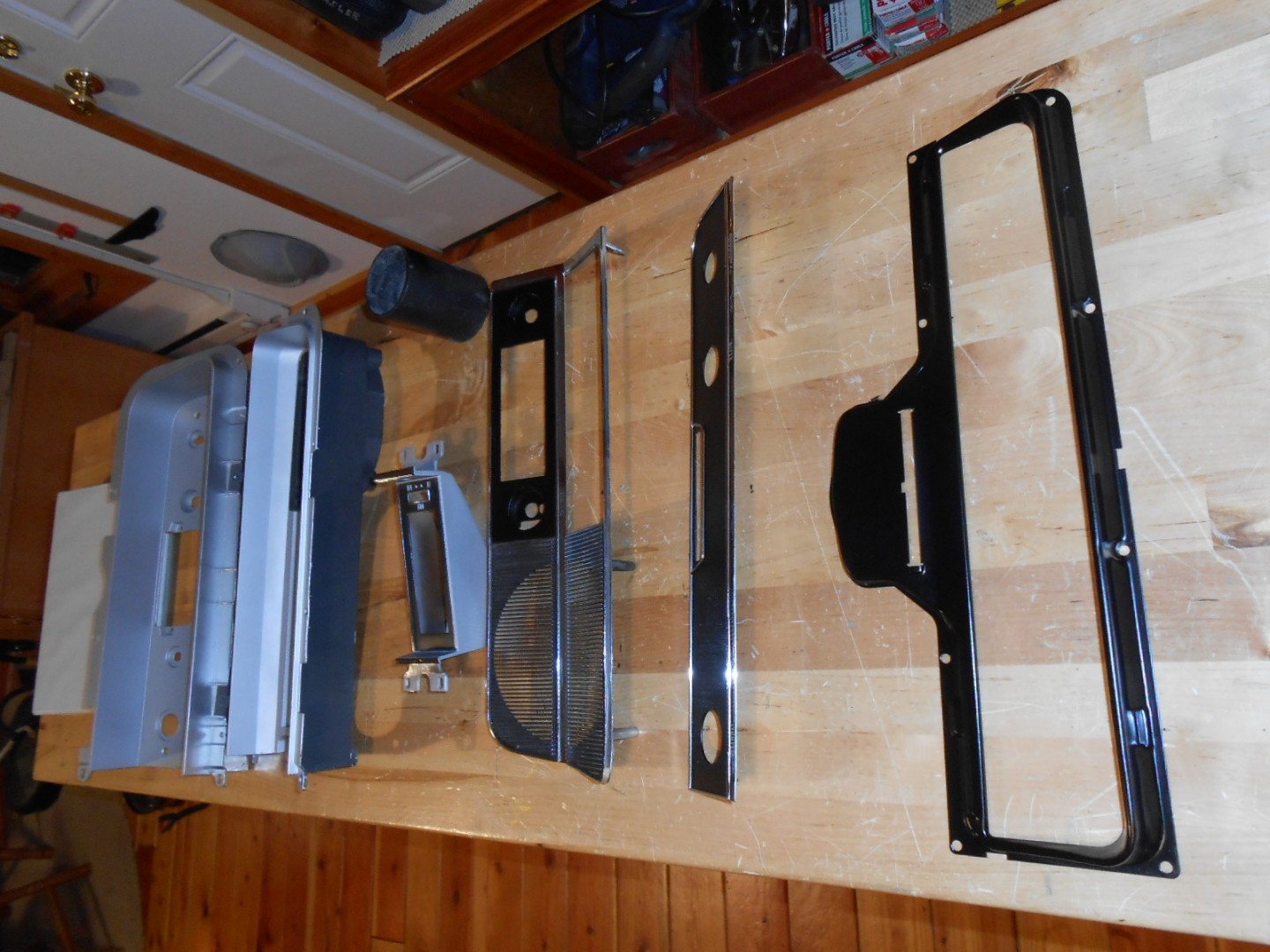

Since I didn’t get much done today here’s some pictures of mock up components we made for the project. The computer mockup is indestructible; it can be dropped and banged around without fear of damage while trying to find a place to put the real one. The wooden engine towers help establish the required engine height.

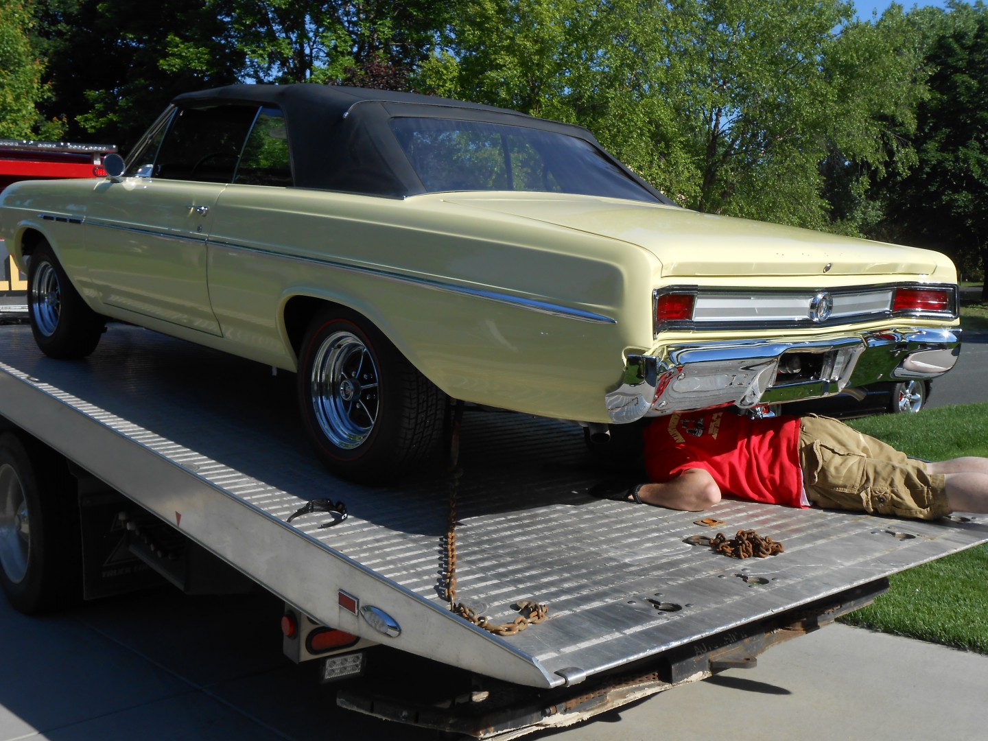

Car is off tomorrow to have the exhaust finished. Today was spent getting it ready for transport and making sure everything was installed that could possibly create a conflict with the exhaust system.

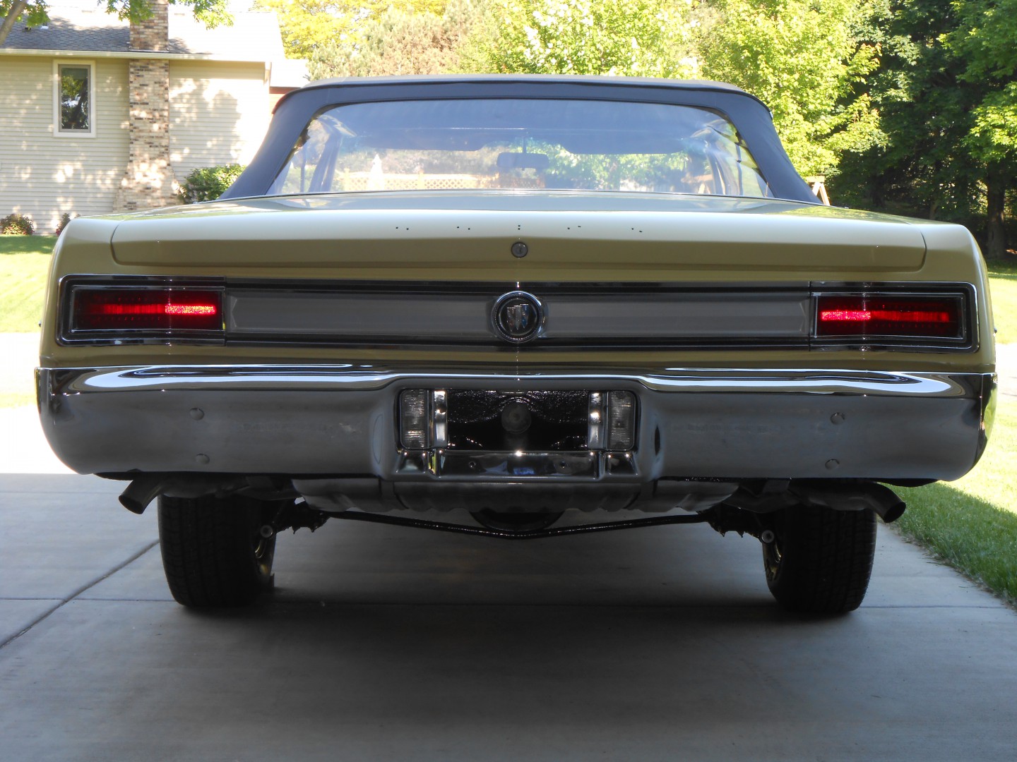

Thursday was the first time I’ve seen the car in sun light and I like it. The exhaust is done, O2 bungs are welded in plus I added two additional bungs for wide band sensors. Speaker is being moved to the rear and the computer will be installed under the dash.

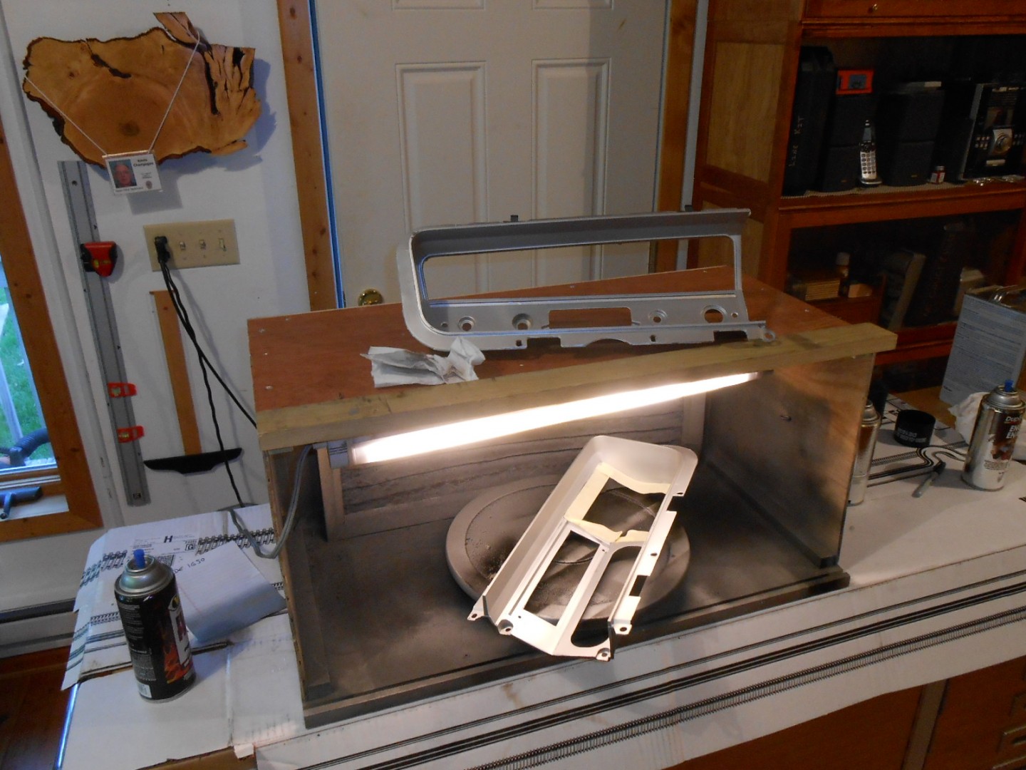

The freshly rebuilt grill now sports an LS1 emblem. Got the paint booth back out and repainted the instrument panel and then installed some soundproofing.

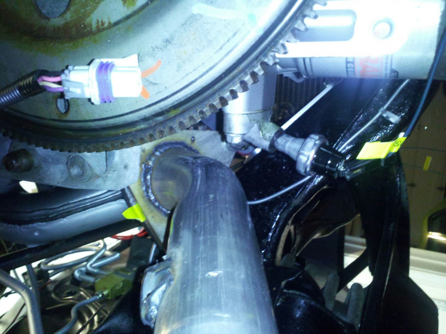

Here is what I’m trying to not over heat. Ideally I would have liked to mount the oil pressure sending unit pointing up but it gets’ even closer to the down pipe.
I think you could fab up a thin sheet-metal deflector and mount to the exhaust stud(s). I made a deflector for my wiring harness since it ran by one of my headers.

I don't see that you have anything to worry about. It appears to be a decent distance away from the pipe and with air flow down the road, won't be a problem. Even with parade speed, the heat will rise away from the sender.

Brake lines, all of them, fuel tank and lines, exhaust, and engine install are done, wiring (under dash), radiator, transmission and power steering to go, plus 50 or so things I don’t know about or haven’t discovered yet. I am getting pretty good with the transmission though, it’s been in and out of the car no less than six times in the last week.

When Stan got his in dash tach Mitch was right, I had to have one. Only problem, no one makes one for a Buick because they never had an in dash tach, until now that is. They used the old knee knocker tach; I was thinking of installing a hood mounted tach but got over ruled by the owner.
Herb at Shift Works was very helpful and helped me research dimensions for several in dash tach. Like so many things on this project days of homework for a few hours work
I had to remove both the clock and tach from their respective mounting cases then modify the clock case to receive the tach. Next I had to ‘discover’ the correct amount of shimming for the tach inside the case to establish the correct depth or distance behind the dash glass. I wanted the tach to be the same depth as the fuel quantity gauge, it's tight but it's in there.
