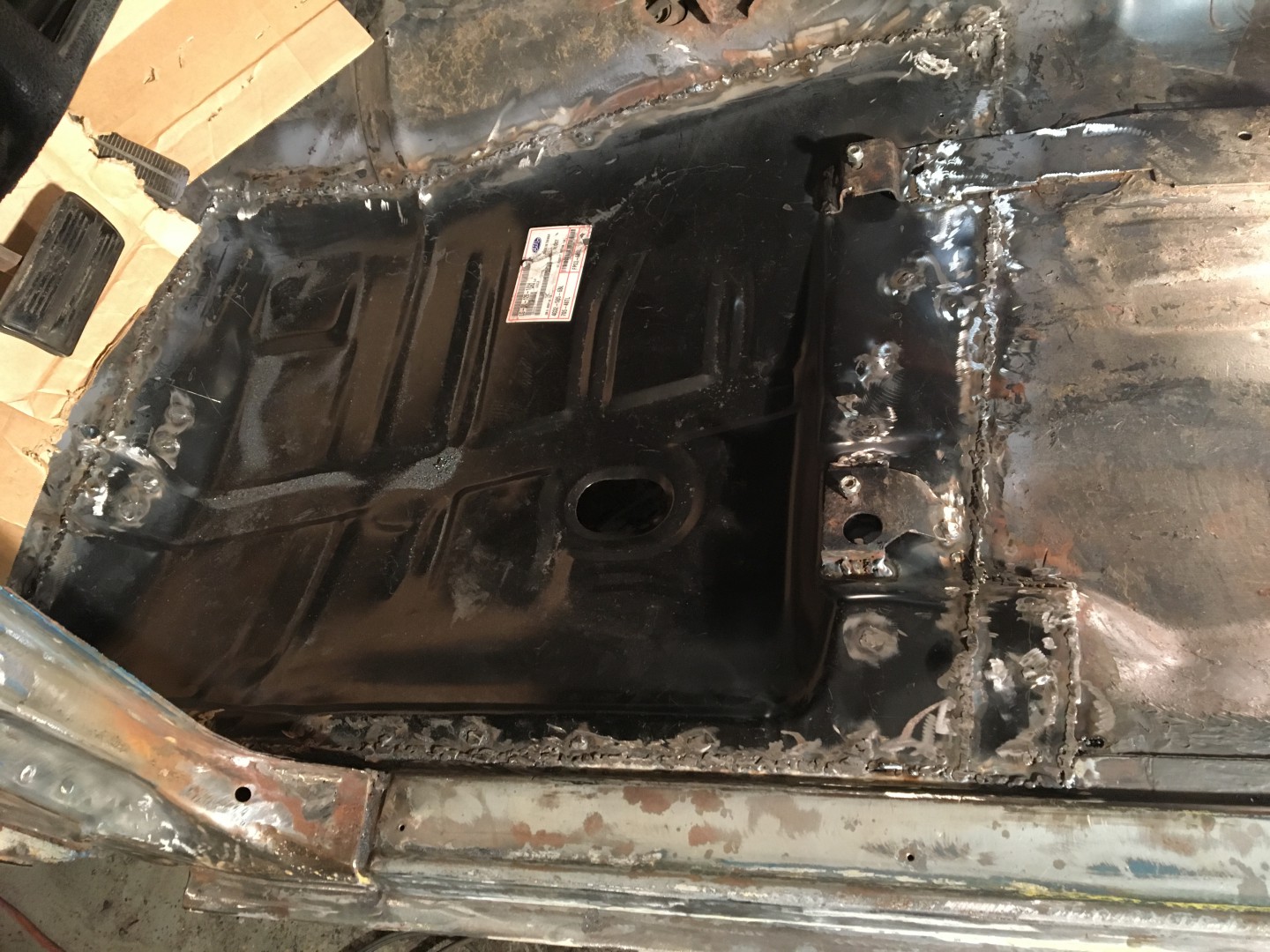

Time for a weekly update ready to weld in the new floor on the drivers side front, perhaps tomorrow.
That should be fun. A person can make more progress when having the time to putz all day, instead of trying to squeeze project time in after a work day...
Jul 18, 2018
Yep, got it all tacked in before i had to head out this morning. did a few rounds of trimming and grinding to improve the gaps.
Made a~2 X 6" piece to go in a small area behind the front patch that was suspect

Front floor just needs a little more clean up and seam seal and it will be GTG.
Cut out the major bad rust and previous work on the passengers side, leaving the solid area.
Considering attempting the full panel replacement. More work to remove and prepare but will look better, just in case it takes a while more to get the rear seat in
-- Edited by BLyke on Wednesday 25th of July 2018 09:06:30 AM

Replaced the passengers rear floor (that i had made a small patch in sometime ago) still need to clean up the welds and prime. It was so much fun... will be ordering the rear drivers side, and then that is it........
the passengers front will be just fine as is....

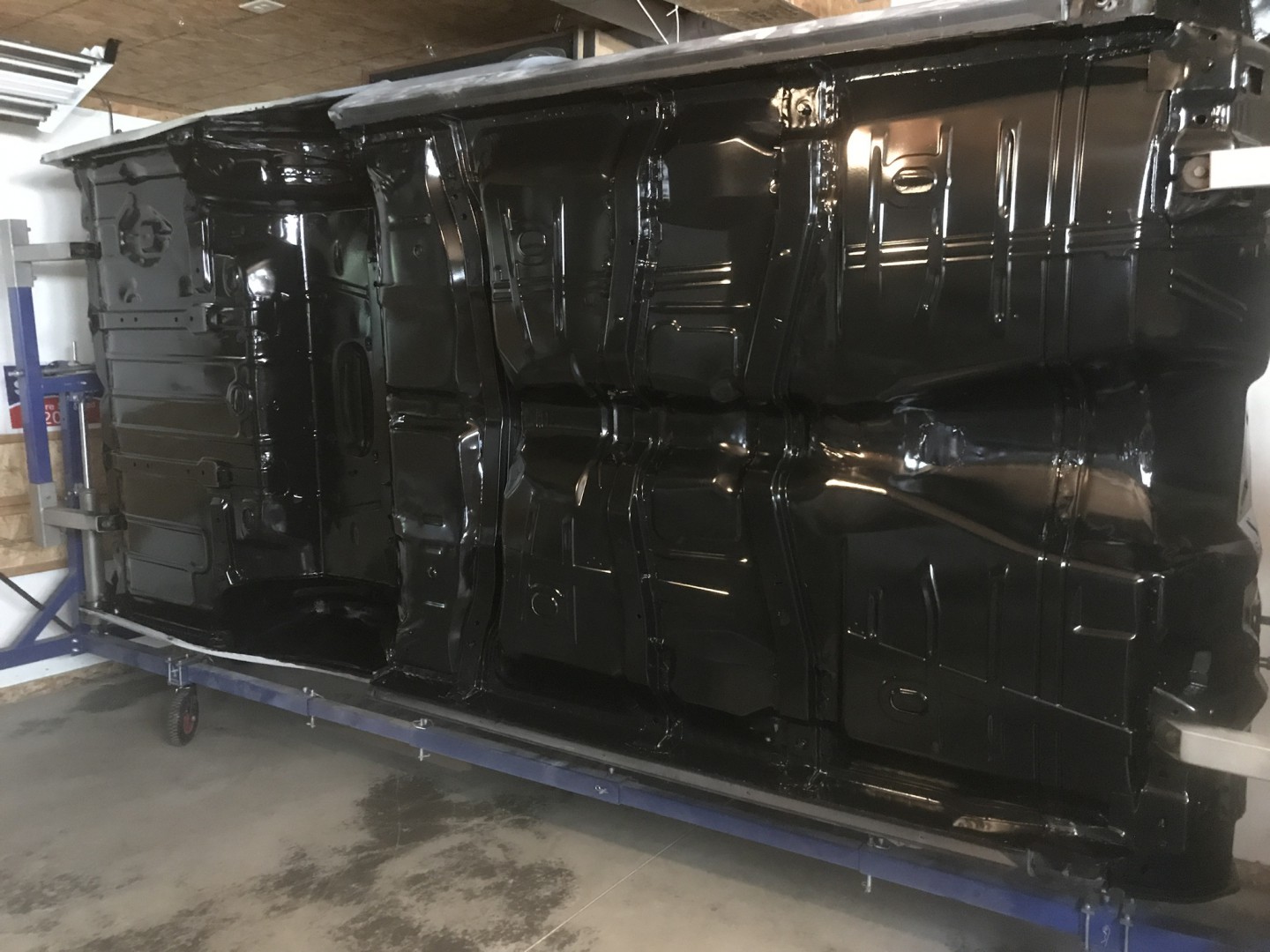

Seams to be getting to the point where i will seal the deal?
I noticed it looks like you used the galvanized floor plugs. Just a note that paint doesn't like to stick to them, so suggest a good scuff with a Scotch brite pad before priming/painting. Especially if you put any in the trunk area and try to spatter coat them. I had issues with that when I restored the vert.

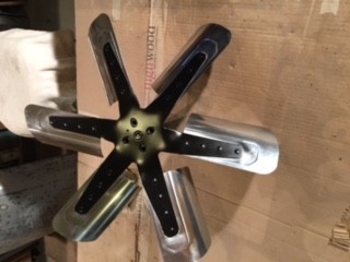

Did not take a before picture, but here is a bit of "extreme detailing" of the fan, which had rusty blue paint and dull blades with some sort of brown streaks.
Starting to get it back to the point it can be moved out of the garage so i can get it ready to prime.
Looks good Bruce. It looks like a factory fan but with stainless flex blades?
Ya, I think they might be SST.

FWIW Bruce, I had a flex fan like that and ended up replacing it with a factory AC fan to keep the temps in a normal range on a SBC. If yours is staying cool, no worries.

Thanks Stan, No A/C and the engine runs cool, at least as i recall from ~4 years ago. Lately is is always at room temperature.
Saw one like this listed for $99 in a Chevelle catalog that came with the blue paint.

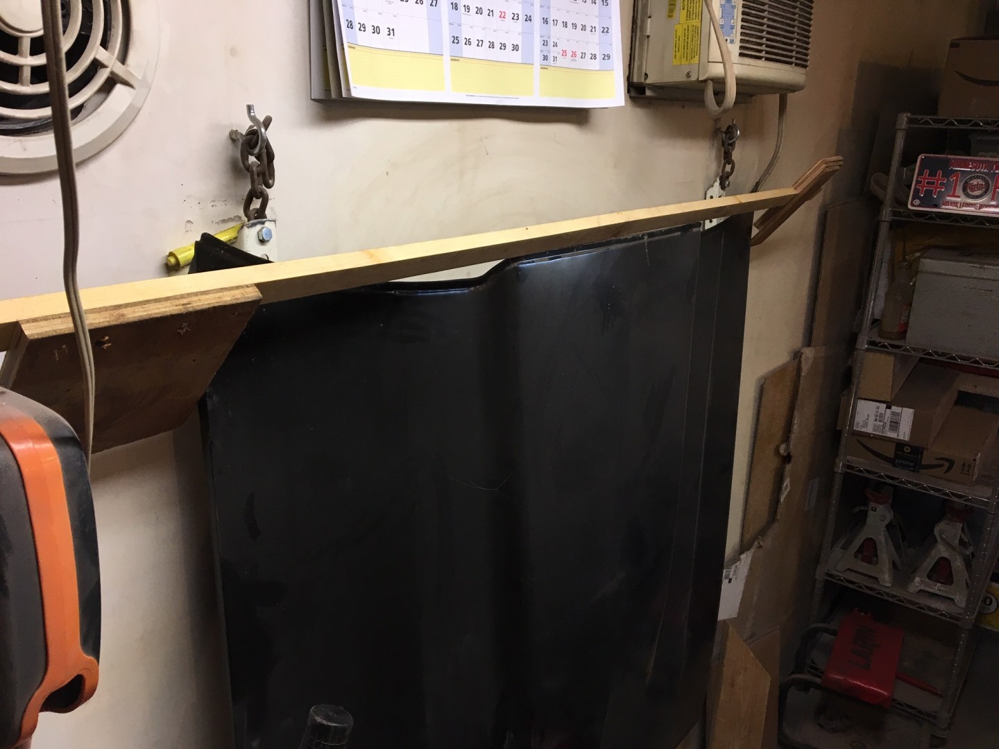

Ever wonder how to measure the exact width of a cowl hood? one way is with a wooden caliper like this. setting up the fenders for proper gaps

Had to go up higher too on the drivers side, removing flat patches on top of rusted parts and then cutting them out.
Will have to fab up the two layers then on to installing the the whole new panel.

Getting there.
Looks great Bruce, I just painted my on again off again floor pans and trunk project.
-- Edited by dashboard on Friday 3rd of August 2018 06:47:47 AM
Thanks, yours actually look great (as in better than new)!
I'm happy with the improvement on mine and that there are no longer flat slabs of sheet metal scabbed here and there.

Floor is now sealed and the project is moving forward to the doors and front fenders.
Looks good Bruce!
Thanks Stan,

Nice template. Hopefully the hood stamping is consistent from side to side, but that should get you in the general area from what I know...
I'm sure Dashboard is happy that you're utilizing wood somehow in your project, as that's his thing.
The hood is a GM OEM part and very consistent top to bottom
