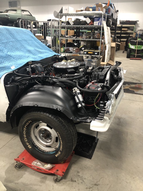

Have Ron leave the headlight "buckets" a tad loose until final fit of grille and bezels. I found it's easier to get all those pieces lined up and then snug the bucket bolts.
Any attempt at brake fluid yet ? Hoping the stainless line mods don't leak.

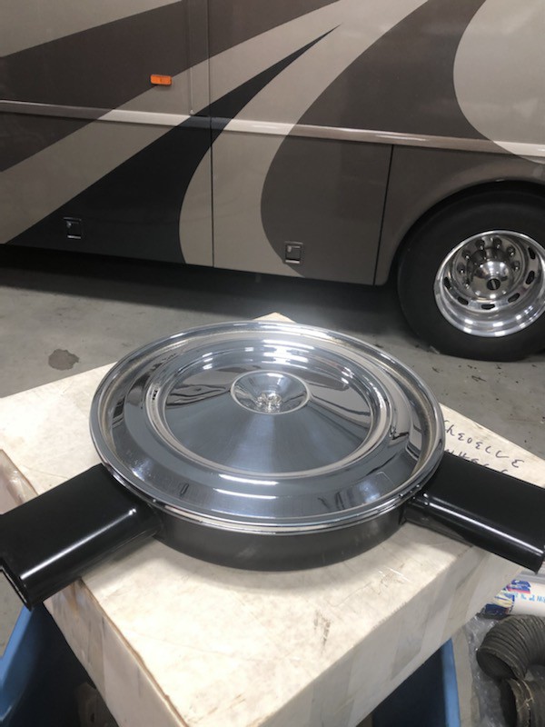

LOVE that air cleaner. I need about 4 of those...
Jul 10, 2020
Not even sure what that air cleaner was really for.
Liked the look. I think the real L-79 ones were centered on the sides.
No brake fluid yet.

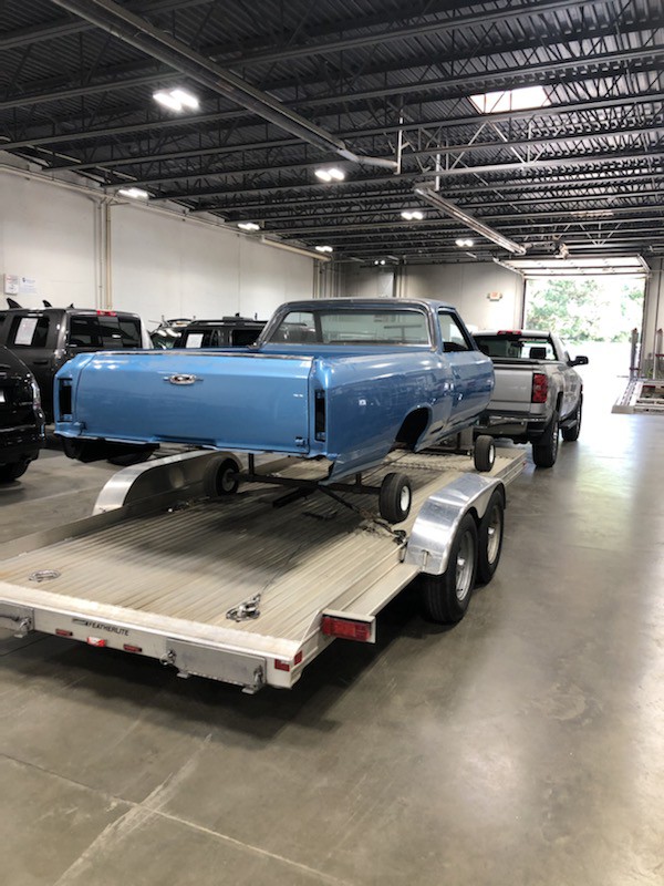

Wed, left at 4 am for VA to retrieve the '66. Got home at 7:30 this morning... 2,400 miles in 52 hours.

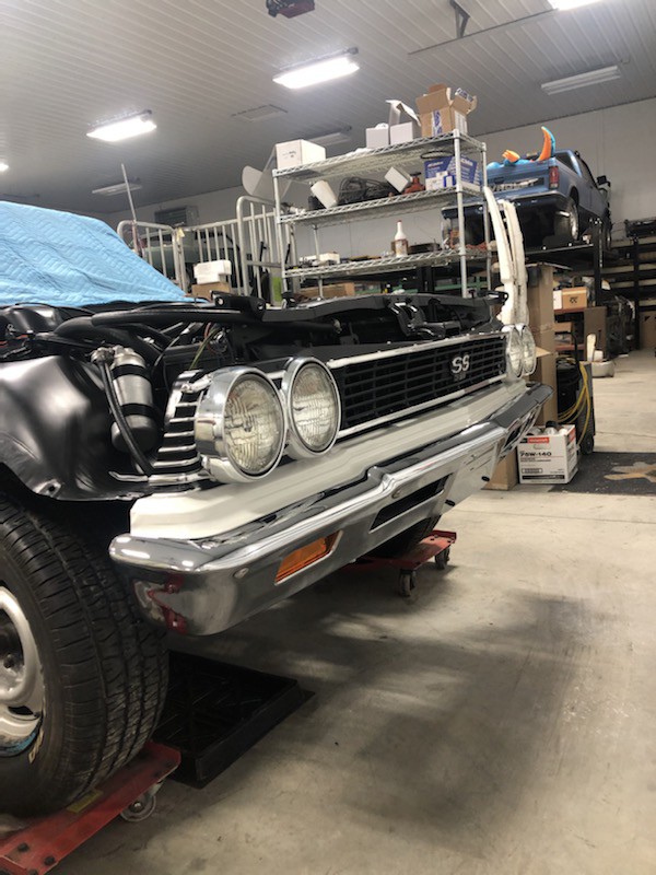

"Cwazy" Ron is moving right along.

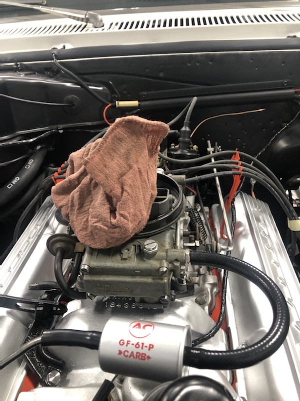

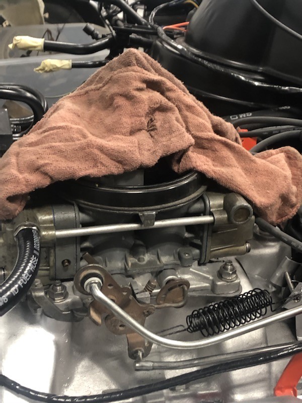

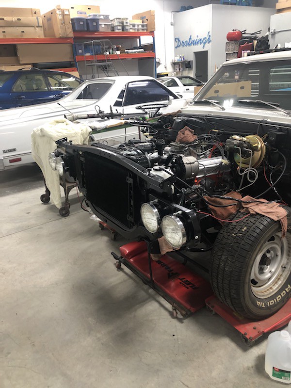

Will still play with shroud clearance, however, really close to fluids and firing.
Lamps are brand new T3s
The correct early style.
Also getting an SS style blacked out grille for contrast.

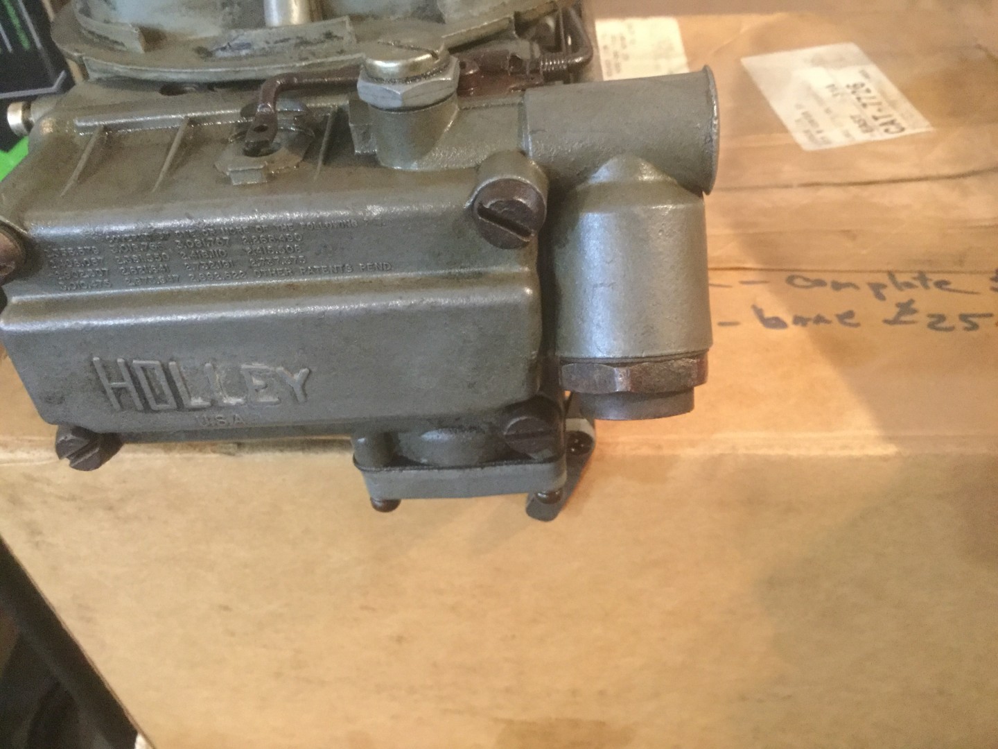

Is the fuel filter placement temporary ? Seems it could cause vapor lock and boil over, being on the thermo housing ?
Jul 21, 2020
Looks like the front fuel bowl should be changed to the other design; but that bowl is hard to find. The threads are usually stripped but there is a guy o n TC that rebuilds those hollers from 66 with a heli coil installed in the front fuel bowls inlet.
Thats the front fuel bowl I plan to use on a holley from 66 on the SB slated for the 66 convertible. Here’s a photo of the carb. No issues with vapor lock on my 66 SS for 15 yrs now same design.

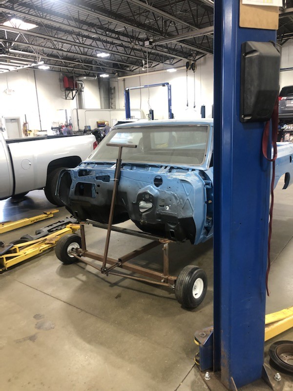

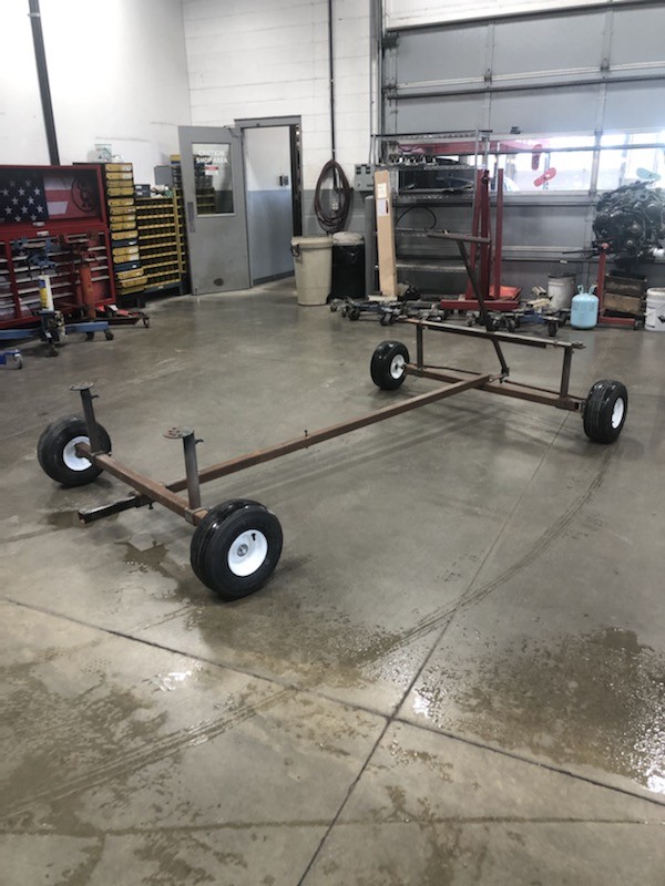

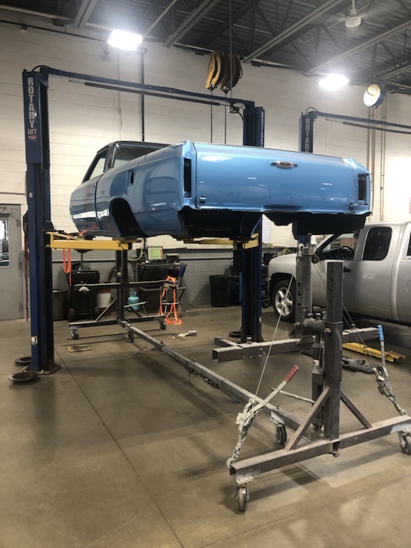

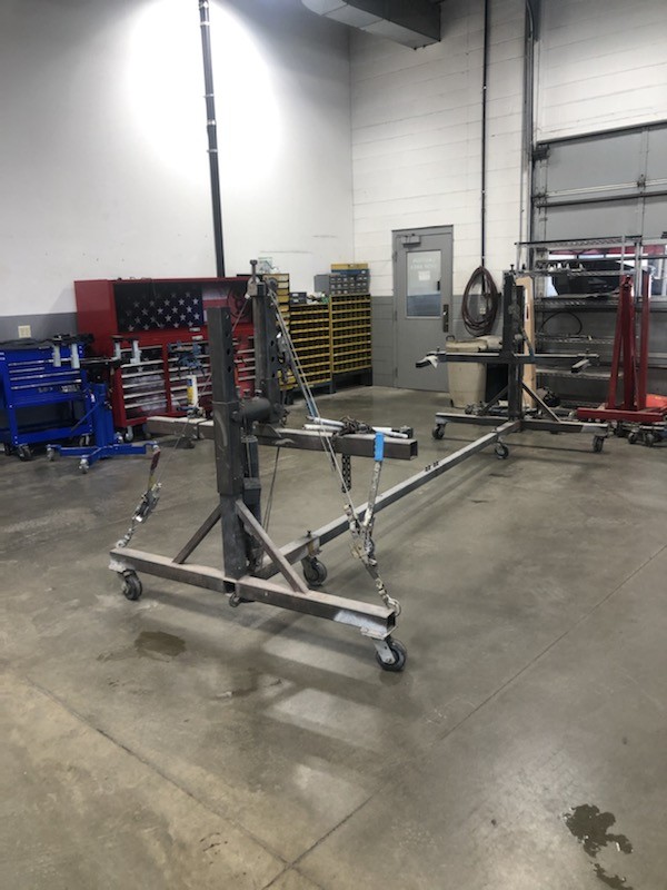

Karl. Is that body cart something that was purchased or did you make it?
Aug 20, 2020
Bought it from a friend. He built a couple of them. It was originally used for truck cabs. Also adjustable for length and width.
I have used it under both ElCaminos. Mitch also used it under his Chevelle. The bar at front mounts was added. It stiffens structure and is preset for front body mount width.
Only had to make one minor adjustment for length, because Greg (original builder) just replaced all axel stubs, freed up steering and lubed everything up. I chased down the fresh wheels and tires, he made everything work.
Remember, I am a BS'er not a Technician or a fabricator. Karl

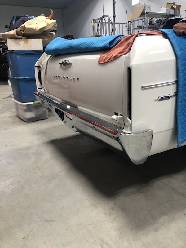

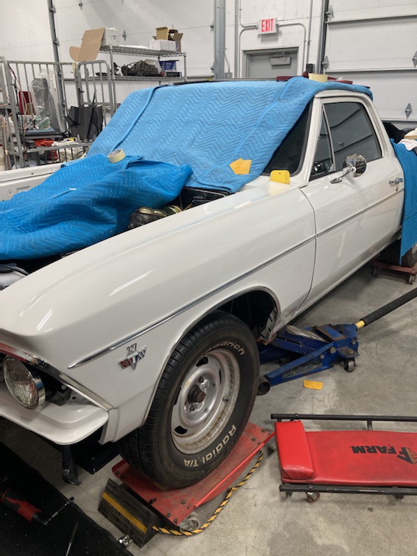

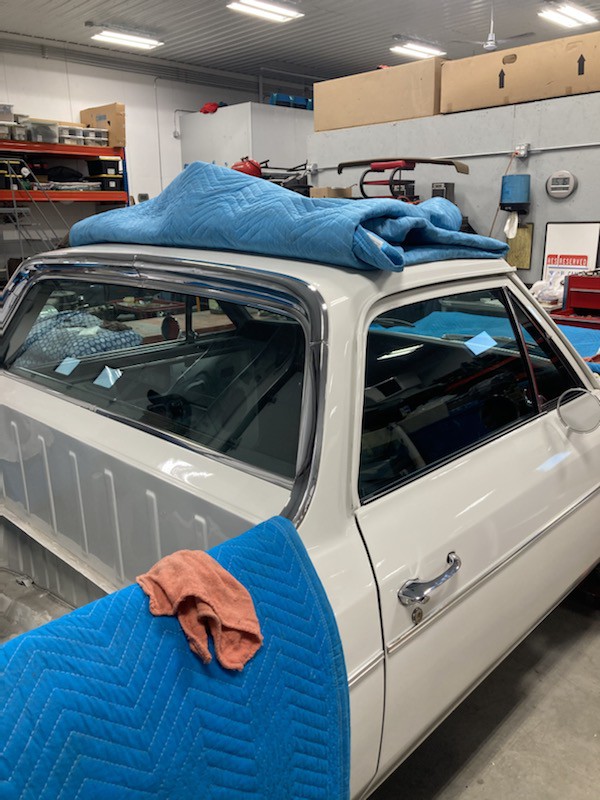

First picture is an example of the two color lower front grille filler.

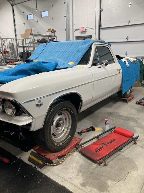

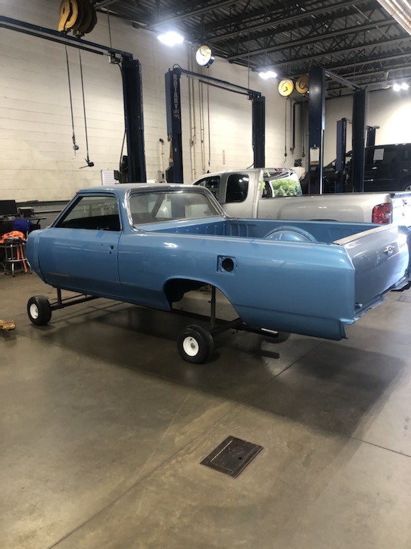

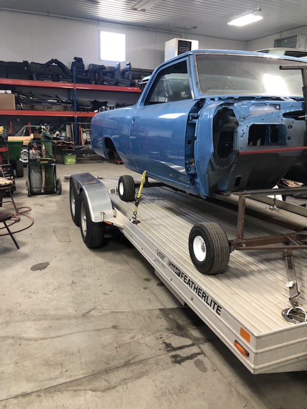

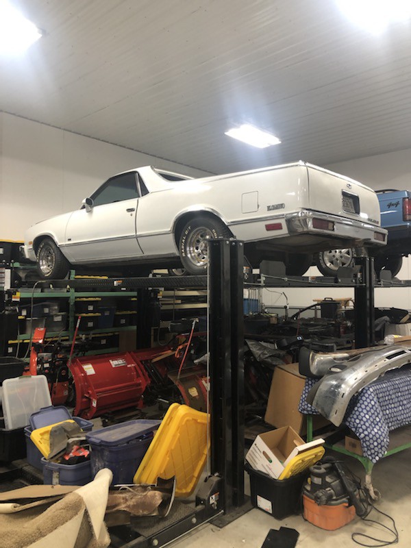

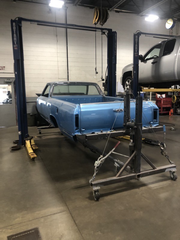

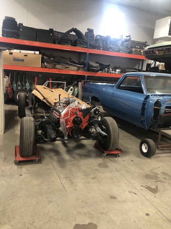

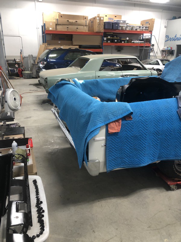

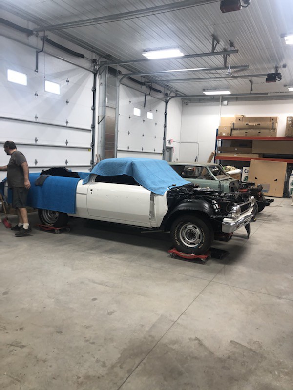

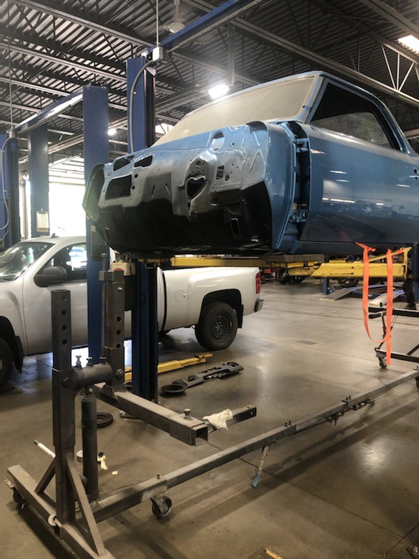

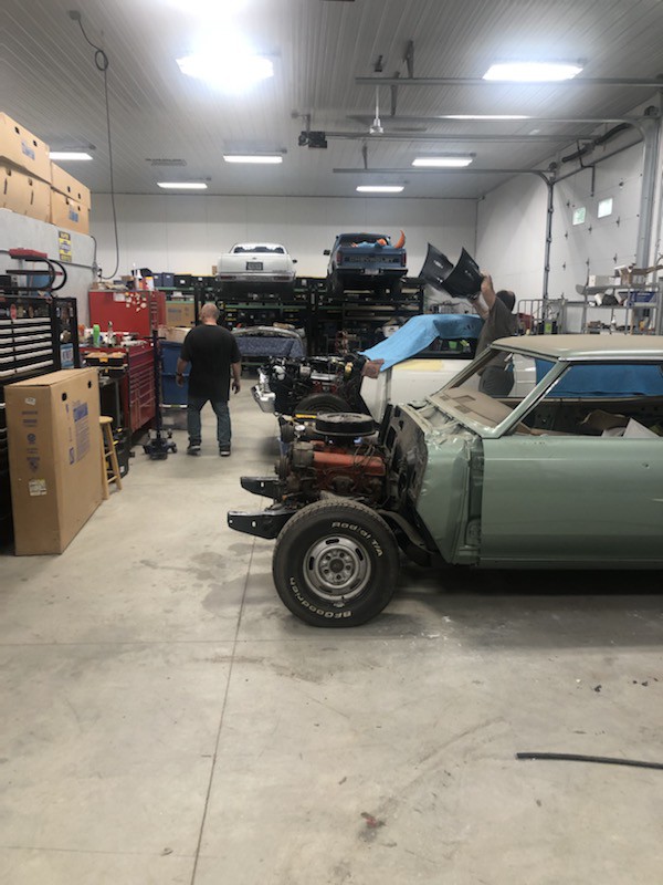

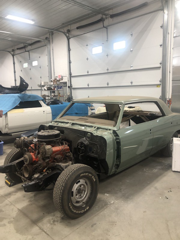

Made some major switches on Sunday. White G-body Elky up on hoist waiting for Pypes exhaust. (ordered today)
Pulled the Green Malibu 4dr. Hardtop car down for some winter work.

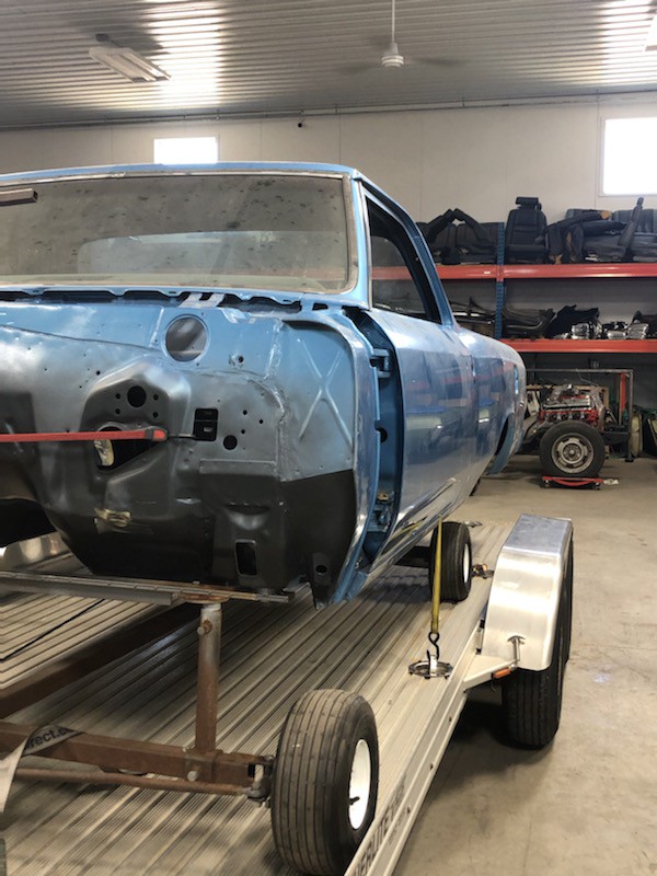

Blue Elky Roller frame and shell cuddled up waiting for some attention.
White Elky turned around closer to firing and more fitting and assembly.
Ron and Scot are the major drivers on this, I just try to stay out of the way.

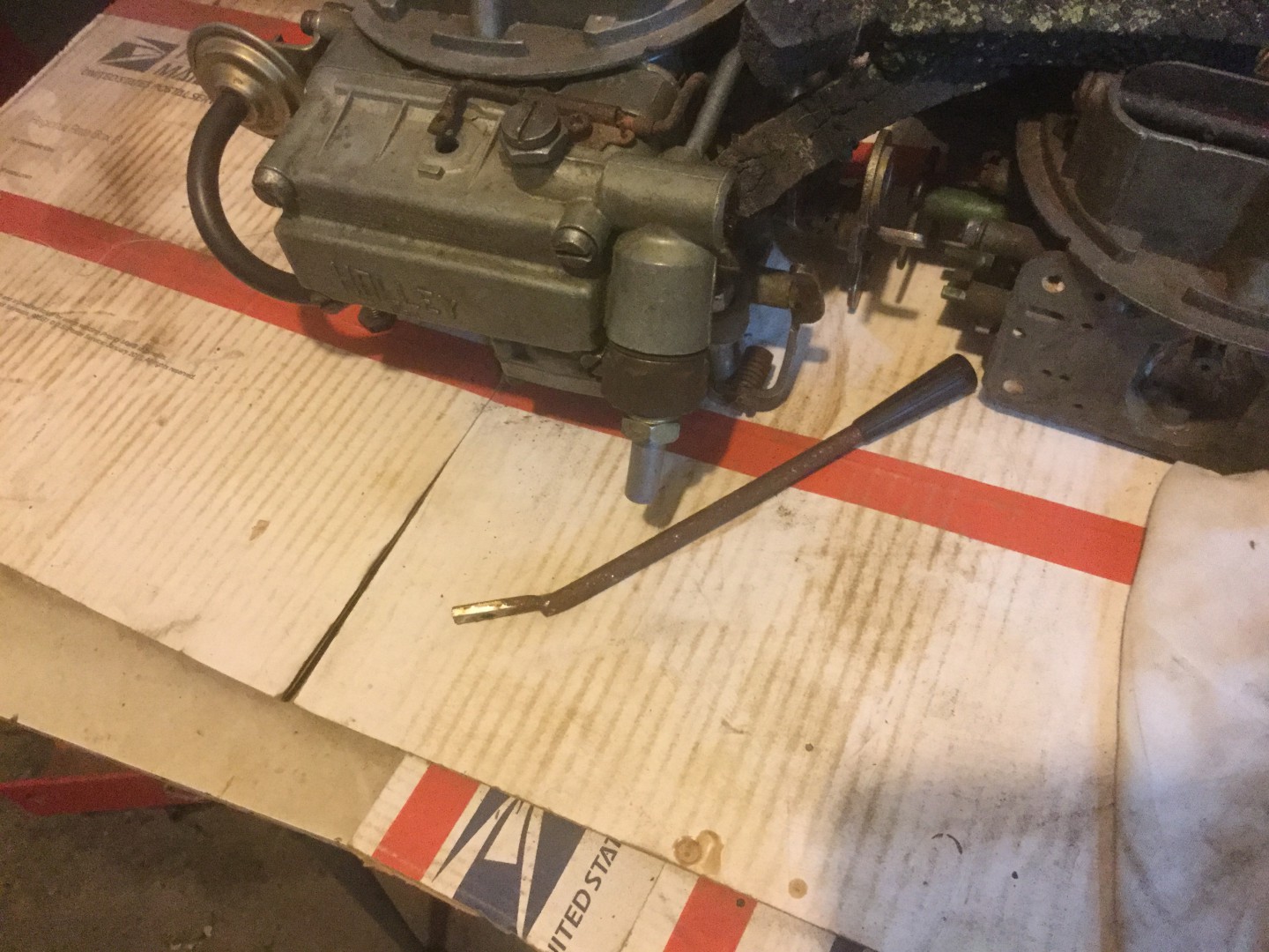

this is suppose to be the correct fuel line for the a corvette 300HP or 350HP, 327 engine for 1966 Or 1967, or 67 chevelle, the L79 not available in 66 chevelle, holley carb list 3367. Bacicaly the same carb for chevelle carbs from 66 for 327 with holley or L34 or L35 with holley. This is the front fuel bowl. Thought you might be interested as this is what I plan on using. For some reason I can’t seem to load the photo.

Ron has been busy. He and I fitted doors and tailgate. (pain to do) He got all holes drilled for power window wiring. Boots and wiring are installed and bedded in sealer. He loaded trim, handles and mirrors on both doors. By the time the glass is installed, we will have parted out 5-6 doors for misc. glass , power regulators, vent frames and hardware. Remember we started with a complete car, nothing missing. Just sorting through 15+ years of acquiring parts and choosing the best components. Adding rally cluster, knee knocker tach, power windows, tinted glass. Changing interior to Black as he found a really nice dash pad, will end up using Malibu Door trim panels. (PUI) Still sorting and cleaning for Big Block Elky and the 4 door Malibu hardtop. This car will also get a black split bench seat, with armrest from a 66 Pontiac. The Multi-color doors shown will be fully stripped and scrapped. Some might be usable, however, too crusty for us to save anymore.
Yes he will be detailing bolt heads prior to installing and fitting fenders.

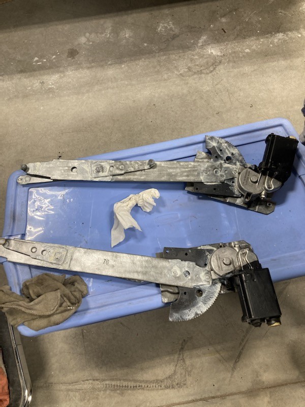

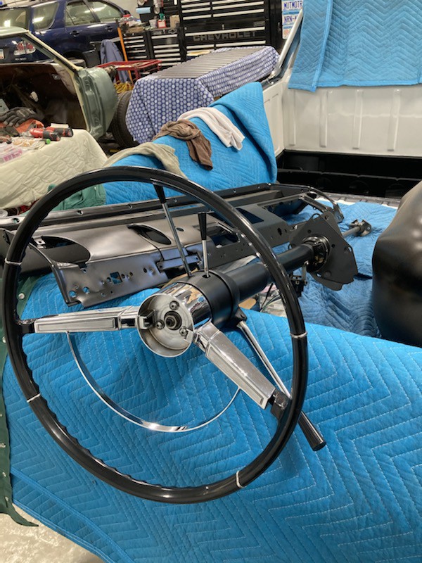

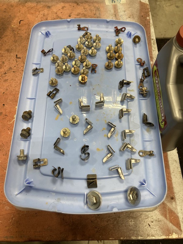

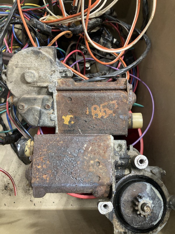

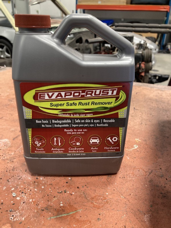

Still cleaning and prepping parts and fasteners. The power window motors I had dragged back from Pennsylvania, at least 12 years ago, were really crusty. Had some U-Pull spares from a 73 Buick Lesabre. Snatched them at least 10 years ago. Ron restored and transferred motors to cleaned up regulators. Will have strip Caulk tomorrow so he can bed the vent windows, install glass and regulators. Should be fun to see then go up and down. (we hope)
The other picture is a rust remover he used on small parts, works really, really well.
-- Edited by more ambition than brains on Tuesday 17th of November 2020 04:21:49 PM
I'm thinking the solution my hoods will be soaked in is something very similar to evaporust. Sounds like it anyway.
Tractor Supply has it in 1 gallon containers and 5 gallon pails. I typed j ug s the first time and the editor **** it out...

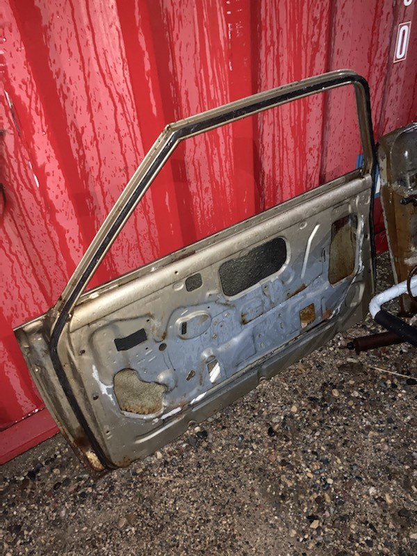

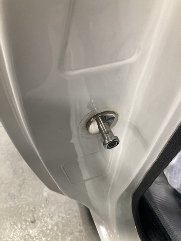

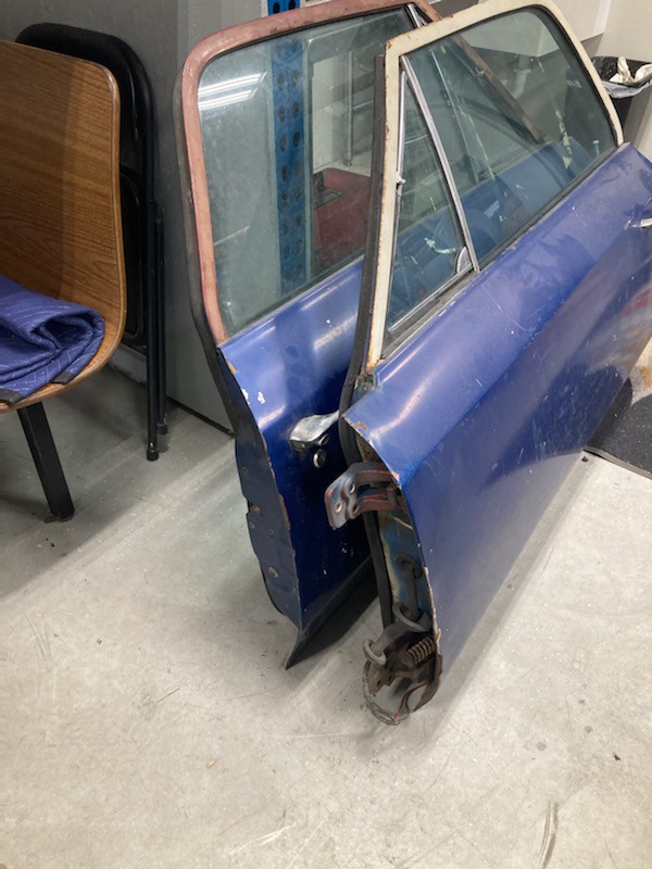

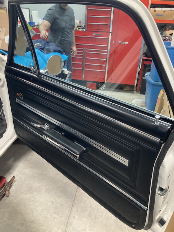

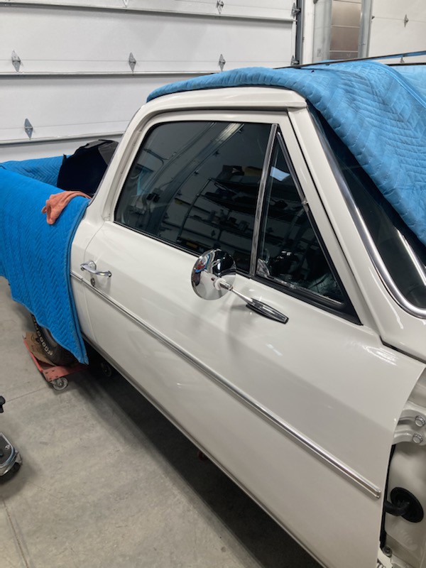

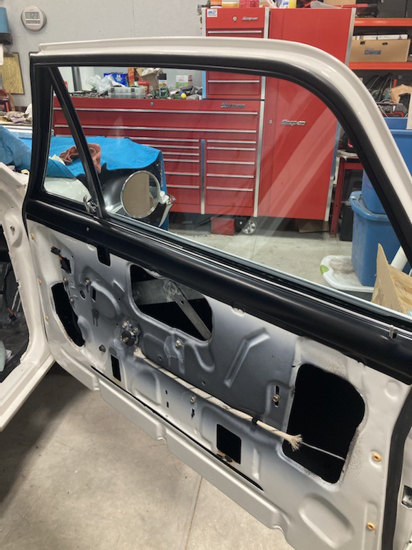

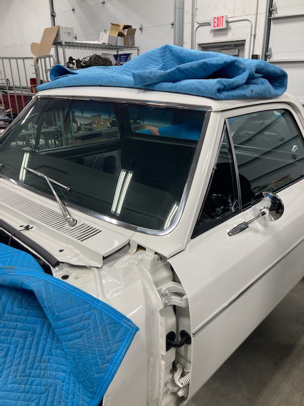

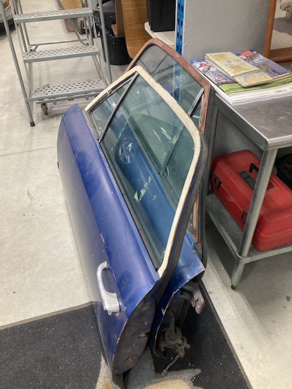

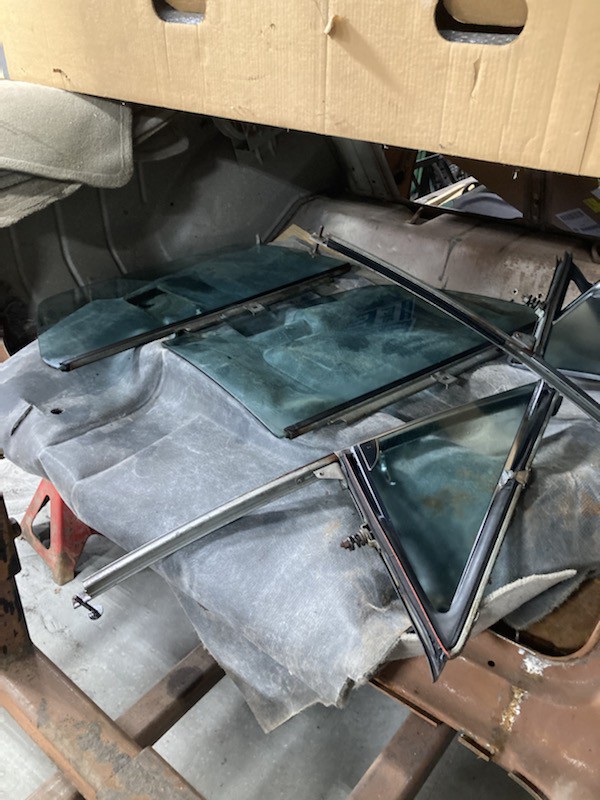

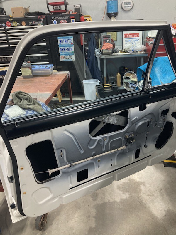

All door glass is in, even goes up and down.
Now has factory tinted, original glass from several donor doors.
Parts doors came from, Waco Texas (green), Eastern Pennsylvania (blue) and our friend Brett Jensen in Fergus Falls, Mn. (gold)
Those door pictures were in previous post. As stated before 5 different doors just for glass, regulators, hardware, plus that old Buick from U-Pull R Parts for motors.
Ron was able to soften vent glass seals so they are original (thanks WD-40)
For 50 plus year old salvage glass and hardware, it came out fantastic.
-- Edited by more ambition than brains on Friday 27th of November 2020 09:19:40 PM

Care to elaborate on the WD-40 trick with the seals? Sounds like it could come in handy.
Nov 27, 2020
I use WD-40 a lot.
It is a natural lubricant that is not really oily.
Displaces water, absorbs into rubber like a hand lotion.
WD does soak in and soften most dried out rubber or plastic.
Kind of a not too greasy lube.
Helps to gently clean grease off your hands too.
I will spray most old rubber or plastic before I try and remove, or install, plugs, seals, and weatherstrip are a good example.
Think of it as a lotion for non metallic parts.
Also makes a good slip fit lubricant.
Soap and glass cleaner also work well for slip/tension fitting.
For softening and cleaning, just spray on and forget about part for a day or two.
50 to 60% of the time it will "freshen" the rubber enough to save and reuse.
We had the luxury of multiple vent assemblies to choose from, Ron "cherry" picked the best ones.
Pretty sure one of the ones he reconditioned came out of a 4 door sedan door from Waco Texas, a dry, baked vehicle.

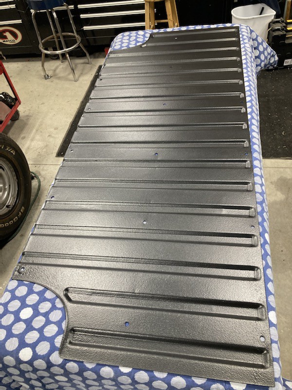

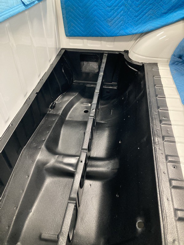

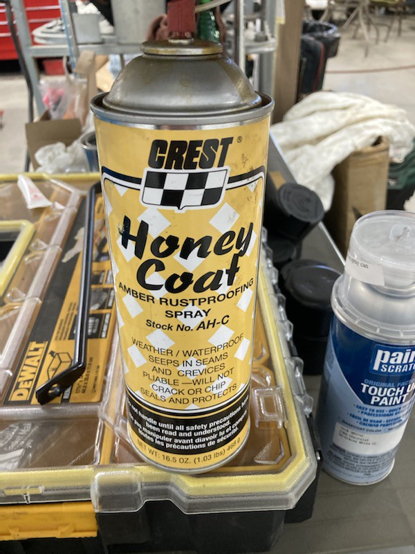

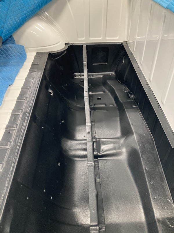

Rustproof and undercoat Smugglers box and underside of cover. Trim panels on doors, hinges touched up, new stainless/chrome strikers, and refreshed steering column.

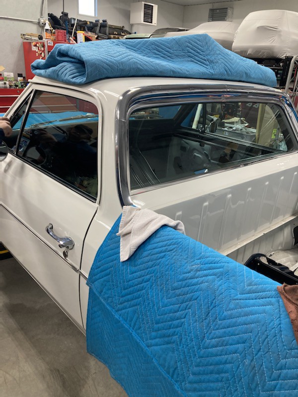

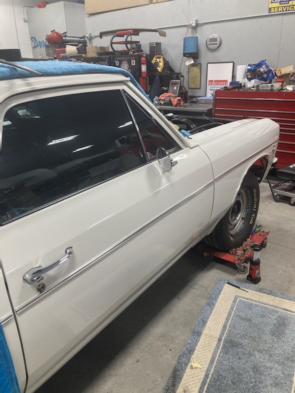

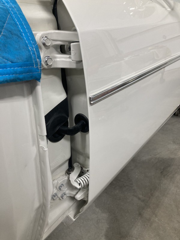

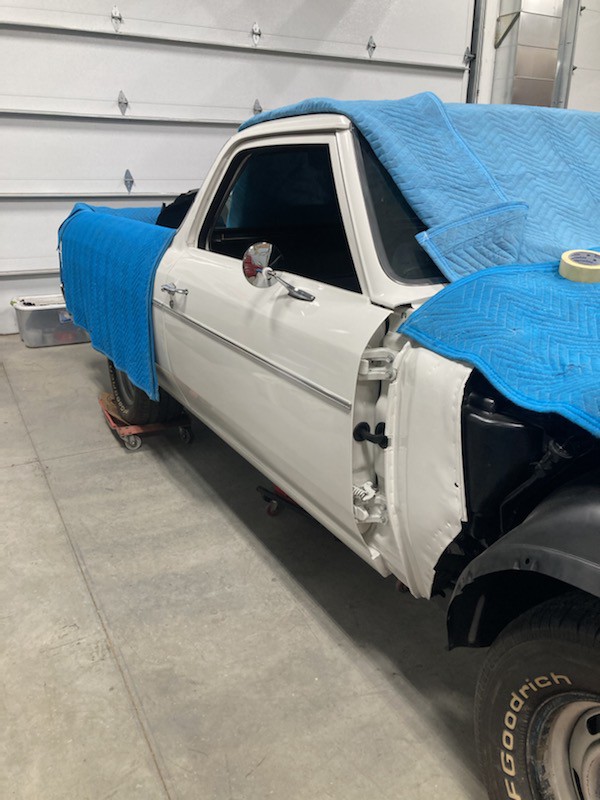

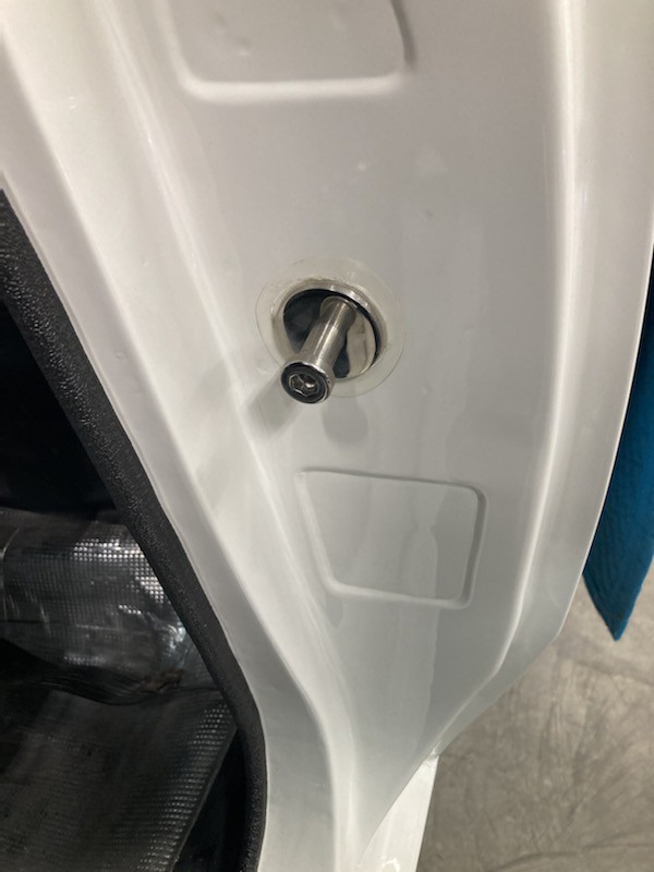

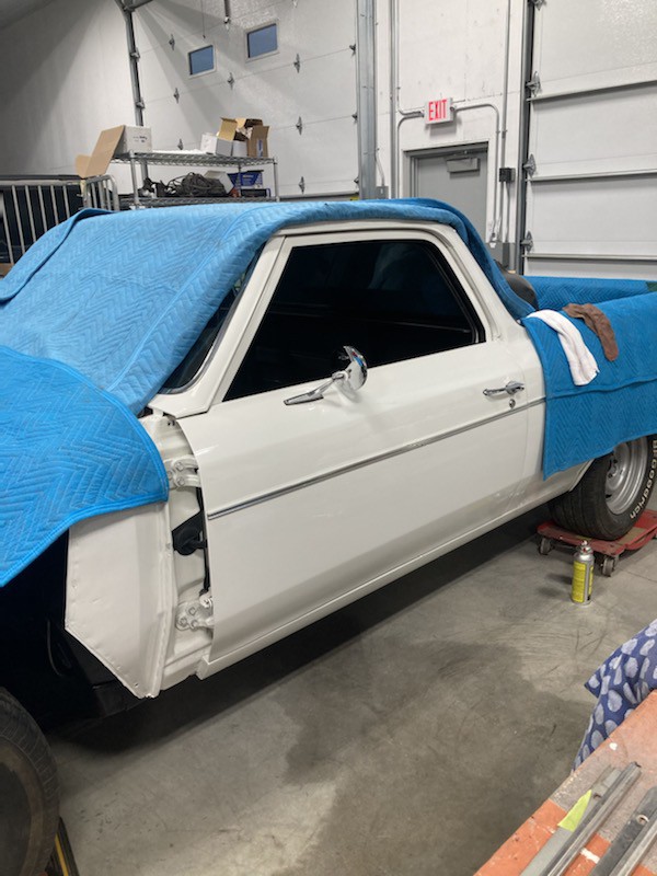

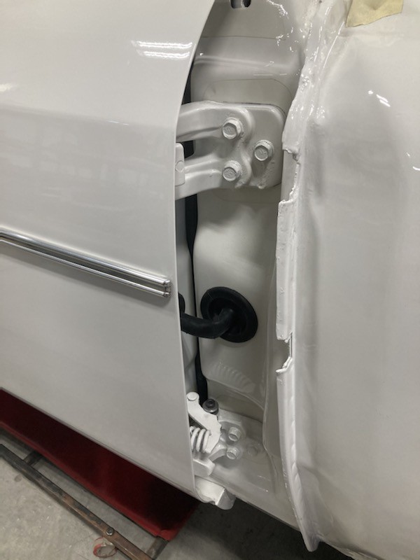

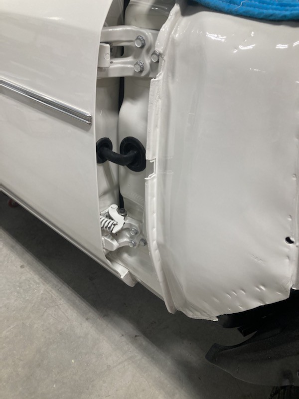

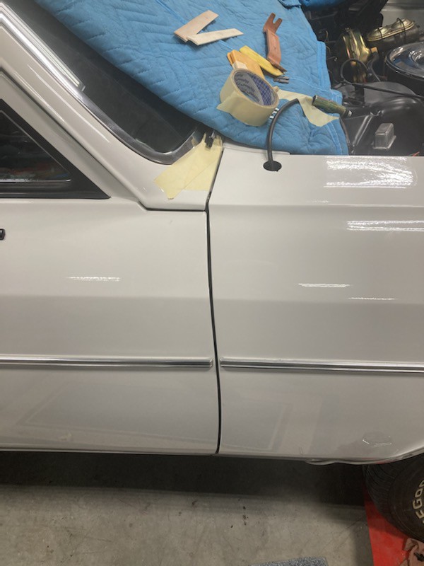

Keep fitting, re-fitting and re-fitting again.
L/f Fender and Door.
R/side Fender was already on and removed to refit door.
I'll take the hinges, if they are going to scrap !!!!
Right side looks great...move along...
Dec 29, 2020
Hinge bolts are frozen in. Soaked them, still stuck, too lazy to heat from inside at mount plates. I try to avoid any open flames inside building. Uppers are nice and tight, lowers pretty decent too. A couple of the tapered Philips bolts were replaced with hex heads at some point.
I have multiples in stock, so I did not try very hard. At this stage, not planning any other 1966 builds, too many others "in the que"
They are yours if you like.

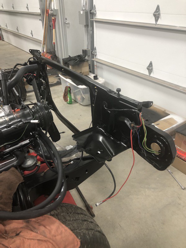

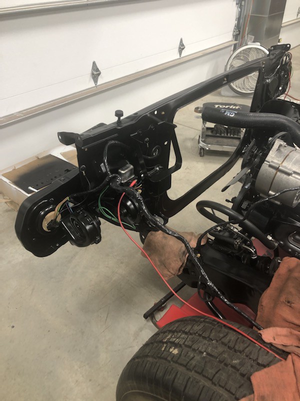

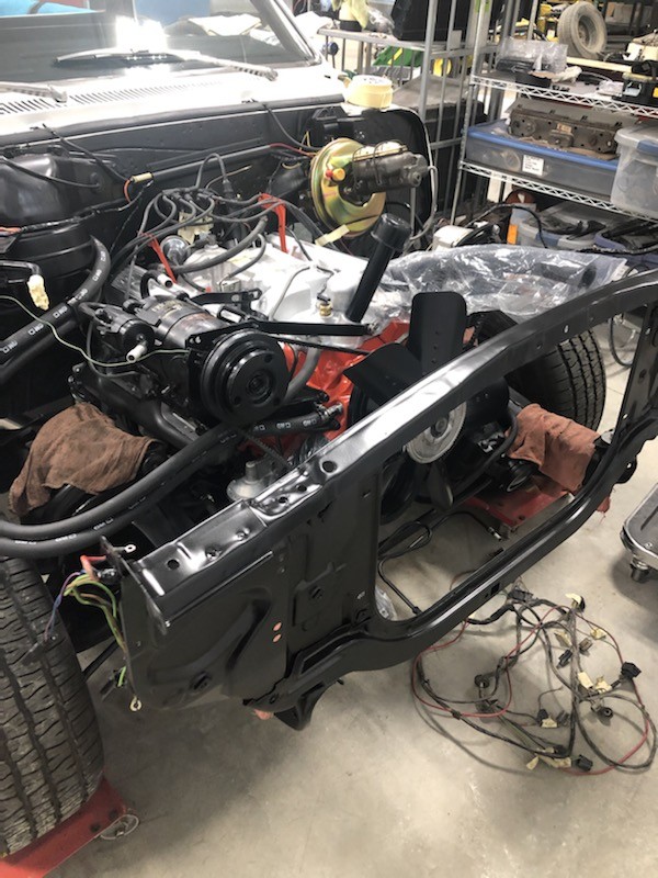

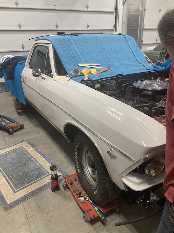

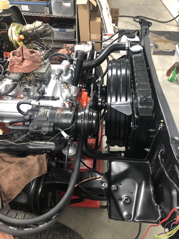

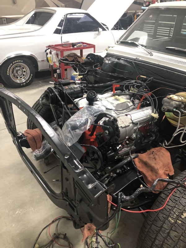

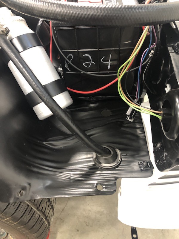

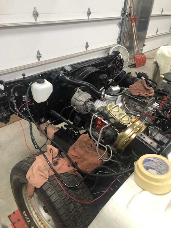

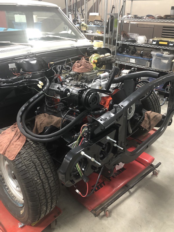

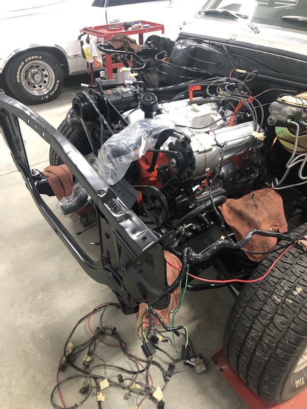

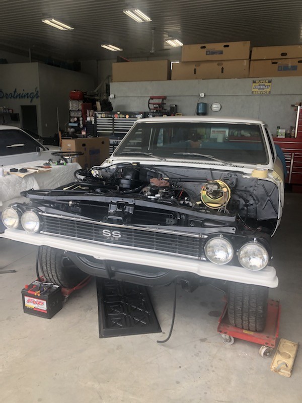

Core support in place, hoses clear, detailing wiring and misc.

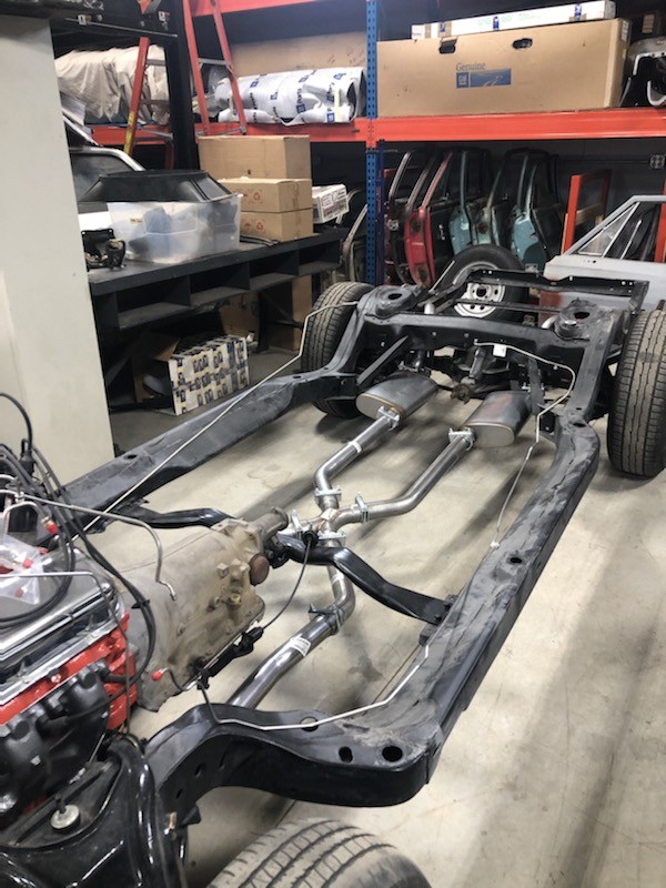

Last picture is Blue Elky frame, exhaust just slip fit, needs cutting, adjusting and welding.
Waiting on some line clips.
Thinking Ron will have everything for core support on White car by the end of next weekend.
Might have to fuel it, carb it, set spark plug gaps, add coolant and fire.
SOON!

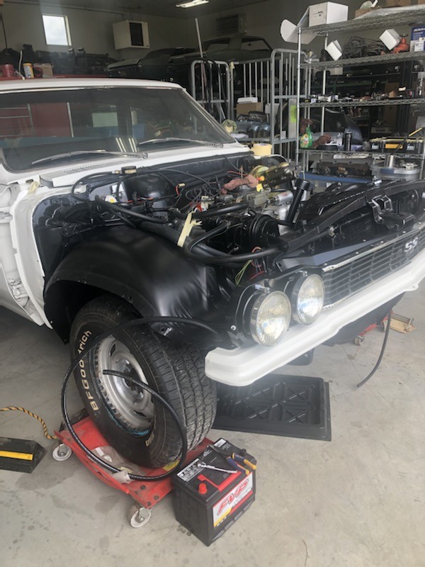

Carb is on, core support is mostly loaded.
Radiator has pin hole from storage, was new core.
A/C condenser restored.
Will get radiator fixed, and start adding coolants and trans fluid.
Getting closer.

Ron is doing a great job on the Camino, but, yeah, sounds like he is getting a little carried away with detail now...
V
-- Edited by jim larson on Tuesday 21st of July 2020 04:53:04 PM
It has add on filter or valve of some sort.
Bowl has a breather or relief valve of some sort too.
See photo.
The carb on there now is the one that came off vehicle, had mickey mouse fuel lines, filter was lower.
It is rebuilt and ready to go, will chance it for now.
3/8 ni/cop brake line. You could make a nice 180° bend and eliminate much of the hose, while bringing the filter away from the housing a little...
Just a slight beginning of a flare on the end will prevent the hose from slipping off.
Don't comment on SS 386 emblem, not my decision.
Hoses are not a cosmetic match, but are designed for 134A, drier tooo.
Caught Ron admiring his work!
Blue Elky going from Rotisserie to Body Cart.
Please note "stylin" new shoes on cart.
OWL or RWL sidewalls were not available.

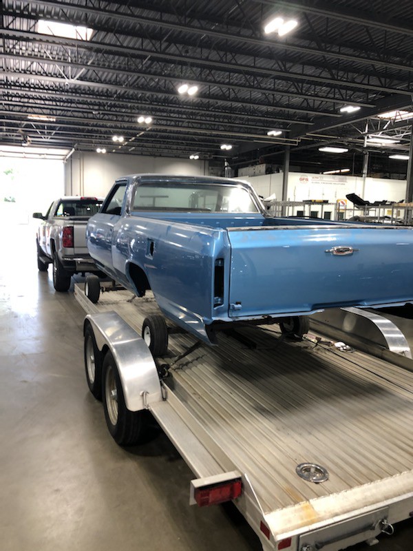

Blue car to Treasure Chest, Roto to Burnsville.
Blue Car relocated and ready to be tucked in at the Treasure Chest.
Chassis and Shell are now within 15 feet of each other,
Ron playing with bumper fits on white car.
Next: Blue car off trailer, work on Chassis plumbing, and Blue Body.
White car: Pull doors, drill for power window wiring, assemble doors and final fit.
Once doors are final fitted, Dash is mostly done, front Sheetmetal can be installed.
Get column in and dash wiring complete.
Continue prepping for firing motor and breaking in Cam.

Did the El Camino's not have the argent silver at the top of the front valance ??
He needs to paint the headlight bezel extensions to match the grille for an original SS appearance...
Yup on the silver.
Both Custom models and 300 Deluxe were combo lower face was body color and upper argent.
Color split was underneath where the moulding would be on a Custom/Malibu/SS.
Ron chose to white it out, at least he was OK with chrome bumpers.
I will share with him your concern abut making aftermarket parts match.
It would look better.

Ron has been busy.

Focusing on door assembling and Dash wiring.
Soooo, close to firing motor.
looks like you are a fan of the evaporust?
Will have to get some and try it out
Ron sure is, he was very pleased with results.
Here are a couple of pictures of the window motors we did NOT use. (crusty things)
Still glad I bought the ElCamino doors as they had tinted glass and the power regulators are definitely different.

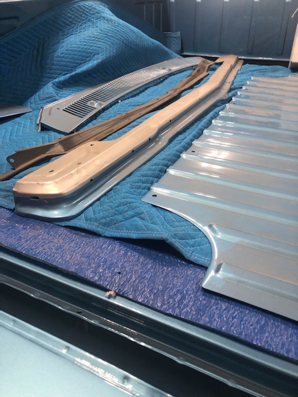

The rust proofing is overkill, however, it will still go to Ziebart to pull frame rails and balance of 1/4 panels.
Baby Steps, Plan to fire motor on Wednesday.
Ok, R/F fender on this weekend. Fits are improving, we keep tweaking.
Fairly pleased with r/side, left needs more hugging.
Did I say I despise fitting doors and fenders on this body style.?
Still having fun even though these can be a pain.
Fired motor Wednesday before Christmas, Roger broke in Cam and played with timing, have a vacuum issue to figure out.
Great oil pressure, no oil or antifreeze sprinklers either.

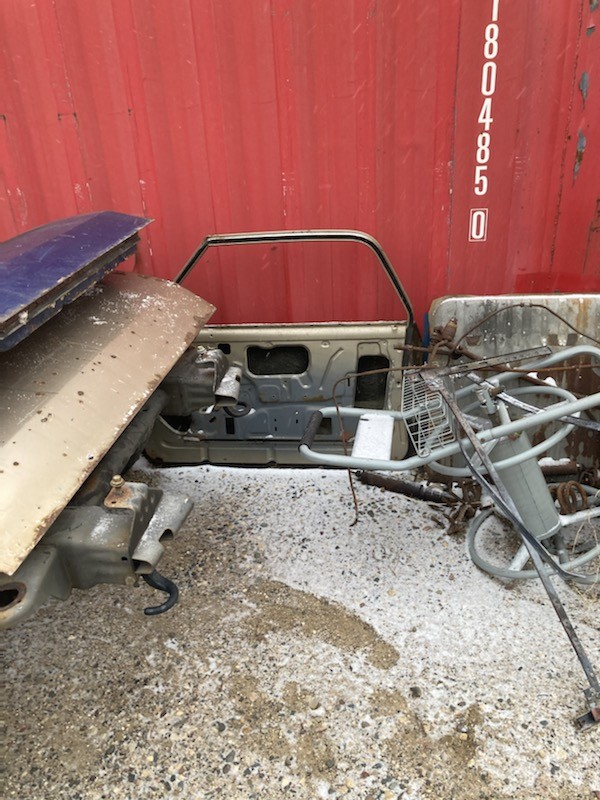

Scrap doors
Trying to prove I am not a total hoarder, and am capable of letting some things go.
NO rush.
