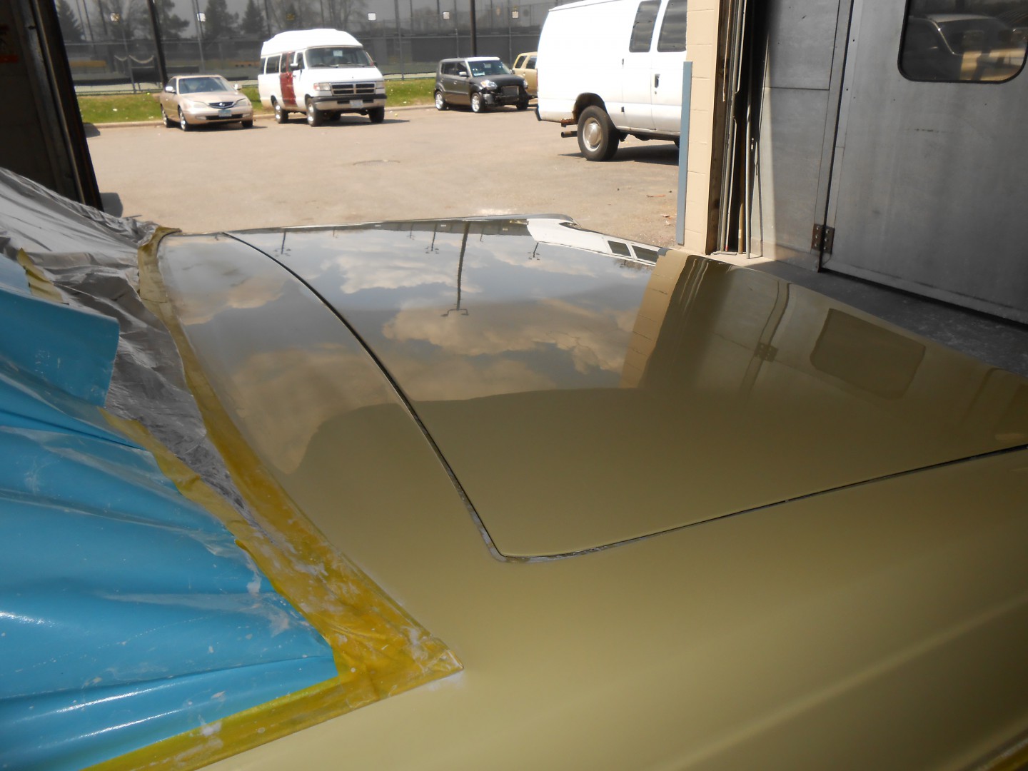

Not much to see but it’s getting really close now; buff and polish time then trunk paint and it’s out of there; but I need to pay the bill first.
It looks GREAT Kevin, but WHY did they put the side trim on and have to work around that before the final buff ???????

Mitch, that’s a good question, they did the same thing last year with the El Camino. First they cut and buffed the areas were chrome/emblems go then installed the chrome/emblems and cut and buffed the rest.
I was surprised to see tape over the chrome, the only thing I can think is they know I spent a lot of time on the chrome. I was in and out of there quickly today; I wanted to be at Derek’s by 1630 to pick up the El Camino; I’ll ask the question the next time I‘m there.

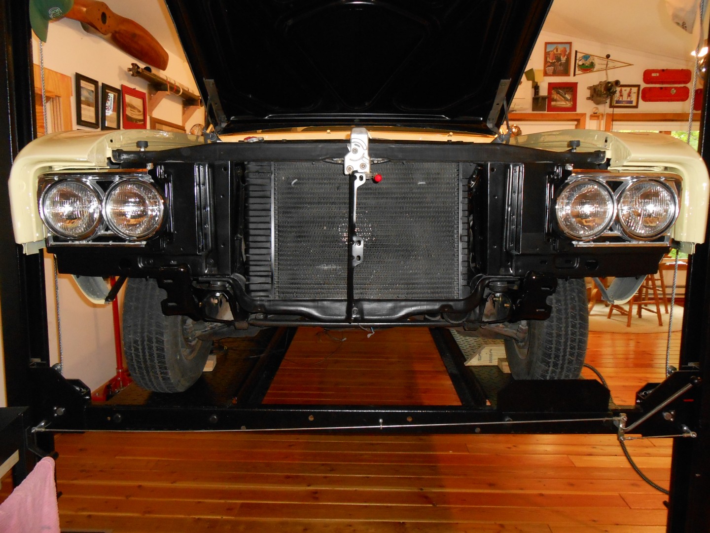

Tomorrow we start on the Classic Air and forward lighting.

I dont think that will be a problem. Car is LS powered and....an A body that has 4 headlights.

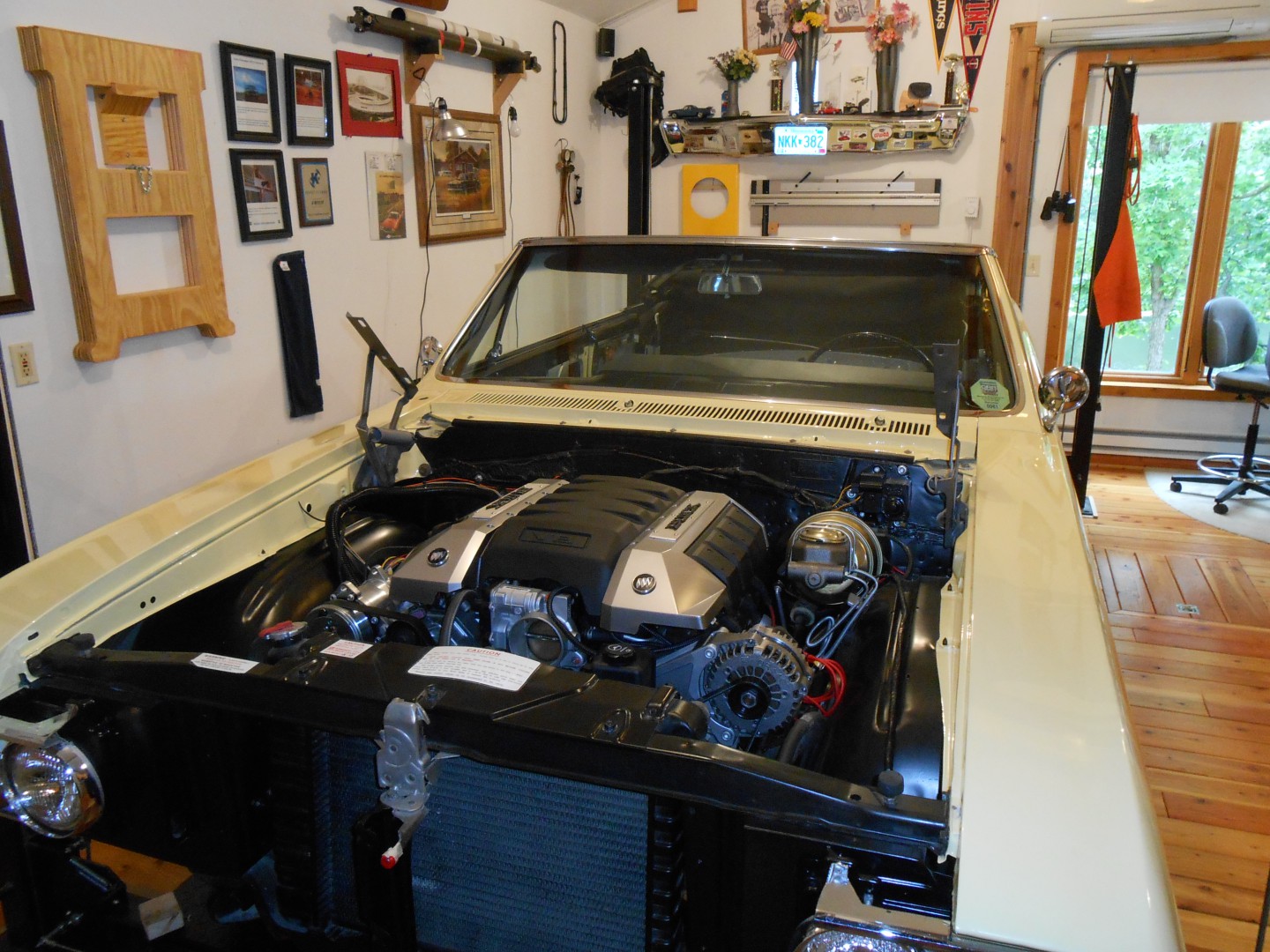

These arrived late yesterday, time to getback to work.

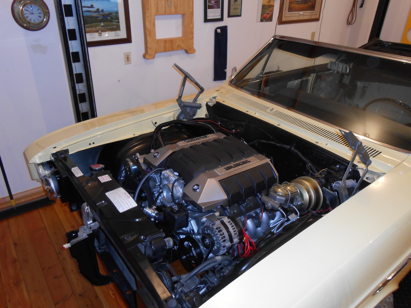

Well it's back in with the new mounts only a 1001 things left to do now. I’d also like to drive it before Car Craft, but that’s only a dateline out in the future at the rate I'm going Sept may be more realistic.
I’ve changed my plan on air conditioning, I am going to install a retro Mark IV under dash unit. I plan to return my Classis Air kit, I need to pay a restock fee and shipping charge so if someone is interested in a AC kit at a great price send me a PM or give me a call.
Looks like the factory put it there . I'm liking the Holley Accessory mounts more all the time. I might have to look into them in the future.

I love that engine cover, it is going to confuse so many people. It looks great kevin, want to do a 66 chevelle next?

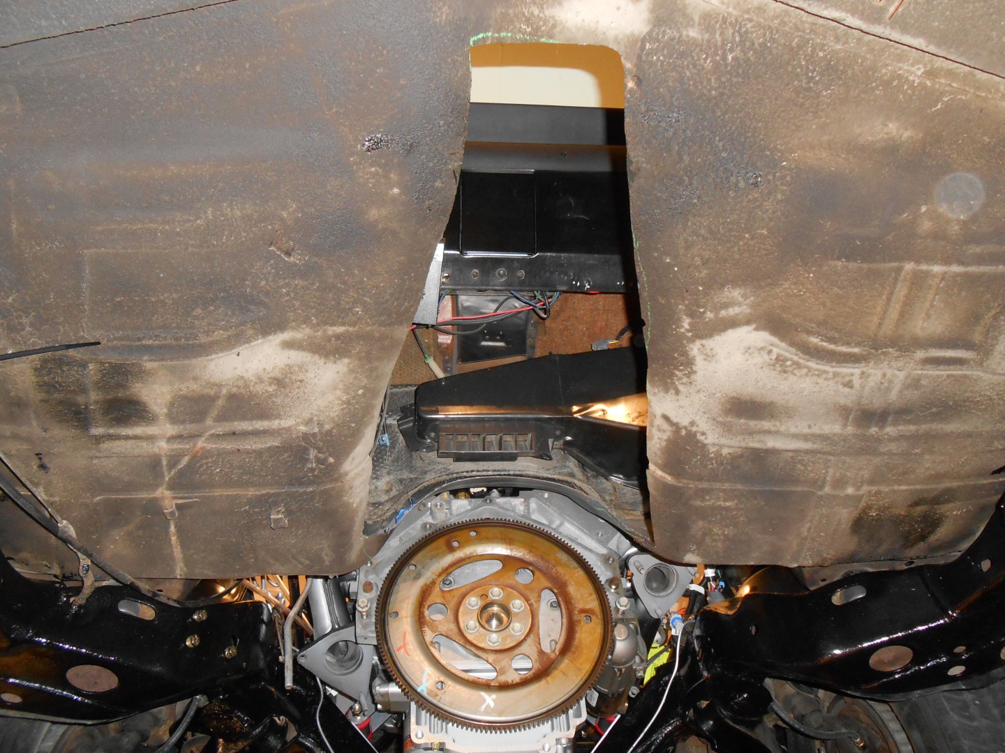

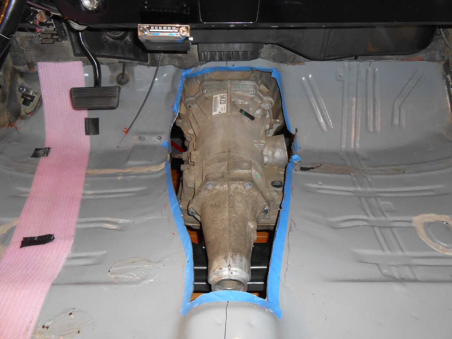

I really did not want to do the cutting but it had to be done. Tomorrow we’ll cut out the patch panels and start laying out the new ‘turtle back’ for installation. Should I weld it or user 3M automotive panel adhesive??
Next comes computer location under the dash between the glove box and radio is the current plan , then just 998 things left to do, closing the gap quickly don’t ya think.
Oh my I could be becoming one!
I say weld it if you can, then cover it with insulation.
Heck..if you'd planned to cut the tunnel, you should have gone T56! LOL!

I cant get over how killer that engine cover looks.

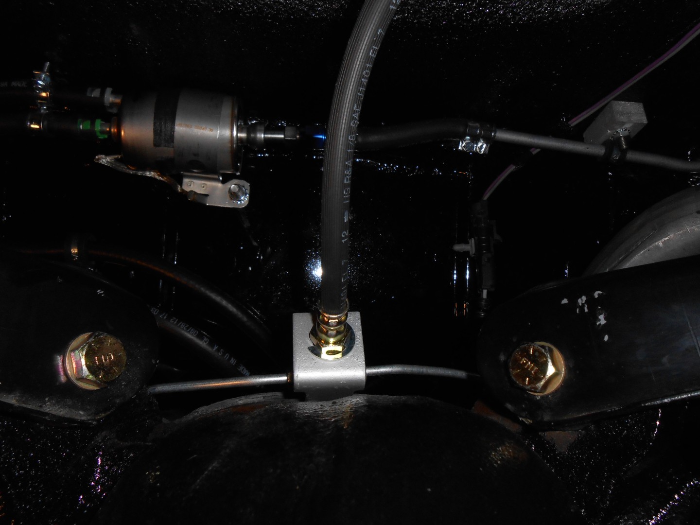

Might not seem like much but the fuel line is installed and connected the engine. It took less than two hours to install the line, it took four hours to make five bends and install two clamps on the frame rail. Unlike the old fuel line that goes through the frame just behind the driver’s front tire the new one travels up the inside of the frame into the engine compartment. It needs to clear the shifter linkage and emergency brake cable, then go up and around the brake distribution manifold, clear the speedometer cable and then start toward the engine just under the brake booster. 3/8’ steel line and it all needed to be bent by hand in very close quarters; ok, so I’m whining, it was a PIA
That mock-up transmission case that John at Master Transmission loaned me is great, it only weights about 20#, two bolts and it’s out of the way.
Tomorrow I’ll complete the installation at the fuel tank. I was going to do it today but I want to install the driver’s side tailpipe first to make sure there are no conflicts.
Ok the tunnel will get welded. I think 3M body adhesive would be strong enough but JD makes a good point if we ever need to change it or readjust it welding is the way to go.

Today I reinstalled the transmission mock-up case so we can complete the exhaust system. Then as soon as the exhaust system is done I’ll remove it and the transmission case to make ready for the real transmission install; I ordered the 4L60E from John today.
I’m trying to work out two issues with the bell housing. The bolt at ten o’clock simply can not be installed with the engine in the car. I looked at using a stud but there is no clearance for it. I don’t want to bash in the firewall so I’m going to open up the dog ear on the bell housing so I can slip the bolt in from the side, pixs latter.
The other issue is the bellhousing alignment with the GM Muscle oil pan. On the oil pan only the driver’s sides bolt lines up. Bryan is checking something’s out, more on that latter.
Steve, Derek on your bellhousing is the bolt at 2 o’clock used?

I can see that 10 o'clock bolt hole plain as day thru that huge hole you cut in the floor. Why can't you leave an access hole with a cover in the new floor for that bolt position ?? Gotta be pretty close to the top of the carpet. Pull the rug down a bit for access in the future.
Jun 11, 2013
Steve, yep that’s how the pan and bellhousing fit together, it would be nice if there was a bellhousing out there that fit. If not it will go together like it is.
Mitch, interesting idea however, the picture I think you’re looking at was taken from underneath the car at a very steep angle, it is very deceiving as to the actual placement of the bolt relative to the firewall. The one to the right with the transmission installed gives a better view/understanding of the bolt location. The bolt is well above the carpet line and unfortunately lines up with the original accelerator pedal firewall through mount, the firewall is not flat there. I think if you saw it in person it would make more sense. I can either snip the dog ear or move the engine forward to install the bolt.
With some luck once the bolts are in it won’t need to come back out in my life time; the last transmission was in there for almost 50 years
Jun 12, 2013
Duh.......I see it now. I was looking at the trans case to bell flange....
I was kinda thinking the same thing about needing to remove it. Get the dang bolt in and forgitaboutit. If the trans don't work, let John deal with it...

She's a trailer queen in the making....
Any ideas on where your going to bring it for the convertible top or is top not needing to be replaced?
Kevin, what LED kit did you get for the tails then?

Chris, the LED lights are not from a kit they were hand made by friend of Barbie’s who was returning a favor; he may check in.
Each fixture has 30 individual LED bulbs that all illuminate in a bright mode when the brakes or turn signals are actuated. In the parking light mode only ten bulbs illuminate at a lower intensity setting, this is the result of some magic built into the fixture by the designer when he built them.
If there is any law governing the brightness or intensity of tail lights I may be in violation of the law; they are very intense.
Kevin. Is it a kit that designed just for the Skylark? Im interested. My brother might be able to use it for a 65 Skylark he has that my grandmother bought brand new.
