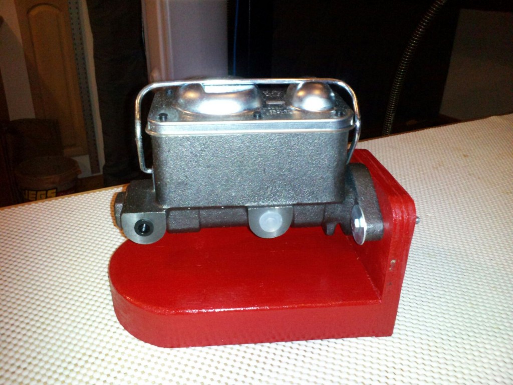

Still getting some things done, but struggling with bad parts. I ordered a master cylinder from a well-known vender (in a different time zone) along with several other parts. When the package arrived, there was no master cylinder so I call the well-known vender. I got the third degree from the guy on the phone “we sent it, it must be there.” Well it was not there, this was the first sign of the part from hell.
A week latter, they sent it out along with some other back ordered parts, more shipping cost. John (the magician) D. and I bench bleed it, as we where doing so we both commented on what we thought was a lack of flow in the aft reservoir. After installation during bleeding and testing our suspicions where confirmed, poor to no rear brake action.
I picked up a brake cylinder at O Reilly’s, John ™ D and I installed it today and wala, rear brakes. Sent the bad one back to the east coast, more shipping cost, so I now have $30+ in shipping cost for a bad part

Other than the PITA of it all, and dealing with brake fluid (don't ask Kevin about brake fluid...) it wasn't too bad of a job. We moved about 1-1/2 quarts of fluid through the system, and now know there is 100% fresh/clean juice all the way out to each wheel.
I'll have to give you a certificate of licensing for the pickle jar bleeder

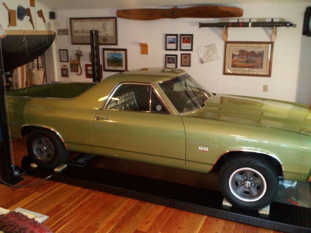

Little things take a lot of time but I had to incorporate some wood working so I jigged up a brake bleeding jig just for John D. Then I copied his vacuum bottle, with some improvements I might add.
This truck had the reverse interlocking column. In order to shut off the car the shifter had to be in reverse, then when the key is turned off the column locks the wheel. That linkage came out when I replaced the M22 with the RS500. I needed something to hold the column in position, my tach is mounted to that part of the column and it still needs to be in the correct position to turn the key to off.
I made a piece of linkage out of 5/16 rod stock about six inches long with four bends in it. It now holds the column in the correct spot. Just need to install a small grommet and its done.
Also made repaires to wiring in several areas this week. So aside from installing the seat the truck is back togeather.
Got the wheels back on, thanks again to Mike for the use of his rollers.

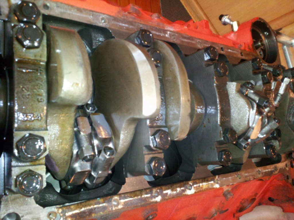

Jim, in August of 1988 I and a friend dragged this motor on its wooden pallet into the back of a pickup truck off a loading dock in Chicago, IL and installed it in my Elky. The lower end has not been touched until I removed the pan this week.
Today JD and I replaced the rear seal; after removing the oil pump we realized it is not brazed, it is welded, there are some other interesting things in there as well.
After replacing, the rear seal I found my torque wrench only go’s to 80 ft lbs, off to Sears tomorrow for a new torque wrench and bring it to 105 ft lbs.
I ordered an new SS emblem for the grill the one that came was much larger than the one that was on it. Turns out the 72 has a different (larger) emblem and my 72 Elky came with a 71 SS (smaller) emblem. I have seen several of these 71-72 quirks on this first week of October 1971 production Elky.
Now it's time to move on to the next phase, more power!

Craig, this stand of yours is outstanding; even with the block on it I can rotate it 360 degrees with one hand and a beer in the other, way cool….
And with 4 bolt mains too!
My oil pick up tube is also brazed by Mitch. You sure it was done by GM?

Making some progress, slowly but moving forward, sorry for the long read; I broke the engine down and delivered it to Competition Engine. Randy installed the cam after having it ground to his recommended specifications (see pix) along with the lifters. He then measured for pushrod length ordered and installed them. The heads where reworked and setup for the new springs.
He is a meticulous engine builder; in the past when ordering valve springs, he has seen large variations in spring compression values. On one Friday, he packed up his spring compression tester and went to his supplier in Minneapolis where he tested springs until he had the 16 sets he was pleased with.
Meanwhile I cleaned and painted small parts finished prepping under the hood and upgraded the new distributor. I installed a Pertronix III, reasoning the rev limiter might not be a bad thing for an old guy driving a stick shift car. Haven’t missed a gear yet, but I‘m not sure these hydraulic lifters will take the abuse the old solids would.
Then the engine came home, I completed assembly, finished painting and then I had to make the really big decision, orange or chrome valve covers.
