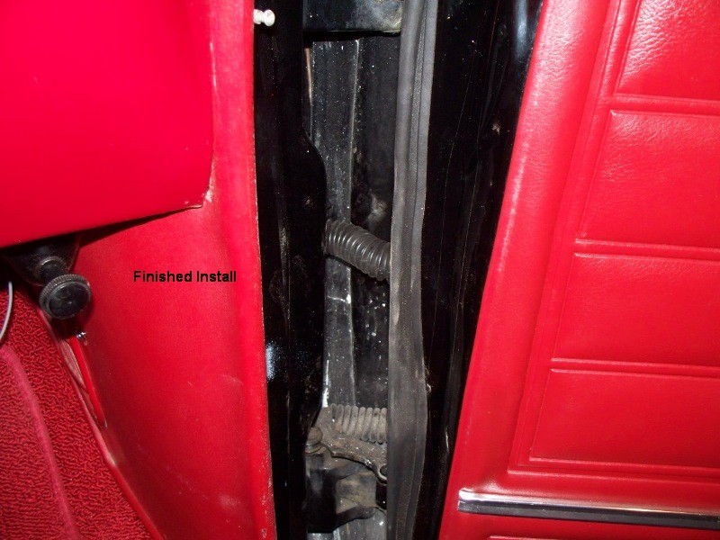

The parking brake cables came in today, and they're installed! Fit perfectly, and allowed me to properly adjust the pedal and have a real parking brake (and be able to adjust my rear brakes)!
I also picked up a new (longer) speedometer cable and got that installed. The 4L60's speedo fitting is about 8" aft of original, and I needed a cable about a foot longer.

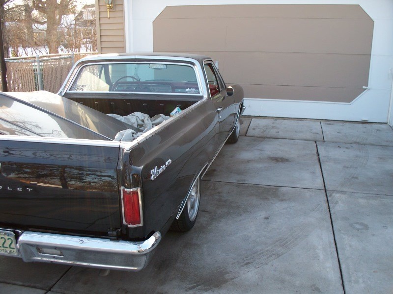

Under his own power, backed down the driveway, 1/2-way back up, then back into the garage. Now I can spend the remaining 86 days cleaning/detailing, taking a "real" maiden voyage, and tweaking...

Yup, and the darn thing kicked my butt yesterday carving a "doggy trail" into the backyard. Got a nice little "tweak" spot in my lower right back today!

Been putzing with "phase II" of the Smuggler's Box conversion...
I've always had the idea of a keyfob remote control for this in the back of my head, and through the generousity of a friend I've acquired a 3-channel remote setup!
Now way back in the day when the "yellow beastie '64" was my daily driver, I was working at Audio King. As a result I'd installed an Alpine alarm system with all the bells & whistles (including adding power locks to the car). When I tore the car down I saved the lock solenoids & linkage... you can see where this is going.
Enter option code JDWC48 - remote door lock/unlock/trunk release.
Problem #1: Blackie has ZERO power accessories in the doors (no windows/locks) - meaning no rubber accordion boots.
Problem #2: Not really a problem, but need to have holes through the inner and outer skin of the A-pillar/cowl.
Problem #3: How to punch holes in the door, of the correct size, in the impossibly tight confines of the doorjamb without removing the doors.
You can get a drill inside the door, but once in there it sits where there's no access holes where you can hold it and pull the trigger!... I've also got sheetmetal punches, but they're in the standard "electrical fitting" sizes (used to punch holes in J-boxes for conduit fittings)... but you STILL need a pilot hole (drill problem again!) to use the punches, and unfortunately they're nowhere near the correct sizes for any of the accordion boots I've scrounged.
Enter the bit extension and holesaws. The bit extension puts the drill in the rear 1/3 of the door where you can get your arm in there and hang onto it! Using the factory "dimples" in the cowl and doors, I drilled the required holes for the boots I scrounged at U-Pullit.
Blackie will now have remote power locks (that will auto-lock/unlock with the ignition like a new car), and a remote "trunk" release. JDWC48
I think I'm out of C.A.C.!!
I had to put the wife's car in the "service bay" today, and diagnose a "clinking" sound (busted RF spring!!), so Blackie had to move. So I moved him.
The hood is back on...
After the meeting today "Dashboard" Kevin and Stan stopped by and lent some muscle to this awkward task.
Now to clean off a winter's worth of dust & crud, and go for a shakedown run!!
