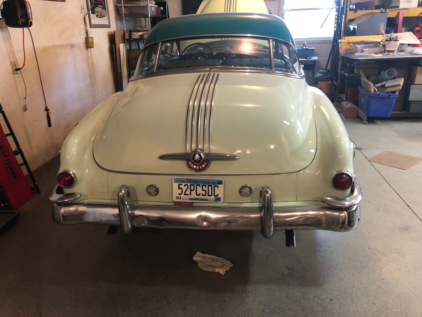

The Catalina has landed. It was finally, was time to get the car back on the ground, as all the necessary additions, repairs and rework are done (as far as i know at the moment) Pulled the "H Guard" off the rear bumper, prefer the simpler look and it is in poor shape (at least in my opinion). hoping to do some test driving fairly soon.
Lookin' good Bruce! Most of the salt is off I think, so get her on the road.
Looks like you went with a personalized 'regular' MN plate instead of a collector plate. Is that so you can drive it to the grocery store or for ice cream and not worry about being pulled over by a bored cop like I did with collector plates one time?
Thanks Stan, will be taking it out soon.
Was planning to register with some old 1952 plates, that meet the new restrictive letter and b=number format, however someone else had it on an old car already (consider the odds?!), so I called an audible

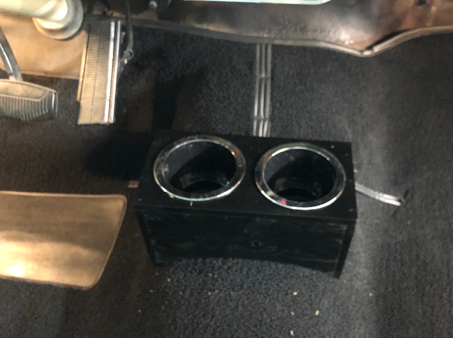

Good to be at the point where there is time for the "Nice to have" upgrades Made a dual drink holder

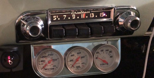

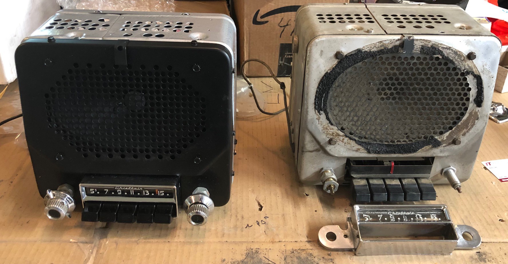

Got my "New Radio" back, AM/FM, Bluetooth Etc. Now if there are troubling sounds, I can always just turn up the volume
Needed a "Parts radio" to get a good one for the swap to a new system

Hot dog, you are really living the high life now...
Any way to connect more speakers in the rear deck ?
May 20, 2022
Yep and I have a set, the trick will be cutting out the holes, no "standard option provisions" in the rear shelf where you just cut the cardboard with a knife

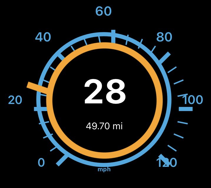

Rached up around 50 mikes and it ran well, lots of power and acceleration. Speedo worked again briefly, then stopped Made a bracket to hold my phone and use a speedometer app The other front hubcap popped off going over some RR tracks, for the weekend they are all coming off.
So, looks like my 52 two tone green Catalina hardtop will be the one with no wheel covers. Doing a few more checks on fluids and such and then perhaps get it cleaned up

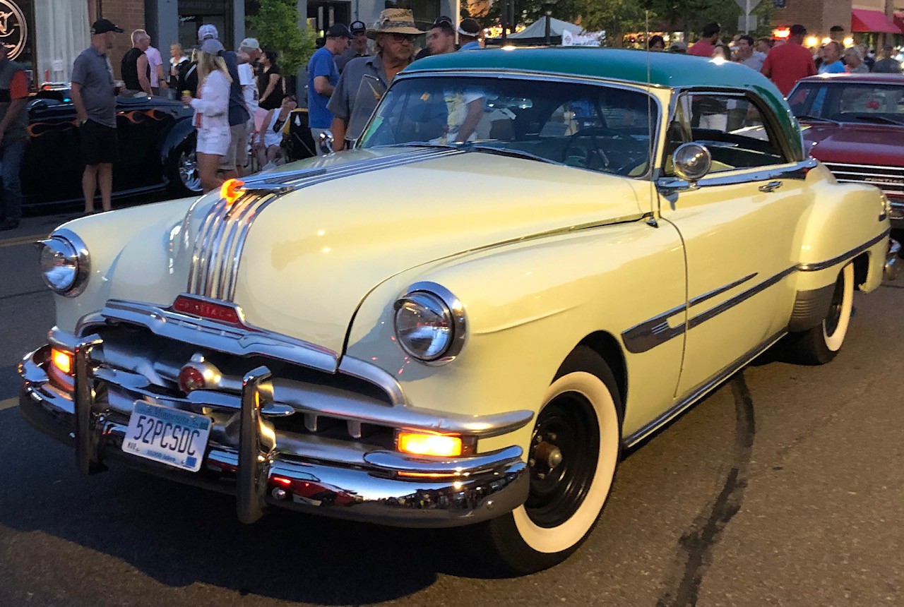

Went to Henderson Tuesday night, a Cruise to Webster Wednesday morning and to buck Hill Wednesday night. Next up is Pan-O-Prog cruise night, Friday 7/8 in Lakeville

Pan-O-Prog cruise night, Friday 7/8 in Lakeville downtown after the cruise Lights on to let folks see the hood ornament

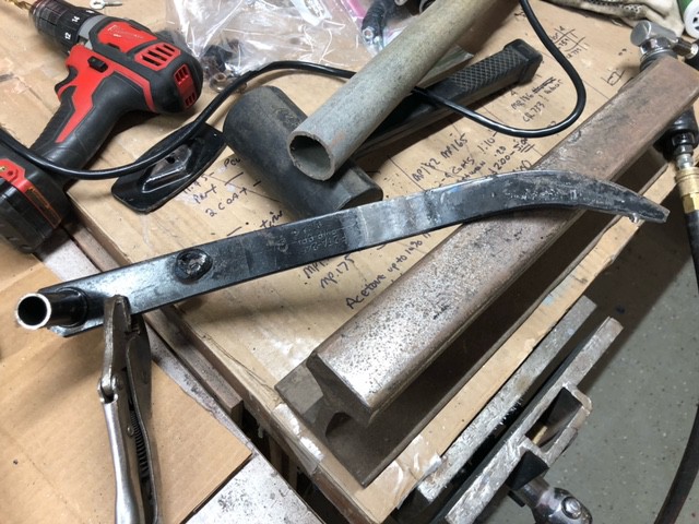

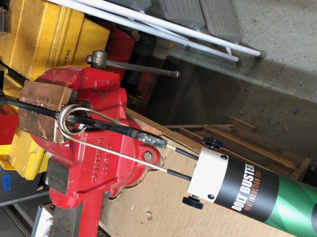

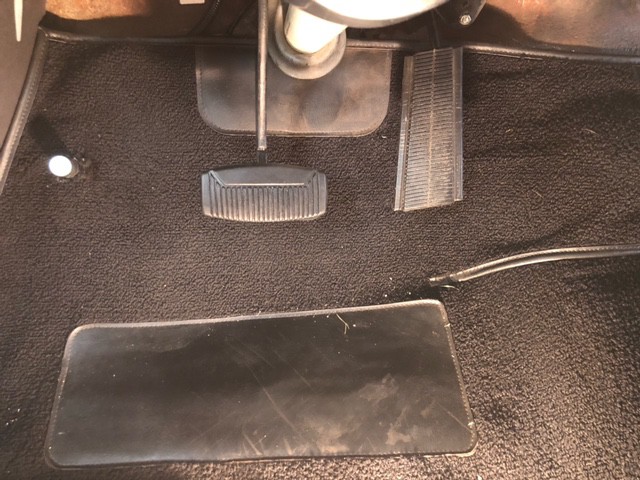

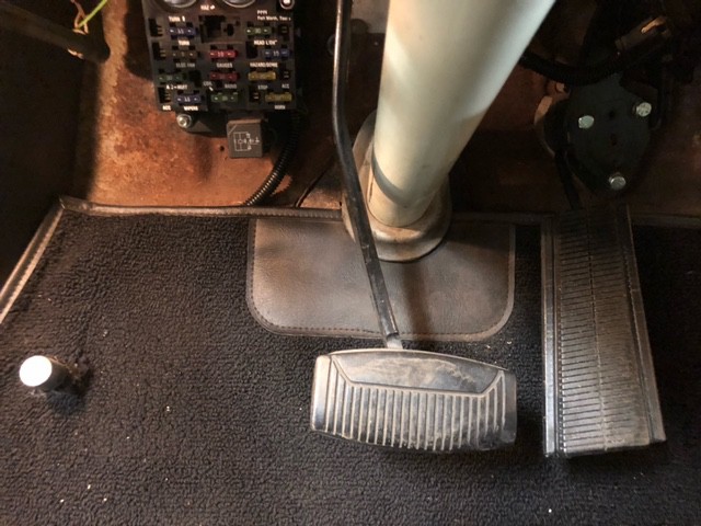

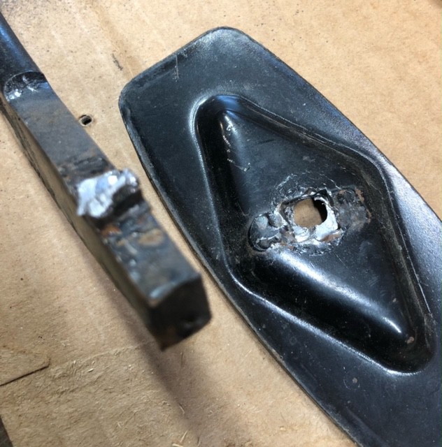

Finally got around to addressing the brake pedal, turns out it is from a 90's Ford Truck the Pedal was ~1" from the gas pedal and on occasion I would hit the gas when braking (with a 5" wide tennis shoe)
Pulled it out and straighten it and then repositioned the bottom of the pedal.
Wow, that looks perfect now !! Ingenious use of the induction heater too...

Thanks Mitch, the Induction heater is quite the invention.
Thanks for the introduction to the "coal/oil/solar/wind' powered electric torch!

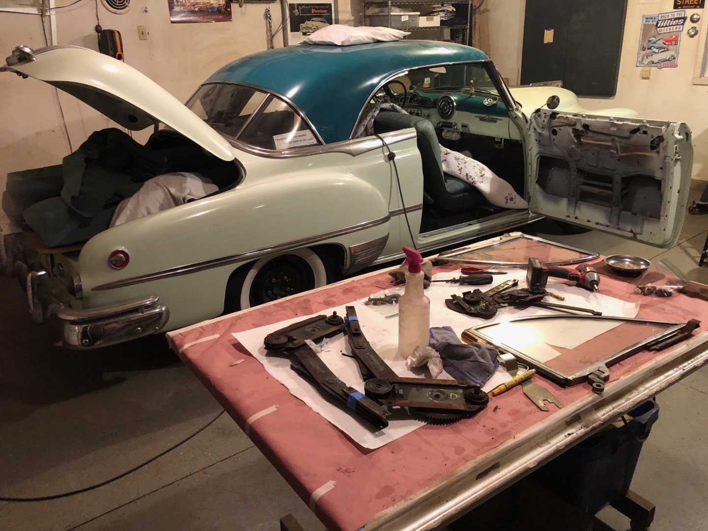

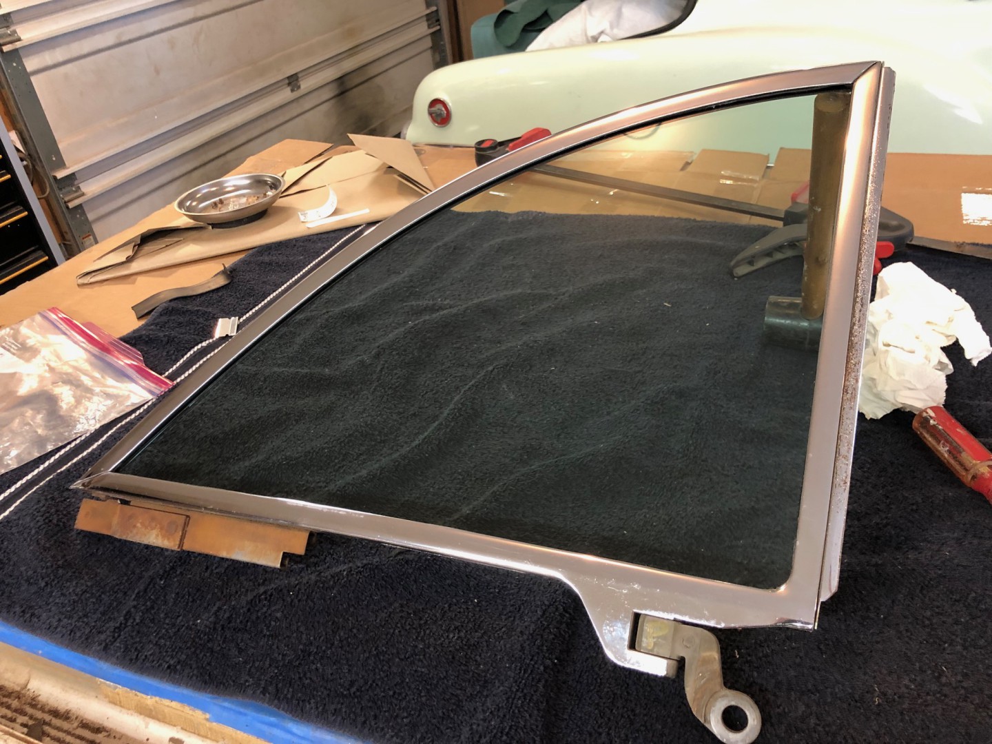

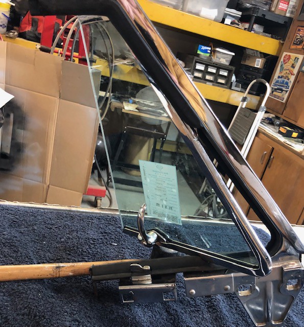

Well, it seems i got a little overextended as I was trying to get my passenger windows adjusted so the flippers would work. I'm offically in the CAC again... Good news is its over a month to the meeting here, and 4 months to BTT50's. All the side glass will be getting replaced, mechanisms sorted and some new seals.
-- Edited by BLyke on Friday 10th of February 2023 10:10:17 PM
Thanks Guys!
looking forward to getting it out thus spring!

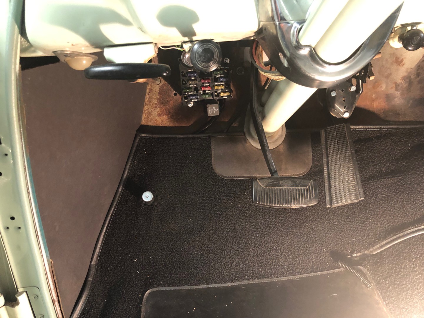

A little before and after on the "Painless Wiring" 12 volt conversion

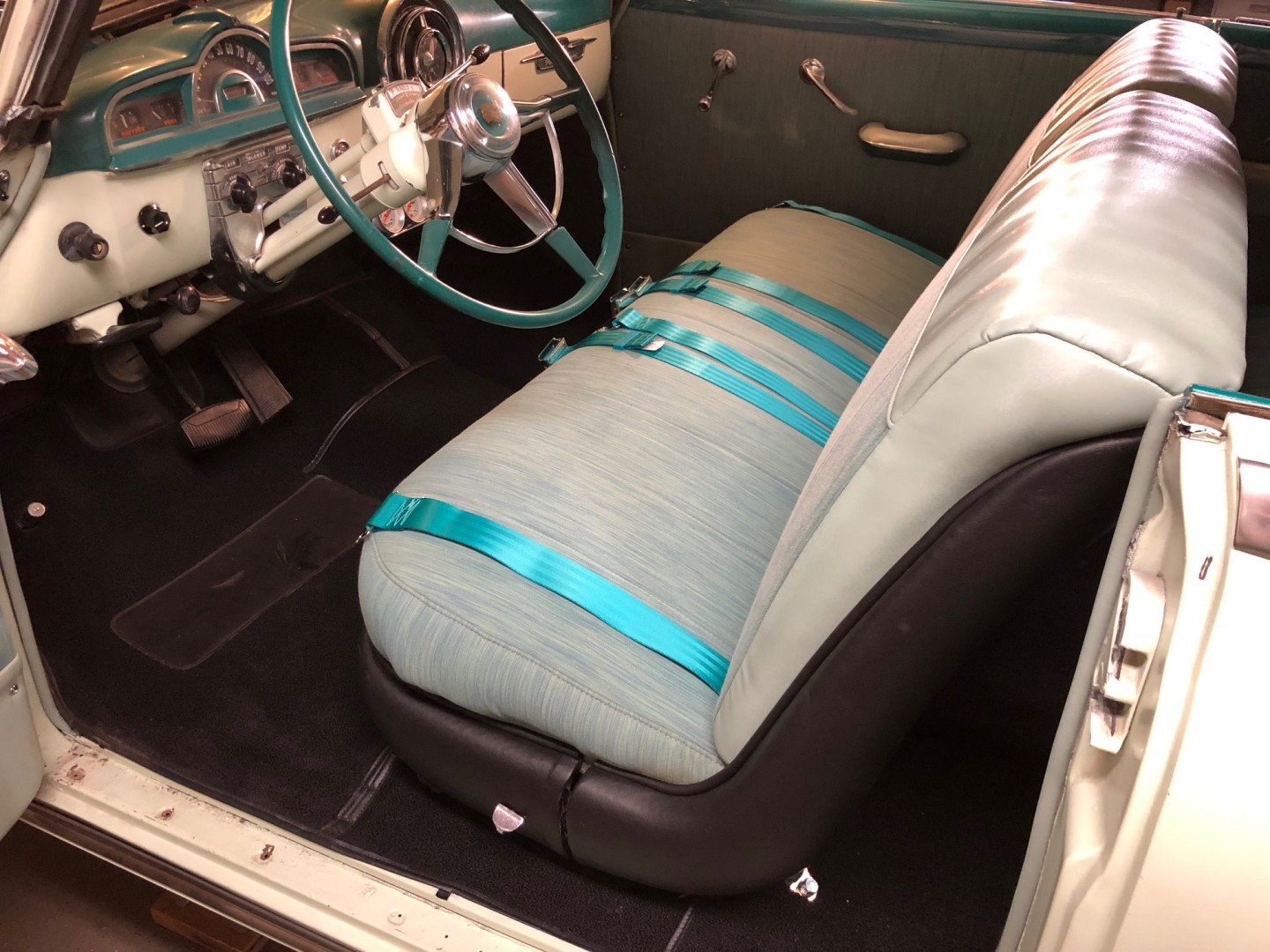

Getting the Car ready for spring and summer.

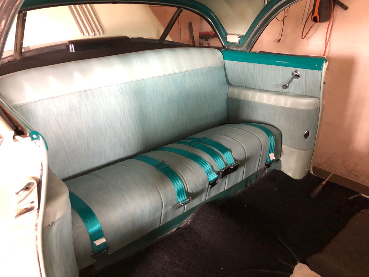

Cleaned the interior with an upholstery cleaner
Installed the seatbelts

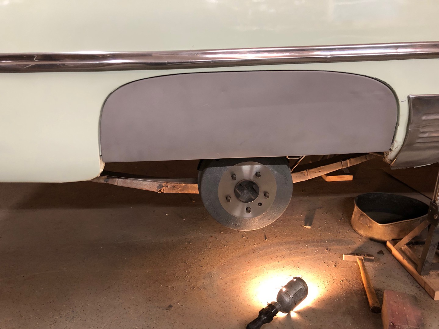

Reworked the passenger side wheel opening to properly fit the skirt

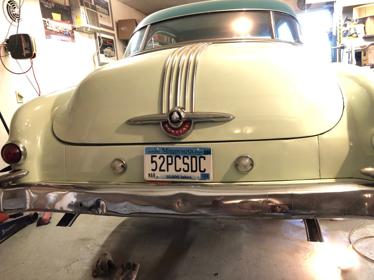

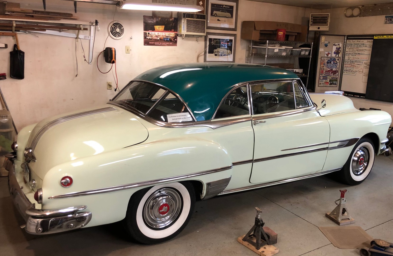

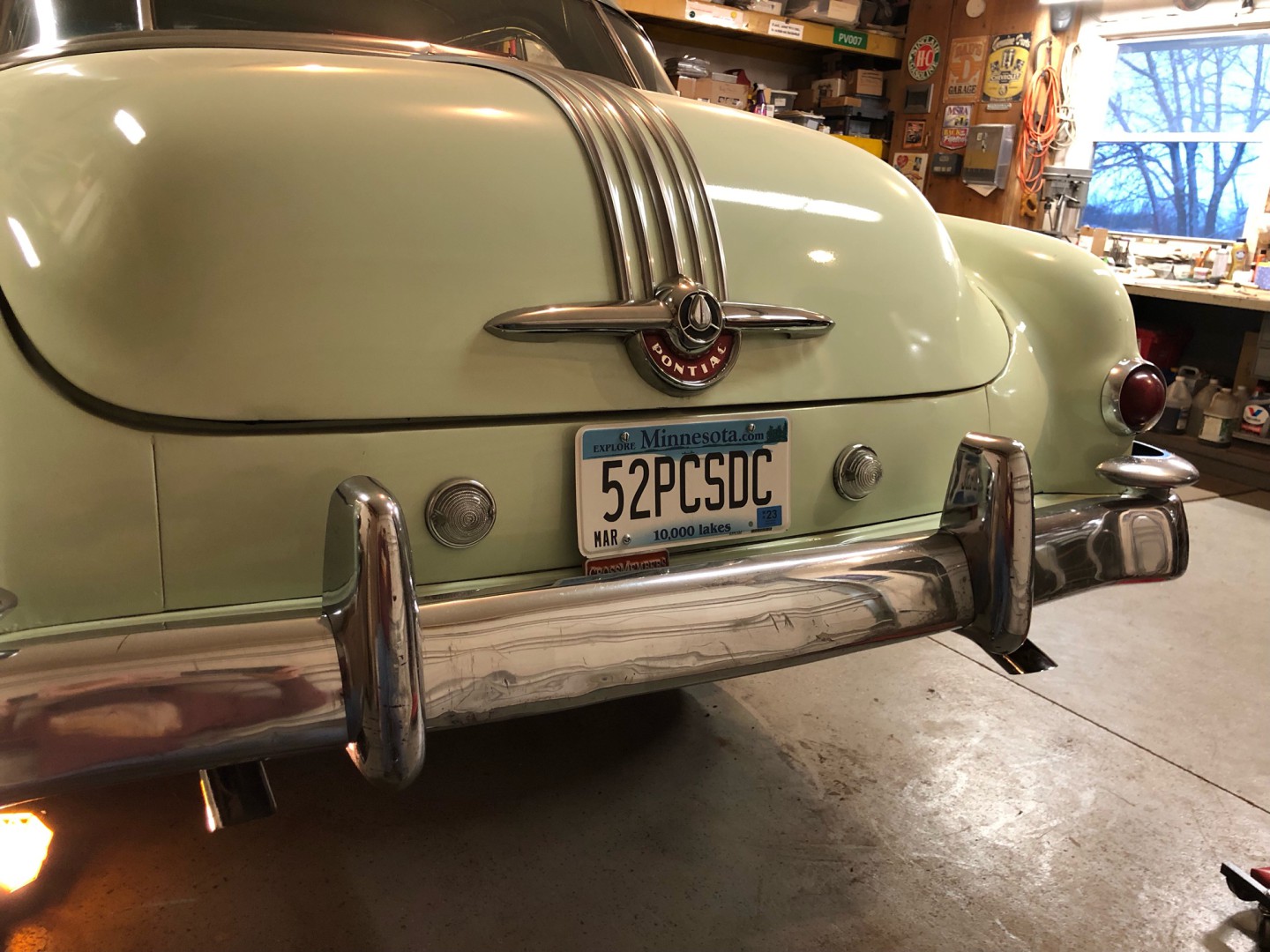

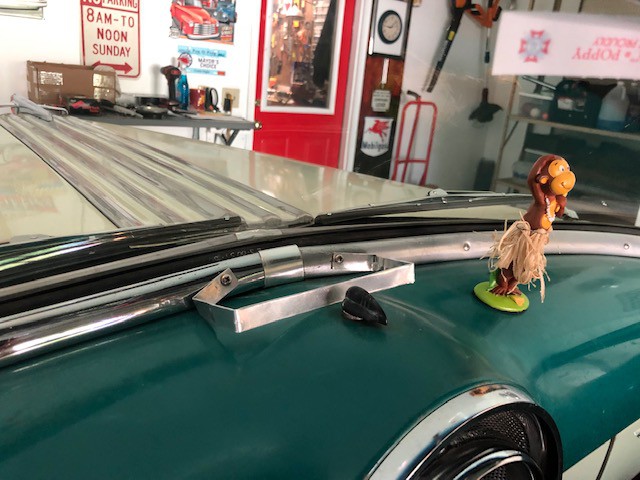

Minor update, added some of the smaller bumper guards (after getting pricing on re-chroming the whole rear bumper including the wings and larger 3-piece guard
Like the look and for now it works for me.
Racked up some more miles, finally tried out the USB port for music. The sample song is a classical piece my wife has played cello on in the symphony
I can use the port to charge my phone, now if I can just figure out how to load some favorite road tunes

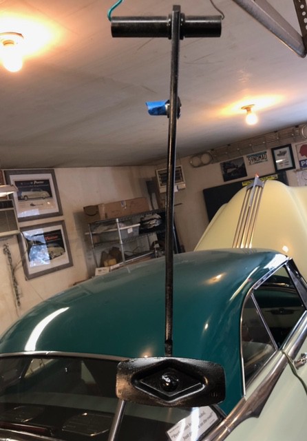

Used an Induction heater to heat the bar.
Much better
But, it will all be better when it's it's done..
-- Edited by Lost in the 60s on Saturday 11th of February 2023 07:16:49 AM
I'm defiantly in "infomercial mode", "But wait... there's more.
Getting there
Installed new glass
-- Edited by BLyke on Thursday 16th of February 2023 06:15:31 PM
Progress continues, was not quite sure how to do this.... so, I decided to just "Wing it".
