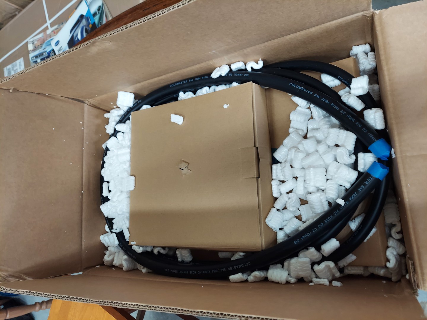

Received a nicely packed 48 pound box yesterday with the kit. It contains everything as advertised.

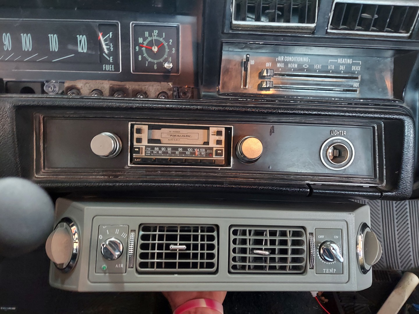

The under dash unit seems smaller than I thought, which is a good thing and fits perfectly in the spot where I thought it would go, and isn't that deep either with plenty of room behind it.

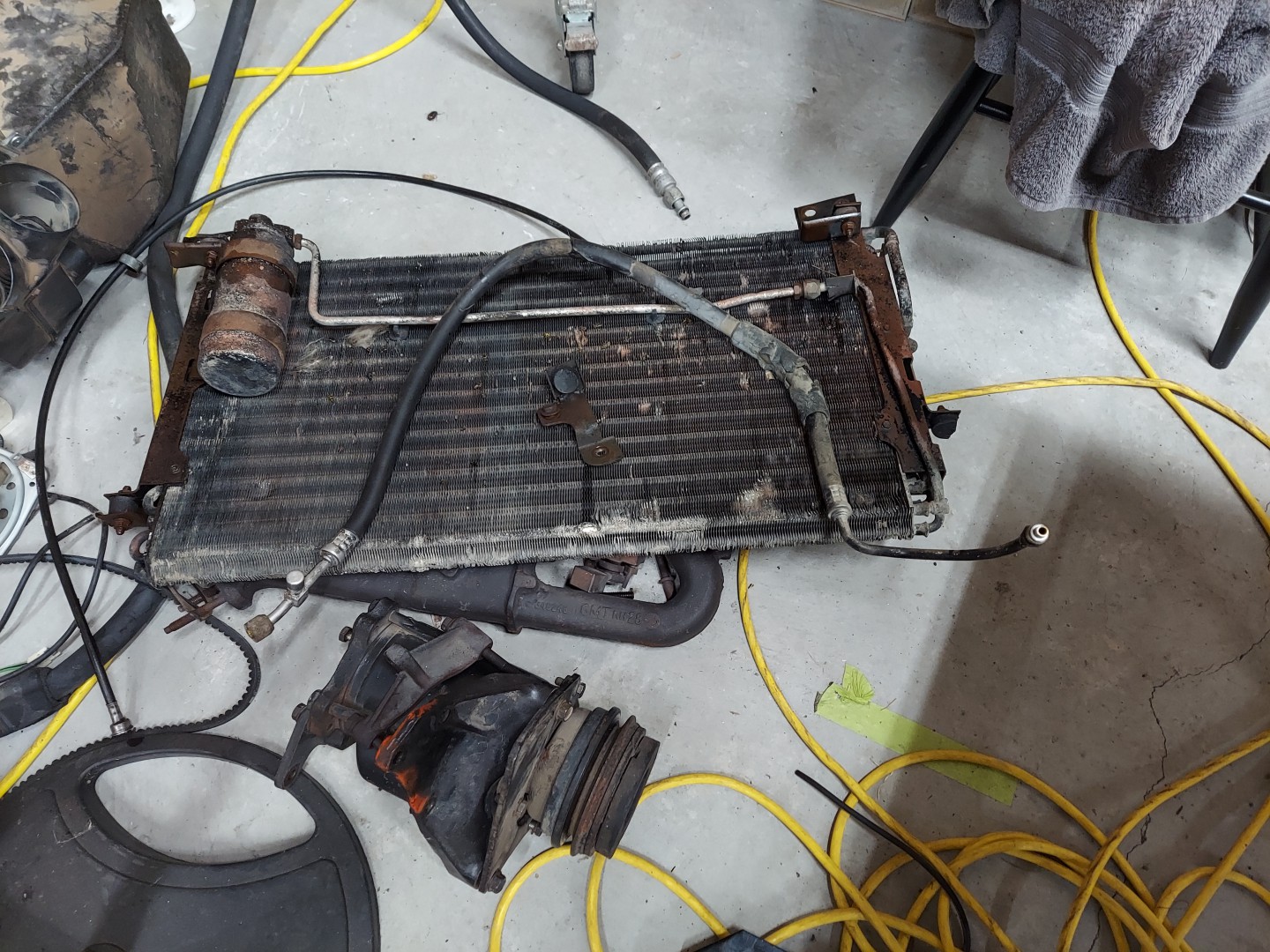

Now I have to 'recolor' it black and start removing the old compressor and condensor/filter set up and installing the new. Bob W. I have you in mind for 'recycling' those parts in your collection.

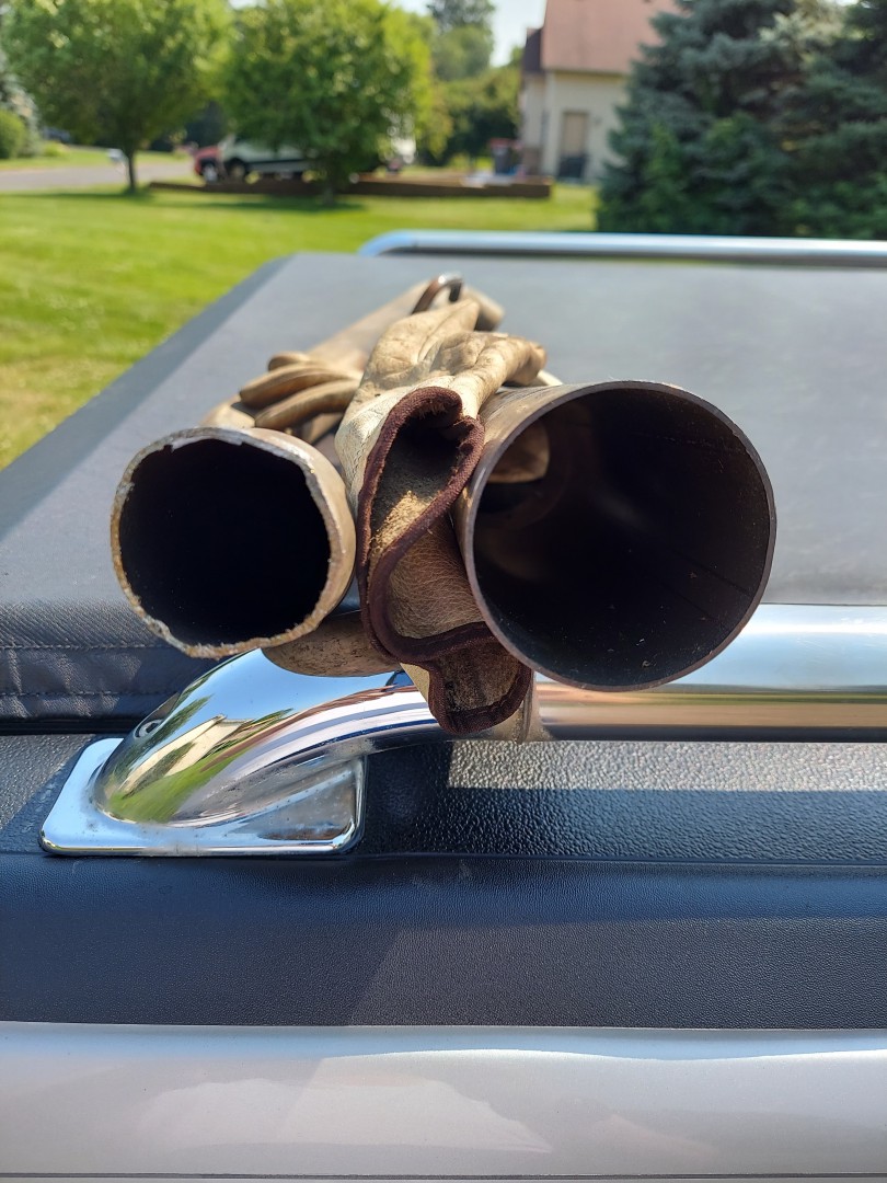

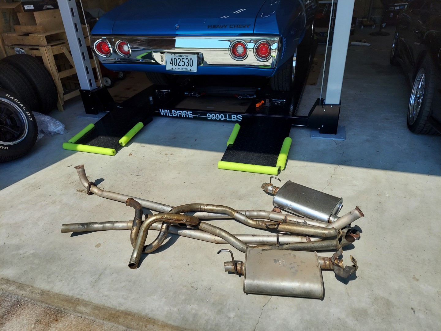

The HC started droning badly at 60 mph when driving home last weekend from the SMN's, so I finally got around to raising the lift to see what was going on. The passenger side muffler had blown a hole in it. So, now I'm in CAC again as there's no way I'm driving it with it sounding so bad.

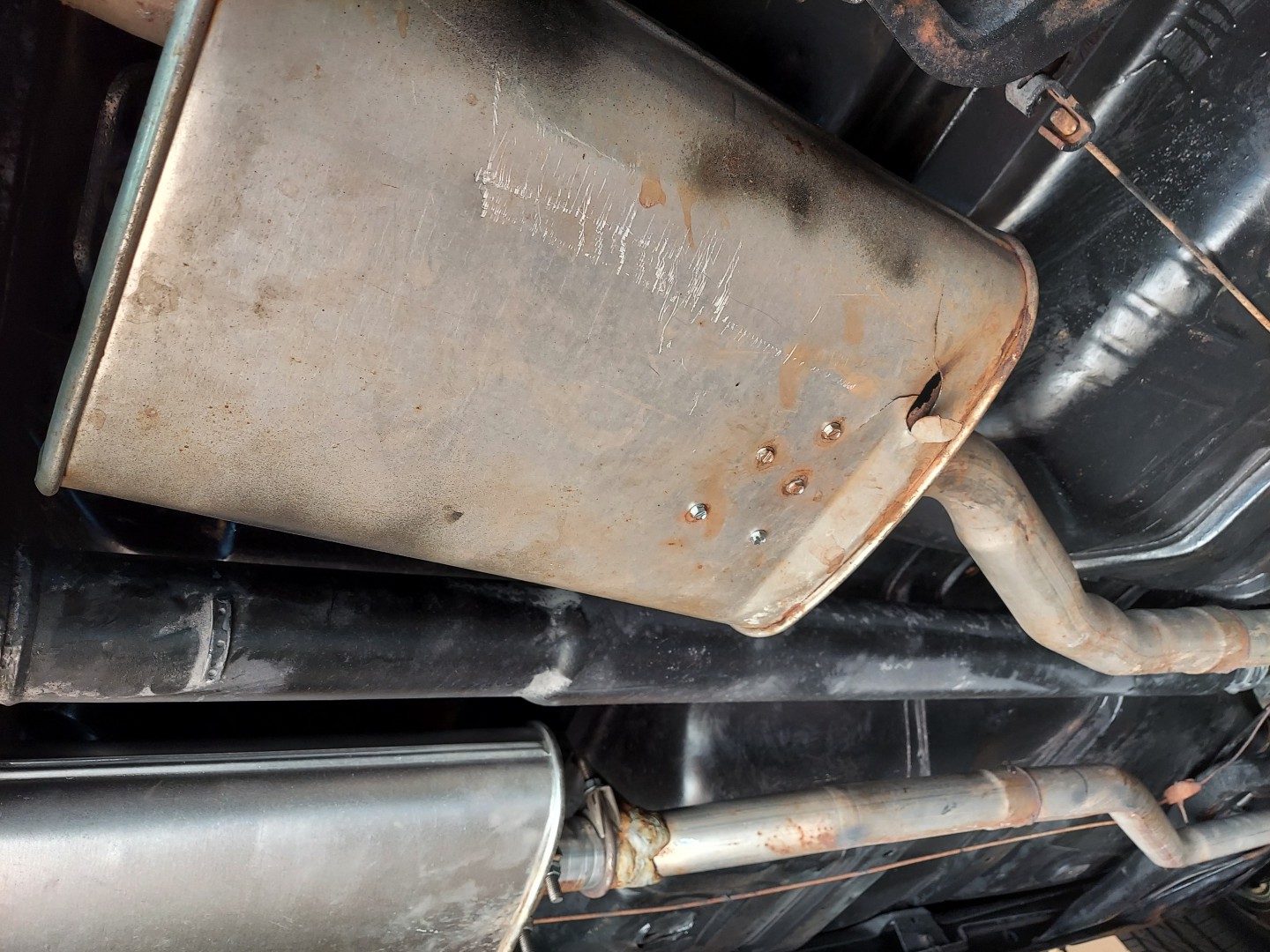

I had already replaced the driver's side muffler this Spring when it started rattling real bad from the baffle detaching inside so that I could get through the season, then replace the whole system with the Pypes system I had bought for the 69 Chevelle but didn't use before I traded it in. You'll see the opening in the muffler and some machine screws in it too. The screws are a hillbilly Stanitization attempt to stop the baffle from rattling on the passenger side, but that didn't help.

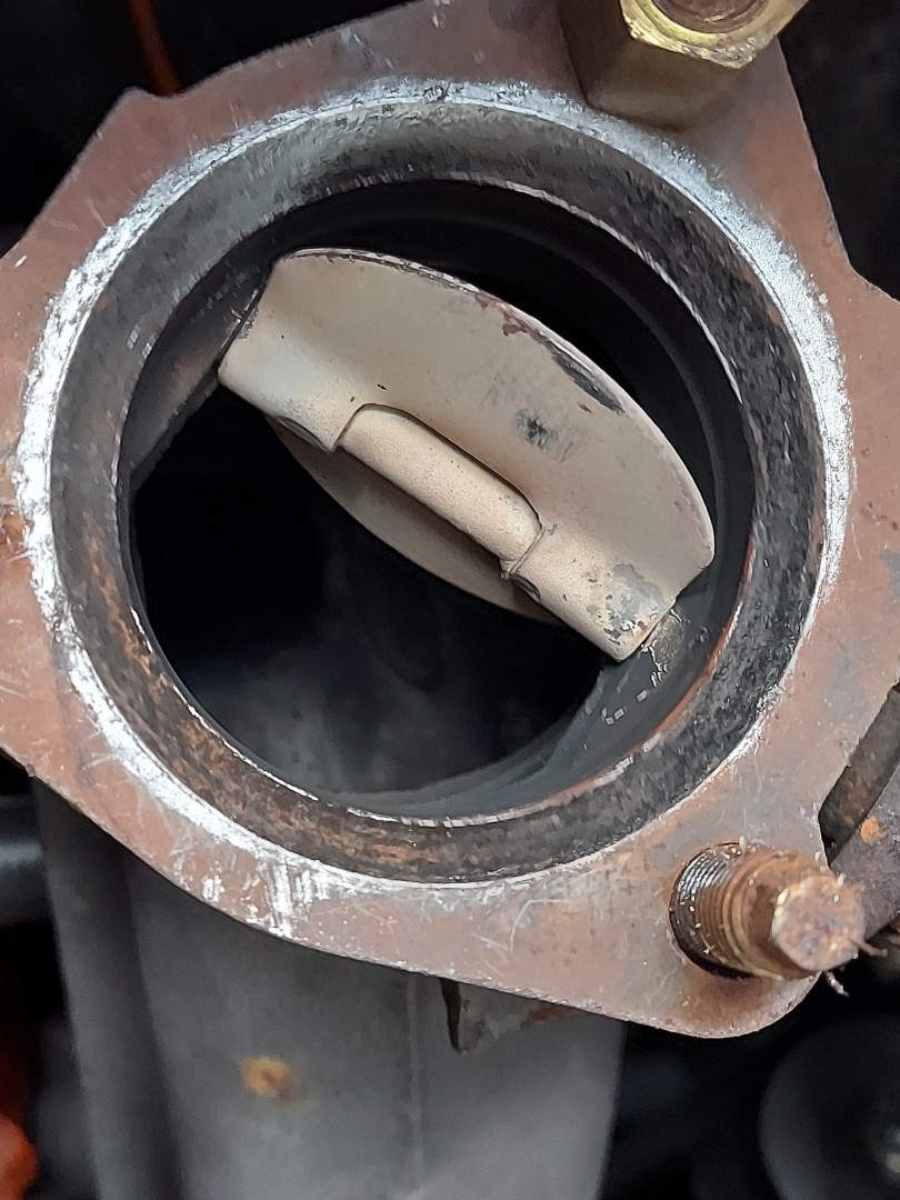

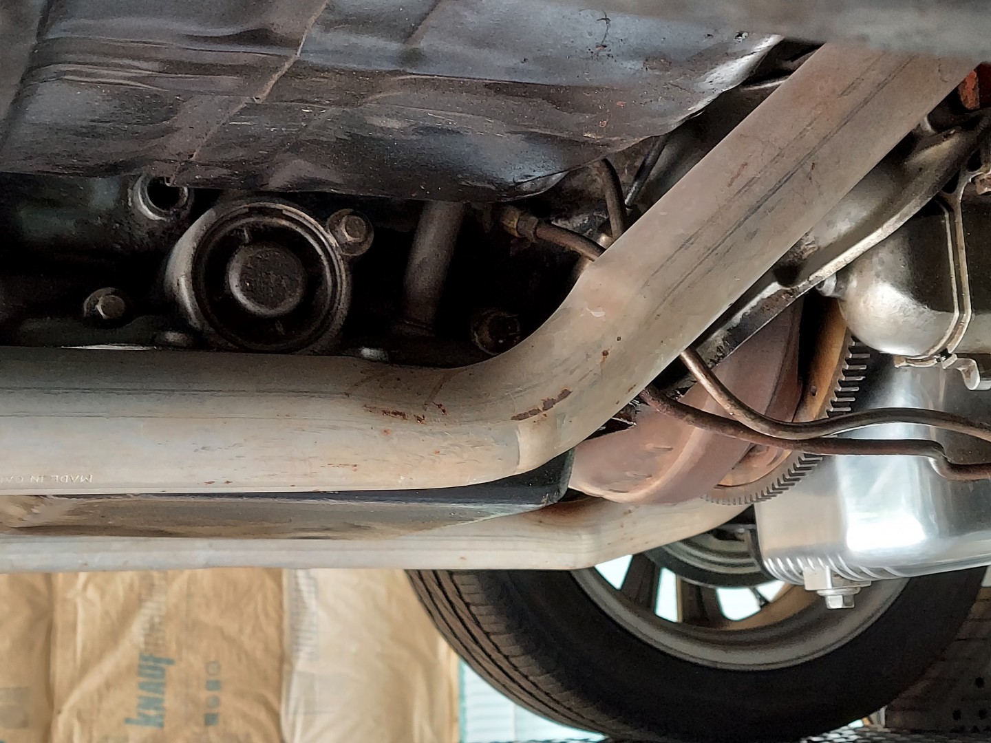

So, about an hour later this morning I had the old system out. LOTS of restriction in it being a 2" system with the bends being less than that, and I found the flapper on the thermal gate on the passenger manifold provided about a 25-30% restriction. The 2.5" Pypes system looks huge compared to what I took off.
I started soaking the manifold bolts and hope they don't break or strip out! I'll also pull the original AC compressor and hoses to give more access to be replaced by the new system soon.

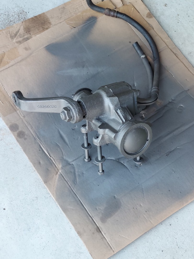

I also decided to use the hottest/humid day of the summer and harvest a 1998 JGC steering box yesterday, so power washed it and painted it up today. I'll get it in when I get the parts later next week.

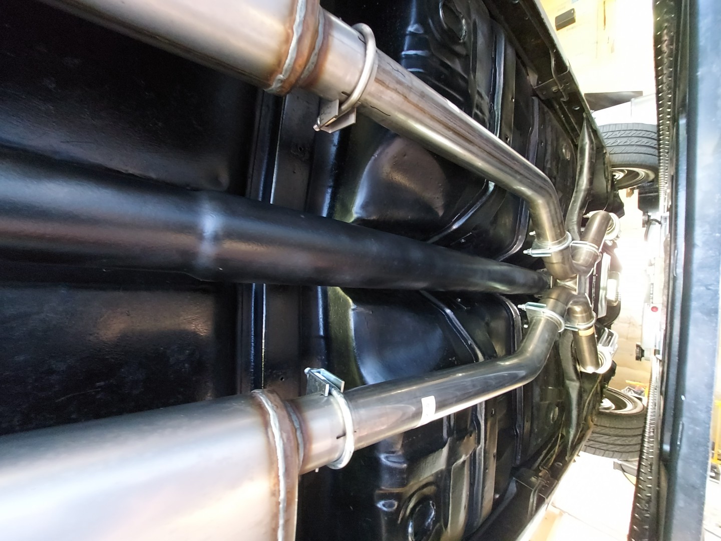

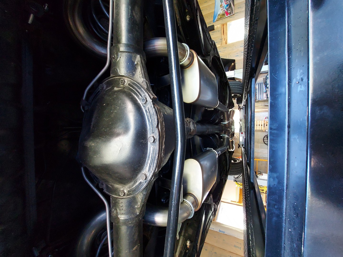

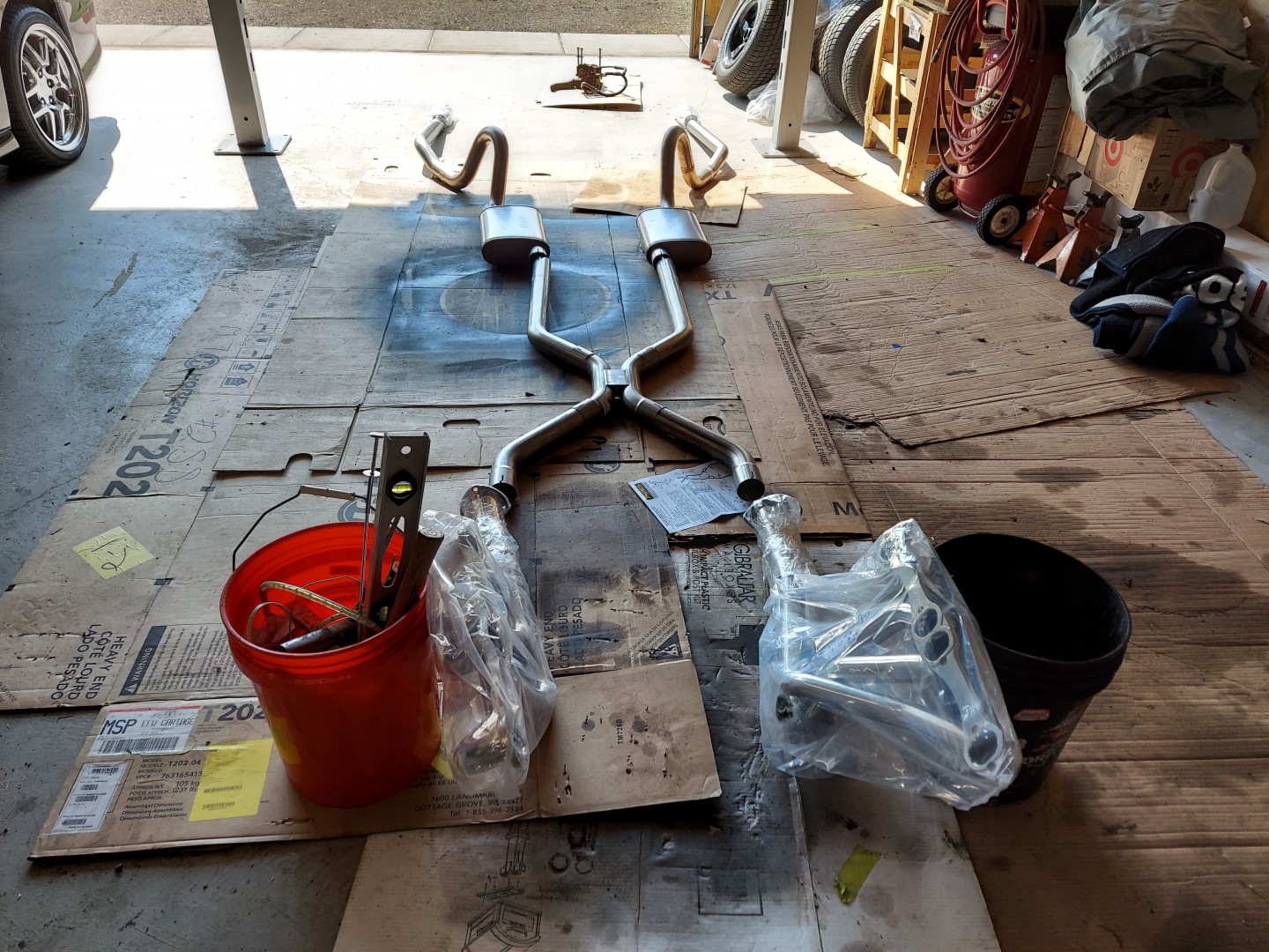

The Pypes 2.5" with H pipe and RacePro mufflers is in and sounds great.
The install went as typical for a kit and tucked up nice and close to the floors. The pics are with it clamped, but I just had it welded up yesterday which is the video. Hearing any fttt fttt fttt exhaust leaks just drives me nuts, so now those are all gone.
Sound wise, it has a nice rumble at idle but when under throttle has a nice throaty sound until about 60 MPH then everything just kind of goes quiet. No drone whatsoever at highway speeds.

Removing all the factory stuff for the underdash setup.
