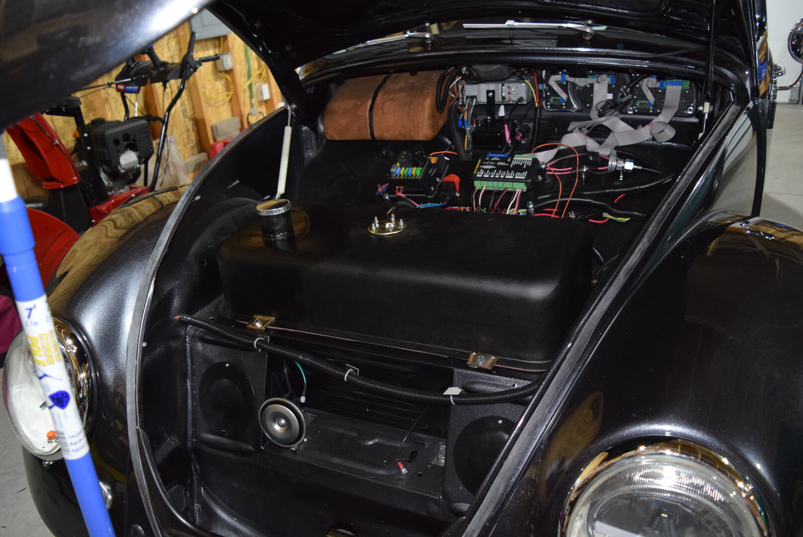

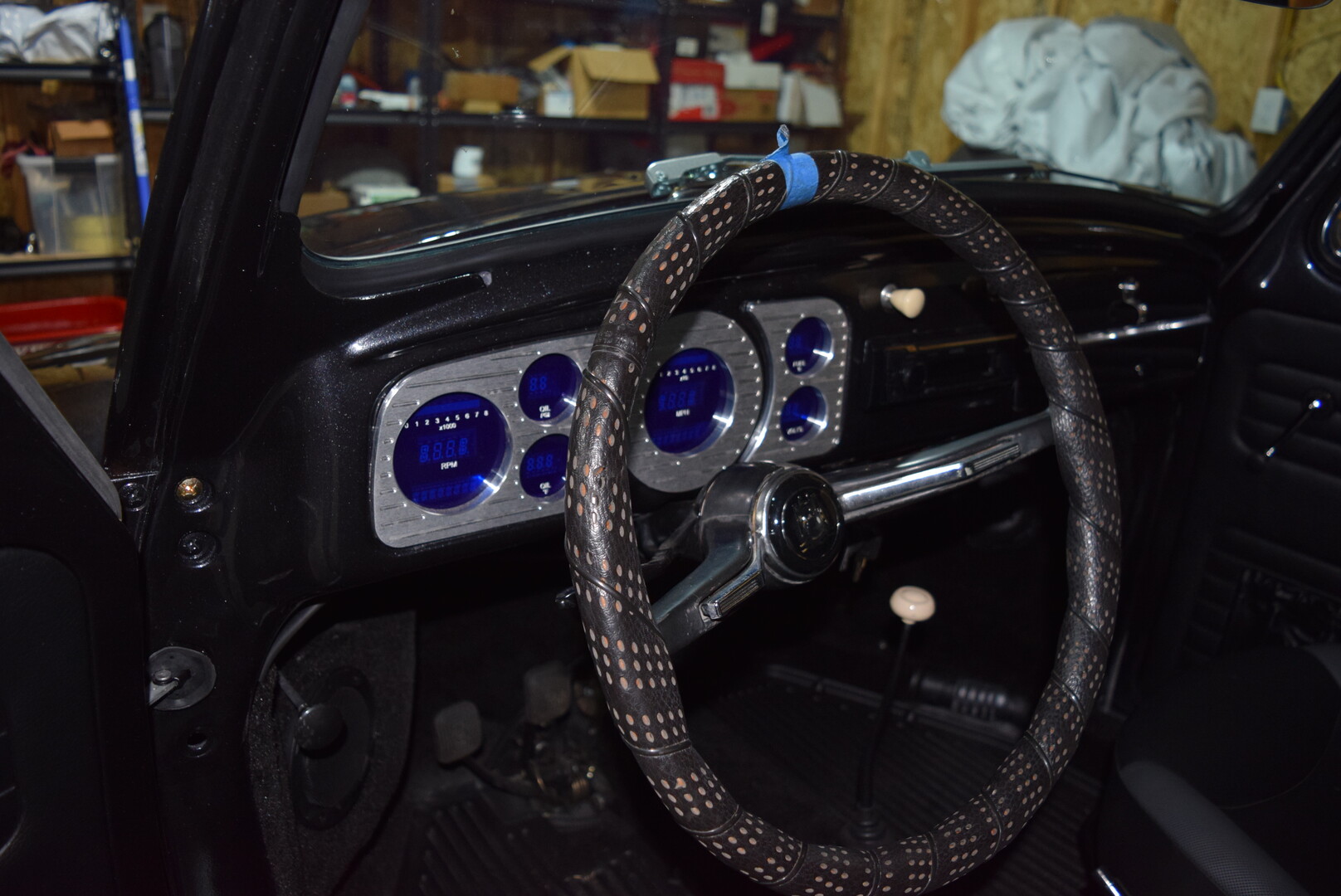

Been a bit since I have posted an update on the Bug, so here goes.
Electrical is done, except for the dome light. The wires are in, but I need to get some jam switches.
Radio is installed. I just need to run the microphone for the hands free
New gas tank is in, float connected to the dash module and calibrated
The Bug is now moving under its own power

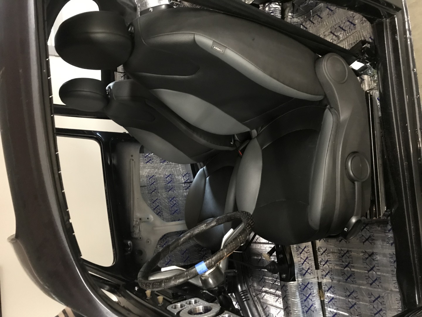

Bought a pair of seats from a 2007 Mini Cooper for $60. Built a set of mounts to adapt between the factory mounts/tracks of the Bug and the factory tracks on the Mini Cooper seats. They are a very good fit
I have the driver side seat belt 'loosy' in to see if they interfere with the seat travel.

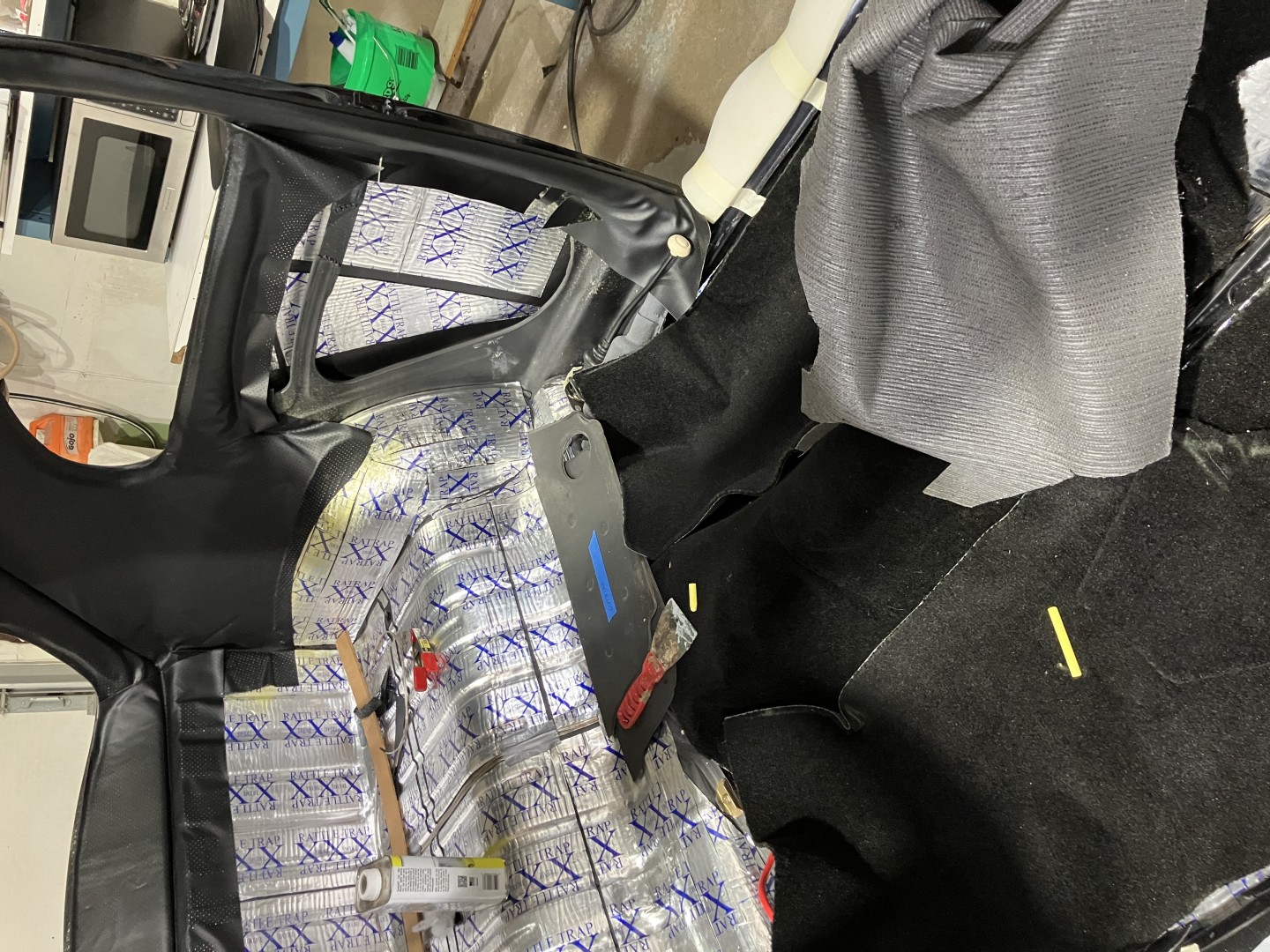

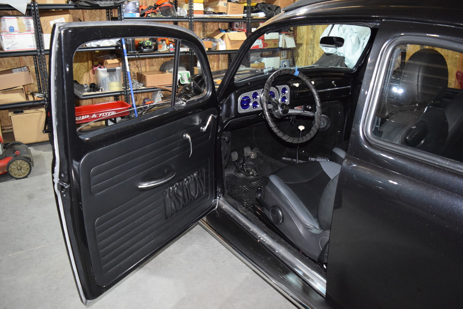

Got the Bug back from the interior shop today. Jon H. had work done by this guy. In hinge sign, I probably should have had him use his material for the 'headliner'. We purchased a kit, thinking we were going to do it ourselves, but life go in the way. The headliner was not the most cooperative for him.
-- Edited by hkgmillette on Saturday 27th of January 2024 07:05:21 PM
-- Edited by hkgmillette on Saturday 27th of January 2024 07:13:47 PM
What has been done looks great. Assuming you are installing the front seats and maybe the door panels ?
6 way power, leather, seats with heat and massage ? ...

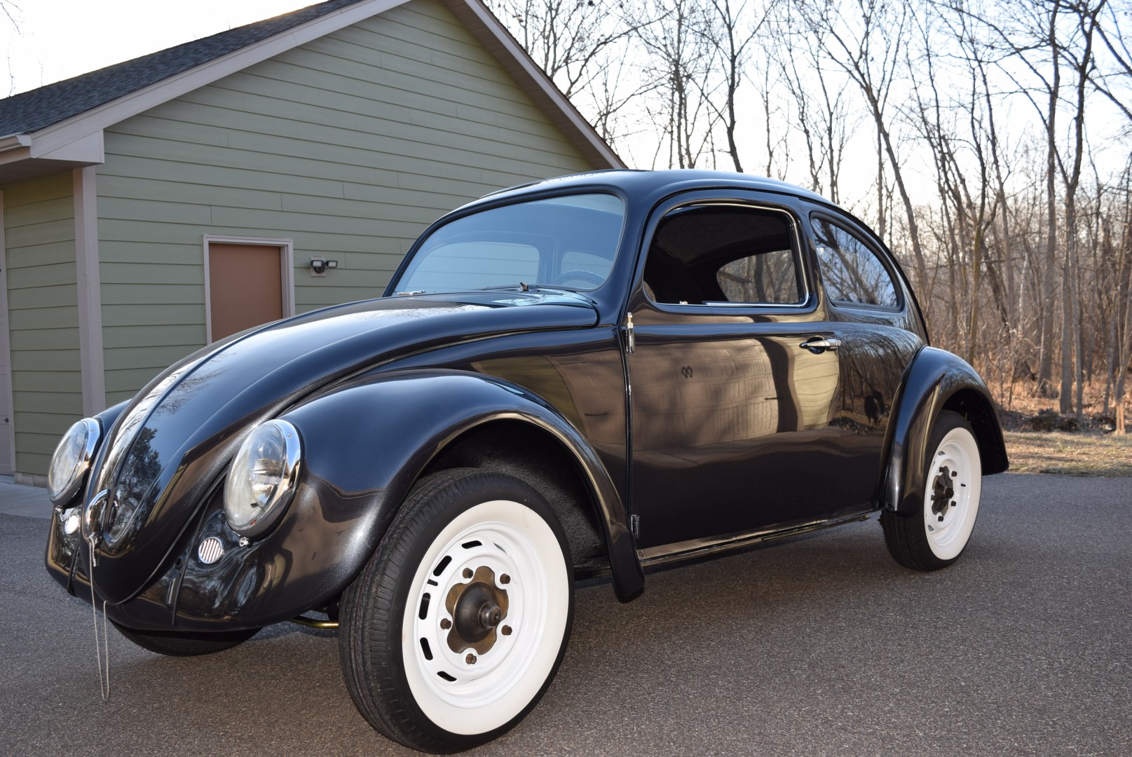

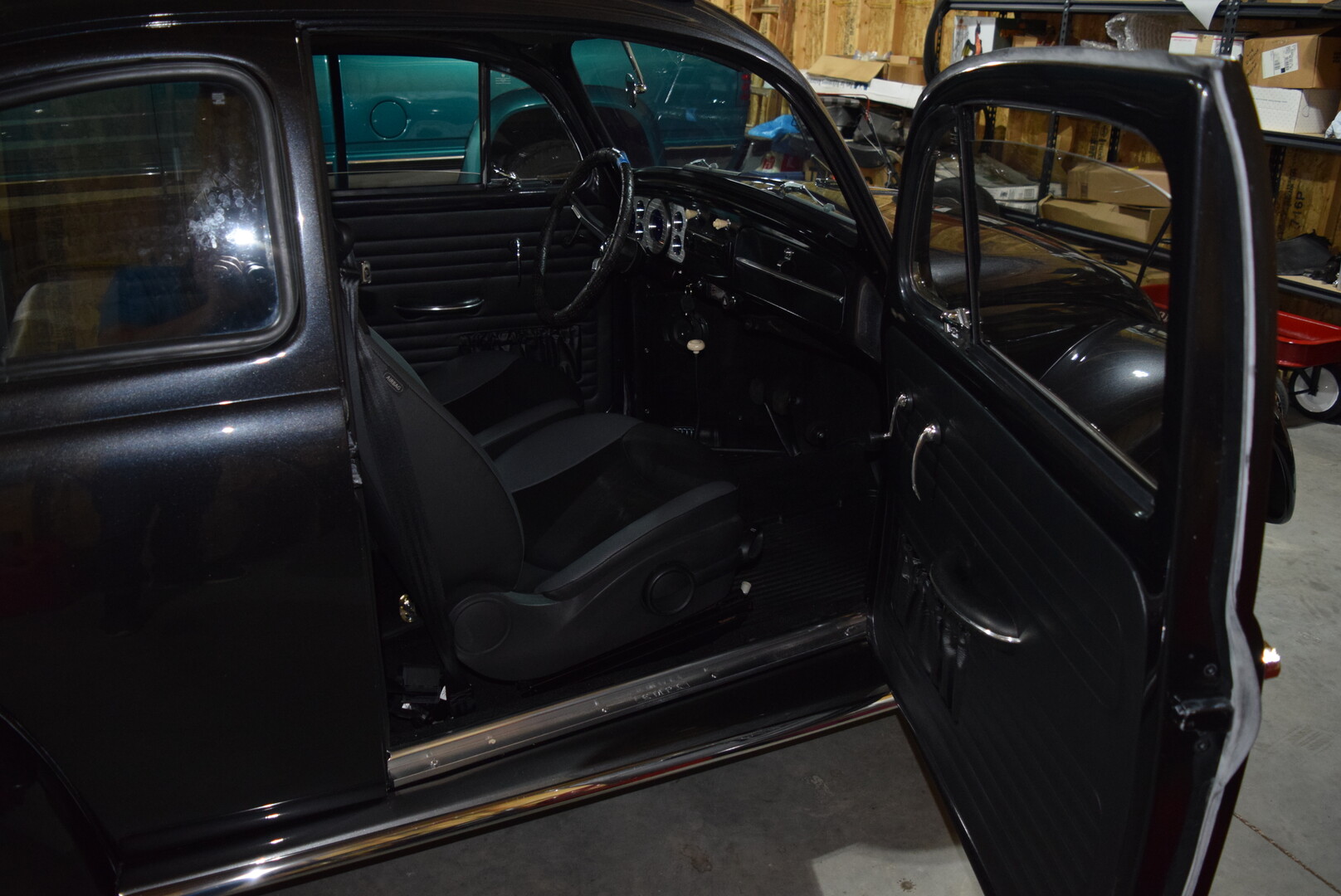

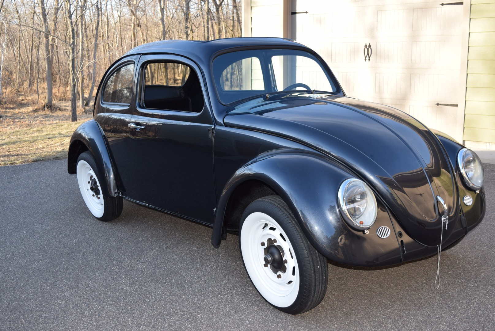

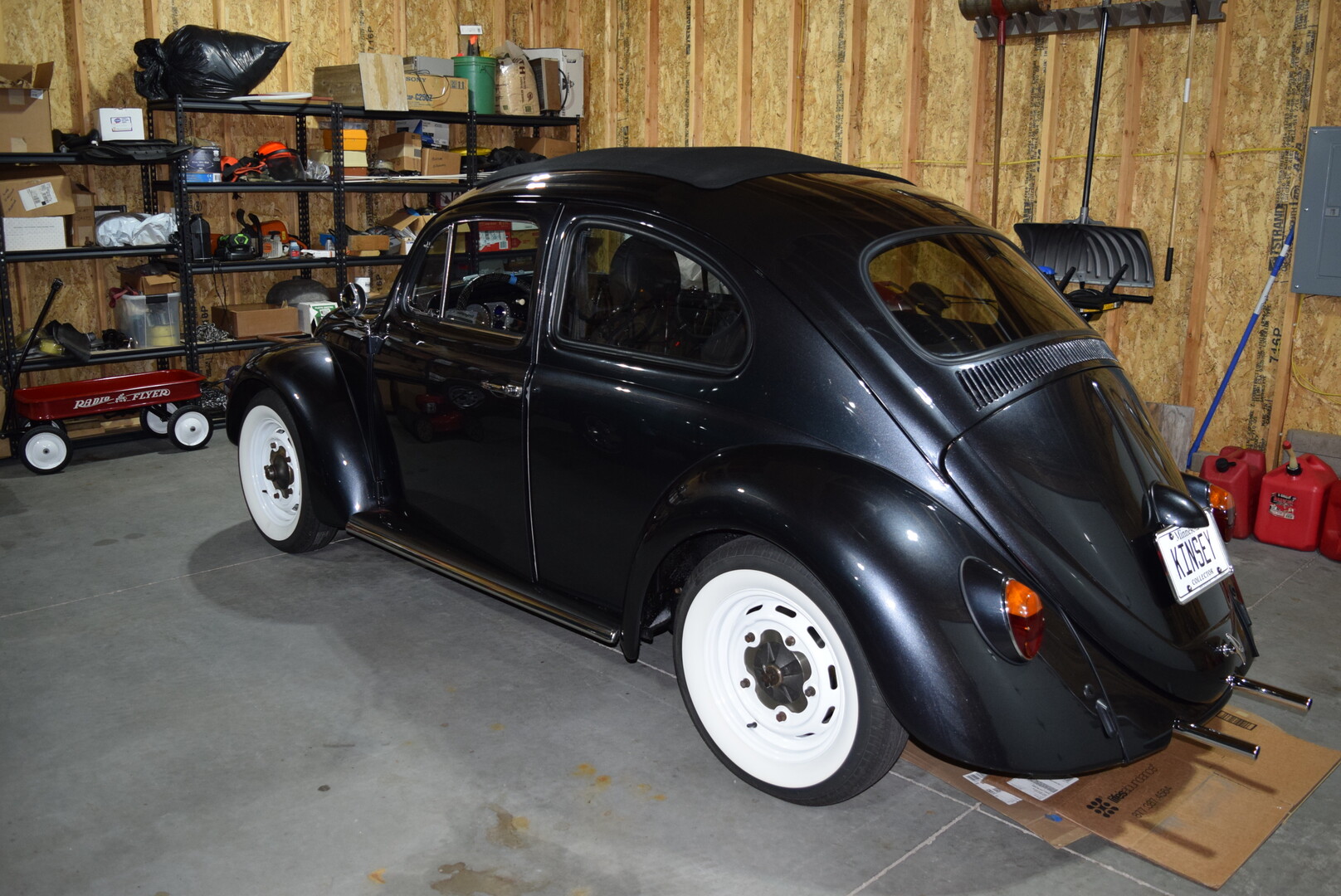

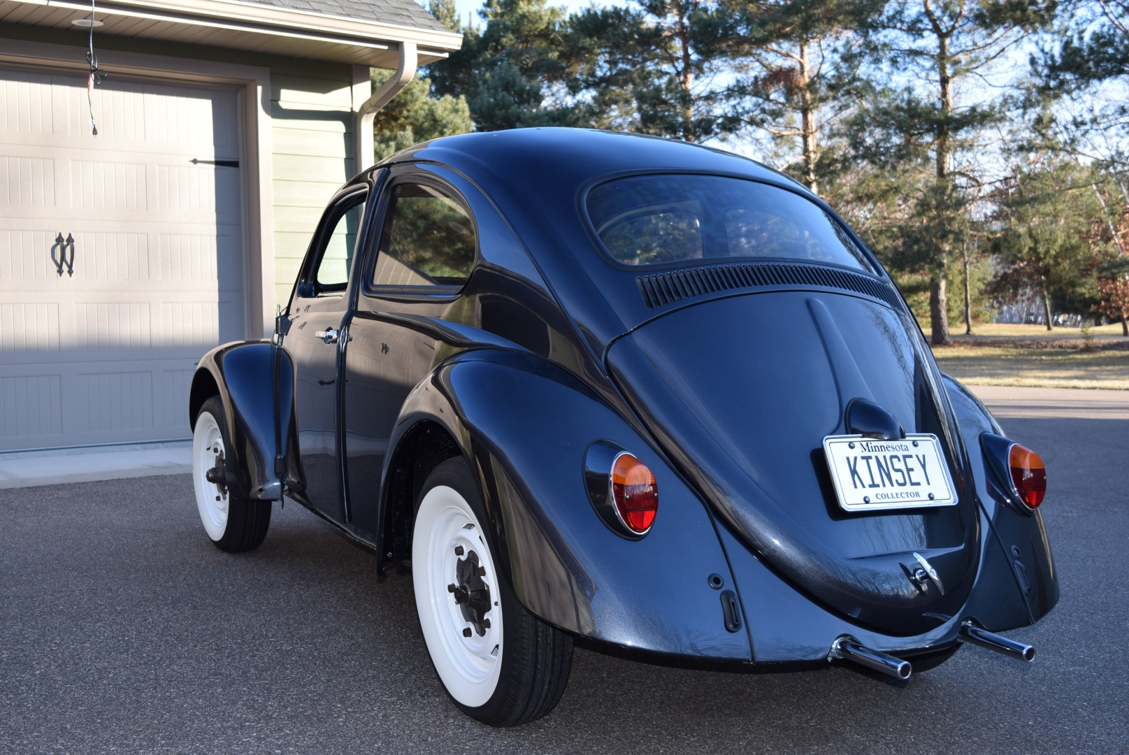

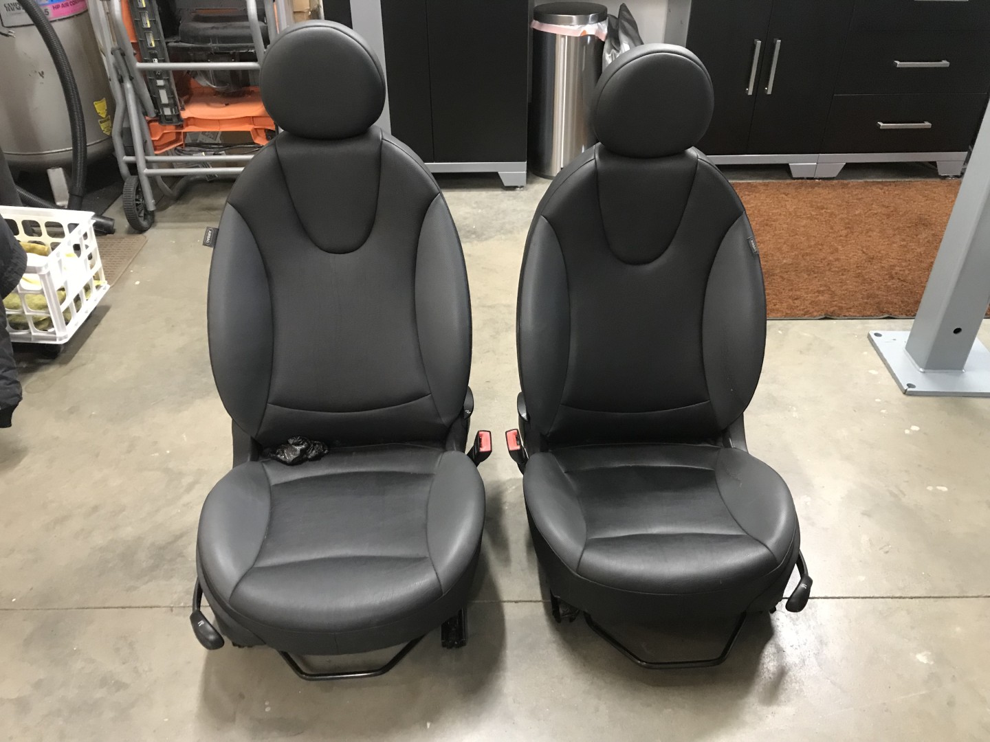

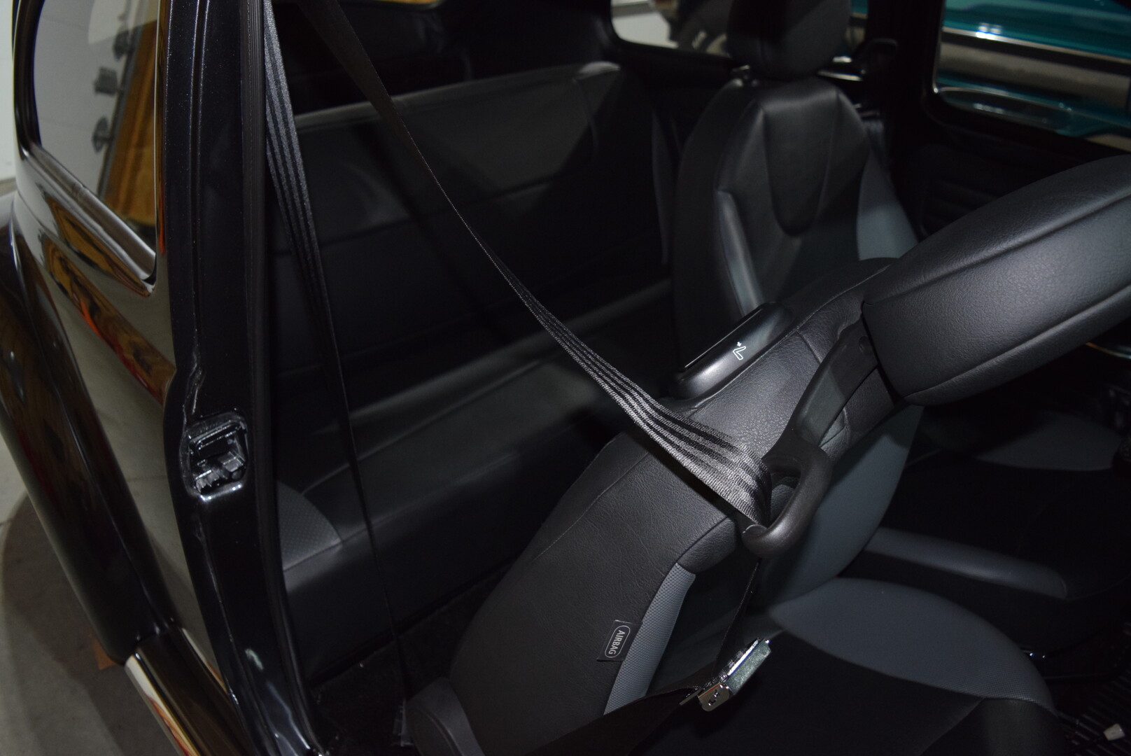

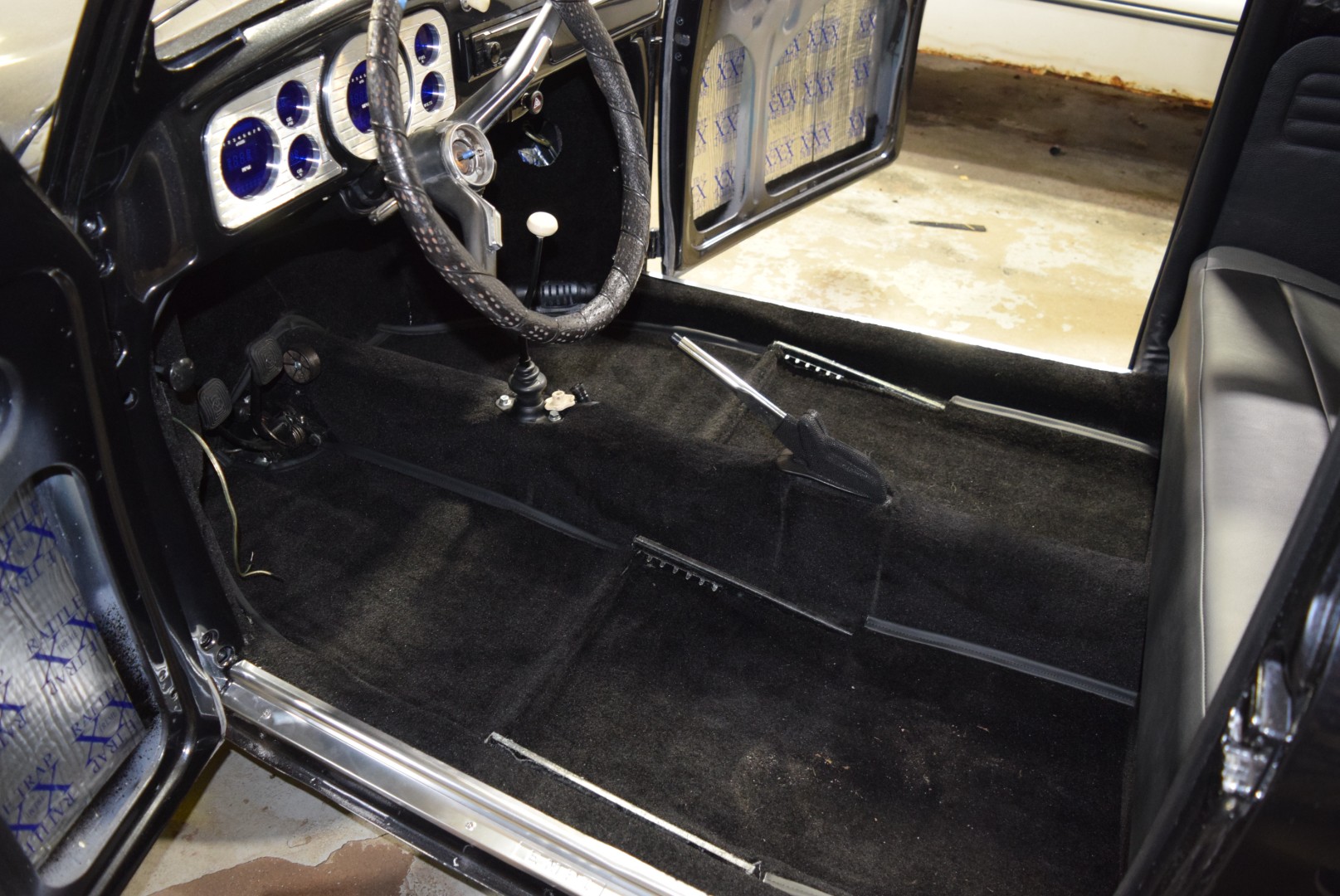

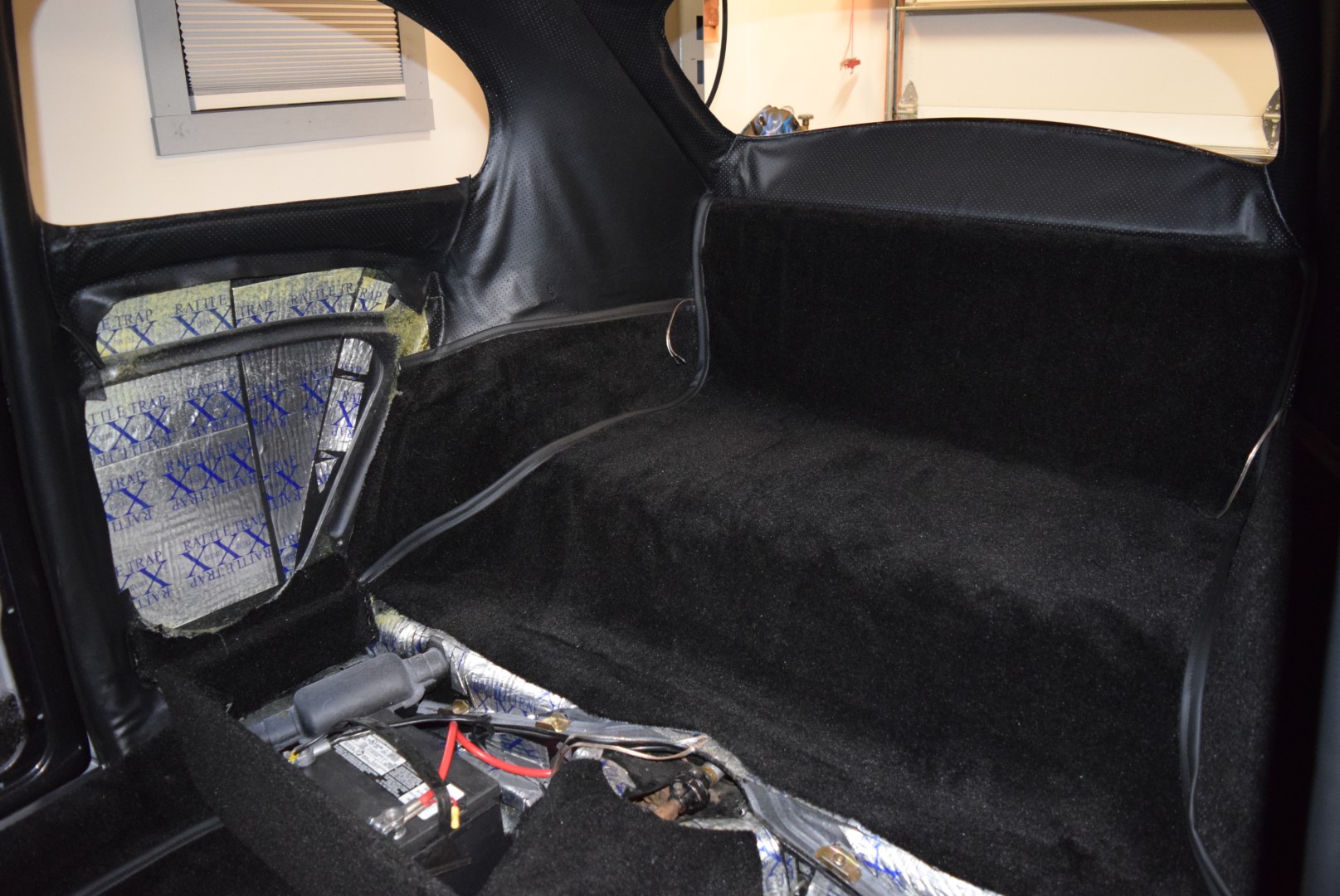

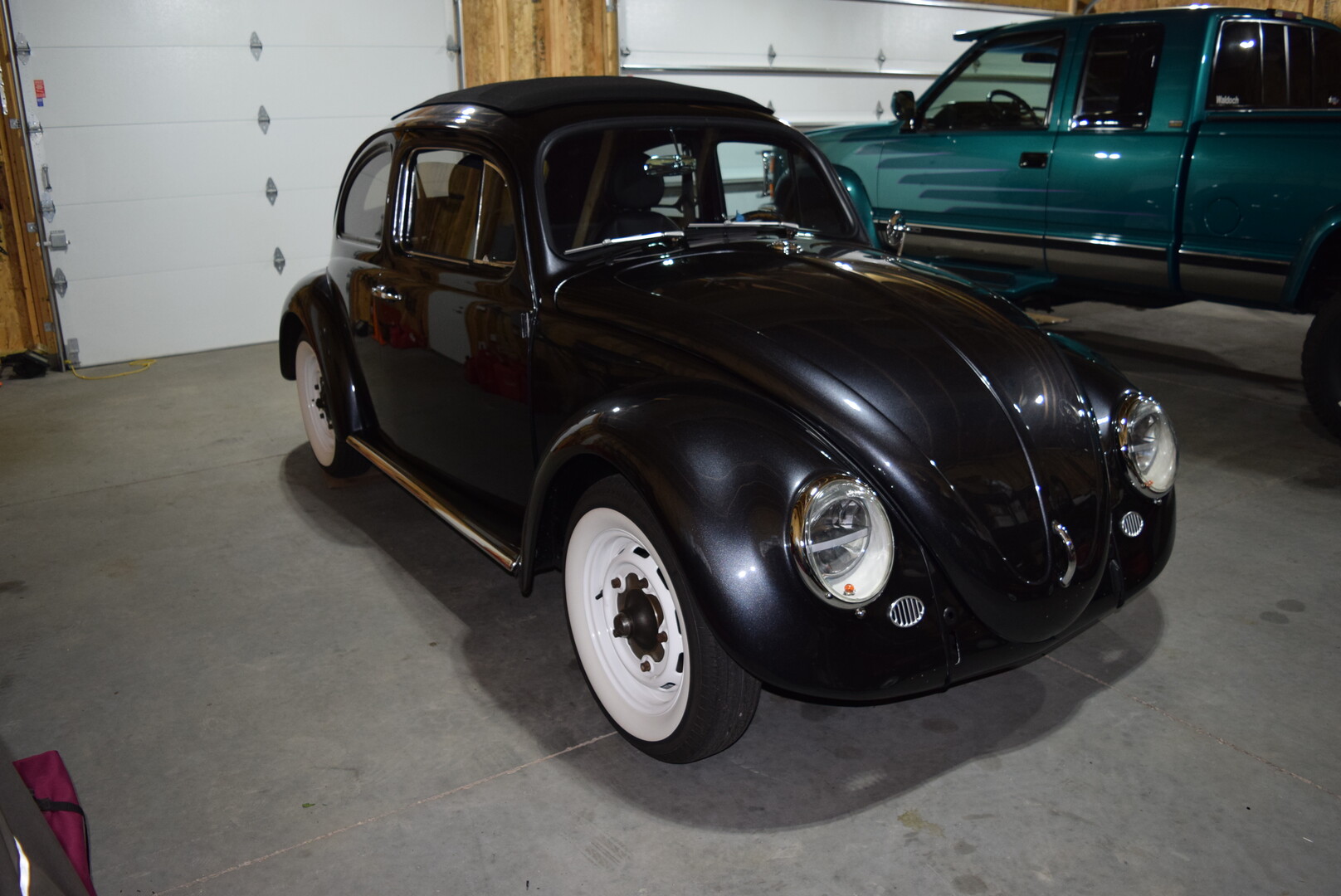

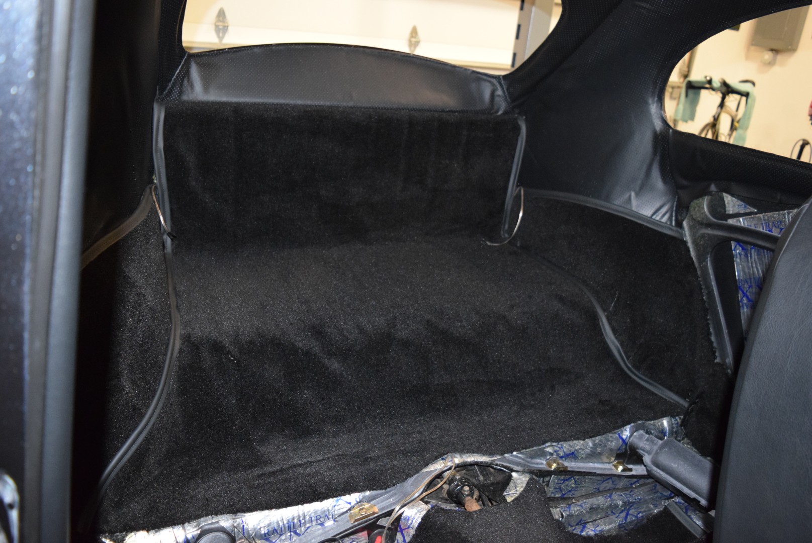

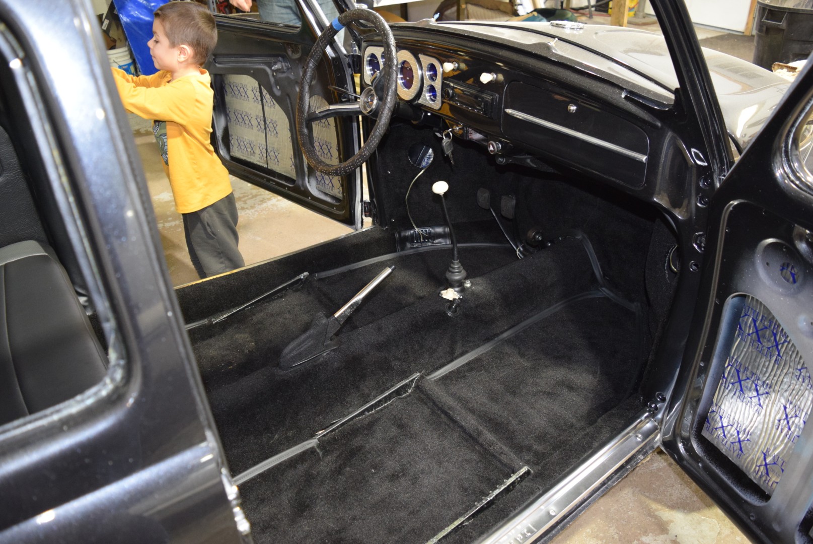

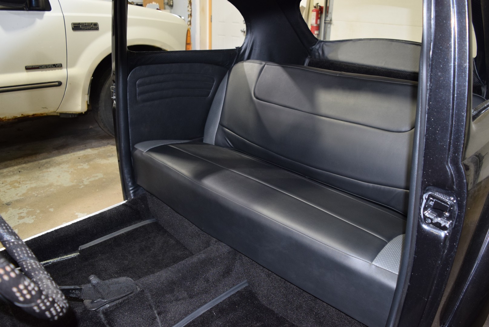

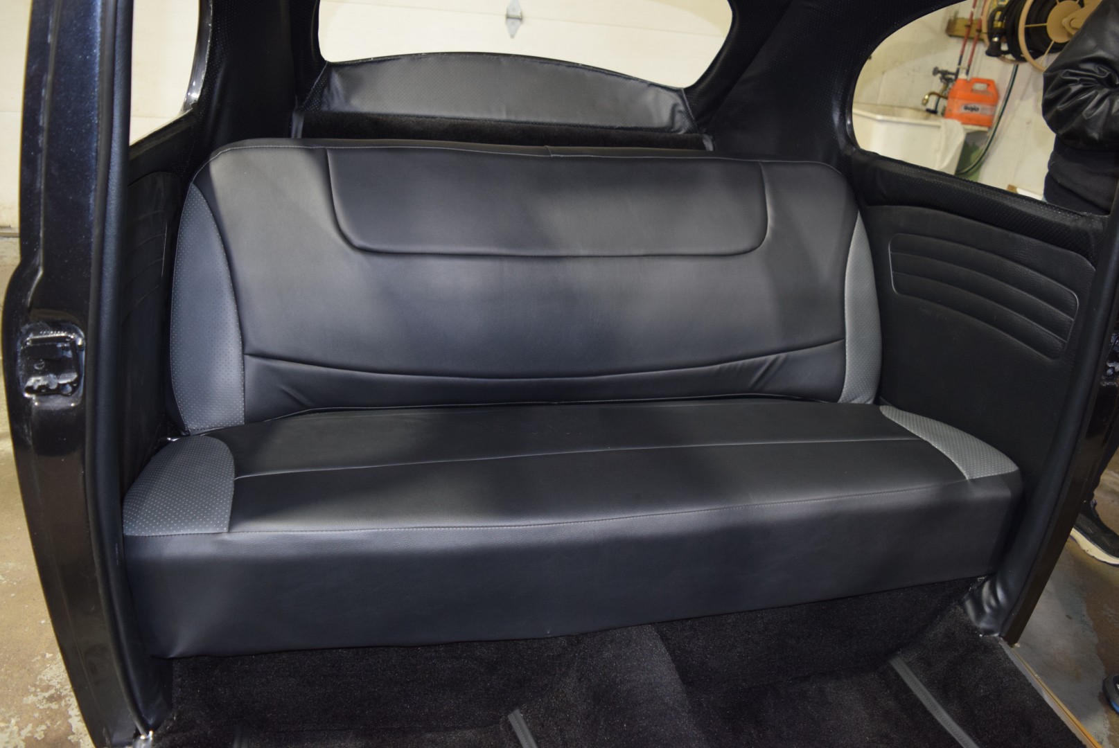

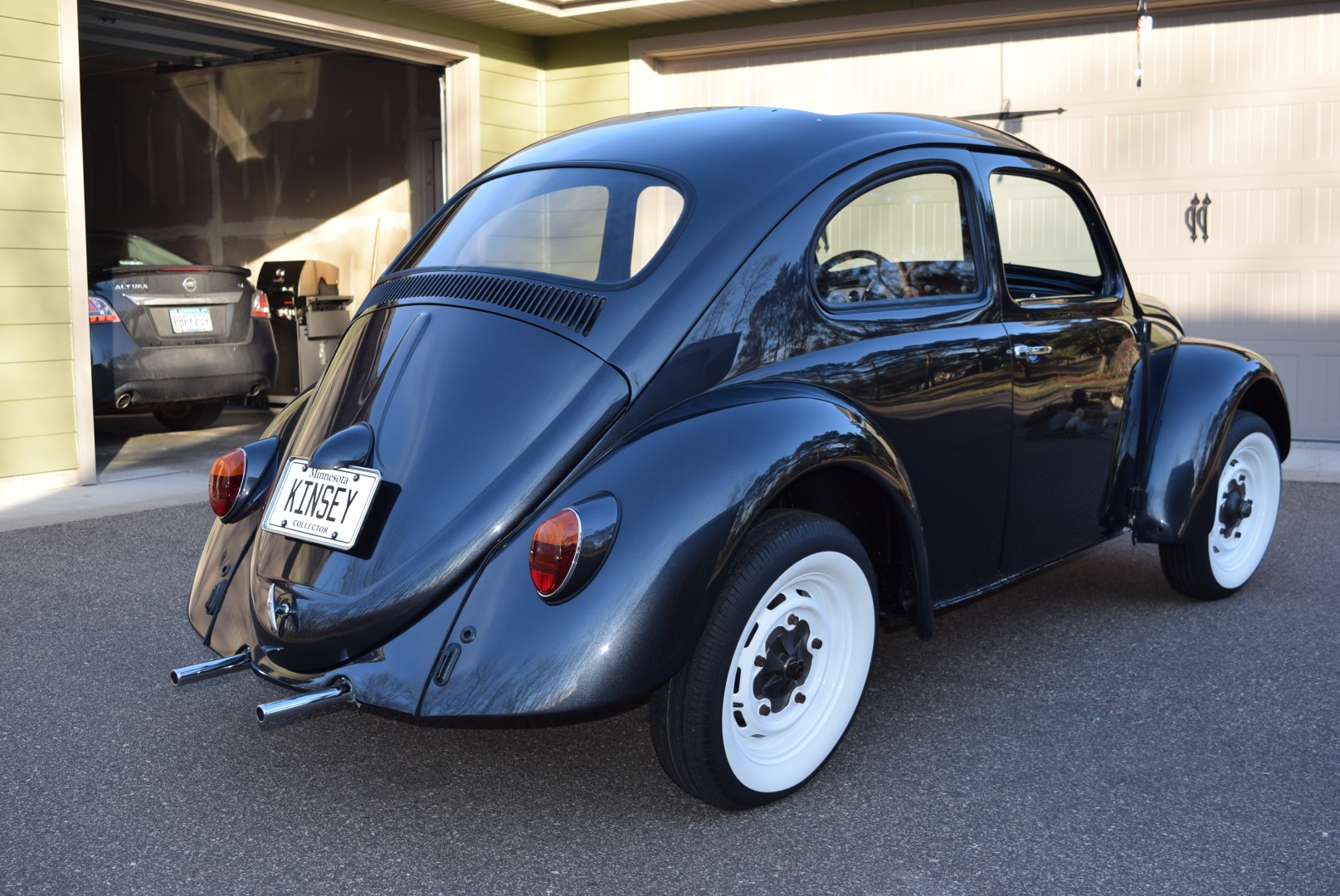

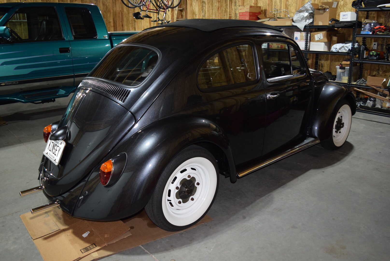

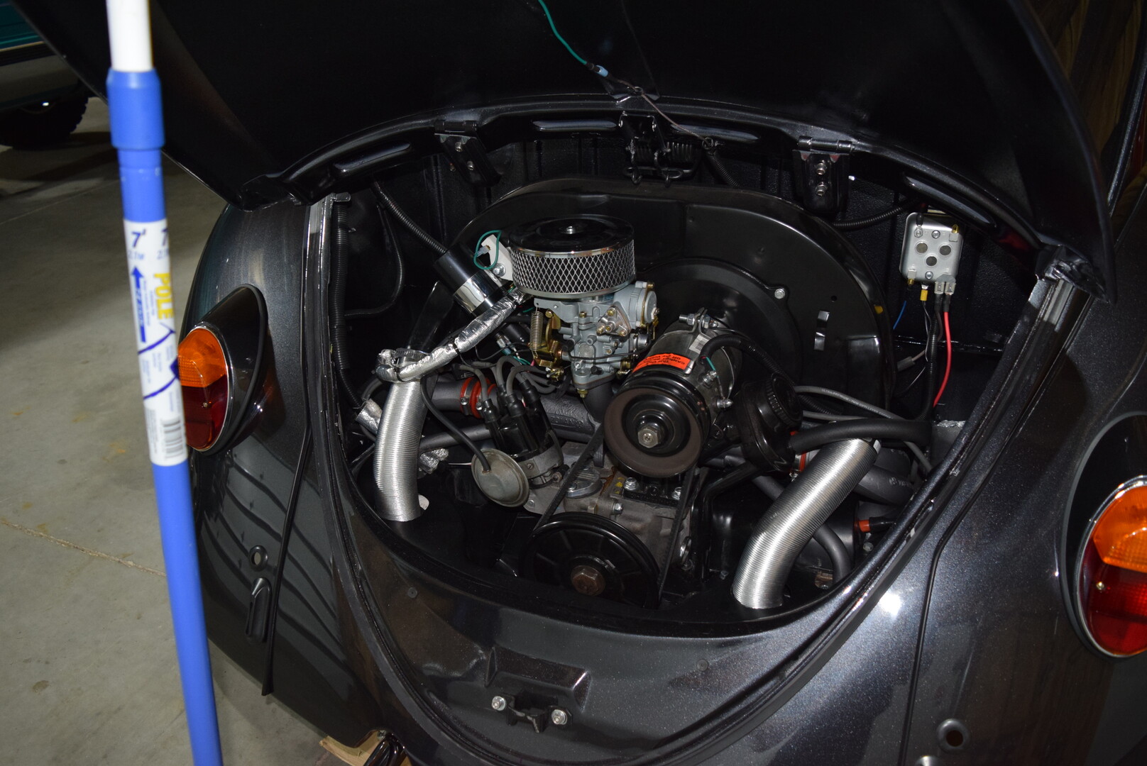

Started to install some windows. Karen and I installed the rear quarter windows. With the help of Chris and Jenny S., we installed the rear window and front windshield. Thanks Guys! Could not have done it without your help. Starting to install the vent and door windows.
I feel the bug is ready for the road. Taking it out of the Car Apart Club.
I correct the engine overheating issue. I installed a heat shield on the back of the of the engine, installed the air tube from the fan shroud to the exhaust manifold and wrapped the muffler with header tape.
Because it had old fuel in the carburetor, I asked Chris S. to teach me how to clean the carb.
After driving it for a bit, I did not like the play in the steering, so I replaced the steering box. It steers nice for a 65 year old car.
