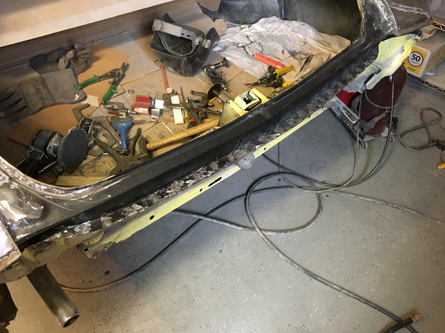

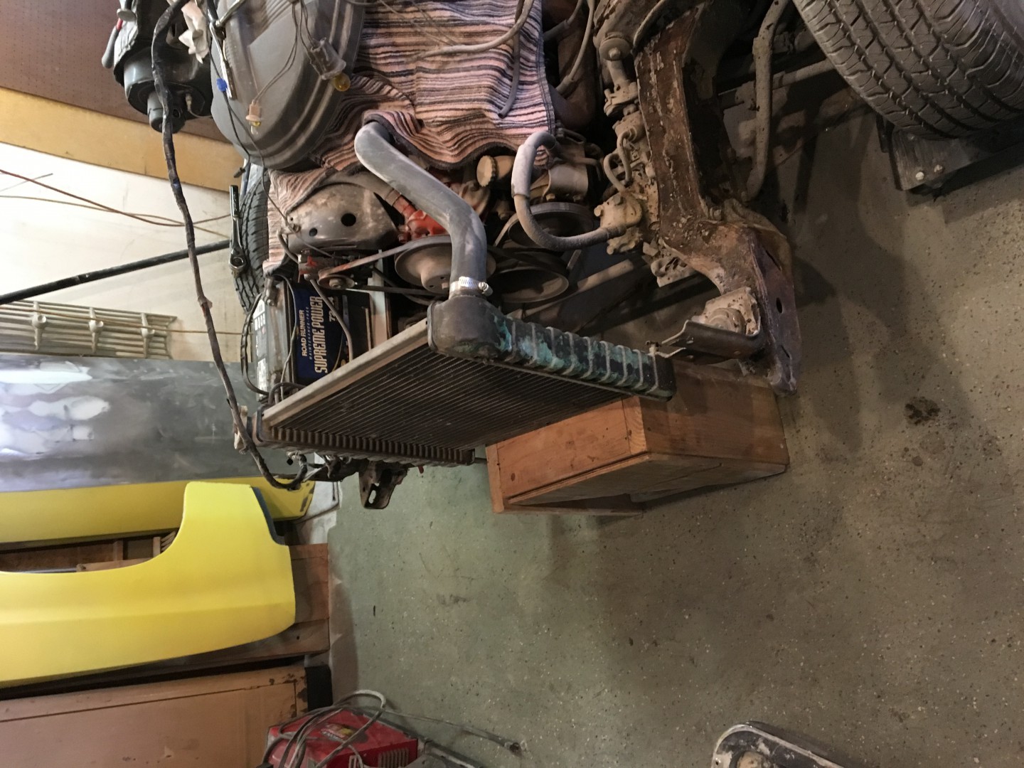

Guess it is time for some updates
Decided that while i ponder the best way to "tweak" the body line at the door jam (have a good idea on how to proceed, but like to do it in my head before the cutting starts), due to previous bad work (resulting in piles of Bondo, id bite the bullet and start on the radiator mount.
It along with most things under the hood was sprayed with some sort of undercoat/bed-liner. At 3 dust pans full so far and still have a ways to go.
A new scraper tool that i got for under 10 on line is really helping, so much better than the little silver ones with a retractable blade.
May as well start cleaning up the frame, also covered with a thick layer... and no Mitch, not planning to pull the engine and tranny (at least not yet?!)
-- Edited by BLyke on Sunday 28th of January 2018 08:24:50 AM
Yuck, that's a nasty crease with a lot of stretched metal. From the book "Principles of Metal Bumping", I would start were the crease ends and try to push it out from inside as best I could, working toward the front. That will move the metal forward to reshape the jam. Basically reversing the crease to the outside where it can then be shrunk back to size. Shrinking disc and cold water in a spray bottle to shrink it back into place. Lots of hours of patience will get it much better.

I do have the book, but the worst part is the contour that should march the door is off, as if the gap from top to bottom. Note to self, again... Next car try to start with la ow rust car that have never had the body worked on. (The comment I have resolved to follow many times)
Jan 28, 2018
The edge of the quarter at the bend into the jam is pushed back and in. By moving metal forward, you will gain metal to push the edge back into shape.
You can see that in the first pic. Looking at the quarter skin from the door back, it appears as a wave, starting too low and going too high. By moving the metal forward, it relieves the stress caused by the edge being pushed back and allows the low area immediately behind it to rise, which allows the high area further back to relax and lower.
Never going to be perfect, but much less "chemical filler" to blend and smooth.

Thanks Karl and Mitch, Actually I as able to get it cleaned up a bit by making a patch, bumping some areas and we working some of the old panel welding (cut, moved a bit and re-welded)
we shall see, will post a new picture when i make the last tweak As far as a drop in consultation, appreciate the offer, when I'm on the project is very sporadic at this point
Update, with the work here, the heaviest layers of "Rage Ultra Plus" will less than the thinnest i took off. Fits well with my goal to "Fix up" my driver, happy with the new vertical gap. It should look a lot better. the lower section may need a patch too.

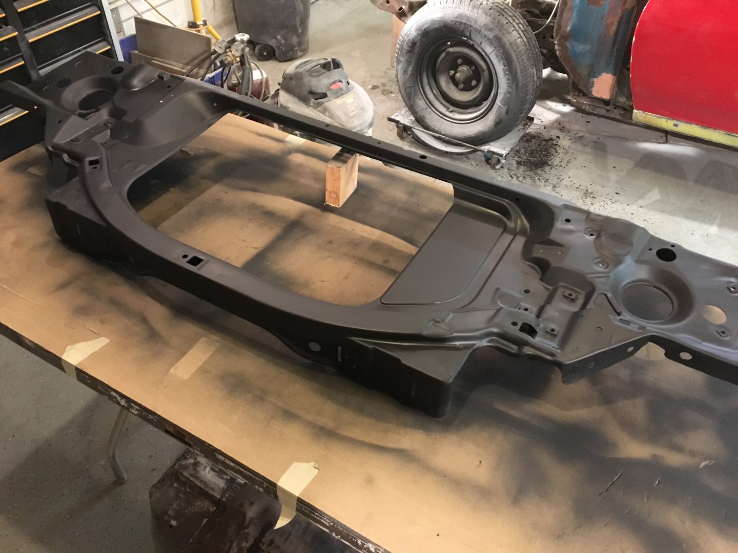

Decided to splurge a bit on this one. It has been in a guys shop for may years It is in primer but in very nice shape, price was on par with a repop Sounds like he never even got around to mounting it on a car. Not sure why he seemed to think it was for a Nitrous Oxide Systems (NOS) Any ideas on how to best remove the tag on the inside?
I have a rubber eraser wheel that I use. If it is factory EDP primer, you can loosen the adhesive with a rag wetted with brake cleaner too. Now you're starting to look like me, buy 3 of 1 part until you get what you want...

Ordered a floor section for the drivers front and one for under the rear seat. At least they don't have to be shiny.

floor just showed up, not sure i could buy the steel at fleet farm for the formed and delivered to my door cost.

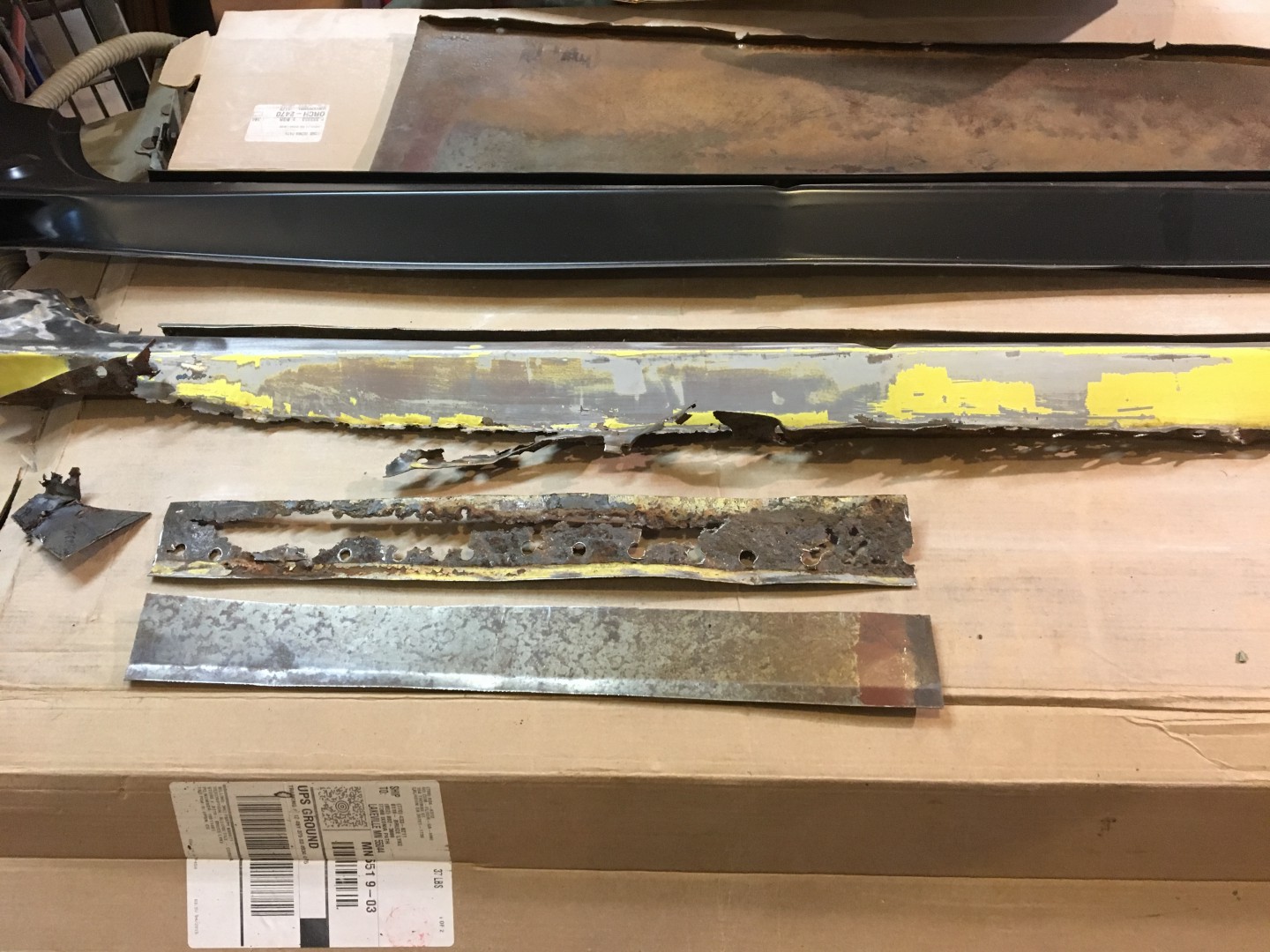

Update on the floor for under the rear seat.
got a notice there had been damage in shipment, then a notice the order was cancelled and i got a refund
now there really ant any as cheap when shipping is included. oh well, orders a different one.

Have you called Denny, up at Auto city Classics to see if they stock this ? There wouldn't be any shipping and we may be able to transfer it down here in stages...

Will be replacing part of the rear before putting the purchased panel on.
Are you going to chase that trunk lip all the way to the quarters before attaching the upper panel ?
Fortunately the bottom layer is very solid.
The back ~5' are home made patches too.
getting there...
Well the price was right and it will fit right in with the rest of the repairs that have been ongoing.
Picked this and a new dash from CL.
Making progress on the back end new metal in and corners reworked to remove the ~5/8" of mud taking the fenders a back to the trunk lid.
Mostly need to clean up and then a bit of filler (yes, but way less than was there) for the "Fix-up"
I'll be following this Bruce on the floor section work under the rear seat, as I have the same issue on the drivers side rear of my '71.
Hi Stan,
there is a new one available at ~1/2 most of what was on line. Seems one that was around may have been discontinued.
should see it next week, no clue as to when it will get installed :-)
