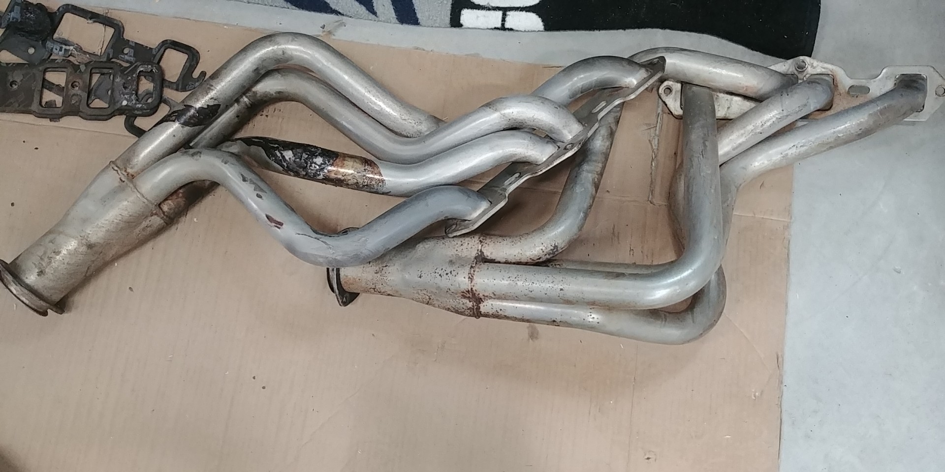

Where did you have the ceramic coating done Karl?
Did they also sand blast them first or did you have it done already for coating prep?
I'm looking for a place to redo my headers since I know they fit the exhaust so no modifications needed that might happen with a new set.
Perfect, thanks Mitch! I need to stop by The Carb Shop in FL anyway, so I'll catch them at the same time.

Stan, I used Prairie Porcelain in Faribault, they did my BB manifolds too.
They prep them too.
These manifolds were pretty pristine, not Minnesota iron.

Sorry to be late with this, but I have had good luck with:
Mark Urban at New Image Coatings
7337 Lake Drive
Lino Lakes, MN55014
651-784-7055 newimagecoatings.com.

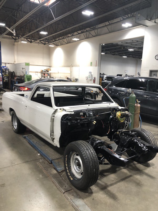

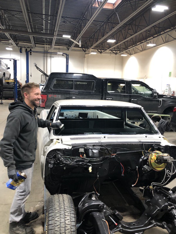

Update, 04/13/2020
Ron has been busy.

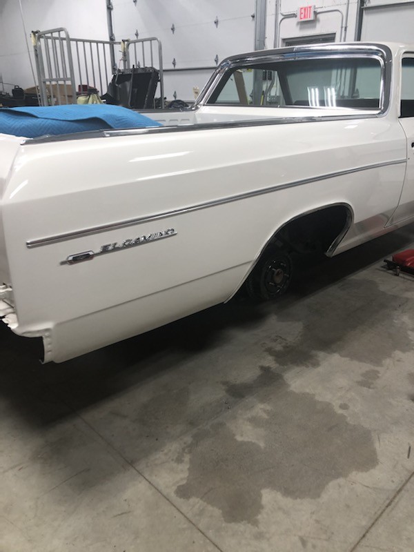

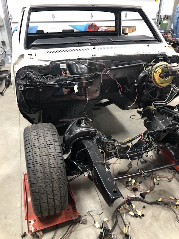

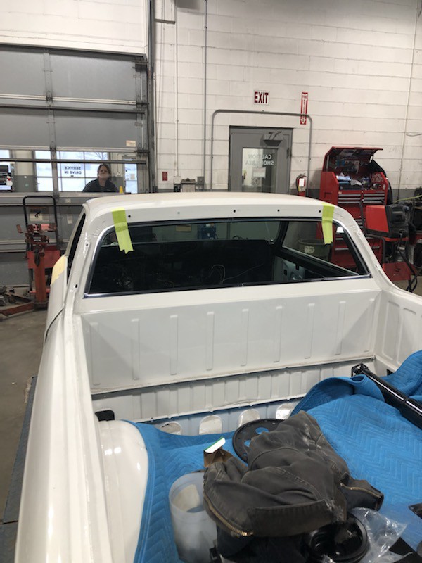

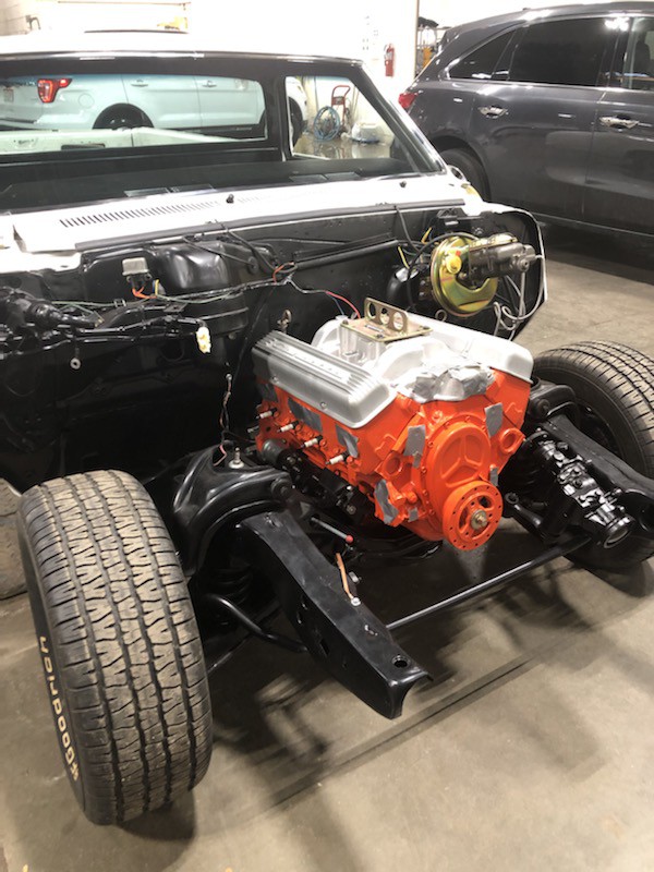

All bed and roof trim on, all 1/4 trim on, gate trim other than upper moulding on.
Upper dash, some wiring both sides of cowl on.

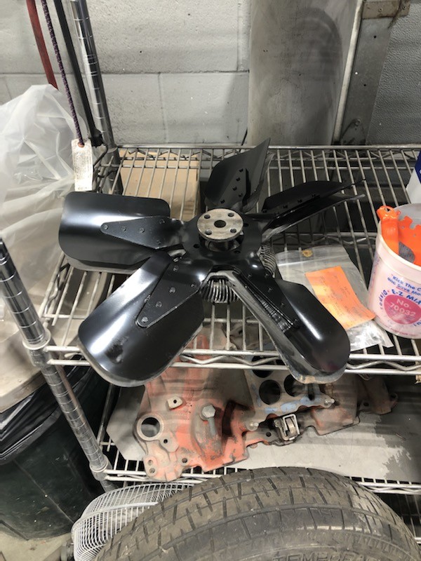

Water pump, Fan, clutch, pulleys, bracketry being test fitted, detailed.

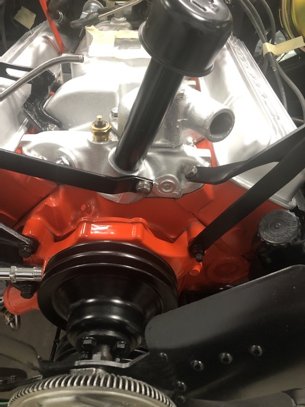

Issue with Alternator bracket, may need to fabricate as L-79 intake is different than stock cast.
It is getting there.

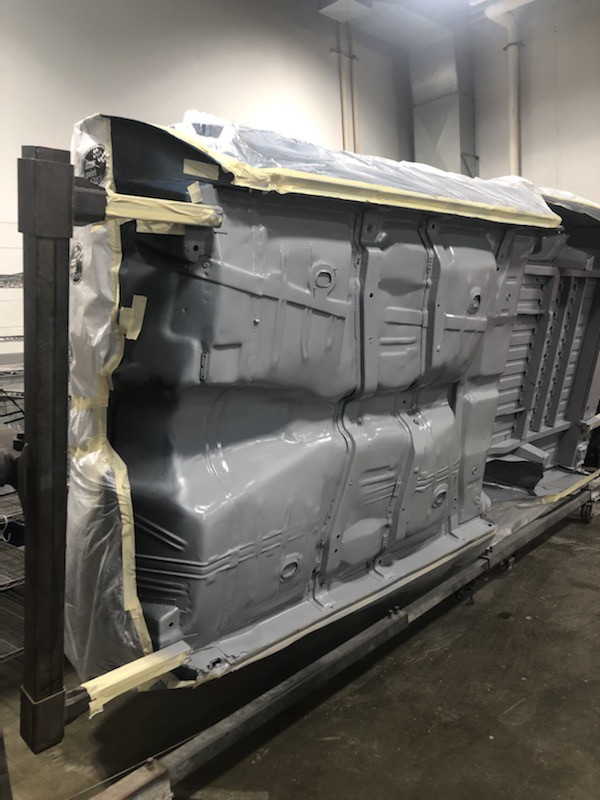

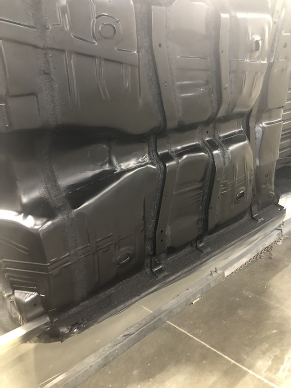

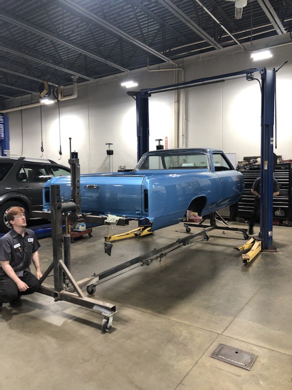

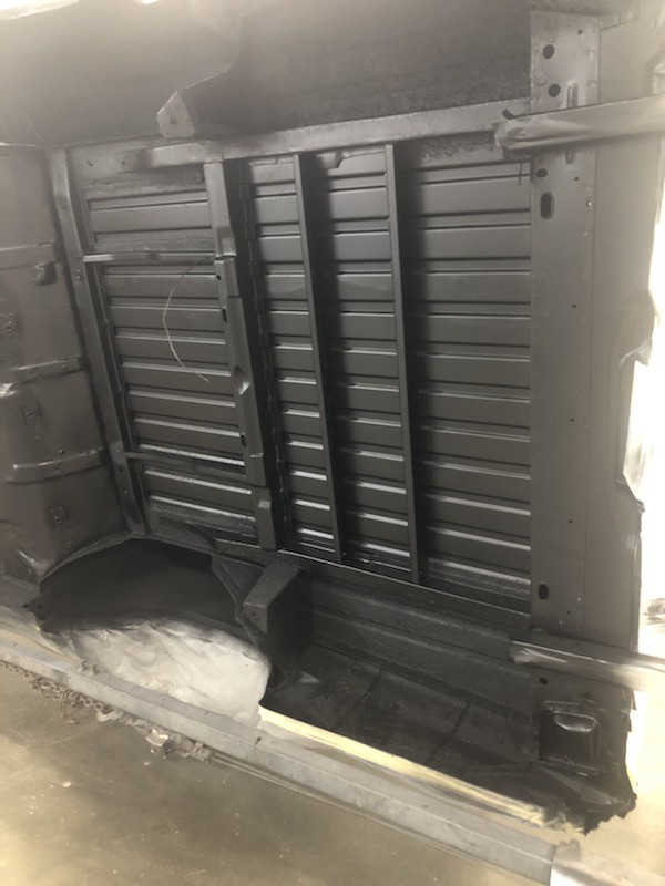

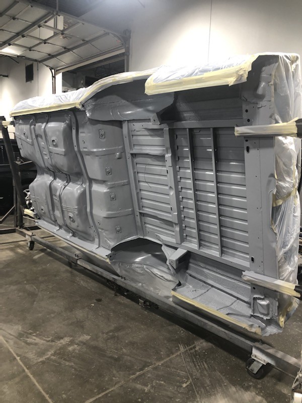

Floor of Blue car is now in Epoxy. My favorite caulking technician is off this week. So Caulk next week. Spray with satin black, then underside is finally done. Crawling along.

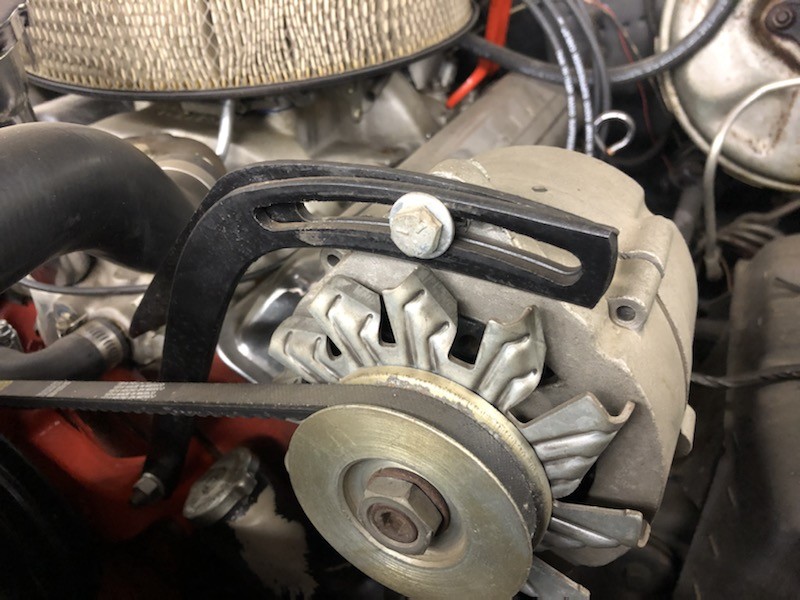

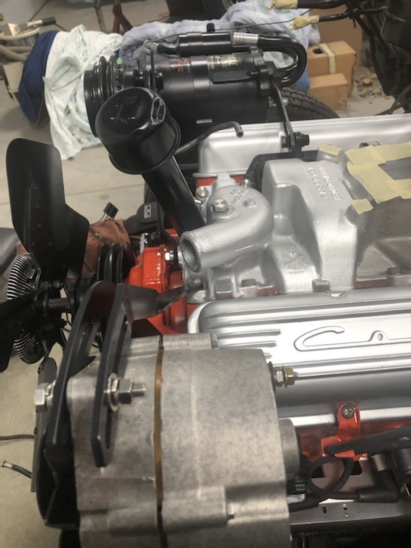

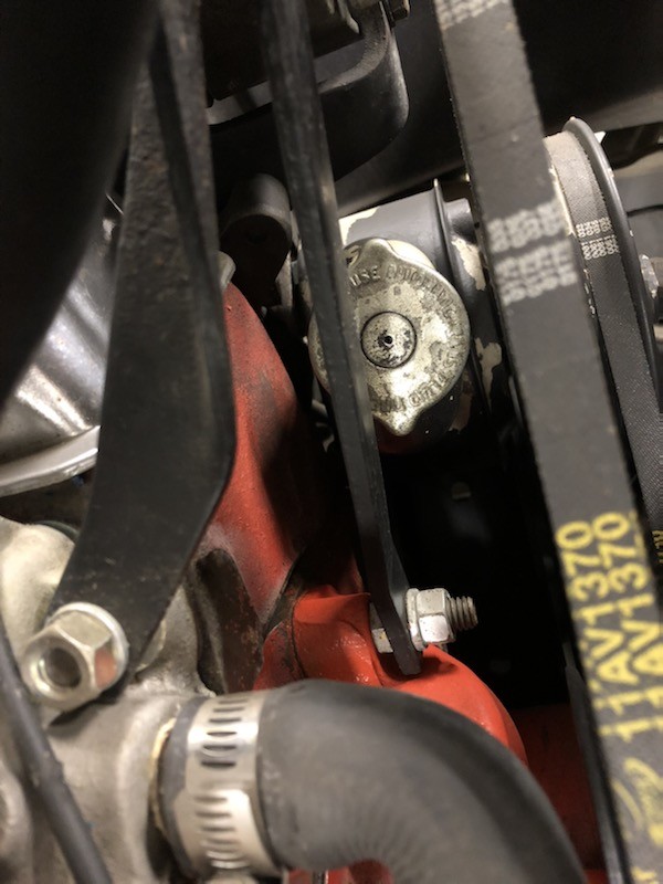

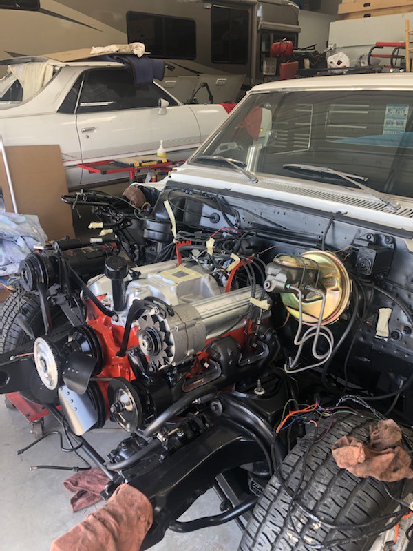

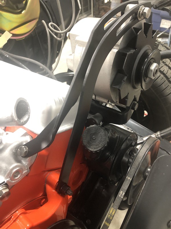

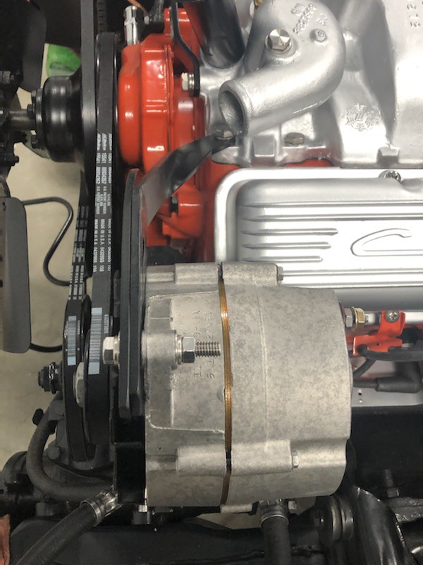

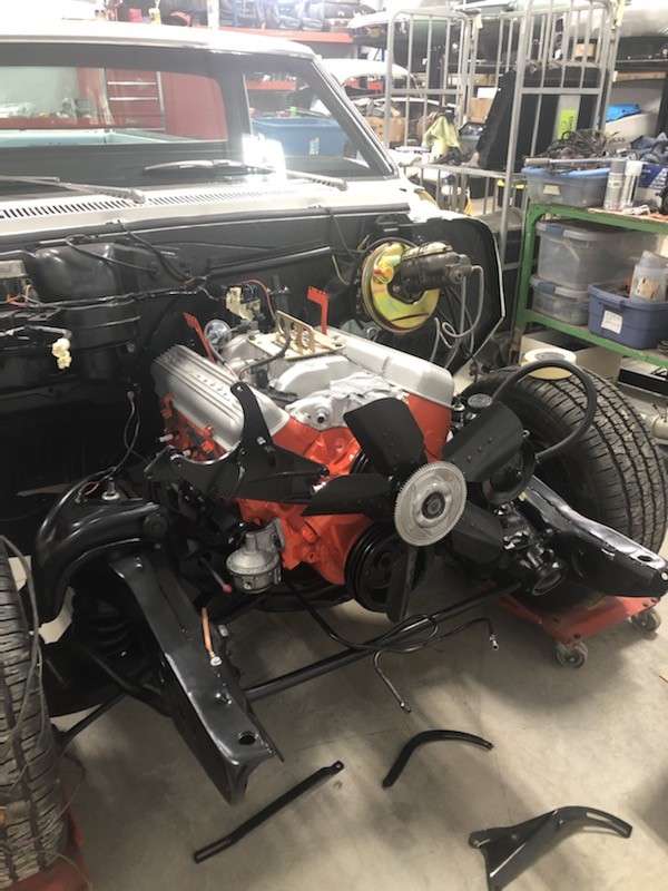

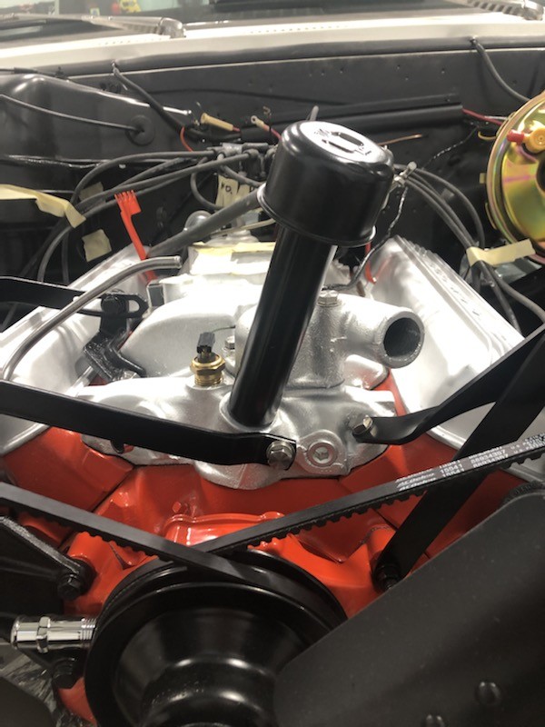

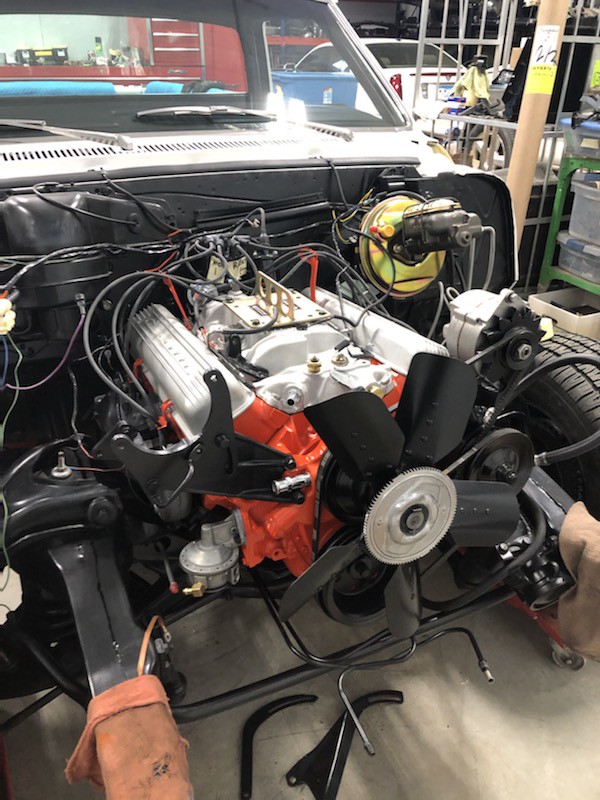

I'm rather certain the double brackets on the alternator are supposed to be together on the back side.
Jun 3, 2020
We don't disagree.
The one on the rear now, can only bolt to intake.
Plan on playing some more on the long one.
Thanks!
Jun 3, 2020

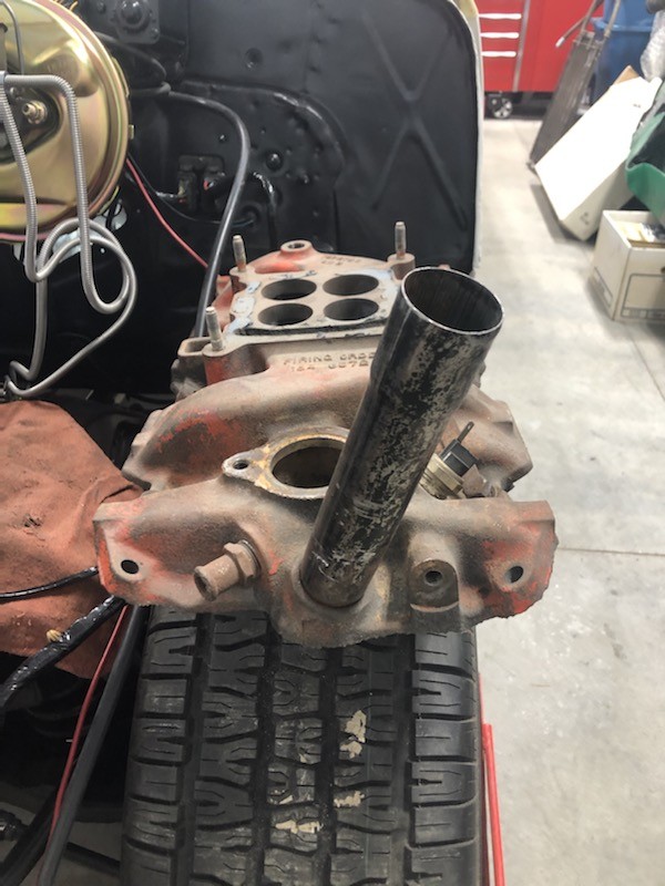

The long bracket may go to a stud on the top right water pump location. That water pump bolt would have a 5/16 thread from the hex "nut" for the bracket and nut. OR, it may have been on a threaded boss on the front of the intake on the hp engines, that the rest didn't have.
I can't find a good pic on the www of how that bracket mounts....frustrating, because I know I have seen them before. 1967-68 Z28 had that double bracket too.
Jun 4, 2020

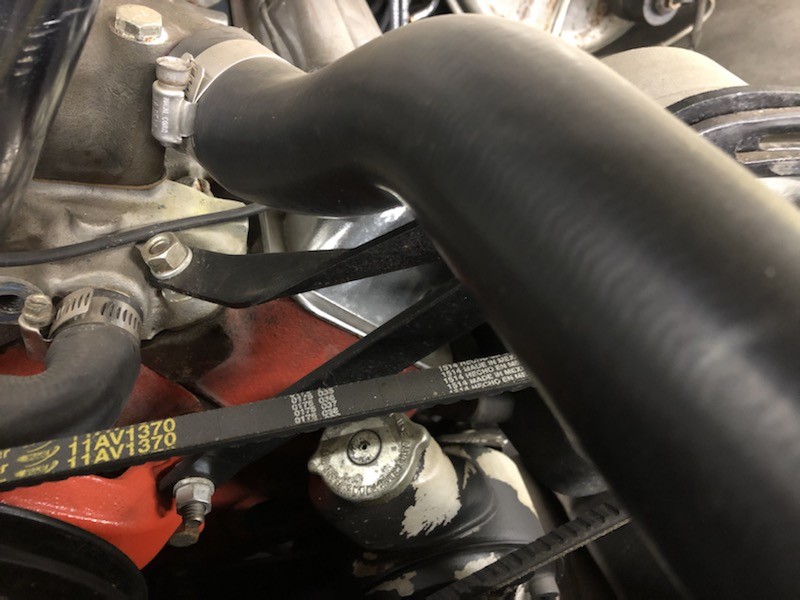

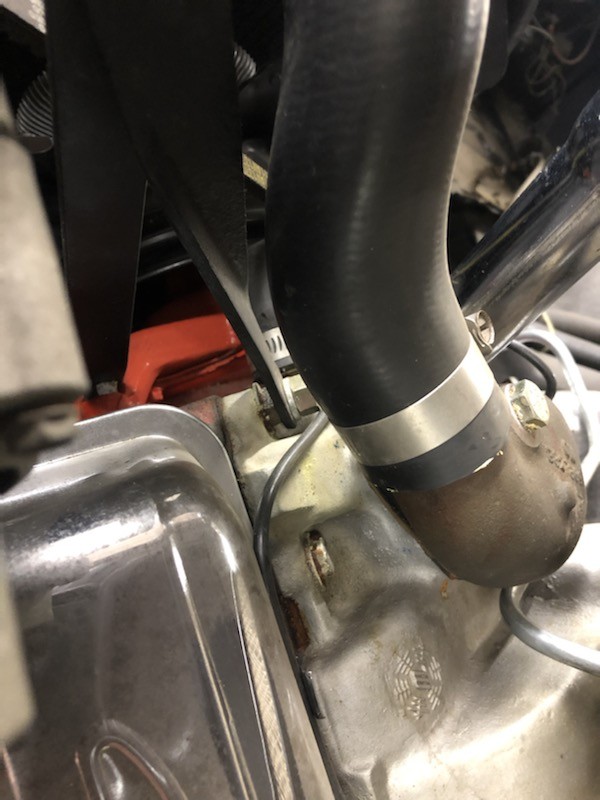

More pictures of brackets.
The upper radiator hose has to clear upper bracket.
Aluminum intake has different Thermostat outlet and mounting locations.
Could probably do some "reconfiguring" of long bracket to pair it up with one attached to intake.
They are aftermarket anyhow.
Still playing.
Really like the machined surface of the intake bolts, they are stainless, think they look pretty cool.

Ordered exhaust for both cars, belts are here, carb will be done next week.
Jun 4, 2020
You should be able to just push the front bracket to the back side. It looks like it wants to go there, as it is closer to the rear bracket in the center area and then is forced forward to be on the front of the tab. Being aftermarket, it may need a little "tweaking" to be where it should go.
Jun 5, 2020
Ron had pictures showing one bracket, two brackets, brackets on front, rear, all over.
We agree with Mitch, paired up on front of alternator.
Texted my friend Brett Jensen, Fergus Falls, he has a 67 L-79 wagon.
Pictures he sent show brackets in front.

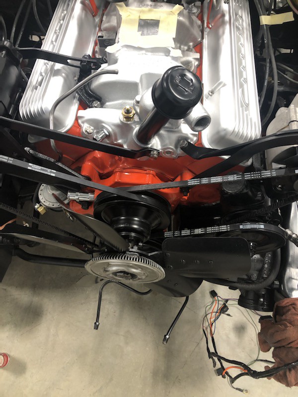

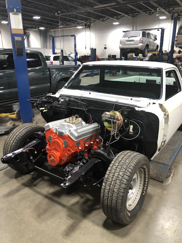

Ron did some "tweaking" this weekend.
Starting to look like these parts actually belong together.

I’ve seen the two brackets on the front of the alternator on numerous SB out in an old salvage yard I go to. Can’t remember if thy were 283 or 327’s. Or if 64, 65, 66, or 66. I’ve also seen the single bracket also with the bracket in front. Then again a lot of guys have it mounted incorrectly and don’t want to here that.
Thinking 2 braces on 65 L79 and 1 brace on 67 L79.
-- Edited by jim larson on Wednesday 10th of June 2020 07:45:39 AM
Jun 10, 2020

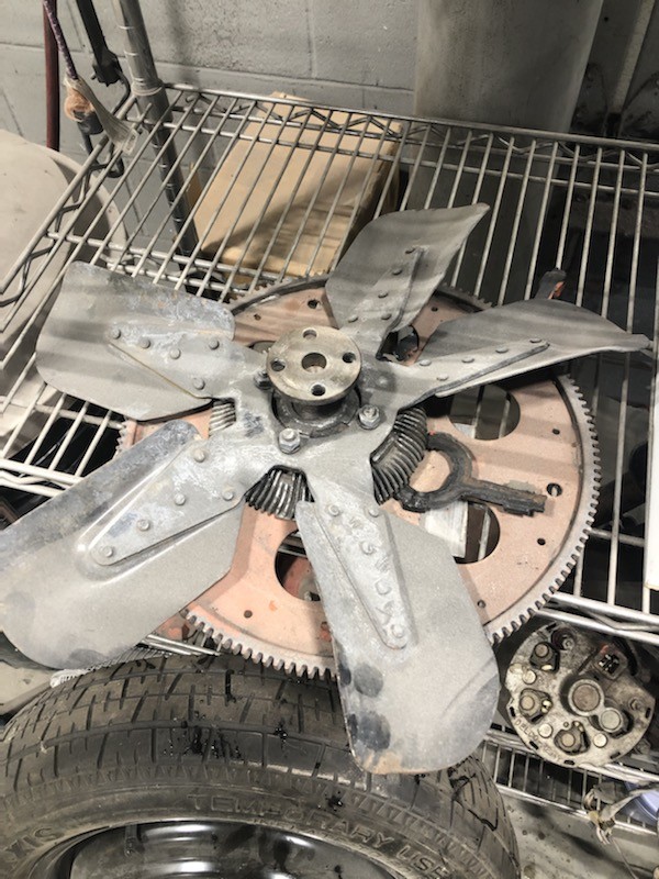

Mounting the bracket on the front, often causes the fan to hit it, as in Karl's pics... but I do see a number of them mounted that way...
Jun 10, 2020

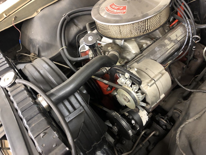

Sorry, I may have miss lead. Both my SS and malibu for 66 show bracket on back side of alternator and that how I have seen them in the Salvage yards with 1 o 2 bracket set up. 1 bracket on 66 and 2 brackets on 65. There is one photo in 66 AIM that hints at 2 brackets for L78; but other places shows a single bracket. No L79 in 66 so nothing there. Don’t dare mention alternator mounting to those at shows who say they have a professionally restore car.
Jun 11, 2020
Here is a very correct '65 L79 showing it behind the alternator.
Know nothing about those, I would say around a couple dozen 65 with a SB that appear very original in that old salvage yard have a couple of bracket, not a single one like in that photo. couldn't say its mounted like Karl's; but I do remember the two brackets. Maybe the intake o n the L79 does not have the provision for the bracket from the intake. But Karls seems to have it. I guess I would ask some of the 65 experts on TC. Maybe even wrong alternator fan?
-- Edited by jim larson on Thursday 11th of June 2020 04:15:37 PM
-- Edited by jim larson on Thursday 11th of June 2020 04:18:04 PM
-- Edited by jim larson on Thursday 11th of June 2020 04:29:40 PM
Jun 11, 2020
Yep and only the one. I read conflicting info on the www about what is "correct" on an L79. Many believe only the '67-68 Z/28's got the double ??
Jun 11, 2020
Where else can we have so much fun?
Dereks' pictures shows earlier model?
Single bracket in back upper hose routed to R/side (passenger)of radiator.
Bretts' picture shows paired bracket, upper hose routed to left (drivers) side of radiator, bracket in front.
Possibility is they are both correct.
I have seen, felt and touched Bretts' 67 a few years ago.
I am in step with Mitchs' concern regarding Alternator fan contact, makes sense, will verify.
The Iron and aluminum manifolds are very different.
Will post pictures of original soon.
Ron and I truly appreciate the comments.

I should have considered design changes during the year. Just for one example: 3 different doors used in 66. the person I have the most trust in is Jeff Helms from NC.

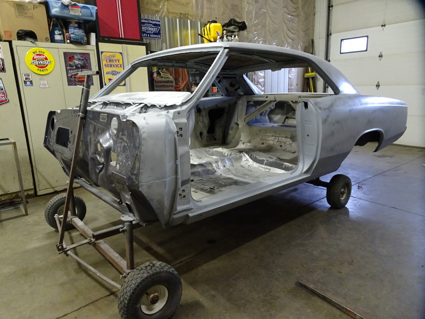

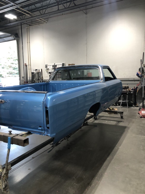

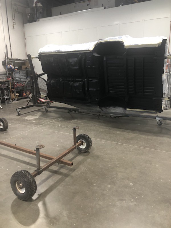

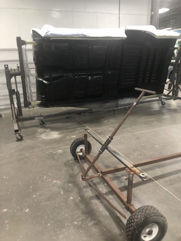

Floor now done in satin black.
Rust proof floor braces and it will go on body dolly.
Good eye MItch, r/f is flat. Have tube and tools. Tires are really brittle. Actually bent wheel lip trying to get bead over edge. Inner bearing races are fused to spindle, trying to get wheel and tire assembly off.
The Lawn tractor that donated the wheels was probably about the age of your son
I may just go to Northern and see if I can match up a wheel and tire assembly (or four). Then we can assault wheel bearing with Heat!

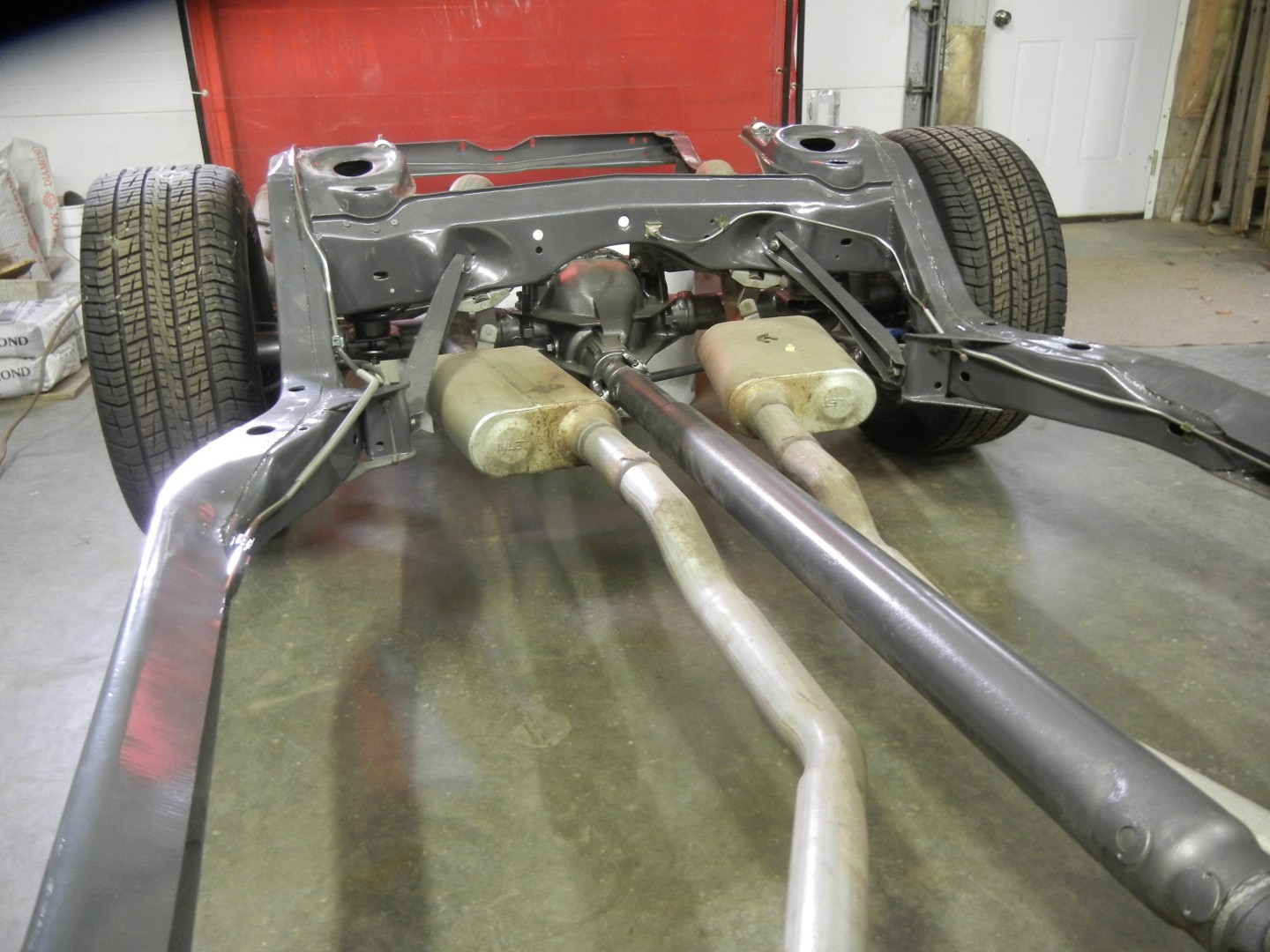

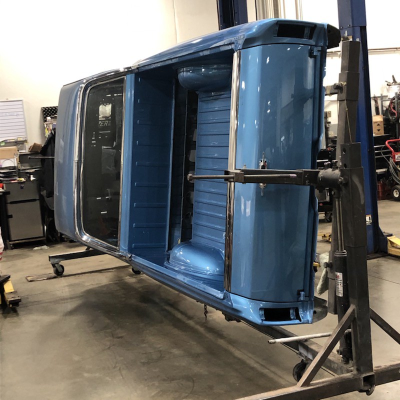

Going to keep Elky (blue) body and frame separate until all lines, plumbing, fuel system and tank are in.
Will slip fit exhaust.
Cart will allow transport and storage or additional assembly if time permits.
Body and cart will go back to "Treasure Chest" asap, frame is already there.
Jun 16, 2020

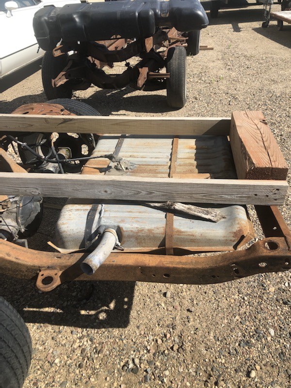

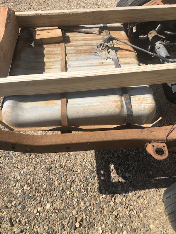

Looking at my pic, it was the right rear, I replaced the tube in. Stinks that the bearing is seized to spindle.
Exhaust can go on the frame before body, then tank on the body and then mate the 2 up, just like assembly line...
Elky tank has straps on top, brackets on bottom. Straps attach to brackets.
Fuel tank bolts to frame, with brackets, not body. Filler neck and transition hose go from tank up to quarter panel. The only tank connection to body is the ground wire, and filler neck attachment to fuel pocket.
Will post picture later of my "roller" frame.
Thanks
Call Clinton at Race Coatings. He is in Forest Lake.
Mention me and you have a Camaro, he gives a little price break for club members.
https://www.racecoatings.com/our-services
With 70 plus people "torqueing" the fitting, it has to work.
They prep them too.

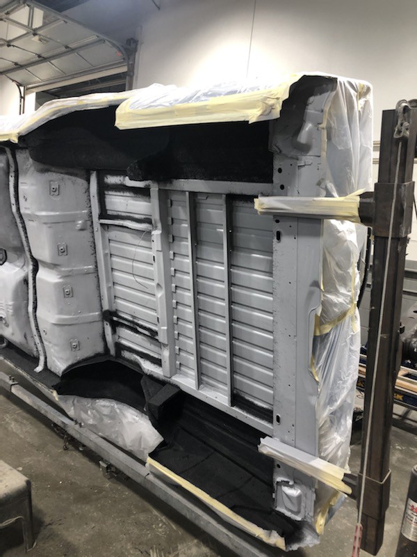

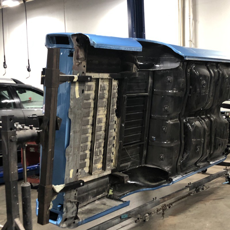

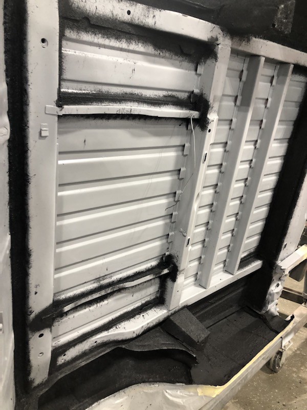

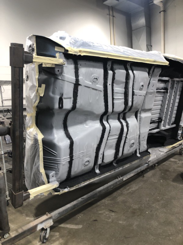

Split body and frame today, floors will get scuffed, epoxied, caulked and then painted.
Rotisserie was still set from White car.
A little more difficult due to balance issues on hoist when tailgate and doors are on body.
Managed not to drop it on floor.
White car engine mostly assembled, waiting for Carburetor build and alternator brackets on order from OPGI.
So Caulk next week.
Crawling along.
Crawling is better than stationary...

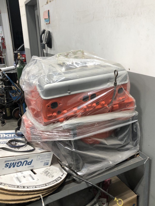

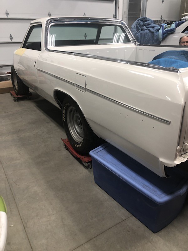

Have been bragging about Ron's progress on white car.

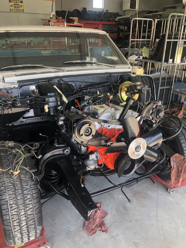

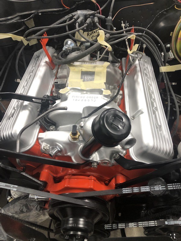

Here are some engine pictures, waiting on carb, belts exhaust.

Blue car floors.
Stainless bolts were a picture misfire, those had heads machined for white car 327.

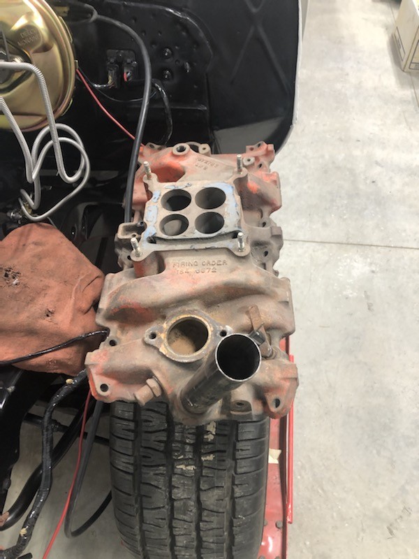

Thanks!
Still playing.
-- Edited by more ambition than brains on Thursday 4th of June 2020 03:14:47 PM
Update pictures on Monday
May still shorten adjustment bolt.
Thanks Mitch, and Brett Jensen in Fergus.
Ron and Karl
That looks correct to me.
The alternator should be threaded for a 5/16 bolt...no nut
1/2" wrench for adjuster...9/16 wrench for pivot bolt.
-- Edited by Lost in the 60s on Monday 8th of June 2020 07:15:42 PM
These pictures are from Brett J. This is an actual 67 wagon with original L-79.
Maybe the bolt on back was added later or maybe it was added as a lock-nut due to the double bracket set-up
Other than maybe shorten bolt we will more than likely leave it the way it is.
Really appreciate your comments Mitch

Exhaust has arrived for both Elcaminos.
Blue Elky needs to get "plumbed" with brake and fuel lines next.
Will also install fuel tank and assemble fuel system for blue car while frame is separated.
My son Scott just reminded me that he needs to get exhaust for the other "Elky" (g-body) project.
Three "car guys" three (Plus) projects.

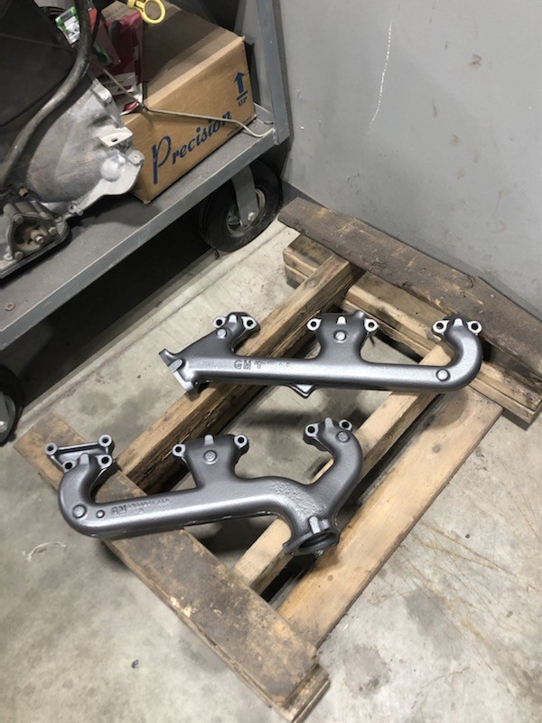

That looks like a pic of Rich Cummings car in Nebraska.
Sure is!

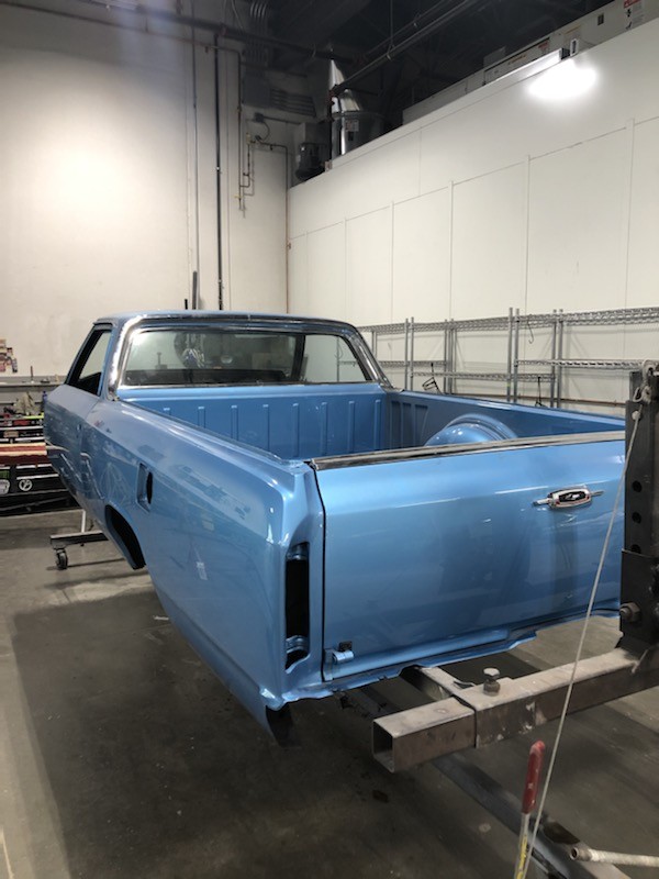

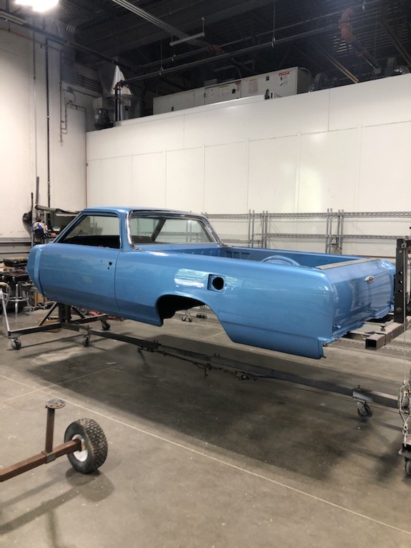

Looks good.
I've seen that body cart... looks like the front tire is flat. Is that the one I repaired ? or was that a rear ? Can't remember...

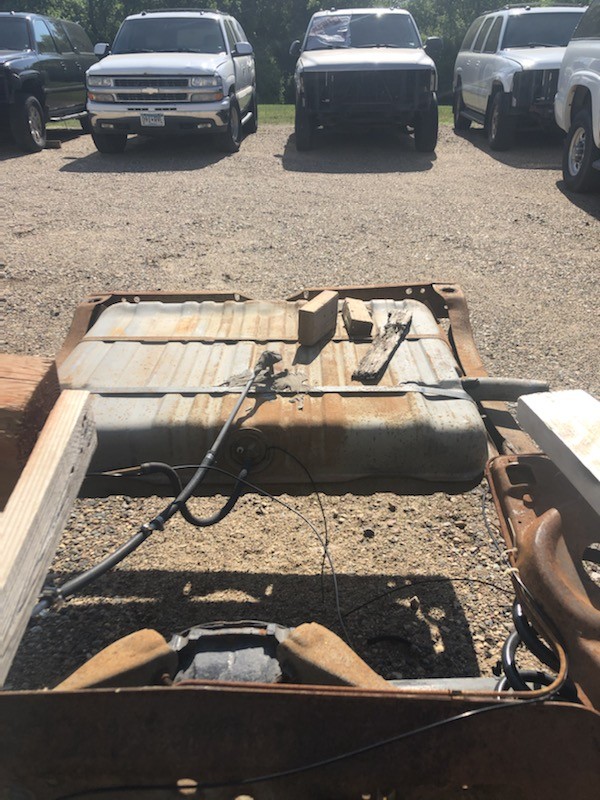

One of the few ways ELCaminos are different.
