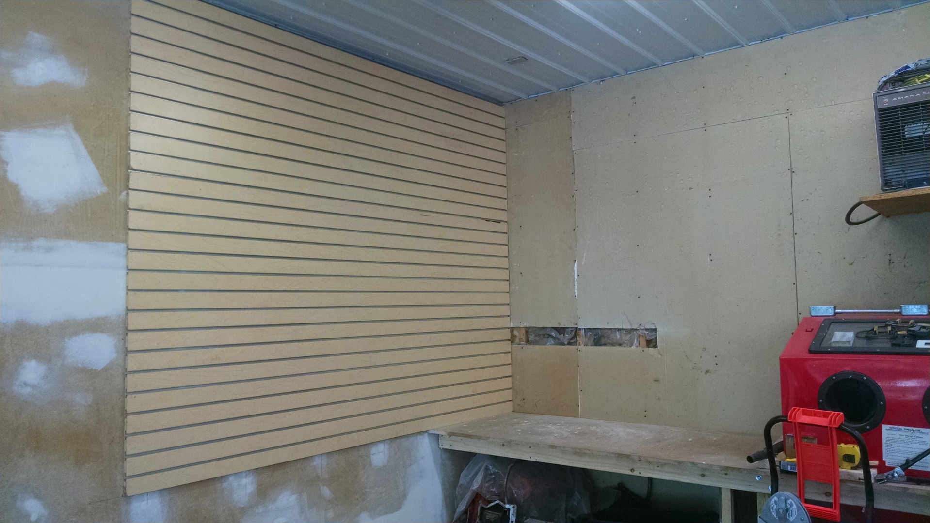

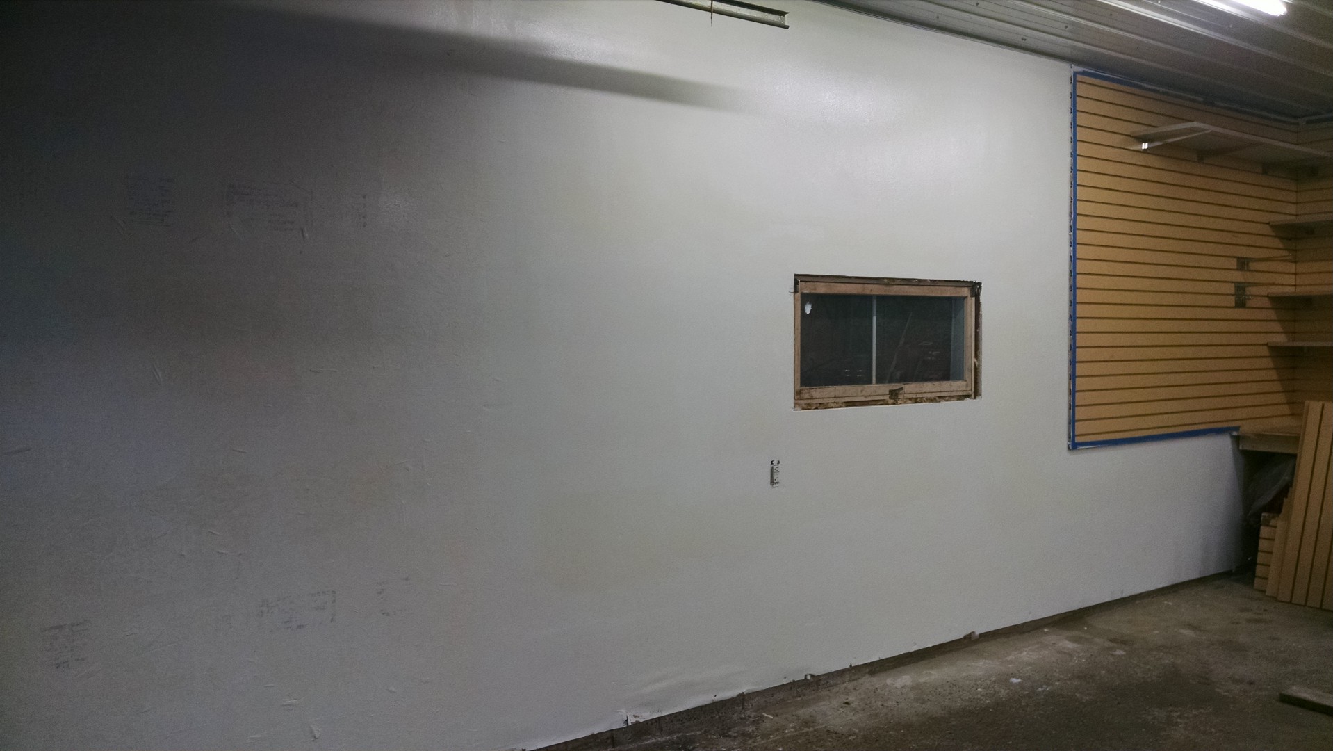

I'd really been kicking around the idea of sticking "FRP" (Fiberglass Reinforced Panel) on the walls... you know, that shiny pebble-grained stuff in janitor closets/commercial kitchens/etc.
After doing some research and watching some YouTube vids, it comes to be that the wall surface really has to be "paint ready" to ensure a good bond with the mastic. Well crap - if the wall needs to be "paint ready" - why not just PAINT the dang walls and save the $25+ per 4x8 panel!!
So out come the mud knives, hawk and tape, get a 5 gallon bucket of mud and revive some old skills. (I really want to punch the old owner of the house in the nuts. He did a crappy job of hanging the 'rock in the garage!)
The other plan was to hang "slatboard" on several areas of the walls. The flexibility of hanging something anywhere, and being able to cover 32sq/ft. of crappy 'rock in one go was appealing. The ugly part is the stuff is $40 a 4x8 sheet for basic white. (Yeah, I'm a cheap SOB). Then, the "basic white" doesn't have the extruded metal inserts in the grooves, so it's very weight limited (cantilevered) as to what you hang off it. The metal inserts are another $55 for each 4x8 panel.
Did some research and found this place! They salvage/reclaim retail store fixtures and accessories... including slatwall. They also stock every bracket/hanger/gizmo imaginable in bulk.
For about $130 I got five 4x8 birch veneer slatwall panels w/ metal inserts, five 14"x60" laminated shelves, and a load of brackets and hooks - and they loaded it in the Green Mary.
OK... the panels aren't perfect. There's a gouge or chunk out here and there, or an outlet box cut in, or the corners are dinged, but cut/plan around the damage and save big $$$.
Next step is to prime this wall, then move/hang crap on it to open up then next wall for work.
That should work great.

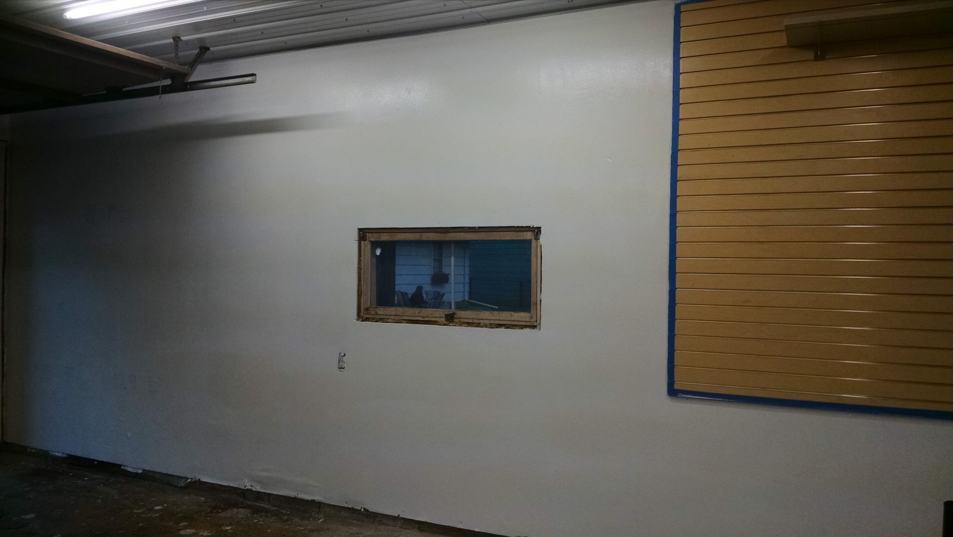

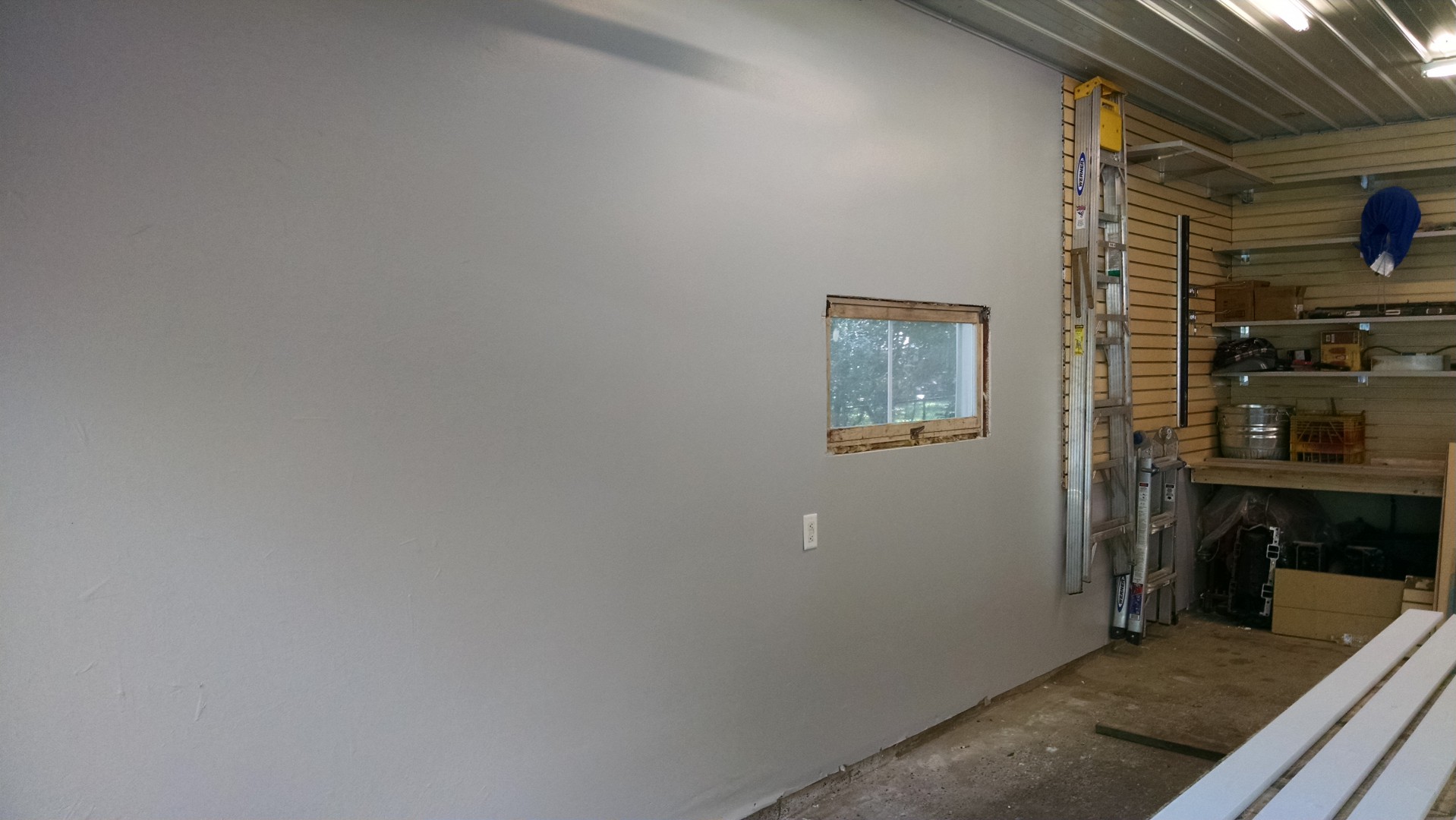

Just got cleaned up from priming the south wall. It took 1-1/4 gallons of Kilz "premium" for two coats - and the stamping on the OSB is still leaching through! We'll see - I'll have to do a test swatch with final color to see if it bleeds... thinking a gloss light grey.
It's amazing at how much just this one wall in flat primer brightens up the space!
(I don't even want to go near why Bryan needs a mannequin...
Yeah, the slatwall is neat stuff - but friggin' HEAVY - about 75lbs a sheet! But what's cool is if you wanna hang something up, just click a bracket/hanger in the spot and done - no anchors, looking for studs, etc. It's screwed to the wall through every 3rd slot into the stud. In my case the ends of the panels fell between studs, so a bead of general-purpose construction adhesive near the edge is sticking it to the wall. What's also cool is if you use the metal slot inserts, the fasteners/screw heads are concealed.

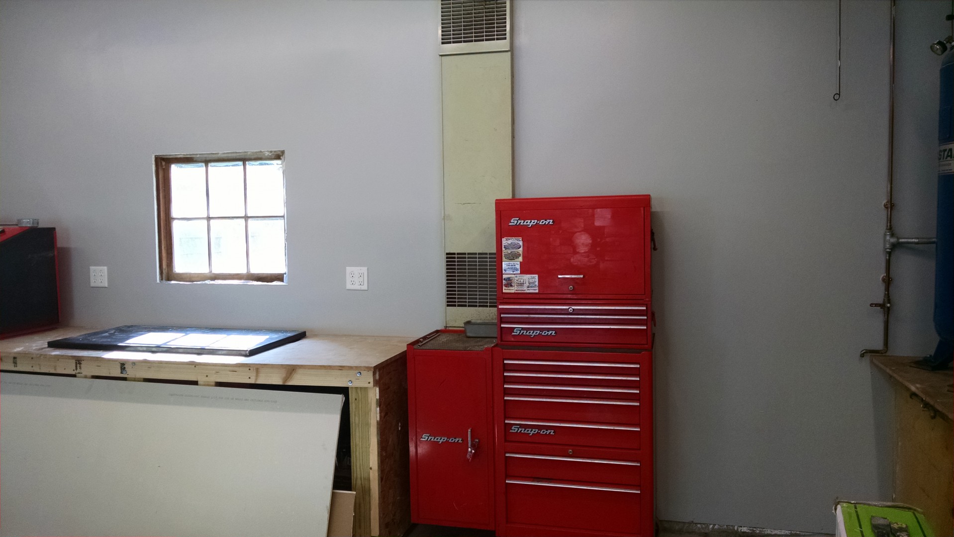

With the exception of a piece of 1x4 base molding, the south & west walls are DONE!! \
Insomnia has its benefits... (OK, maybe not insomnia, but being "body-clock" programmed to wake up at 5am) Did the finish sanding & the prime-coat on the west wall before the stores opened. While drying I went and got the color paint. Got back and put the color on the south, then the west.
I am REALLY HAPPY at how this is turning out!
And well you should be. Nice job.
I have the body-clock thing going on too....

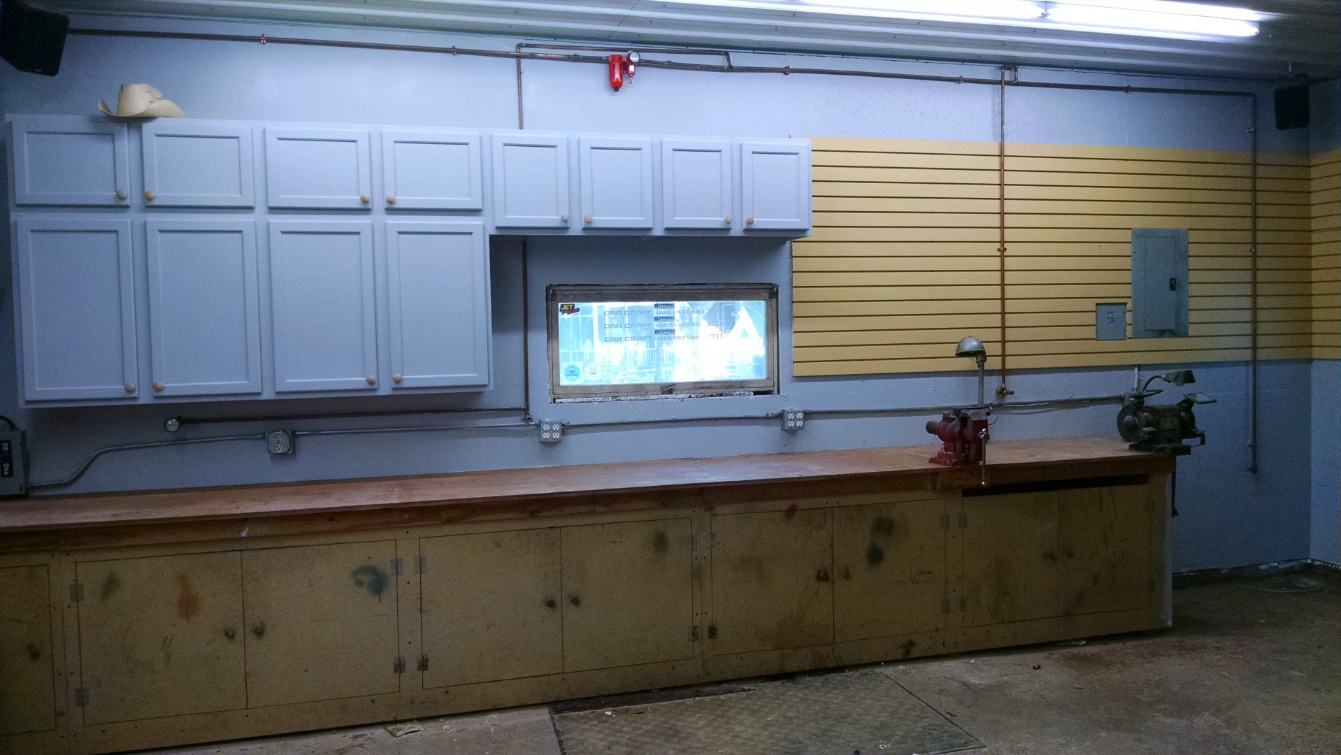

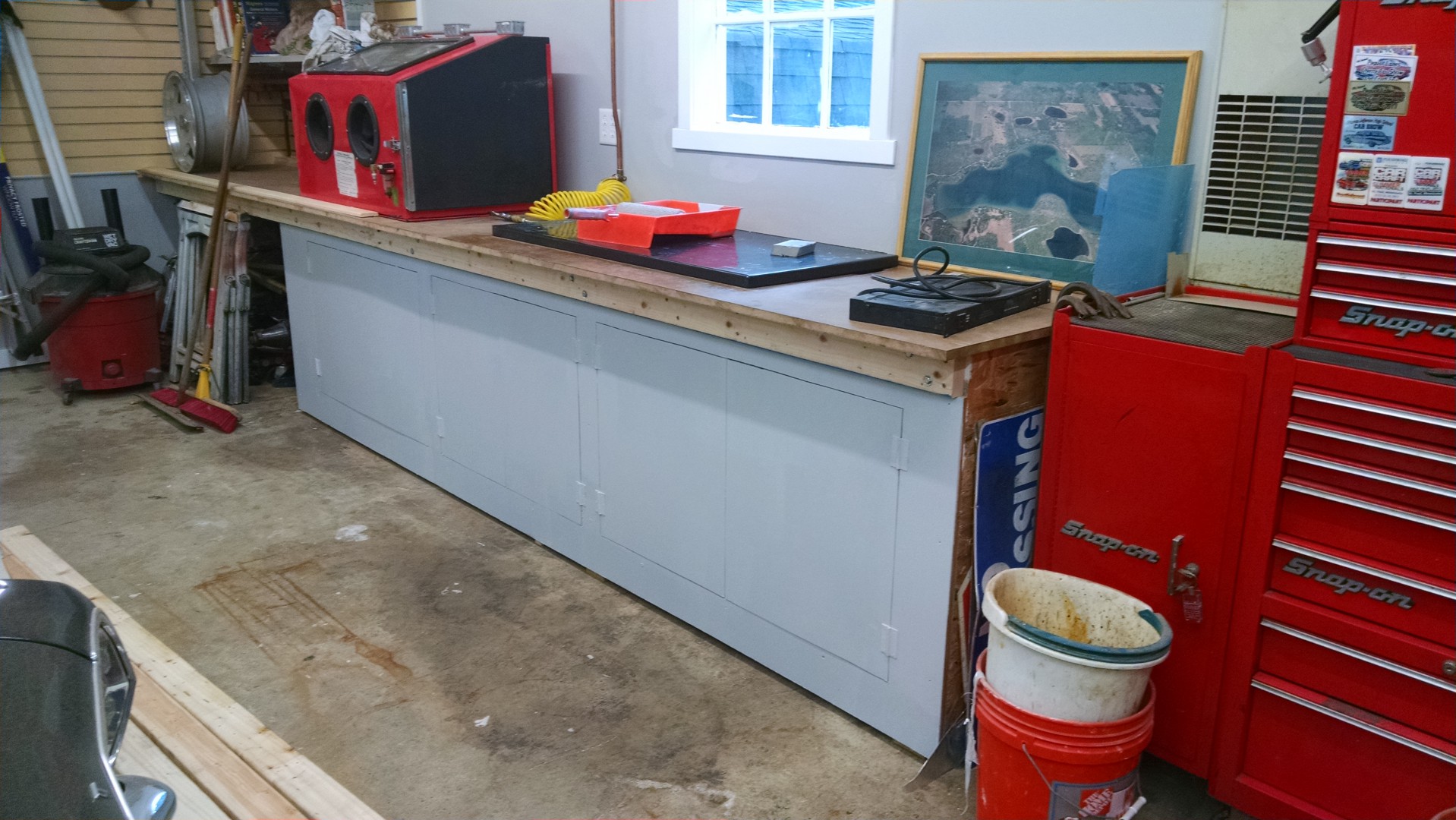

Been awhile on a construction update...
Got about 1/3 of the north wall done. This is the toughest wall to do, as it is the "working" wall over the main bench - everything happens here, and all the CRAP is centered around here.
Pulled down the '50s leftover/kitchen remodel cabinets that were screwed to the wall (moving the contents to the SW corner shelving), and moved the bench stuff to the new west wall bench. This wall wasn't bad, as I planned to install new cabinets - so I didn't have to do a really good job on the taping/mudding (90% of it was going to be covered up) - but my inherant machinist thing kicked in and did the friggin' wall nice anyway.
Went over to "Save Big Money", cashed in some 11% rebate coupons and got some cabinets. For those that watch the "house flipper" shows - these are the units that are touted as "oak kitchen cabinets" - yeah right. They have oak face-frames, oak stiles and panels on the doors, but they're only good for a garage or laundry room. Getting them kitchen & stain ready would cost 3x in labor the price of better units! No worries - they're in primer and will be painted.
Progress report:

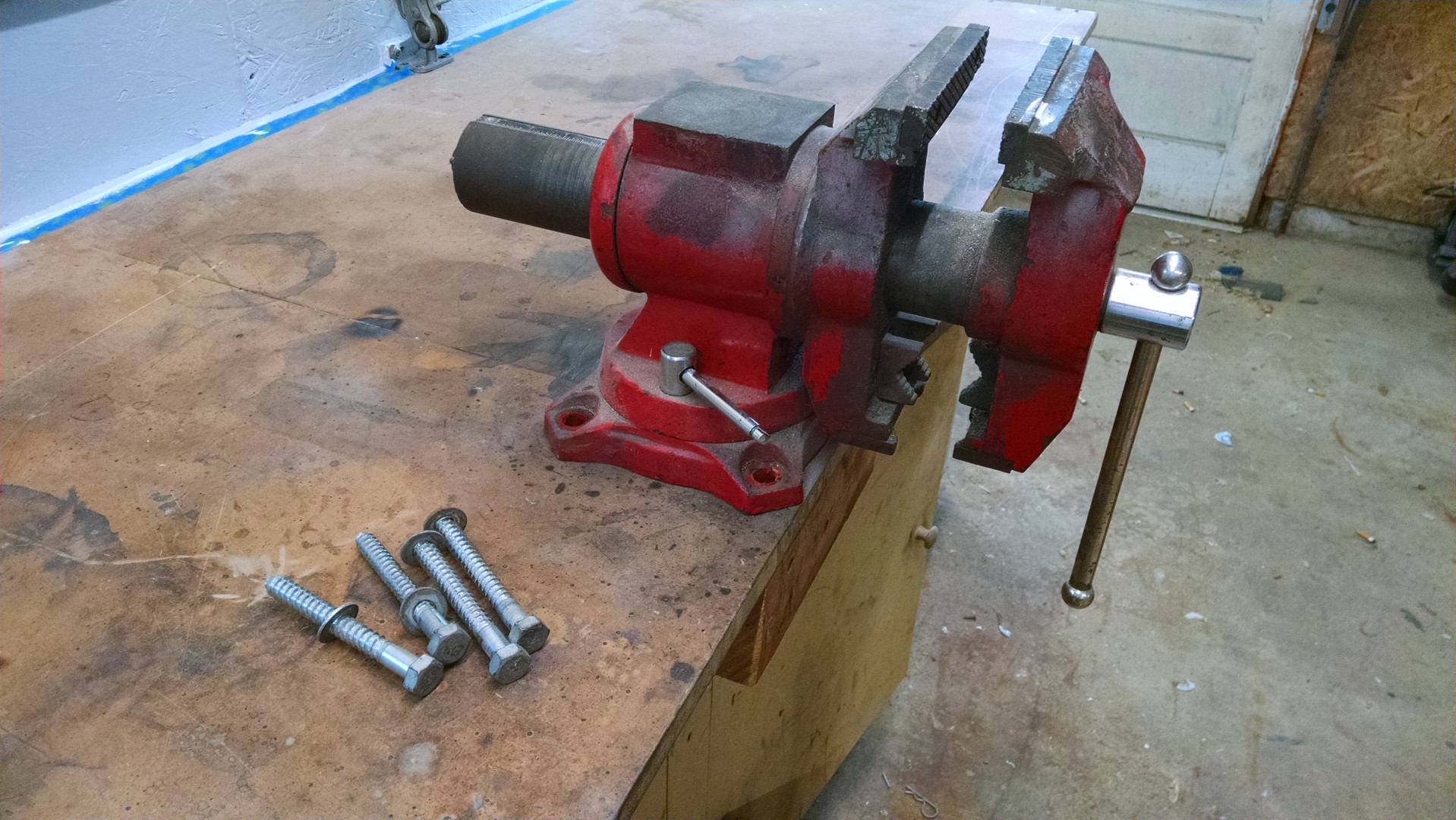

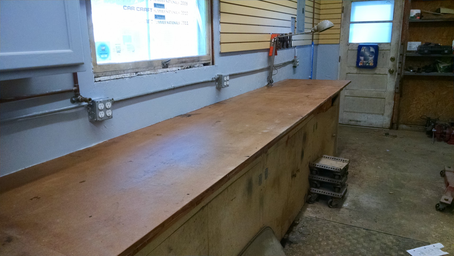

North wall is 98% done. Just some 1/4-round to trim off the slatwall. Log this in your history files - this is probably the cleanest you'll ever see the 40 Watt main workbench!
(Pulled the vise and grinder off, hit the entire bench with the belt-sander (varying grits) and there's a quart of sealer back on it.)

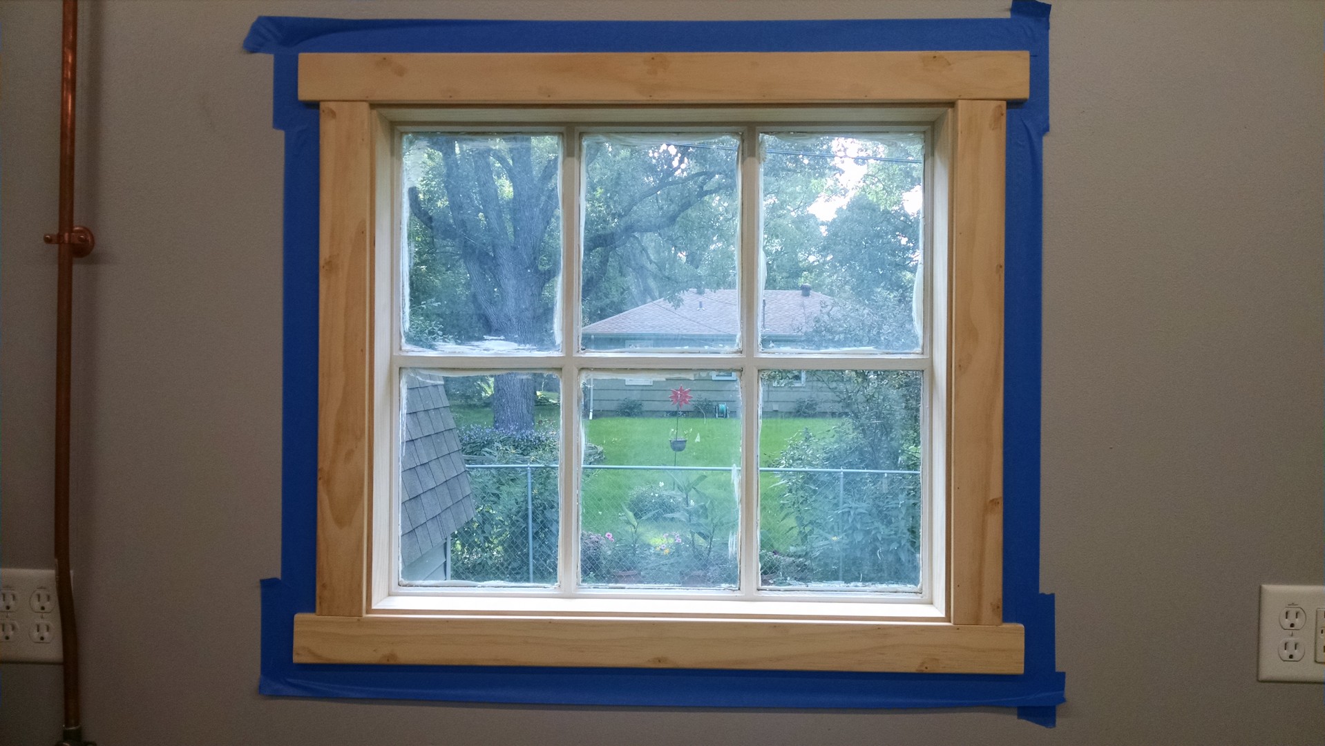

Well, the windows are trimmed & cased, did a throwback to the 70's and glued some cork around the main bench window (to actually use tacks and hold stuff up...), and started a little "man cave"/auto-art on the unusable wall areas.
