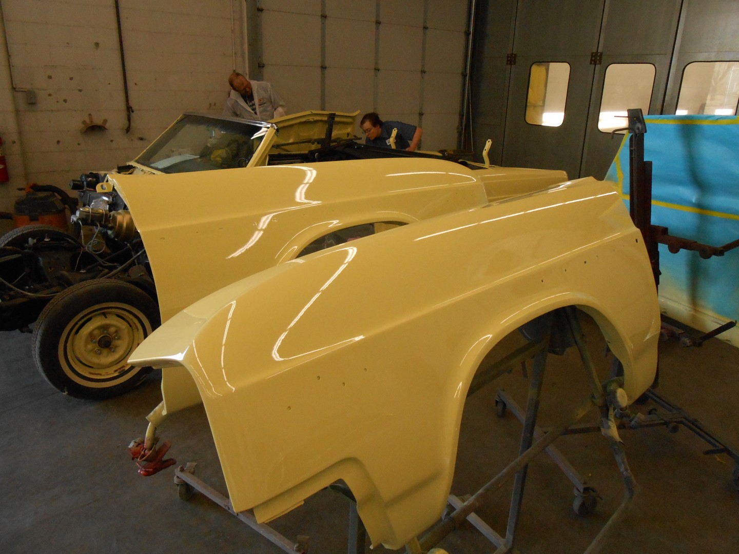

Not much to report as the body has been just a dusty body shop gray for some time; pictures really don’t show the progress taking place. The second block sanding is complete, yesterday it was in the paint booth for primer so we might even see yellow this week.
Bumpers arrived Tuesday, I have to say it was more than worth the 16 week wait, they look great both front and back. The Keystone folks were great to work with and I recommend their service. AC kit arrived from Classic Air last week; lots of other parts have as well my parts return ratio has dropped to two to one. I’ll post pix updates later; today and tomorrow will be devoted to removing some of the 80 foot Maple tree that came down during the last storm. If anyone wants some free firewood it’s here for the taking. All you need to do is put on some hip waders go 60 feet out into the pond cut it up with a chain saw drag it to the shoreline cut it up some more then drag it 100 feet up a very steep slippery hill and carry it to the street. Send me a pm if you’re interested.
-- Edited by dashboard on Thursday 25th of April 2013 05:51:19 PM
We have a Y code, Bamboo Cream Buick Special. Maaco has done the same thing with the Buick as they did with the Elky last year. Paint it Friday afternoon in its disassembled state then let it sit in the booth over the weekend and start assembly Monday morning.
Everyone that has worked on this car has taken ownership in it. From body work, paint perp, masking to painting they all treated it like it was theirs.
When we arrived late this afternoon people who had worked on the car were standing outside the booth as the painter applied the last coat of clear waiting to see how it came out. The painter taped notes to both ends of the booth warning people to stay out of the booth, I think in jest but I didn’t open the door to find out.
Assembly starts Monday, I’ll get some close up pictures without needing to shoot through paint booth glass.
Stan’s car is next, then one more club member is in line behind him.
-- Edited by dashboard on Saturday 27th of April 2013 06:50:20 AM

Apr 29, 2013

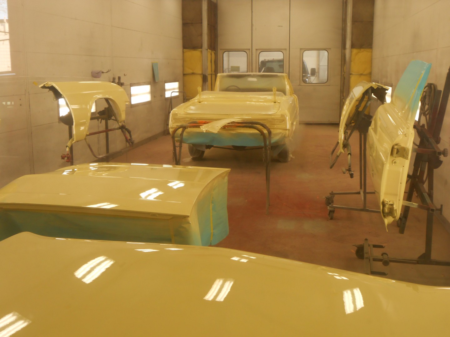

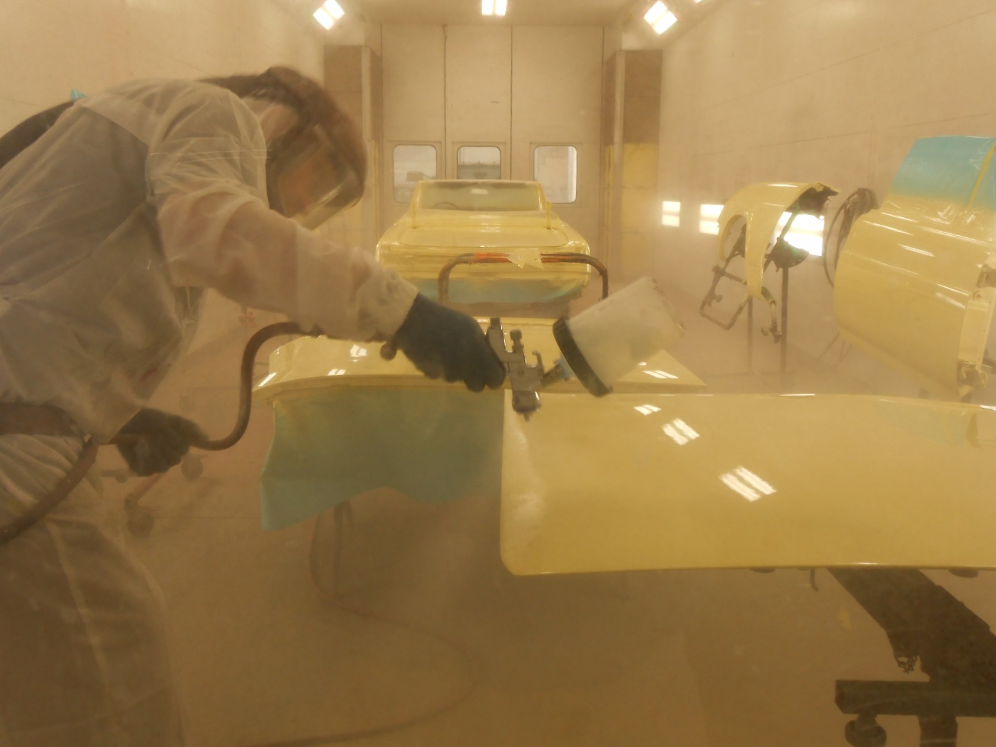

Out of the paint locker, now its cut, buff and assemble time, paint looks great we are very happy. The grin and thumbs up from the painter last Friday said it all.
Tim to answer your question about the process, after the body work and primer the car was block sanded then sprayed with a heavy build primer and then blocked sanded again followed with a primer/sealer prior to base coat clear coat.
Jacob was just starting the wet sanding this morning; he starts with 1500 and will finish with 5000 grit then follows up with the buff and polish.
I dropped off all the new weather-stripping, seals and some chrome parts; I need to go back to remove the heater box and install the AC blank off plates.

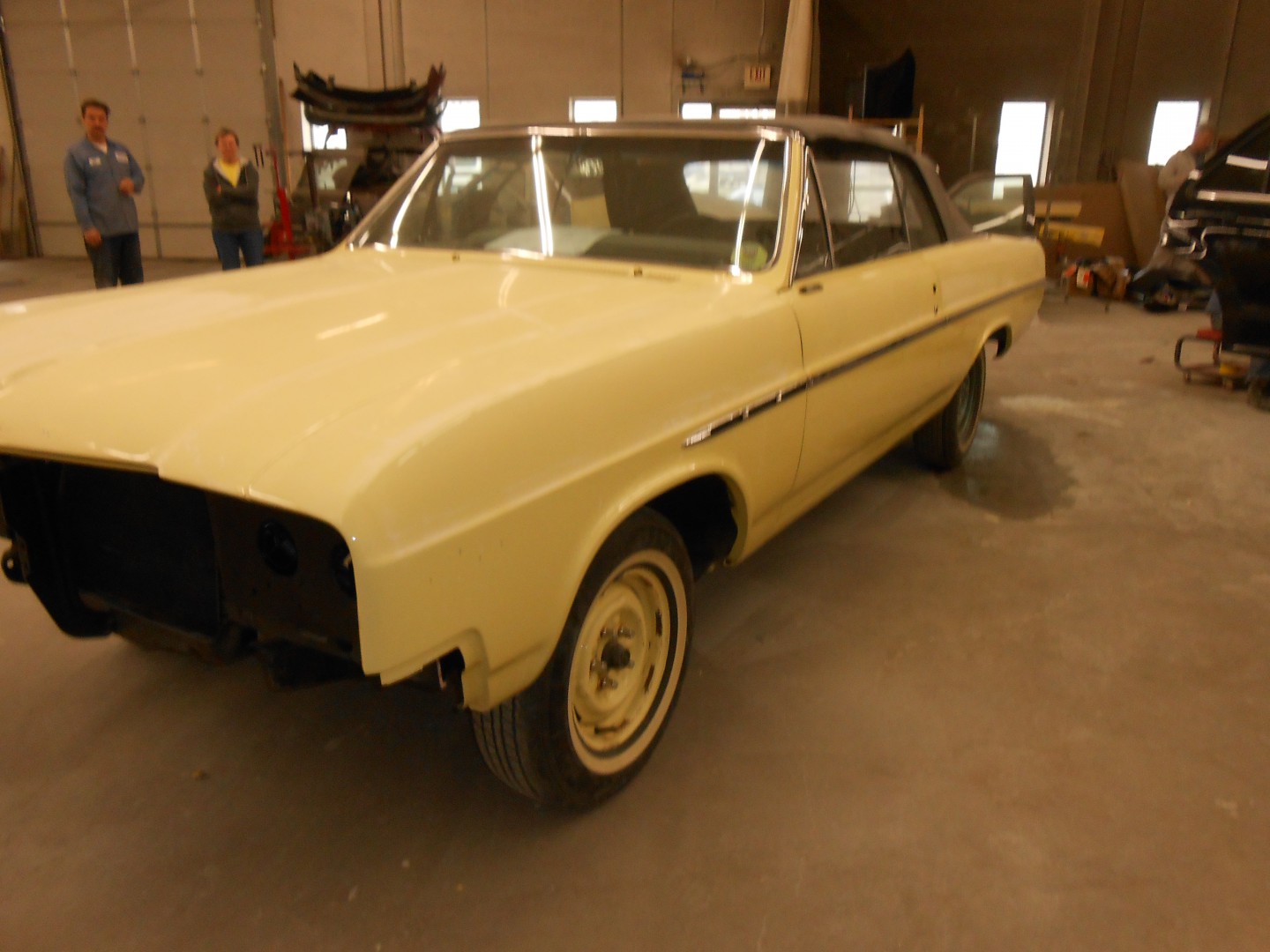

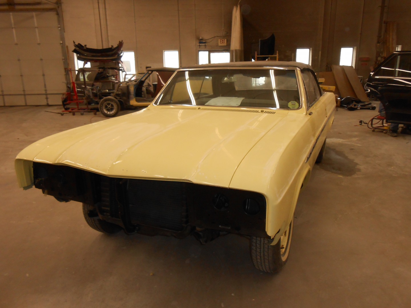

It’s finally coming together, hard to see in the pixs but the body seam’s doors, hood and trunk gaps are very consistent. The finish is covered with sanding dust and powder but its very smooth even the inside of the trunk and jams are as smooth as a ………
Still needs buff and polish, trunk paint some more hardware and final detailing but it’s getting close; even the owner was impressed.
It’s in good company; the GTO was in for some touch up paint before heading off to Indianapolis for the Mecum auction. A very nice goat, it’s dark blue with a pearl white bucket interior and a four speed.
If you look closely you can see another club member’s car in the background.
