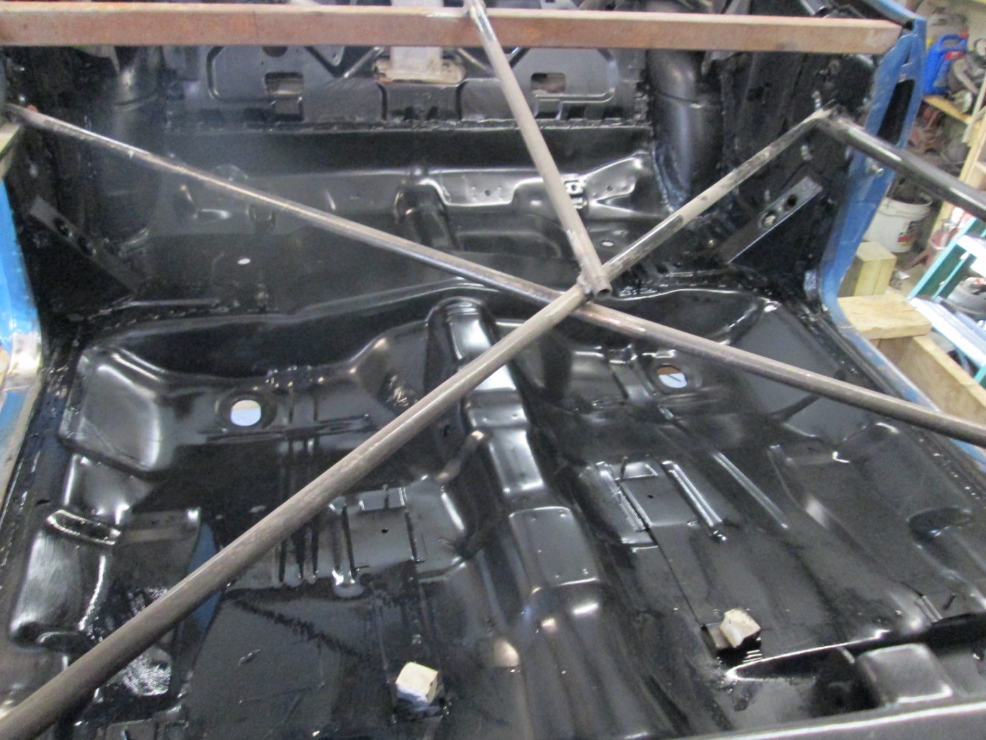

Looks good Stan………………and Tim, when that floor goes in you will have turned a big corner. When does the frame go in?
Nice to see you wearing the safety glasses and the extra safety supports under the body, I spent four hours in the ER Tuesday morning. Ya, me Mr. Safety, and I had on glasses and a full face shield and still got something in my eye; Doc suggested it came off my gloves when I was removing the face shield.
Sorry to hear that Kevin. I did the same two years ago. Maybe I should start wearing safety glasses.
With any luck the floor will be in on Friday then we can cut and replace the trunk floor. After that the frame can come out and head to the powder coater. We're burning this thing up just ask Stan he'll tell you we were on fire

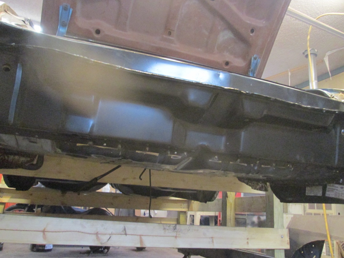

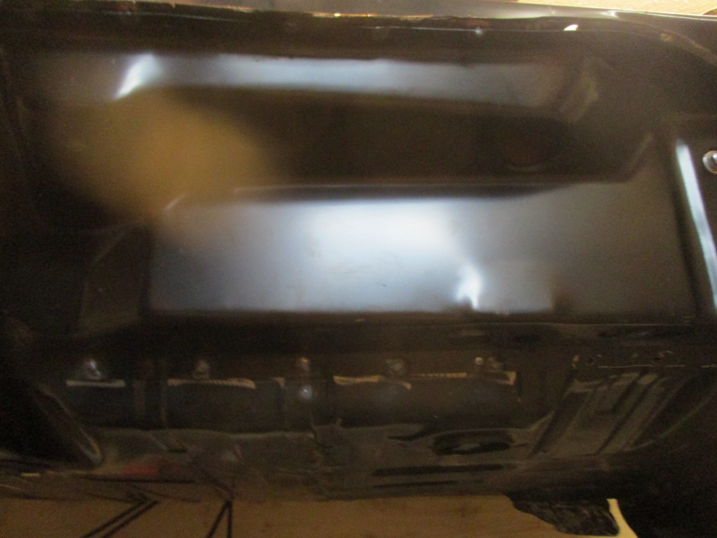

Houston... we have a floor!
Just needs some patching on the toe boards, and it will be good as new.
Then on to the trunk pan!

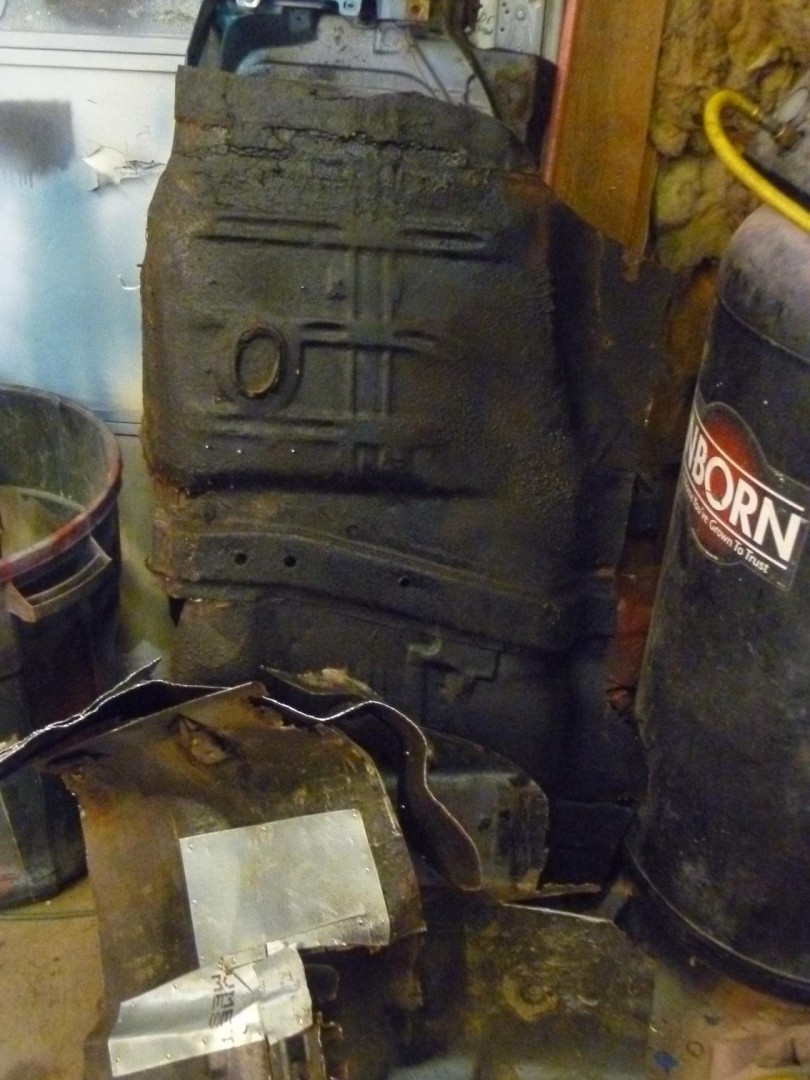

If anyone needs some boiler plate I'm cutting the custom trunk out now. It should lighten up the car by a few pounds.
Here's a pic of the 3/16" thick steel plate. It has to weigh 75 pounds min. and that's not including the 25+ lbs. of dirt and rust that came out with it!

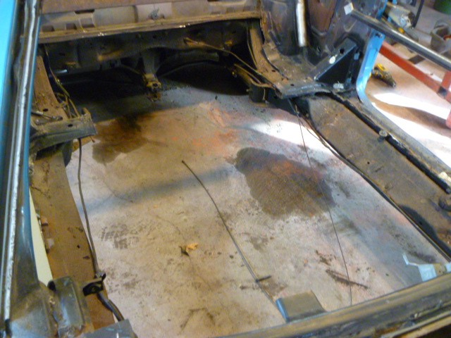

And here's what's left after the floor is out:
Then on to seperating the body from the frame while the frame gets blasted and powder coated and the trunk floor pan in installed:

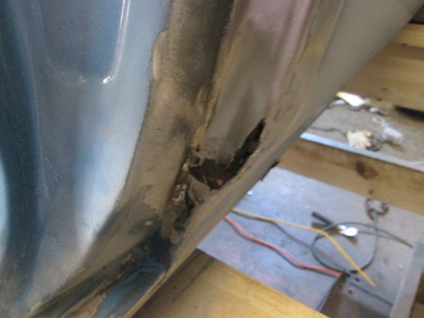

Making progress. With the crash damage evident on the left cowl, I would get the frame checked on a rack to see if it is tweaked before paint/powder. Gonna need some mount washers welded in to. Common issue with these cars.

Yep, there's a plan for the body mounts that are rotted/rusted out. As you said, common issue after 41 years.

Buffers R Us was busy this weekend and the firewall and underside are more or less done:
