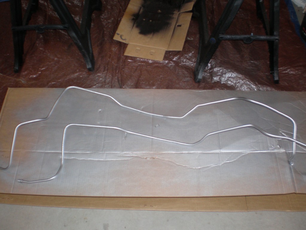

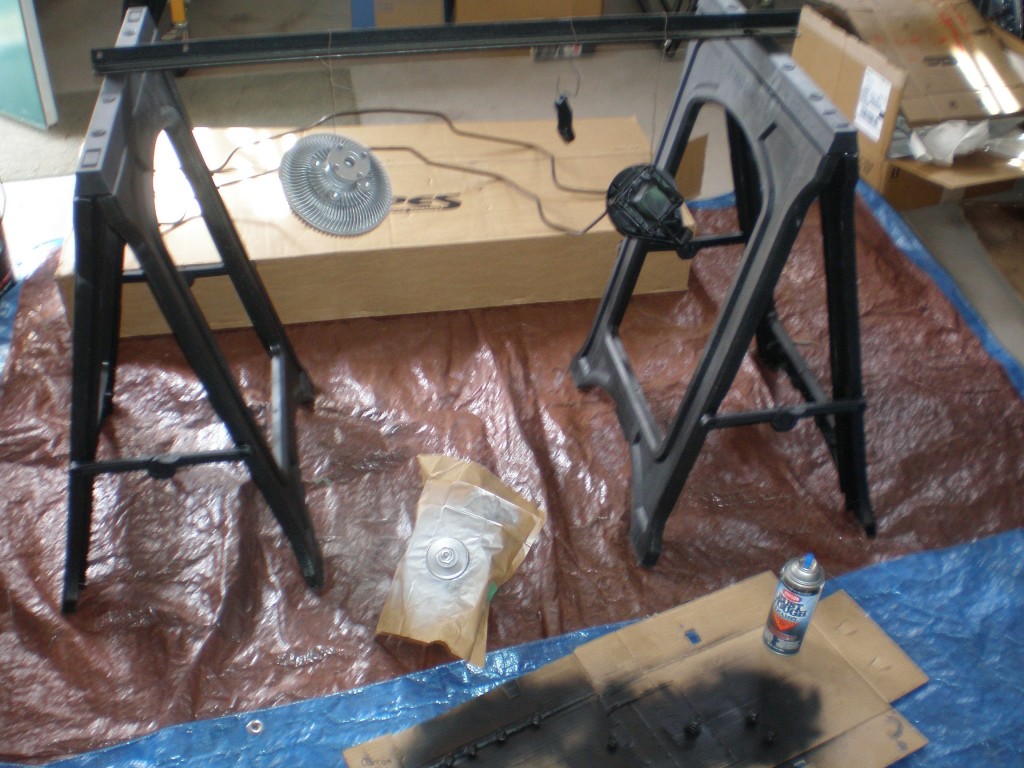

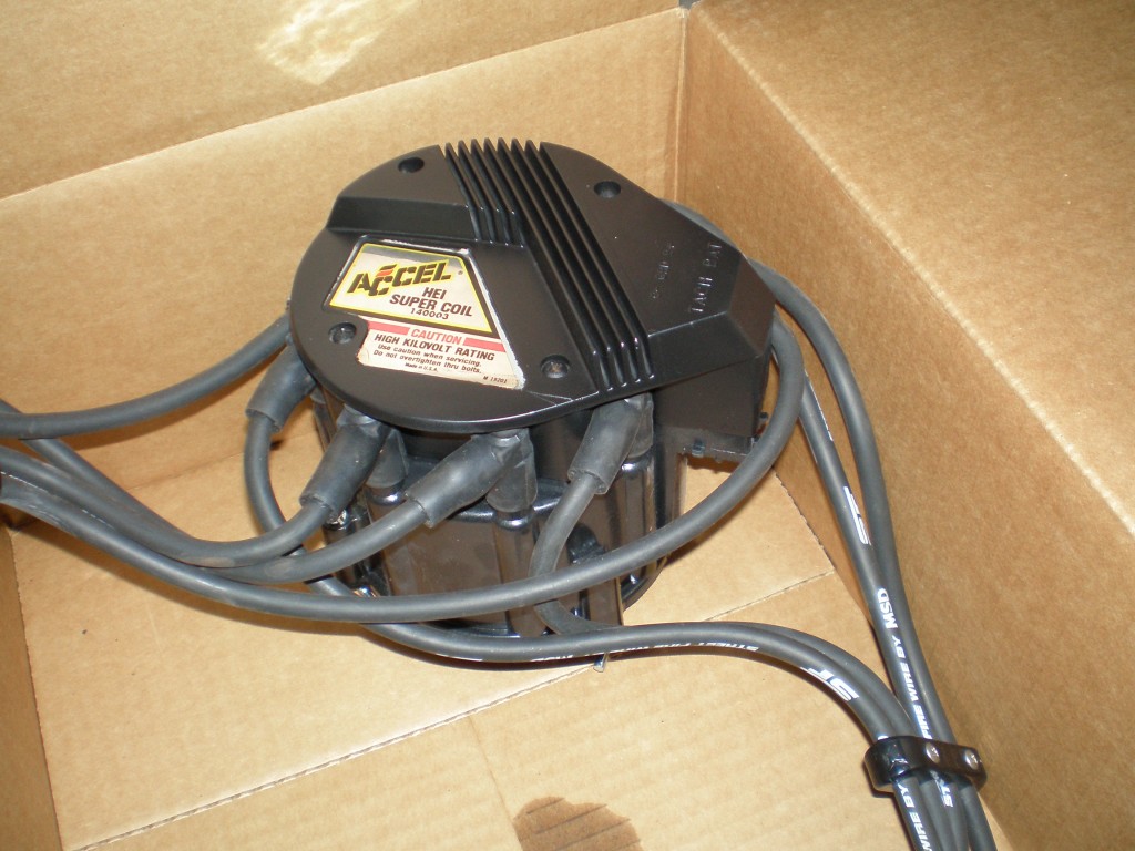

Made some progress this weekend on cleaning up and painting some misc. parts.

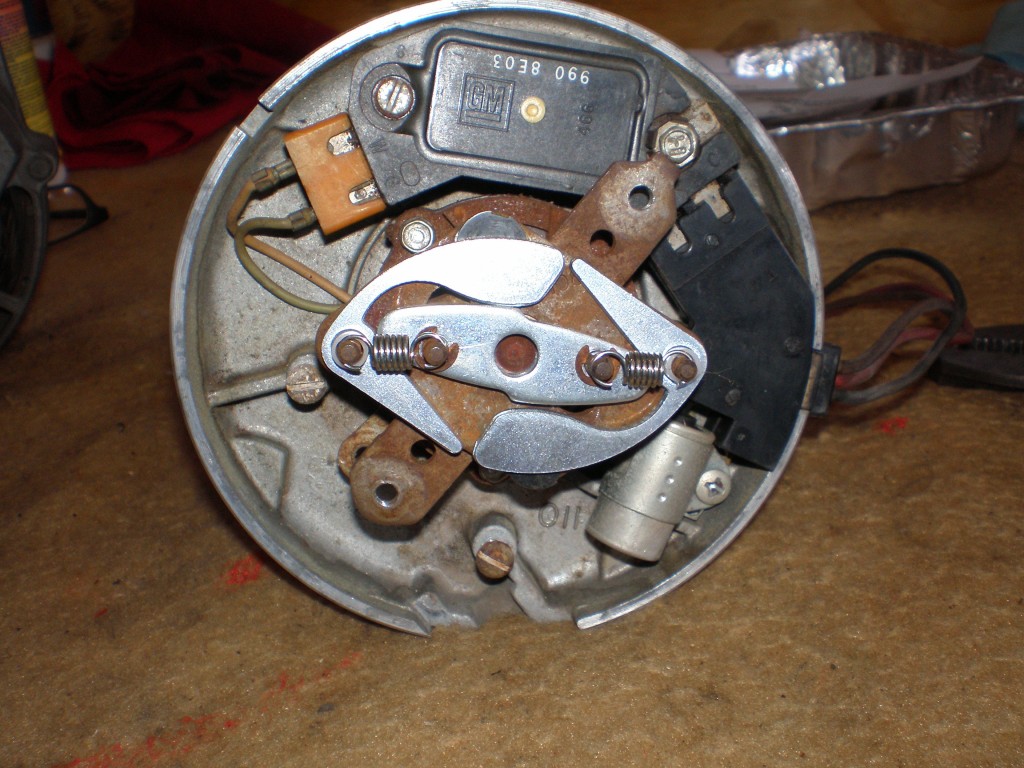

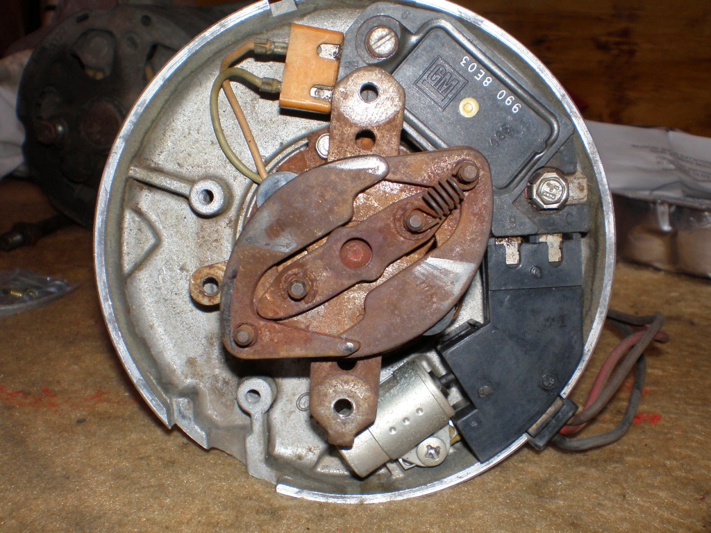

Also found another reason the 402 wasn't running it's best. The disty weights were trapped one on top of each other, and I could see where they were rubbing the underside of the rotor, so I don't know how it was advancing the timing much at all. I replaced the weights, springs, and bushings with a Mr. Gasket HEI kit, and we'll spin it up at Competition Engines before starting it up at the dyno to check the advance. It's amazing that this engine ran as well as it did with 1 dead cylinder (burnt exhaust valve) and bad timing... The big blocks are pretty strong even when they aren't running optimally.
I painted the Accel high voltage coil that goes on the top of the disty cap from light gray to satin black so that it will blend in more. That always bugged me when looking at the engine.
The trans cooler lines were too far rusted to polish up, so I painted them with an aluminum color instead.
Those weights haven't moved since the moment they were pinched by the rotor. The marks on the rotor are just the clean spots from contact. It appears you removed the main shaft to install that kit ?
The coil cover looks much better black...
Wear gloves when you pick those trans lines up. Aluminum paint always rubs off for me.
Mar 6, 2011
Nope, just took off the springs, the weights, and then the center plate and reinstalled in the reverse order with new parts.
Bungy L-76 said
Mar 7, 2011
Wow, you can clearly see how the rotor held the overlapping weights from advancing. I too like the black ACCEL cap. Looking really good Stan! Following these build up threads is like reading a good book. I'm on the edge of my seat waiting for the dyno run. Good luck.
Mar 7, 2011
That distributor looks like its been sitting on someones shelf in the garage for years and just stabbed into the engine without any sort of attention.

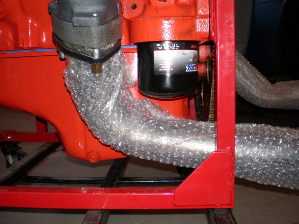

I decided to go with their test exhaust manifolds since they have a set that have the temp probes already in them. I'm using manifolds in the car, so this will be a real world test with the stock cowl induction air cleaner too.

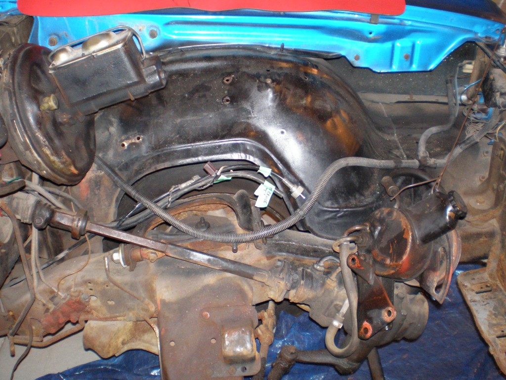

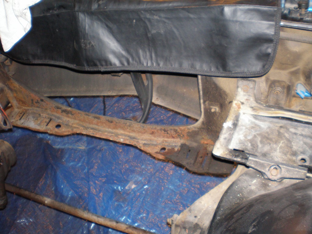

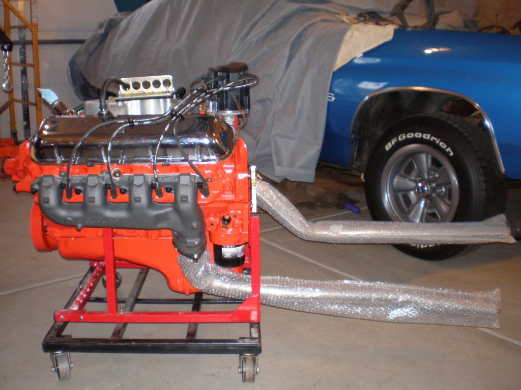

Got some more smaller engine details done today:
-Installed flex plate and torqued bolts with anti-seize -Completely installed gasket/ex. manifold on passenger side (driver side hits the engine dolly, so it's just mocked in place for now -Reinstalled fuel line -Mocked up the down pipes from Pypes, and it looks like things are going to fit! I love that there's lots of room around the filter! The last set of headers I had, you had to drop the drivers side header to change the oil because you couldn't get the filter out!!!
Will start the disassembly and cleanup of the engine bay in the evenings this week now that the temps are up, and the furnace hardly even runs to keep it at 65 degrees. I didn't like warming it all up just to be out there an hour or so.

1. Did you block off the heat crossover ports on the intake manifold so the carb does not get the heat across the base?
2. Are you going to permanently fix the exhaust manifold damper into the open position?
Mar 21, 2011
Tim H wrote:
Stan
A couple of questions for you. 1. Did you block off the heat crossover ports on the intake manifold so the carb does not get the heat across the base? 2. Are you going to permanently fix the exhaust manifold damper into the open position?
#1. I didn't block off the heat crossover ports on the intake manifold. We did install an Edelbrock 1/4" thermal spacer so that we could use the shop carb for start-up/break in/baseline, and I will also use it as Edelbrock carbs tend to boil off fuel when sitting after running for awhile, which makes restarts difficult (I know this from experience). The spacer solves this issue. Dyno Bob also showed me that on the Performer 2-0 manifold, that with an Edelbrock carb placed directly on the top of the intake, the motor only 'sees' two 2 barrel carbs instead of one 4 barrel carb with the spacer.
#2. I'm using an open 1" exhaust spacer that sits in place of the butterfly exhaust valve. I bought it at Corvette Specialties, but Ground Up sells them too. You can kind of see it in the first pic showing the drivers side exhaust manifold.

Started removing things from the inner fenders to prep for paint and found proof of the Mojave Gold color that this Chevelle was originally. See pic.
I'm not doing a full on resto, so this will be a basic clean up and rattle can job to make it look nice for a driver. I attached some 'before' pics for posterity.
Now onto cleaning up and painting the engine bay.

Forgot to add... Randy rebuilt the top end of the disty since he doesn't like the Mr. Gasket weights as they are too light and touchy (either all on or all off) in his opinion. So he rebuilt it and spun it up before we installed it. He did all that for $20!
We also didn't use any vacuum advance on the disty the way he set it up.

Here's what I can tell you:
-When the disty was rebuilt, I think(?) the initial mechanical advance is at 4-6 degrees (need to confirm)
-It was rebuilt not to use vacuum advance since the vacuum out of the cam I put in is on the lower side and may have caused it to 'dither' or bounce back and forth between advance and no advance at idle
-The TOTAL advance the motor was happy with was 42 degrees (the dyno guy checked this at 3500 rpm)
-I don't know what the advance was at idle (850 rpm) because my balancer had so many marks on it, we couldn't tell which one was BDC or ADC and we didn't want to pull it off, so I need to replace it with one that is marked properly and then I'll know (I'm going to call they dyno guy tomorrow to see if he remembers what it was before he dialed more in on his timing gun)
