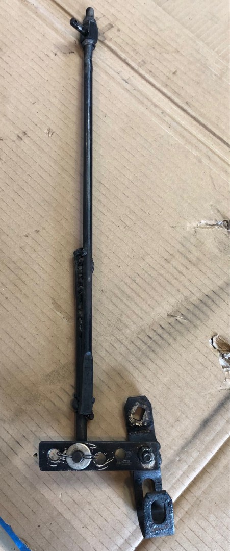

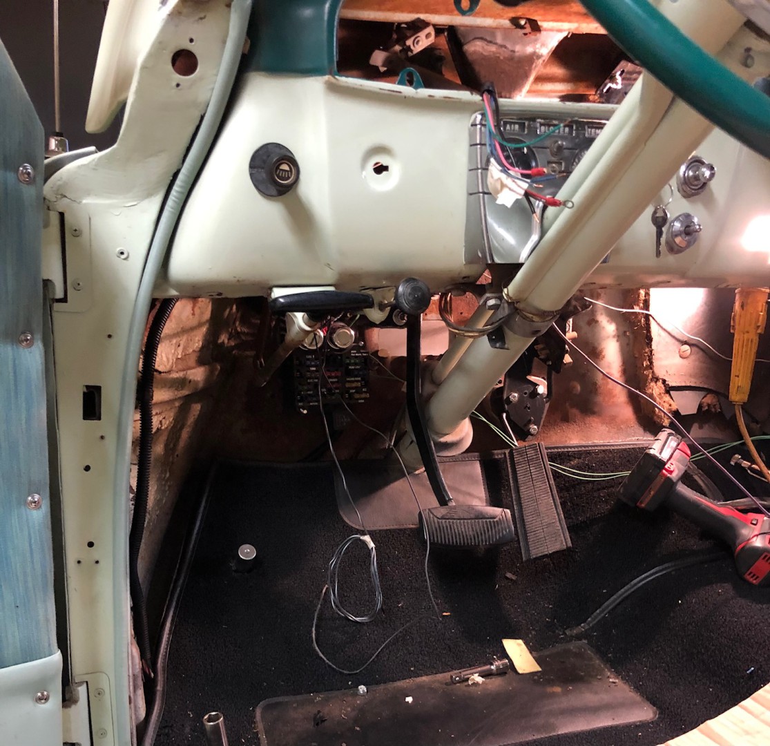

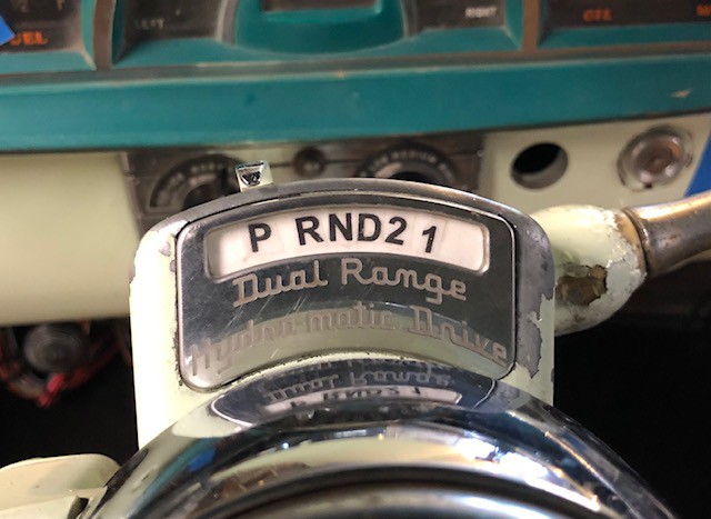

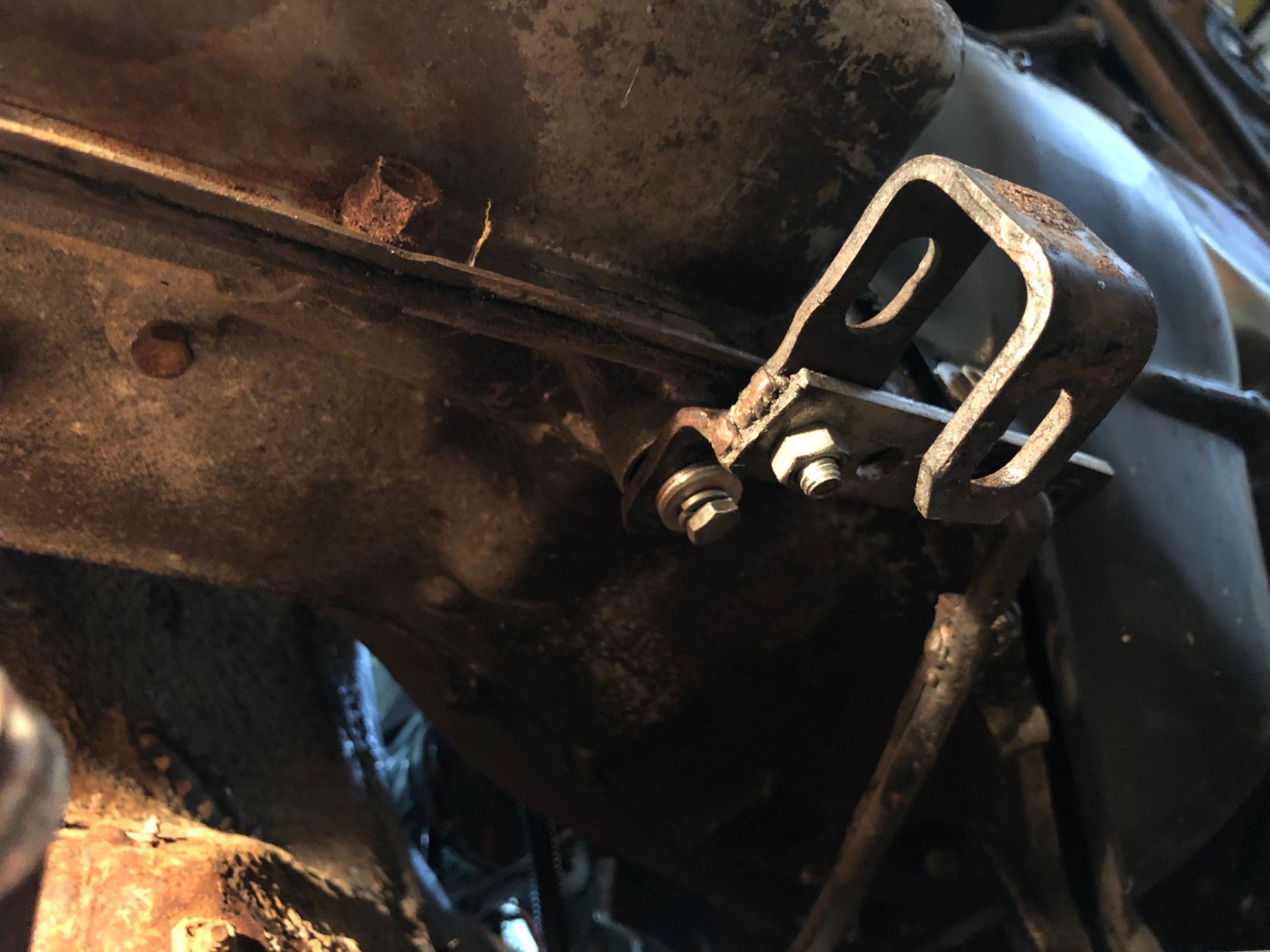

Pulled the old shifter linkage and did some troubleshooting on the range of movement.
From the looks of things, the PO put the engine back a bit too far, with homemade engine and tranny mounting supports. the shift lever on the column hits the valve cover.
It looks like I can cut off an inch or so, it is currently about 5" from the center of the shaft to the current connecting rod shaft.
Have a Lokar (or that style) kit on order and looks like this will allow a normal range to all gears.
Currently it was not possible to downshift to 1 & 2
It appears the arm on the shift shaft of the column could be loosened and rotated up, for more range before hitting the cover. That would require the super heavy duty welded rod to the trans to be longer and I don't see much length at the top swivel for that.
Dec 14, 2021
it actually hits the cover at the mid-point of the range, can only go down.
it is almost hitting the firewall now, so choices are limited. Think taking an inch off will do the trick

We will see, think just cutting and drilling a new hole should do it.
There is a ~3/16 hole closer to the shaft that may work out,
Once the new parts are here it can be mocked up, probably will get it cut before so it has the full range of motion

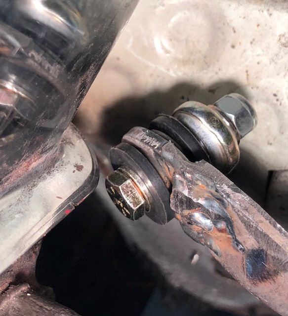

Well with a bit of effort, some cutting, welding, rework, Boy Scout knots, as well as some trial and error, the Catalina now has a fully functional gear shift.
The lever on the column no longer stops at the valve cover.

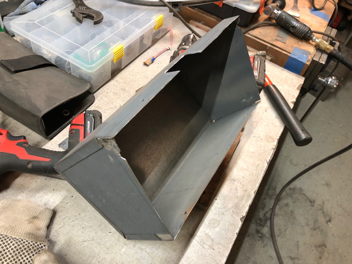

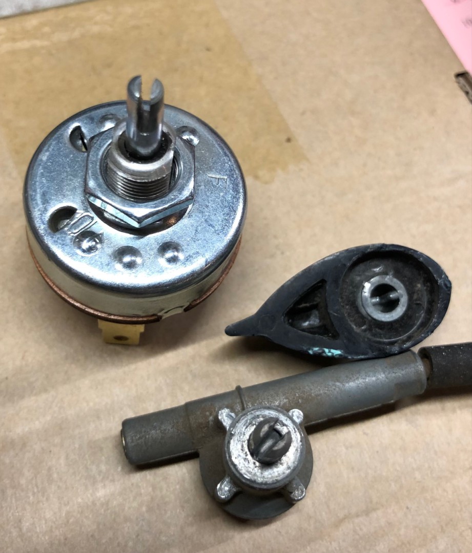

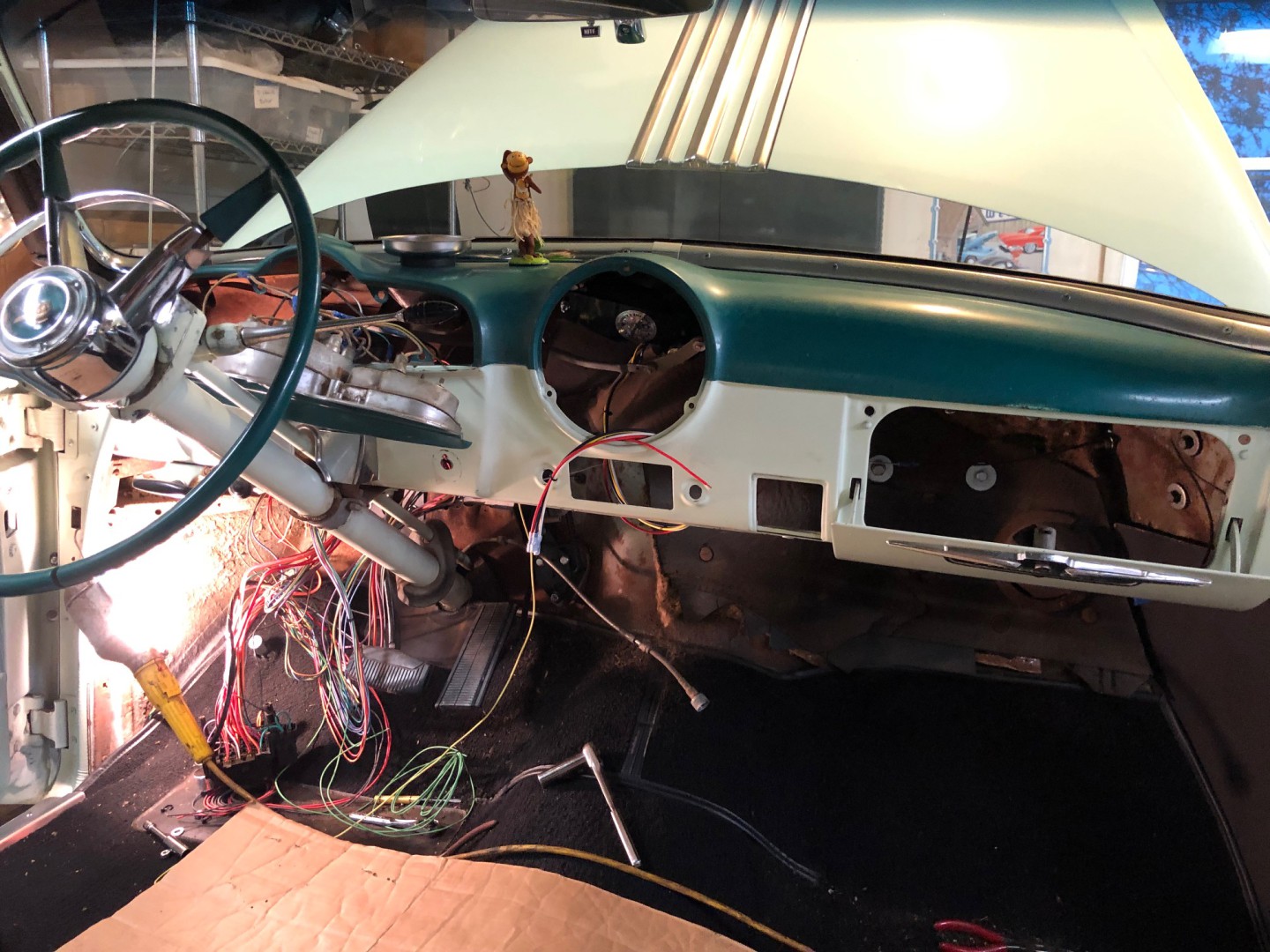

Time for an update.... The new wiper motor is now in and the switch was modified to go in the top of the dash and use the original knob Also have the heater ready for some paint and then installation, there will be plenty of air going to the windshield which was the main goal
Well, look at you, Mr. Tinsmith !! That defroster housing looks might nice.
I have New Port wiper system in my '38 as well and the control knob was originally on top of the dash then too. They sure didn't change placement of that for a long time. The PO of my car mounted the tach up there, so the wiper control is under the dash. I hope you bought the intermittent controller as well. On misty days, it gets really old turning those wipers on for a couple cycles and then off for 30 seconds... I keep telling myself I'm going to get that "this year". Uh, huh, I've had the '38 for 9 of those "years" now...
I should just go online and order it, and new blades, right NOW, except I can't remember if the blades are 7 or 8".
Jan 10, 2022
Only went with a 2 speed, which is a big improvement from the original, that was nonfunctional As you know there were variable speed, well actually 1 speed but would stop when passing or driving up a hill, they literally "sucked"

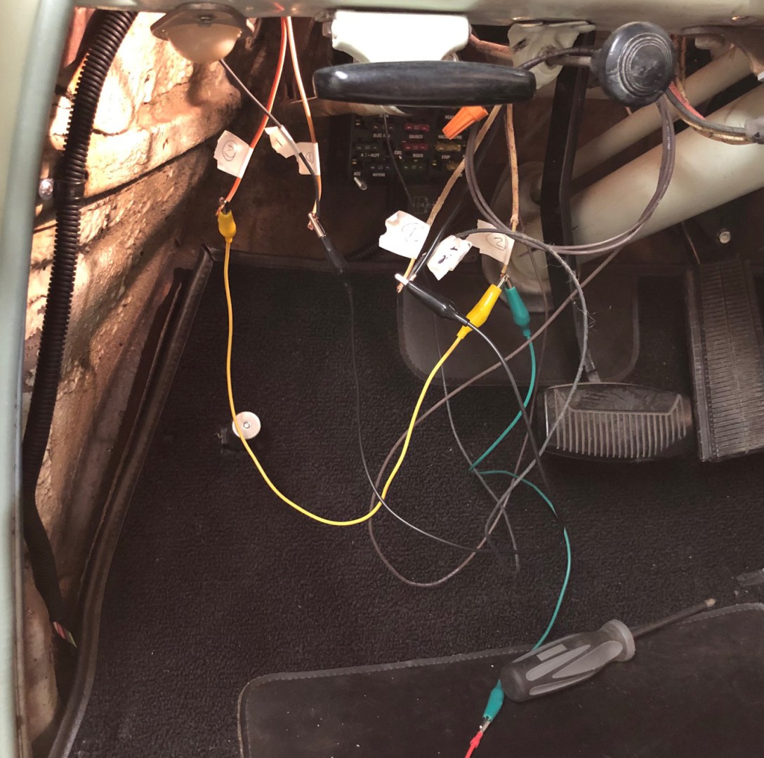

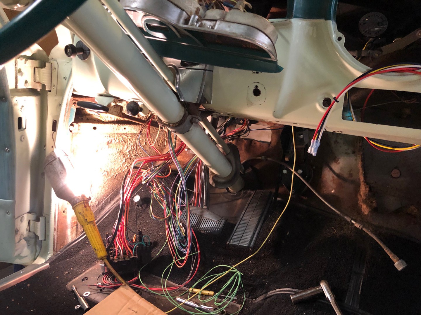

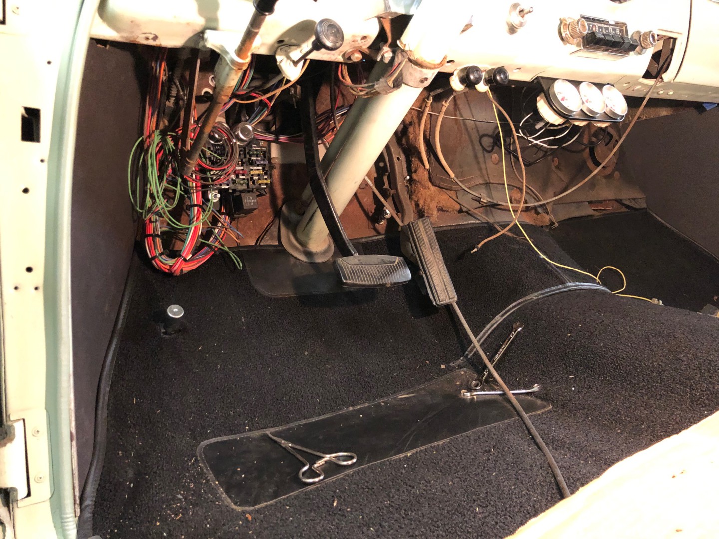

Progress is steady but slow, as the rework on the wiring is getting done. Hard to see the progress but it is happening

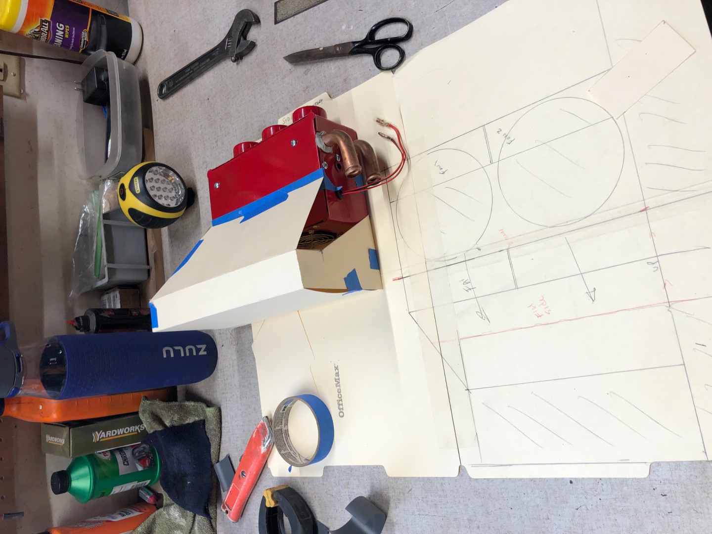

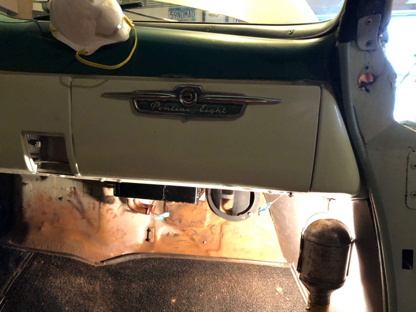

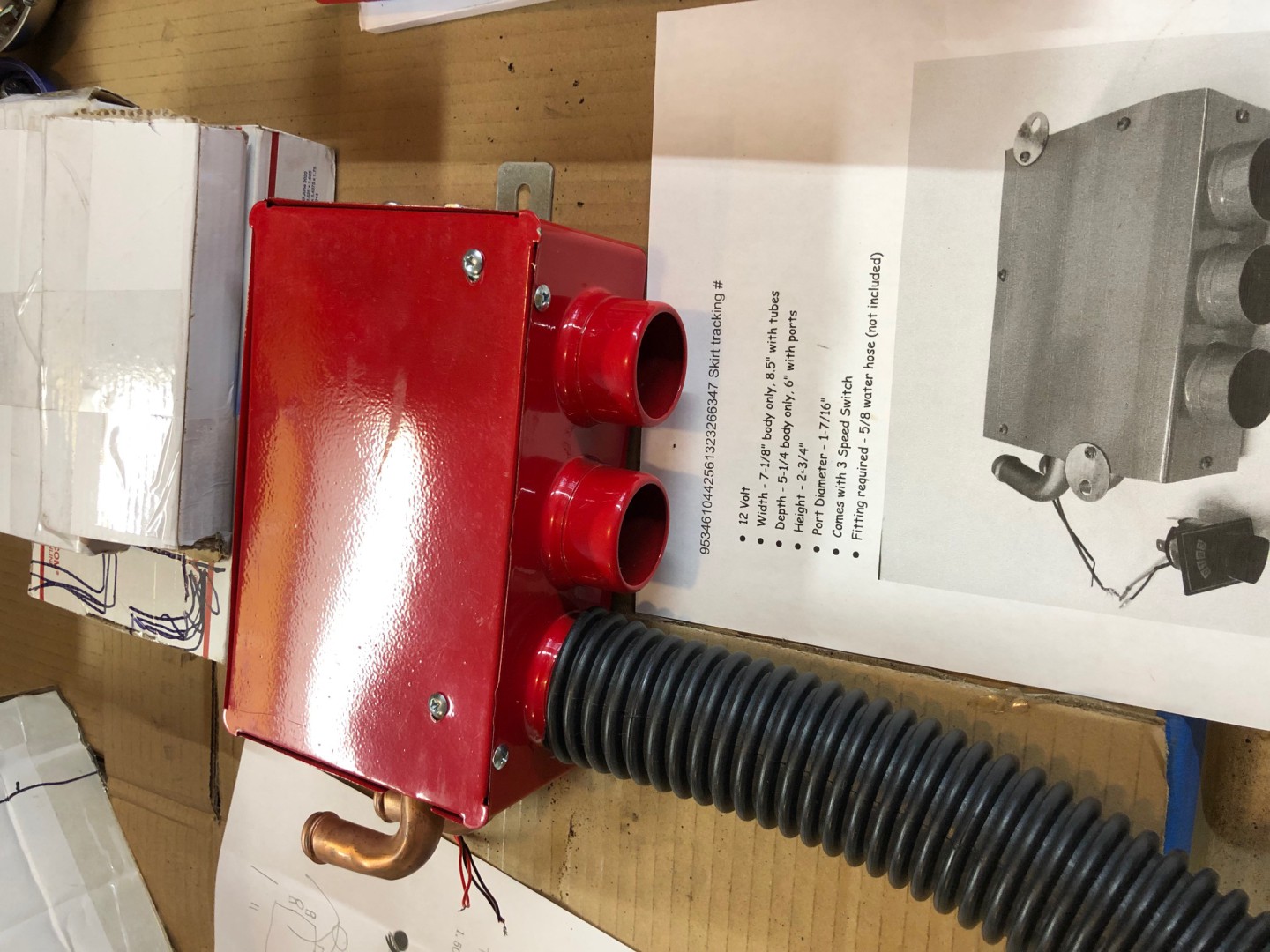

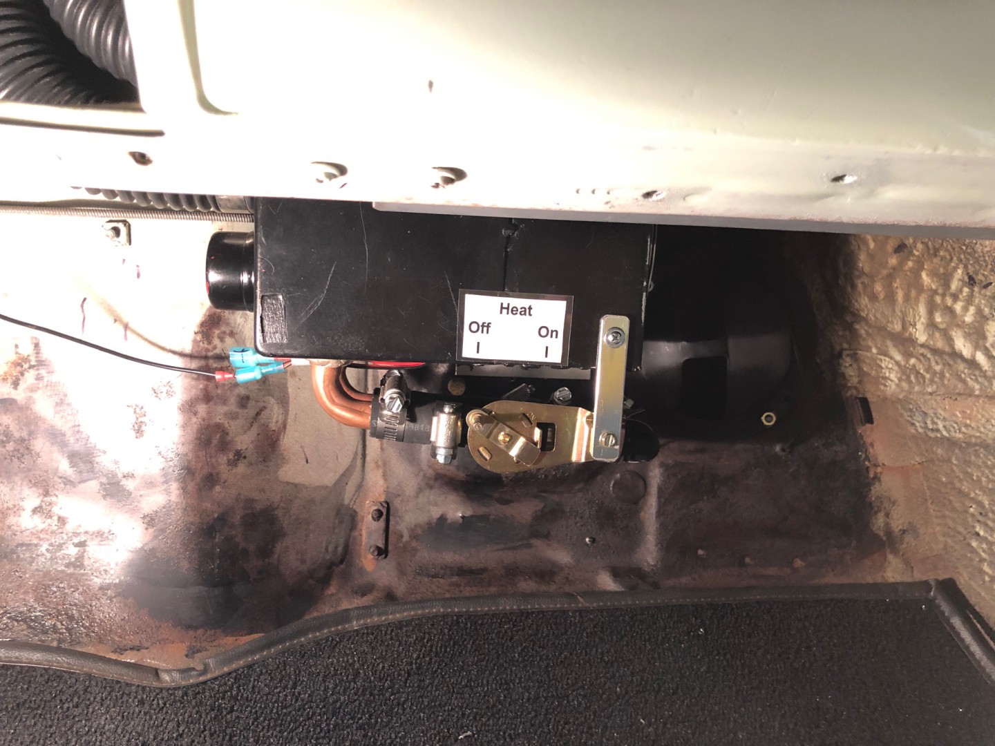

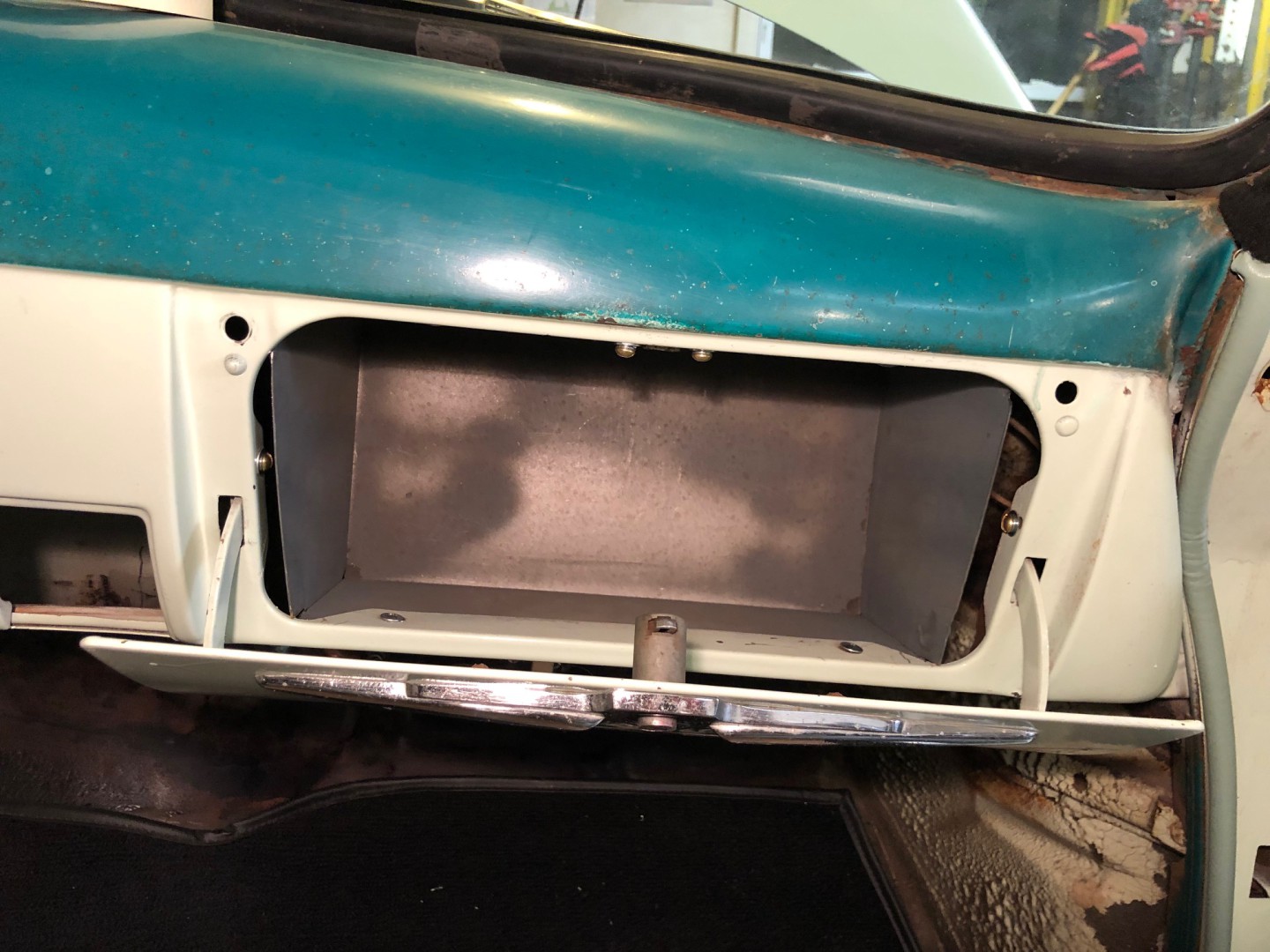

So here are a few more updates - Finished the plumbing for the heater - Started on plans for a 3RD Rear light, using the same type that was in the Nomad - Made a glove box out of an old file box I made in the 70's (the heater took up several inches, the old one was a former mouse hotel) - Added a set of headlight visors.... Just for fun? (Or do they help keep the car "Cooler" in the summertime?)
-- Edited by BLyke on Saturday 12th of February 2022 05:11:05 PM
Might have to keep watch over them. I'm sure they would fit my '54...
Your glove box liner is another work of creative art. ..

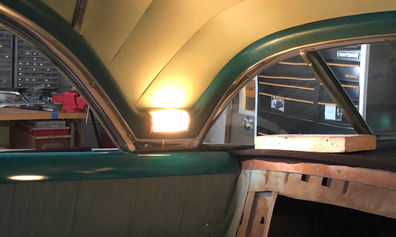

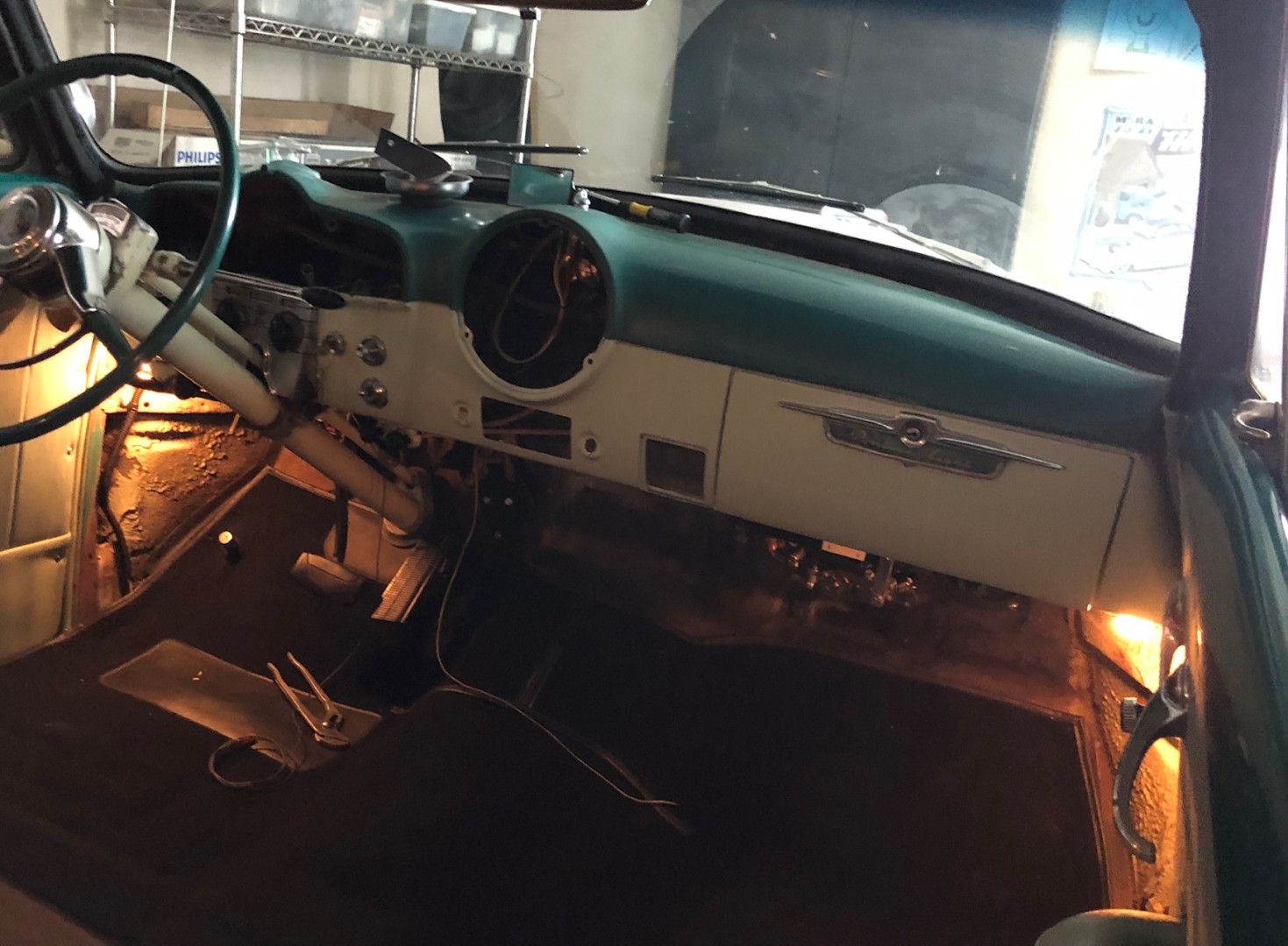

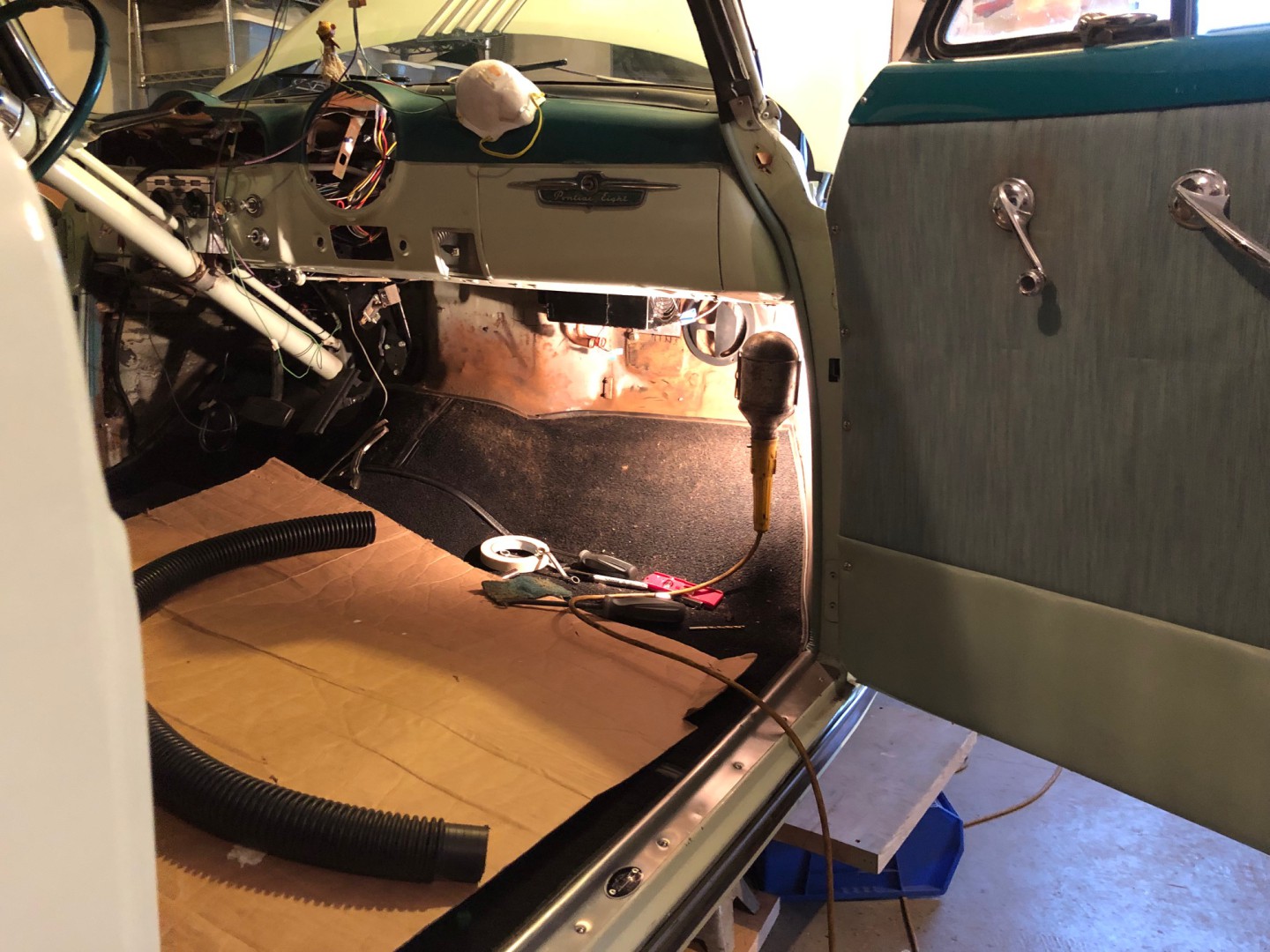

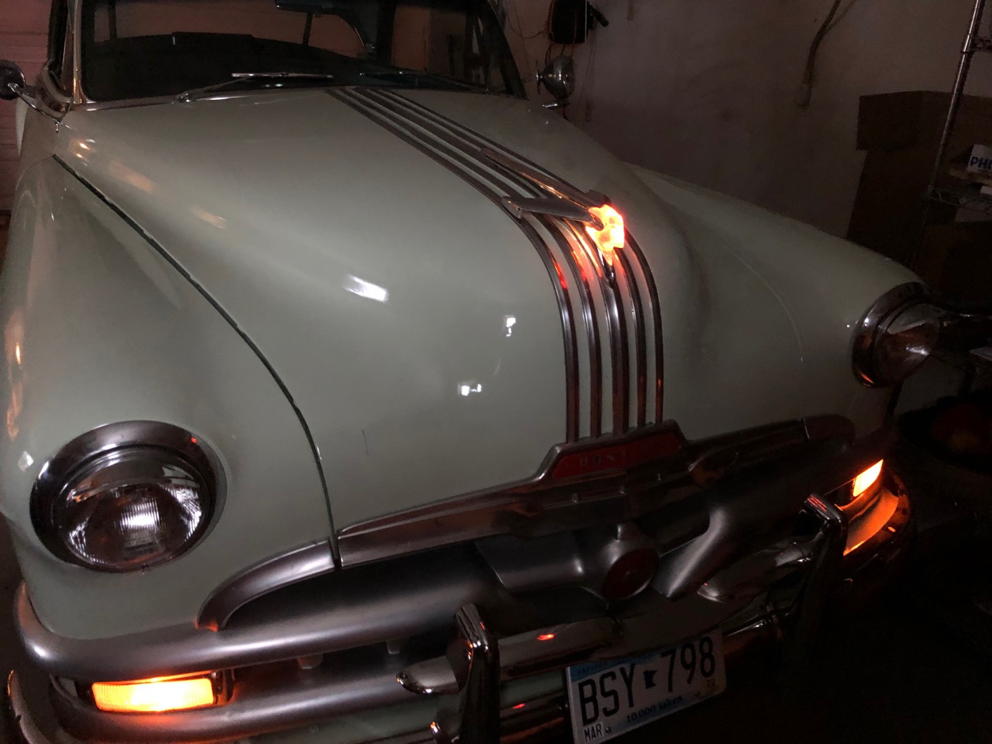

Happy to say the wiring for interior lights and switches has been sorted out and is now ready to go. It’s toward the end of the rewiring list since it is not “necessary”. There was not a lot to start with as much of the existing wire and parts were gone or needed rework. To figure out how to get 4 lamps and 4 switches to all work in harmony a lot of jumpers with alligator clips were used. Only 2, 15-amp fusses were blown. Discovered there is a back seat switch for the lamps, its on order and will just need mounting on the rear driver's quarter panel cover. Made my own larger schematic to check off parts of the circuits as they were confirmed.
Also have a functioning Neutral Safety switch mounted under the car to the TH400, Reverse light switch and Kickdown switch. I will spare the details unless someone needs to know the process used.

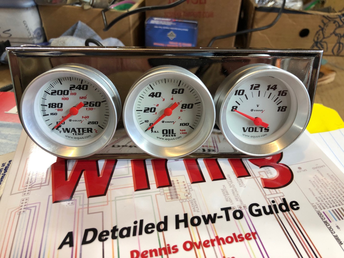

Wiring and sensors for the oil and water temp are next

All electrical systems are a go, at least all of the ones I was working on and need to drive safely and legally.
A few nice to haves were tossed in too

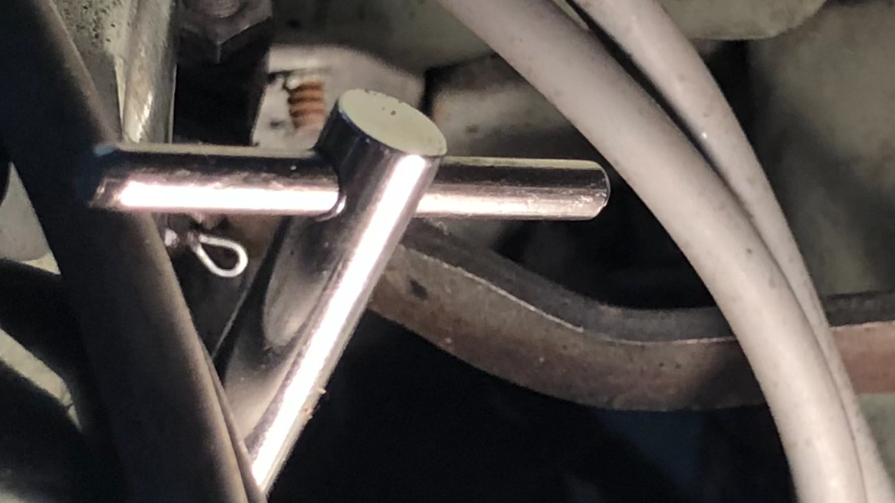

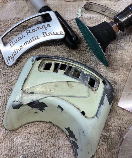

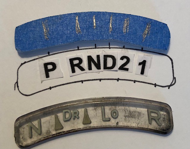

Now have a functional shifter and a reasonably accurate indicator

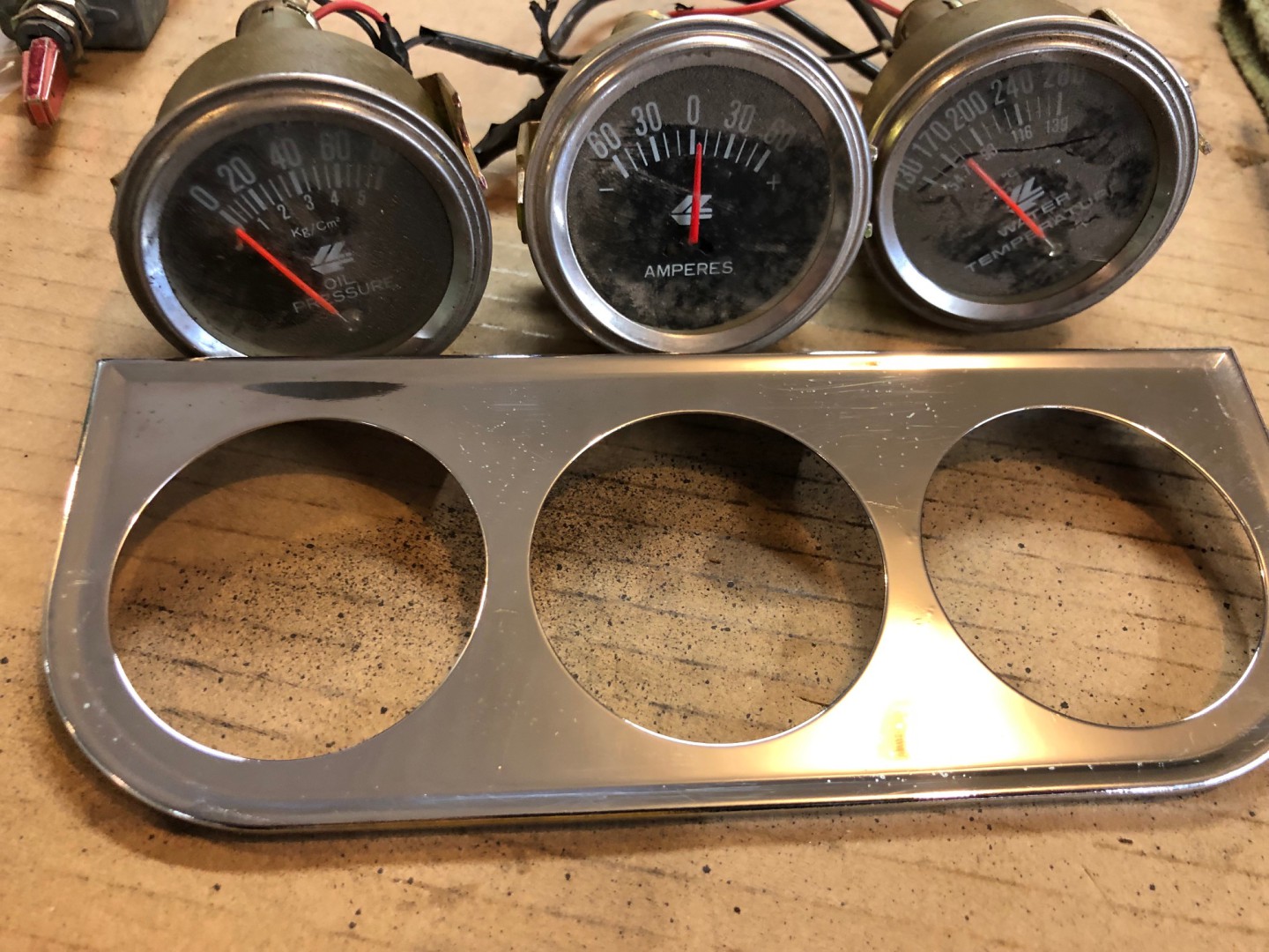

Updated gauges to use a chrome mounting that was in the Nomad when I got it.

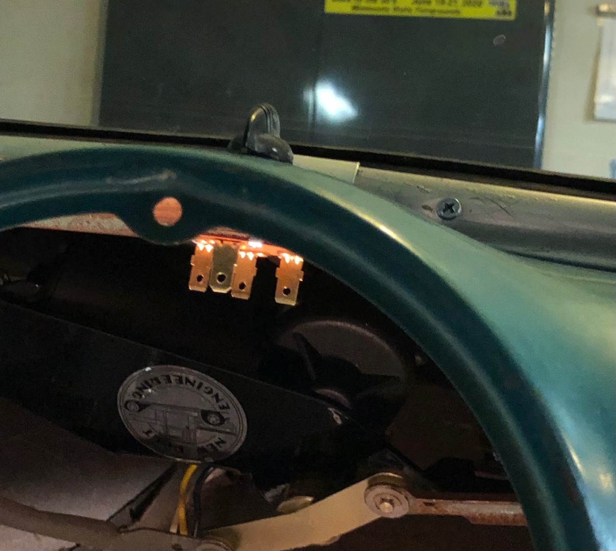

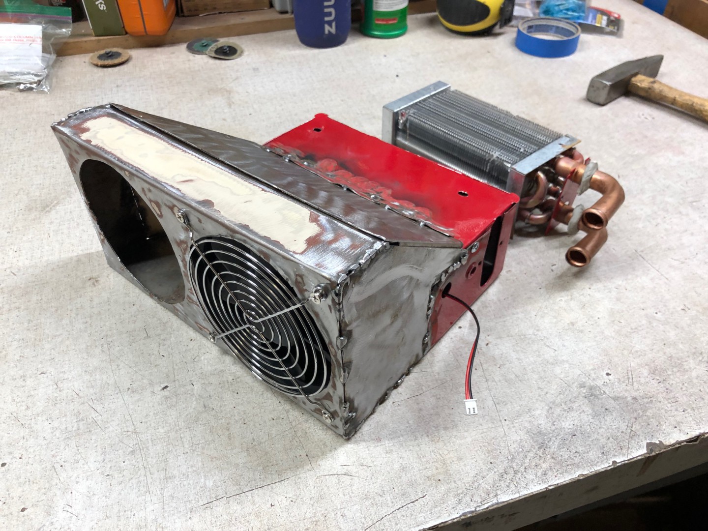

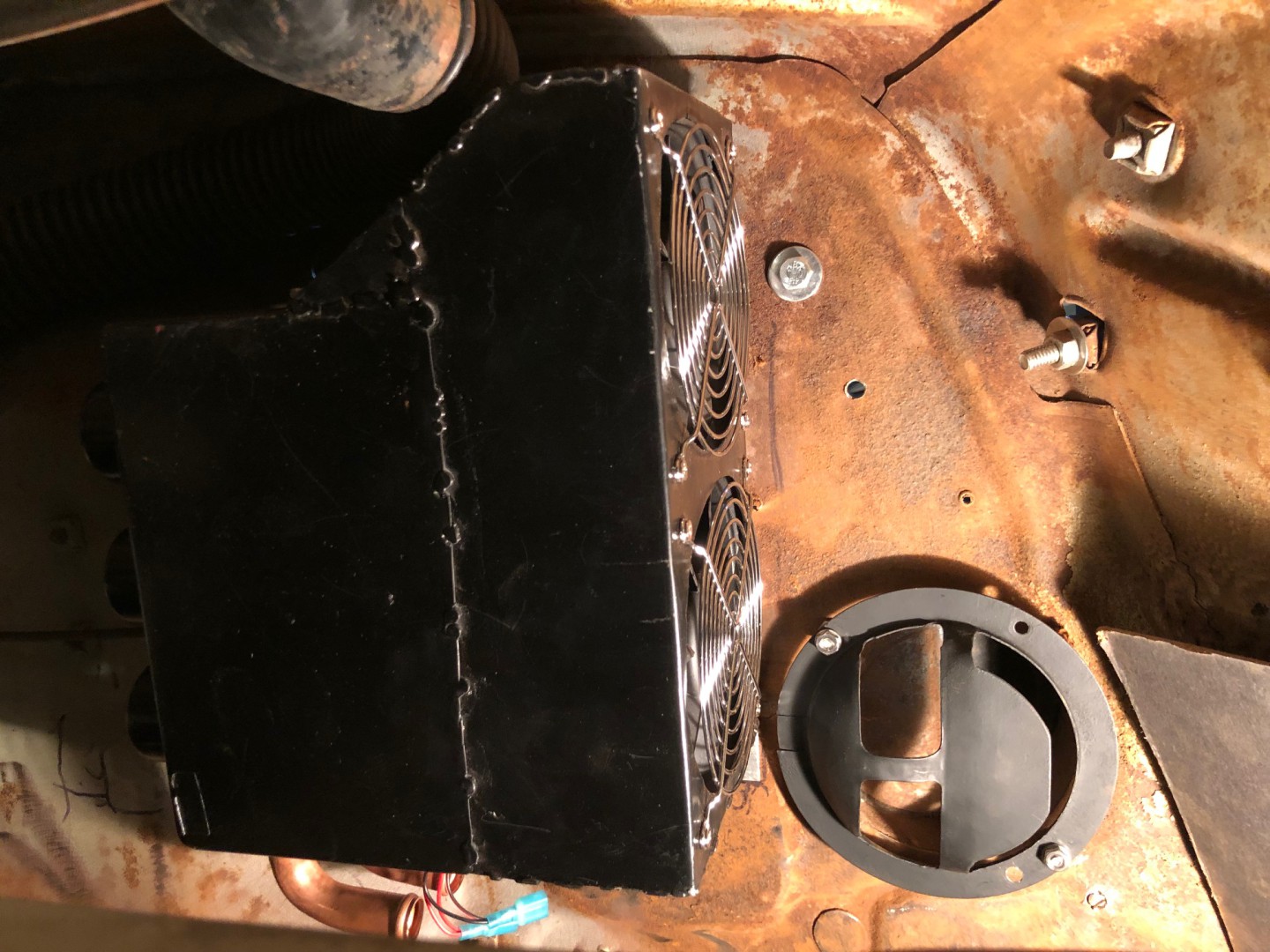

Already appears far more neat and orderly.

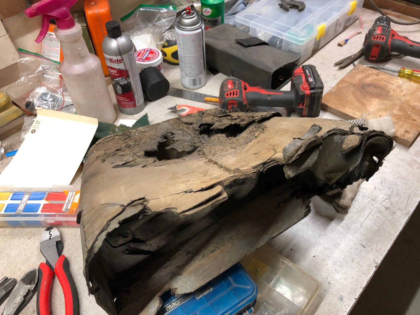

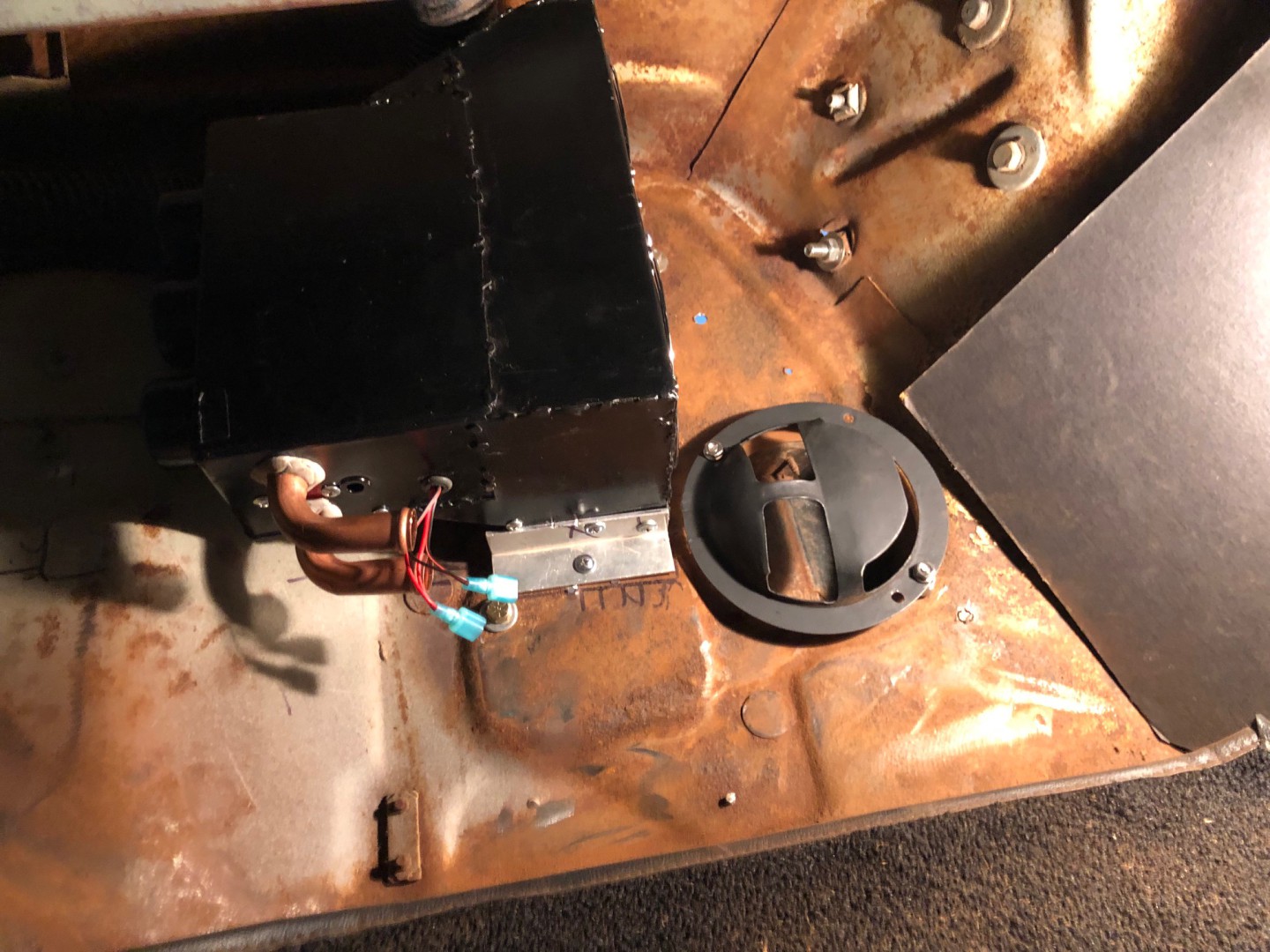

Progress continues, decided to rip out the remaining firewall insulation which was pretty bad shape.
This made it a lot easier to finalize the location of new Heater/Defroster
Will clean up the rust and put something on the firewall to help with heat and noise.

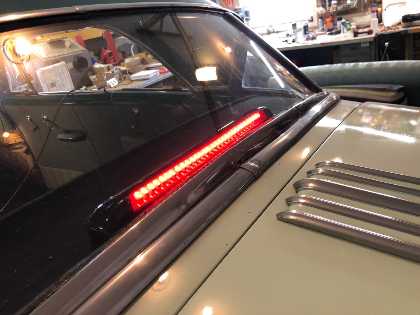

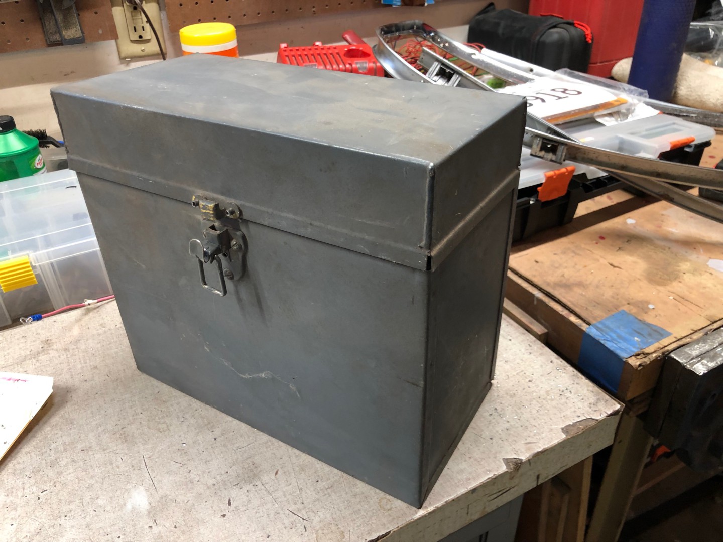

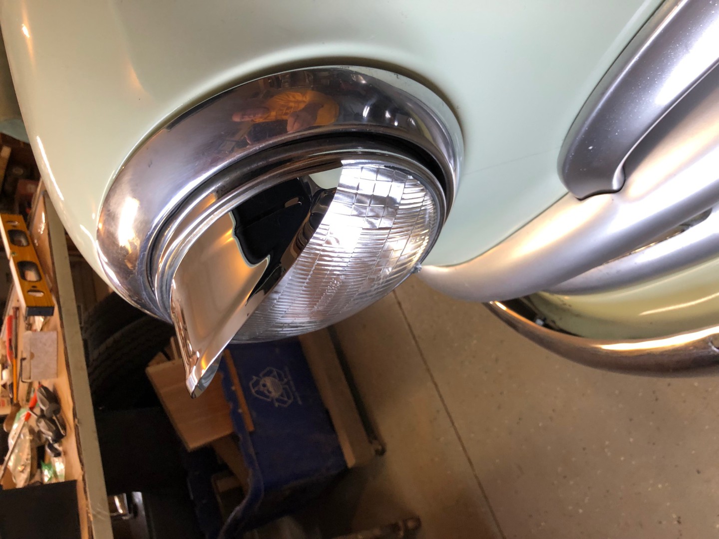

Now to really focus on the electrical, it is getting there but taking time so hopefully will not make "Short" work of it,
Functional lights
it really took a lot of other work to get to where I could hook up 2 wires for the back-up lights
-- Edited by BLyke on Friday 25th of February 2022 04:20:21 PM

Lights look nice.
