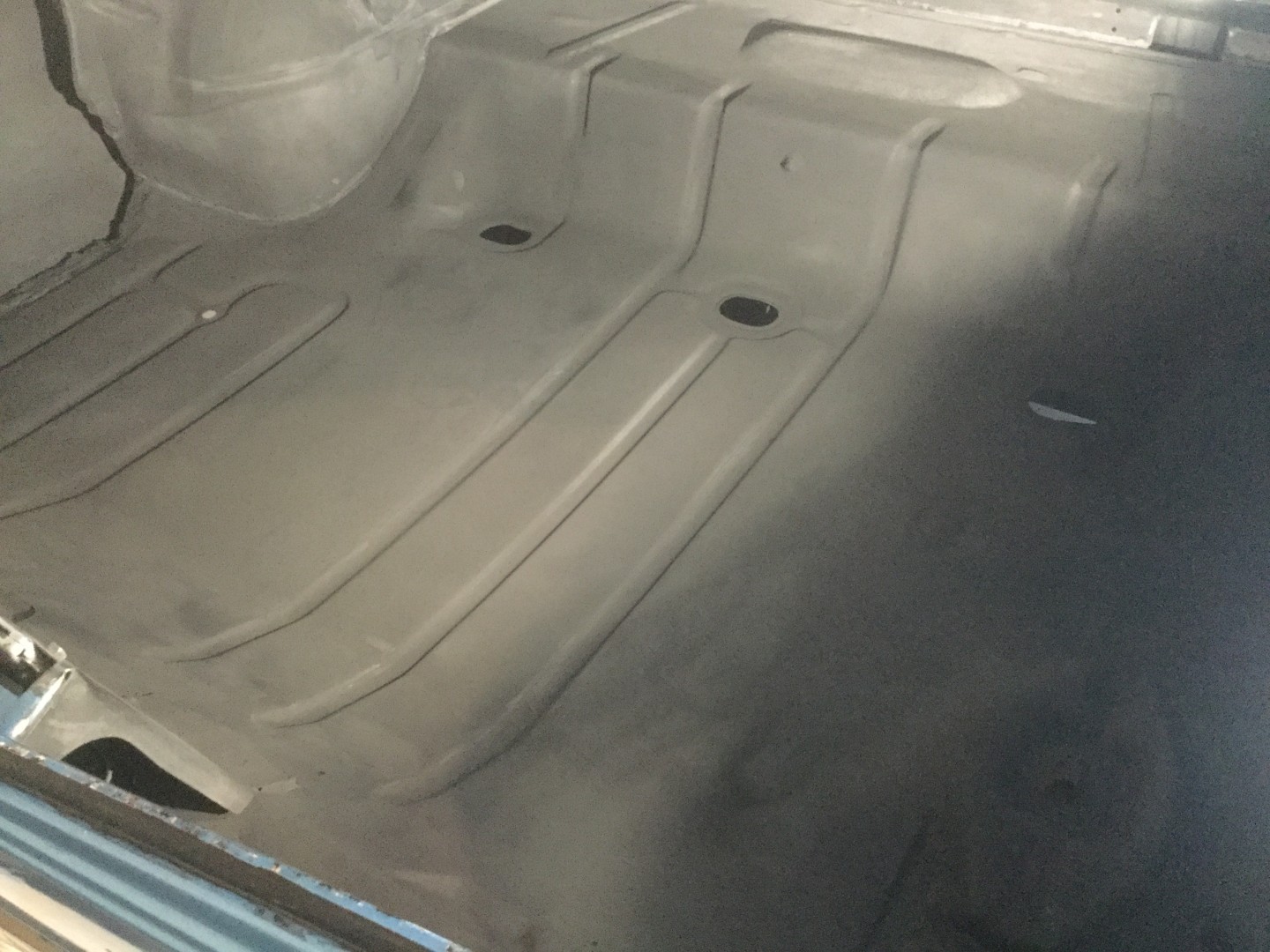

Done for the summer. 2k epoxy primer this morning.
dashboard wrote:Jim, Is that a primer and sealer?
Yes, primer sealer, 2K epoxy except for the upper trunk which I have yet to spray, just going to use a primer sealer on that.
