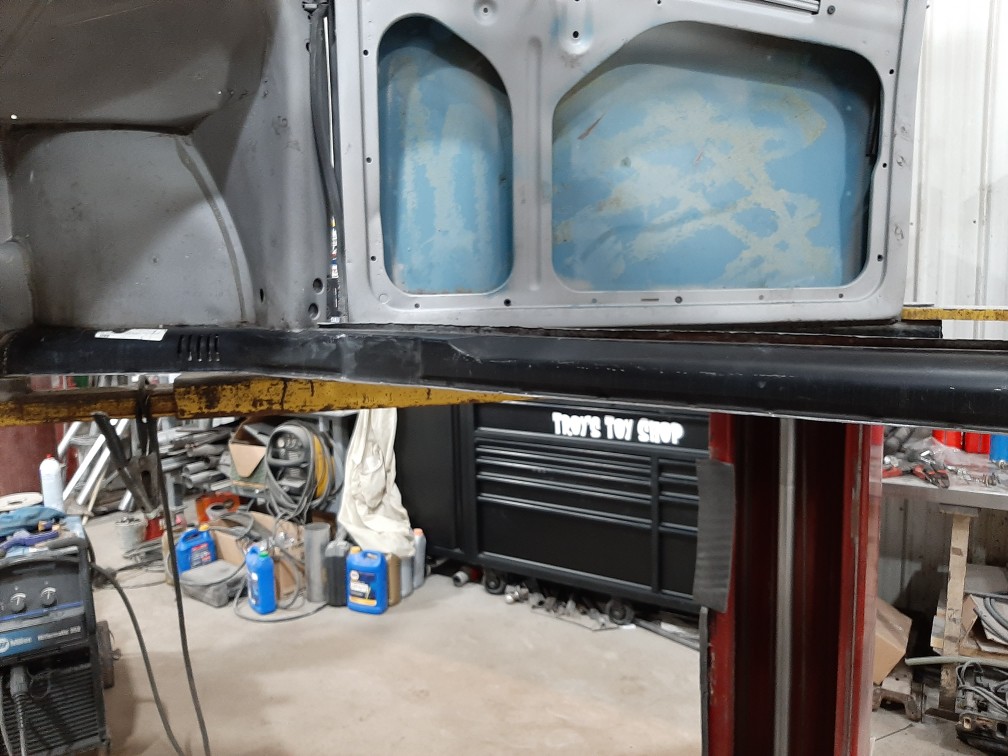

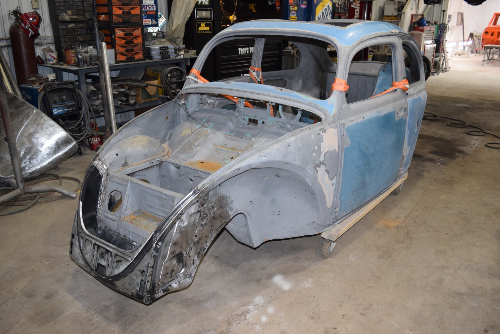

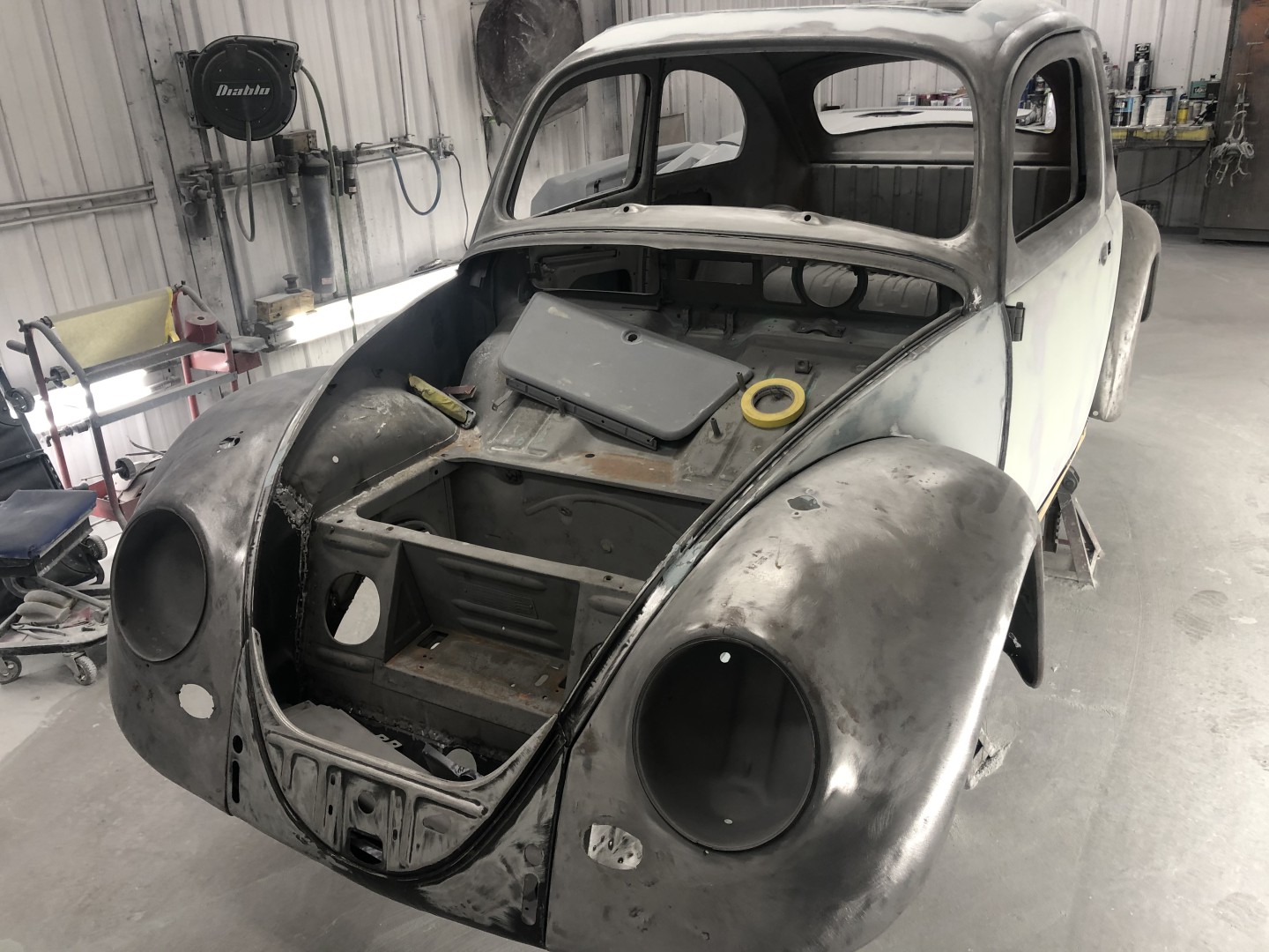

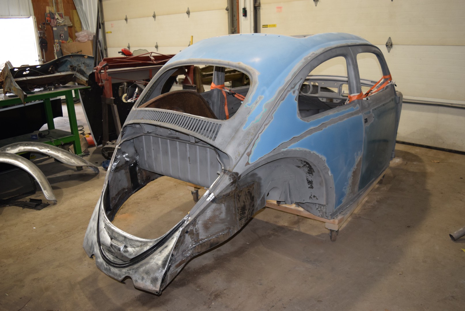

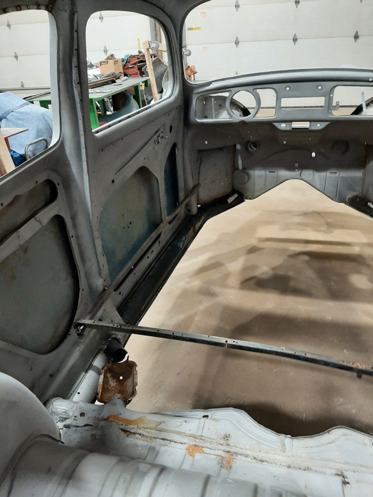

Looks like he cut out the wrinkles in the right front too. Good deal. He seems to be moving right along with the patches as well. Is he going to paint it ?
Mar 4, 2021
Yes. This is the same person that did my Chevelle. Right now the color will be Subaru Dark Gray Metallic
Bruce – Per plan. As you are aware of, as you get into doing a project, you find unexpected things that need to be corrected. So the plan can quickly get changed. I like the job he does, because he approaches the job that it is his name on it. He generally has a couple of projects going at the same time. One will be in the final stage, on in the middle and one just starting. The Beetle currently is a filler project. I am not expecting the beetle back until fall. FYI – He had the Chevelle for 5 months.

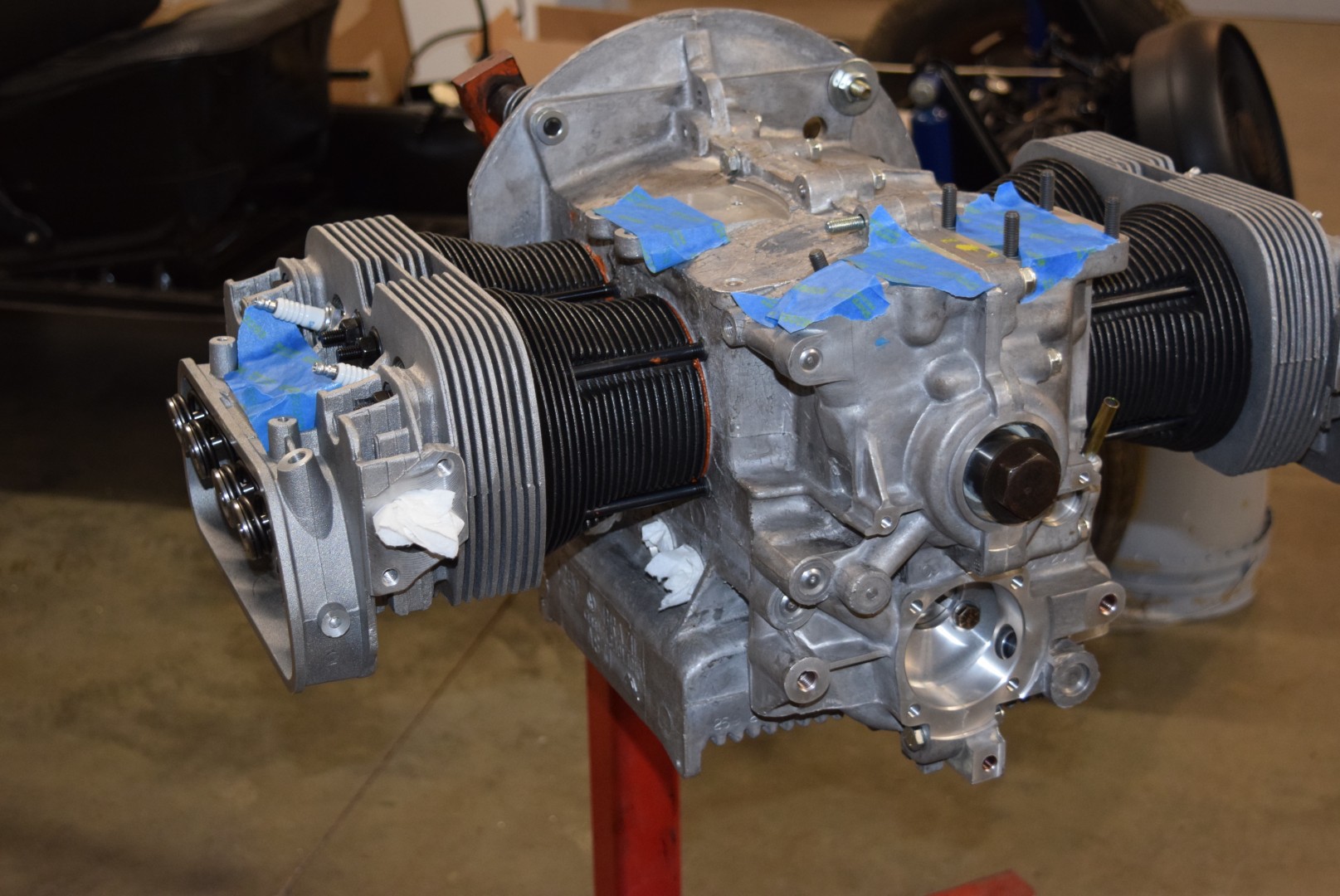

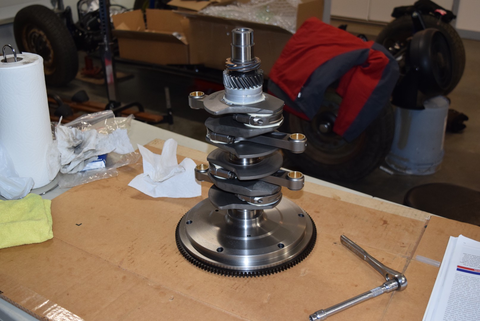

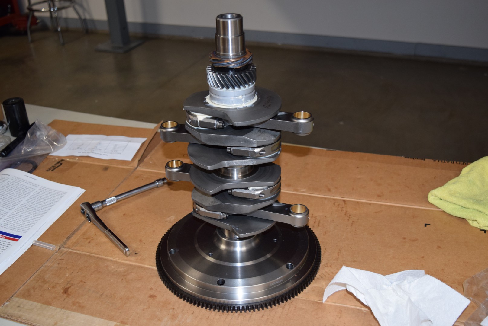

Bob - The engine is from EMPI. It has a number of improvements over the stock engine, including Hi – Perf quality rods, ARP Bolts and bronze bushings. The rods were balanced within 2 grams of one another (330, 330, 331, 332), ring gap was already set and the pistons come in the cylinders. It is basically a long block where I re-use the exhaust manifold, intake (if I had a dual port intake) and the air cooling shields. When I started to price out the replacement parts and the machining of the block, the cost difference made it a no brainner for me on which direction to go.

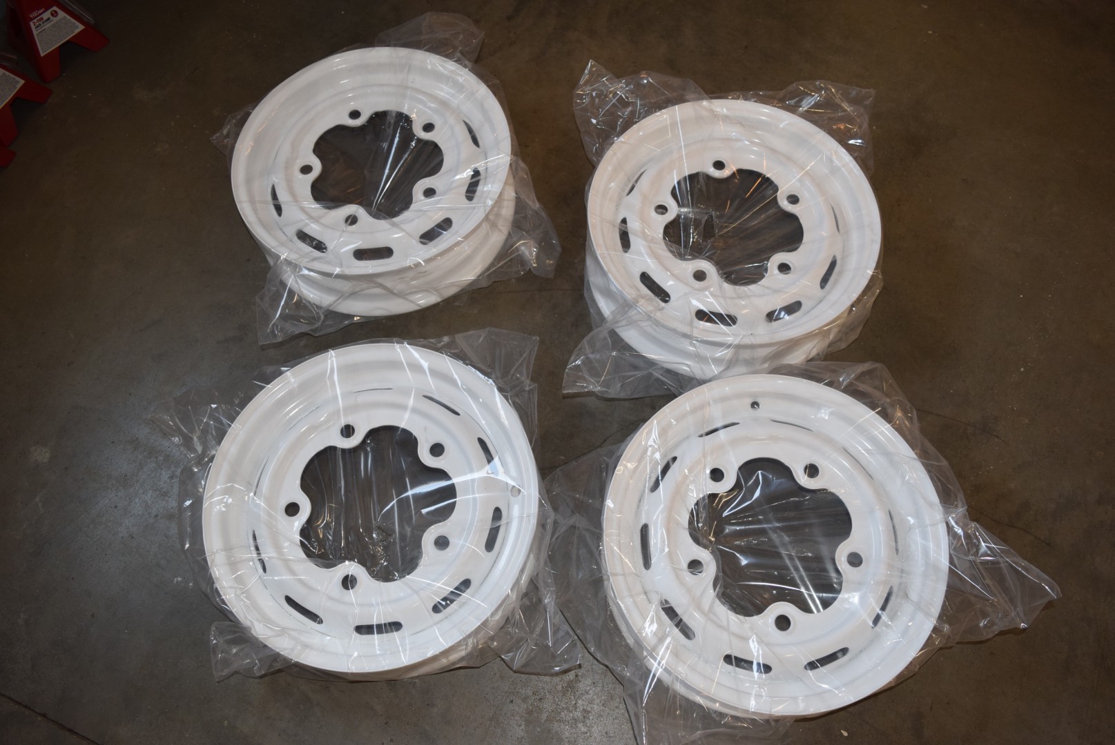

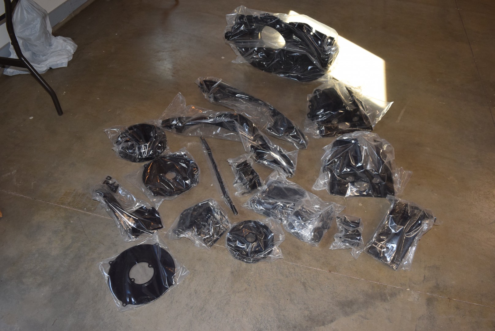

Rims and engine tin are back from powder coating. Going to be ordering tires next week.

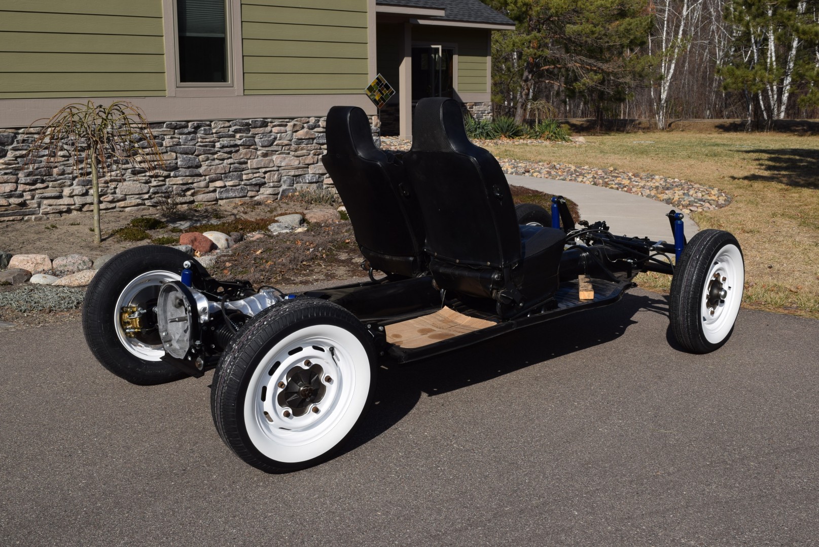

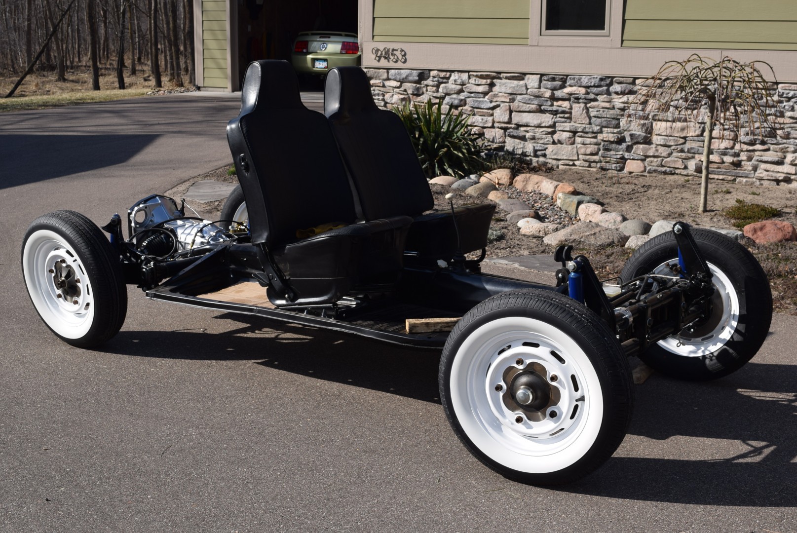

Bought a seat of VW high back buckets a couple weeks ago. Just want to get some better protection in case of a rear collision. Got the new tires and mounted on the rims (love the white walls). Just waiting for the VW baby moon hub caps and slowly assembling the motor.
Karen is ging to be sooooo happy with that. She might even let you drive it.

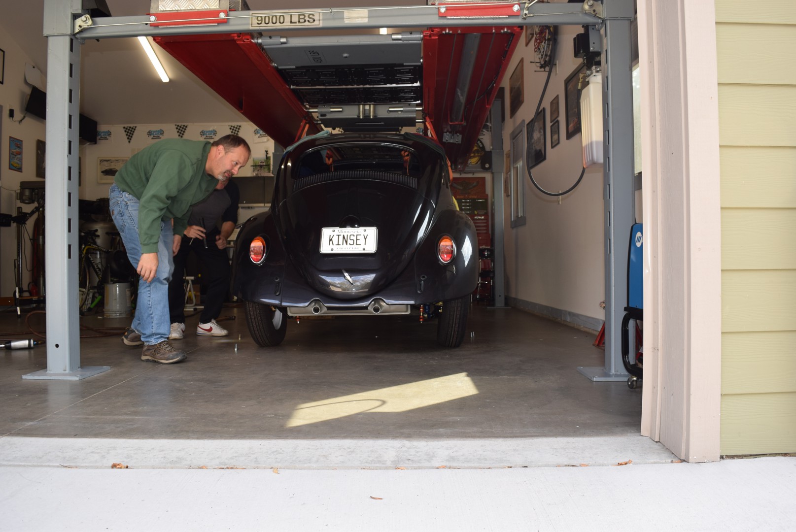

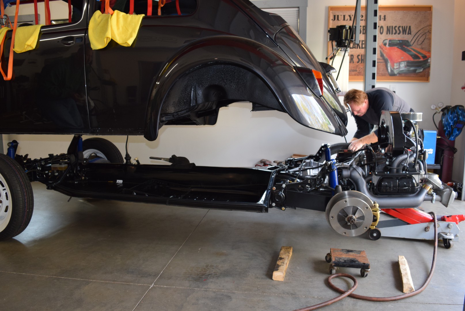

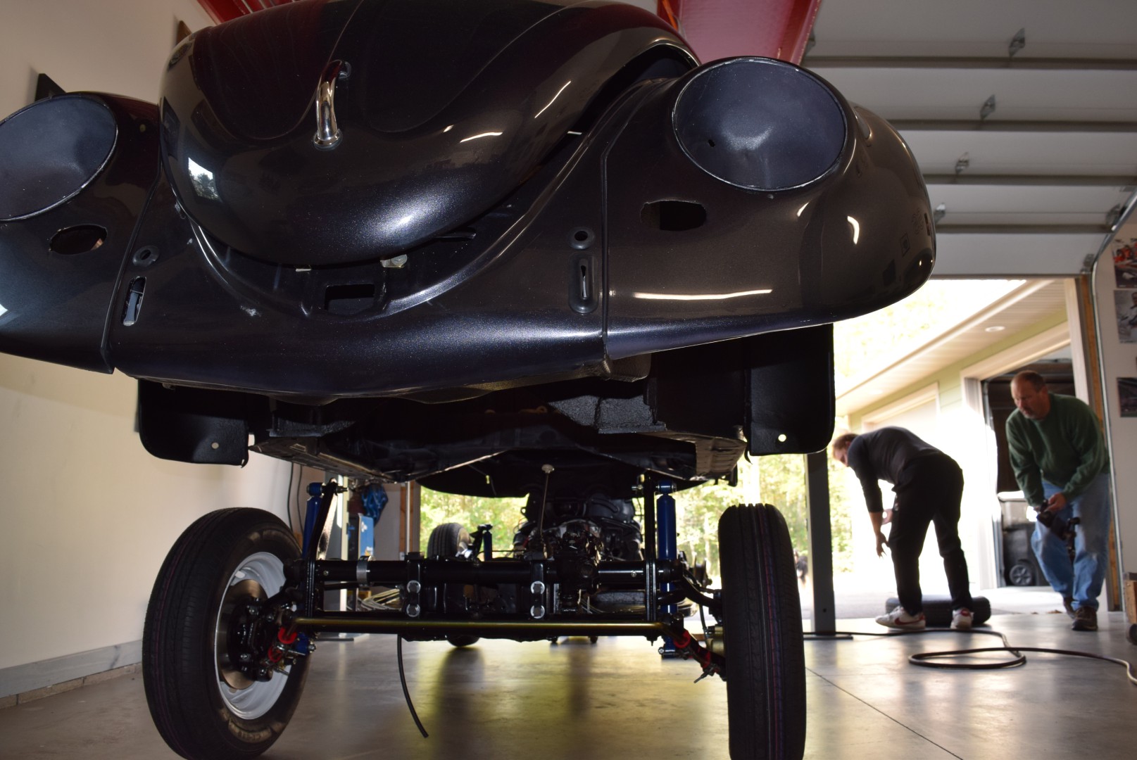

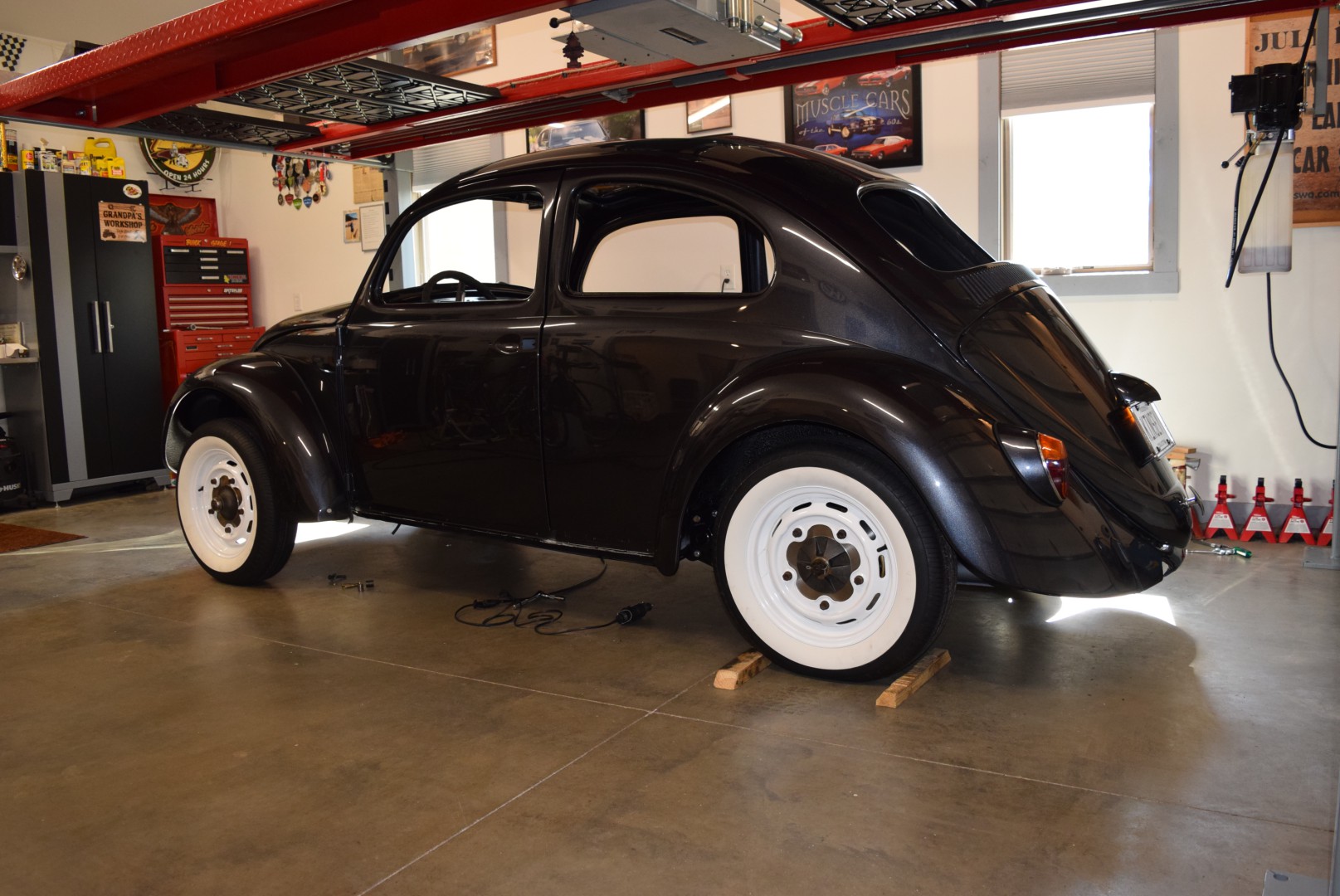

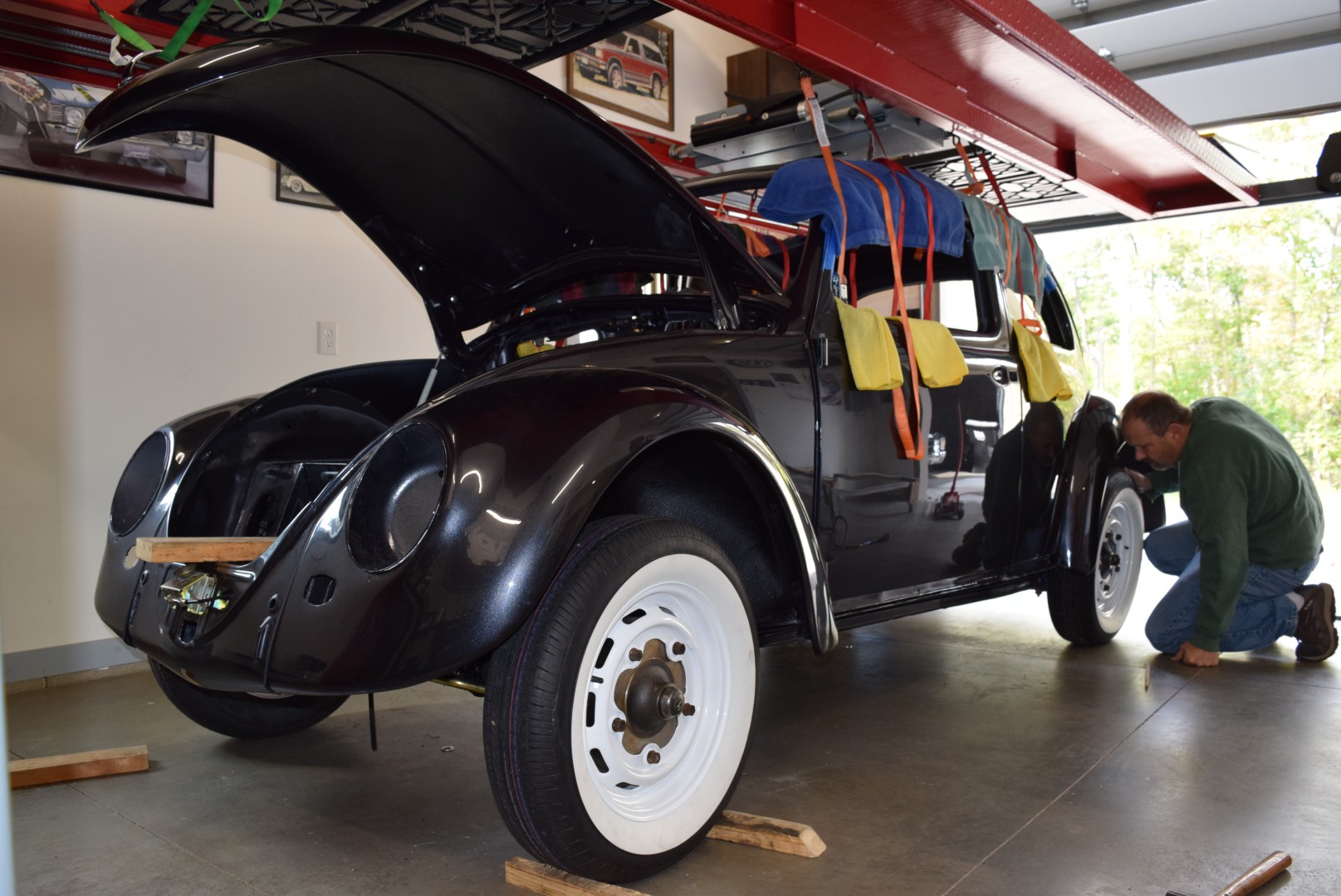

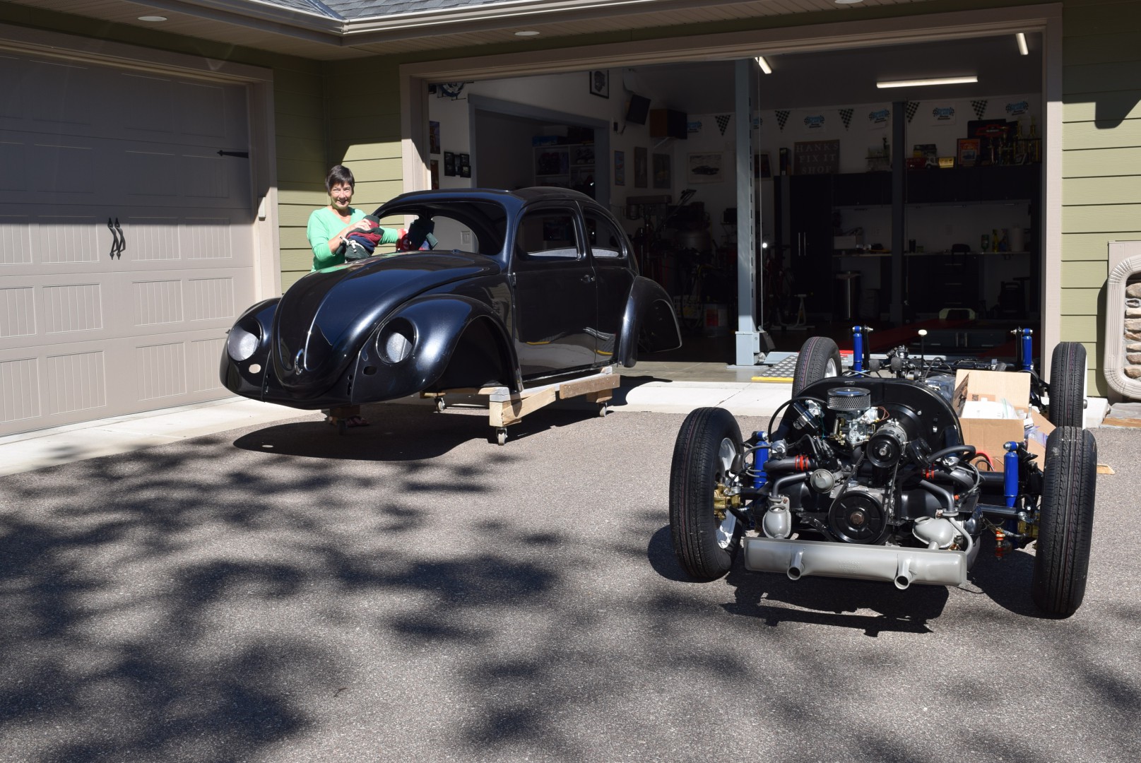

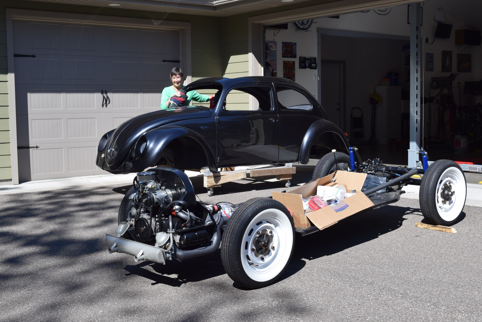

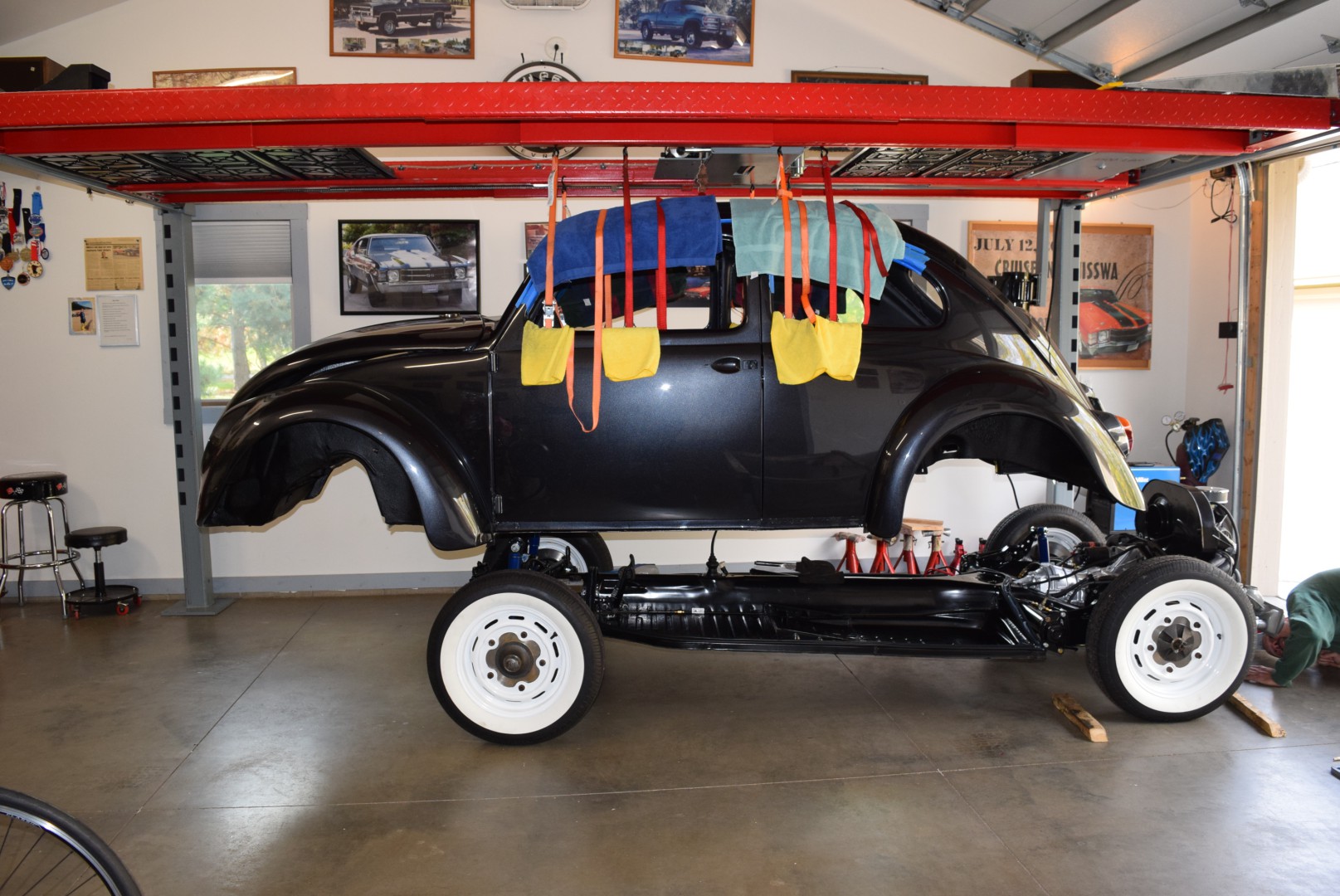

Put the body back on the chassis. Thanks to Chris P for the help and suggestions. Had to do some minor modifications, but not too bad considering how many parts were replaced.

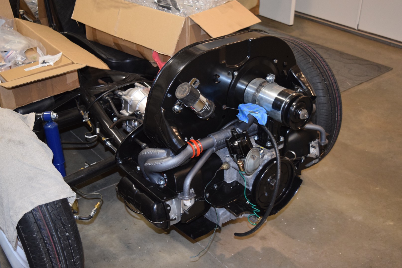

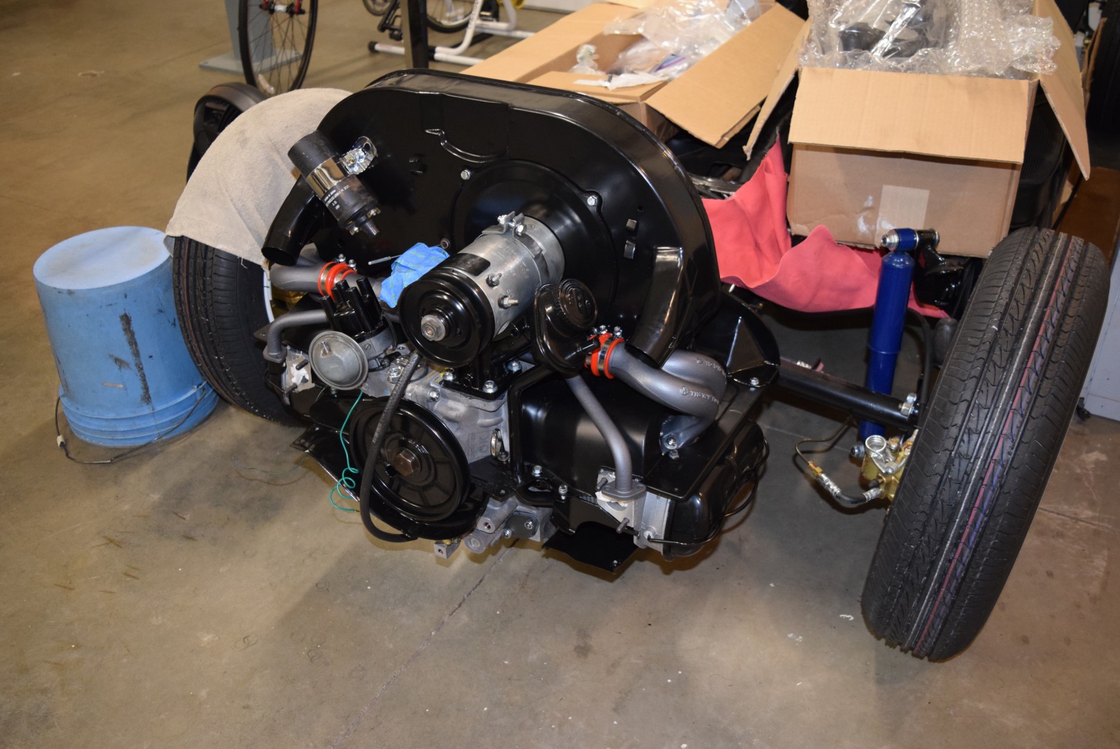

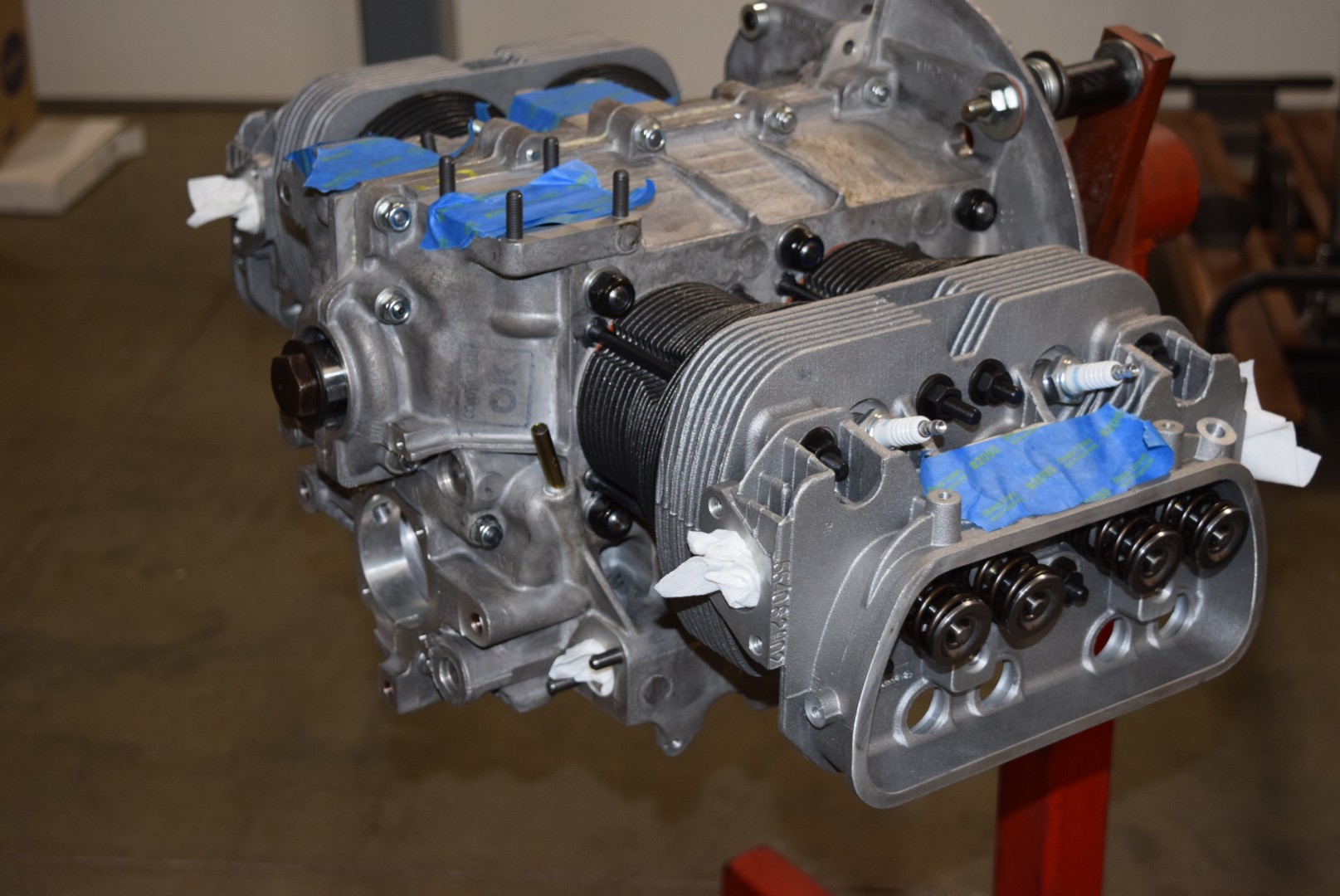

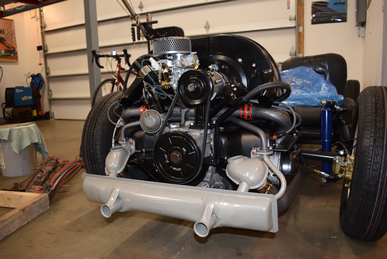

Started assembling the motor
Don't look like VW parts
1600cc?
Sounds like a nice color, how is your guy on getting things done per plan?
Yeah, what are you thinking ? 4 bolt main block, 10.5/1 compression, rectangle port heads and a 390 Holley...
Grenades on the track...

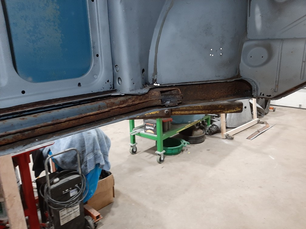

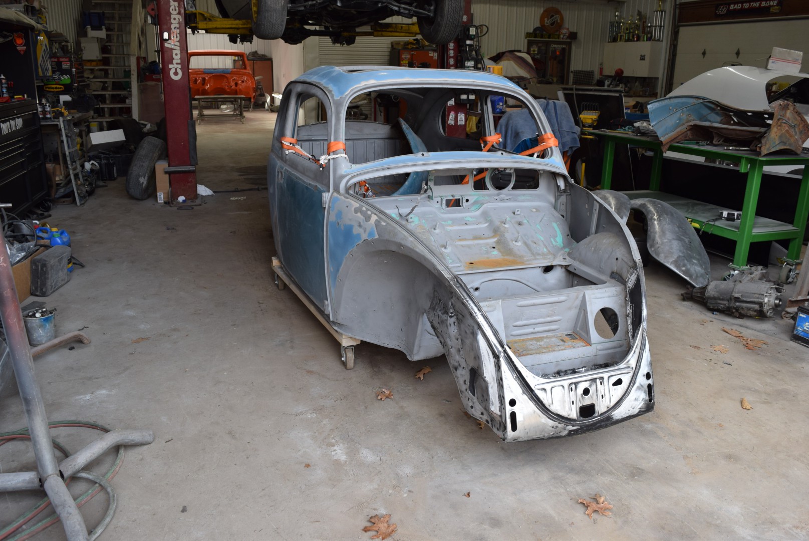

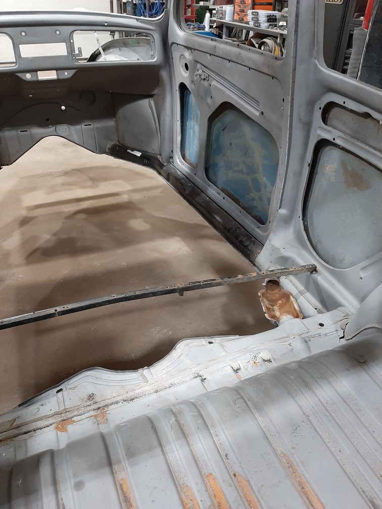

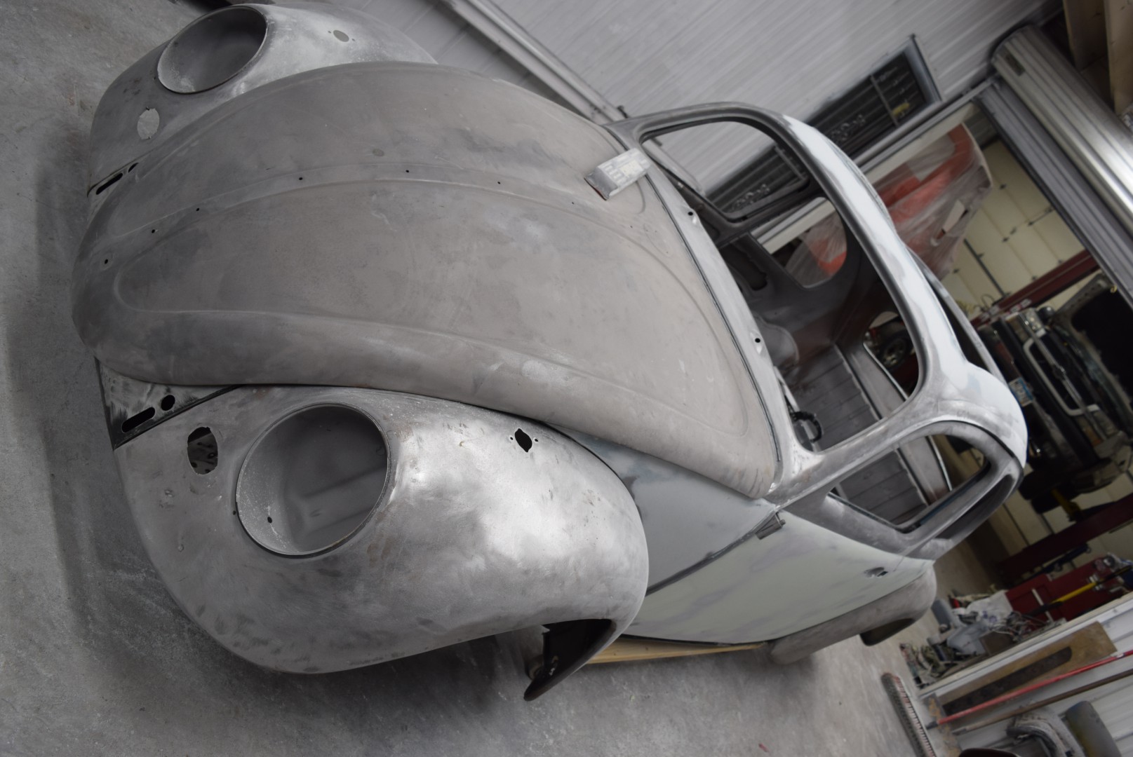

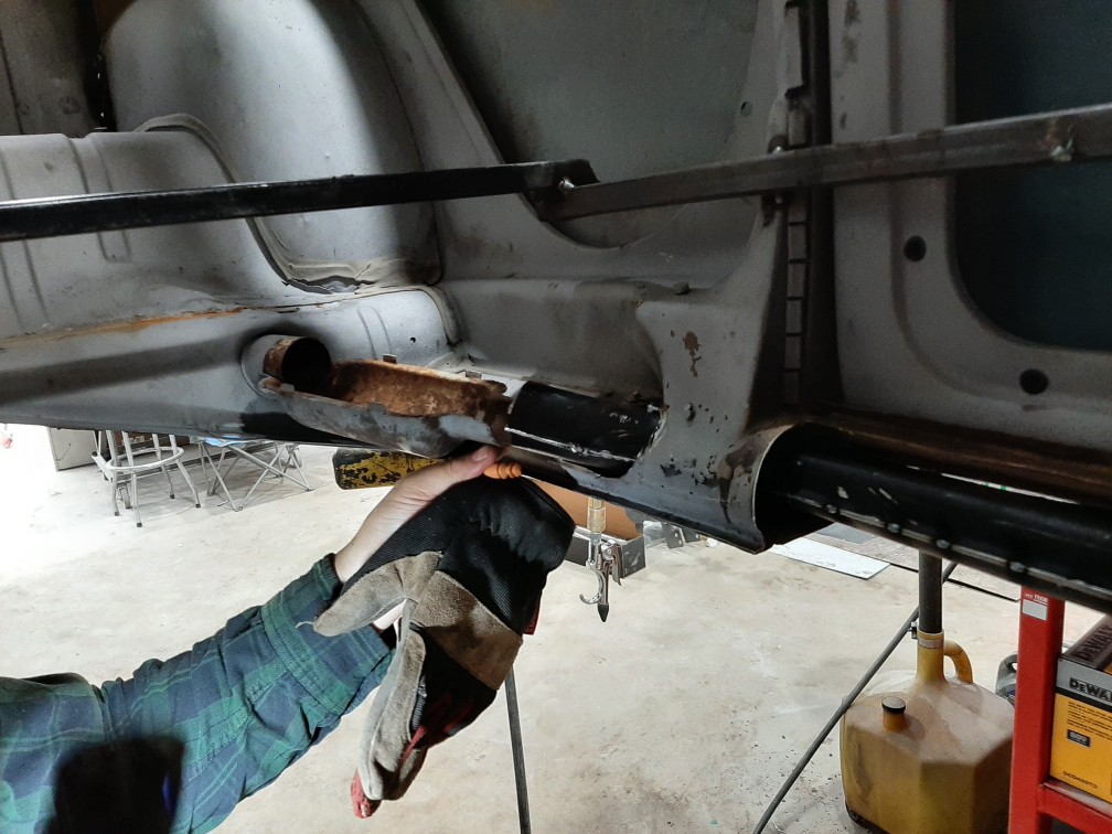

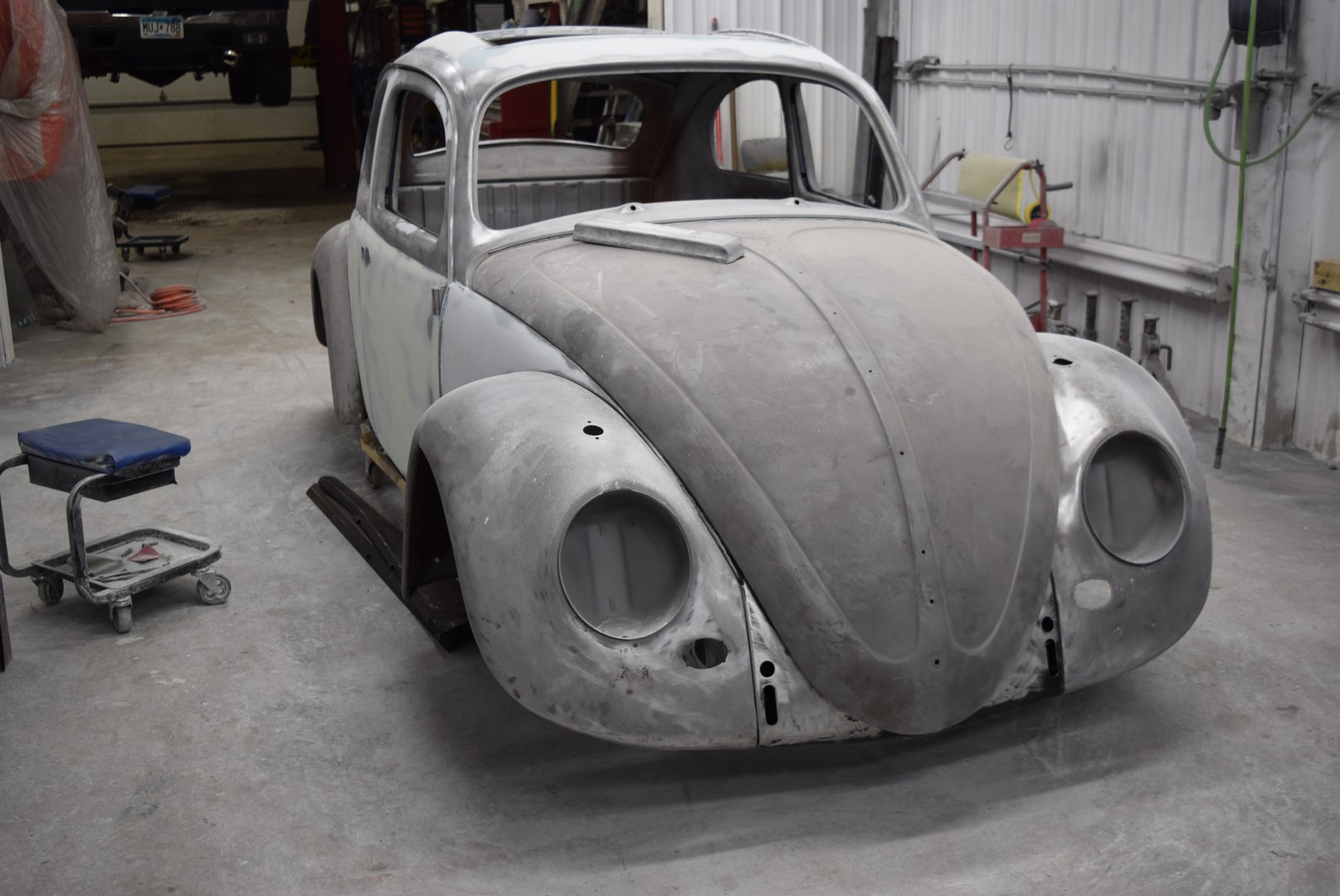

Some updated pics of the front/rear of the Bug. Plus they installed the heater channels

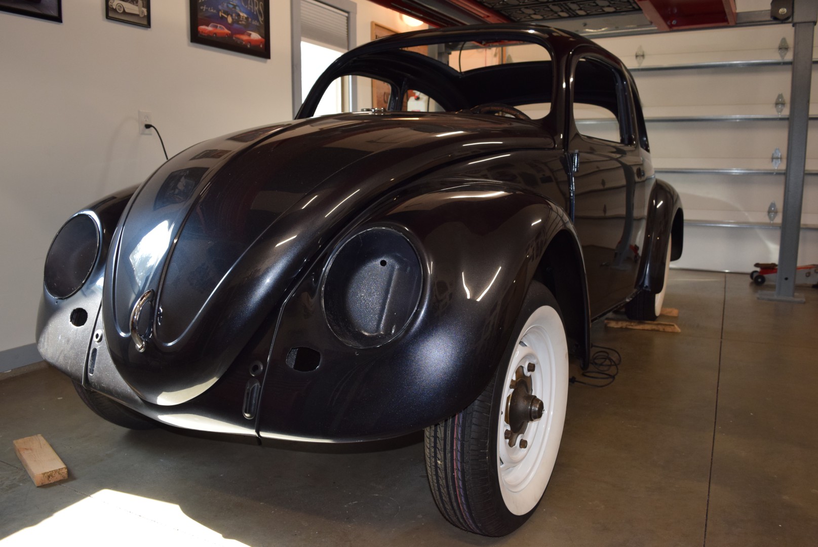

Nice work.
Remembering the old heater channels and winter in a VW, mostly pumping exhaust in to the cabin and doing little to clear the windshield.

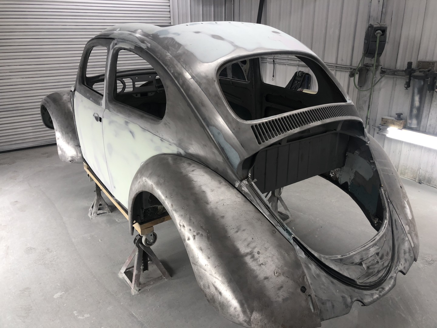

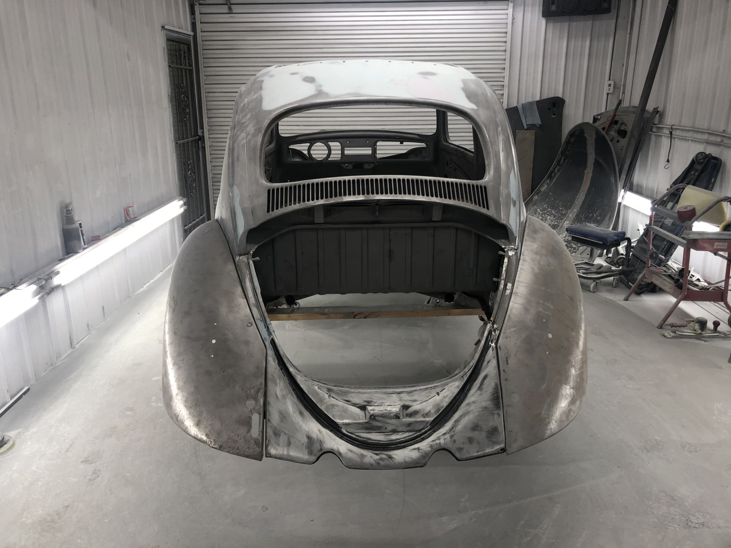

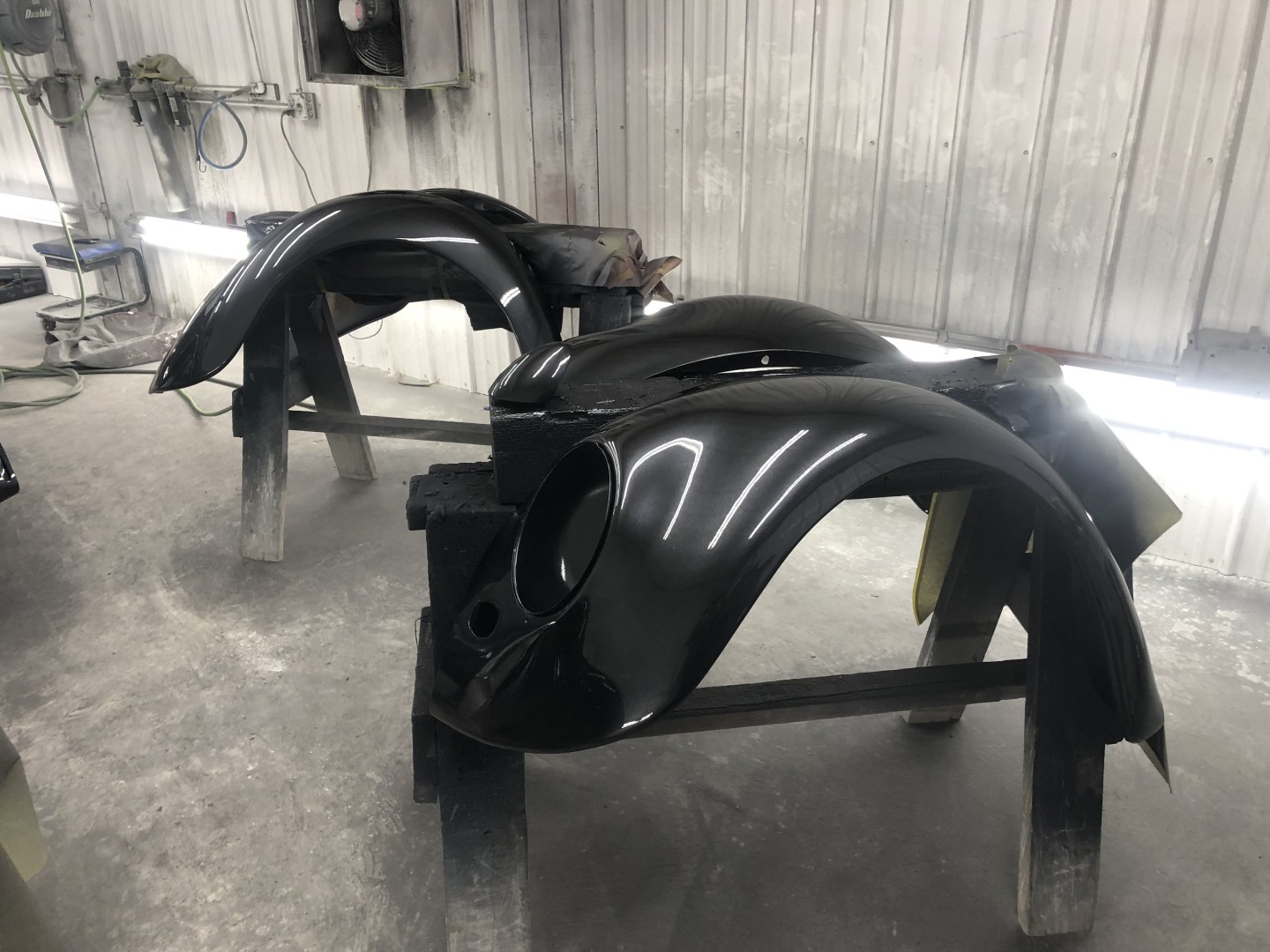

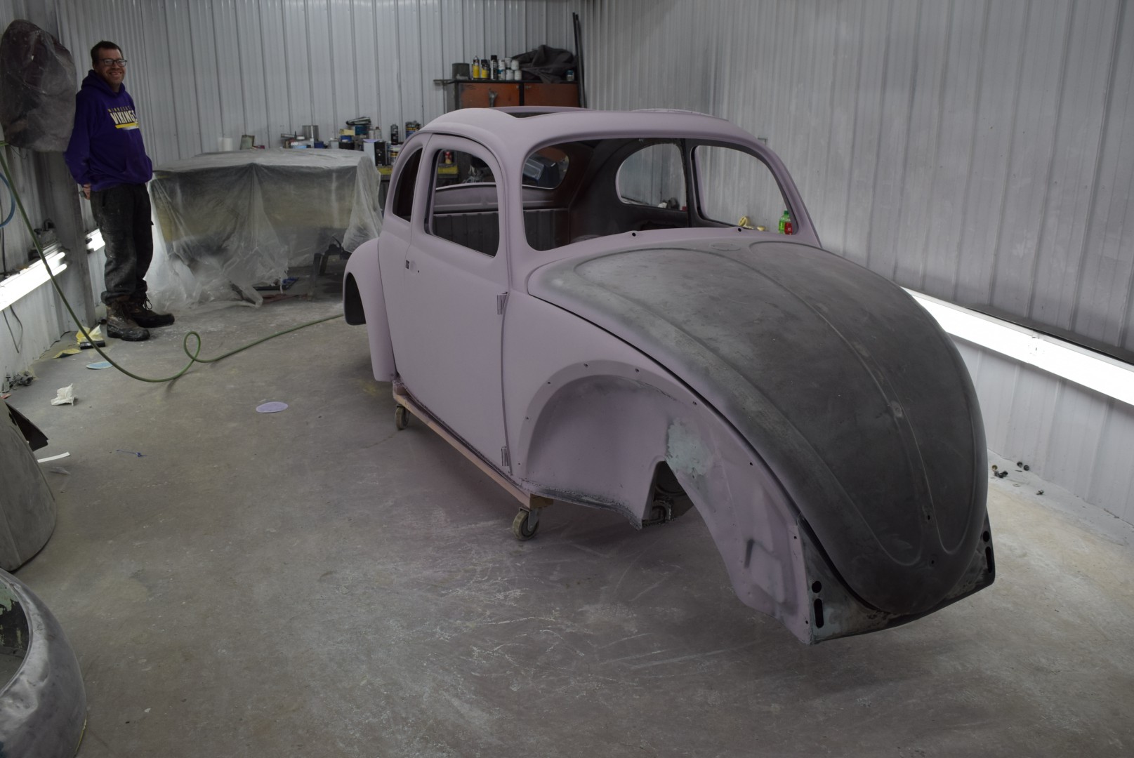

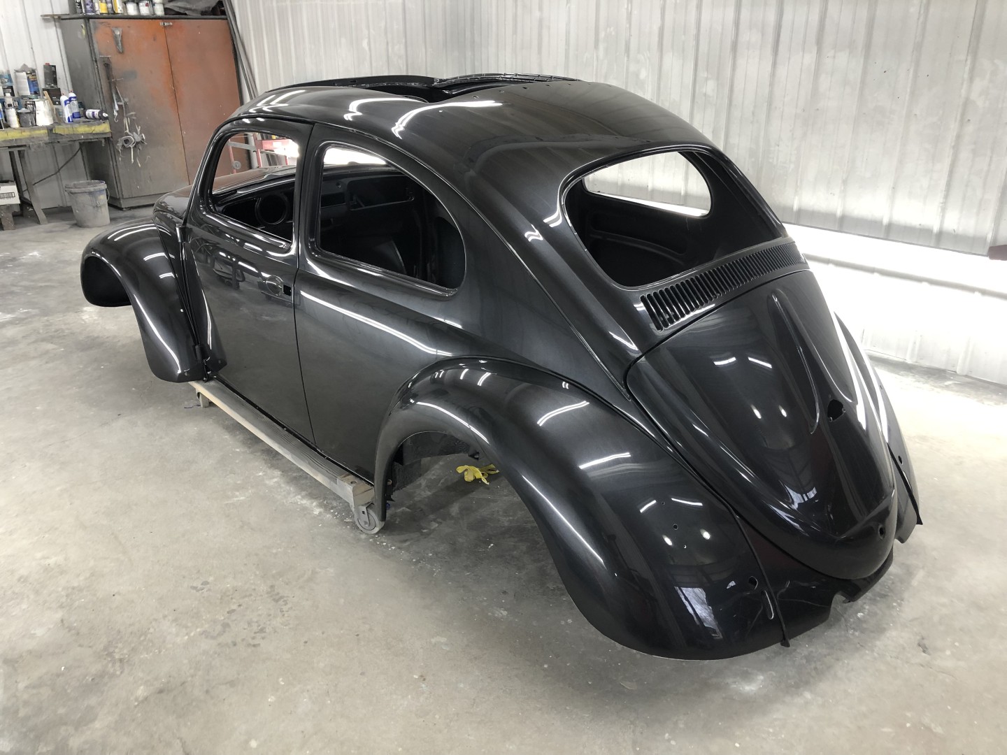

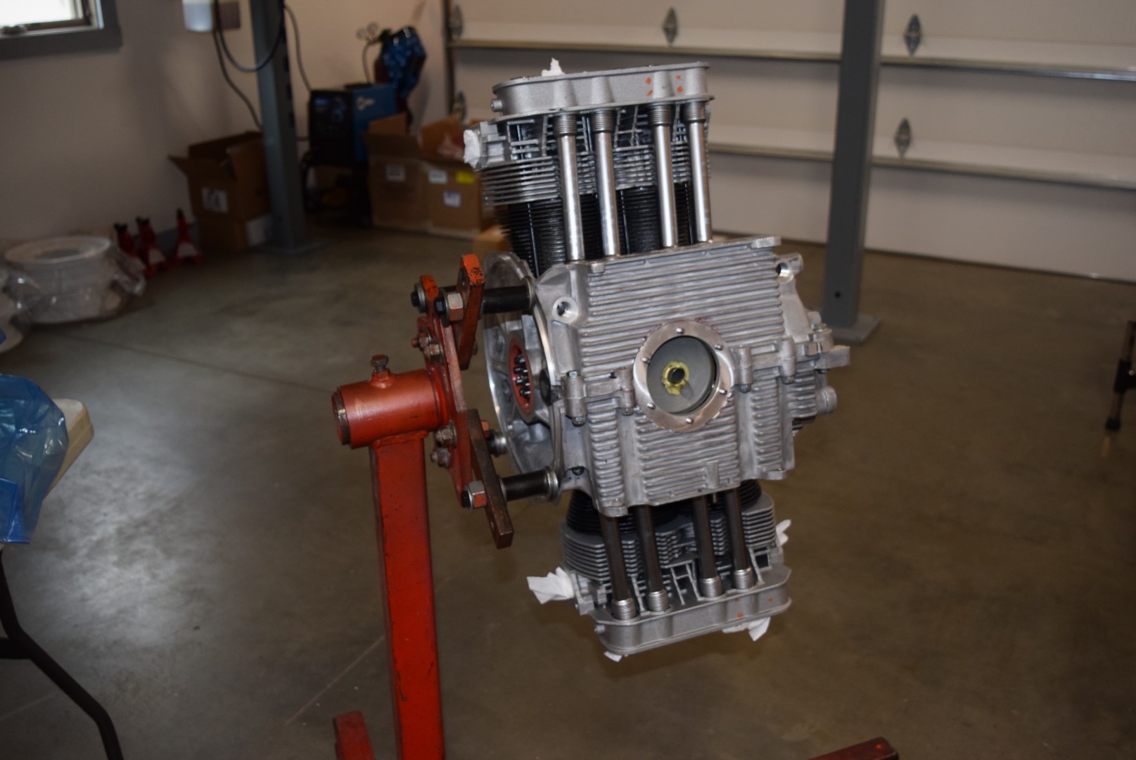

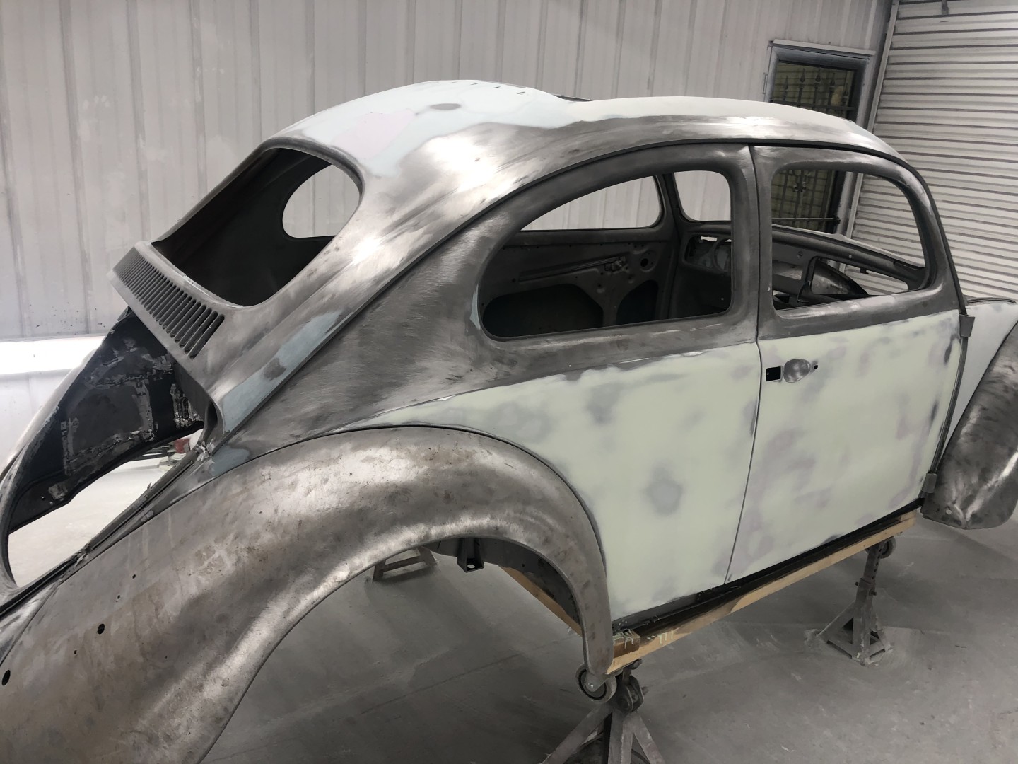

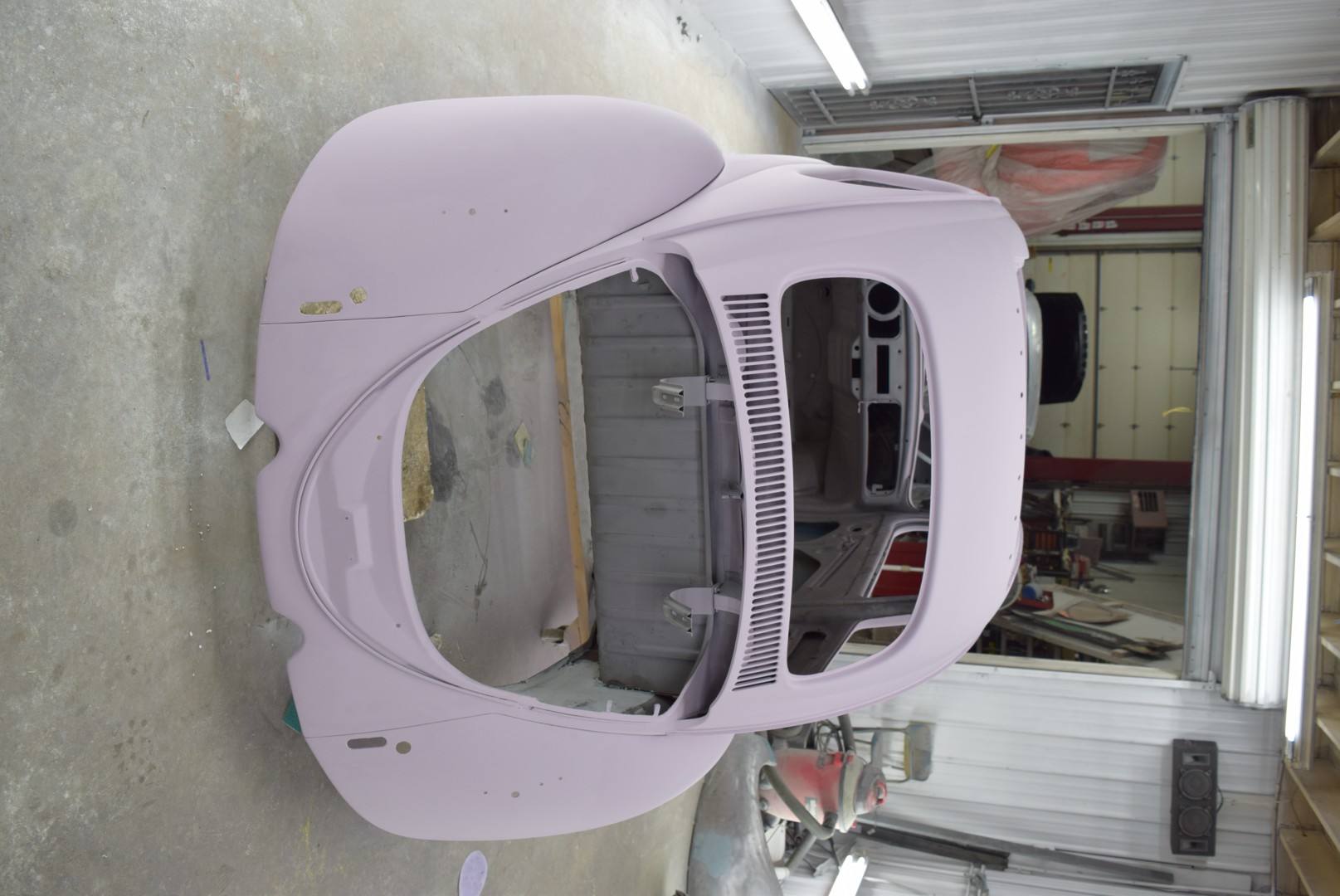

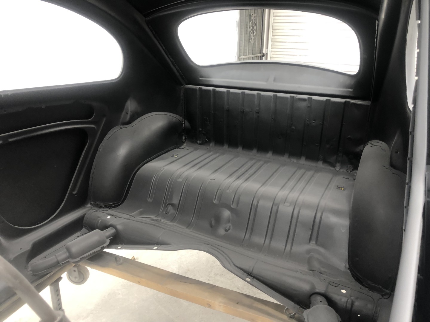

Though I have not posted recently, there has been work on the Bug. The majority of the body is in a primer/guide coat.

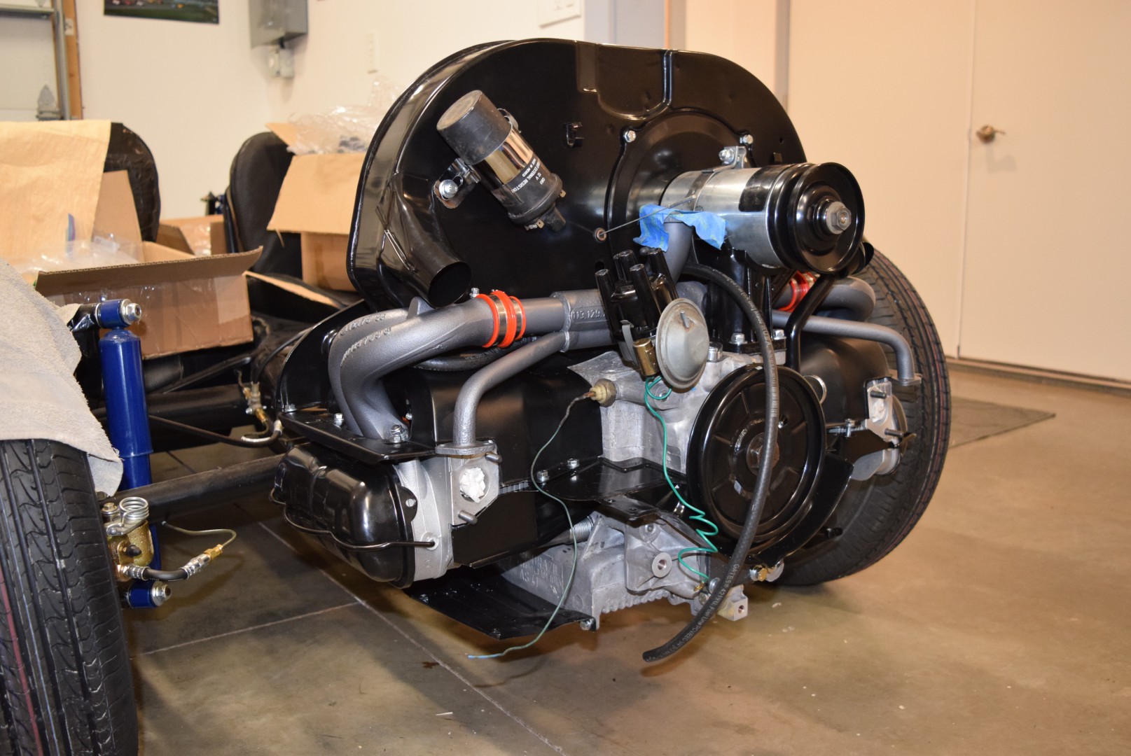

Here is some recent pics of the motor
Purty!!
We have another automotive Artist among us!
Thanks to Bill L. and Chris S. for helping with the engine. Chris and I broke it in today

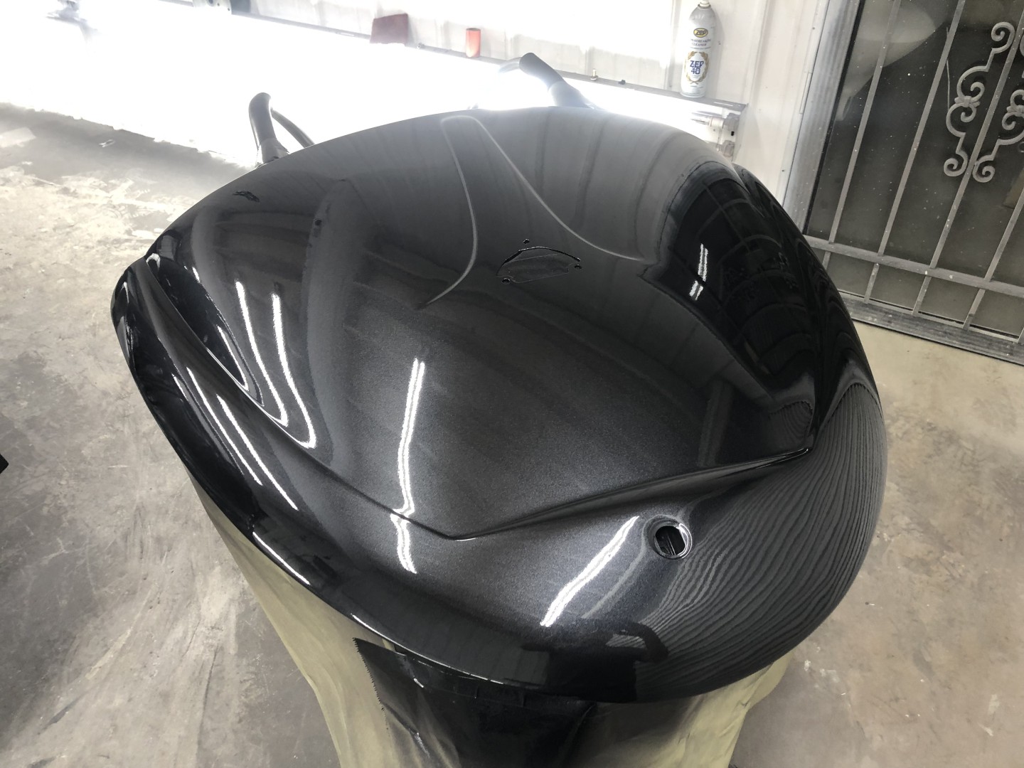

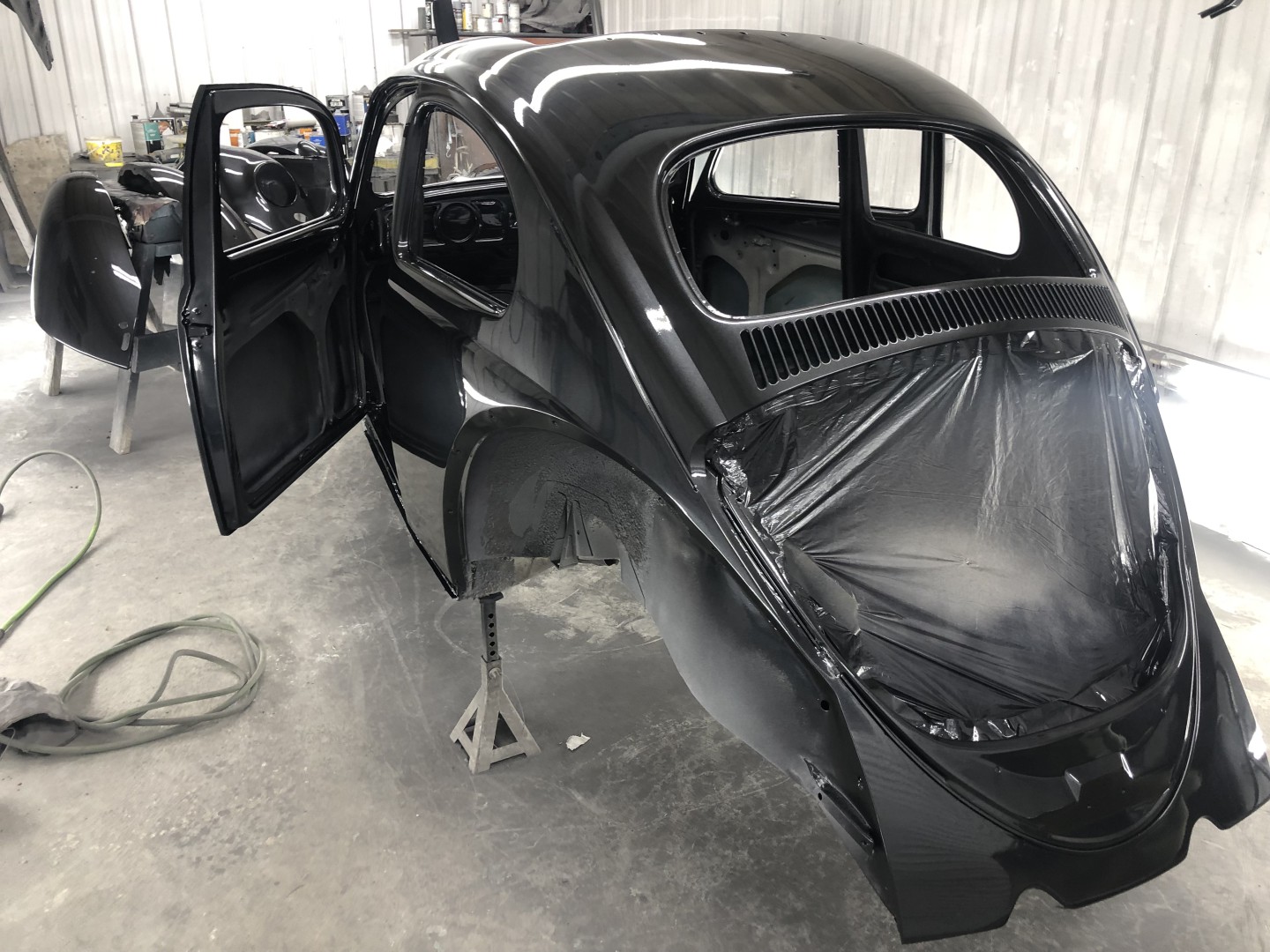

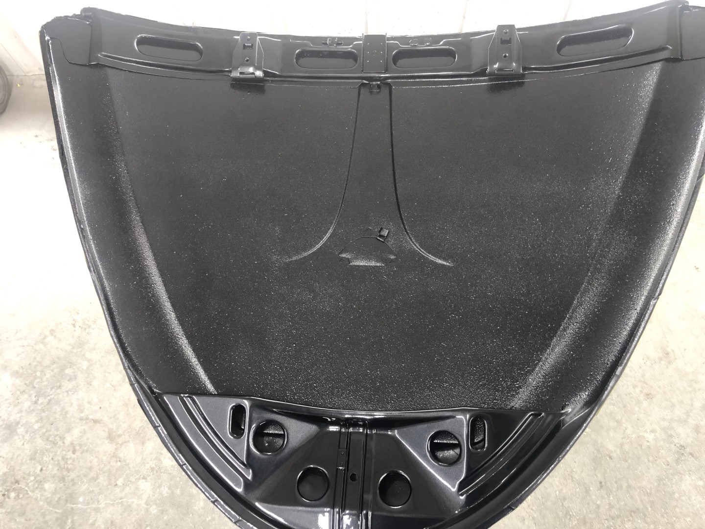

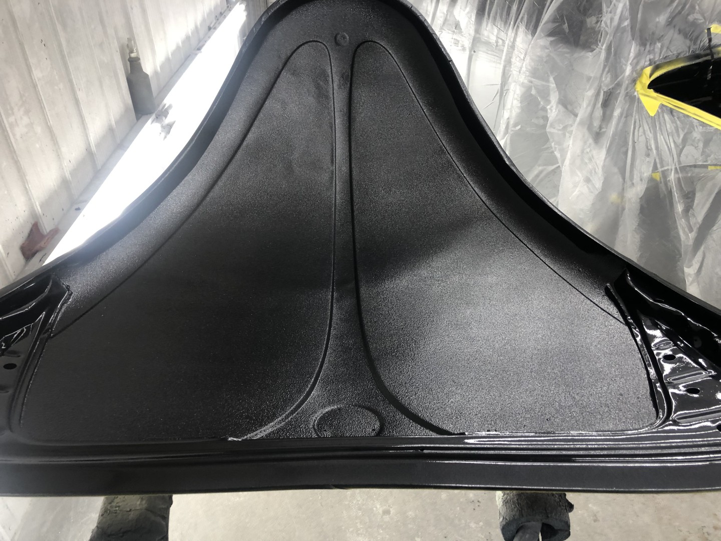

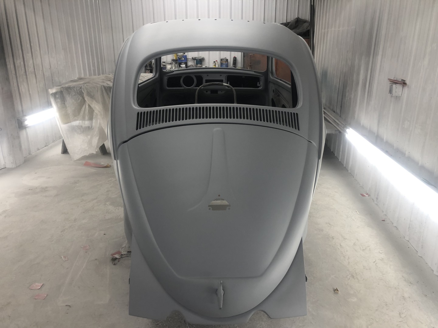

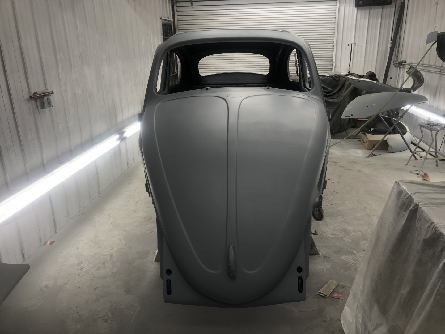

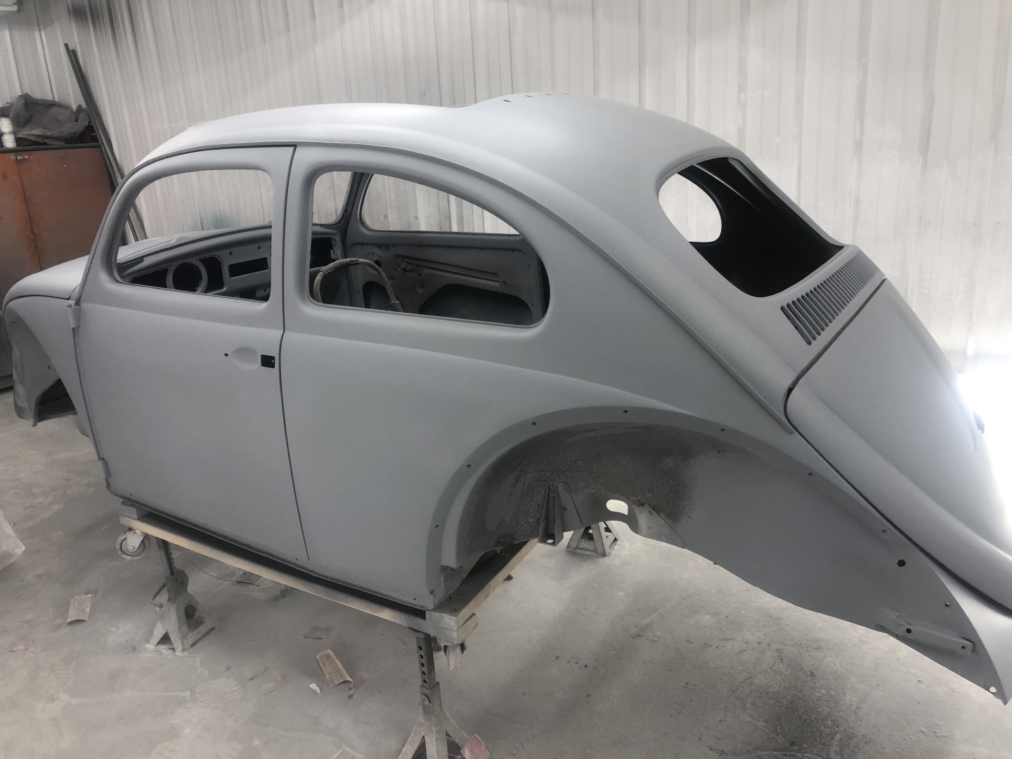

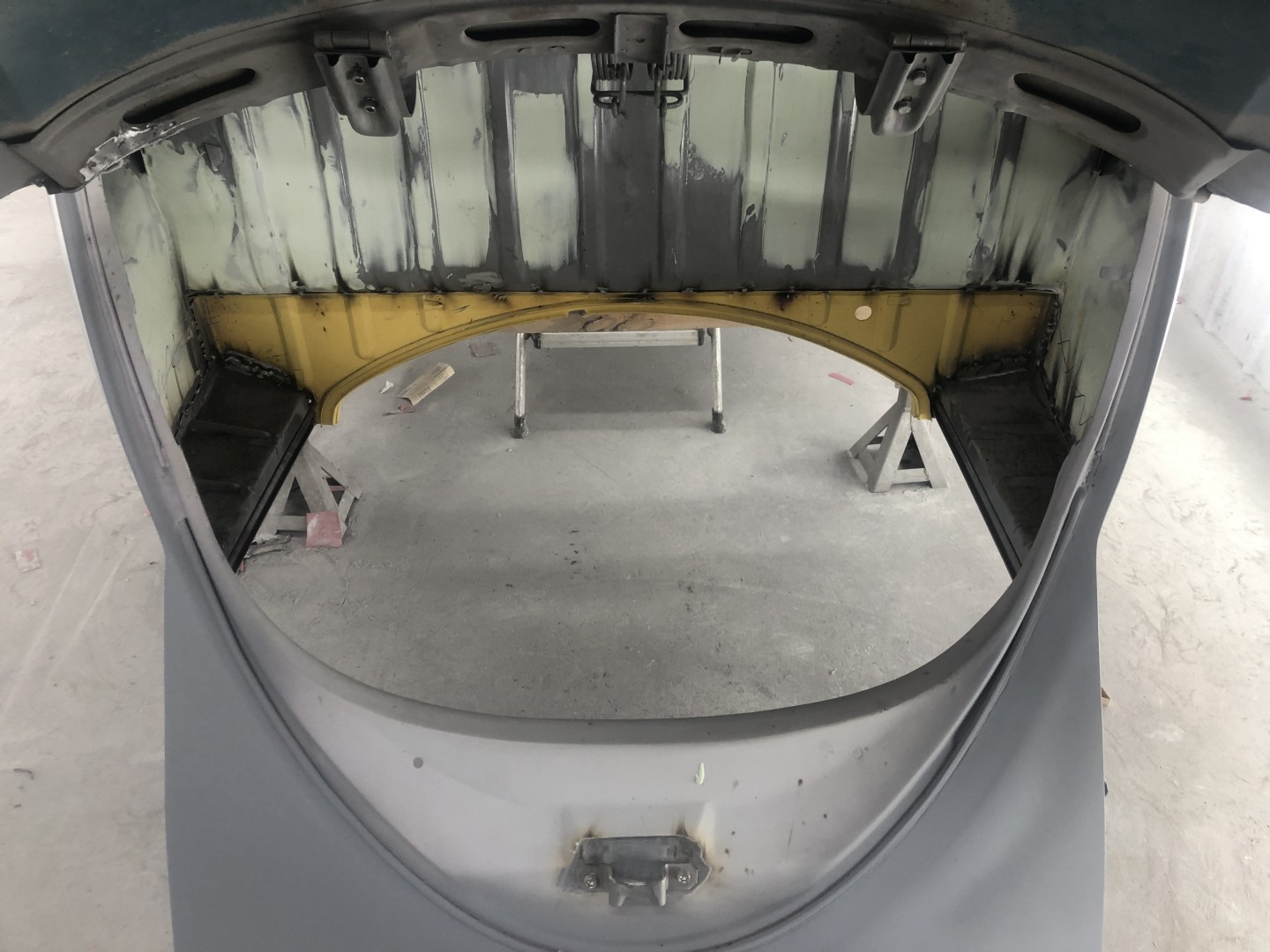

Latest pics of the body. They are planning on it going to paint next week
A lot of hours invested getting it to this point.
An awful lot of style lines.
No small thing.
Glad to see things are progressing.

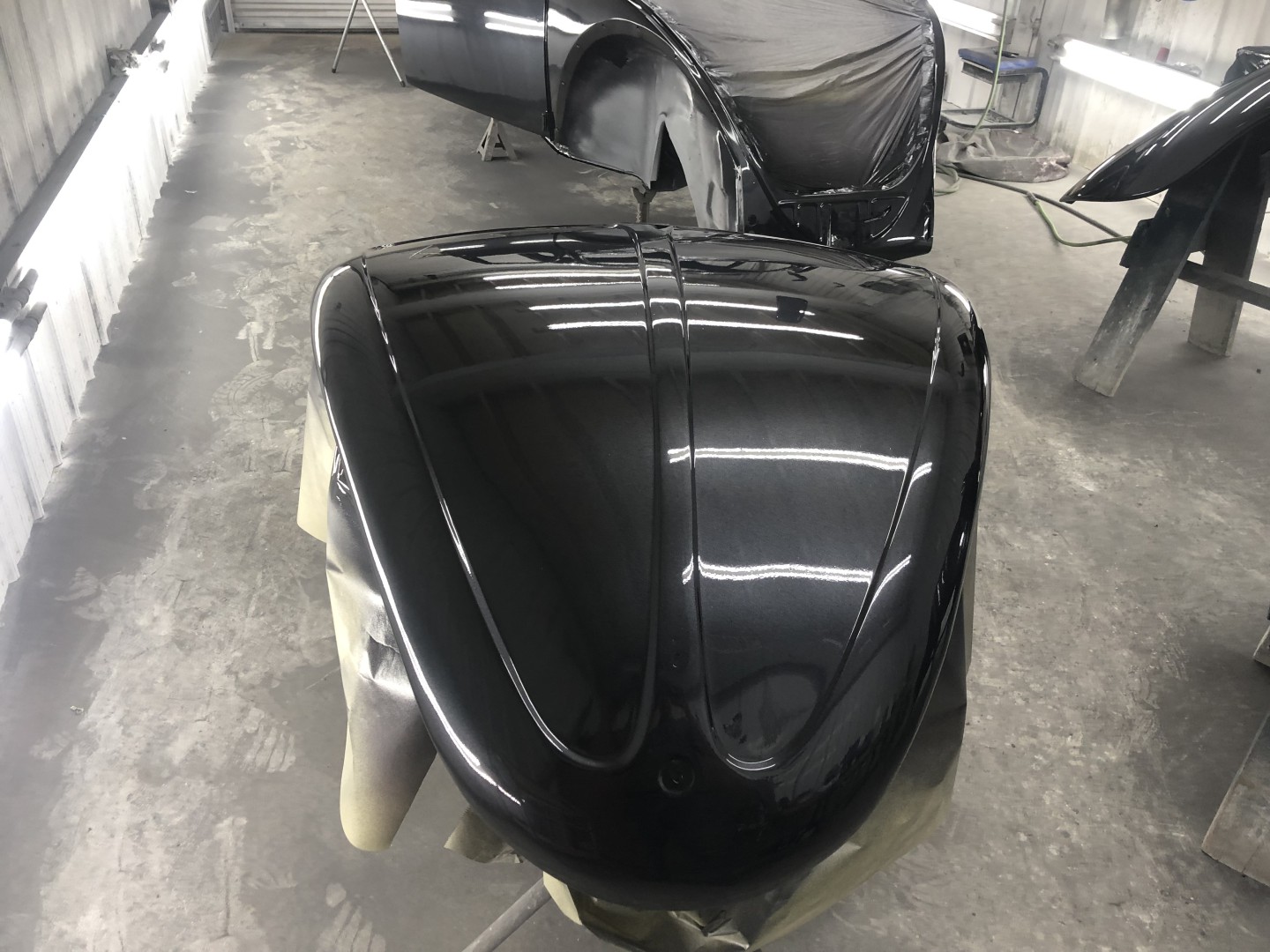

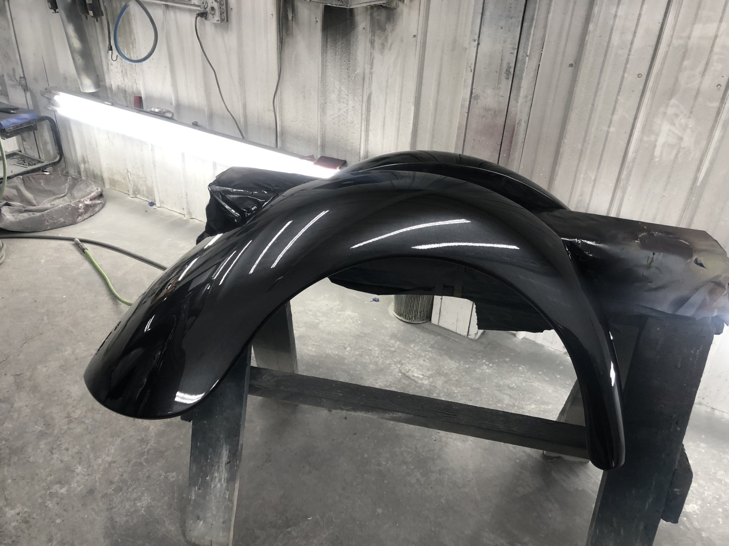

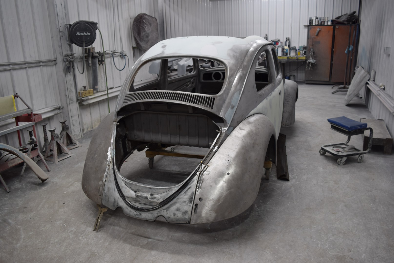

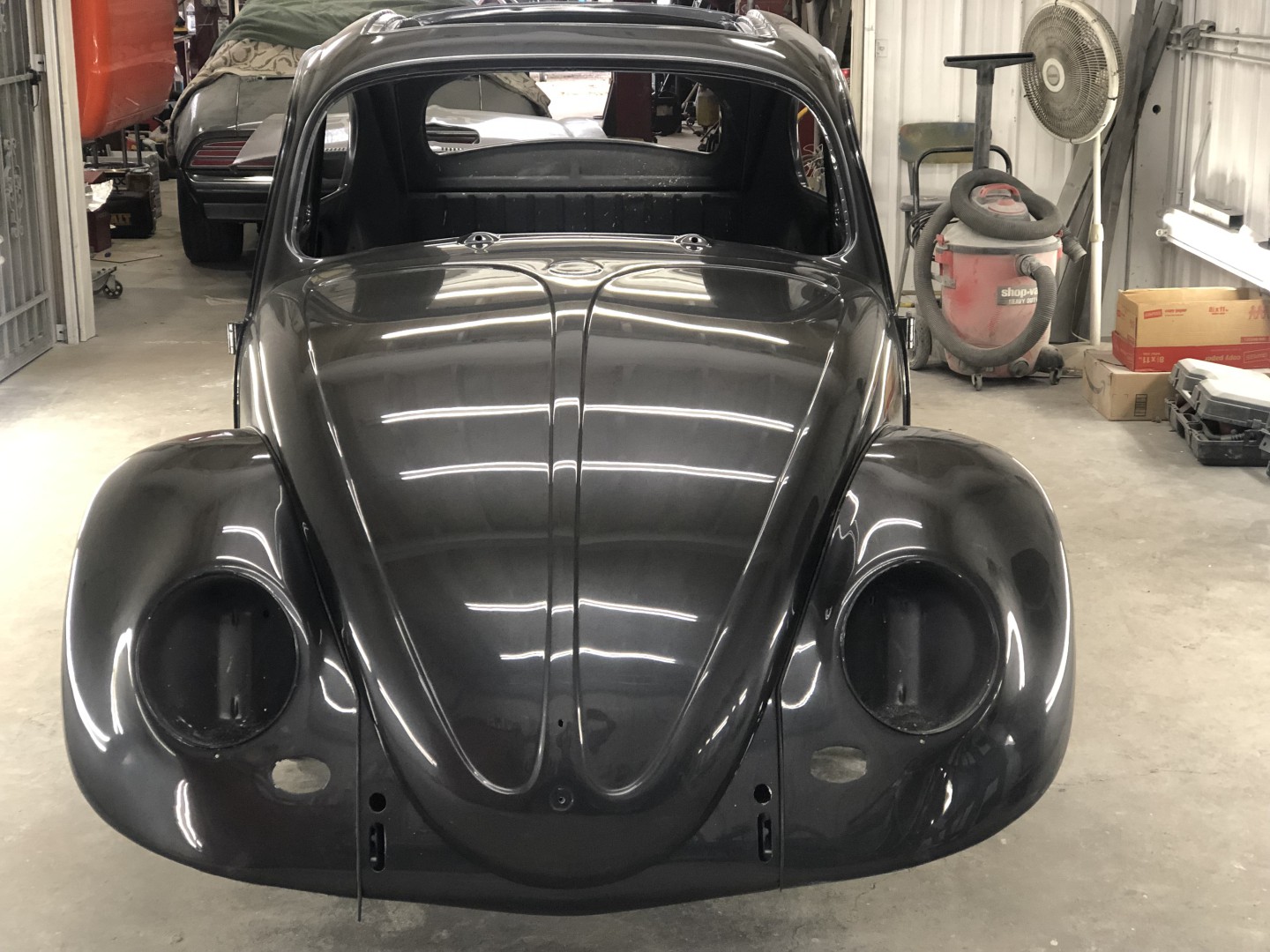

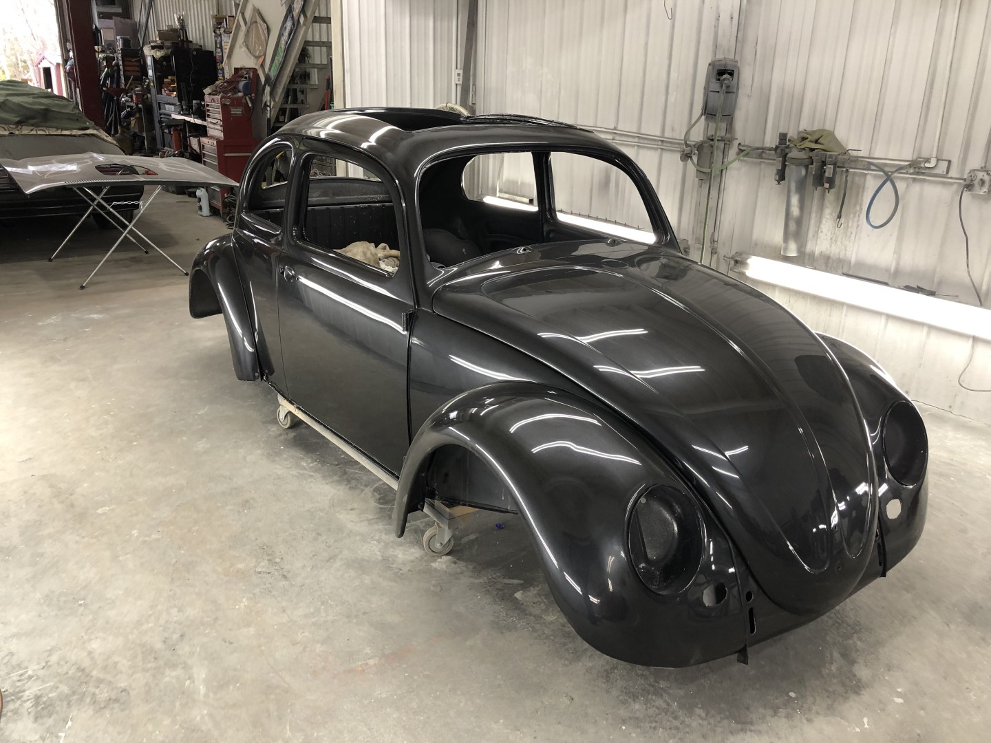

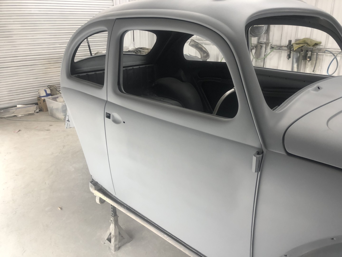

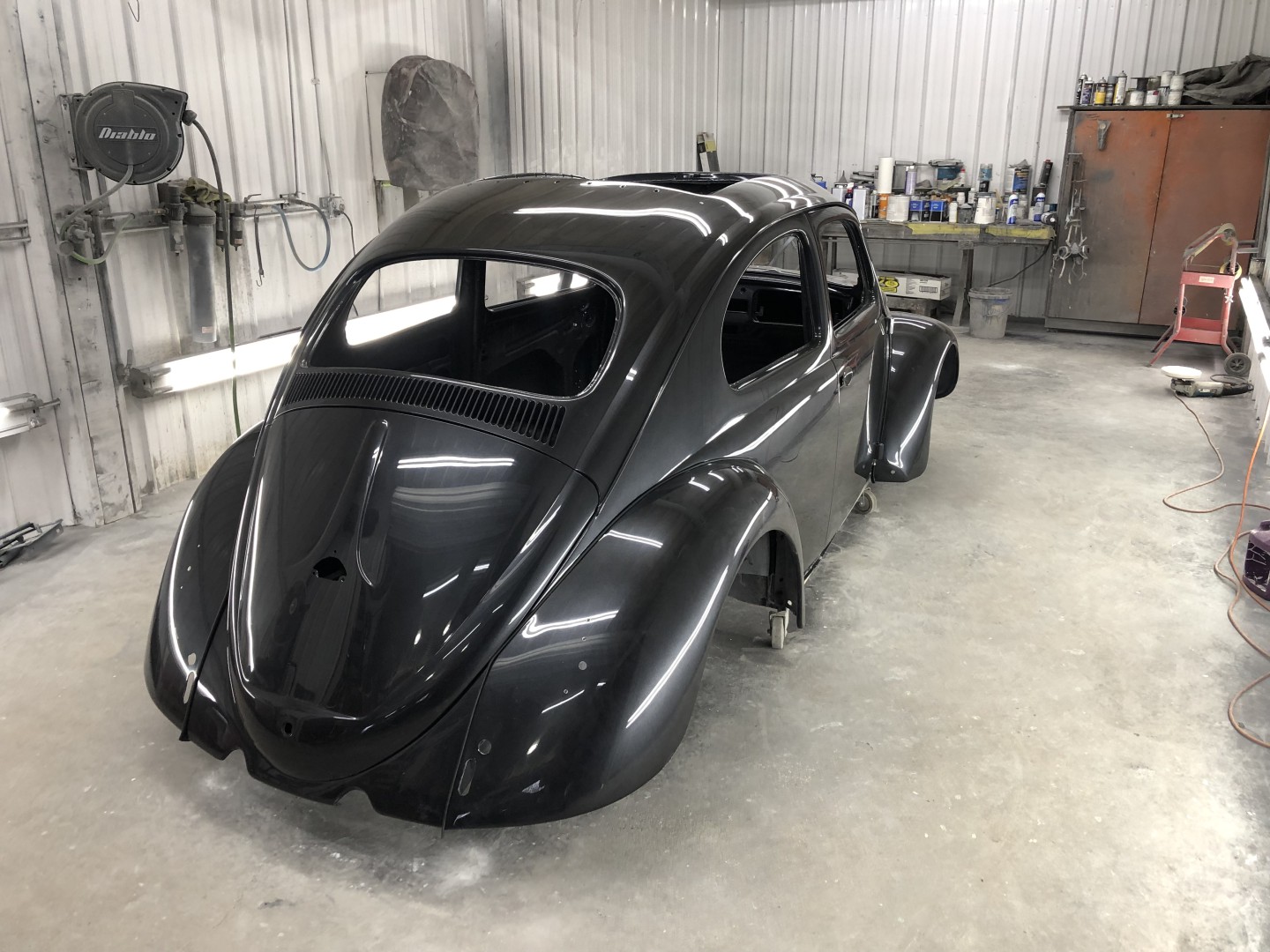

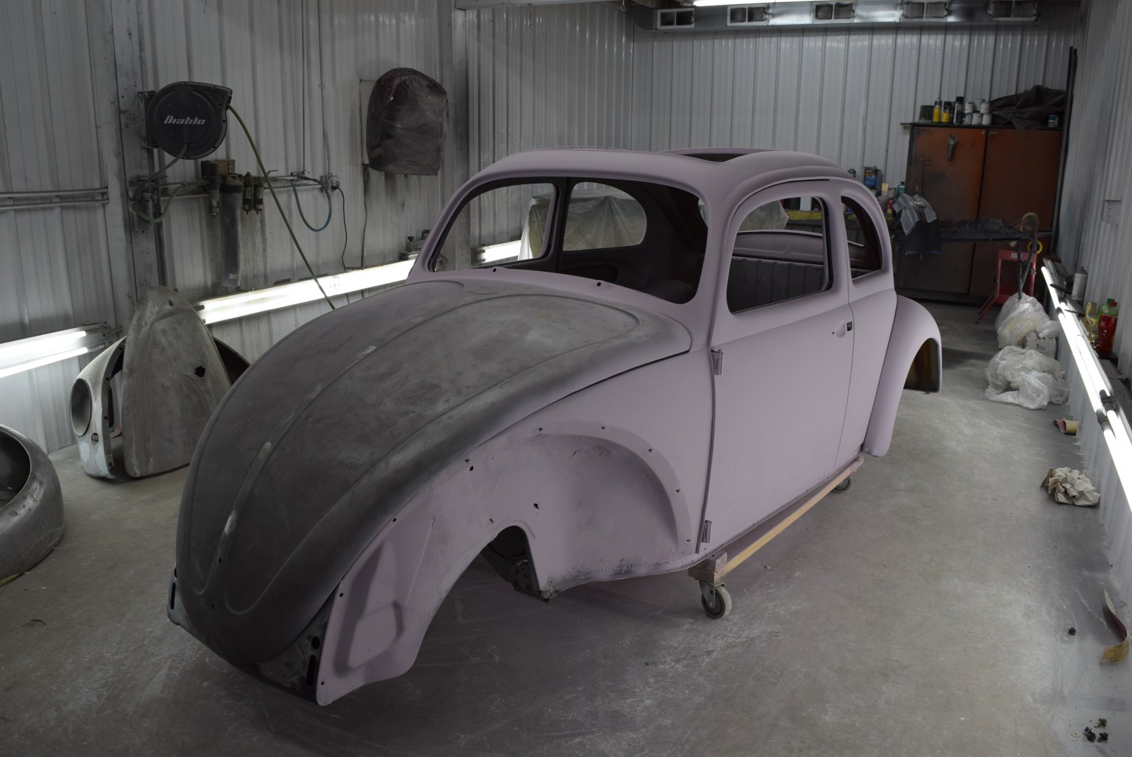

Just received these pics. It will be wet sanded tomorrow.

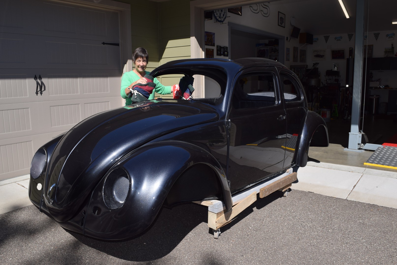

Will be picking it up next Saturday. Woohoo!

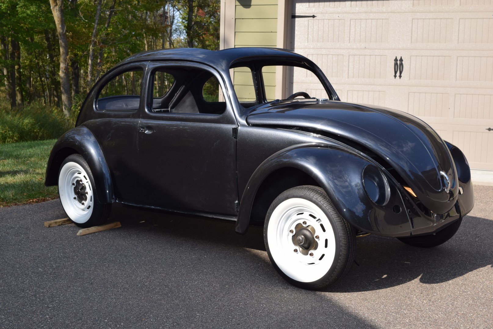

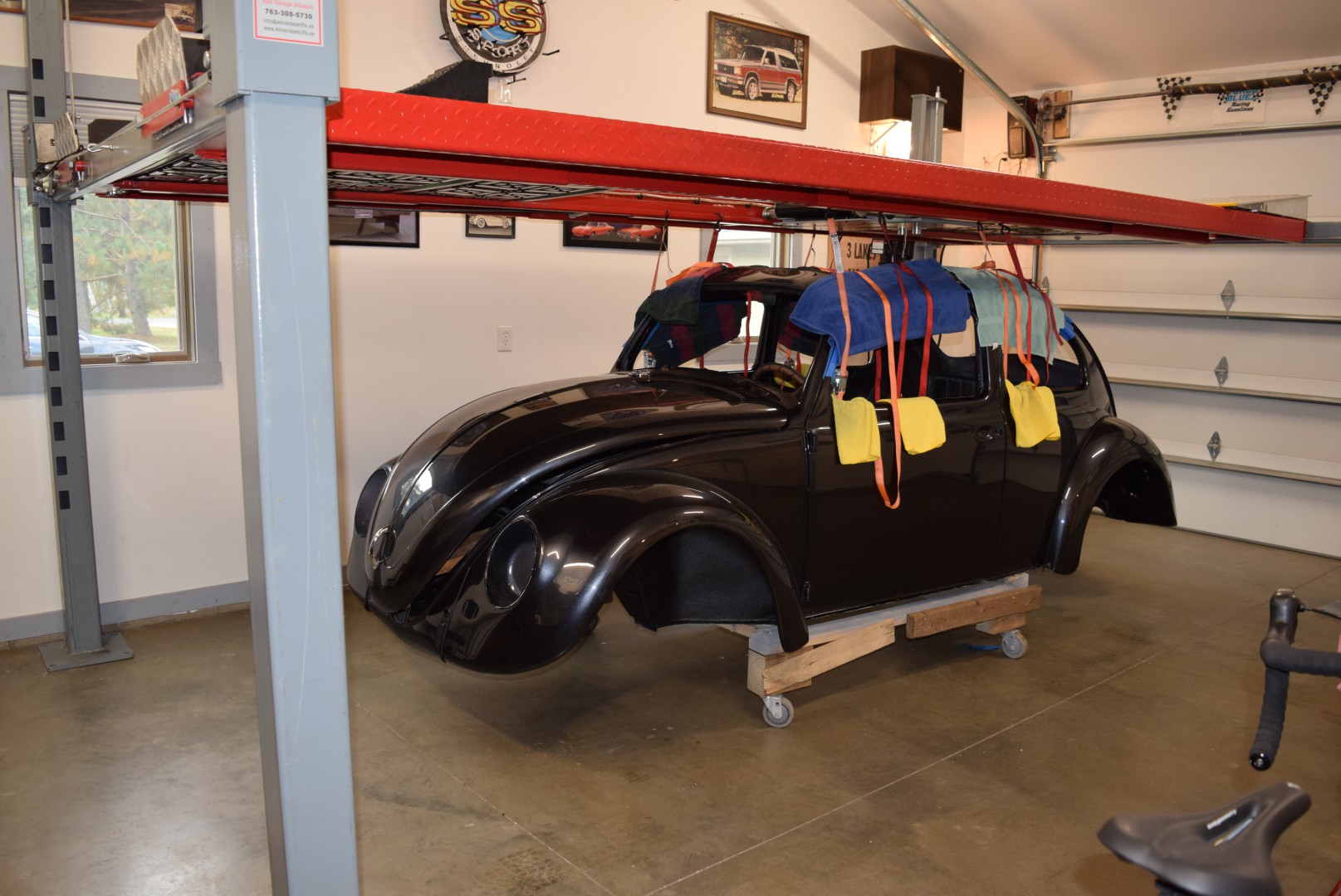

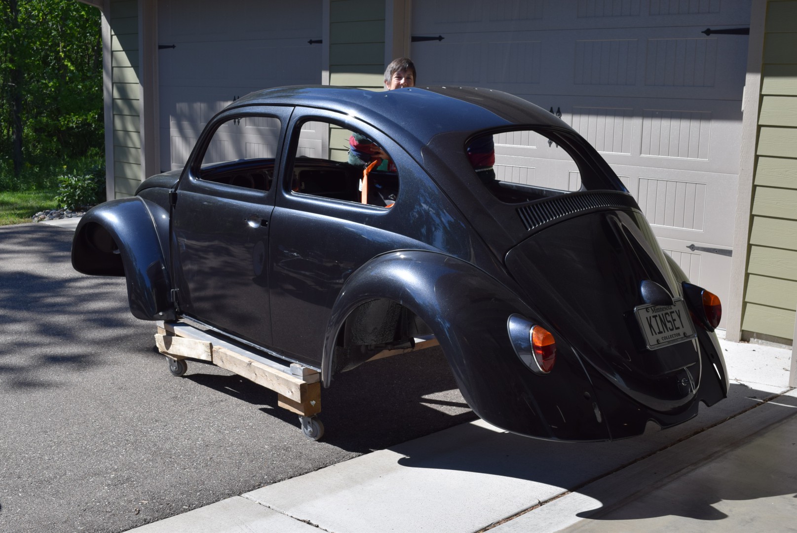

It has been a bit since I posted an update last.
The body came home from the body shop the end of April, beginning of May. We had many things planned the summer, so the body has just sat.
Last weekend I:
This weekend:
I am down to a couple of items and then the body can be put back on the chassis. Hopefully will be doing that in September.

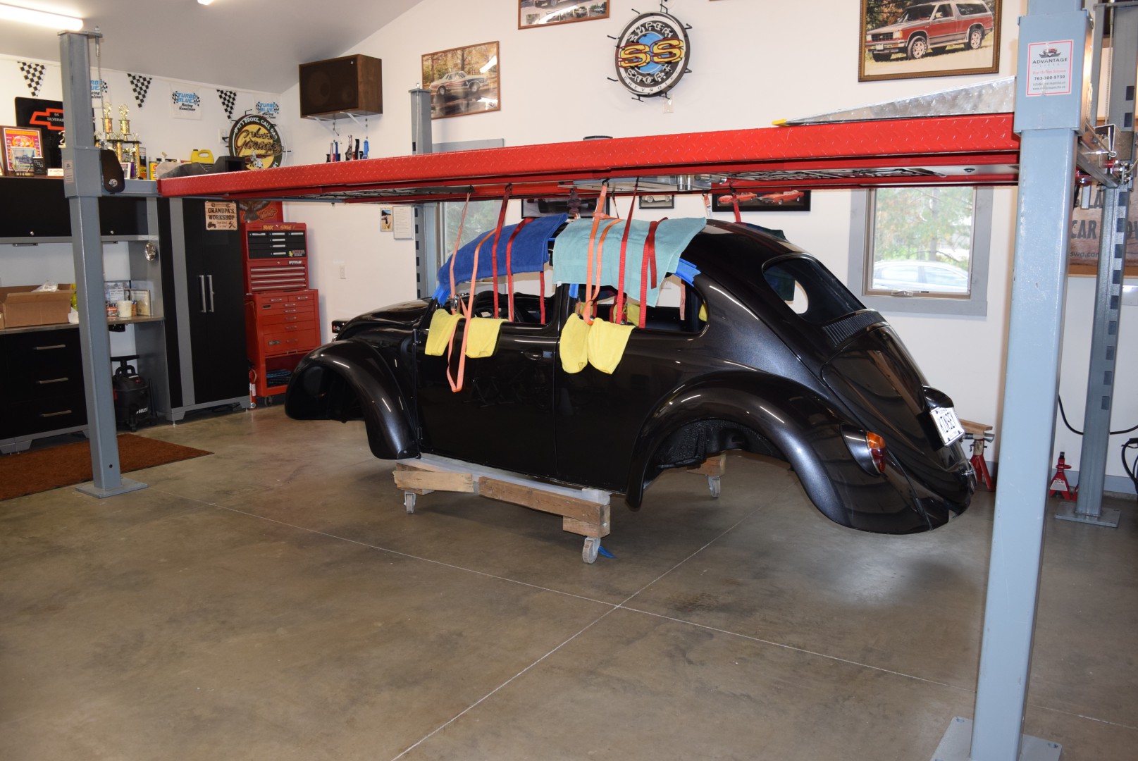

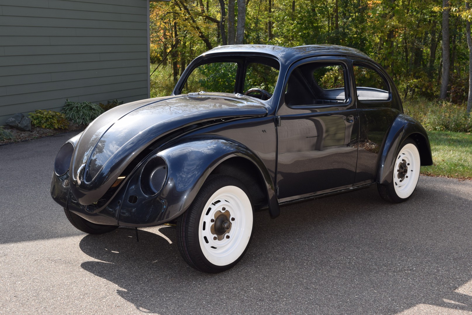

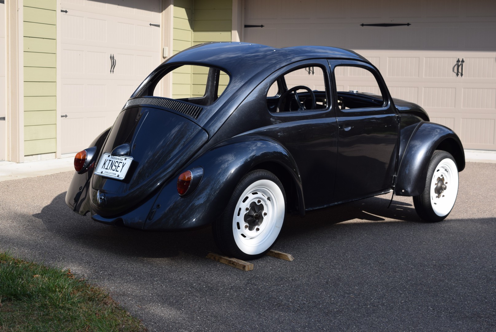

Looks great !

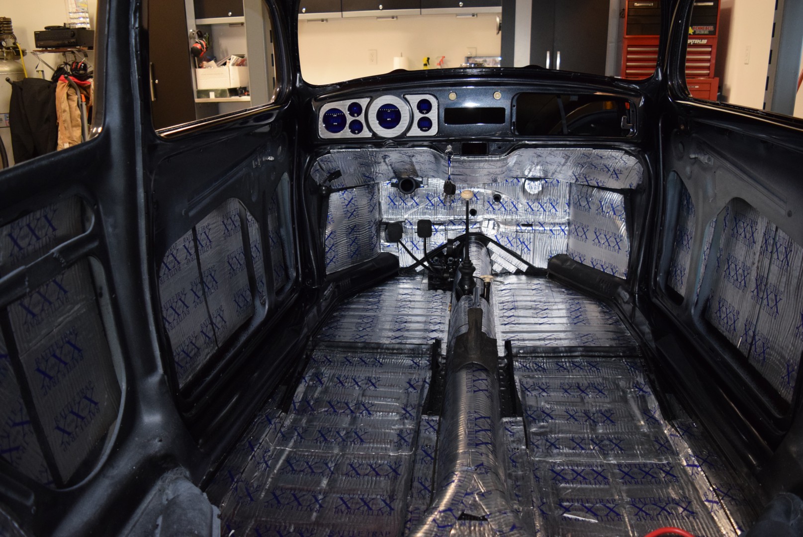

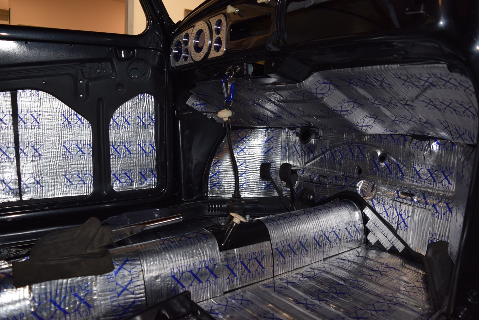

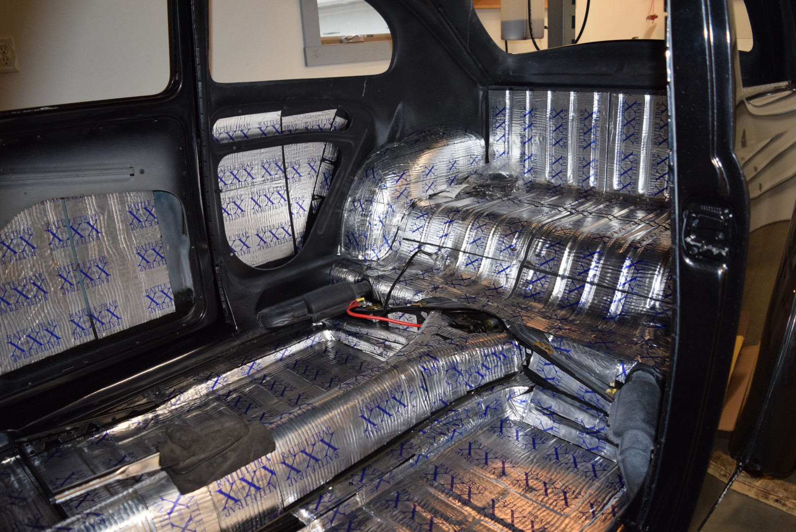

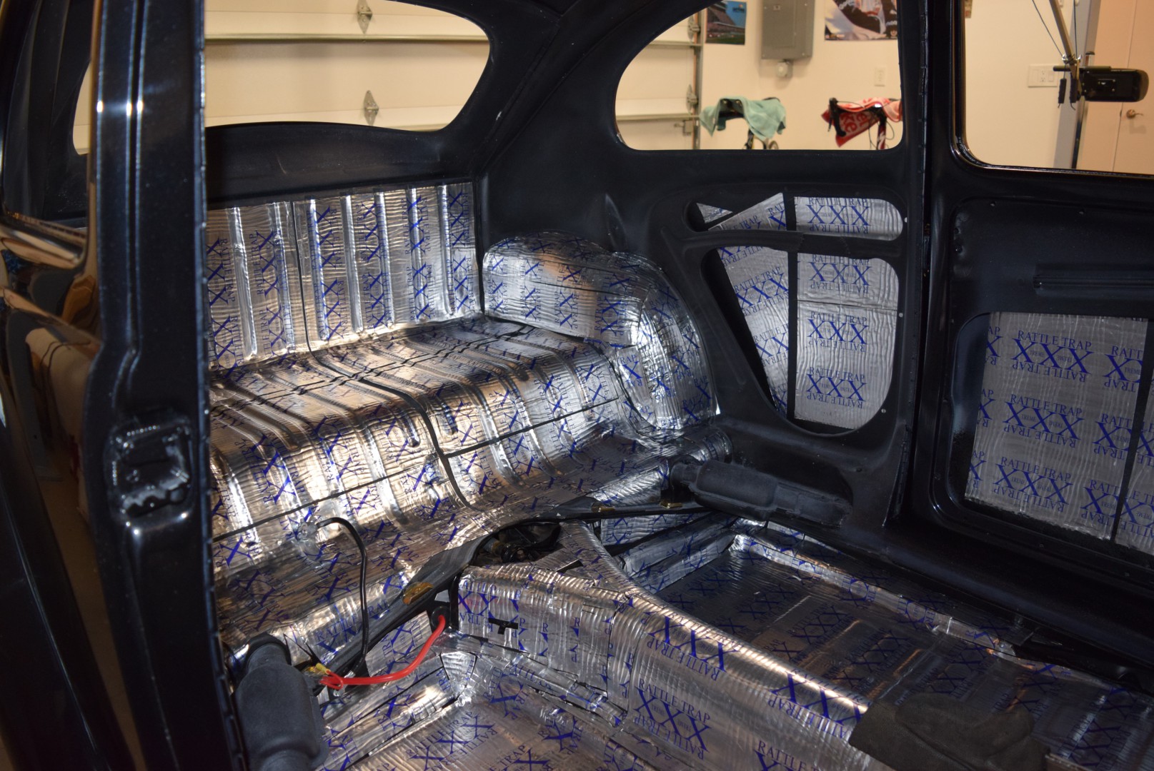

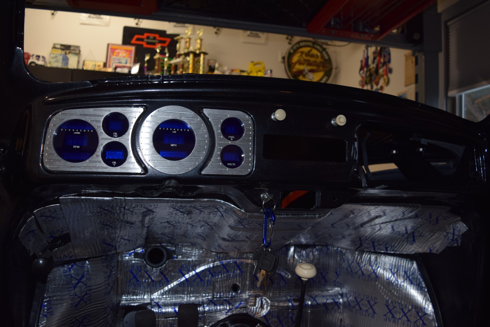

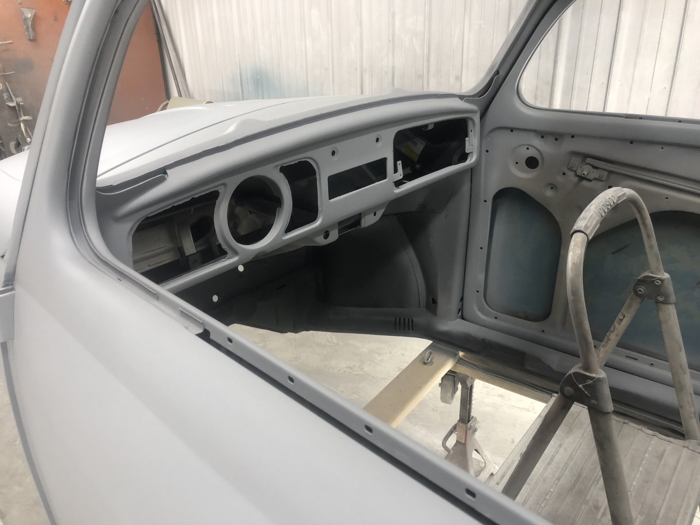

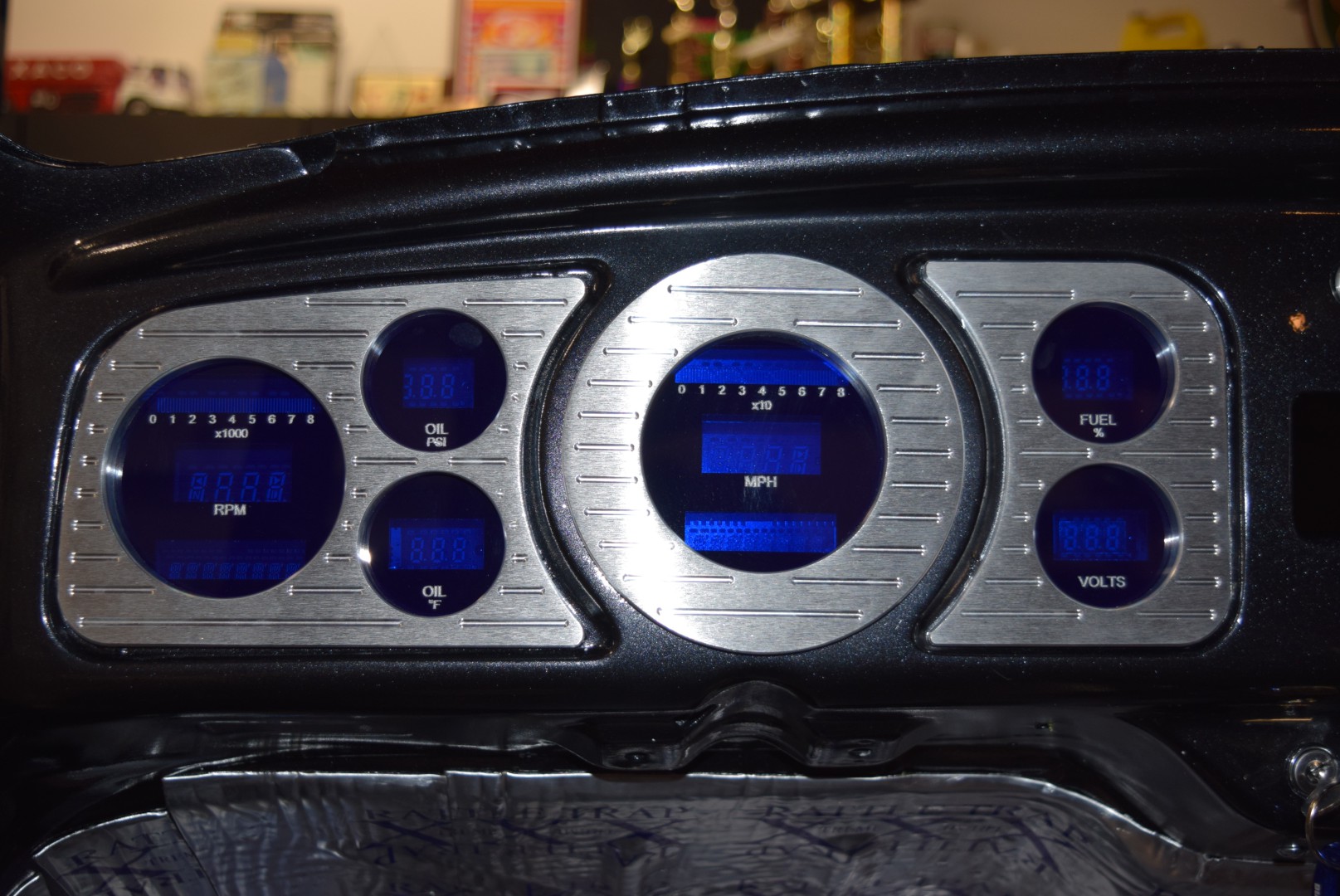

Sound deadening and Dakota Dash installed
Very fancy instrument panel...
