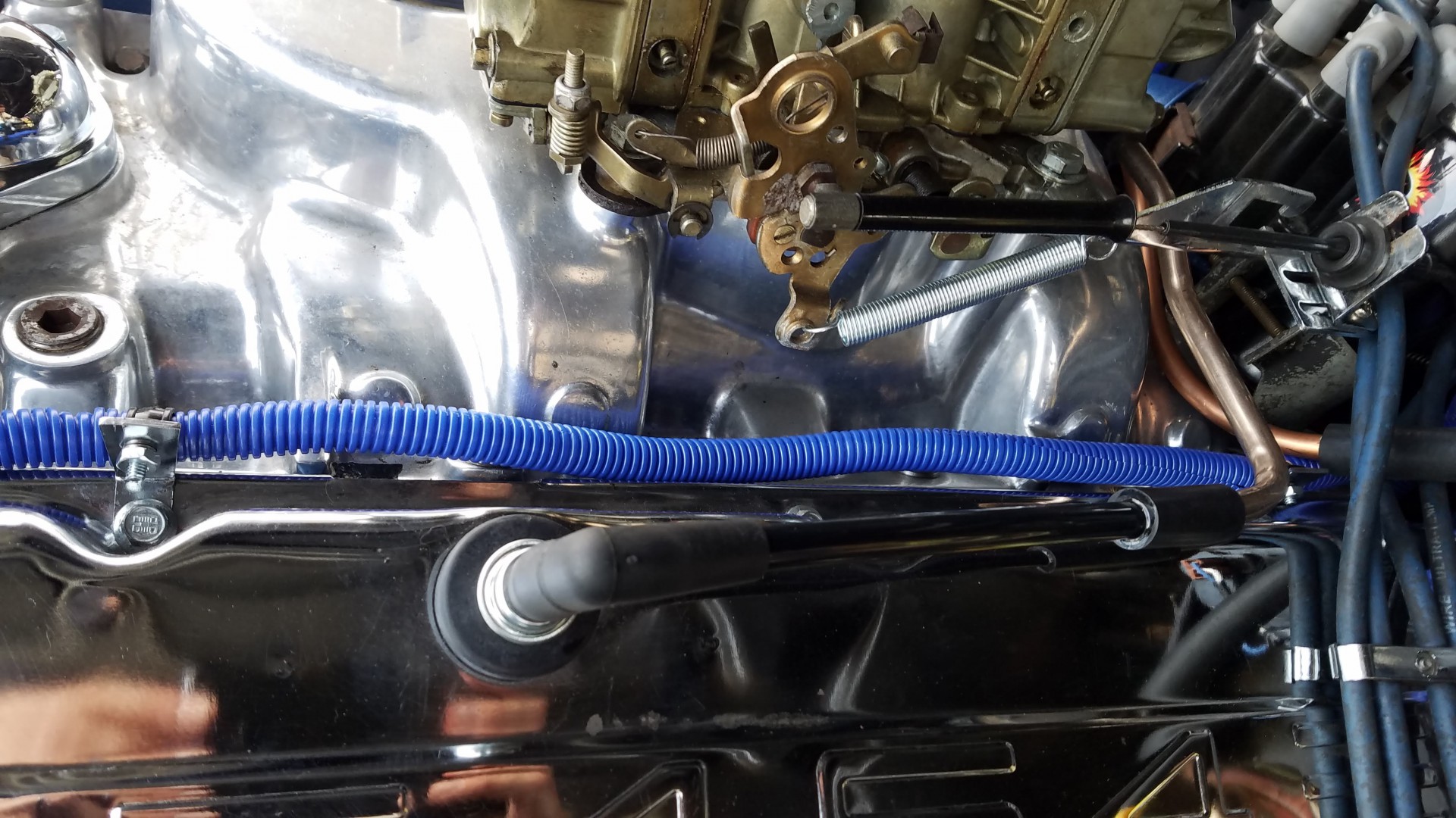

The wiring in the engine bay looks flawless - Hank routed the front light wires through the driver fender and under the radiator support - very clean looking.
We created the custom wire support brackets and installed on the valve covers and on the bell housing. We then ran the wires to the temperature sensor and Hank finished the wiring to the passenger side of the engine bay. He also left the wiring for possible future projects including an electric fan and A/C. Light bulbs were replaced and the front half of the car was working and the engine running.

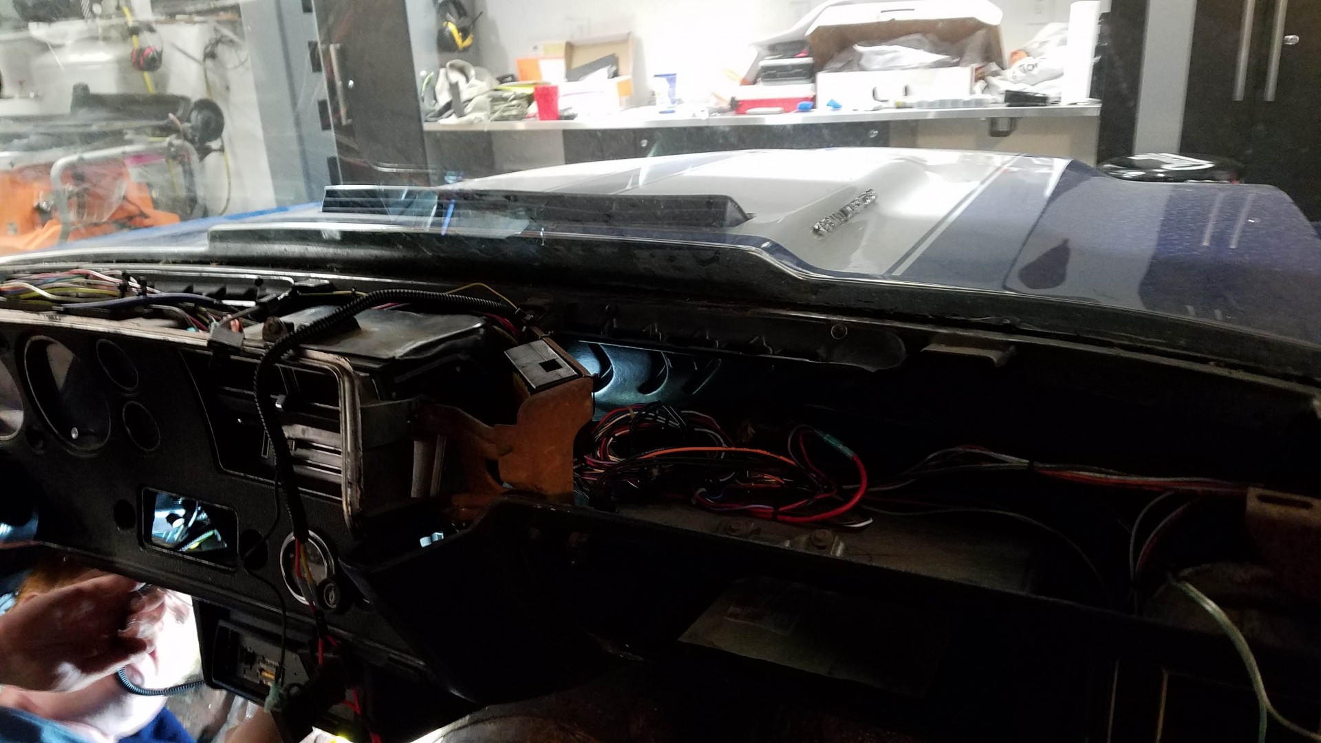

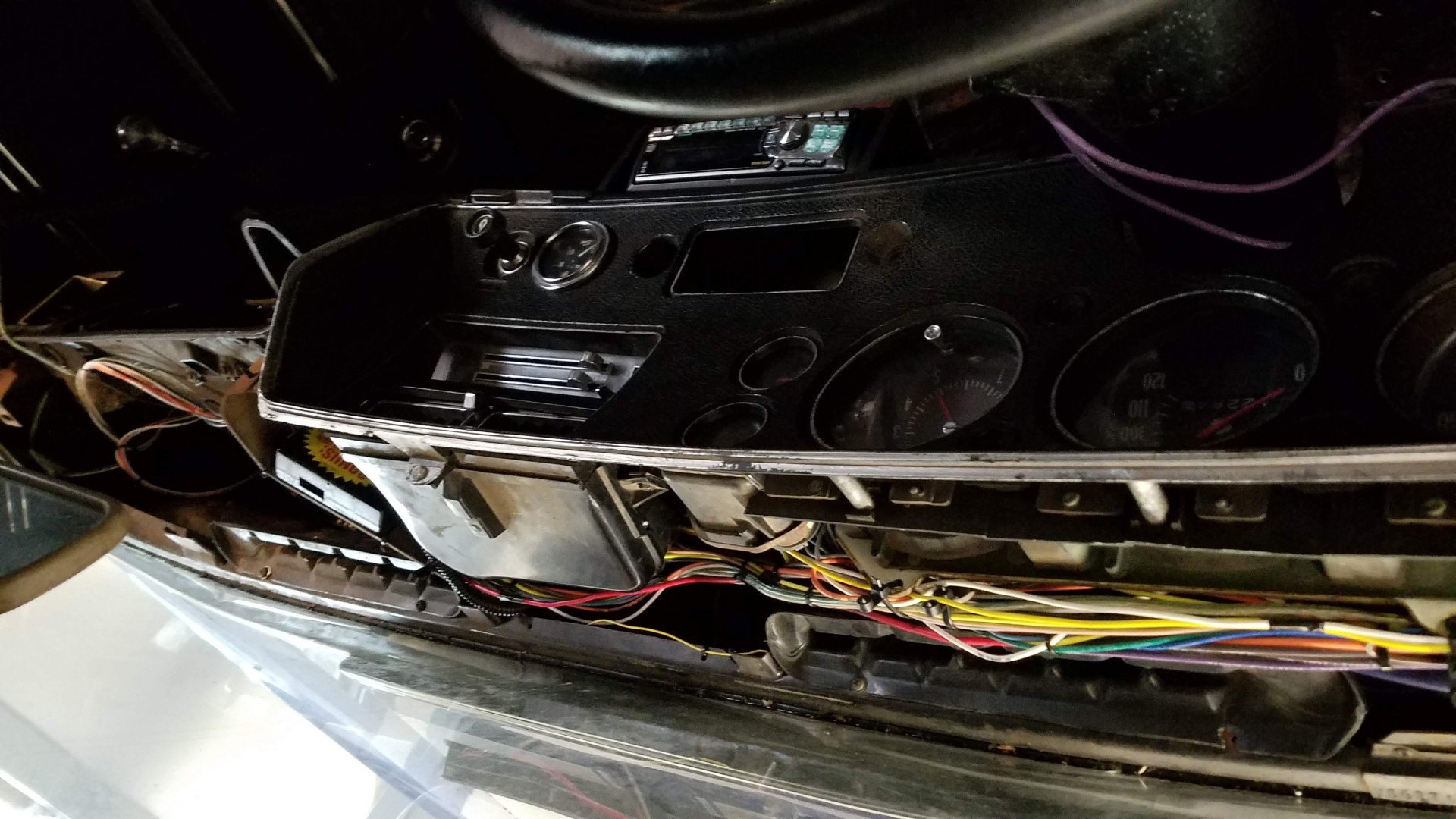

We removed the old radio and had to deal with my aftermarket radio (which has a splitter for 4 speakers up front, wiring for an Amp, and wires for the rear 6x9s). Hank upgraded the system to have connectors to make removing the dash much easier in the future.
My car also has power door locks and Hank found a nice new home under the dash for the control module.

Hank reviewed the schematic's and talked with American Autowire which made things go much more smoothly! Thanks to those that helped repair the dash wiring during the April tech session.

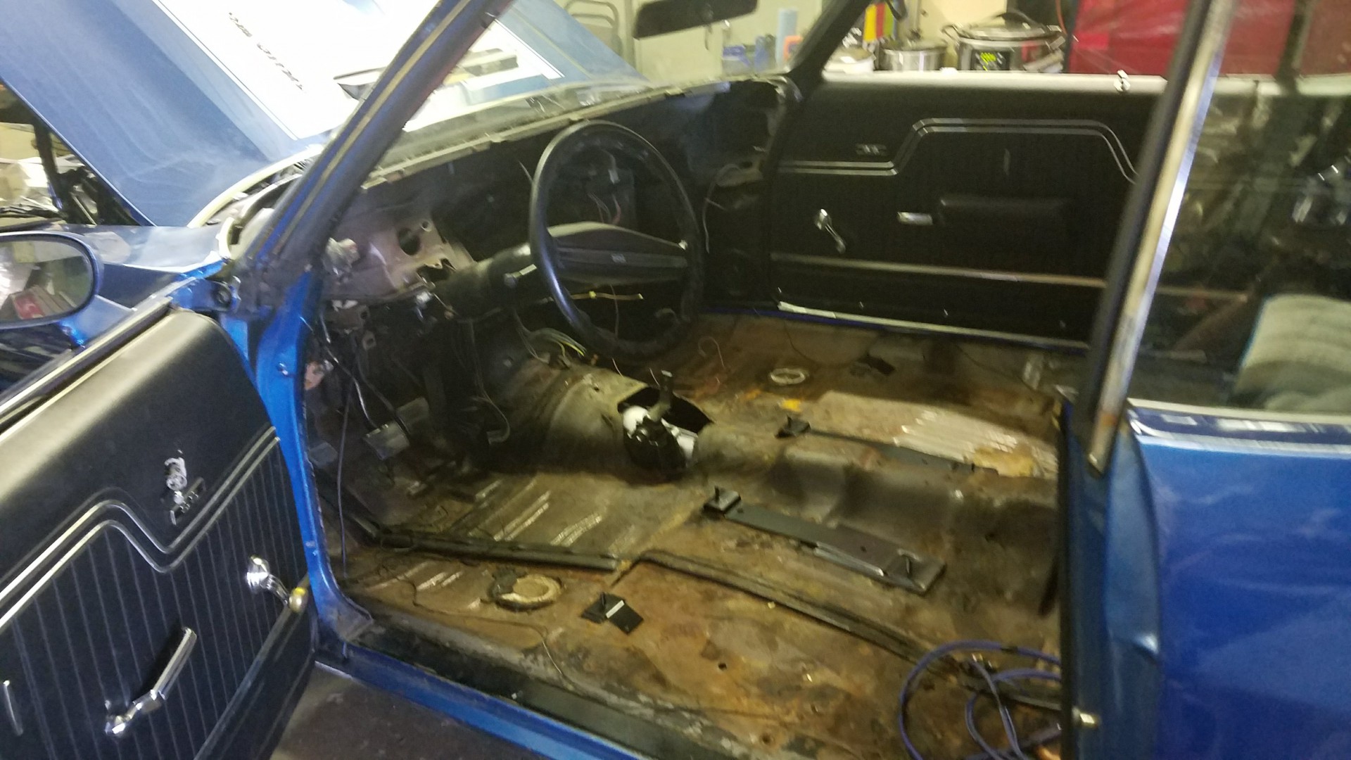

Yep, in 8 months it came from this...
This was incredibly fun to drive home.

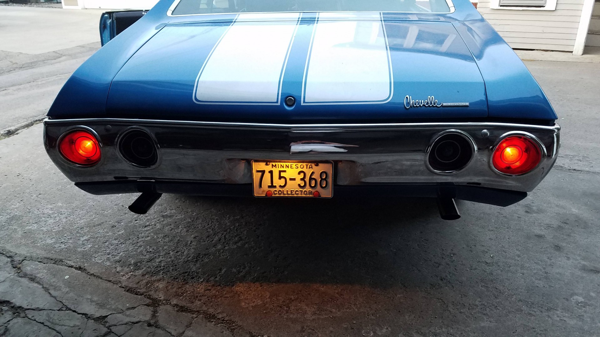

We worked on the rear lights and most of the bumper bolts broke free without much pain. But of course there was one bolt that required a trip to buy a Cut-off wheel. And same with the valence as one bolt was giving us grief.
Hank had to finagle the gas tank to get the new wire installed.
All rear lights were connected and tested.

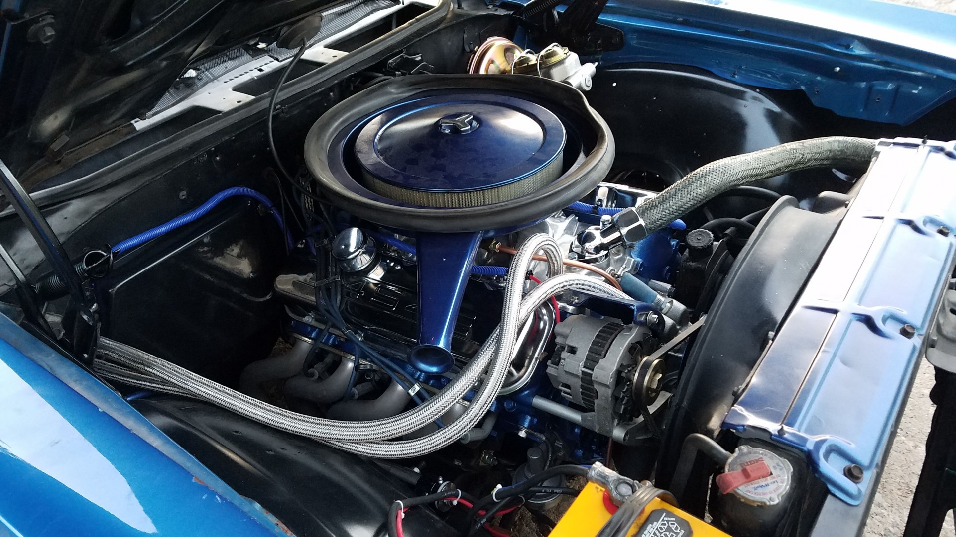

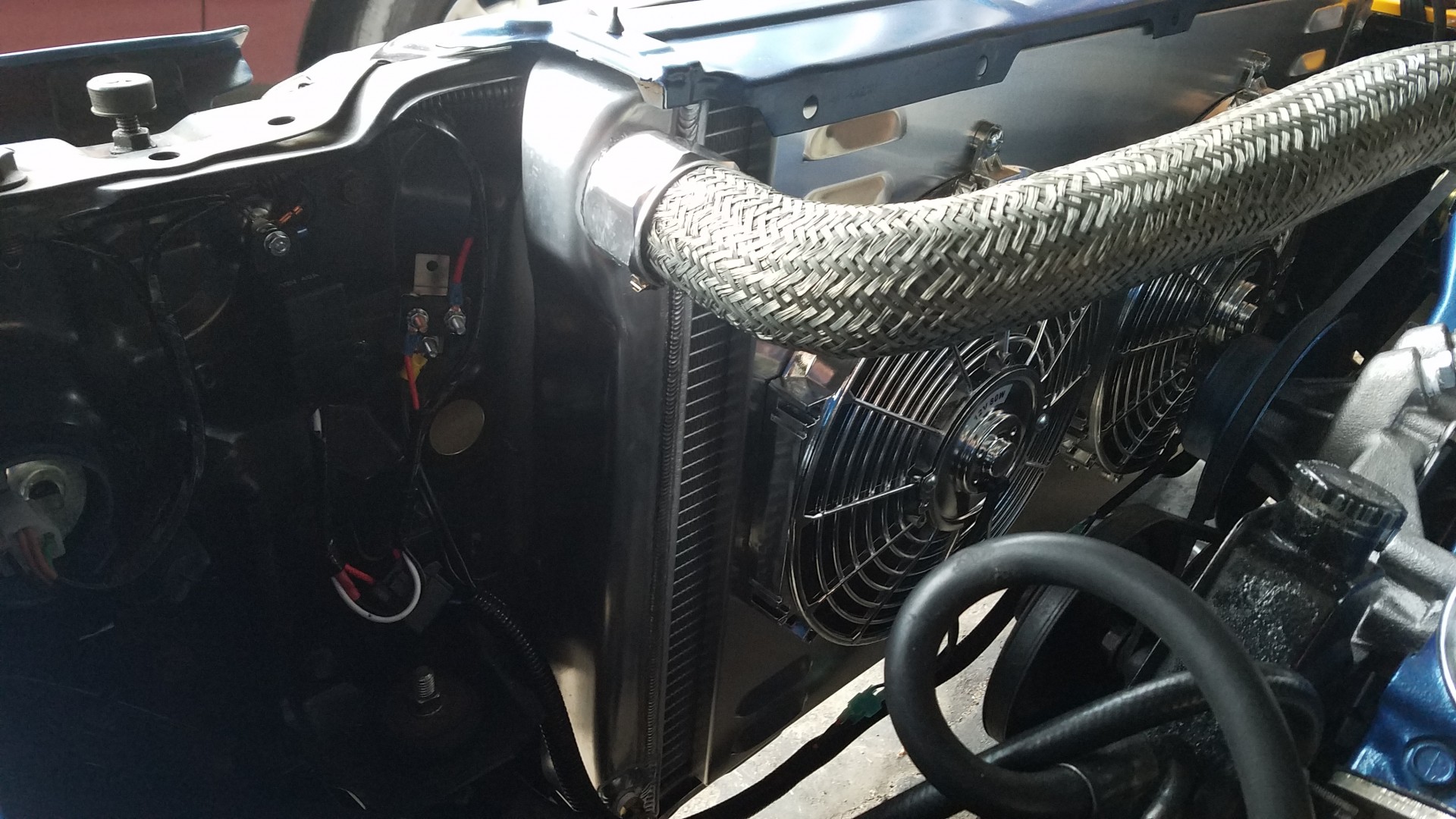

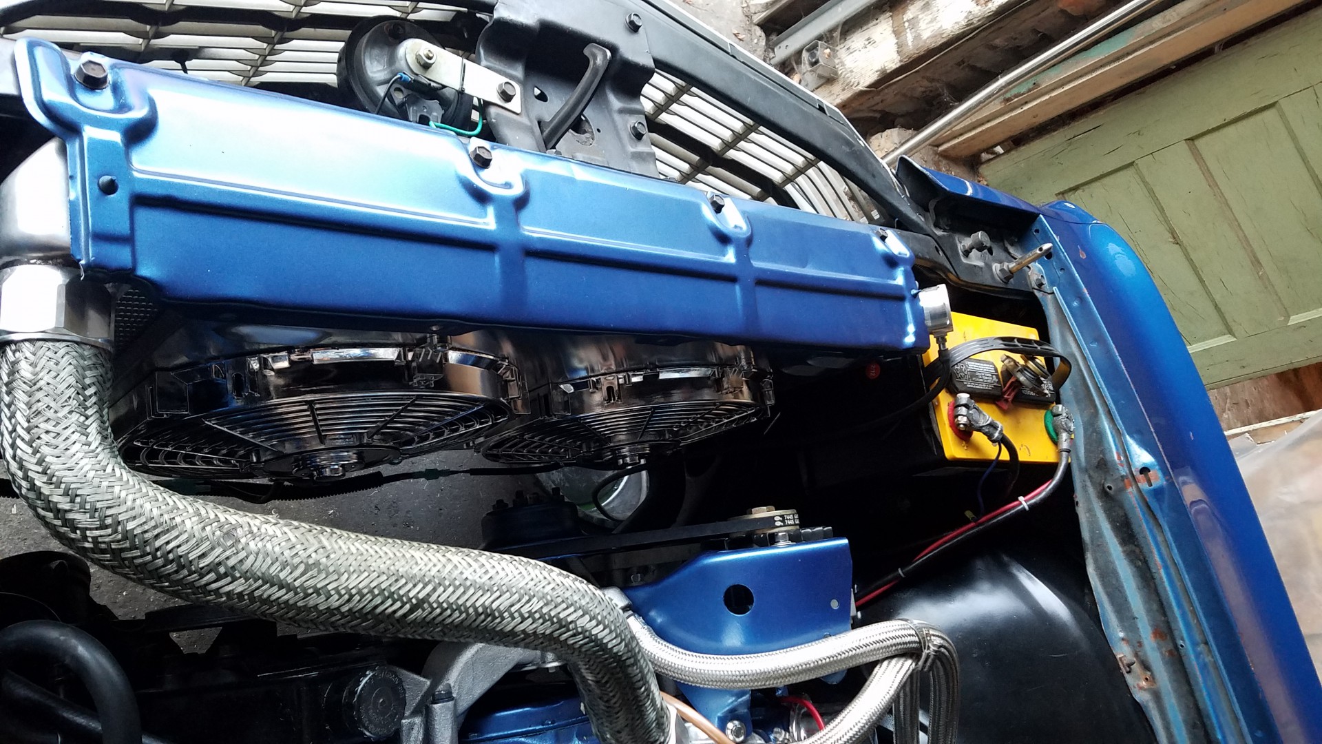

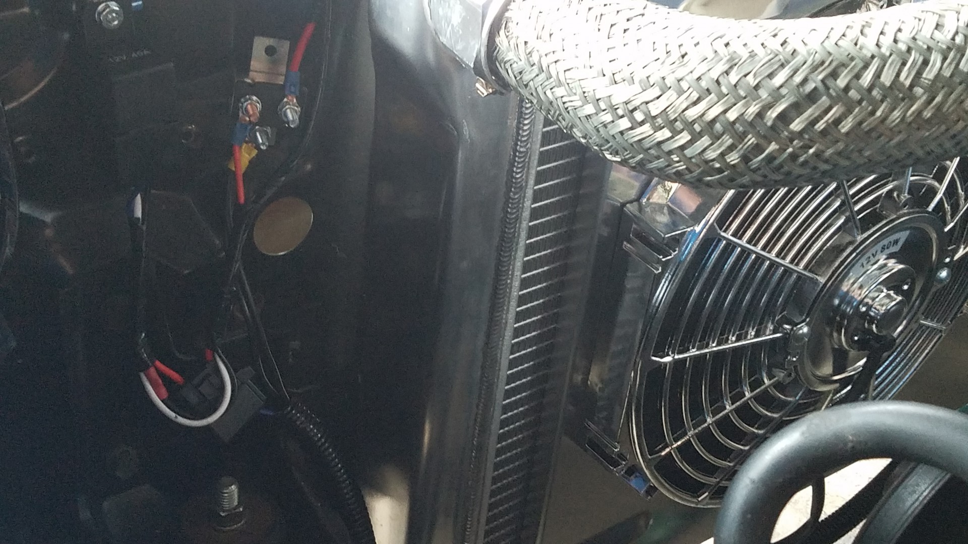

Hank stopped over Sunday to help me wire and drop-in the new radiator and fan.
I'll add more detail soon.
