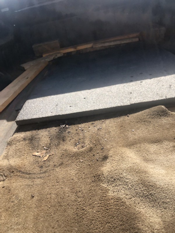

I guess I was just a little unclear. I was talking about that piece of vinyl that goes between the top and trunk that'd keeps to top out of the trunk, unless yours is somewhat different. How did you keep it up out of the way when you were painting the inside of the trunk or did you remove that piece? There appear to be some screws holding mine on. I was thinking about removing it when I finish the paint with the zolatone this fall.
May 26, 2020
Jim, that is the well liner.
I can't find any clear instructions on install, but appears it may be stapled with stainless staples...
Jim, if I recall I used wood slats and gaffers tape to hold it up.

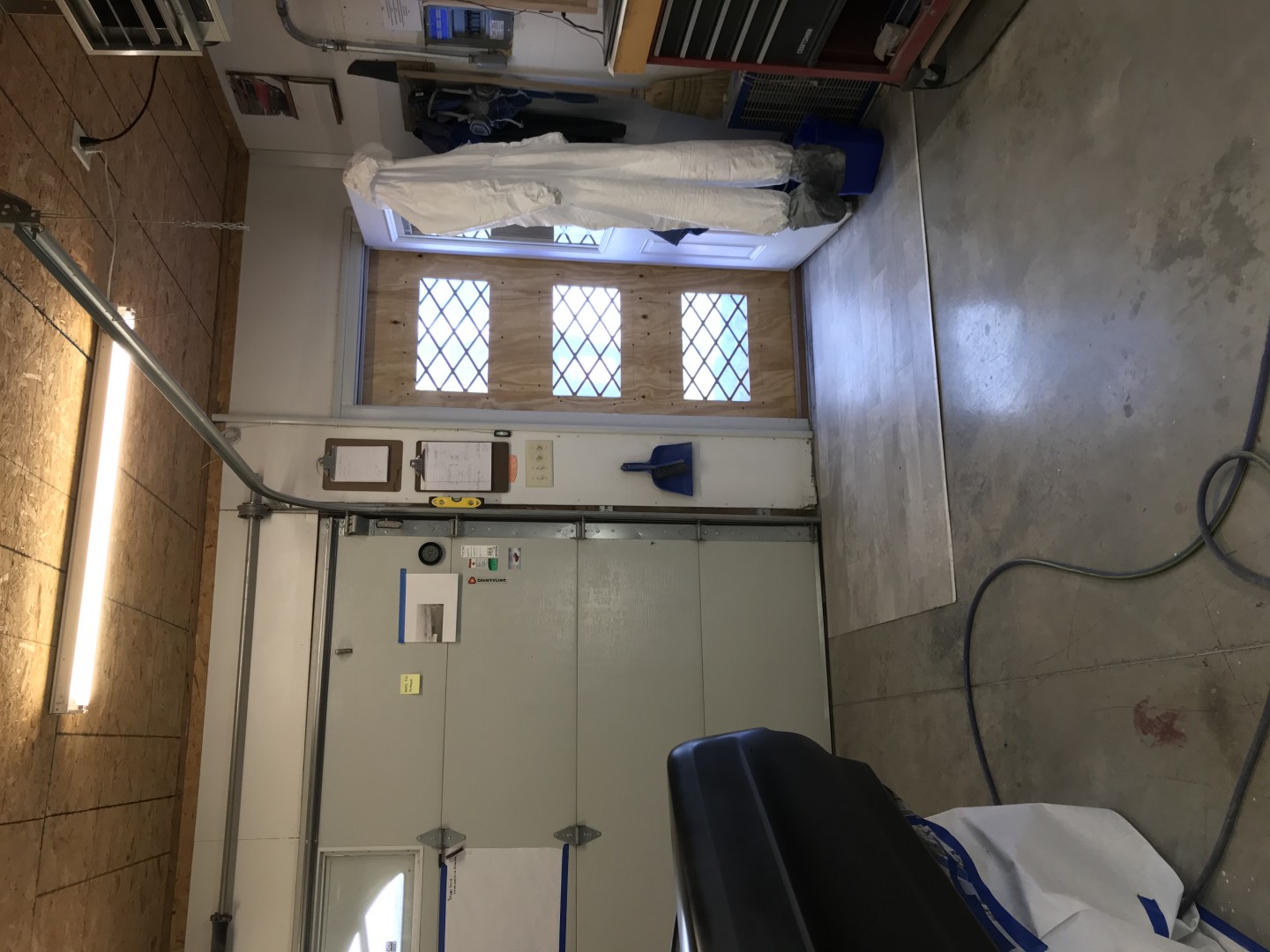

I also like the punch list taped to the garage door. Great tip as we get older and forget what we did/didn't finish!

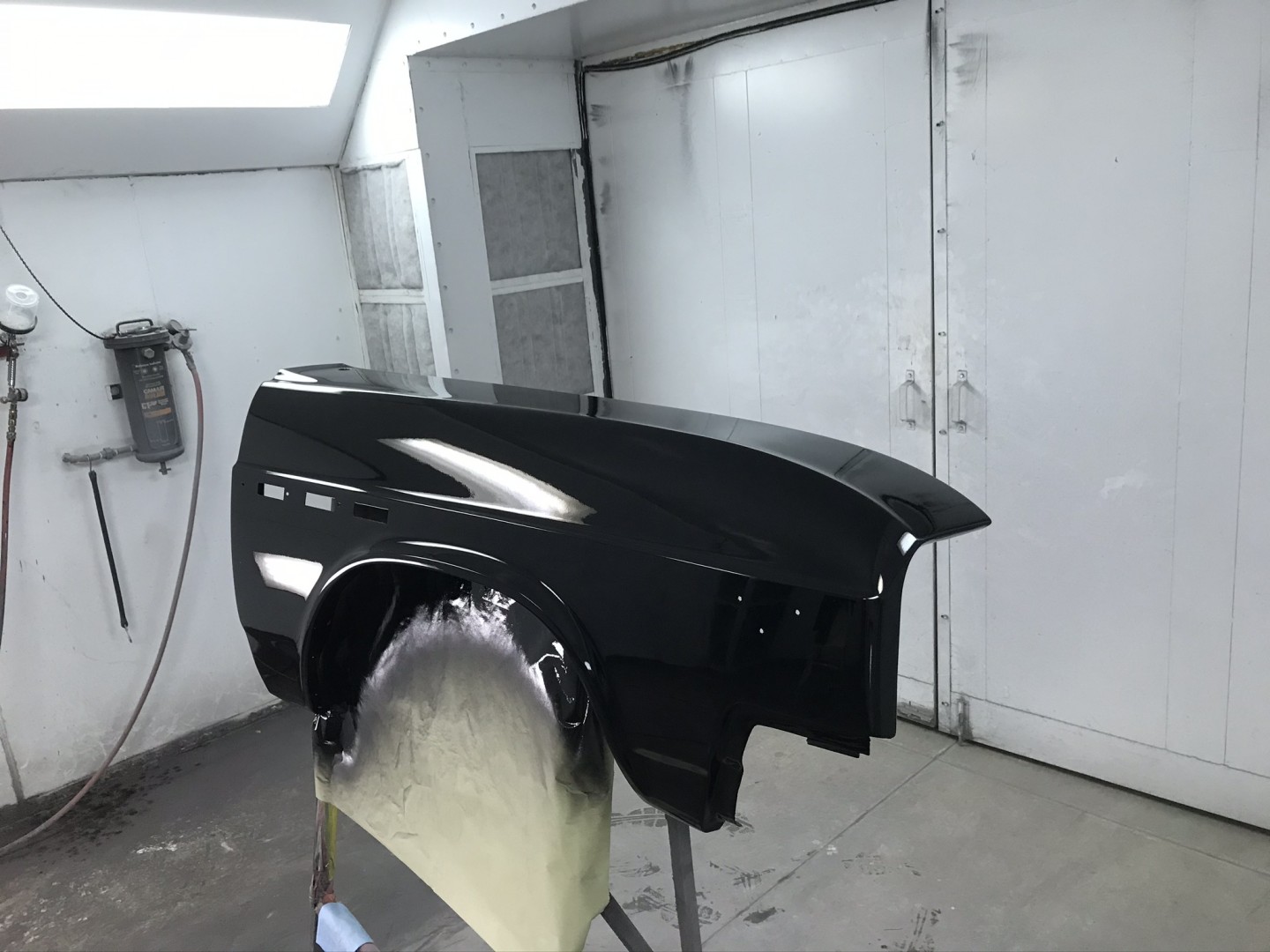

Thanks guys. Jim my short career as an automotive body and paint cosmetologist will end as soon as the buffing pad stops turning and last piece of chrome is installed.

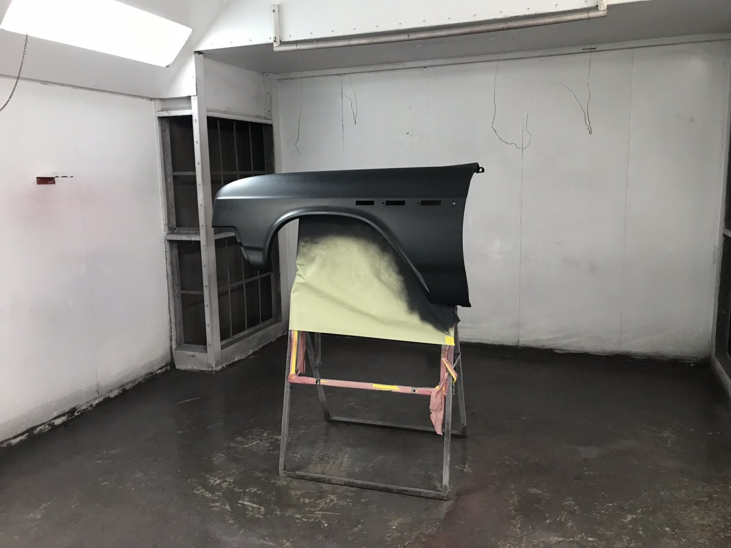

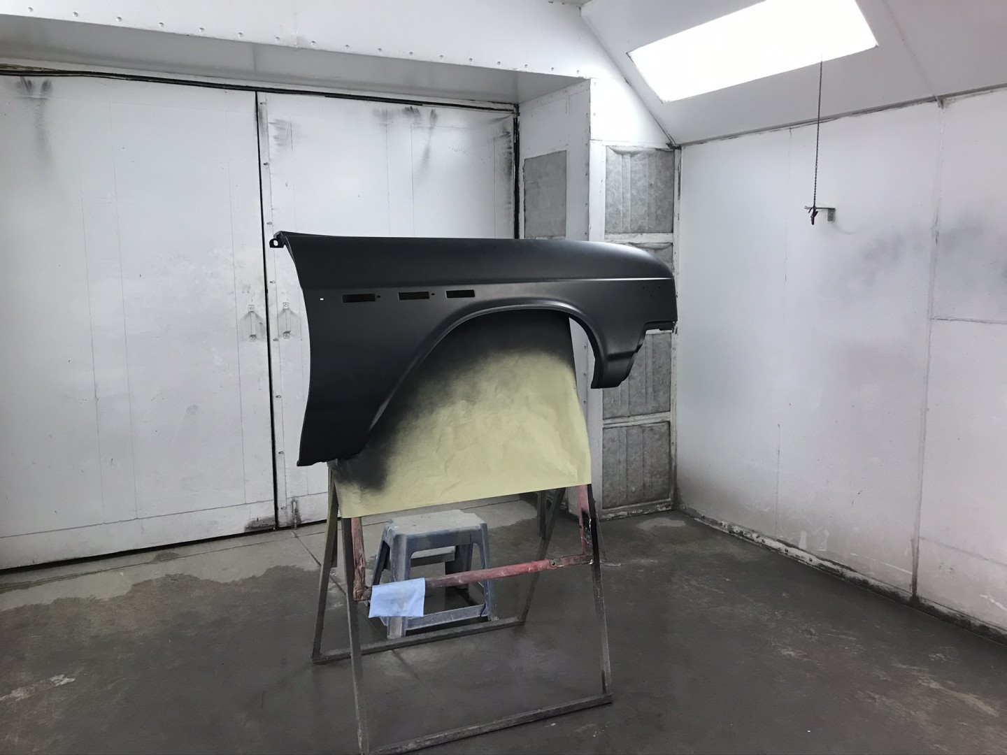

I now have a spare 65 Skylark fender, I’m taking it through every step in the process from blasting, filler, block sanding, paint to cut and buff. It’s my training aid, once satisfied I can achieve a satisfactory final finish. All my auto body tools will be available on Craigs list.

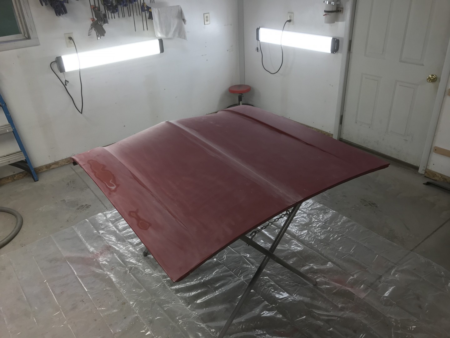

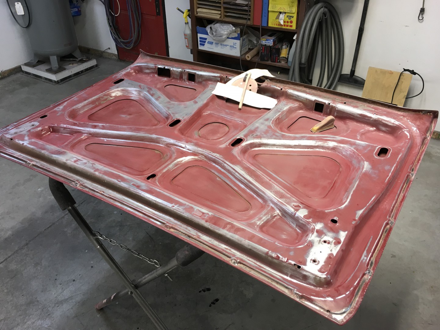

I’m now three days into hood and trunk lid prep. Just when I thought I was home free.. The underside of the hood and trunk lid are taking many more man hours that the tops. And of course its all hand or finger sanding, darn battery tenders.

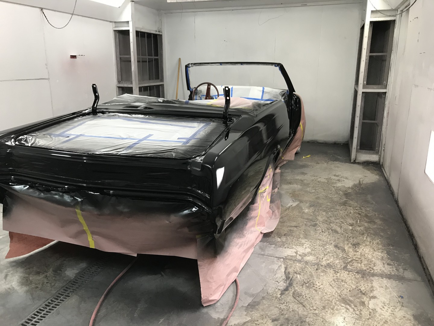

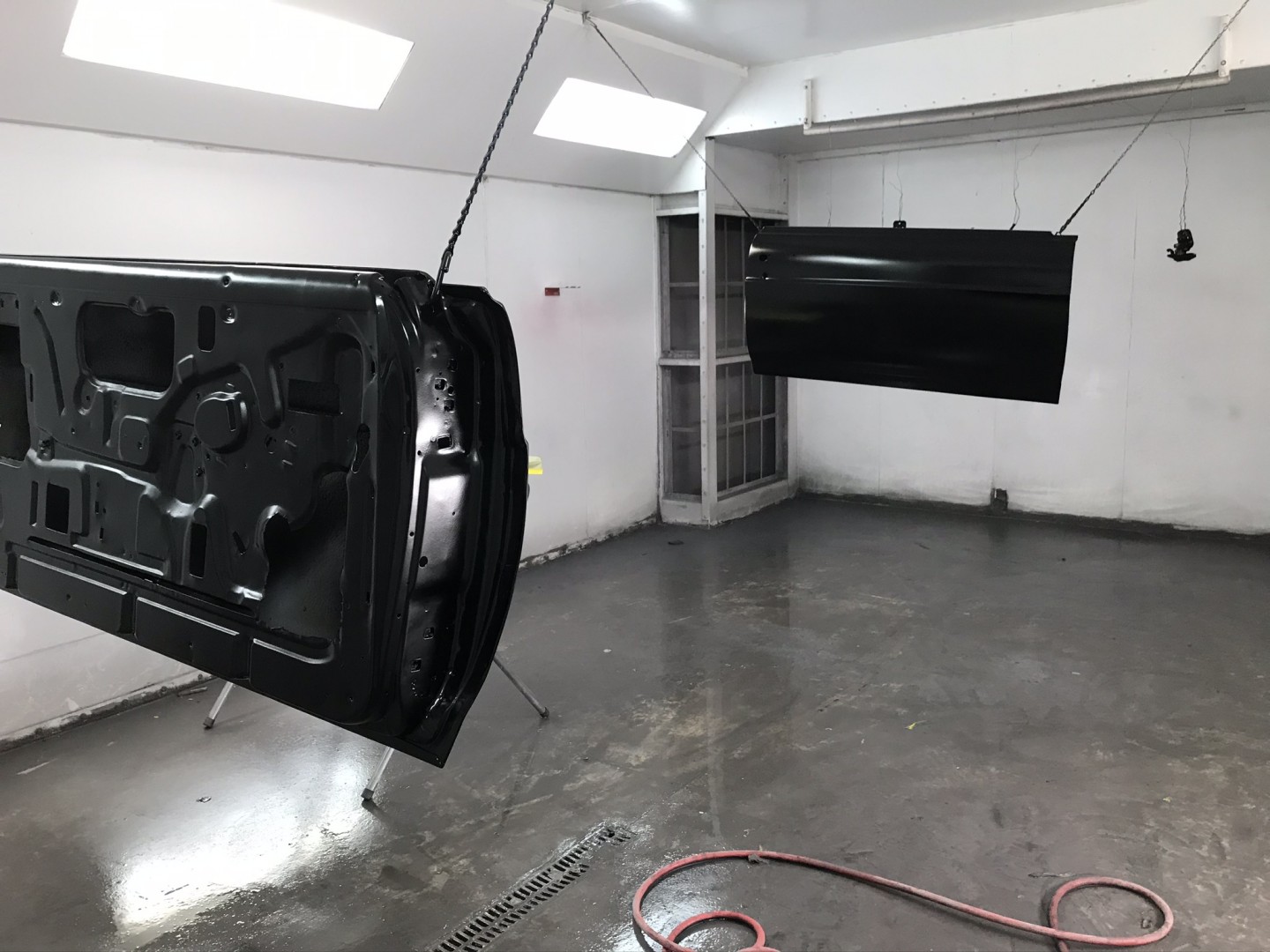

Using a buddy’s paint booth on an as available basis and receiving some excellent coaching and the use of a very sweet spray gun I’ve sprayed the my first paint; on my 70 birthday no less. I started out in the moon suit then quickly got comfortable. One coat of black primer, two coats of black base then four coats of clear Dupont (now different name) paint. Followed by sanding with 1500, 3000, 5000 then cut with Wizards Mistic Cut, recommended to avoid swirl marks in black paint and polished with 3M Perfect-it #3 polish. I couldn’t be more pleased and somewhat amazed with the finial result. I should be back on the project next week doing the fenders and hood. When done they’ll put in storage until the final drivetrain is decided and complete. Then the body and trunk will be done and mated together. The top and interior are on order, both black. Four to six weeks for the top and 12 to 14 weeks for the interior. So it looks like I may have winter project.

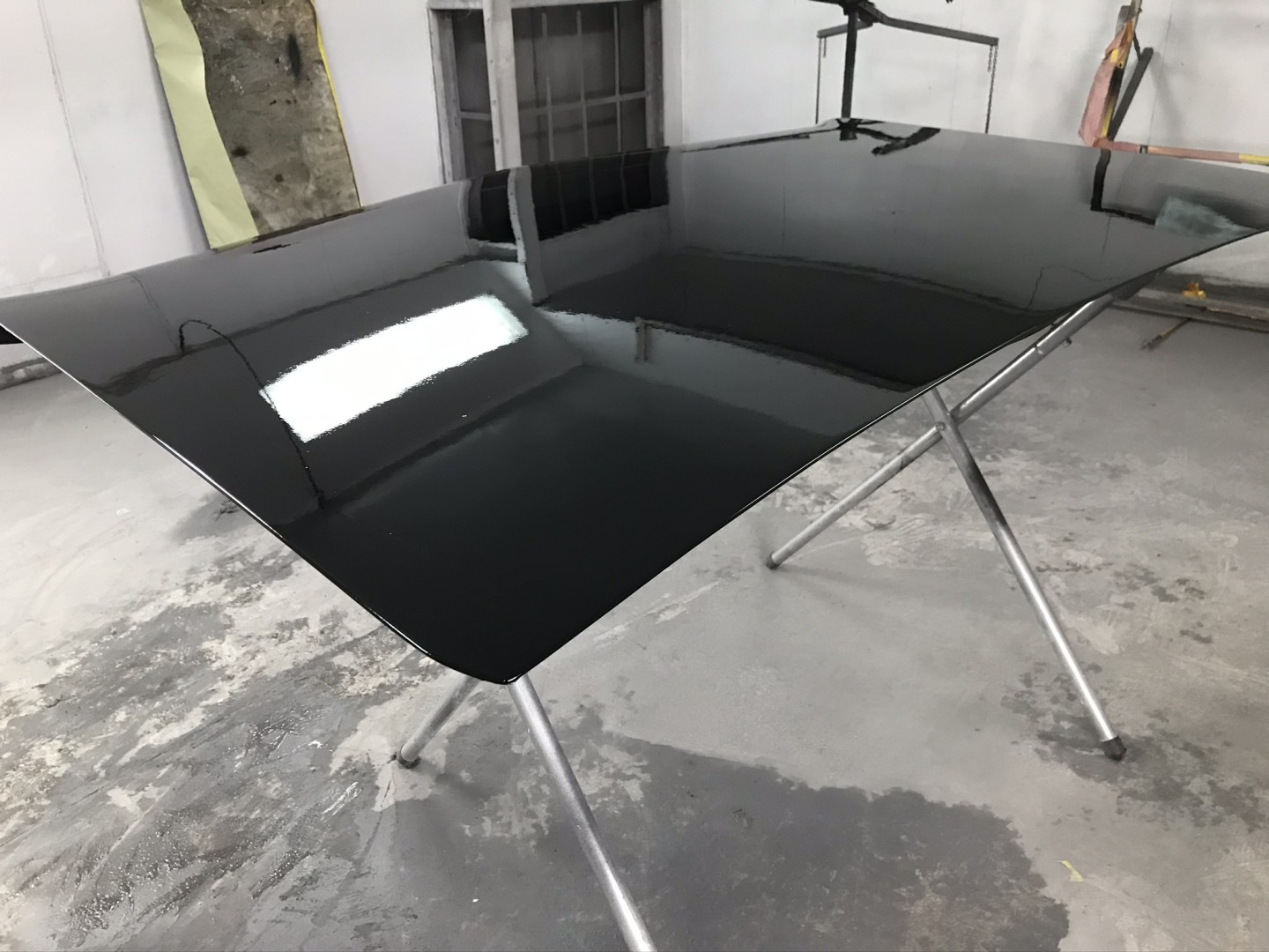

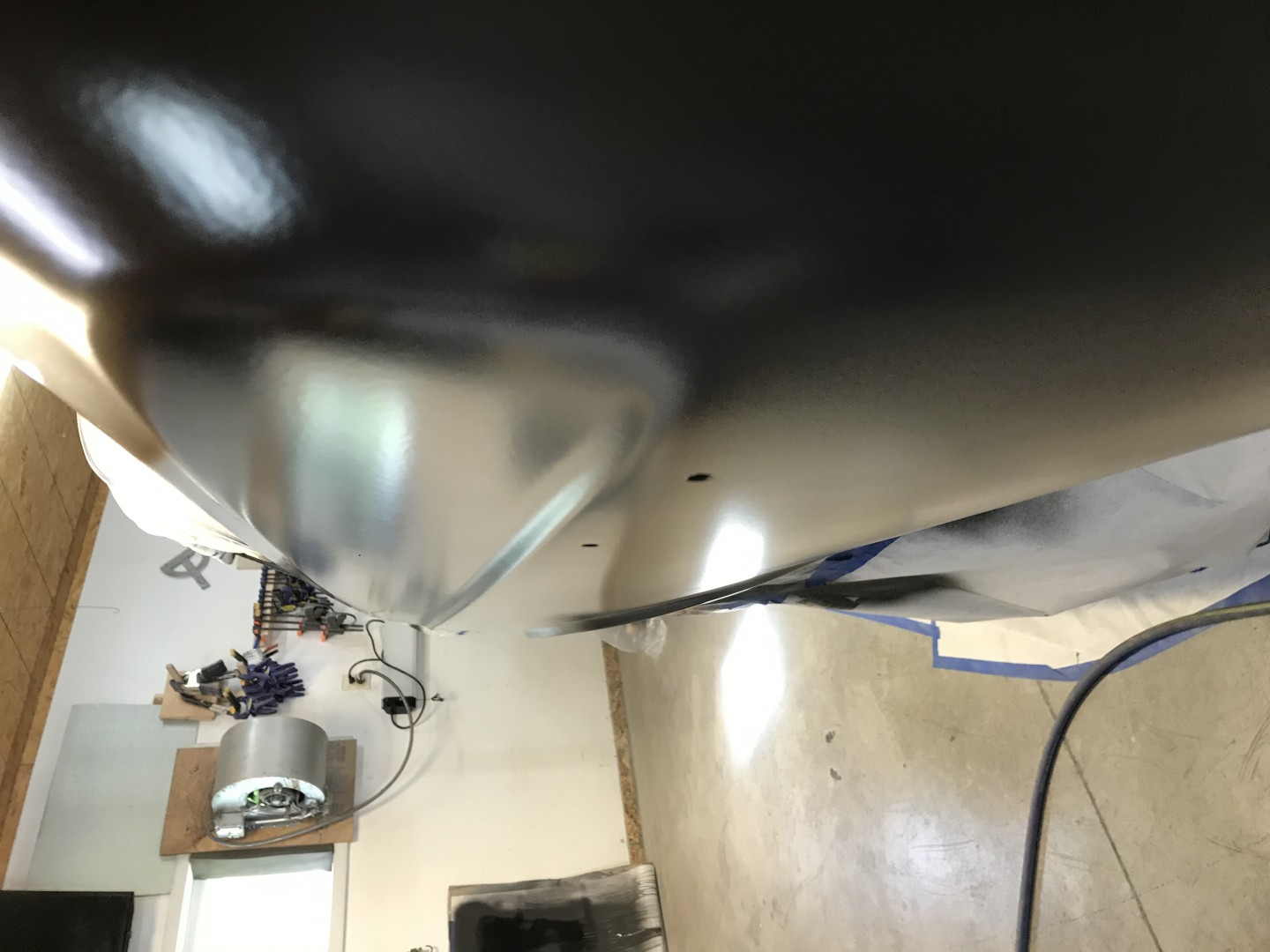

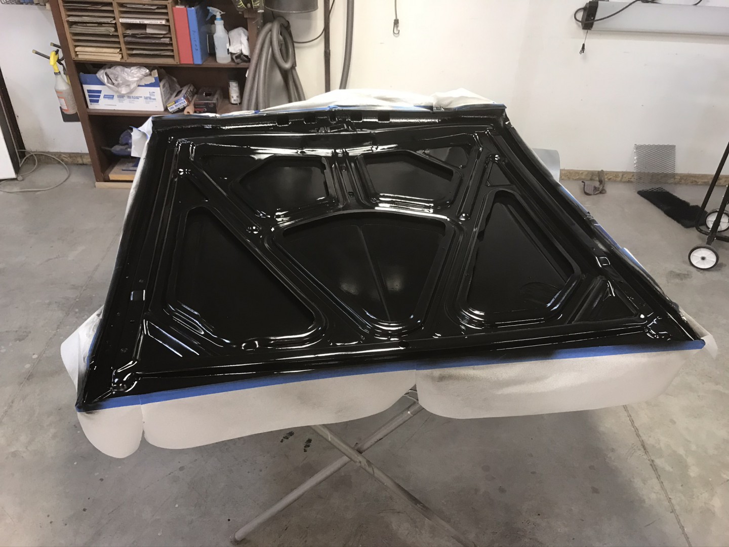

One more small bite. Should get the hood and trunk top done tomorrow. The underside of the hood and trunk just take so much time.

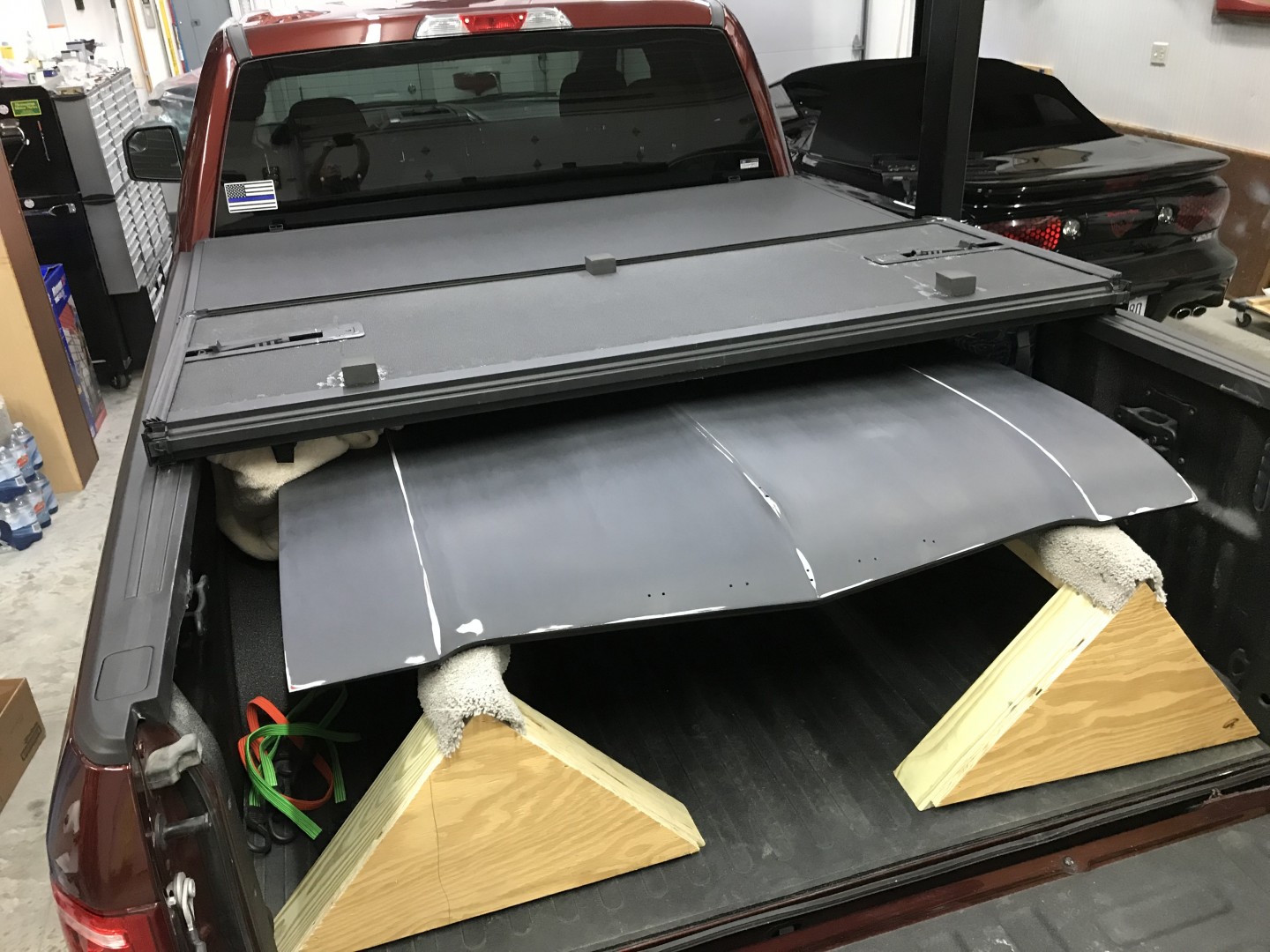

I built racks to transport the hood in my pickup. A six foot long 12 inch tall sawhorse, the trunk lid will fit underneath the hood for the ride home

Wish you were open for business here in MN. Looking great. Boy that quite a set-up for transporting a hood. I only had to take mine 4 block to the body shop. Good idea if any distance is involved.

The underside pics look better than the exterior paint on any car I've owned.
And of course I'm not surprised you figured out a way to include a woodworking project as well.

Jim, the sawhorses will be used later in the shop, they came in very handy to transport the hood over the 30 mile drive. They also provide a nice storage options for the pickup bed, more on that later. You’re on your own buddy I’m painting my first and last car. I’m pleased with how the hood and trunk came out, I’ll start the sanding and buff tomorrow. Then the body, which because it’s a vert amounts to just the rear quarters and the paint is done.

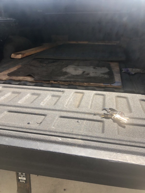

I saw a display for the Bedrug, when I had the topper installed and HAD to have one. I REALLY like this liner. My truck had the spray in bedliner and I don't like them, so this not only covered all that, but is nice for hauling delicate parts too.
Also easy on the knees. I also have one except the no carpet on the topper rails, etc.
Oct 8, 2020
Not trying to hijack subject, however many of you have a much higher standard of "BED MAINTAINENCE" My pictures show our 2016 3/4 ton shop P/U AKA "PLOWZER" 44,000 miles.
The "bedrug" consistes of cardboard, foam pad, oil soaked cargo carpet from a Suburban. Spray bedliner and some lumber for good measure.
Also note swing out tool box a little more scuffed (wrecked) than MItchs'

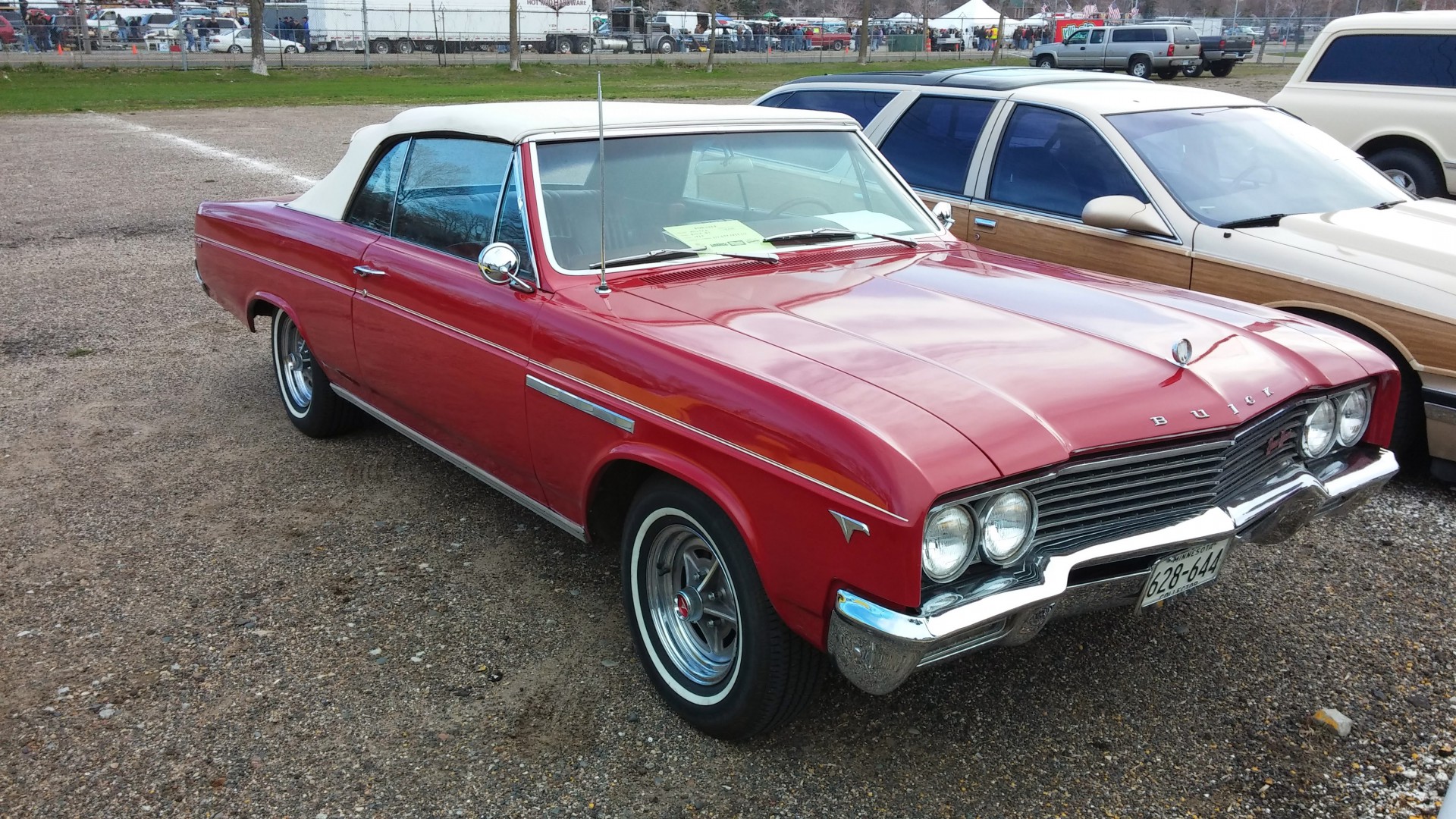

I think it's time to have a flashback of this project to really appreciate how far Kevin has come on this one.
These pics are from that warm sunny May 4th, Sunday in 2014 at the Buick show at the St Paul fairgrounds when I spotted her and sent the details to you. The rest is becoming a beautiful history for this car!
You did start this with those pictures Stan. I just went back and looked at my first post regarding this project, here's a copy and paste from that post of 6 Feb 2016. It contests of freshening up the drive train, rebuilding the long abandoned AC system, detailing the engine compartment, dash and carpet. I blew right through that plan and I'm still a long way from completion.

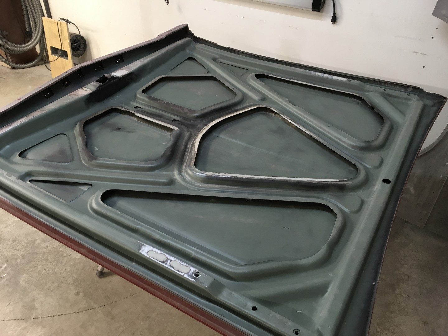

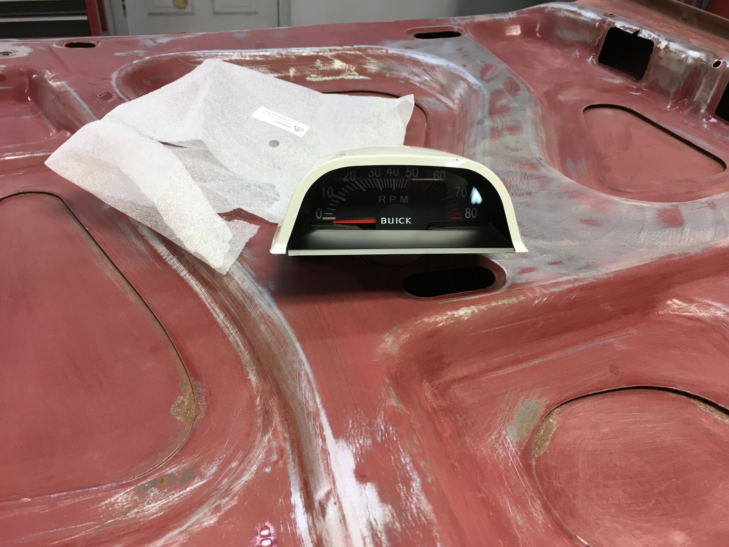

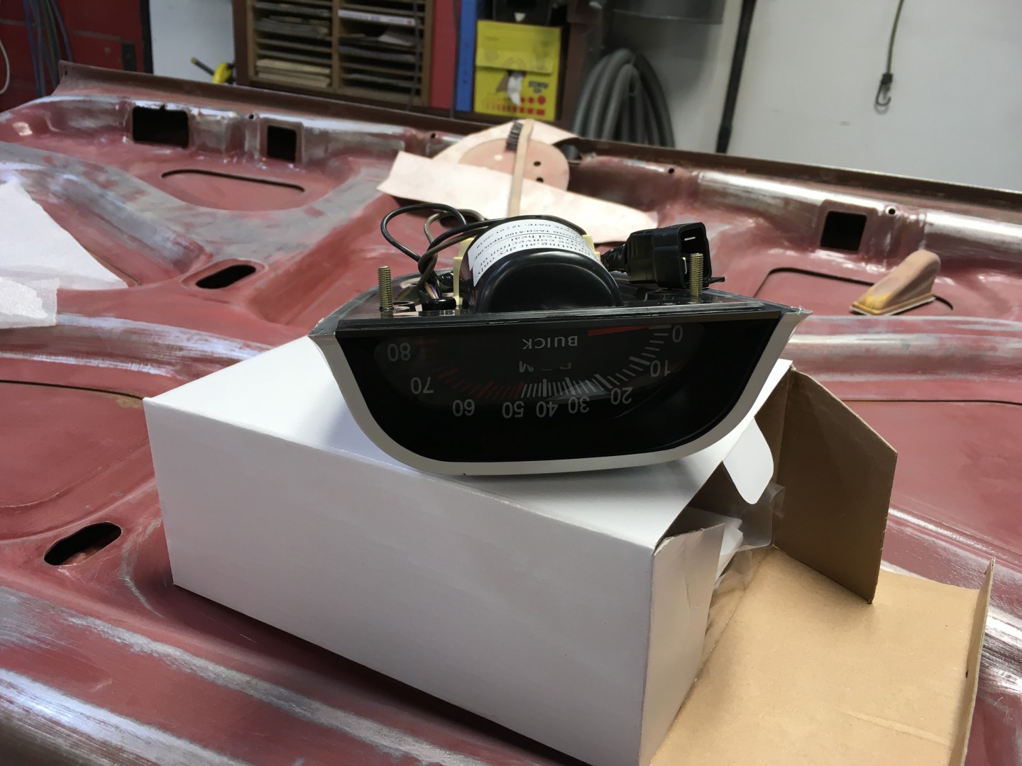

I’m going to install a hood tach, not original to this year Buick but I want one. I thought it would be a simple install, drill a couple holes for mounting bolts and one for the feed wire. But......nope I need to remove a good size area for the tach body that lives below the hood level. More on that later.
The tach install was more than I thought it would be, but its in. Paint on the inside of the hood is still wet when this pix was taken.

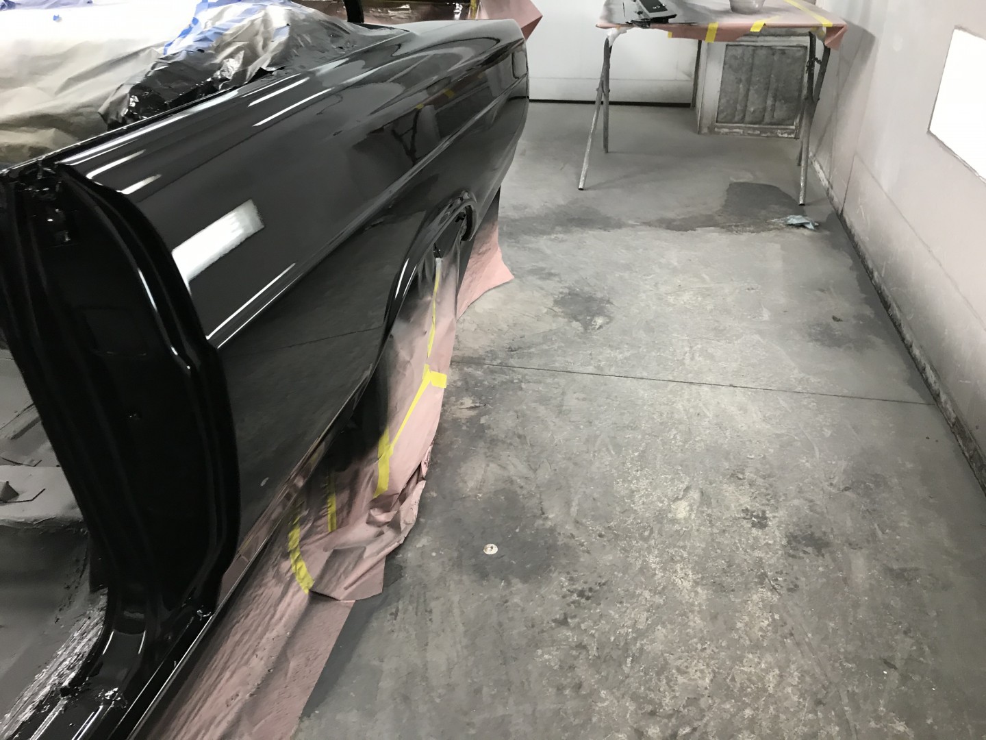

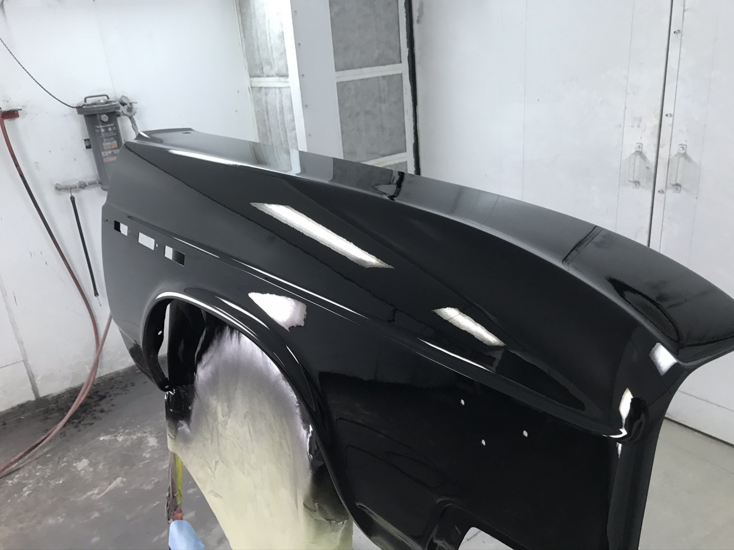

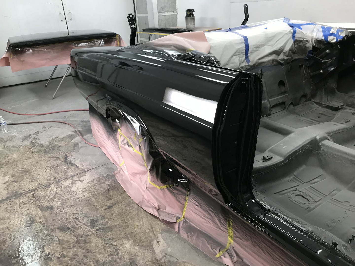

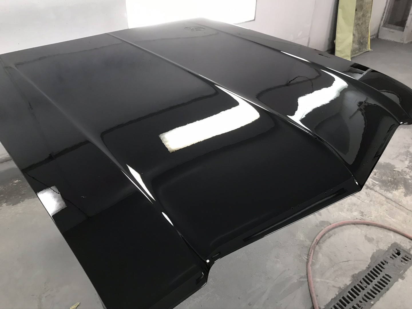

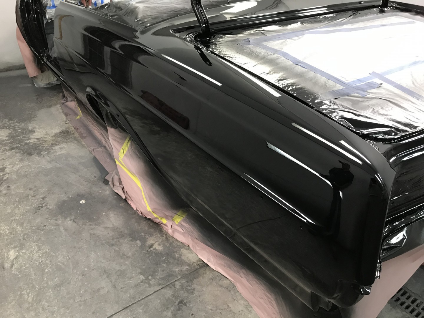

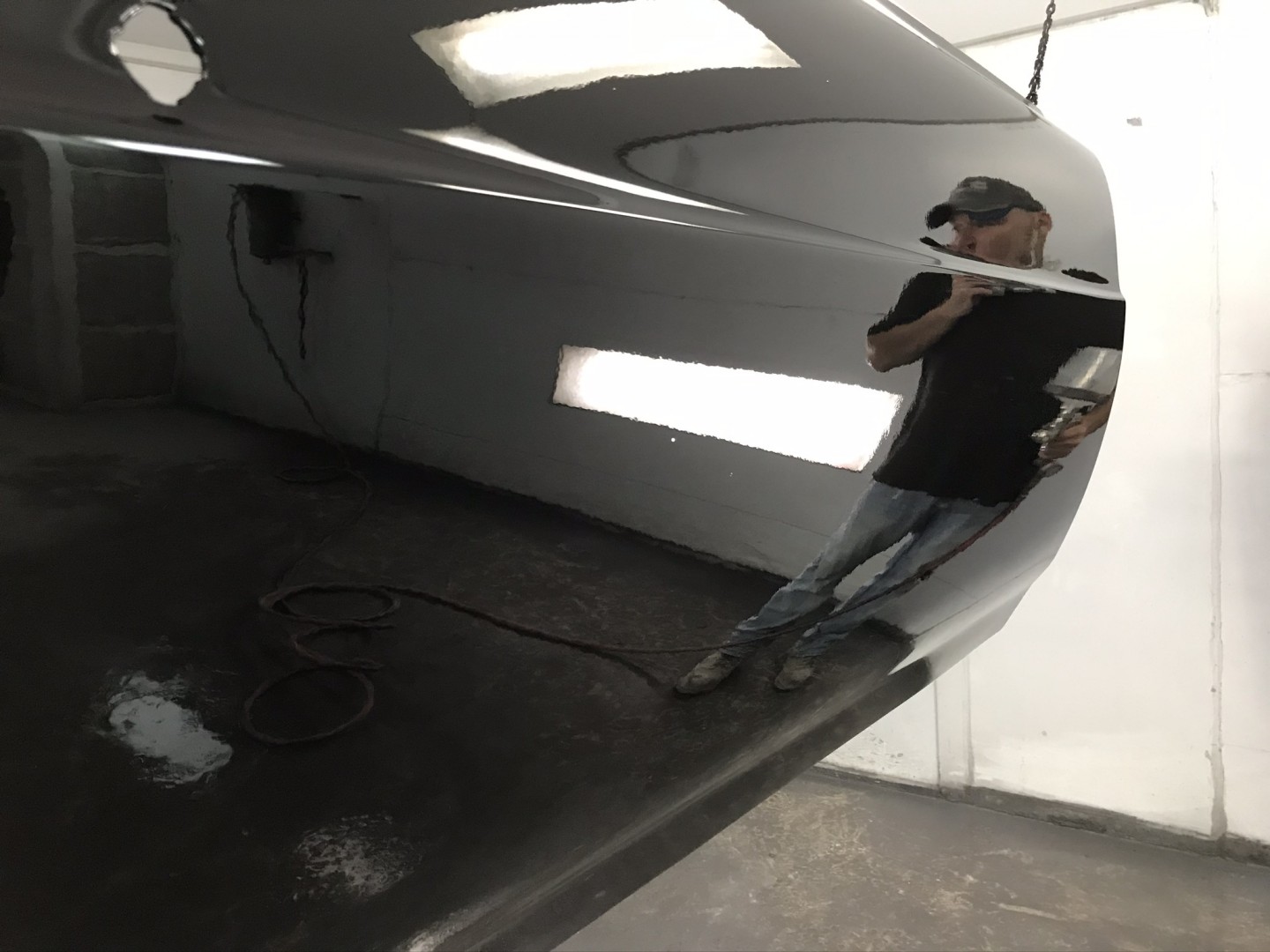

VERY nice Kevin! I'm not surprised though. You picked the hardest color that shows everything, and it's great.
The satisfaction and pride has to be through the roof. If you're happy...that speaks volumes.

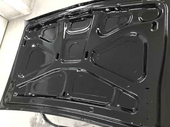

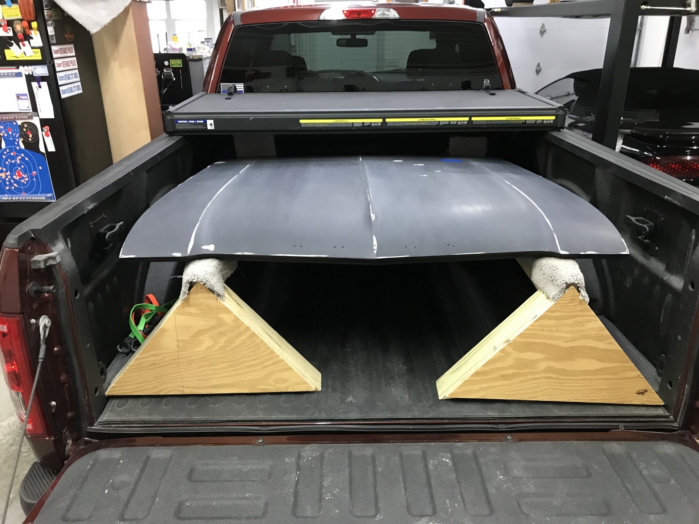

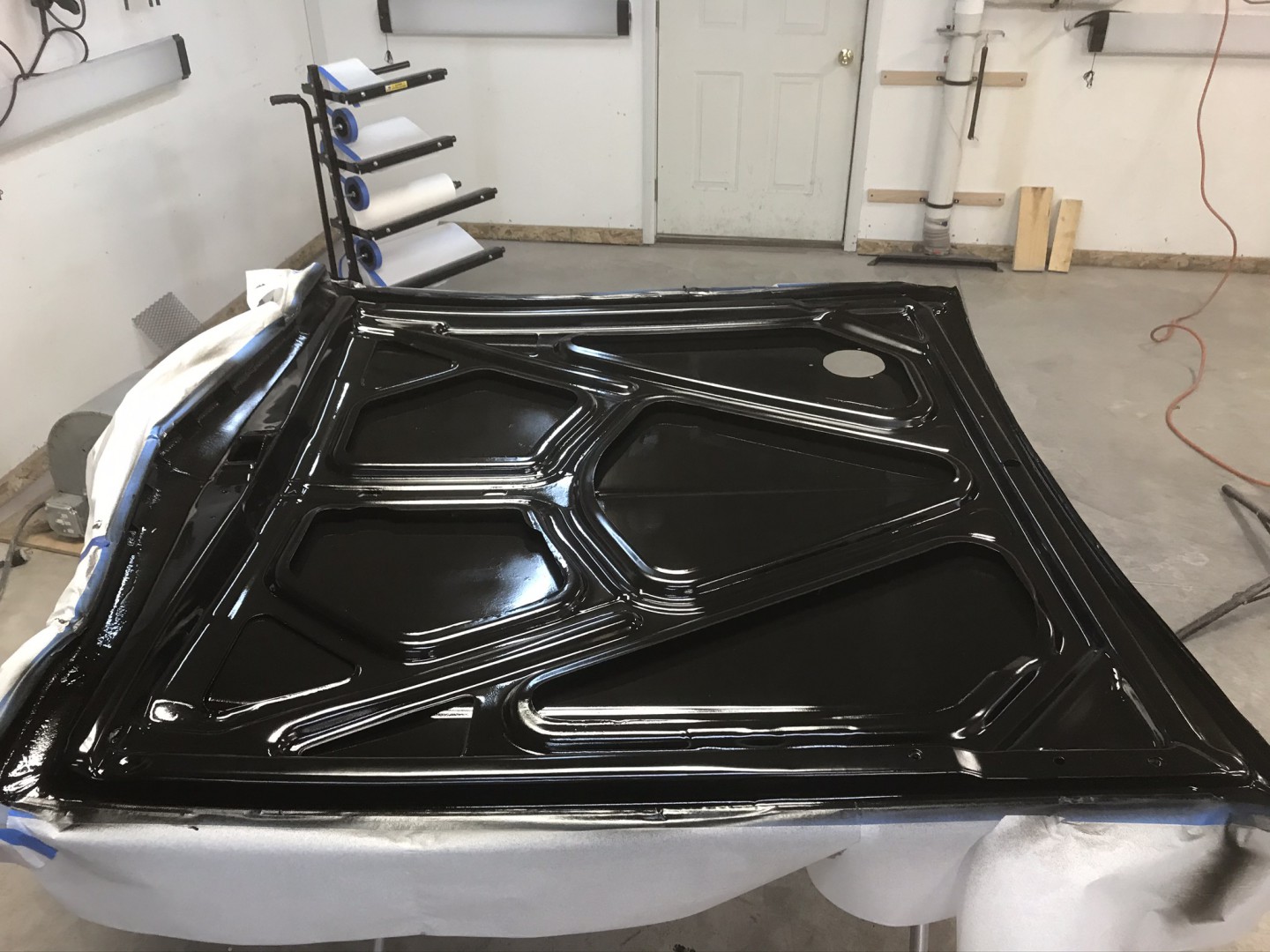

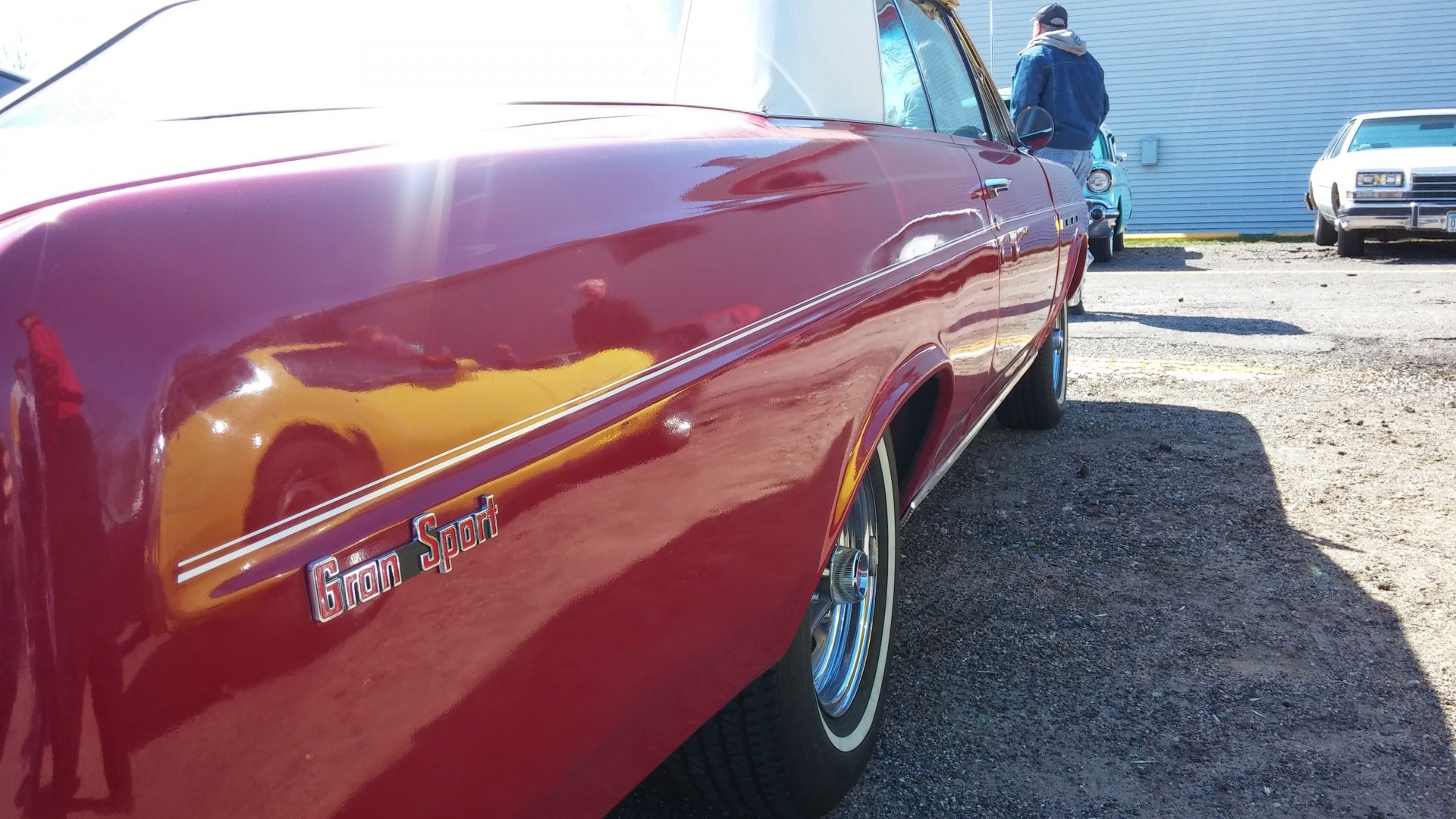

Finally after five years the body is painted, little cut and buff and assembly will began.
Truly awesome to have it THAT nice in Black...
BEAUTIS!!!
