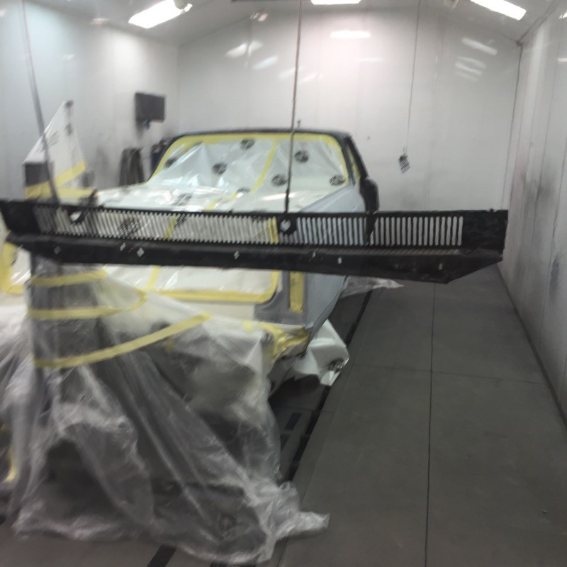

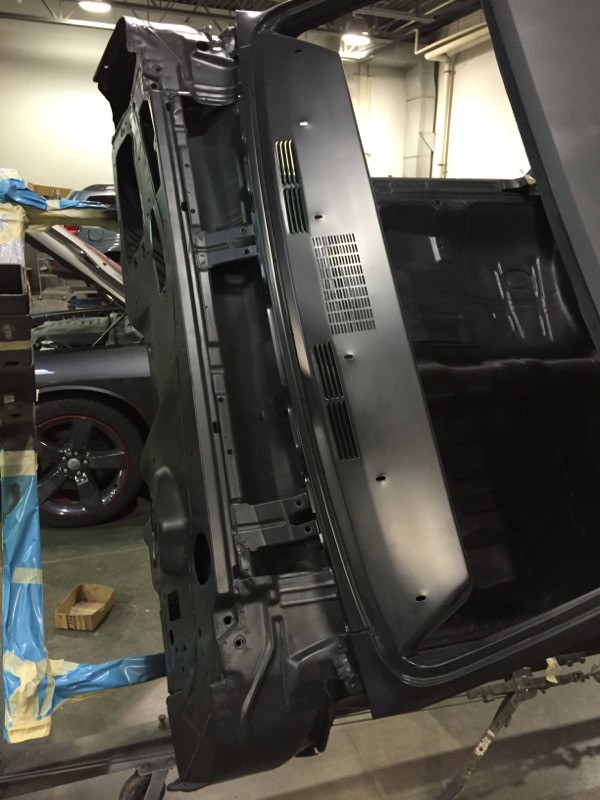

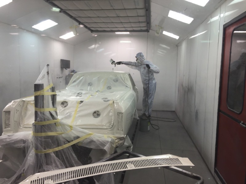

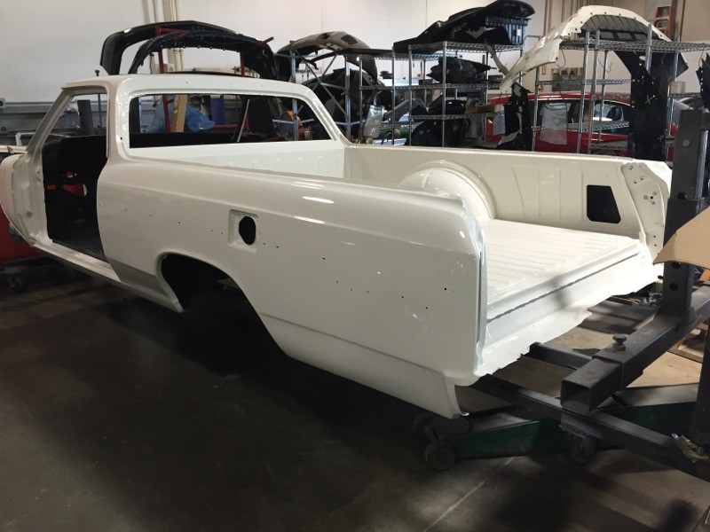

Stock Ermine White is just fine!!!
Easy to touch up and fix assembly damage, remember, I am kind of a butcher, no patience with "things", just people.
Good news, almost all outer panels, core support, front wheel housings are already painted.
Have muitiples and some NOS of stainless and wheel trim for both cars. Even some Nos bed rails.
Pretty soon I will have two "painted" ElCaminos to assemble.
However, I do think moving may get in the way!

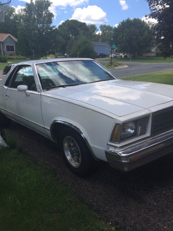

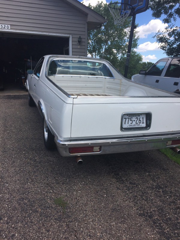

Son reports gentle squeeze on fuel pedal results in excessive traction loss in r/r wheel. Possibly r/rear tire failure instead?
We have experience in this as the 78 Elky he had in high school had the same defective tire issue on the r/rear.
It had all new shoes, r/rear wore out prematurely. I suggested to him I would replace that tire, due to the fact it was obviously defective, but the next one was on him.
Next one lasted longer.

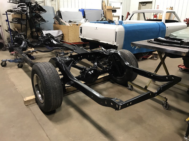

Yes, JIT powdercoated my frame. If you're going to cover it with Ziebart, no point in spending the money for powdercoating, although it was probably less than paint. Both of my trunk lids are good, thanks.

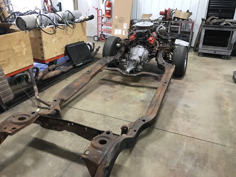

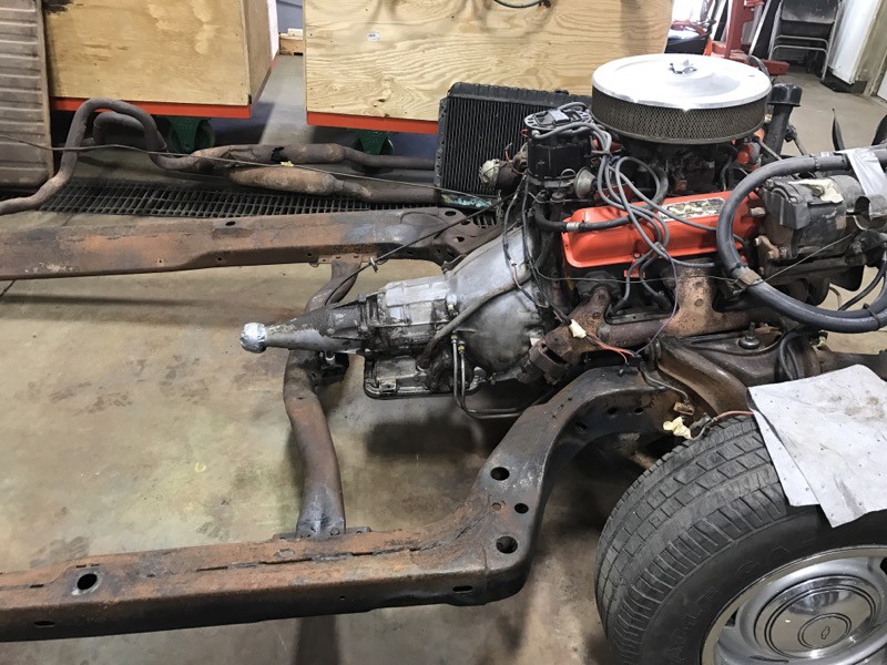

Mar 6, 2017

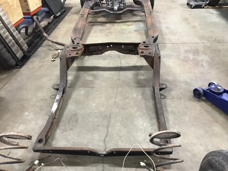

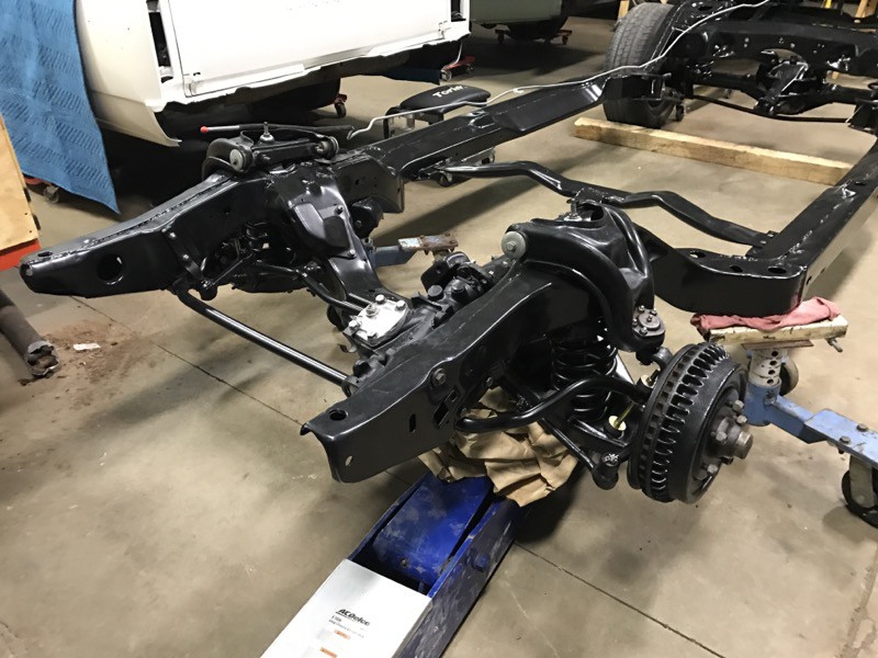

Update! Frame stripped, heading to blaster. Parts all over the place!

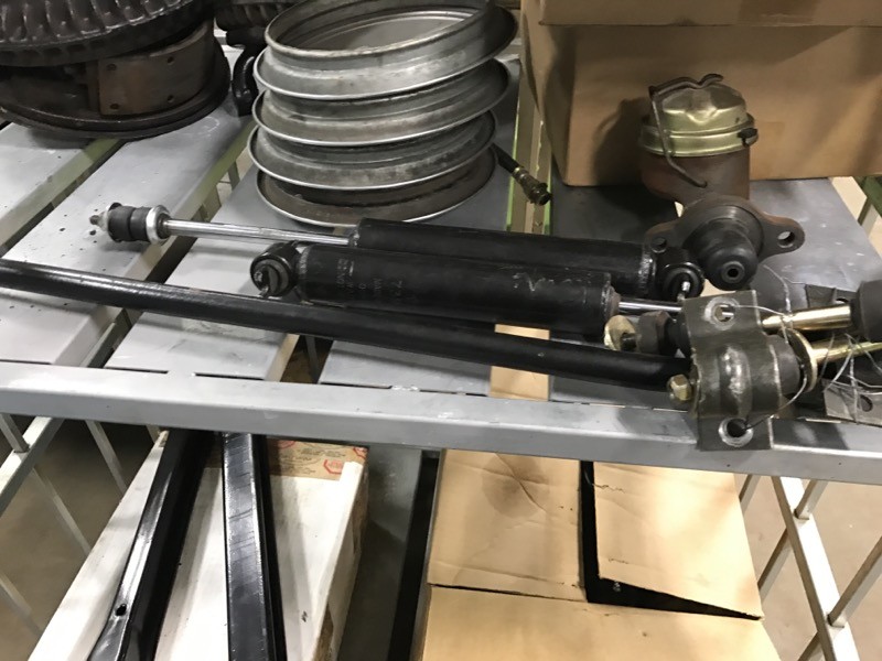

Did you get all the suspension parts blasted for coating too ?
Mar 24, 2017

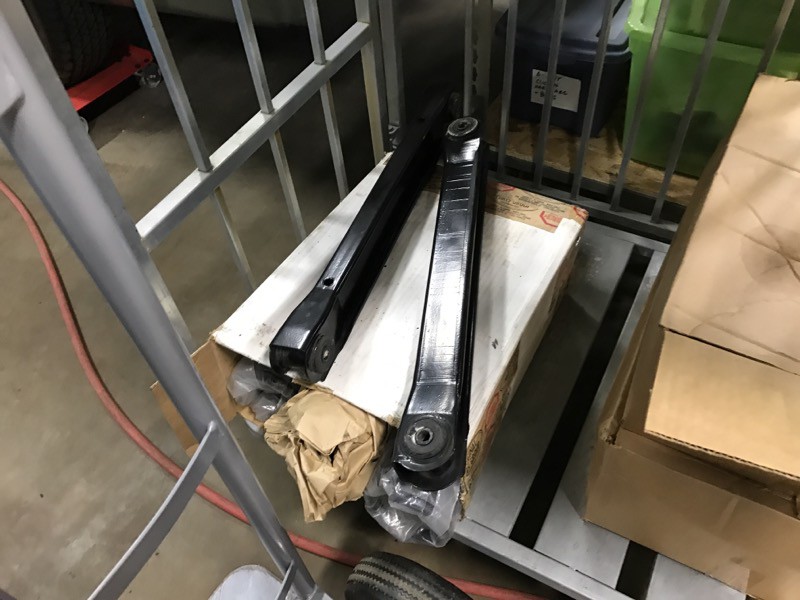

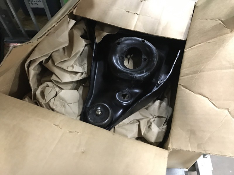

Bought some front control arms on Craig's list powder-coated and re-bushed.
Going to re-use springs, need to deal with trailing arms, I think I have some boxed ones somewhere, still looking.
Part of my search and destroy project this weekend!
Still sorting in Farmington.
Hope to find everything before I take the frame in next week.

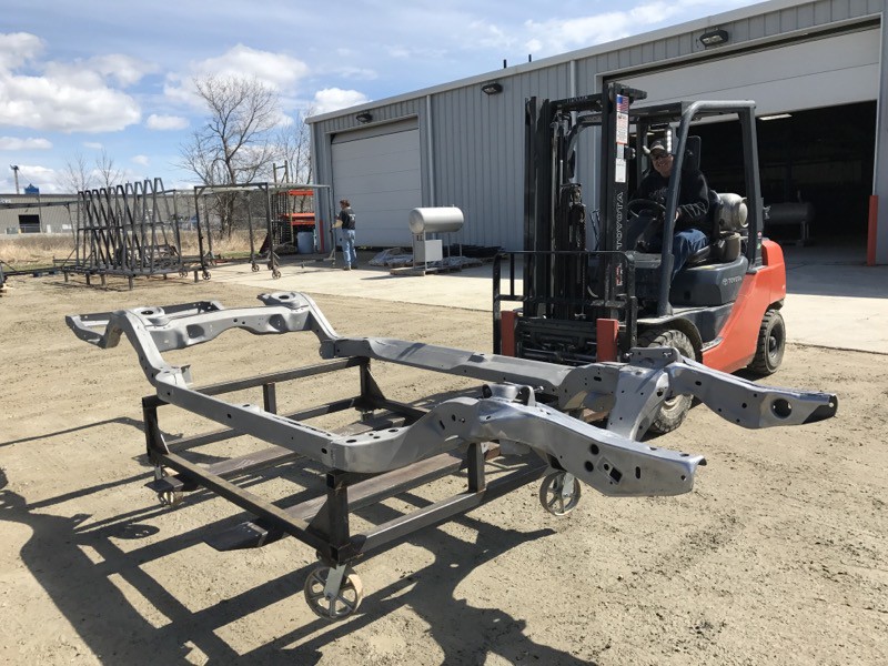

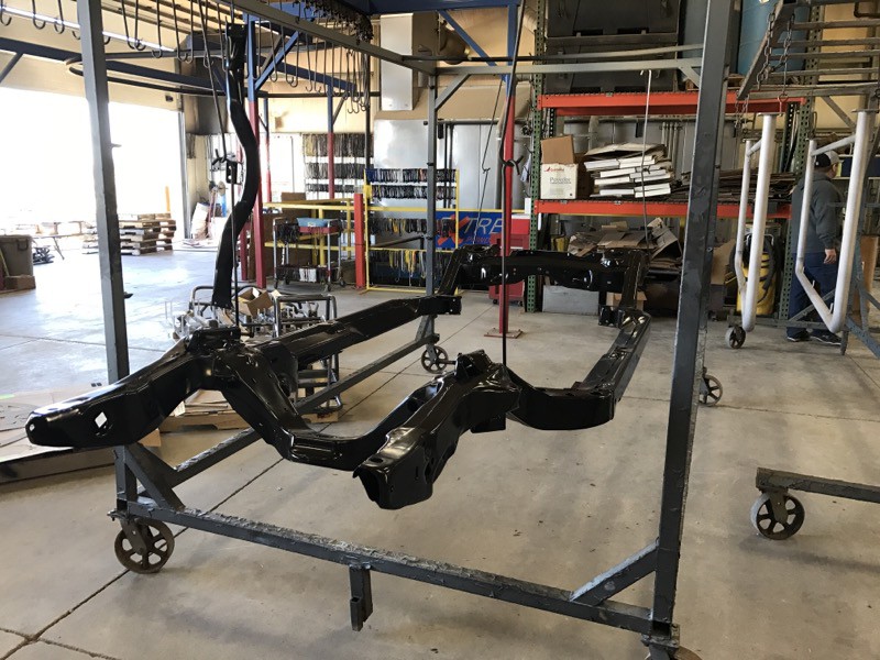

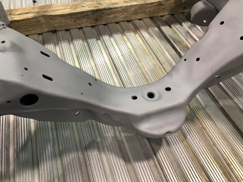

Apr 4, 2017

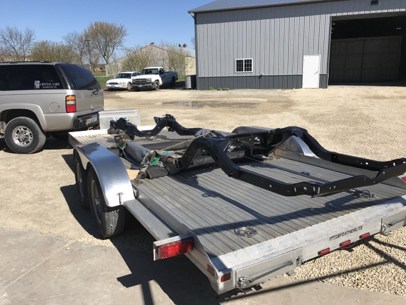

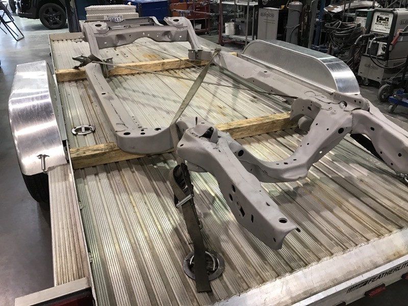

Pics. of Powder coated parts from Craigs list.

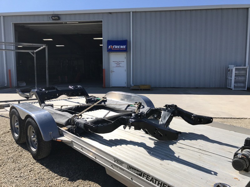

Frame being dropped off at Xtreme Powder Coat , Blooming Prairie. They have done some stuff for me before, nice people. Also Derek and Jenna can visit it, as it used to be theirs.

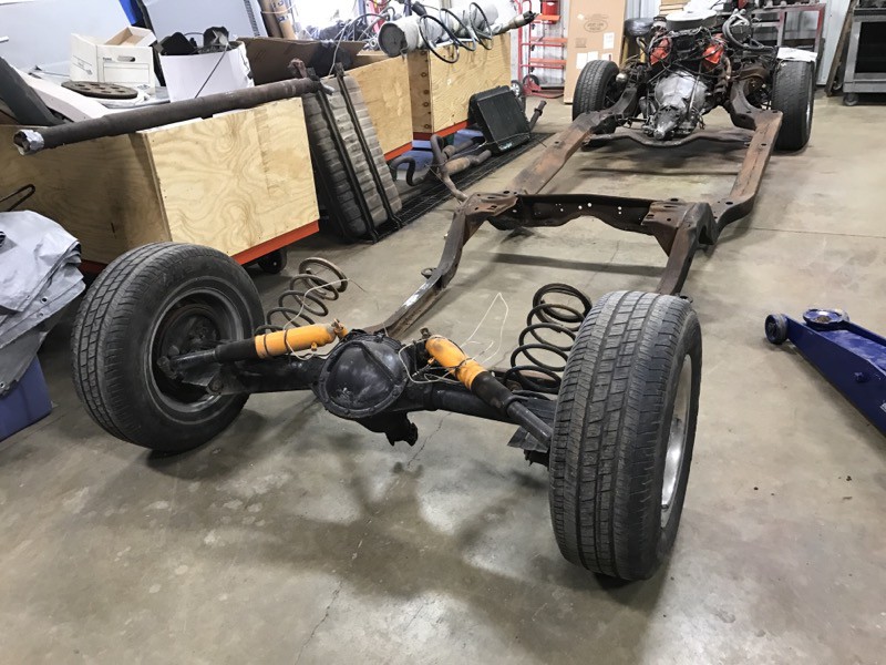

What is up with the "Diffi"??? Gears/Bearings?? Can help if you like.
Apr 28, 2019
Differential issue.
Biskwik has a beat 12 bolt, posi probably 5:56 gears.
Fourth gear by time I cross the intersection, 3000rpm at 55mph, barely drivable.
I have a complete fresh 4:10 posi in another 68 basket case I acquired.
Seller was cloning up a big block car from a 39000 mile 6 cylinder stick.
Should be good, guy was a square shooter, had a built 66 post also.
Biskwik was originally delivered with a 3:55 posi gear.
Probably an ok all purpose gear for most uses.
It was then raced, a lot!
Current housing has some grenade marks inside.
I have 3 (three) 12 bolt open housings purchased complete, gutted, stripped and in cosmetic reconditioning phase.
Choice:
Continue to screw around trying to come up with a freshened 12 bolt 3:55 posi in one of my gutted housings for Biskwik.
Just move the 4:10 complete assembly from basket case to Biskwik
Pull basket case diffi and switch gears to 3:55 install in Biskwik.
Park a spare roller diffi assy. under Biskwik and get Biskwik converted back to 3:55
Biskwik housing is not pitted, little rust, nice appearance.
Sometimes having inventory creates too many possibilities.
Still have possibility of my Crate 427 GM motor for Biskwik.
Switch to auto, as the Muncie probably would not be happy with the almost 500 lbs of torque from the 427.
427-2004r built, probably 3:31 or 3:55 gear.
The basket case has disc brakes, all new bushings, ball joints, blasted and painted frame and suspension.
Could be put together and slide under Biskwik, move Biskwik complete current set up under basket case.
Remember, the frame under Biskwik came from another very dry Arizona car.
So, not original, not like I am messing with a #s match deal, most original drivetrain is long gone.
See,
Too many choices.
Easiest is to continue plan A, build a 3:55 out of one of my 12 bolt housings.
Bolt into Biskwik, play with 427 combo in other detailed frame at later time.
Now I am confusing myself!!
Thanks for comments and input, it is appreciated.

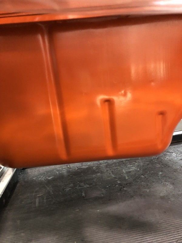

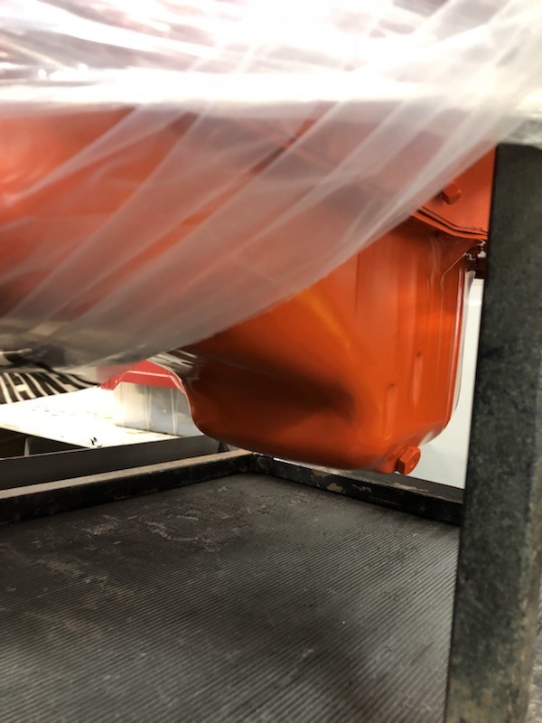

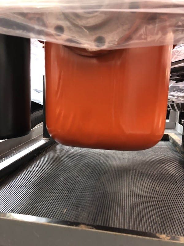

Where did you find a good body man to straighten the pan...
May 1, 2019
Engine Shop took care of it, If it runs as well as it looks, we are good.

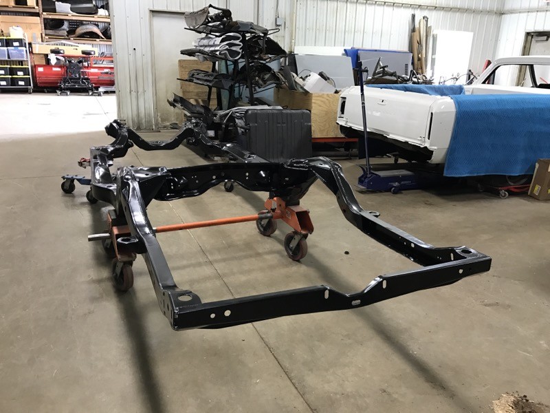

Dec 19, 2019

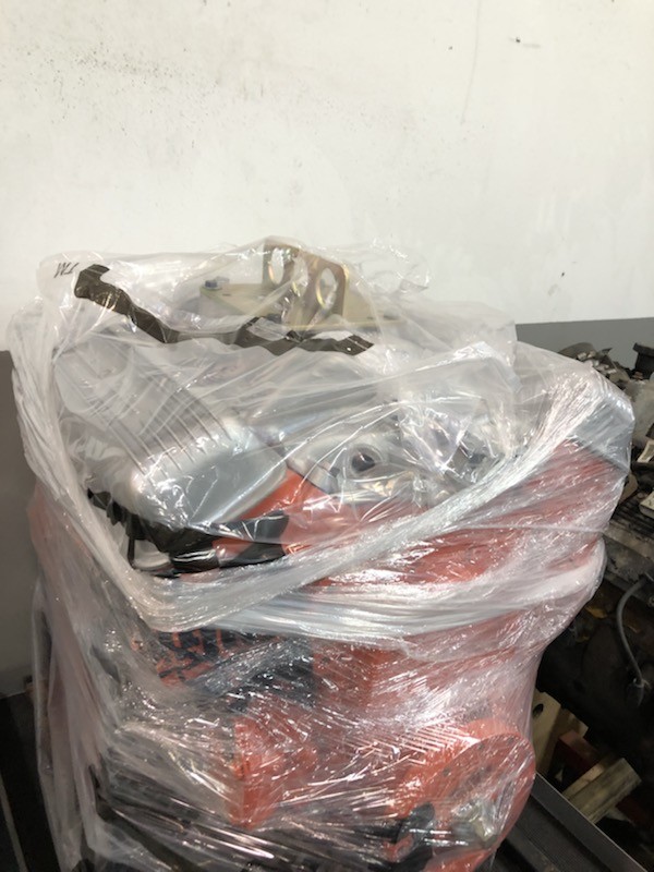

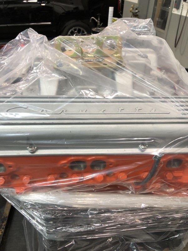

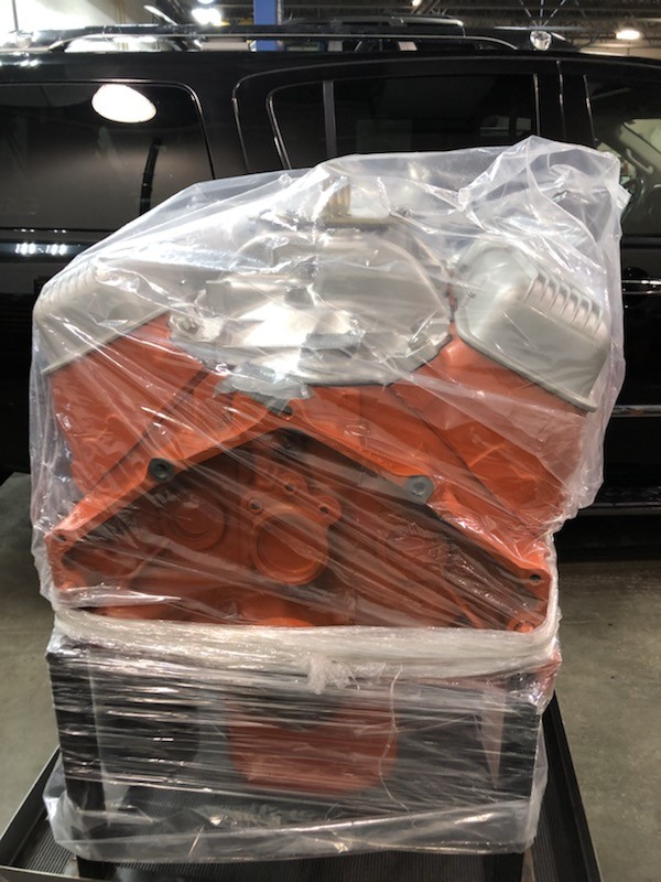

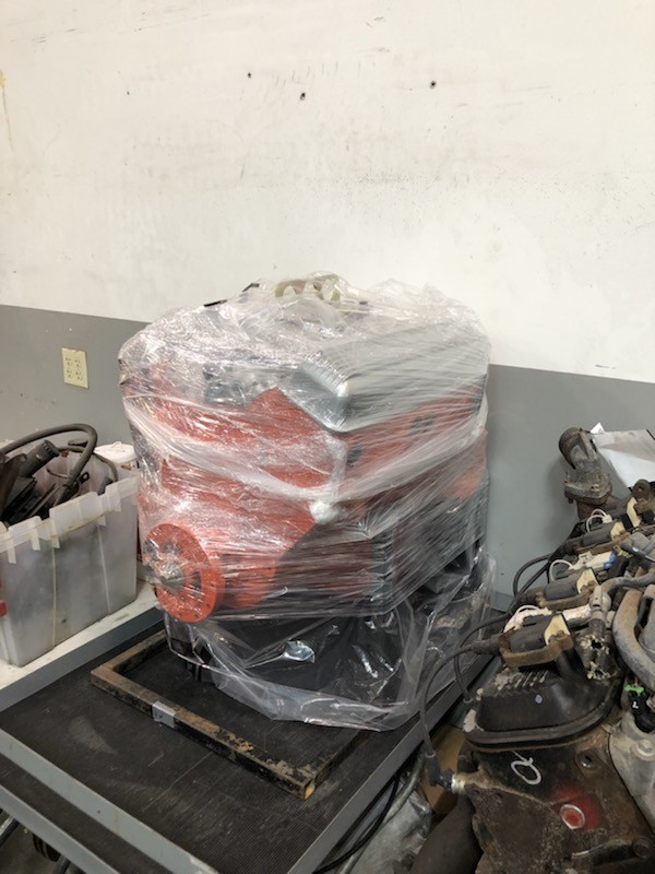

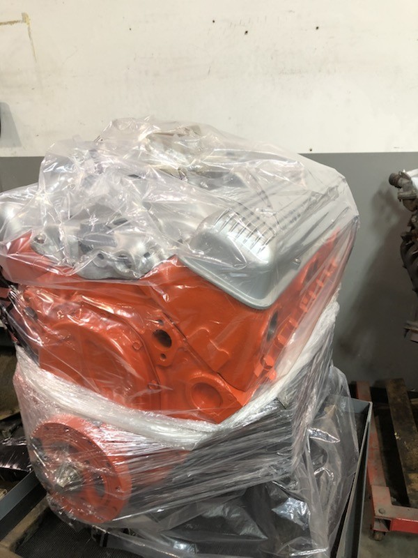

Time for update: Ordered and received distributor and coils from summit, thanks Mitch for your advise. Dropping Exhaust manifolds off for ceramic coating tomorrow. Still need to order wire set.

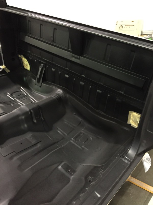

Son-in-Law working on firewall, floor and all plumbing.
May try and get glass in prior to Bowtie Brunch.
Goal at Brunch, assemble trans, engine, manifolds, wiring, distributor set in car.
Exhaust Manifolds done (ceramic coating), fresh water pump,
Billet flamethrower 3 distributor and coil, wires. Thanks Mitch!
Most all brackets and p/s pump detailed.
New stock reproduction 5 blade fan.
Starter out being upgraded to Hi-torque, alternator getting a "hug"
Driveshaft balanced, new u-joints.
New back glass, windshield, hope to have installed prior to Bow Tie Brunch.

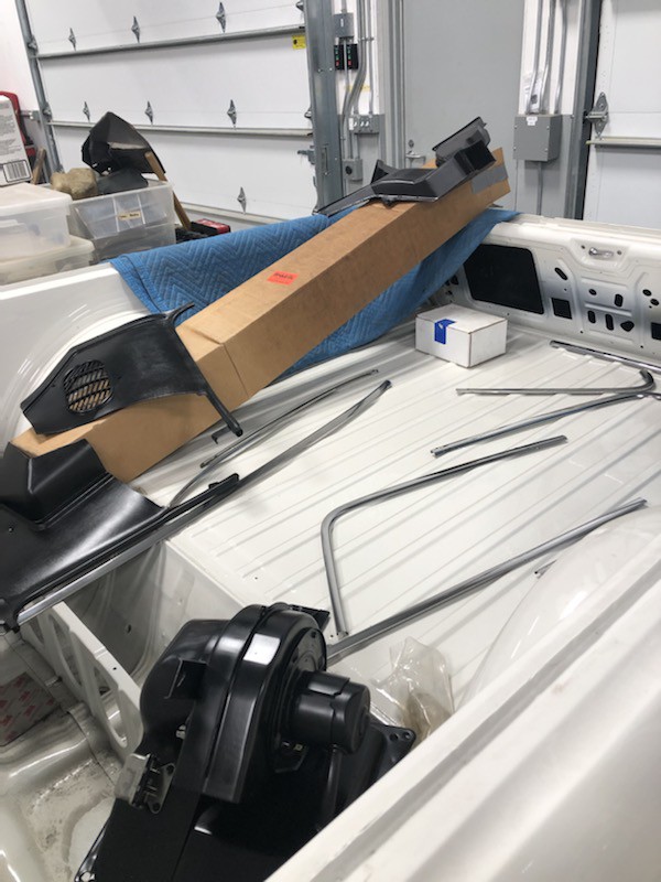

Firewall, heater/ac mostly assembled.
Issue to resolve at Brunch, rear brake line too long, may need to coil, stainless, tough to cut and re-flare.
If someone has experience and the "super tool" for stainless flare it sure would help.
Pictures to follow later today.

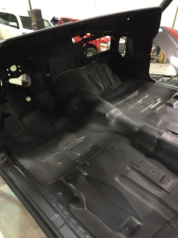

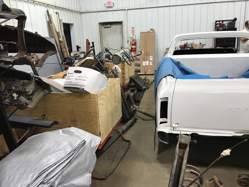

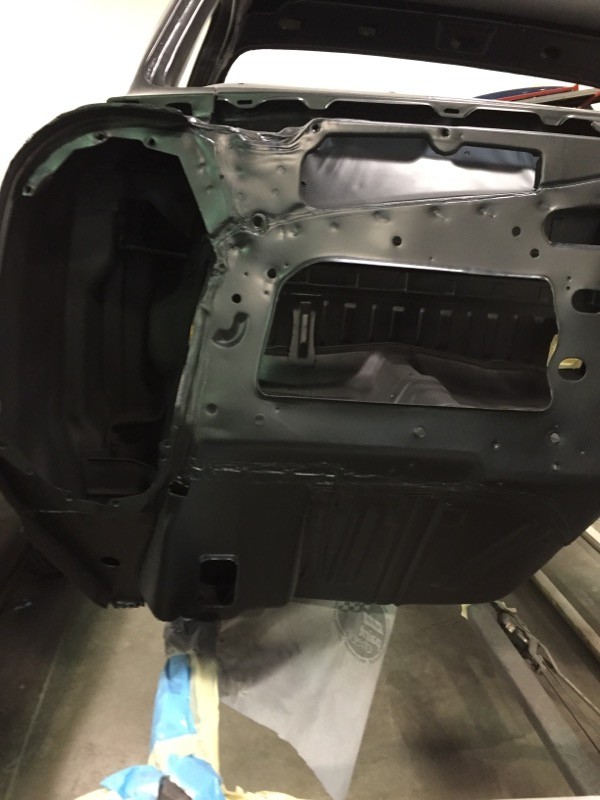

My Son-in Law Ron used most of his recent "must use up" Vacation cleaning, detailing, painting and assembling.
We both have made a few parts runs and been ordering stuff online.
Getting close.
Plan on transporting Car from 'Treasure Chest" (AKA Farmington Toy Box) on Wednesday, hopefully for glass install.

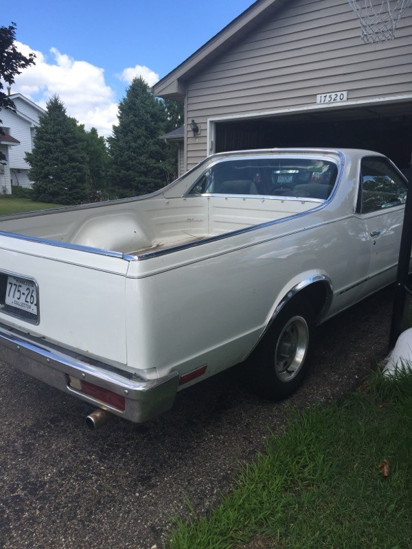

One wheel wonder!
And you know it's a 1 wheel wonder because you checked the axle code ?...
He hadn't learned to rotate the tires when you weren't around to have them all wear evenly...
Been a while since an update.
These pictures were taken today for the most part.
Son-in-law Ron is more ambitious than I am.

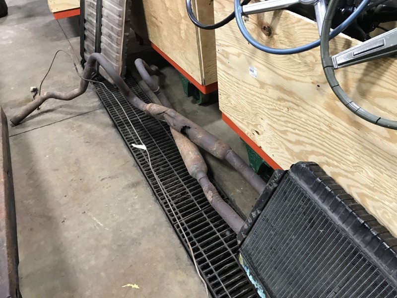

Stripping white ElCamino frame for blaster.
Frame is as pristine as they get.
Exhaust was kinda rusty.
This was the car where the fuel line had a hole in it over the axel kick up. Body mounts were "dead" rubber, really compressed, causing wear thru.

Update!
Good job....you know you're making progress when you have parts everywhere...
Really a pristine frame almost NO pits.
Little detailing this weekend, out for powdercoat next week.
Couldn't help but show a picture of our newest household member IVAN.
IT'S BAAAACK!
A few photos from this morning.
Came out very well, and on time.
Thanks to Xtreme Powdercoat for their nice work!!
Was leaving and Dicks Hot Rod Shop pulled up.
They have a fancier hauler set up than I do!
It's home!!
When is the "frame assembly" tech session...
If I'm around, I'm in.
Son -in-law is far more ambitious than I am, he wanted to roll the frame to the new building.
Thus, the progress shown in these pictures.

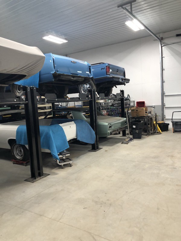

Good excuse to try and get differential done for Biskwik.
Parking that on hoist until differential for that is ready.
With my blazing speed pretty sure it will spend the next year up there, for sure.

Original 327, warmer cam, all first class pistons rods, bearings.
Balanced, detail assembled, fussy head work.
L-79 Winters aluminum intake, stock Holly carb, Corvette finned Aluminum valve covers.
Powerglide, freshened.
Oil Pan pictures are for Mitch

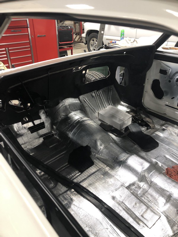

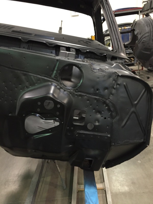

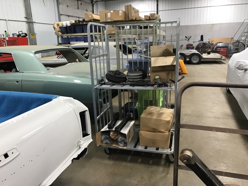

Most of what is happening on body now is hard to quantify, one step at a time though.
-- Edited by more ambition than brains on Wednesday 1st of May 2019 10:44:15 AM
Yeah, yeah, it all looks great...
