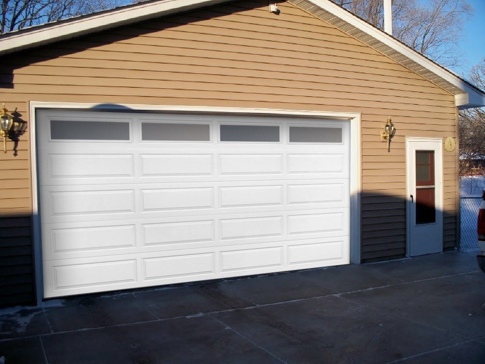

One thing I neglected to mention... ok, two things:
a) it's an 8' door
b) it's frosted glass
May 8, 2014
Ditch the windows, paint on squares if you like the look. You'll be adding enough light that these won't make a difference. As an outsider looking in, the frosting would take care of it, but for physical security that man door on the side is #1 concern (frosted or not), but I assume you're leaving that because it's a detached garage.
May 8, 2014
The windows are a concession to style and "Mama"... they're too small & too high up for anyone to crawl through.
The man door, window, and structure have several levels of security devices (physical & electronic) already in place, so it's not really a concern. (they will prevent an amatuer crook, and deter a determined one long enough for me to get a sight-picture )
May 8, 2014
I like the window look just for style especially in a residential neighborhood. Based on your comments we know security is not an issue. Definitely the long style just for cleaning sake, why wash 12 windows when you can wash four?
May 8, 2014
The Prairie style panes are just plastic dividers inside. The outside glass is still all one piece.
Who the heck washes the windows on a garage door anyway ???? We never have....

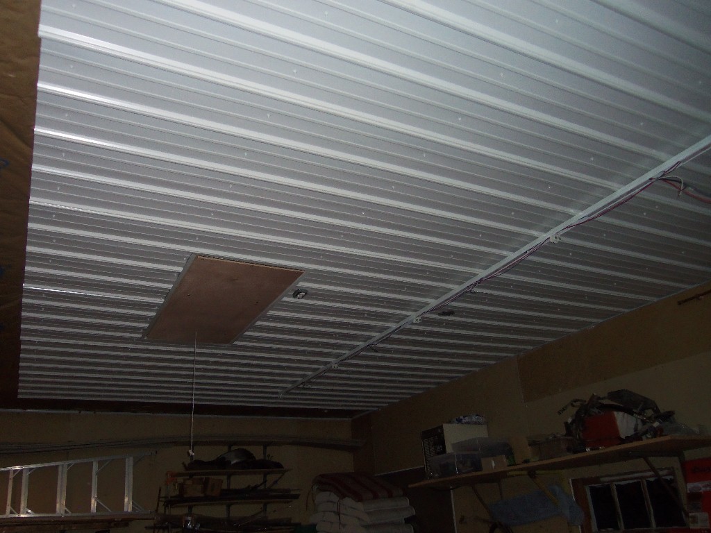

Made some more progress today, got about 50% of the ceiling tin up with Jr's & Sheryl's help, and mounted the 1st string of lights. I've already pre-located the feeder drops for the lighting circuits, and they'll through the ceiling into the fixtures with a short nipple (nothing exposed).
The old lighting (with the goofy shrouds) is dismounted from the joists and just hanging by some baling wire so I've got lights to work. It'll come down as work progresses and the new fixtures come online.
The air line & hose reel will go back on "surface" mounted. The new duplex outlet (by the hatch) will be for the trouble-light reel.
I don't have a problem fishing walls for a future outlet if I've missed something, or need to add something. I do it every day at work.

Another marathon session today. Rented a sheetrock jack/lift for the last 9 panels (shoulda done this for the 1st nine...). These are 14' long, and it's nutz what only 2 feet more does to manageability! Got those installed, and hung the remaining light fixtures in place.
I was pretty darn close with my drops/feeders, and the final connections didn't take too long.
All I can say is WOW. I'm having a hard time imagining what it'll be like when I get the walls painted white too!!
You're gonna need sun glasses inside....

Most of the time, I only use the regular bulb light, but lately I have gotten more into using the tubes when I'm working on a project out there. I don't do it at night much though because it's like daylight inside. You're going to love it.
May 31, 2014
Looking good John, nice and bright. I'm going to steal some of your ideas and put steal on my ceiling also.
Jun 1, 2014
Looks awesome JD! Lighting is one of the most overlooked upgrades in shops that I see, IMO. It makes such a huge difference to see what you are working on, and with your attention to detail... I know it will let you make things even more 'JD clean' for gasket sealing when you are working on projects!

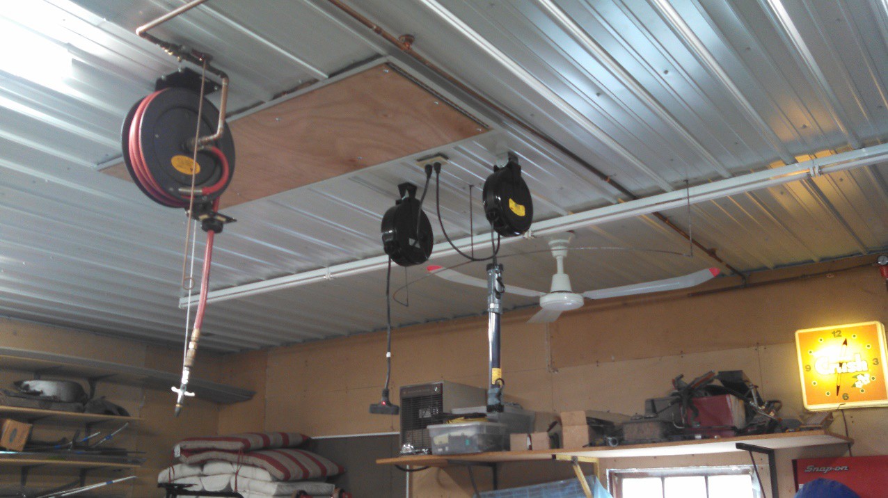

Well, another marathon session in the shop today...
Got the ceiling fan assembled and mounted. Welded up a wire-frame "guard" to keep the trouble light and extension cord from accidentally getting pulled into the blades.

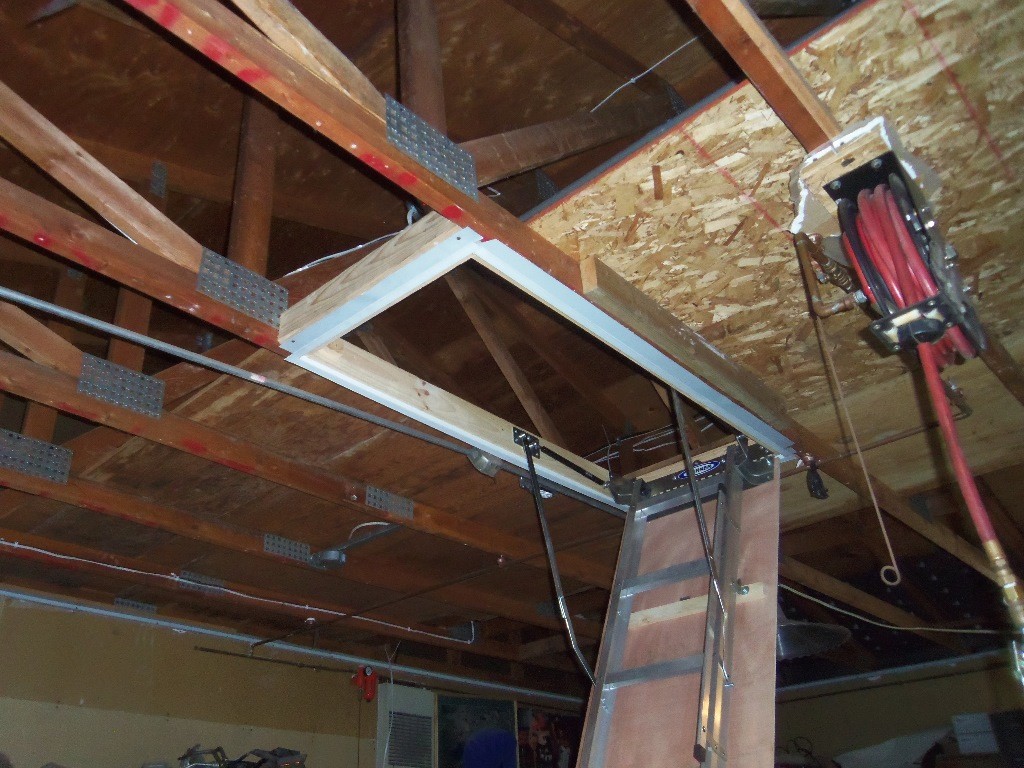

I've been waiting on re-decking the attic space until I got the compressed air piping, hose reel, trouble light, and extension cord mounted to the ceiling. I had to install "blocking/scabs" between the joists for something to screw into, and that happens from above. Got the blocking installed, then the hose-reel re-mounted and plumbed, and a new retractable extension cord reel and retractable LED trouble light. On to the attic.
The previous owner used whatever scraps of plywood he had laying around up there. It was a mess and with 1/2" & 3/4" it was a PAIN to slide anything around without getting snagged. Well now the whole usable attic space is decked in 1/2" OSB.
Pics to come.
Jun 17, 2014
As promised...
The ceiling fan really makes a difference in the space. Even on low, it just moves air around and it's nice in there.
I used a few "leftovers/truck-stock" camera swivel mounts and mounted my Boston HD-5's to the ceiling (I'll run proper wiring later, when I do the walls), and we made a serious sort & toss-donate session before bringing stuff back to the attic. Goodwill got a lot of stuff.

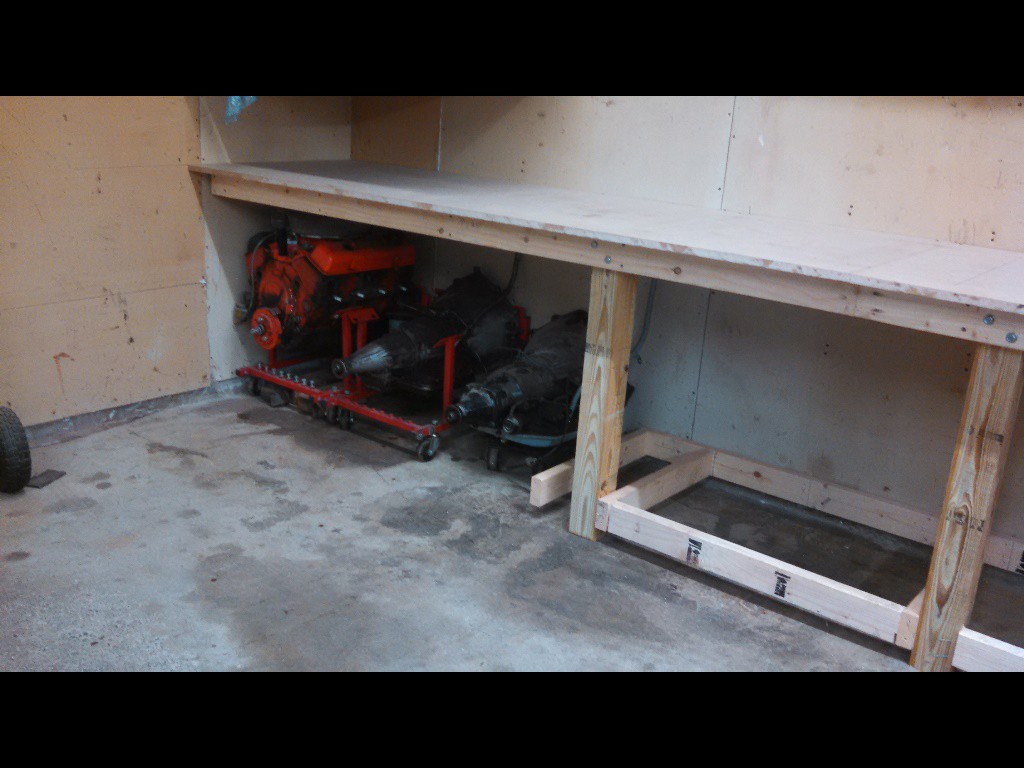

Well, attendees of the June meeting will notice a difference between yesterday & today...

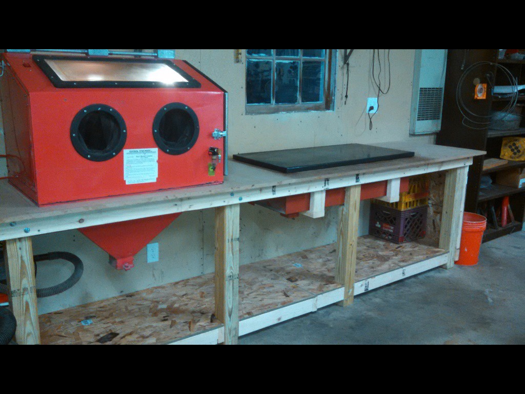

Today's project was the workbench on the west wall. It's about 90% complete. The "plan" is to cut holes in the top, and flush/surface mount the blast cabinet & parts washer into the benchtop (you can see the "saddles" that the parts washer tank will rest into).
The benchtop is 3/4" MDF (Medium Density Fiberboard), framing is std. 2x4, and the posts are PT 4x4. I like the MDF for the benchtop, as it's HEAVY as h*ll, can be "machined", doesn't split or chunk-out (when pre-drilled), and readily takes a sealer.
The bottom will be decked in OSB for storage, and an intermediate shelf put it where allowed. The front face will be finished to match the existing bench, with doors for access.
-- Edited by John D on Sunday 29th of June 2014 11:12:51 PM
That is going to be a really neat set-up. The only thing I see that concerns me is the supports for the parts washer. I would put a 2x4/4x4 under the center of each stringer as they will be tasked with holding a lot of weight with only 8 screws from straight up into the risers. Might be overkill and you may have it designed for the rim of the tub to rest on the bench surface too...

I suspect it will be hung like a sink with the lip resting on the top. I like the setup, makes me think about something like that for my shop. I'm kinda getting over the dirty side setup I currently have. It's functional but not exactly what I want.
Jul 1, 2014
You're both kinda right... Got the parts washer cut in yesterday, and the blast cabinet tonight.
I was kicking around doing this for a few years. What stopped me was occasionally over-thinking the deal, and saying to myself "self... what if you want to move the stuff around? It would be locked into a certain spot." Well, in the 4+ years I've had the two items, the parts washer has NEVER moved (too dang heavy & flimsy legs), and the blaster to retrieve something that fell behind it.
Well now I better storage under the items, the bench is still reasonably functional as a horizontal surface catch-all (with the washer lid down), and once I get the front on with the doors, the crap in storage will be out of sight.
I'll cut in a hard-piped compressed air drop down to the space between the two, and have a curly hose there. Then I'll have air for the cabinet or air for a blow-gun to dry parts.

a) it's an 8' door

Well, I finally got back at it. I lost a few weekends with Graduation and Cabin Opener, but I filled the time during the week chipping away with getting my electrical drops and other things ready for the last push on the ceiling.
Pics to come.
As promised...
