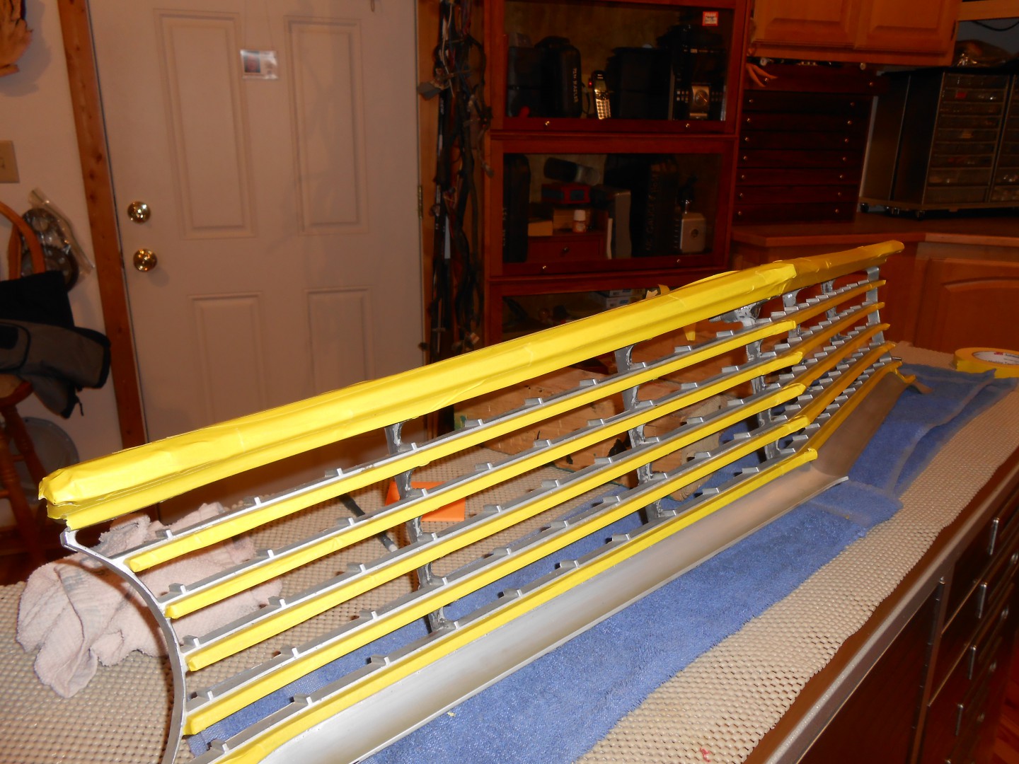

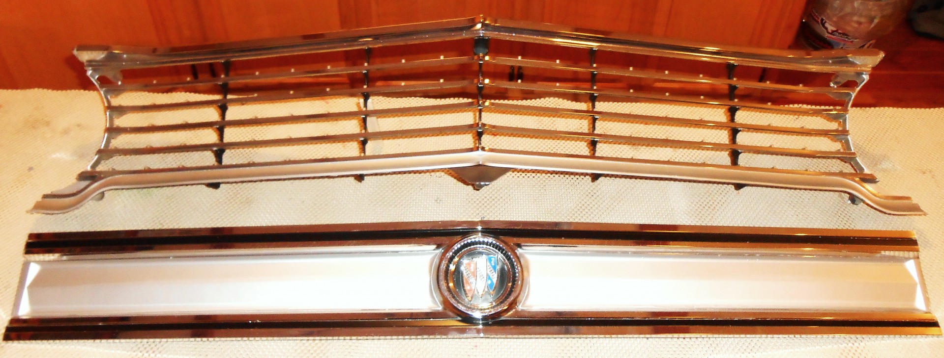

Grills done, I touched also up the rear trim that goes between the taillights. The grill is much more solid now after repairing the cracks.
When I see the grill sitting on the workbench, it looks like it belongs in a 56 Chevy.

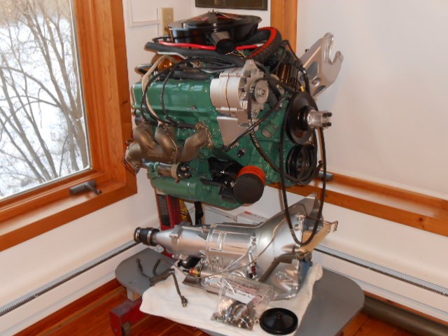

The engine is ready to come off the test cell but I cannot bring myself to pull it off, I just enjoy walking out to the garage firing it up and playing with it to much.

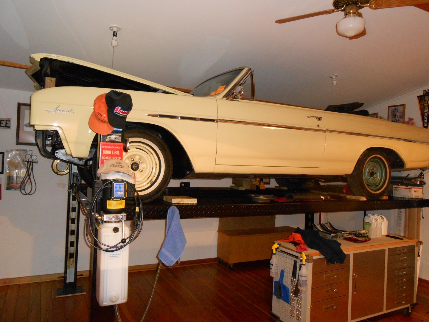

Still moving along here, engine and trany have been installed for fitting and mockup work.I wanted to use the truck intake but it was ½” too tall for this hood, and the owner said where not cruising around without a hood on my car.
Several parts arrived this week, so many in fact our UPS guy asked “what ya building in there?” Mocking up the accessories tonight; using Holley’s accessory drive brackets, they look more factory than the others and GM accessories bolt right on. Also arriving this week was an LS6 intake to go with the 799 heads and a 2010 Camaro water pump (thanks Bryan) which moves the water return to the driver’s side and allows clearance for the TB.
The 4L60E case on loan from Master Transmission fits well, in fact the 48 year old factory shifting linkage on the frame lines up perfectly and will bolt right to the 4L60.

Looks like a very nice fit !!
As for the hood clearance, just put 1" taller tires on the front and the hood will be higher too......

Kevin, those frame mount brackets look to be BBC brackets as opposed to SBC brackets.

Good eyes Jim, they are 65-67 Chevelle BB pads, I tried both BB and SB pads, SB pads have a conflict with the engine block castings. Denny at ACC was great he handed me both sets and said send back the ones you don’t need, what a time saver. In that same photo I set one of the original Buick V6 (also V8) engine mounting pads on top of the new driver’s side mount pad, you can see how far forward the new one moves the engine mount. I also shimmed the pads and mounts up about 3/8” for additional oil pan clearance.
In the same photo you can see a string hanging down on the engine/ Tran’s center line, it represents the point where I wanted the engine bell housing joint to be, I came within ¼”.

Still moving along here, engine and trany have been installed for fitting and mockup work. I wanted to use the truck intake but it was ½” too tall for this hood, and the owner said where not cruising around without a hood on my car.
The brackets are $270 plus an adapter kit that sets bracket depth for pulley alignment, short, medium or long water pump, balancer setup $70 plus another $100 for the tensioner and three idler pulleys. What I really liked however was Holley’s installation and fitment guides; different applications are well explained and they list Holley, GM and Dayco part numbers for the idlers, pulleys, tensioner, PS pump, AC Comp, and Alt that Auto Zone and Pep Boys stock.
I almost bought the Corvette kit, it brings things in tighter to the block center line but the cost of the Corvette accessories is higher and I felt this setup will help with cooling.
