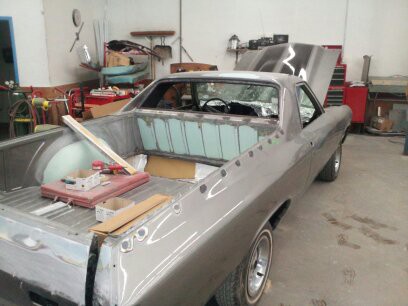

Things are moving along nicely at Maaco; most of the body work is going to involve the bed area. Matt’s doing the body work and Matt is very meticulous, plus he loves classic cars; he also has a 69 Chevelle cream puff.

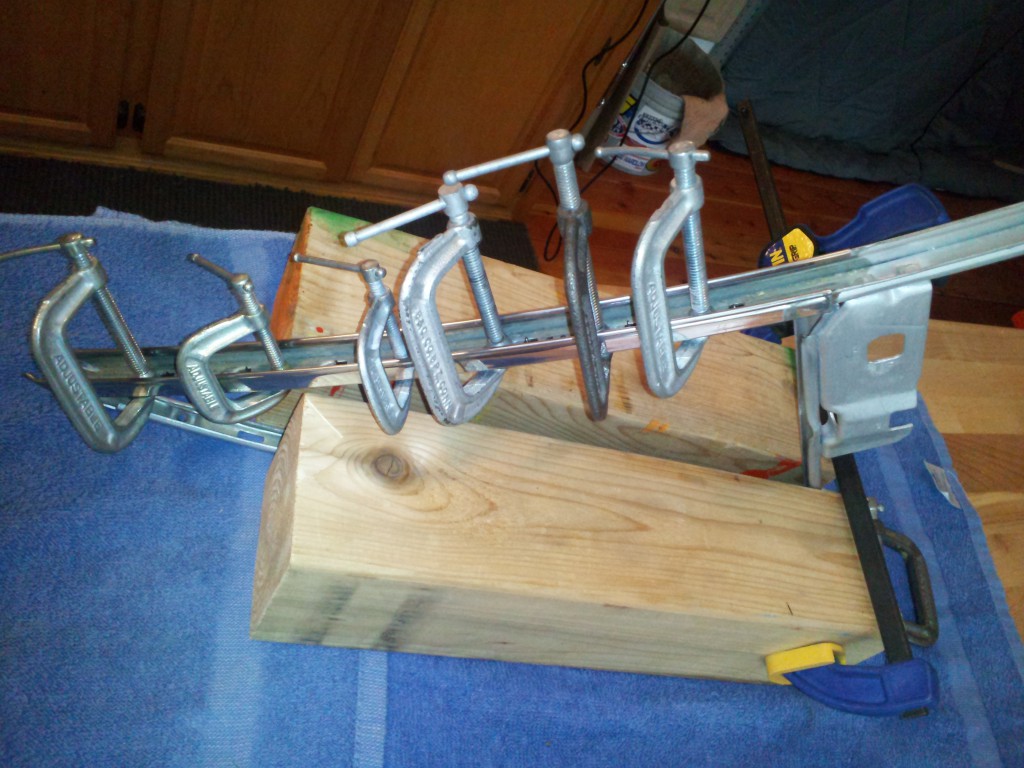

Today I worked on rebuilding the vent windows; I now understand why GM engineered them out of their cars; they are a real challenge. I may need to go to confession when I’m done.

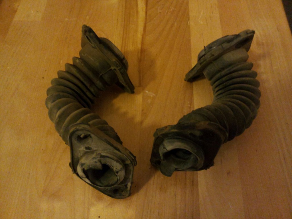

Anyone know of a local source for door rubber looms to route wires through? I’d like to drill the holes and install them when the doors are reinstalled after painting.
maybe try Metro Moulded Parts? Probably a long shot, but you never know....

Looked into a one-piece window, the price was way beyond my pocket book but it would have been cool.
Started when I decided to polish and buff the vent window chrome on my wheel buffer then, I got board and thought I’d give the seals a try; you’re certainly correct, time and lots of patience required. I have installed the rubber seal in the first vent frame but I’m not pleased with the fit; the window does not seat as well as I think it should. I’m not sure if the regulator once installed will hold the window tightly closed. I’d hate to go through all this and still have wind noise. Still waiting on the window channel felt.

Kevin The boots I used for my doors came out of a U-Pullit wreck as well. The hardest task was finding a set where you could use a standard size holesaw or electrical punch. You may have an advantage as the doors are off the car. You could use an undersize saw/punch and merely file the opening to what you need. You could even use oval shaped boots.
Jan 27, 2012
Did you get Metro seals ? Mine didn't look exactly like the old ones either but then they hadn't been mashed by the glass for 40 plus years either. My vent has a lever lock and once I latched that, the glass sealed very nicely.

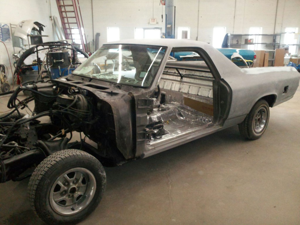

Not a lot to see the last couple of days as its been prime sand, prime sand, prime …..you get the idea. Today Jason sprayed the truck down with a product that levels out and leaves a very high gloss so we could check for imperfections in the body, it is laser straight.
We worked out where the bed liner is going to meet the paint and trim, yep, a sprayed in liner so I can haul the clubs tent my chairs, cooler, grill as well as make a trip to Home Depot.

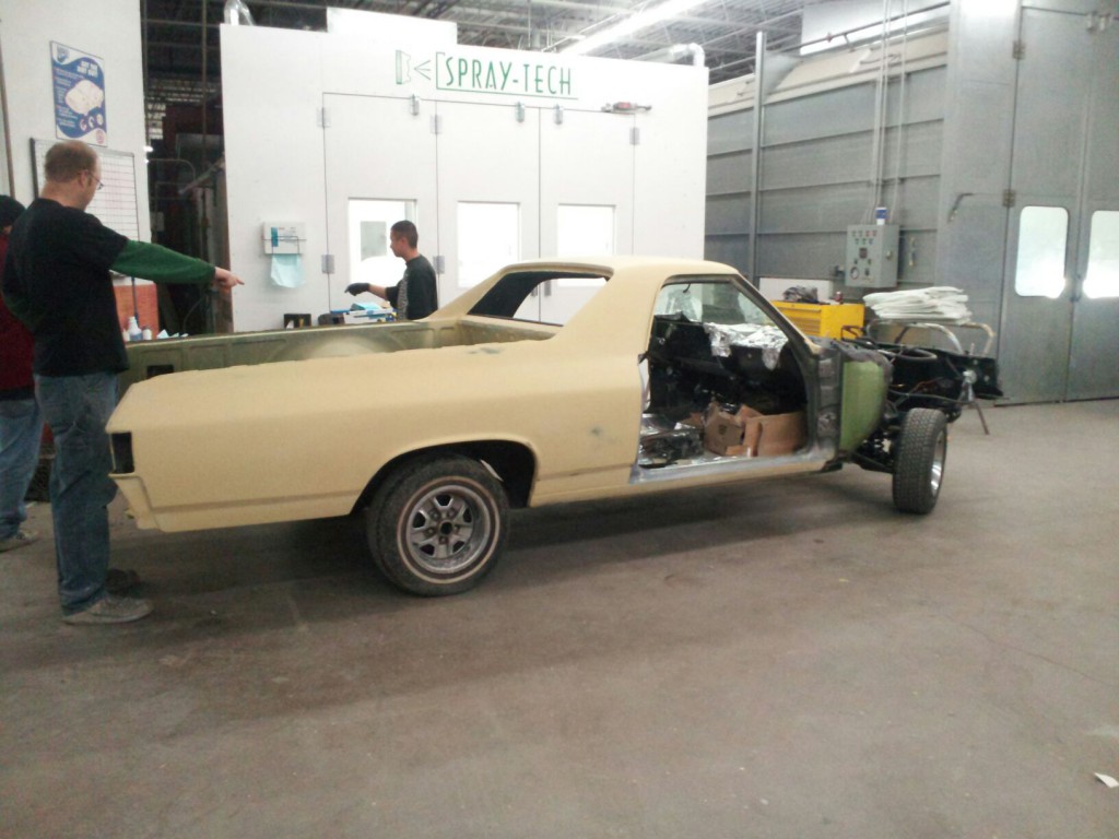

However, biggest news today was that the truck moved from the body shop where the bodywork is done to the paint room or clean area and is ready for paint, got my paint sample today, could be a green Elky tomorrow.

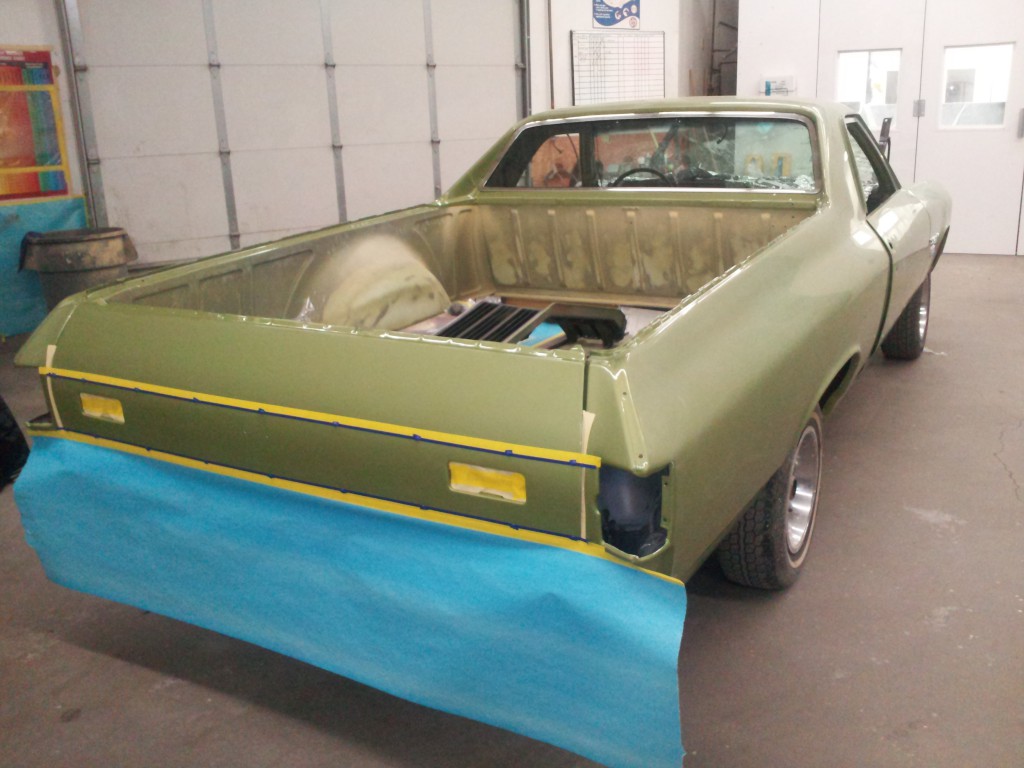

Going green, paint looks great. Jeff told me the painter spent 5 hours in the booth, not sure but it seems like a long time to me.
As we always say the pictures do not do the paint justice, the color really jumps out in person, yet it’s the original color. Much more so than I remember 32 years ago, could be because when I bought the truck in 1980 it had spent its first eight years in Texas and suffered some fading. Or it could be 32 years of Miller Lites.

Attached pics are from Kevin's spy cam installed when nobody was looking...

John, heres what I picked up at U-Pull. I need to drill 1 7/8 and 1 5/16 holes then I should be able to run all the wires I will ever need.
They/you make an "arbor adapter" sleeve for the pilot bit on a holesaw arbor. They all use a 1/4" bit for a center drill. You need to make a sleeve with a 1/2" OD, and a 1/4" ID, for the hole saw arbor to ride in the 1/2" hole in your sheetmetal.
2nd bytch - 1-1/2" and 1-1/4" are the nearest standard hole saw sizes. Now taking into account the inherant "wobble" of a hole saw, you'll still need to do some filing to open the holes to your required diameters.
Not too bad of a job with the doors off the car.
Here's pics of the factory ones on my '72.
John, My thoughts also, I was going to drill a ¼” hole through the center of a piece of ½” hardwood doweling then use the universal rasp and file on a drill.
Stan, the ones I have look identical to yours.

Also, yesterday they repainted the cowl, firewall, core support and rear window shelf.

Not much to report, a few more parts installed, sanded with 3000 grit and going back in the paint locker to paint the black on the tailgate.
