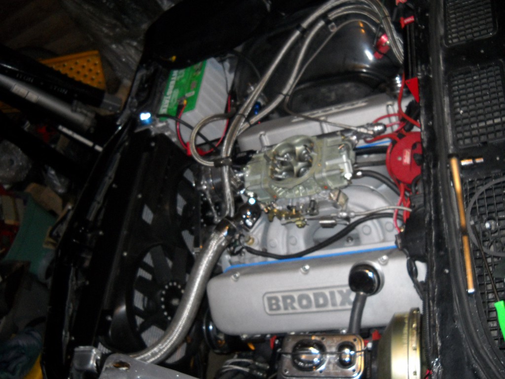

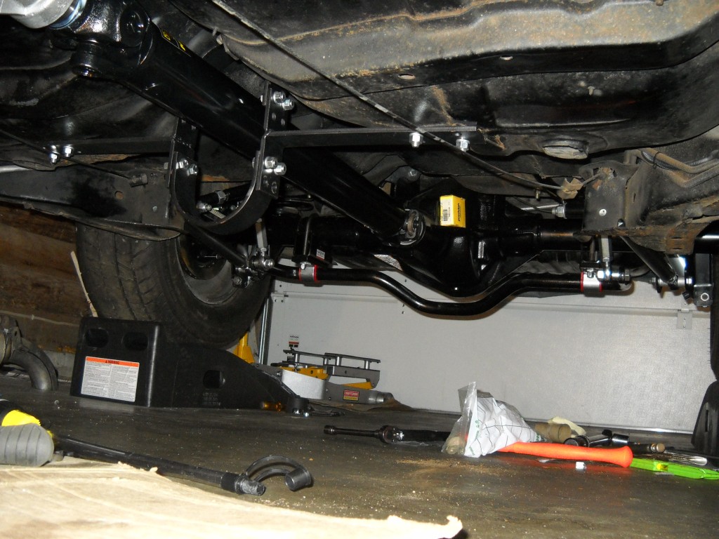

Got ARB in looks like the exhaust mounts did not come into play and fabricated and altered my Driveshaft loop it is about 2/3 up from the rearend Yoke. I hope that is Ok.
Left to do
1) put drive shaft in should be here Thursday
2) Install exhaust hoping for NO issues
3) Time engine check for leaks set carb up hope to do tonight (Open header running Fun) may late it warm up if my ears can take it.
4) set ARB (it is in but have to adjust)
5) Install hood take for test drive. May have found the 14" drop base solution : )
6) have to make bracket for overflow and install.
I do not want to deal with a converter issue or tranny issue. Had to reshim the starter and what PITA. can not fully drop the inspection plate without taking the headers off.
If all goes as planned should have all accept #6 done this weekend. Will not know till test drives, but this may be good to go to Rock Falls the may 21st.
I have spare yokes for both TH350/manual trans and TH400's here, if you want to use one. I will be in St. Paul on Saturday with the Camaro Club and could bring them.
The loop should be fine where it is. It's position needs to be such that if a front u-joint fails, especailly at speed, it will prevent the shaft from falling onto the road and either launching the rear of the car or coming up thru the floor. Anything from mid-point forward will do that.

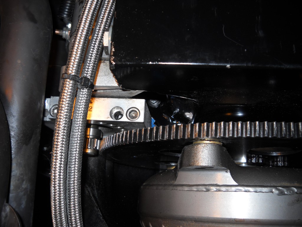

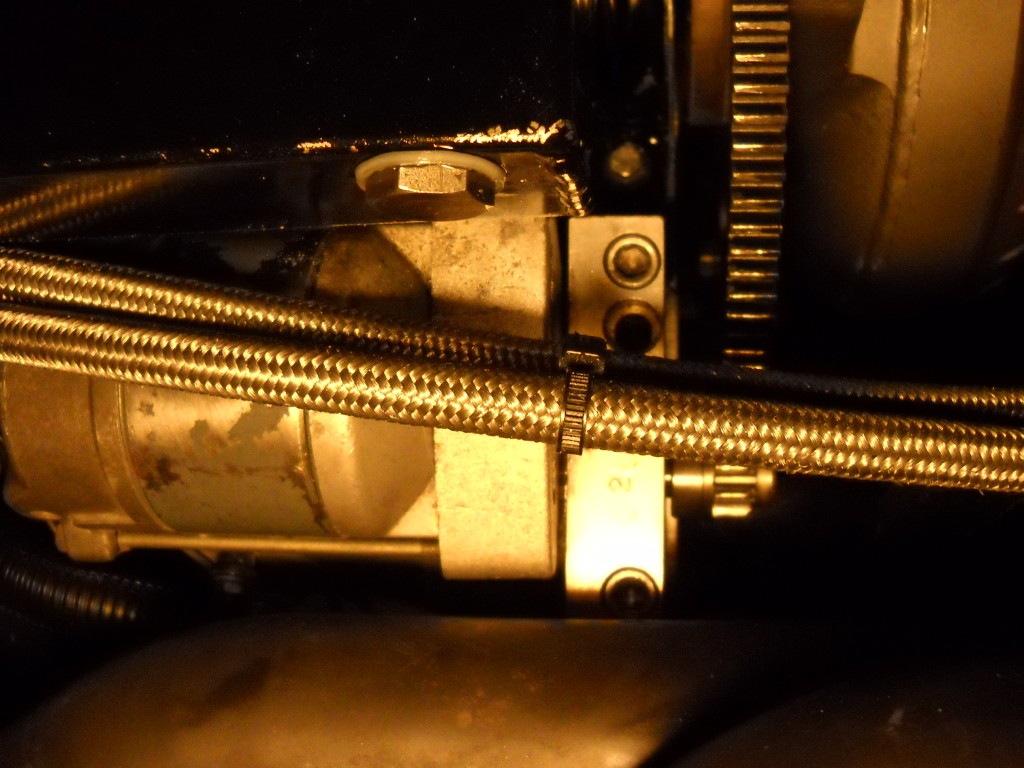

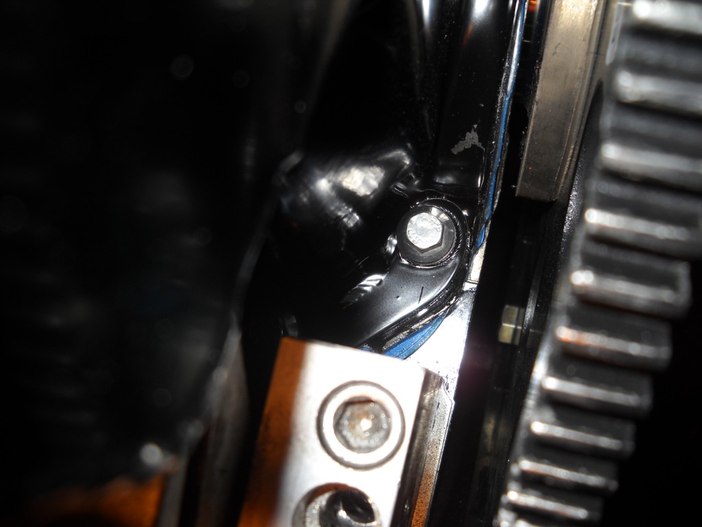

Got driveshaft in fits nice. Filled up GV OD. Had 3 issues. On the side installed System 1 oil filter changed oil and tightend the header bolts.
1) Damn starter works and then does not work keep removing and adding shims. When I set it up to spec it grinds on flex plate. I notice the starter shaft has some play which I do not like. It worked ok today added a 1/64" shim we will see tomorrow. Tyring to find a happy spot for it.

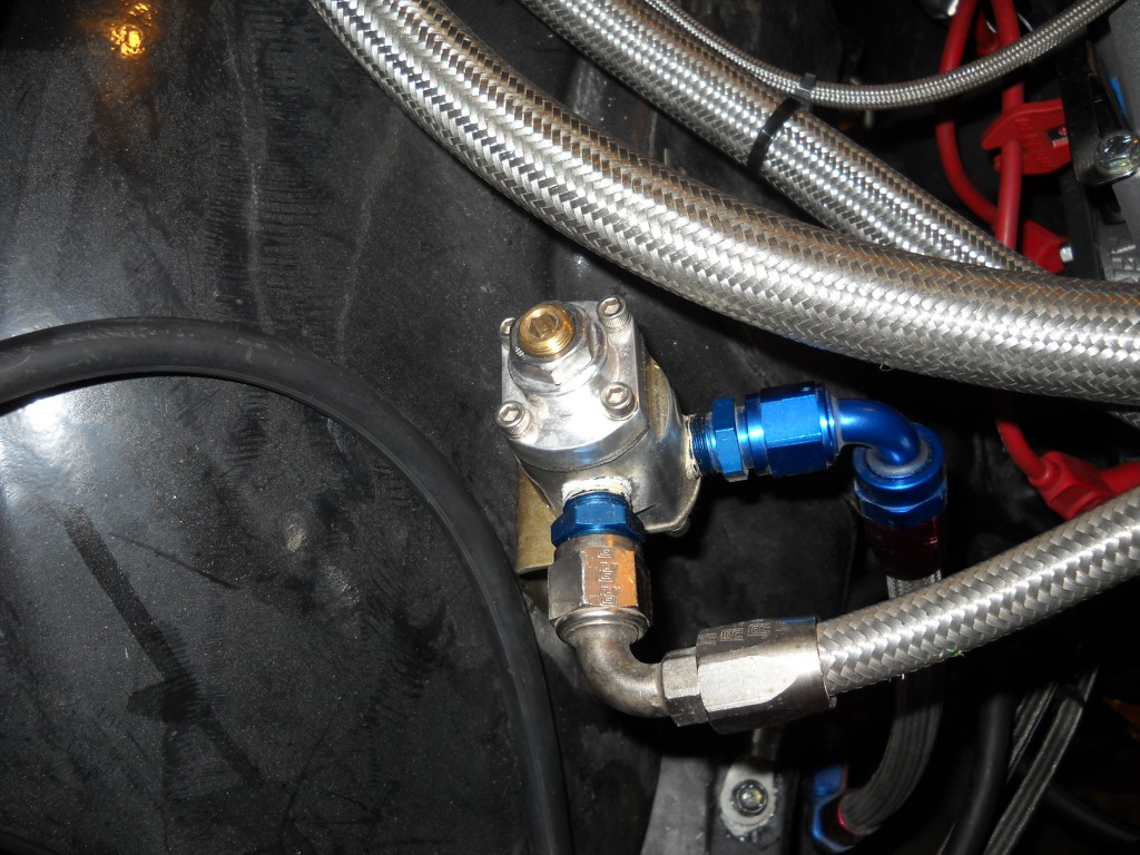

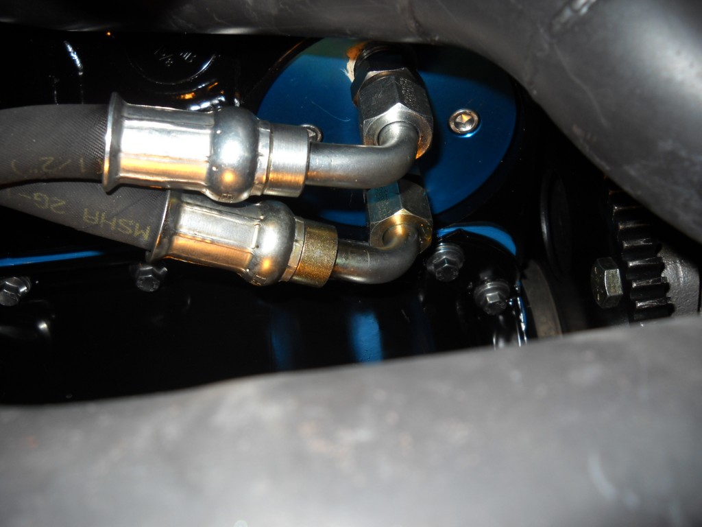

This Fuel pressure thing may be the gauge also, but not sure I seen gas dripping out of carb down the throat at idle which I do nto think it normal.
It is an auto meter in the car with isolater under the hood or the fuel is heating up. I want to get mechanical FP gauge right off Regulator so I can see what is going on. Needless to say Exhaust is not in and nothinelse got done. 1 step forward 3 back. Got to order some more parts : )

Jim, is your flex plate new? I had a similar problem with mine except the flex plate was well used and the teeth had been chewed up pretty good, so depending on which area of the flex plate I set the gap at, the starter would either grind or not engage at all. I have a new one in there now, set the gap per the specs, and so far so good.
It was used but as good as new. Got it off CL from a person who just got it back from ATI. He was a racer and sent it into ATI to get SFI renewed it took so long he ended up buying a new one waiting to get it back. It looked BN. It had no marks now it has some but nothing serious. It was working well last night. Perhaps check later today.
It will not grnd now but it will also not return. I will try 1/64" shim. I had it where it would just slip back by hand, but then it would start grinding. I wonders if I can fit in a stagger type with the nose support. I do not think it can be done : ( headers and clearance issues with kick out pan. 30 min jobs become hours price you pay for performance. The shaft and gear on his starter had some play. So I may bite the bullet and get one from DB Electric

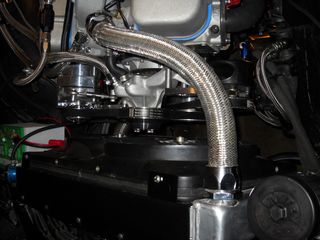

1) Need 3/8" H20 pump spacers.. Was not sure how that would come into play with electirc fan at the time spacings.
2) new crank pulley spaced 3/8" back. Would have to be custom made & this would my perferred way to deal withit. I will ping around to see if someone can make one witout braling the bank. Any ideas hear would be cool. currnet is a March pulley I picked up used. Also have to get box figiured out ot run with it.
