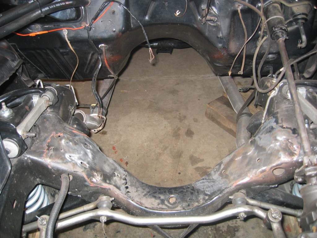

I cut off the clam shell motor mounts that were welded to the crossmember and cleaned it up with a flap disc.

Wow. Those engine mounts really are a mess.

OK, last Saturday, I finished removing the bushings and ball joints from the right control arms and ran them thru the blaster 1 last time. Gave them a shot of Rust converter and let them sit till yesterday. Yesterday was assembly and paint day. Prothane bushings, Moog ball joints and Global West offset upper shafts.
All assembled and ready for paint.
Today I needed to address the frame issues before continuing with the frame clean-up for paint. I was told by the PO that the frame was "fine". Here's fine...I specifically asked about this area where the front boxed frame meets the side channels. Both sides were rusted thru and weak.....
First I fabbed a flat plate to tie the box to the frame rail again.
Then fabbed a piece of angle iron to reinforce the bottom just for safe keeping.
Loads of fun lying on the floor trying to weld under there and not burn myself up in the process. Oh well, got-r-done...here's the left side too.
